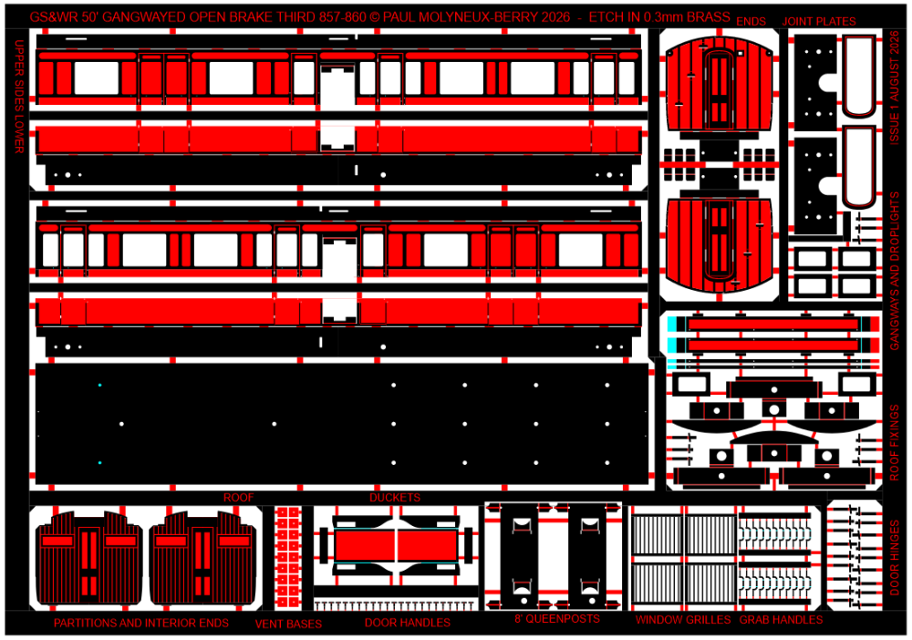

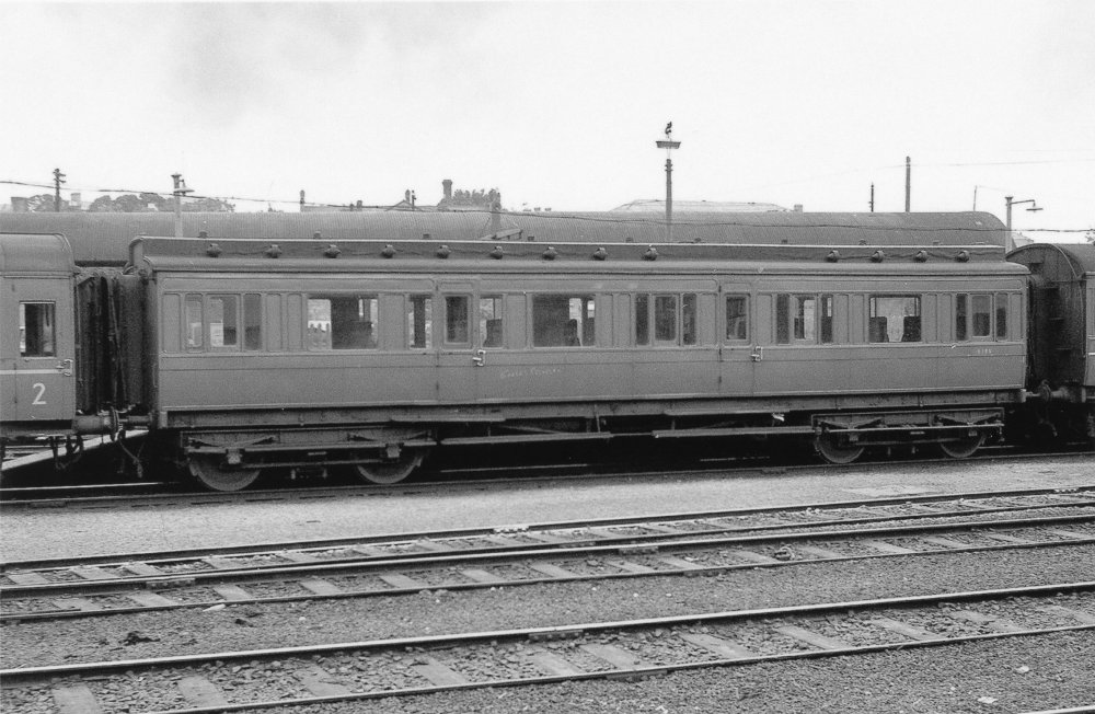

Mol_PMB Posted February 25 Author Posted February 25 The closest relatives to the 50' open gangwayed thirds were a group of 4 brake open thirds that were identical in style and dimensions and also built in 1902. In the Transport Research Associates diagram book these are diagram 32, and they were numbered 857 to 860. They were withdrawn between 1960 and 1966, so had the same lifespan as the thirds which are the main subject of this thread. Originally built with a gangway only at the passenger end, another was added at the brake end in GSR days (not shown in the 1924 diagram but the 1947 and subsequent lists show them all having 2 gangways) By 1961 the three survivors had been demoted to secondary stock. I've found a few photos of these while looking for photos of the thirds, so I thought I'd just add them here. First is an excellent colour view from Ernie, dated 12/09/1960 and showing one arriving at Cork Glanmire Road. With a C class for traction this is unlikely to be a Dublin express, more likely from Tralee. The coach is in light green livery with waistline and 2 class digits: The IRRS archive has two nice photos dated c.1964 showing what appears to be 860 S (S for secondary stock). Also at Glanmire Road, this one seems to be in 'plain green', probably light green, with no waist line or class digits: https://www.flickr.com/photos/irishrailwayarchive/53511482569 https://www.flickr.com/photos/irishrailwayarchive/53511482574 The NLI O'Dea collection has another nice photo dated 08/09/1959, and once again in Cork. This coach has slightly different roof details to the two shown above. It may be in plain green livery and looks darker than the freshly-painted light green K801. https://catalogue.nli.ie/Record/vtls000304702 Unfortunately the IRRS drawing set does not include these brake open thirds. However, I have a simple diagram and there may be enough information in the drawings for other arc roof coaches to derive a model drawing. But one step at a time! 3
Mol_PMB Posted February 26 Author Posted February 26 Following on from the previous post, I found a couple more photos of brake third 860 in the IRRS archive, at Inchicore in 1954. The catch is that these images are flipped left/right - the carriage number is legible (backwards) in the first photo: KAM_DKR_X_Inchicore_12_June_1954 | [Photographer: Kevin A Mu… | Flickr KAM_DKR_GSR_98_X_Inchicore_12_June_1954 | [Photographer: Kev… | Flickr The livery here looks like plain dark green, no lining or class designations.

Mol_PMB Posted February 26 Author Posted February 26 The end artwork was more tricky because the end elevations and cross-sections on the original drawing were badly damaged. However, to fill the gaps I've been able to make use of other drawings from similar carriages, as well as dimensions from the plan view of the one I'm actually modelling. As far as possible I'm using labelled dimensions, only scaling when there's no other option. I've finished the basic end now, there are some more parts yet to draw for the gangway, footsteps etc. Also I need to add the flanges and brackets that connect the sides, ends, underframe and roof. There won't be more progress on this until later next week as I'm heading to Dublin tomorrow morning. 6
Mol_PMB Posted March 15 Author Posted March 15 Newly posted by Ernie, the leading coach here is one of the 50' brake open thirds described a few posts up. Work on the artwork for the full third is progressing gradually when I get the chance. The body sides and ends are nearly done, but I haven't started on the underframe or roof yet. 5

Mol_PMB Posted March 18 Author Posted March 18 Development of the artwork continues. The body is nearly complete, just a few more detail parts to draw and then I need to finish off the tabs: Meanwhile the underframe is catching up. This will be a separate etch so that it can potentially be used with other body variants. There's still a fair bit to draw on this, and then I need to configure it all onto an etched sheet: 5

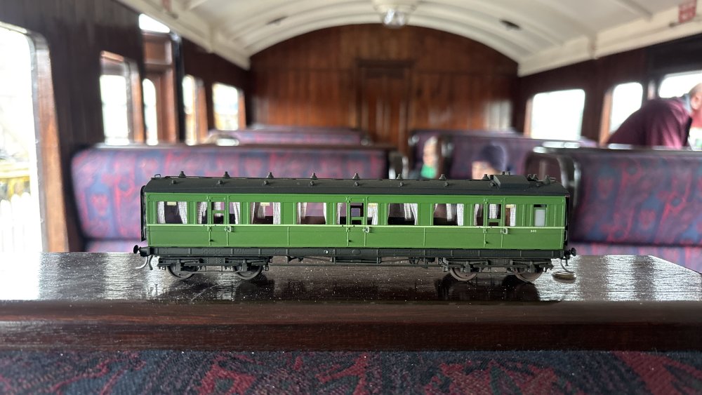

Mol_PMB Posted March 25 Author Posted March 25 I think I've now completed the body etch artwork. This uses broadly the same construction principle as the SSM 6-wheelers which I found worked rather well. There is still more to do on the underframe and bogies, but that will have to wait until I'm back from Ireland next week. Then I'll get a trial set made. I have provided some etched partitions for the interior but haven't yet gone beyond that - at one stage I was wondering about etched seats or at least seat ends, but I've run out of space! The windows are quite big so maybe it's worth making some more effort on the interior, if there's room on the underframe etch? But these coaches were only ever gas lit so it will be gloomy inside. The original seats were more elaborate than the restored example at Downpatrick, and they had high backs: Also seen here in a photo: https://www.flickr.com/photos/irishrailwayarchive/53509061464/ Or do I just use a bog standard Comet style open coach interior? https://www.wizardmodels.ltd/wp-content/uploads/2025/11/int3.pdf What do you think? And how do I reproduce the distinctive material for the curtains? (extract from Ernie's photo https://www.flickr.com/photos/irishswissernie/54398371926 ) 7
Colonel Posted March 26 Posted March 26 Excellent progress! Single ply paper tissue for the curtains? 1
Mol_PMB Posted March 26 Author Posted March 26 10 minutes ago, Colonel said: Excellent progress! Single ply paper tissue for the curtains? Thanks. I think you're right about single ply tissue - perhaps the stuff the etches come wrapped in. I had looked at crepe paper but it was too coarse. I also thought about using graph paper to approximate the checked pattern, but even with 1mm squares it's too coarse and the paper is too stiff. I don't think the tissue paper will successfully go through the printer, so perhaps a very fine pencil or pen could be used to draw a pattern? Or probably that would just look overscale. I will postpone that decision for a while! 1
