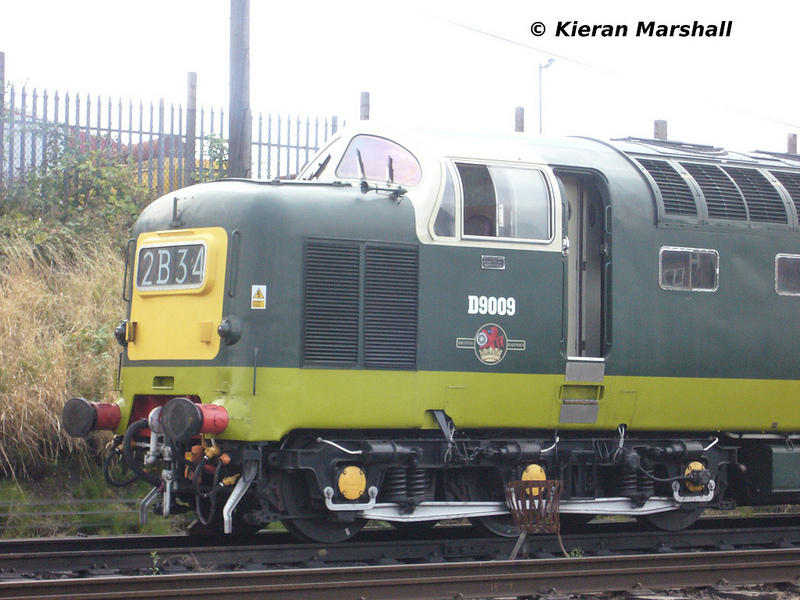

0 daryl43068 Posted June 2, 2017 Posted June 2, 2017 Hi Dave, Replica do the B5 bogie. I did think about using a Class 55 Deltic nose grille on my GSV, but opted to use Evergreen instead (due to ease of conversion) D9009 nose end, 7/8/10 by Kieran Marshall, on Flickr Cheers Daryl
