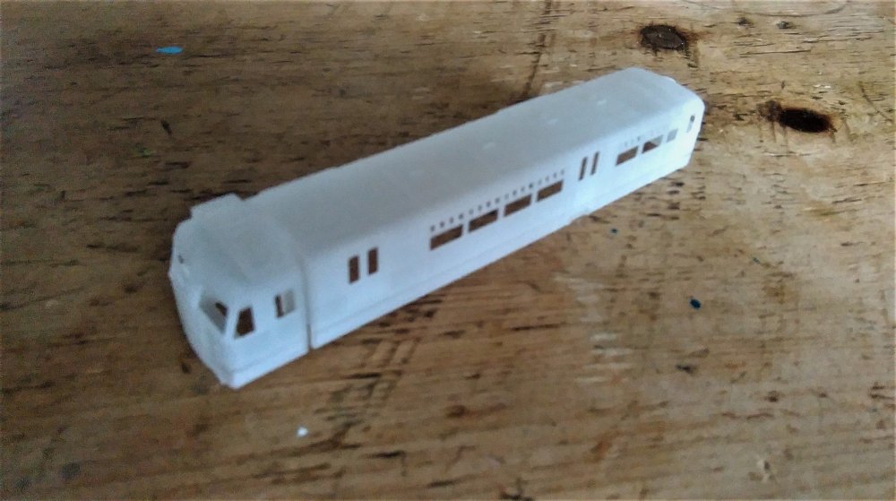

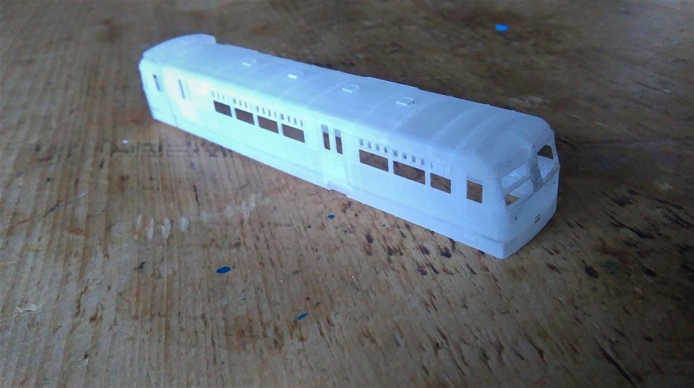

David Holman Posted May 29, 2019 Posted May 29, 2019 Never ceases to amaze me at the stuff that it out there. A 2mm 3D printed SLNCR railcar for goodness sake - and looks good too! Can the body be articulated I wonder? Don't know a lot about 2FS, but would think Code 40 rail should be fine, especially compared to Peco's Code 55 and the wider gauge would definitely set the scene. 1
Angus Posted May 29, 2019 Author Posted May 29, 2019 Indeed, 3d printing does open up a whole new world for rare prototypes, and for 2mm scale is not too expensive either. It isn't an open the box and plonk on a chassis as it is sometimes portrayed, I am already a couple of hours into the smoothing and sanding an only one side and the roof is complete. The cab is rigidly fixed to the body so would require cutting and a flexible connection added to articulate, I'm not sure whether this is worth the effort. The current plan is to use a coach bogie (LNWR 8' seems the best representation) combined with some 5.25mm disc wheels for the 28" rear wheels and use 6mm discs wheels for the 33" fronts. The fronts will need drilling to accept crank pins for the coupling rods, but that shouldn't be too hard. The main issue is the use of wagon wheels prohibits the use of a standard 2mm split frame chassis so I will be back to wiper pick ups. The plus side is this enables a solid drive axle to be used, current thoughts are to use one of these to power the rear coupled axle:- https://shop.kkpmo.com/product_info.php?info=p1003_m400g144-micromotor-with-ratio-144-1.html I reckon it will give a top speed of around 60 MPH (so in line with the real thing) 550rpm x 6mm dia x pi x 60mins/hr / 2mm/ft / 3ft/yd / 1760yd/mile if my calcs a right. It probably won't be very powerful but then there is no tail load to drag. The motor can be mounted vertically in the luggage compartment and should be relatively invisible. 1

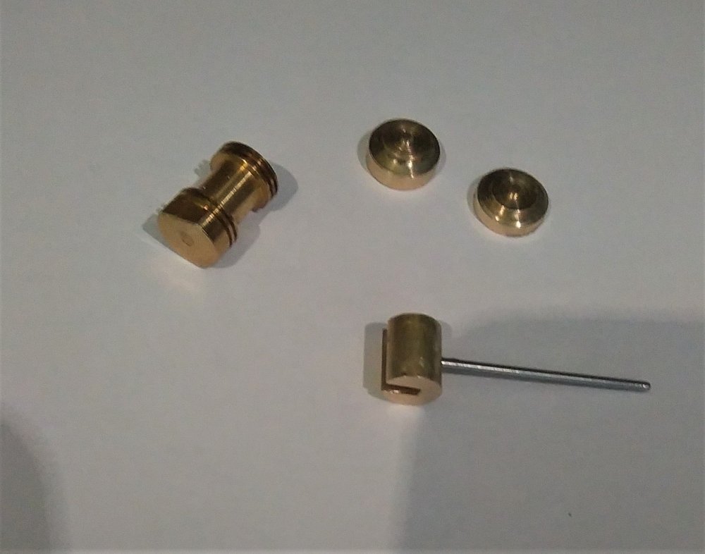

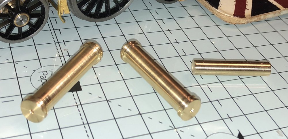

Angus Posted June 16, 2019 Author Posted June 16, 2019 Ok, it may not look much but these bits of brass represent a massive step forward for my recreation of Dromahair. Without them the track could not be built and I wouldn't have a hope of getting anything running well. The are no off shelf options for these gauges for 10.5mm 2mm gauge so they all have to be turned from scratch. I was fortunate in that the rolling gauge was kindly donated to the cause by a fellow 2mm Irish modeller over on RMweb. The rest are the work of my own fair hand. I still need another roller gauge and I would like a check rail gauge, so there is still work to do. I need to get a spacing washer for the toolpost on my lathe before I do though as I am getting some movement as I cannot tighten it down properly without one. Without this I haven't a hope of turning the roller gauges accurately. The gauges here are enough here to start the straight section of track at the rear of the layout that runs past the station platform though. 2
Galteemore Posted June 16, 2019 Posted June 16, 2019 Angus - significant step! When I sold my 32mm UK stuff one major investment of the proceeds was in these ...made for me by a model engineer.... 2

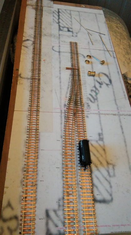

Angus Posted June 23, 2019 Author Posted June 23, 2019 When the Rolling Stones christened their album "Sticky Fingers" I don't think they were talking about gluing sleepers down...... It might not be very rock 'n' roll but I've finished the sleepers (and cleaned the glue off my fingers....) It should be ready for some rail once the holes for the droppers and point control are drilled. 5
Broithe Posted June 23, 2019 Posted June 23, 2019 That's what they mean by "rock and roll" - ballasting and then checking for wheel clearances... 3 1

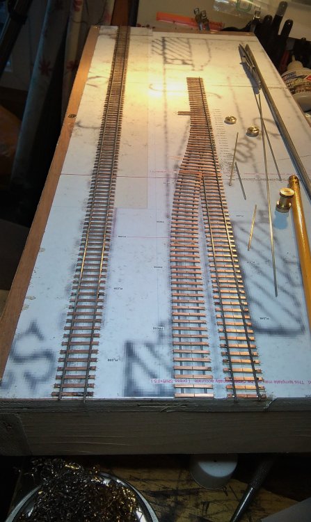

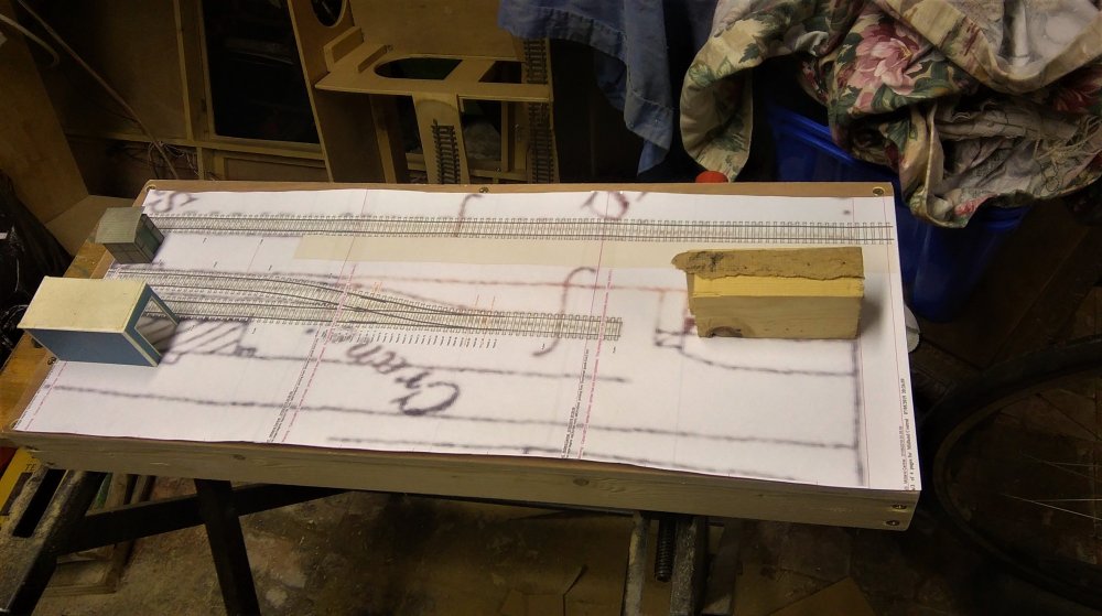

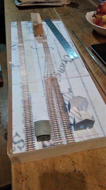

Angus Posted July 8, 2019 Author Posted July 8, 2019 Slow progress at present over at Dromahair due to the past couple of weekends being tied up. I've managed to get some rail down though. H I've used the 2mm Scale Association's code 40 flat bottomed rail which is a bit heavy duty for the SLNCR but hopefully it captures the Irish broad gauge feel. I really need to get a wagon chassis built before I finish the point though otherwise I risk having to rebuild the whole thing once complete if a roll through highlights any issues. 4 1
Angus Posted July 9, 2019 Author Posted July 9, 2019 7 hours ago, Mayner said: Trackwork looks really neat Thanks Mayner, but I'm not sure that's a compliment if I'm trying to replicate the SLNCR! 1 1

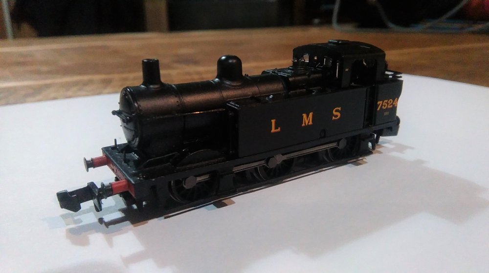

Angus Posted July 22, 2019 Author Posted July 22, 2019 (edited) Due to the recent outage I am behind with my posting. Whilst viewing some photos of the SLNCR on the web, I found a photo with what looked like a 14t tank wagon just coming into shot. As I've got a Farish version of one of those it occurred to me I don't need to build a wagon chassis in order to test the trackwork, I can use a Farish chassis with replacement axles and the wheels spaced for 10.5mm gauge. The tank wagon seemed a suitable candidate but required the brakes to be removed for the wheels to spin. I'm not sure who owned the wagon, I seem to recall seeing a photo another tank wagon on the SLNCR but could have sworn that was in Shell livery. There is reference to tar being delivered to a Council siding on the line, perhaps this is the delivery method? A tank wagon would add variety to the freight workings. With a rolling wagon available the trackwork was finished over the course of a few evenings. Next I need to install the mechanism. I have a manual (blue point?) switch left over from an abandoned 7mm scale project. These are like an unpowered tortoise motor, and was going to be pressed into use on Dromahair, The only snag is that I've used 2"x 1" timber frames which aren't deep enough. A couple of inch deep 2x2 sections on the corners of the baseboard should add sufficient depth, the backscene boards will hide the bodging. I found the lever frame at the Gauge O Guild's Telford show a few years ago, broken, bent, tarnished and for sale for a few quid, A couple hours renovation work brought it back to life and with three levers will find use at Dromahair (two signals and one point). It will be mounted on a platform at the side of layout. Edited July 22, 2019 by Angus 6 1 1

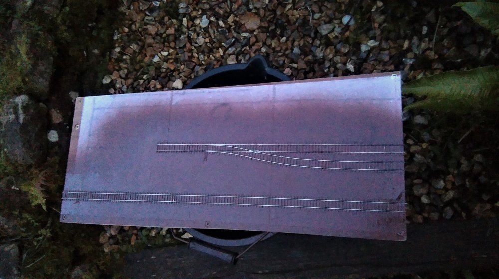

Angus Posted September 1, 2019 Author Posted September 1, 2019 (edited) slow progress over at Dromahair. I picked up some Alphagraphix kits at Telford on Saturday so hope to get these scaled down and some wagon builds under way soon. Otherwise I've wired up the track ready for power once I have a suitable loco and given the track a quick spray. It'll need a bit of touching up where I've caught the sleepers when I wiped the rail tops cleans, it will also need a bit of tone adding but then should be ready for ballasting. I also managed to track buy a reprint of the 1936 Service timetable recently. This gives a real insight in how the line was operated. One of the nice things about modelling a real location is the tangible link to the past created when reading documents such as these. Edited September 1, 2019 by Angus 6
