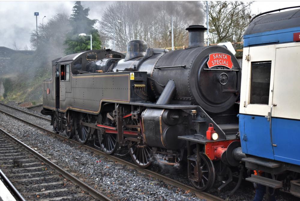

Noel Posted April 14, 2020 Posted April 14, 2020 (edited) Hopefully next winter might get around to tweaking this Bachmann Fairburn 2-6-4T closer to no 4. The prototypes (ie ex-LMS UTA Jeeps) were quite powerful locos well capable of hauling 8 coaches. Edited April 14, 2020 by Noel 2 Quote

Galteemore Posted April 14, 2020 Posted April 14, 2020 9 hours ago, Noel said: Hopefully next winter might get around to tweaking this Bachmann Fairburn 2-6-4T closer to no 4. The prototypes (ie ex-LMS UTA Jeeps) were quite powerful locos well capable of hauling 8 coaches. Nice Noel, although the LMS hooter will have to go! I never liked No 4’s whistle which always sounded like a scream. The GNRI version was more melodious. 1 Quote

leslie10646 Posted April 14, 2020 Posted April 14, 2020 (edited) I hate to rain on this parade, but the "Tanks" were a parallel boilered loco. The base used for the two built for me (by a well-known gent in Co. Down) is the Hornby Fowler tank - which was, anyway, the grandpa of the Class WT. That said, thanks for the video of the Fairburn, Noel. I had one ride in 1966 behind one between Birkenhead and Hooton on the day I was interviewed for the job which is still paying my pension! Edited April 14, 2020 by leslie10646 2 Quote
Galteemore Posted April 14, 2020 Posted April 14, 2020 (edited) I’m assuming that’s why Noel’s waiting for winter Leslie - to have time to Dremel off that taper and insert a parallel tube..and you can hear 4 scream here.... That’s always struck me as one of the frustrations about the WT as a model - from smokebox to tank it’s largely Fowler - after that it’s Ivatt/Fairbairn! Edited April 14, 2020 by Galteemore 1 Quote
