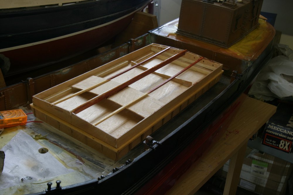

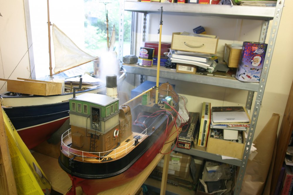

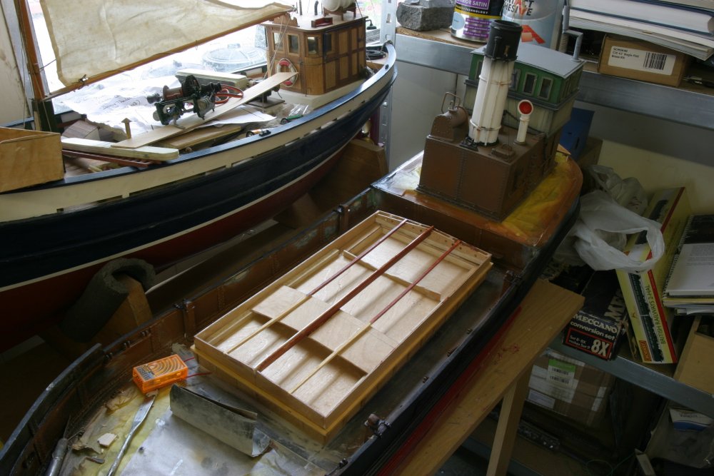

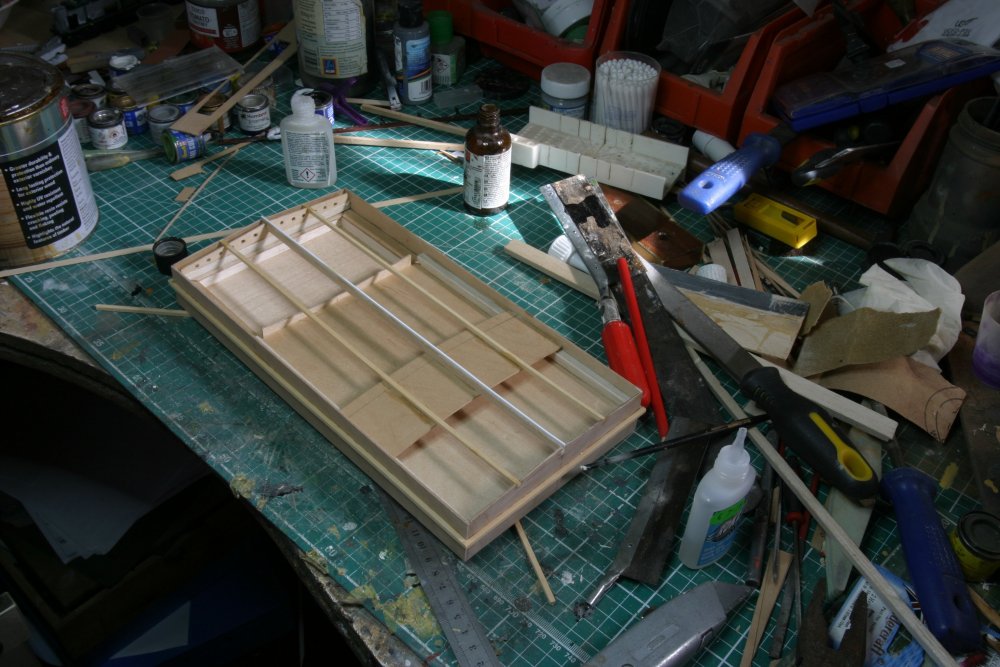

Georgeconna Posted April 29, 2020 Posted April 29, 2020 (edited) Hi all, This was a pressie for my Fathers 70th, 5 years ago and he is just not up to the job due to MS and poor Memory, I did not want to push him to finish it as he is just not able so after some cafeful discussion he asked would I take it on so this is the next project. It is a bit model, There is a Mark 3 on the deck for size Comparison. In order to finish this I had to splash out on the follow bits and bobs and you though Trains were expensive!, Add to that Brass wire, replacement Handrail Stanchions and a Step up Converter plus a bit of paint! EF DESCRIPTION QUANTITY PRICE COST QD20 1:24 Scale 10ft Clinker Dinghy 1 £15.65 / US$19.56 £15.65 / US$19.56 RB017314 14mm bottlescrew with 2mm dia thread fork ends 7 £1.12 / US$1.40 £7.84 / US$9.80 K65409 8.7 x 5.7mm Brass Stud-Link Chain 1 mtr 1 £13.91 / US$17.39 £13.91 / US$17.39 K62212 Brass Shackle 4mm wide x 7mm high (Pack of 2) 12 £5.10 / US$6.38 £61.20 / US$76.50 4125/20 Rigging Cord Natural Hemp 2mm 5mtr 1 £4.14 / US$5.18 £4.14 / US$5.18 GR632 Working 360-degrees lanterns: 17 mm high (Pack of 2) 1 £6.42 / US$8.03 £6.42 / US$8.03 34390 Rigging Cord Natural Hemp 1.25mm 10mtr 1 £2.88 / US$3.60 £2.88 / US$3.60 RB08230 Single derrick block 6.8mm long (Pack of 5) 1 £3.62 / US$4.53 £3.62 / US$4.53 RB01006 6mm dia drilled brass sheave 3 £0.52 / US$0.65 £1.56 / US$1.95 5664/23 360 degree masthead lamp,Dia. 12mm 1 £6.85 / US$8.56 £6.85 / US$8.56 RO1643 Nav lamp set lighting board 30mm long 6v 1 £11.58 / US$14.48 £11.58 / US$14.48 F643 Ships Bell 10mm high x 10mm dia 1 £0.83 / US$1.04 £0.83 / US$1.04 Subtotal £136.48 / Here is the current State of play this am, More done in the past 5 days than 5 years, To be fair he did most of the superstructure for the decks but that was it. I had to strip down a good bit in order to tidy up the splodges of Resin he dropped about the model. ( I hate working with Resin but it is a must) Here are some pictures of the boat. It should looks nice when done and the smoke unit is working away and the lights working. cheers for now. George. Sorry wrong shutter speed on the camera so bit blurry Arrgh. Edited April 29, 2020 by Georgeconna 11 3 Quote
scahalane Posted April 29, 2020 Posted April 29, 2020 That's a cracker George, good size as well. Off down to Atlantic Pond when restrictions lift to lauch her!! I got my mind on doing the Cork dredger 'The Ringacoltig' at some stage but very much on the very long finger. 1 Quote
murrayec Posted April 29, 2020 Posted April 29, 2020 Lovely stuff George, I like the scale and it's my preferable type of boat, it will be nice to see it running when finished.... Eoin 1 Quote
popeye Posted April 29, 2020 Posted April 29, 2020 Beautiful model, beautifully built. It will be nice to see it on the water. Quote
JasonB Posted April 29, 2020 Posted April 29, 2020 Lovely job George. Very impressive. It'll look great on the move. Quote

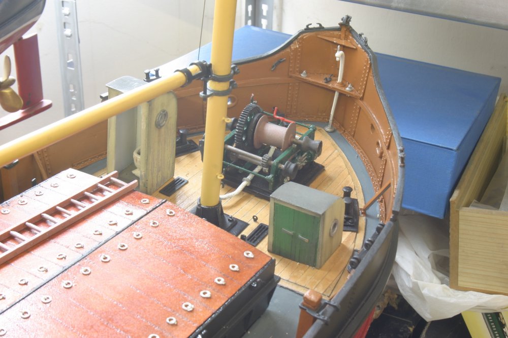

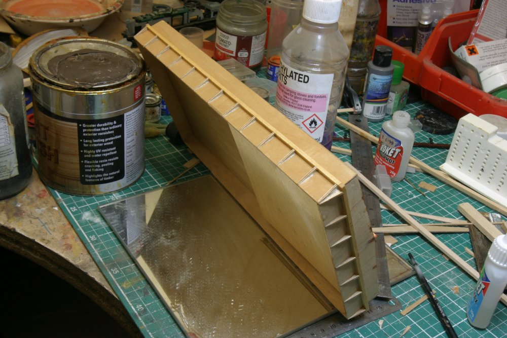

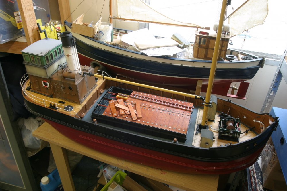

Georgeconna Posted May 6, 2020 Author Posted May 6, 2020 Hi Shipmates, Full steam ahead on this one, the Hatch done, Hull Re Sprayed, Steering chains done, Handrails done and some other little fittings not that apparent. Just now waiting for the rigging gear and lights and some other little bit n bobs to enhance it. Sneaky Titanic in their too. 7 1 Quote

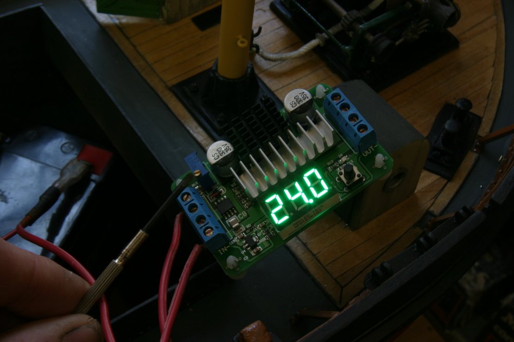

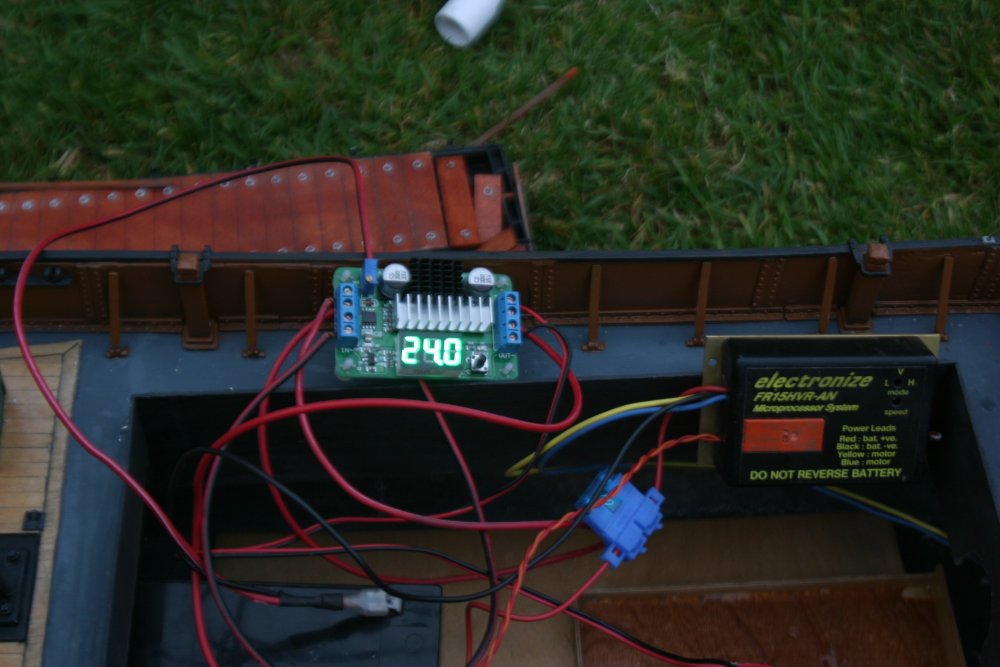

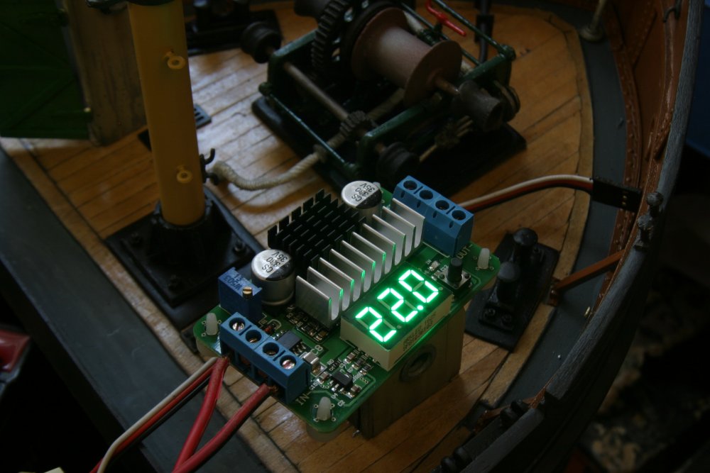

Georgeconna Posted May 7, 2020 Author Posted May 7, 2020 (edited) The Step up convertor arrived in the post today. Some types of these are handy as you can also step down so have a application for Model Railways too if you want to power lights off your 12V you just dial in the out put and hey presto (not this one though). Simple enough to use. you can see here the unit was set at 22V output, the little POT was then dialed with a screwdriver to the desired out put that I needed to 24V. Magic The joy was short lived as the flipping mister unit gave up the ghost 10mins later. 5 years old but 10 mins switched on. FFS. I hope to be able to get the mister part itself now so I don't have to junk the whole thing. You can see the mister unit taken apart in the 2nd last photo. Edited May 7, 2020 by Georgeconna 6 Quote
popeye Posted May 7, 2020 Posted May 7, 2020 Too technical for me, looks like a bomb and might set the smoke alarm off But it will look nice on the water. 1 1 Quote

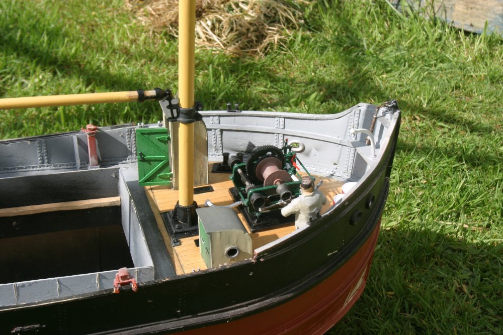

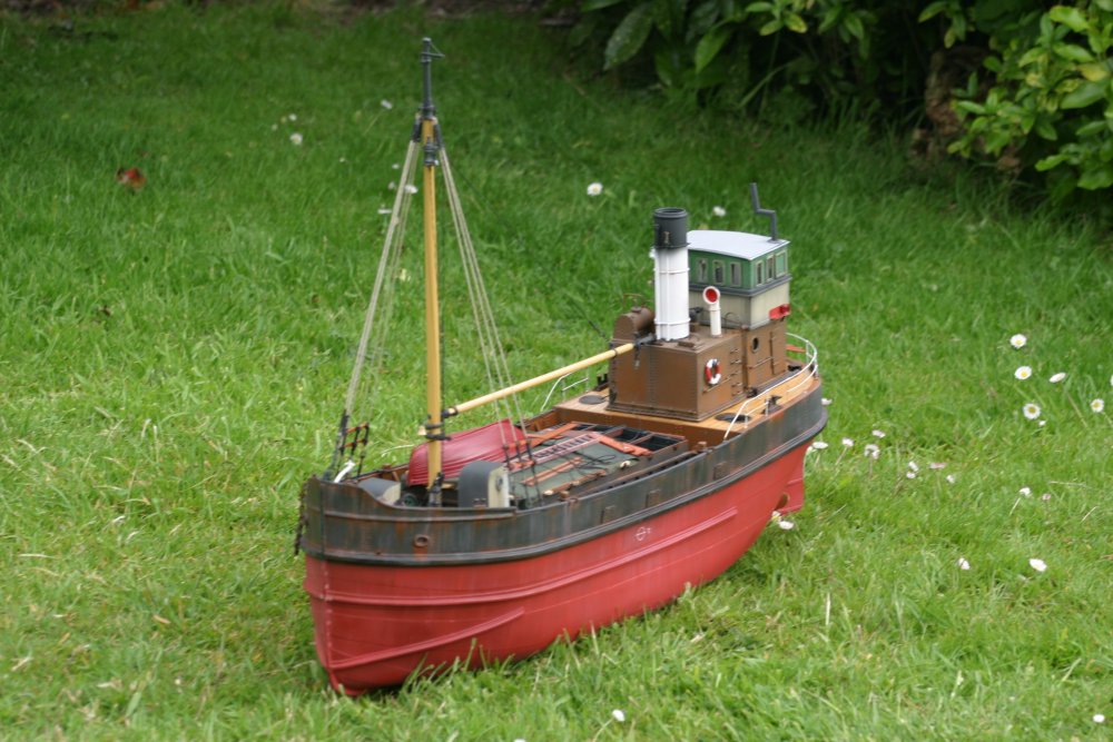

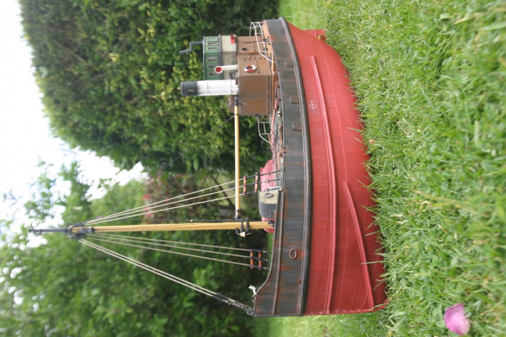

Georgeconna Posted May 19, 2020 Author Posted May 19, 2020 Hi Lads, My packet if goodies came so the rigging is 90% done, just need to do the rat lines and source a suitable Cargo hook. Still need to have some 1mm cable or the winch to arrive and some black a white rigging thread and a few other bits n bobs to set it off. Leds going in tonight in the cabin area Heres the status at of Last Saturday, 6 5 Quote

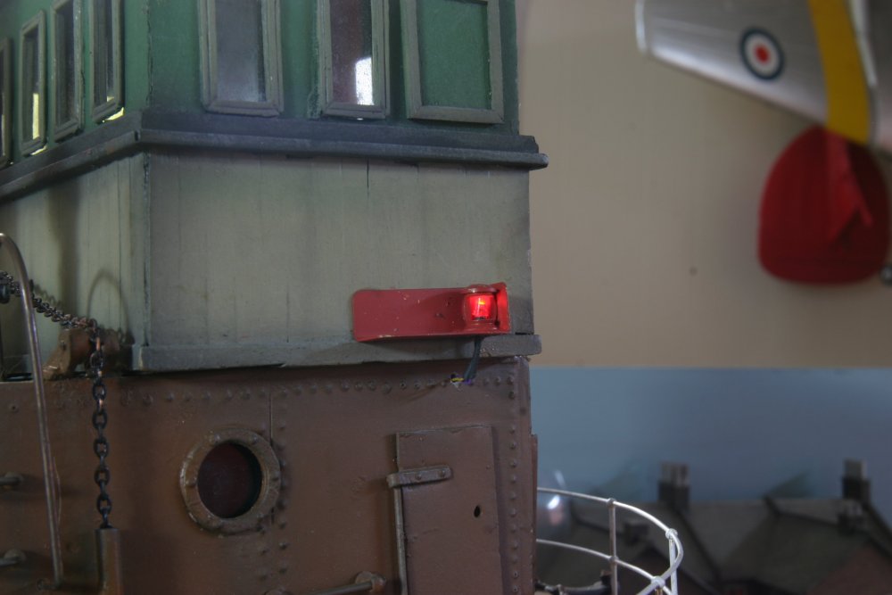

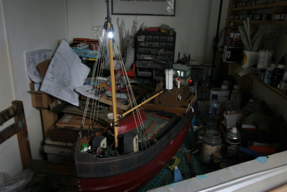

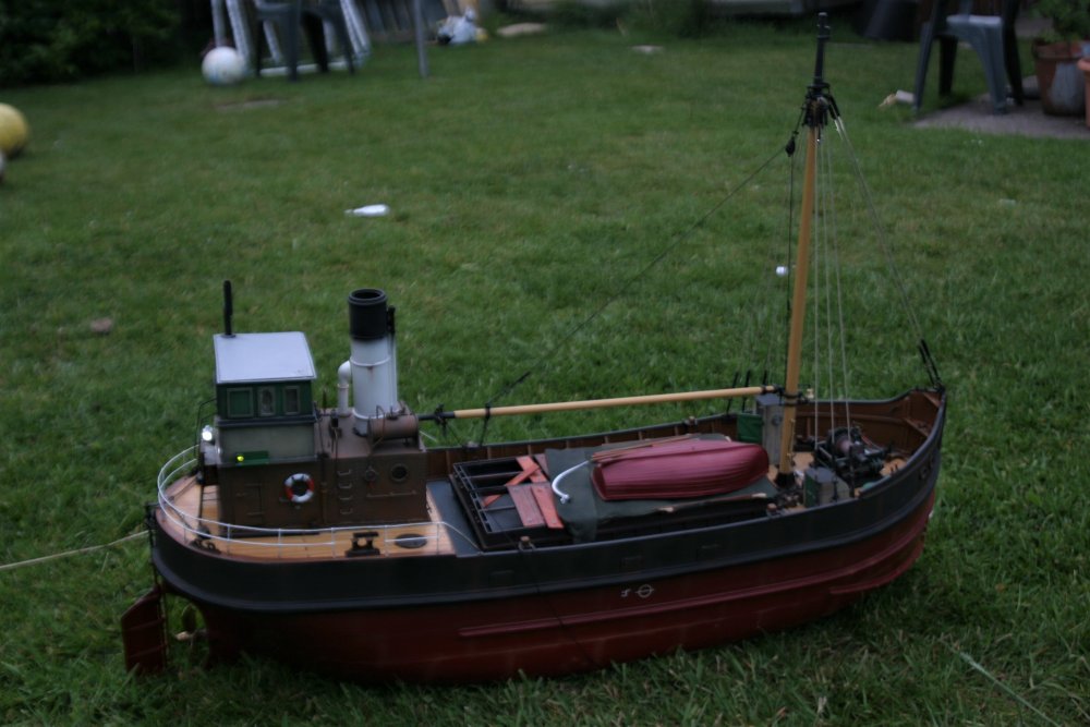

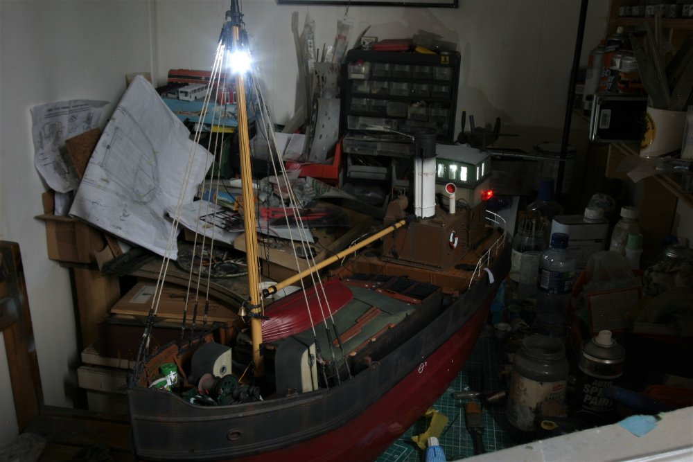

Georgeconna Posted May 21, 2020 Author Posted May 21, 2020 The Dark Side. Well those light went in lovely! Just stuck in the spot light post shots, I was not going to but what the heck. You wont see these in daylight to be honest so these are a luxury. Stern lamp, Nav Lamp, Cabin Lamp and foremast light all in. 6 2 Quote

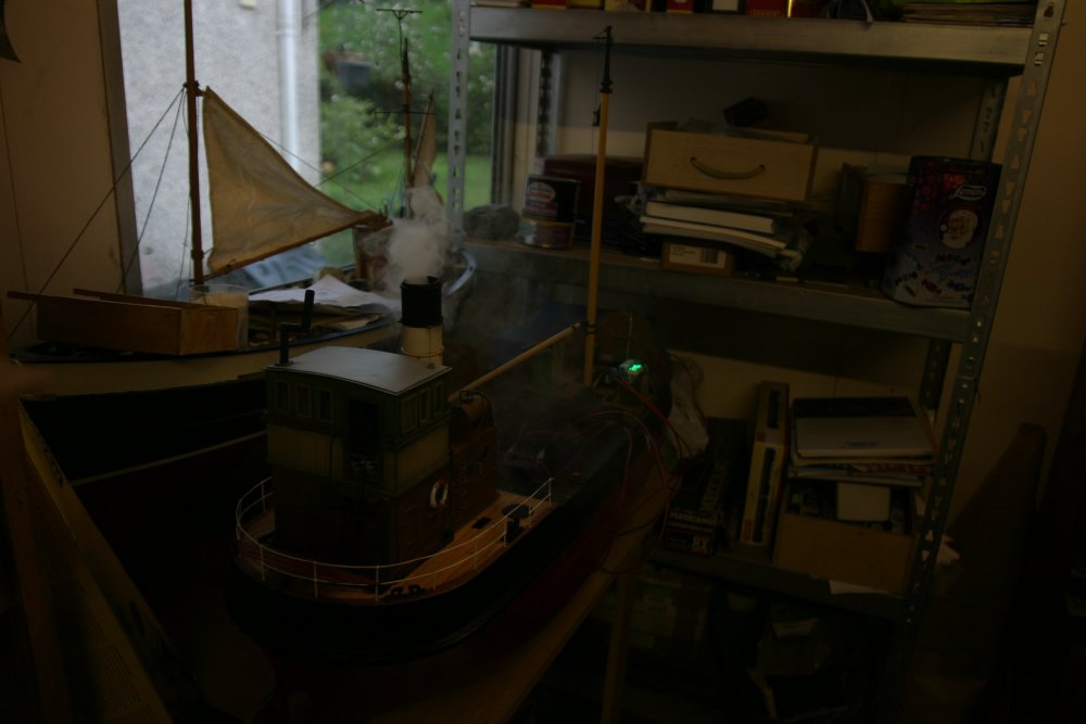

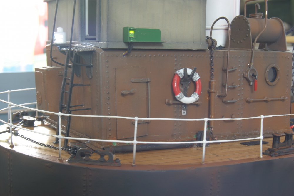

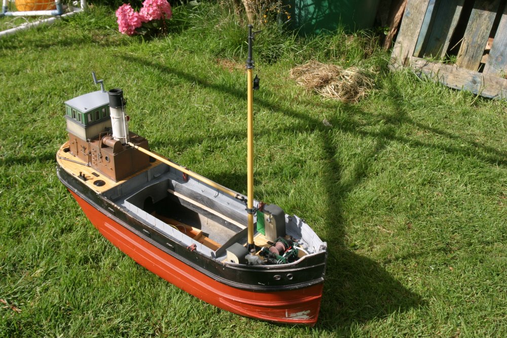

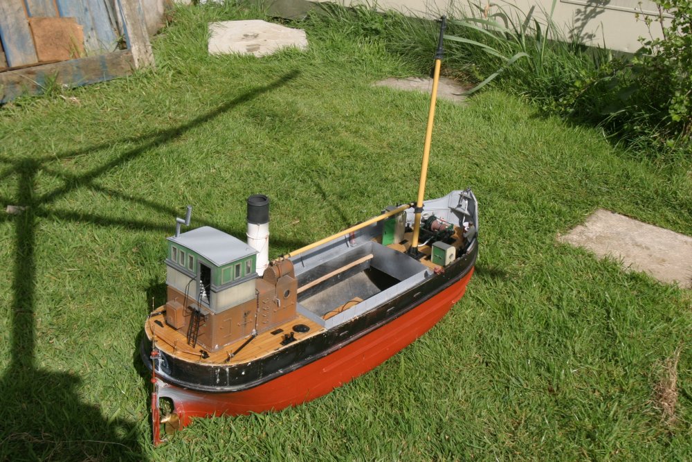

Georgeconna Posted May 25, 2020 Author Posted May 25, 2020 More weathering done or possibly overdone and I touched up the hull chipping, Need to get some salt streaks on the black part next and bed the stuff in and some fading on the red. You can just about see the Smoke coming out of the stack but as it was near gale force it did not hang about to much! 4 Quote

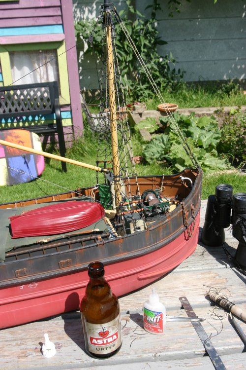

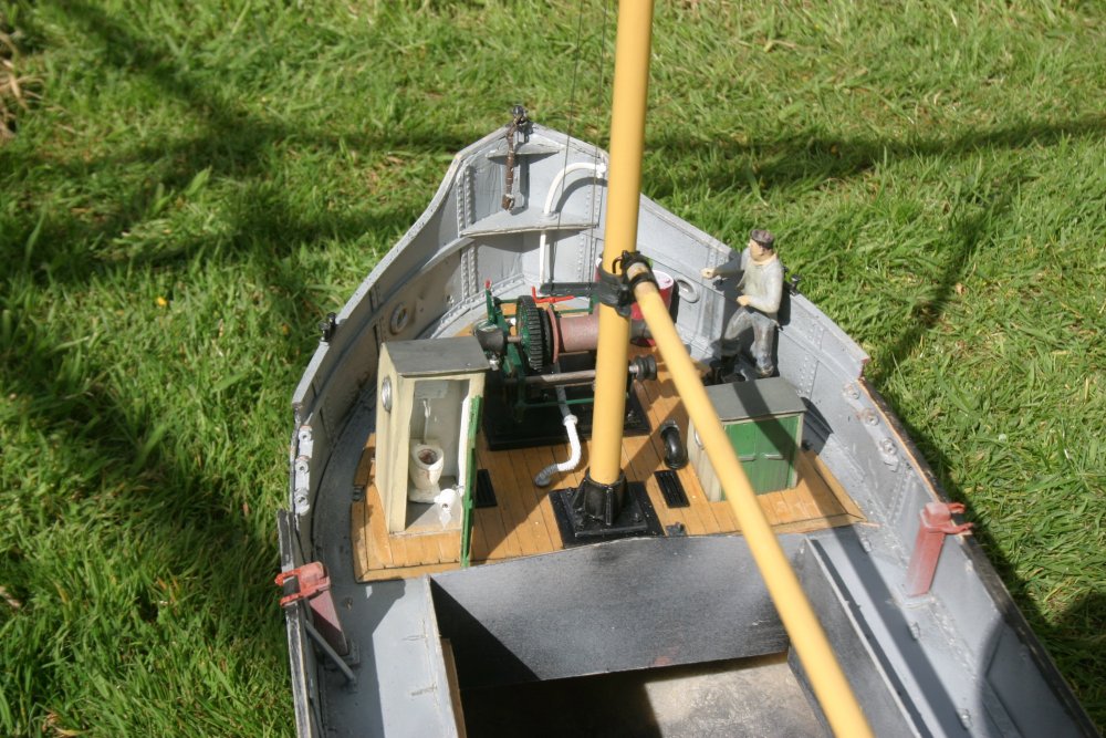

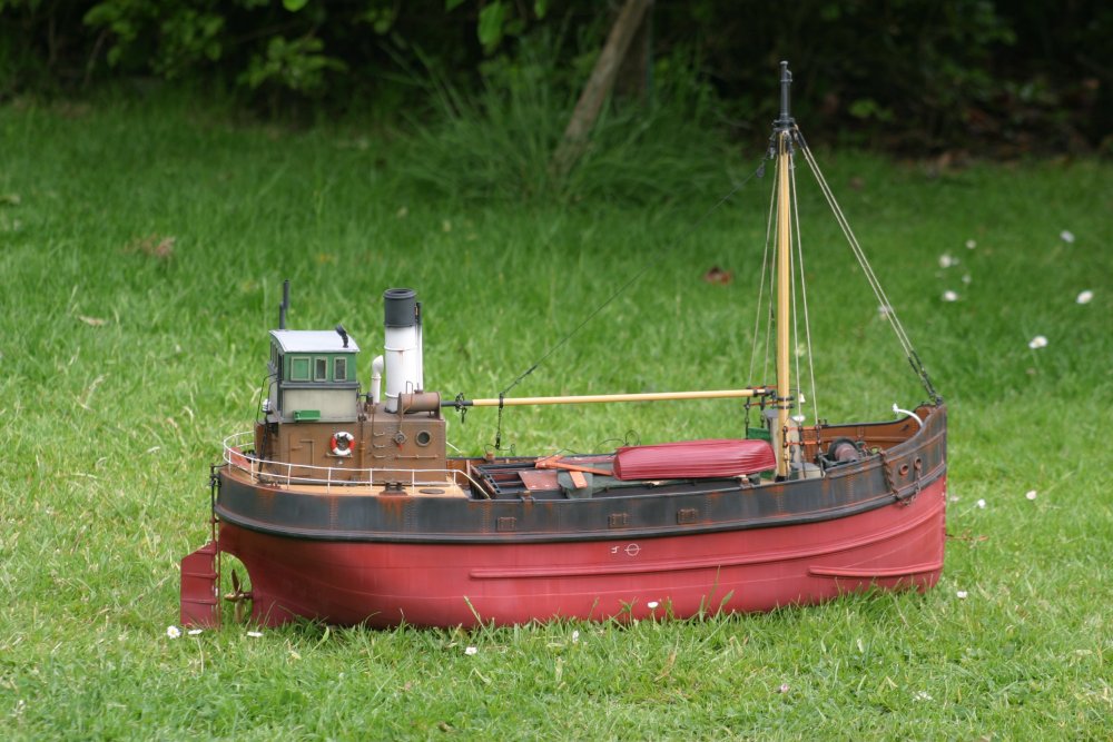

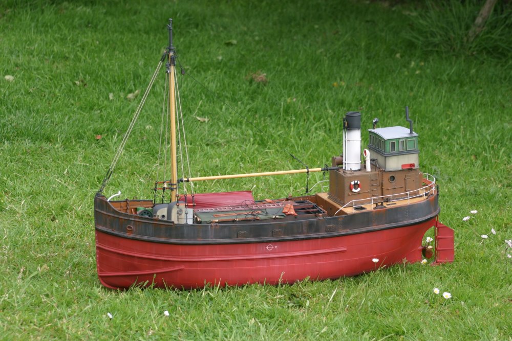

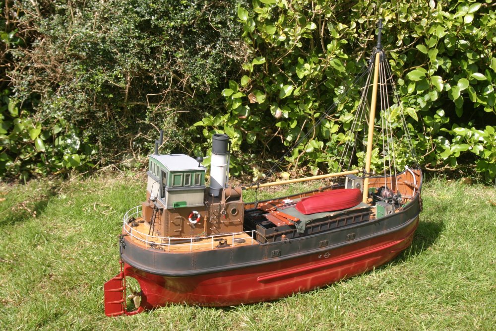

Georgeconna Posted May 26, 2020 Author Posted May 26, 2020 Slowly Slowly does it, Weathering complete. faded the hull so looks kind of used and perhaps more pity and love will be shone upon here in the Pond, The ol fella is 75 tomorrow but still need the final bits to come through so not complete for his Birthday, the rocket pack never came through and the back up plan of a Balsa wood Comper Swift and free flight glider also do not materialise so it is going to be 2 packet os Bassets allsorts for now Few Piccies for now. 5 3 Quote

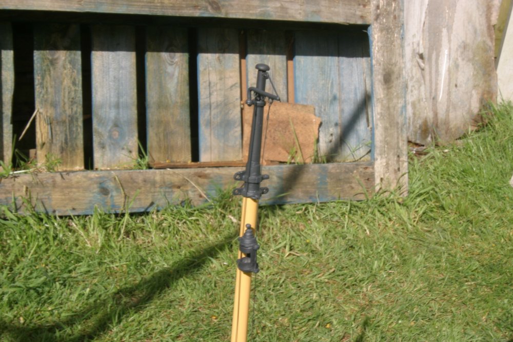

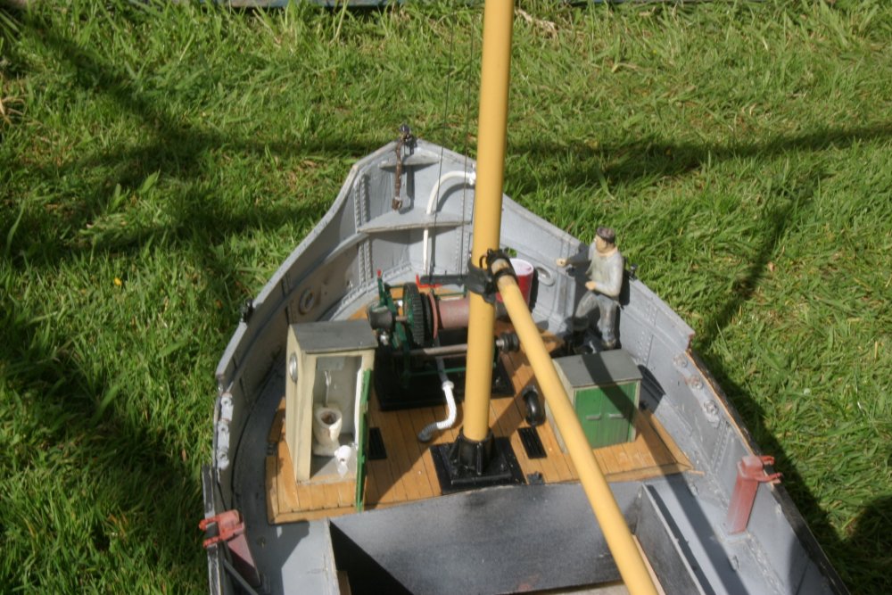

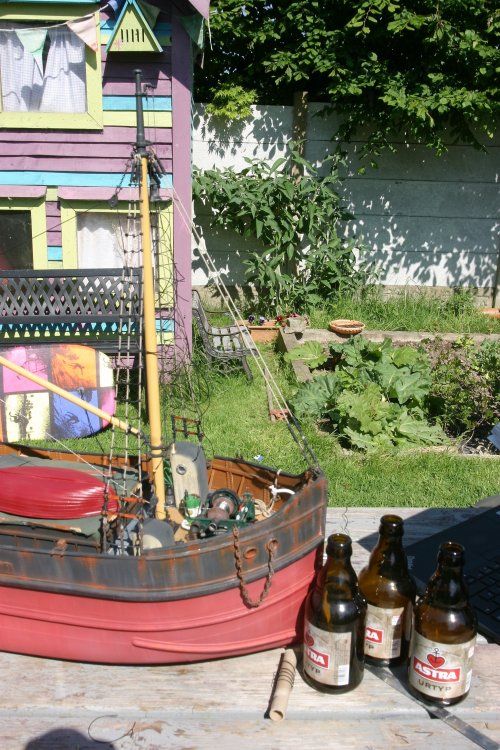

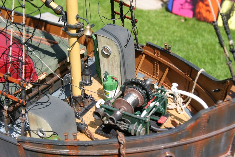

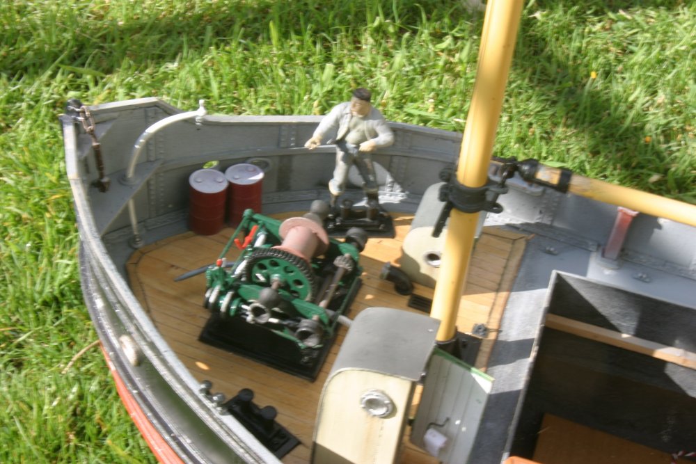

Georgeconna Posted June 1, 2020 Author Posted June 1, 2020 4 hours in the garden nearly 100 knots, 3 beers and a Scorched back and the Rat lines are now done. worst job of the whole thing I reckon. Winch is wrapped up with some lovely cable. Sets it off nicely along with a Hand pump for the oil drum 5 Quote

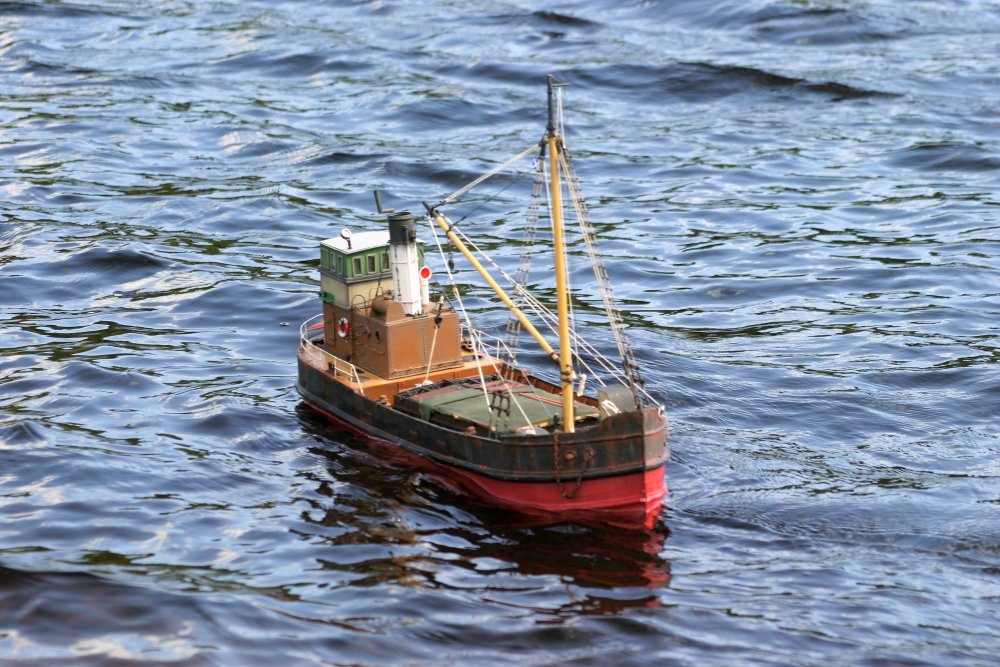

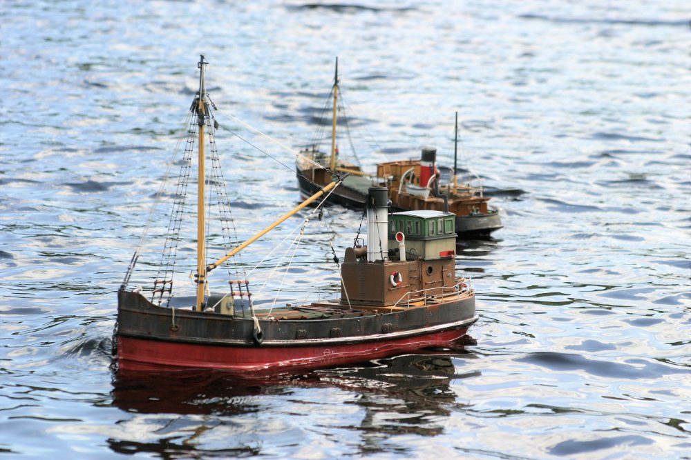

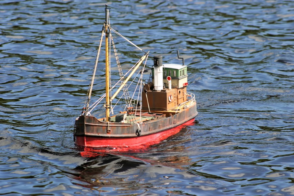

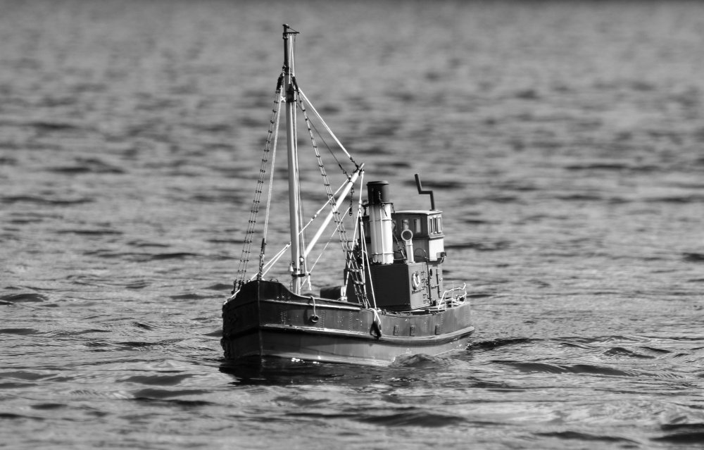

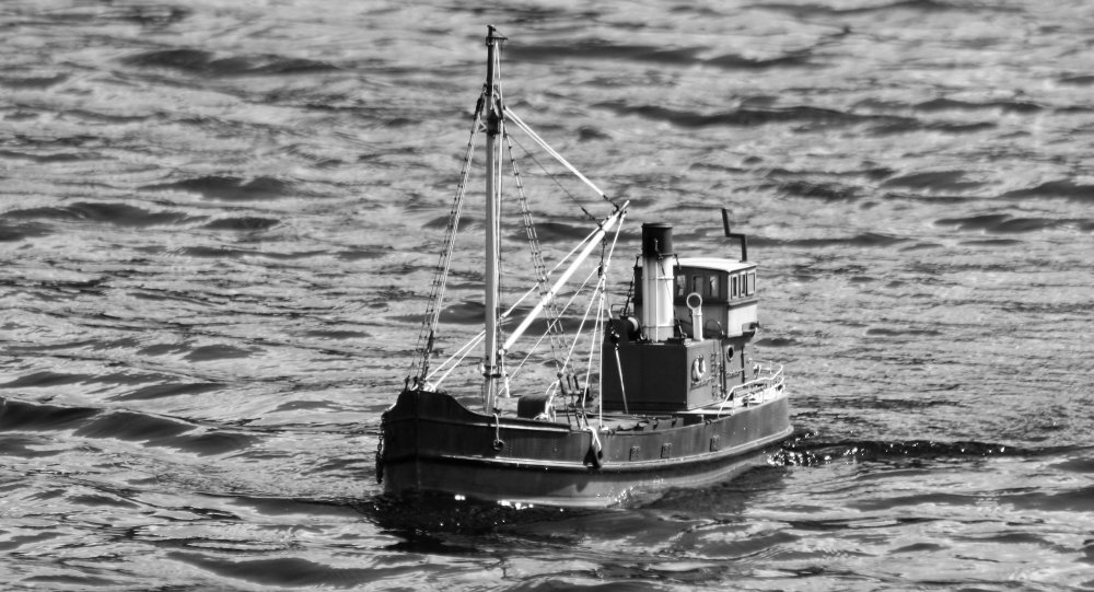

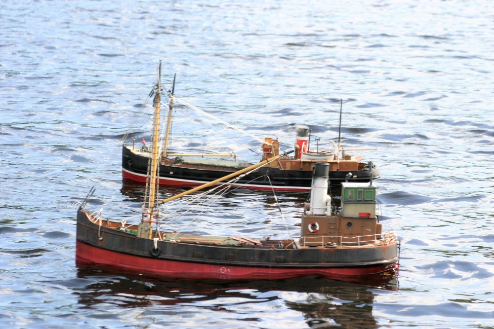

Georgeconna Posted June 21, 2020 Author Posted June 21, 2020 Ahoy there Maties. Well I did not get it finished for me Dads 75th but Father Day turned out to be reasonably nice so a meet up was arranged at Knockananig Reservoir near Fermoy, The reservoir used to supply the water for the town. Its a lovely wooded location but frighteningly deep water, Possibly 150ft deep. If we lost a boat it was gone for good. Anyhow the Puffer was ballasted out and good god she was heavy but ready for her maiden voyage. Snag though two wires pulled out of the converter which meant the smoke unit was not operational and I had no screw driver to fix and could not remember anyhow which wire as Live as they were brown and green. I got my Talacre ready too and she had her 2nd proper voyage this time in heavy seas due to the wind whipping up the water from time to time. Passers by were pretty amazed at the the 2 boats doing there thing especially the kids as some got to have a go at the controls. Anyhow the boat and a book of Parahandys Full stories and a packet of peppermints was handed over for fathers day and I got to spend a lovely hour with me Dad. Turned out it was a dicky switch that caused the lack of power to the lights too which is a pity , next time, maybe dusk sail. Heres some pics. 6 3 Quote
scahalane Posted June 21, 2020 Posted June 21, 2020 If the water had of been flat calm these would look life scale. Great job. 1 Quote
popeye Posted June 21, 2020 Posted June 21, 2020 Great pic's, they look lovely. Whats next, a U boat with torpedoes. 1 Quote
Georgeconna Posted June 21, 2020 Author Posted June 21, 2020 Oooh Popeye, The big 50 is coming soon so tempted with one of these. No U boats I'm Afraid. thats be done: https://www.hobbies.co.uk/model-boats/radio-control-model-boats/caldercraft-schaarhorn-model-boat-kit http://www.mountfleetmodels.co.uk/sir-lancelot.html http://www.mountfleetmodels.co.uk/admiralty-coaster-c642.html 2 1 Quote
