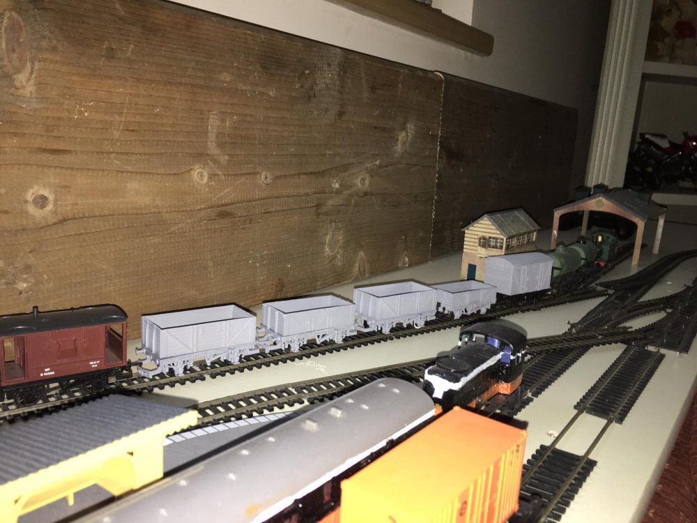

Interestingly the cheap hornby wagons seem to all come built on one of two common chassis, this actually helps quite a lot as can be seen later in the thread. the teign valley wagon is a bit more detailed and seems to have its own individual chassis but aesthetically its the quite close to cie wagon photos so its in for this job.
117106156_584839695734283_2096776795044903932_n.thumb.jpg.326fbabb13a6f4c7e12ce0f3450b0f88.jpg

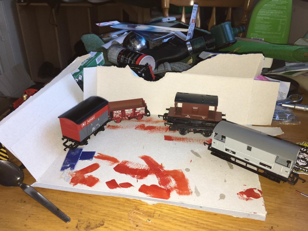

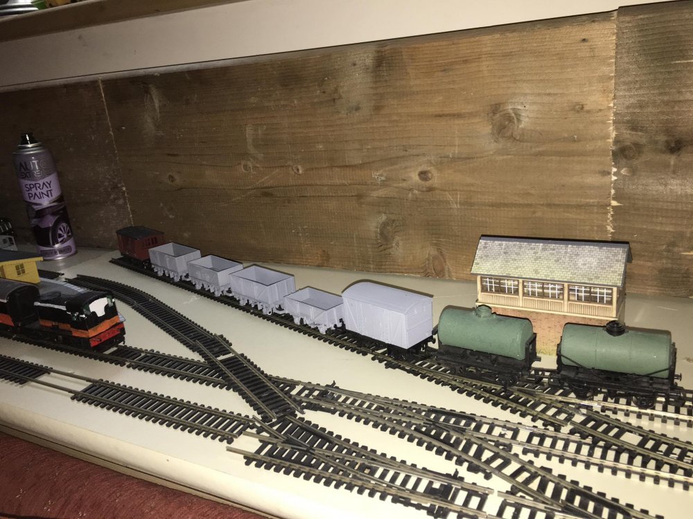

so these are the first few wagons that seem the simplest  to turn into Irish stock. the van and 5 plank wagon I am just going to respray into grey, later on  I will add cie decals but its not a job for today, the grey brake van can pretty much stay the same until decal day as its not a million miles from an irish van it may get some body mods in the future but its okay as is for now. I couldnt decide on a colour for the brown brake van so its staying brown for now. It is however being moved from the long Hornby wagon chassis to the short one. im not sure how accurate this will be from an Irish standpoint , but it will make shunting a bit more interesting on my layout and im not a huge fan of brake vans with the open platform on either end anyway.
116470072_2335780083395319_5486115001754436694_n.thumb.jpg.5d65c5bfff47c8931e874923fae8703e.jpg

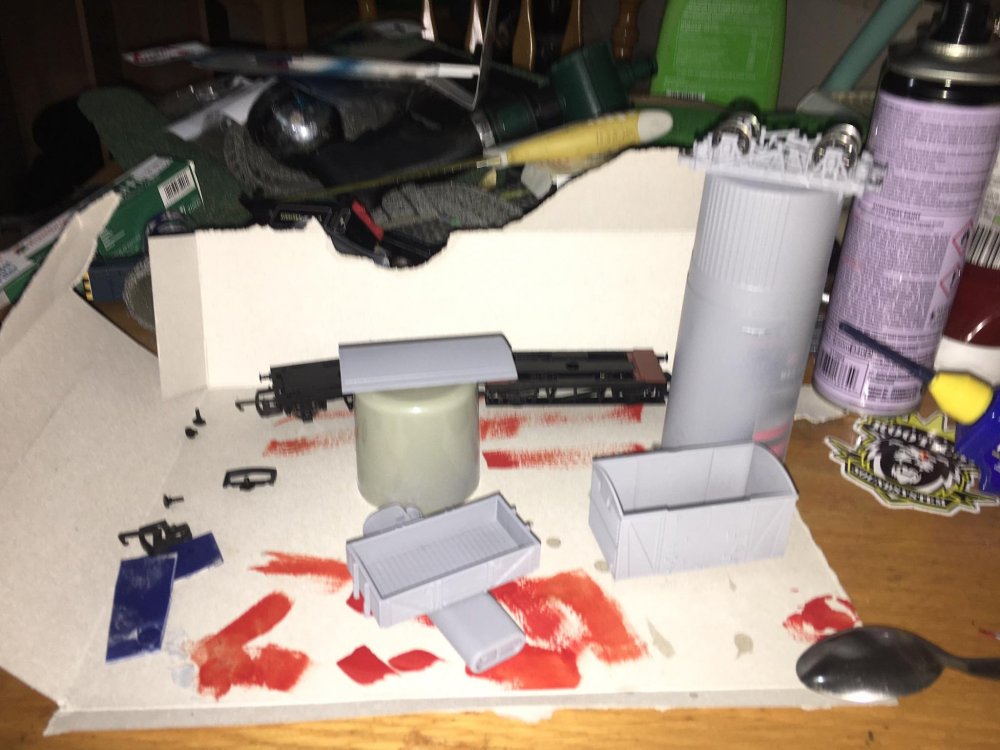

getting this stuff apart is all very straight forward with plastic clips located on the underside to get the bodys off on a few seconds.  the entire wagon including chassis is being painted grey with details to be added back on afterwards on order to reflect on the colour of the cie wagon,  the vans seemed to mostly keep black chassis so this will be left alone for now. once the van is off its chassis we can see its the very same as the other short chassis which I will be moving the brake van onto. I have a few more coal wagons built on this shorter chassis which would also be suited to conversion although in my opinion they do not look as good.
for paint I have chosen the very versatile Dealz primer grey rattlecans, I think the colour should be okay, if not at least they can be primed to take the correct colour.
117296661_1187644611590982_8668363296693738221_n(1).thumb.jpg.63c4c0fccf1d9a4ba35d3e45b9e53d1d.jpg

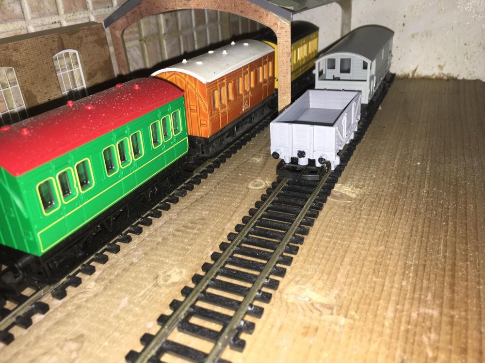

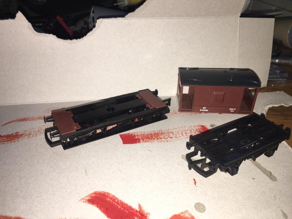

as we wait for this to dry its time to tackle the brake van,
117088639_630819611166722_8671342857555168091_n.thumb.jpg.1585beed4610edf248c9ab919bcad591.jpg
in theory it should just clip onto one chassis from the other as they are sold new like that,but we will see.
116427858_580861809460674_5006178361296360727_n.thumb.jpg.51ec377f6ab0d904c0758817e986cd76.jpg
unfortunately not, but a little dab of model glue onto each corner sorted that out easily.
116721241_982196762222976_1288734895267744733_n.thumb.jpg.6607f26fb636772908a91781d9107e0b.jpg

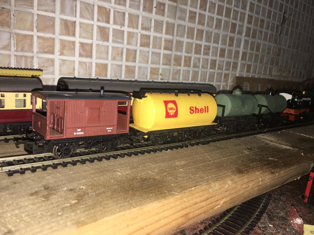

as the glue dried and the rest of the stuff went back together i put some small details back onto the wagon so it doesnt just look like a primed wagon.
117110042_1239510466392354_6372208953310206455_n.thumb.jpg.fa8f8a644bbc98311d0e2dbe7f5cacc5.jpg

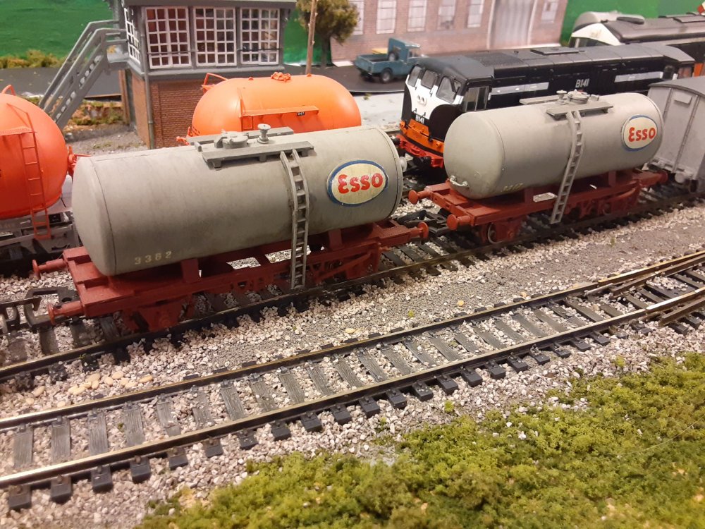

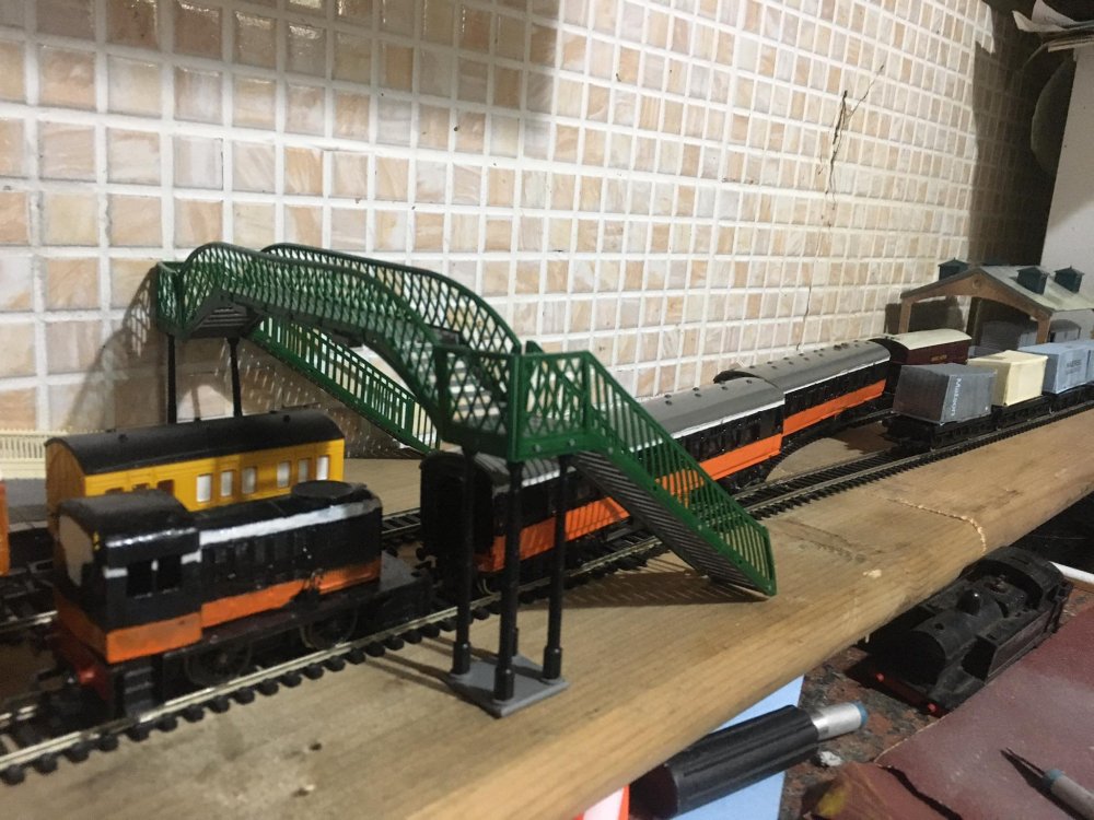

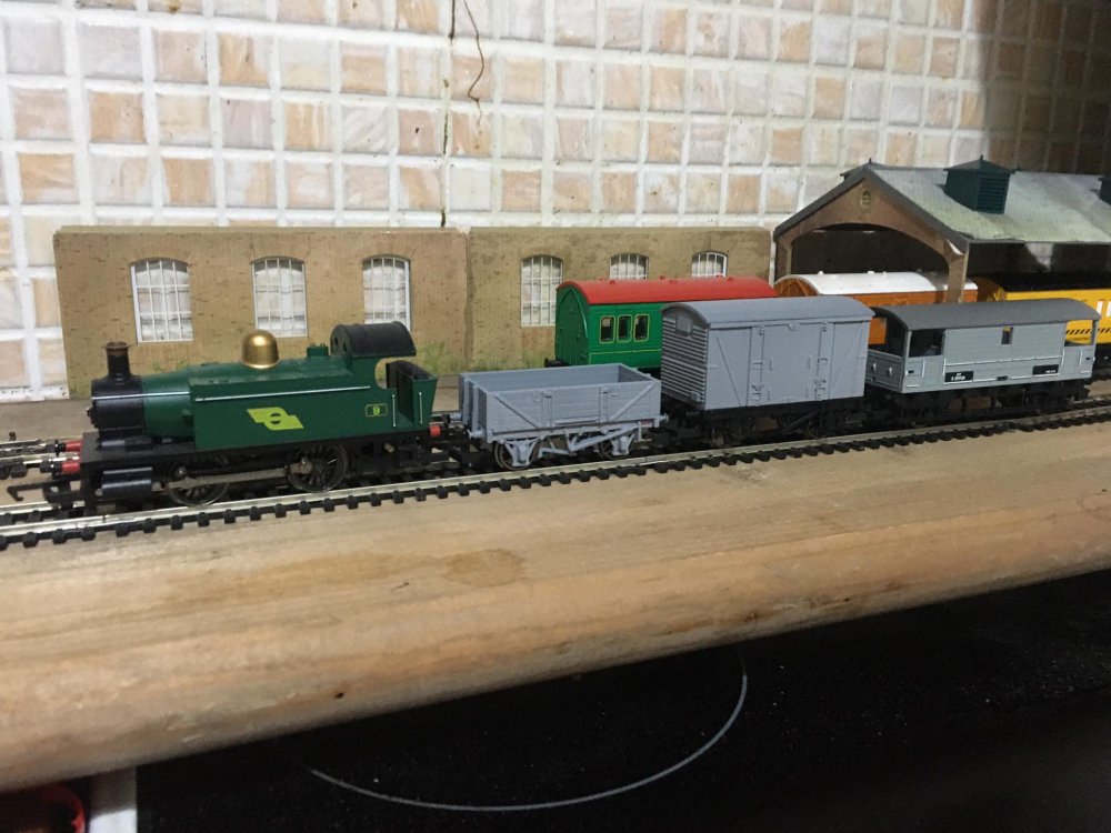

now the imaginary hornby cie tank engine finally has some appropriate rolling stock to pull behind it, will surely look good when detailed with decals etc.
117336225_668402860420703_232463666127281897_n(2).thumb.jpg.5f158abf113efcd954780cb76c7dc557.jpg
New shortened brake is looking right at home behind the tanker train.

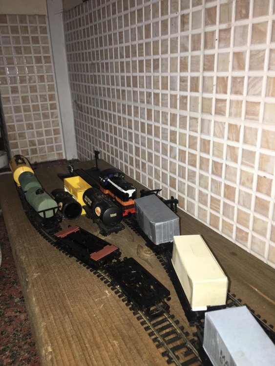

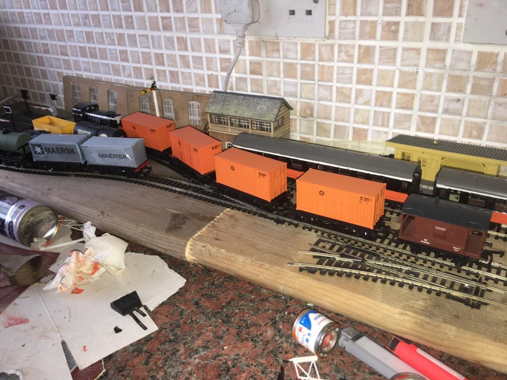

So the reason i had been keeping an eye on the wagon chassis size is because i am considering container traffic on my layout  and have ordered some oo guage 20 foot containers as I think they should fit just nicely on a large hornby wagon chassis if my measurements are correct.
117300874_295360338358763_2965343363304778834_n.thumb.jpg.dfa097526fb1dfcce2266185f86007de.jpg

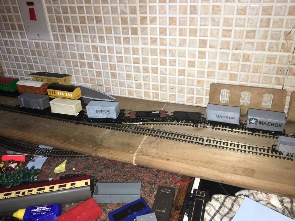

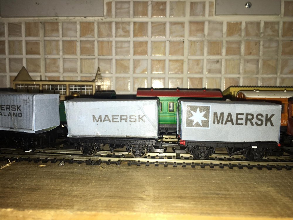

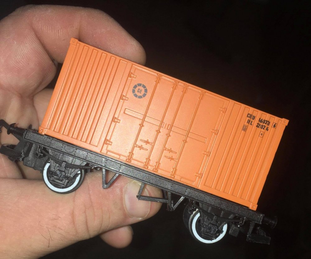

Unable to wait I found some HO guage containers that i could print out and make up on card,  unfortunately i am limited to grayscale printing on blue card so they dont look amazing but give me an idea what to expect when the plastic ones get here.
117326608_3017449881697383_958862003019389790_n.thumb.jpg.0afe03f7989ff9588af37b861728280e.jpg
much to my surprise these fit really well onto the smaller chassis with just a little overlap, if it was scaled down just a tiny bit it would fit onto this flat perfectly and look great.(and of course printed on proper card in colour)
117135947_615269405801109_5174949917084225157_n(1).thumb.jpg.f76a3006bd15f6d5aefe733c0d7ab35f.jpg
unfortunately the container is a bit too short for the larger chassis but according to my measurements the oo containers should make up the extra cm and fill the bed, I think it would also be possible to take a lot of the underside plastic off this chassis with an exacto knife so it looks more like a proper container skeleton as well so it will be interesting to see how these progress next week.

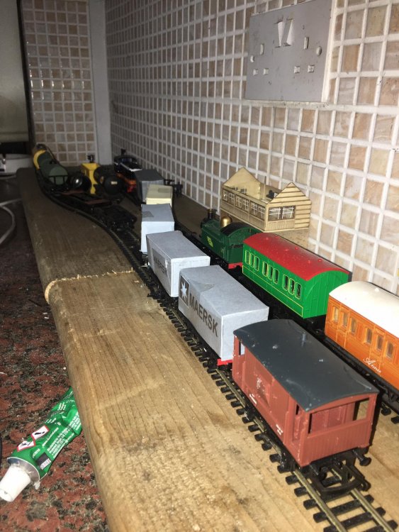

117261784_345038223551732_1728265331678220515_n.thumb.jpg.c03a662c85a7f9dd3aed6ff31d687e6d.jpg116913394_1243753952645392_4873025293733783783_n.thumb.jpg.086a8e26bd0f496fa33cf49e95b31639.jpg
they do look half good being pulled out of the yard in a rake though. the great thing about working with either of these wagon chassis is that hornby sell a 3 pack of them for 20 pounds on their website  and there are a lot of used wagons on ebay etc which would suit for these types of conversions.

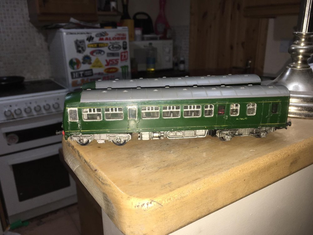

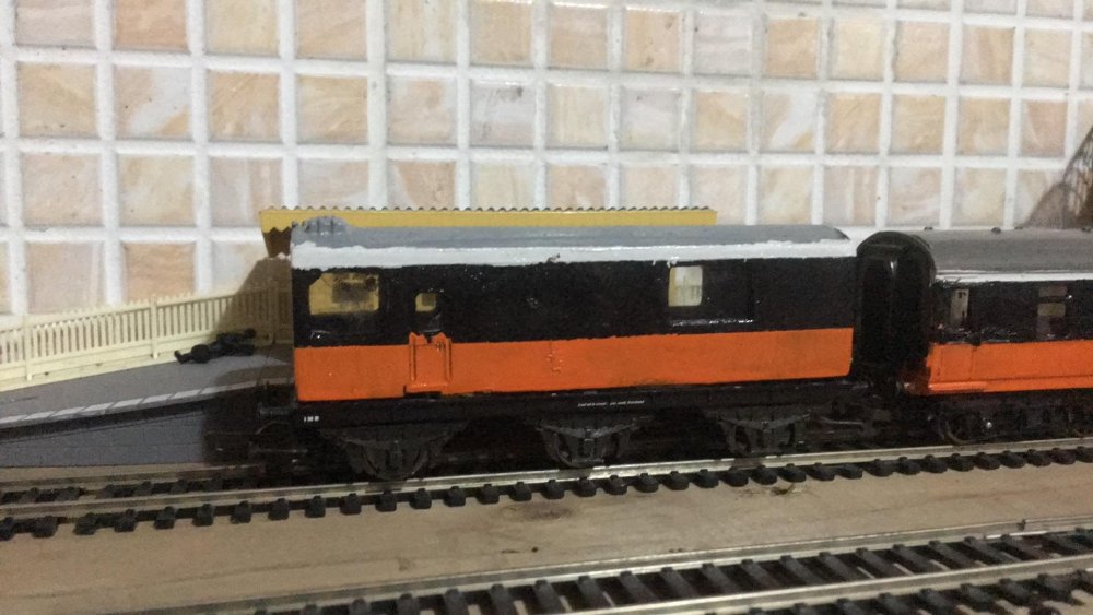

interesting enough set on the workbench today.

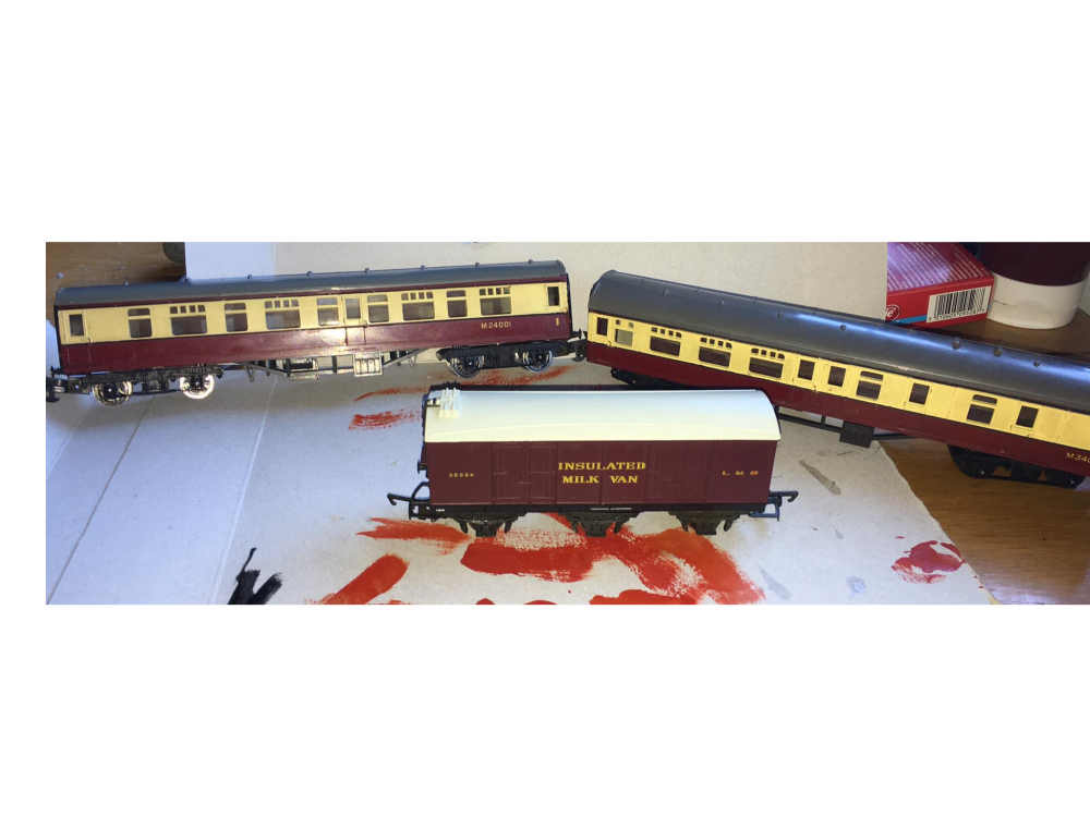

I have owned this set of tri ang coaches for many years, they were given to me by my grandad but i was never able to properly run them on my modern track due to them having very primative wheelsets which i did not know how to change causing them to derail almost always on points.
Well recently i discovered how to change these wheels . so i have been thinking it would be nice to refurbish this set into cie black and tan in order to run on my layout . it has a few things going for it.
the open coach is not a million miles from one of the opens in the silver fox 1951 set  so in theory they wouldnt look too out of place in that livery,
i think the brake van would be technically incorrect but i could later run it with some mark 2's as a heating van if i wanted to.

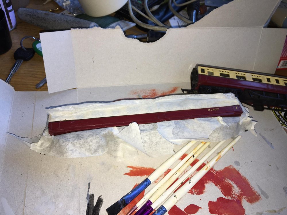

there are lines molded into the bodywork  which can be used as a template for masking off for the multi colour paint job and even with my skills it should turn out half decent.
when compared to my set of hornby composite coaches these seem to be made to a slightly smaller scale. they are a bit shorter and the roof height isnt exactly the same either. this makes the track look a tiny bit bigger but more importantly space is at a premium in my station area and the missing inch or 2 of wheelbase does help a lot with clearance issues  in the runaround loop. this is generally the longest train that will ever run on the layout anyway.
due to the wheel issues they seem to be very commonly available for around 5-10 pounds  online so there are loads of them out there, it is also a bit of a pain to fit modern wheels but its actually very straight forward without buying any additional bushings etc.
117387425_297413291489121_6950492867870358152_n(1).thumb.jpg.5290da71f0b052bc492a70033b86a7ee.jpg
Another thing i noticed whilst browsing the silver fox library was that their 6 wheel heating van seems to sit on another common hornby chassis which i actually happen to have in my posession in the form of the milk van , it seems to have the same black bed details as the silver fox van as well as the couplings which pivot with the middle wheel turning, so this seems like an ideal oppertunity to try and create my own 6 wheeler! We will revisit this another day as the coaches have absorbed all of my modelling time today and ive only painted one side of them as im taking my time with them. im still deciding wether to just repaint this one or somehow try to cut in for the windows so ill sleep on it. and decide.
117182046_743446346454925_6311324867577040562_n(1).thumb.jpg.fc9baa65c88cc8a716a0b55691e9a52c.jpg

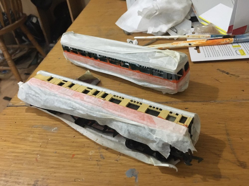

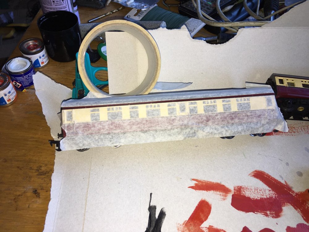

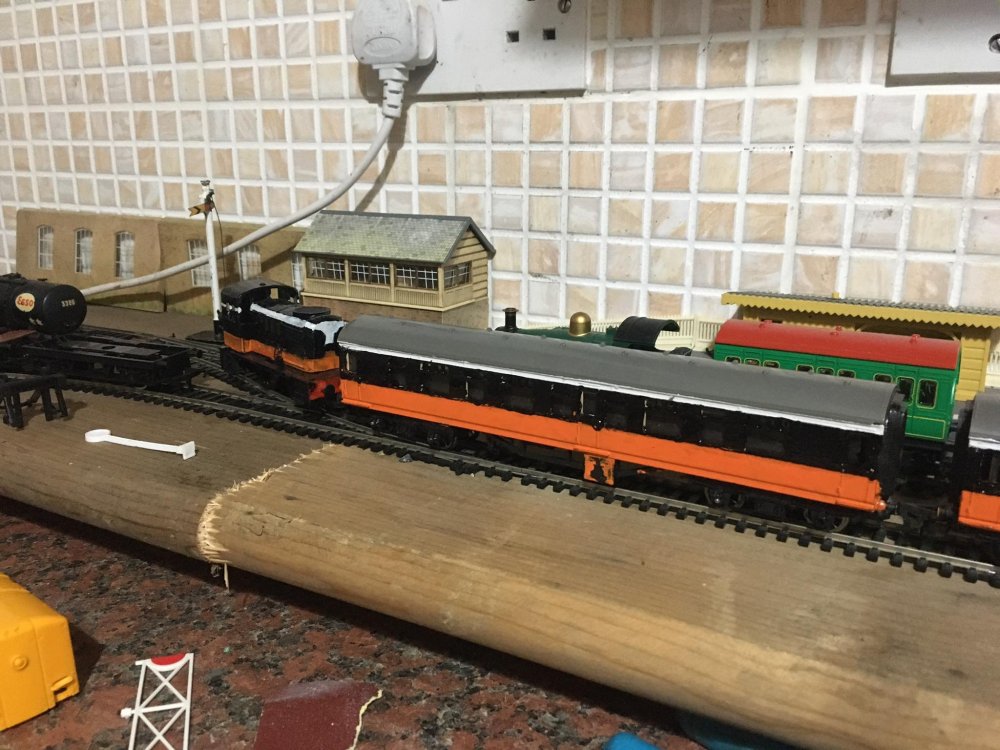

masking was a piece of cake as i could just lay the tape down along the plastic lines of the carriage so it was easy to know they were straight.
117323363_287915365838484_5451393132091369442_n.thumb.jpg.9df7883342f2013ff4c6186a118f82ae.jpg
much to my amusement i was able to simply fold the masking tape back up and i was masked for orange. I couldnt find any obvious way to take these apart and the bogies are riveted on so this is why the roof and bogies are masked instead of removed.
116344014_1749699408541449_594072624833194200_n.thumb.jpg.5d31bd98fec74af1d0e9a55bbbff1c15.jpg
no pics of the actual paint job, and only one side of the coaches was completed today however I do think they are looking good on the layout
116726790_3317524094960816_3524047384890261039_n.thumb.jpg.67545489616ecc06b96ac19f5d1df40f.jpg
need to go back and tidy up some of the lines when the paint dries, particularly between the orange and black as there was no fixing it with the paint wet, the black section was painted freehand as i could not think of any obvious way to mask up the windows, they had fallen in though so i was able to paint most of the frames without touching the glass with my brush all that much. i reckon these will look really decent tidied up with some more details added.
really pleased with the results of what i have achieved on this thread so far in just a few short evenings i think i have drastically changed the look and feel of the layout i have planned  with more of an idea of how to actually build the layout to the strenghts of my new rolling stock. Will keep this thread updated as i hone my skills and begin to improve on the wagons here so far.

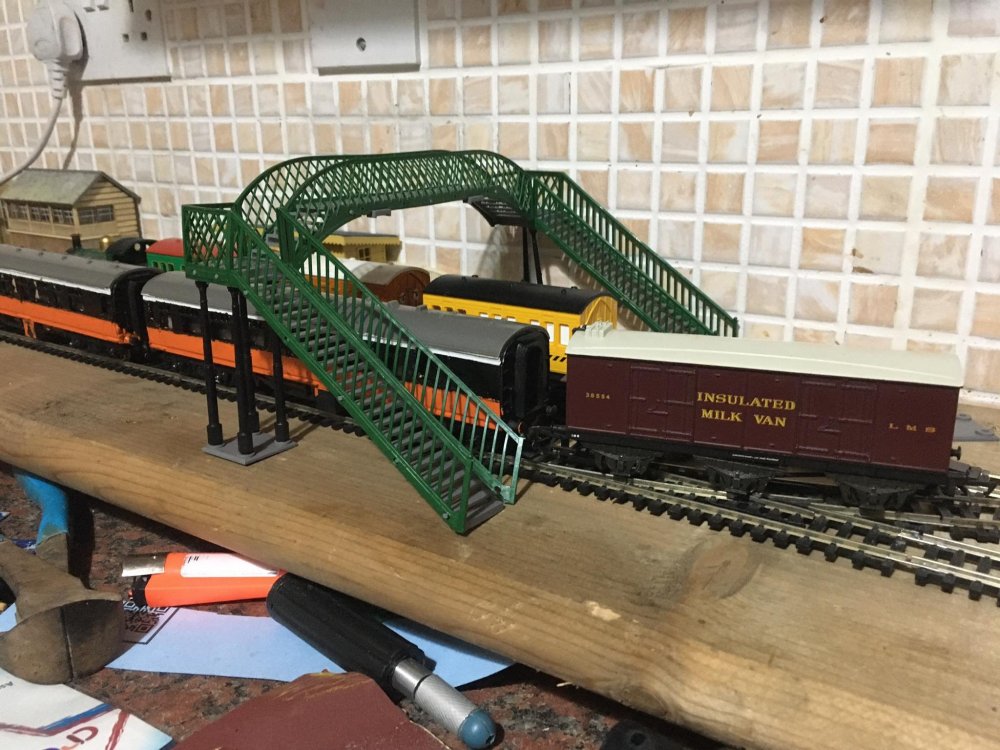

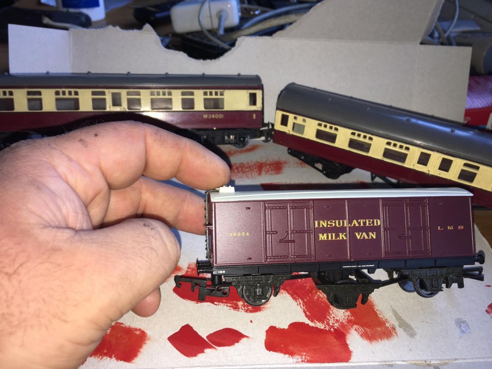

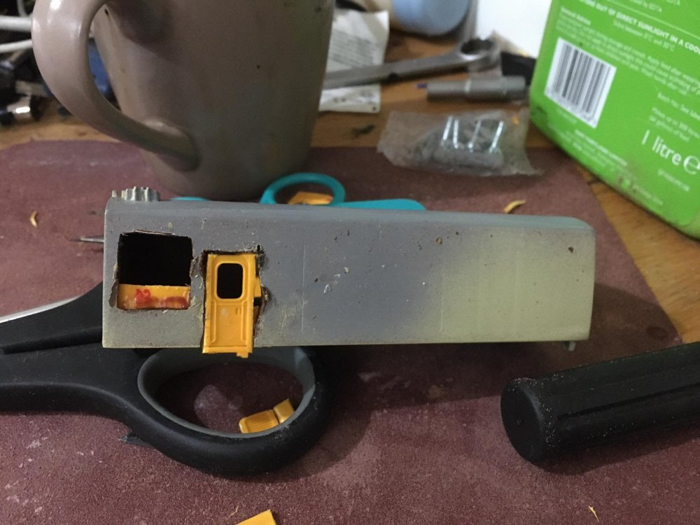

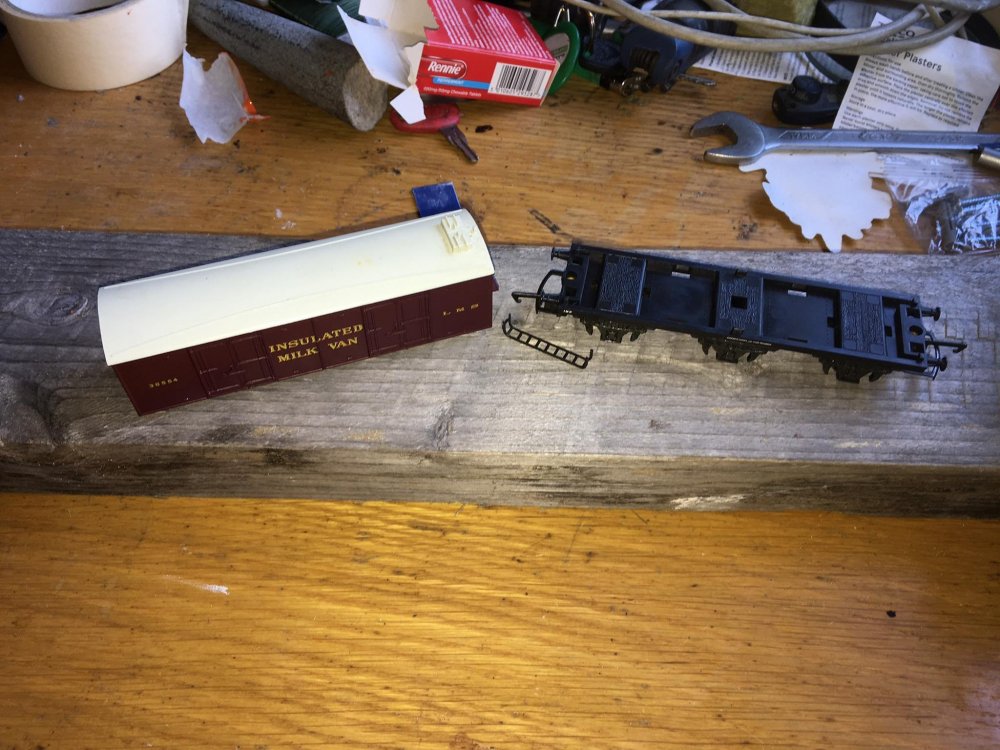

not too much to report today as im tied up with other committments however I have gotten  a little start on the heat van.
116901707_941416529695503_5248604894350569323_n.thumb.jpg.ca25b34ed8dd60c66ed88479ce86ea90.jpg

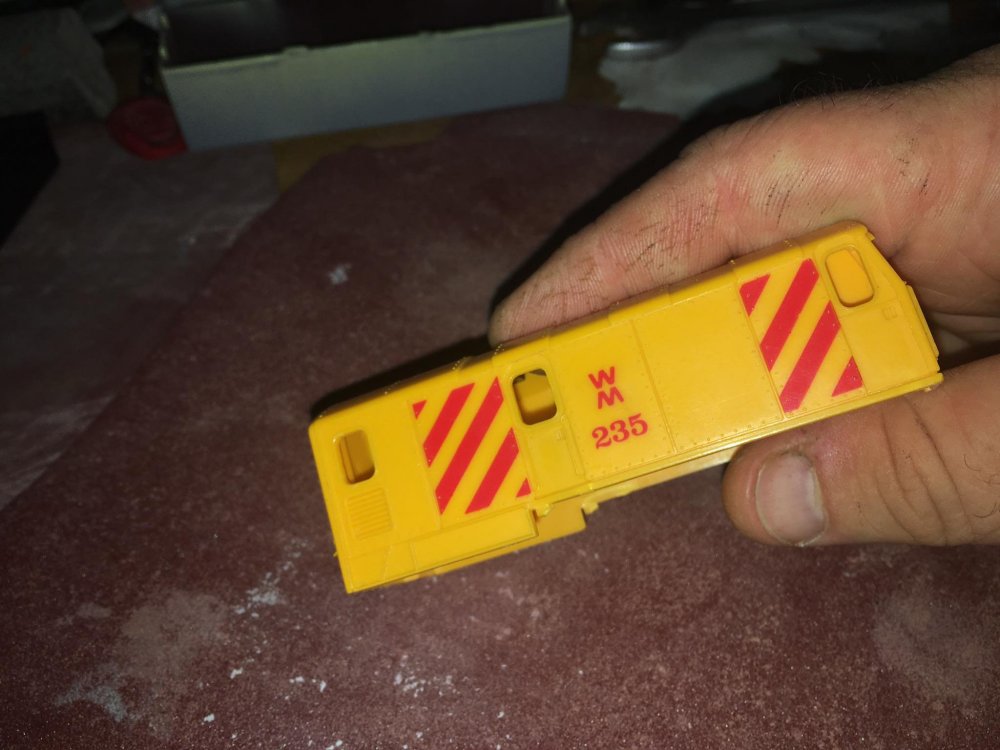

like most things hornby this clipped apart with ease, still undecided about how to add a window and door at this stage, im torn between finding a very cheap damaged coach to use as a donor and just trying my hand at cutting them in when i find my dremel in the shed again.
117328700_1192006027824585_3349702482265907547_n.thumb.jpg.33d202a9468b930c260895ea17925bfc.jpg

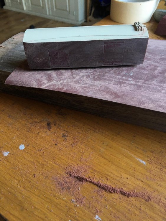

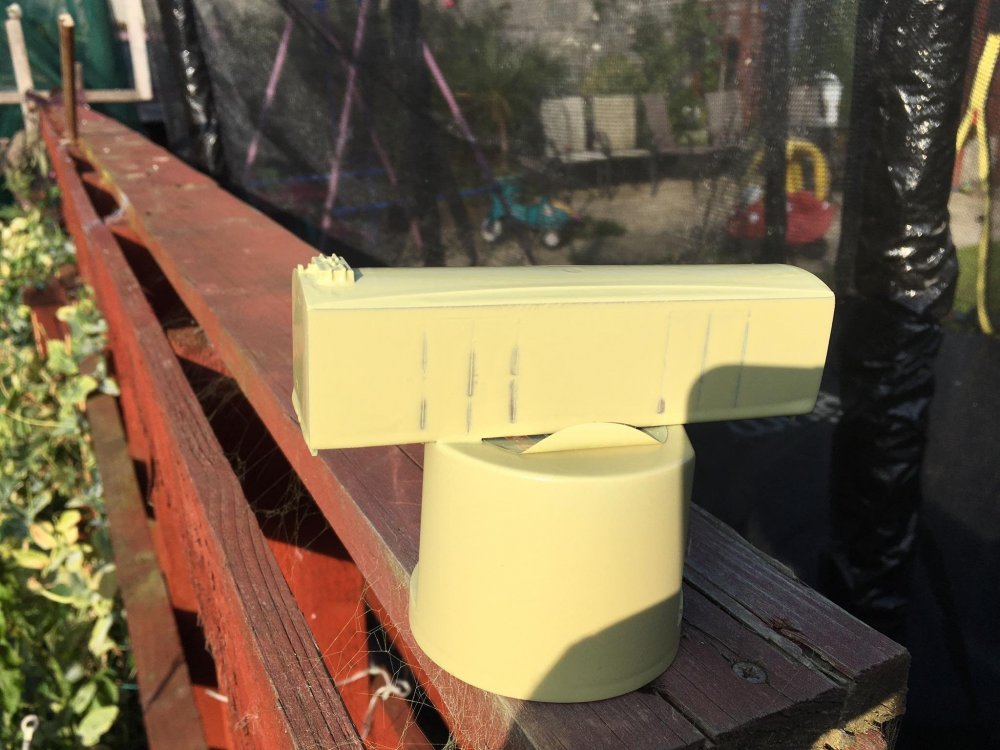

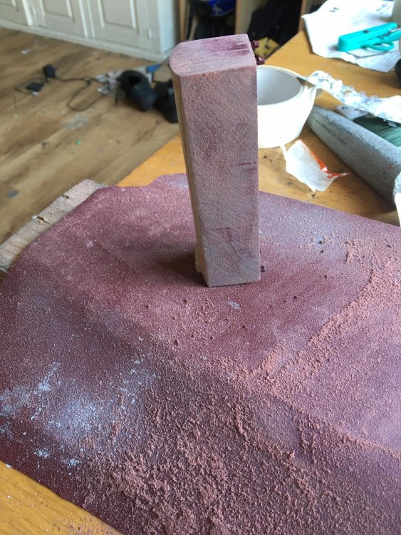

fairly drastic step next. but im completley sanding down the wagon  on all 4 sides on a block of wood to deface it.
117174785_863685774158489_8171633440034323329_n.thumb.jpg.f6f1745d442eb578719f0ac09e306541.jpg
that is then repeated on a nicer bit of sandpaper as 120 grit will have it left feeling a bit rough.
117101905_390133358637847_5456381185521188309_n.thumb.jpg.5fa021c109d773274de6d7db2a5461e7.jpg
So now ive basically got a blank canvas for a new carriage! decided to give it a coat of  high build primer to start to fill in the heavy sanding job and highlight any imperfections left behind .
ive got to take some more measurements but interestingly it has left the doors of the old wagon behind and these dont seem like they are a million miles away from where they should be.Could be onto somthing with this.
117289863_237349540678114_2629696476126344268_n.thumb.jpg.d80561f84a41c1a465ba1e4a4daecb6b.jpg117052203_2651949075023152_7246384404082899246_n.thumb.jpg.a327ed5bbec1dd150e5ae2ad46d368d0.jpg

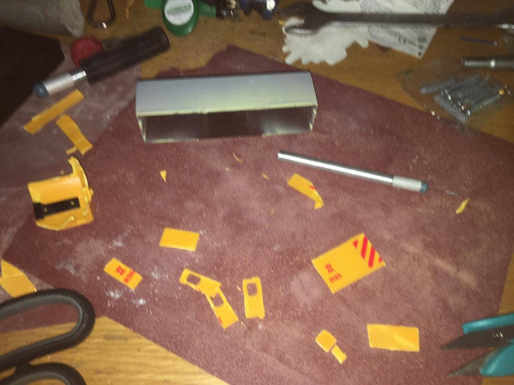

so among my old bits was this other little gem it used to form part of a fairly big breakdown crane on a one of the old ho sets i had as a child. plenty of doors and 2 little vent details i can use later, time to get my blunt cutting tool out.
117237726_301677747714630_6994157050200449268_n.thumb.jpg.e14acccd8548a14ddb38536933562803.jpg

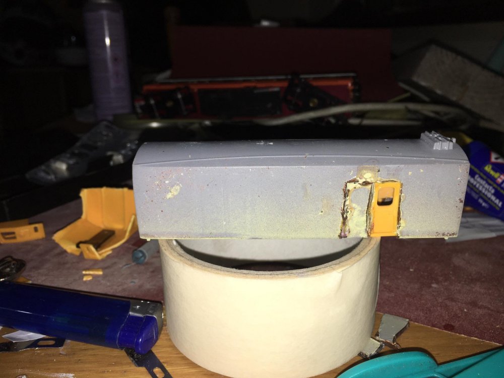

roughly 5 minutes later it has been hacked into a load of old doors and panels. childhood ruined.
117353299_296984844723717_2608760165234458631_n.thumb.jpg.db32c1c02a68fbcdf6e900a4ba14a199.jpg
was looking for ways to easily cut into this wagon so i heated up the exacto knife with my lighter and it went through like butter,  once i had the door in i got a little more confident and cut in the first window! not perfectly but tidied up with the bit of card.
117034821_788966618598214_1162433937676791583_n.thumb.jpg.54874e48b2d6484845d4dee84d909931.jpg

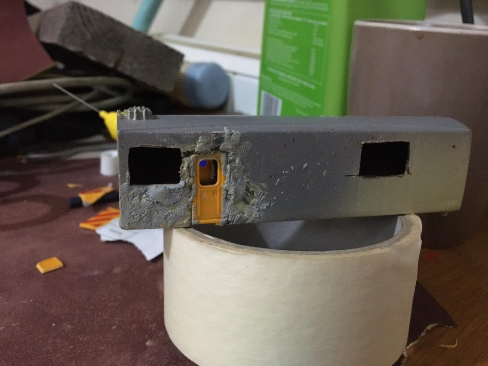

mistakes were made on the other side too!
117206454_320871092626185_3108721360225180830_n.thumb.jpg.c03e6805ef5516cf4341861ac8979f7b.jpg
thank goodness for fillers :P when i get back to this ill use the masking tape all the way around the wagon following the lines of the windows i cut,
i dont need them to be perfectly square(although it would be a bonus ha) as long as i dont cut them too big to ruin the lines of the livery. the exacto knife is able to make shave out a surprisingly square looking cut out though.

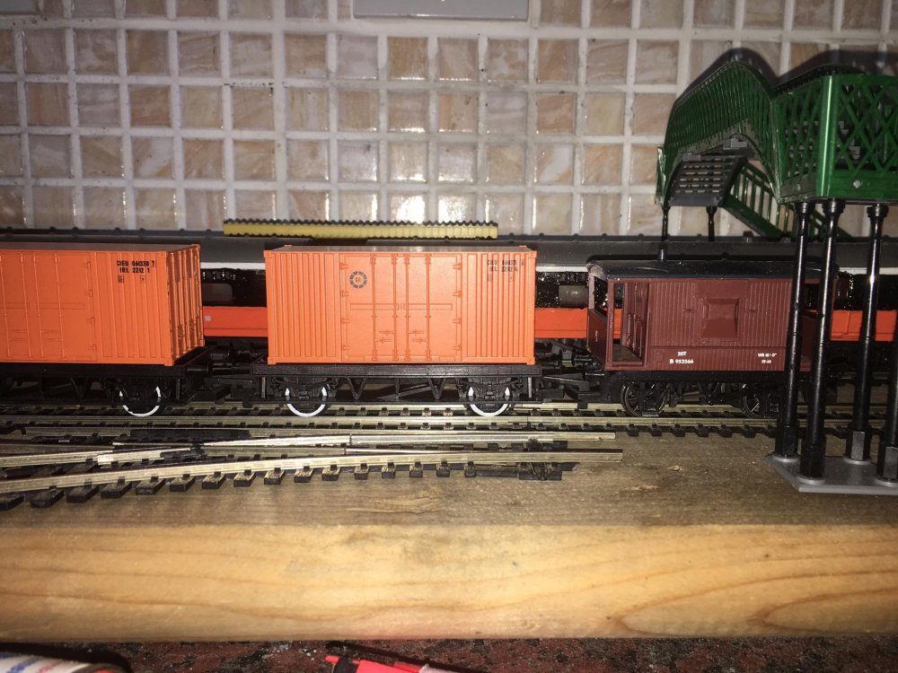

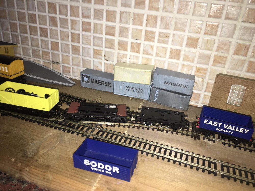

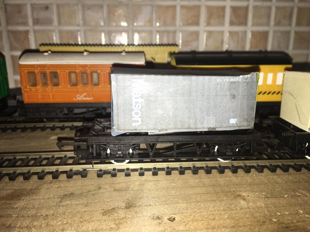

containers arrived today, they arent an exact fit for the large hornby bed. but its close enough for my layout
117392665_592989701386566_1766621060683525866_n.thumb.jpg.4536870ca5d6d6033013472a58264aba.jpg
and they do set a nice scene alongside the coaches.

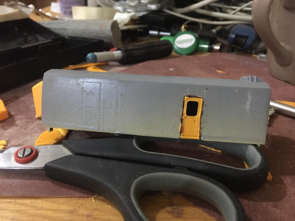

managed to get the windows cut into the heating van and they arent looking all that bad after tidying, this unit should paint up nicely , i took the plastic screen off an old broken thermometer and this should make up the window glaze nicely when cut into small pieces..

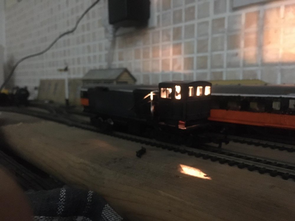

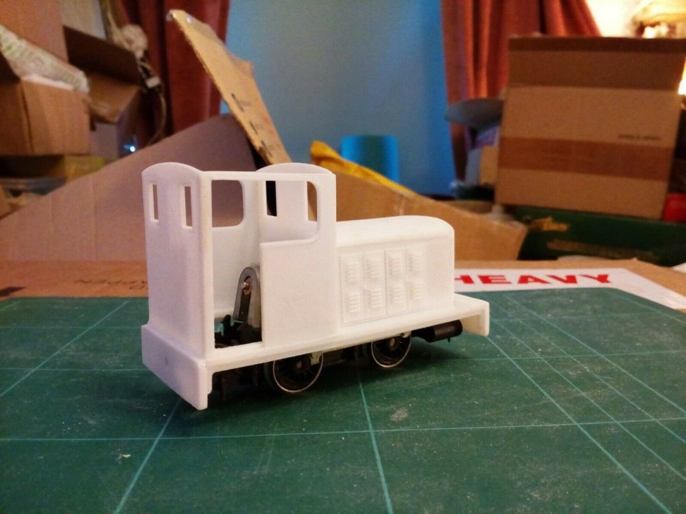

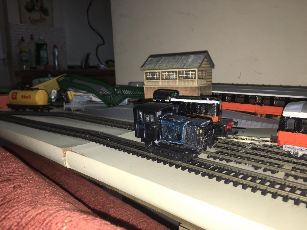

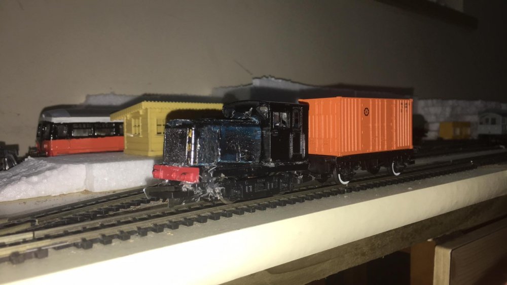

as im a bit of a glutton for punishment ive started to piece together another familliar face, thought i was done making trains for now but this small pile of parts kept sticking its tongue out at me so i said i had better make use of them.
not gonna be aiming for a super detailed example again although there are some elements which I want to spend additional time on such as getting the curve into the front of the cab and rear correct.
a117111703_1331488630392197_1140864627323120000_n.thumb.jpg.a3fdcfa04d85f74d7c53a890059ff329.jpg
even has a lit cab! i should be able to think up a little circuit to keep it lit for a few seconds after the train comes to a halt.
117284303_359685242096754_6655831514692234294_n.thumb.jpg.a54377976730e63e33fd9ec38d7b13b5.jpg
van is looking really well although not too photogenic at the moment with my poor lighting, will update tomorrow when i finish that one off altogether. quite looking forward to getting the windows fixed in after paint. this is its good side and most likely the side ill use the details on. other side is not terrible but it was done first and details like the door just didnt come in as flush as i could get them on this side,overall im very pleased with this van though,only thing annoying me is that this van is sitting slightly higher than the coaches and therefore the orange stripe is sitting a little too high and i imagine the white one will too, i think its partly because of the small scale of those tri ang coaches though so may be okay next to some proper irish stock.
overall im happy with my little DIY branch line rake. :)

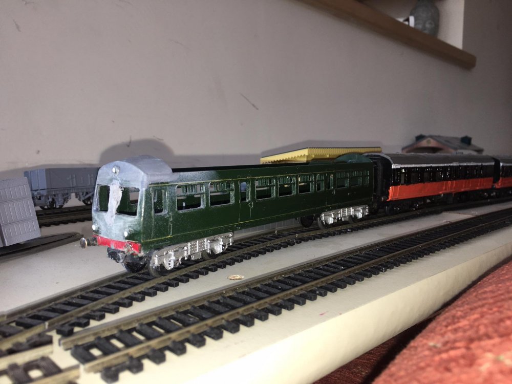

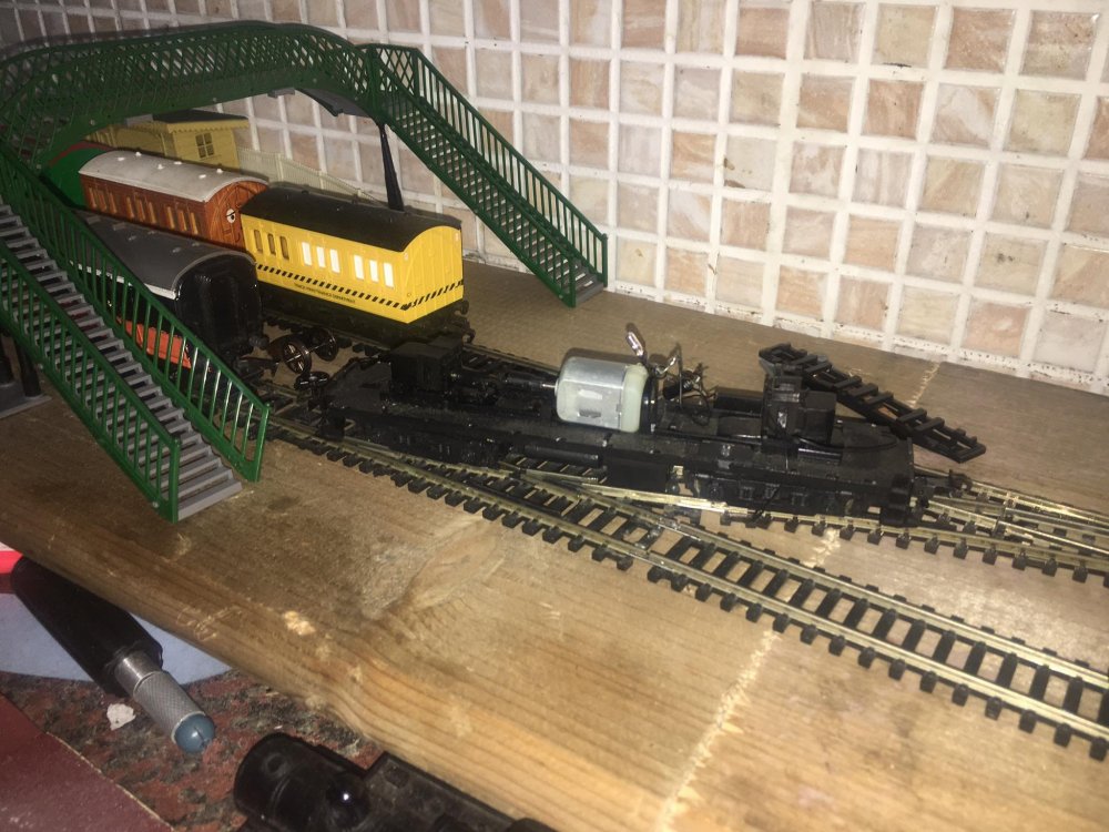

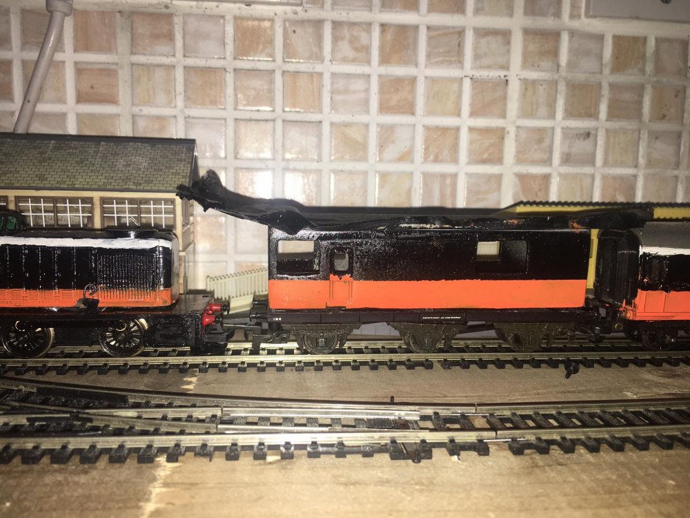

117595541_305151907469419_294217489850748996_n.thumb.jpg.6e87933bdfc8fa248b1a2904b2b6f403.jpg
van is done and the windows are in, needs the usual bit of touch up where the masking tape bled but overall its a good little van.
since i had to make sure the new loco chassis was still able to be fixed up and ran I was motivated to finally wire up my little line, so now we have the new little e class moving under its own power handling an outgoing container run, who said the hornby 0-4-0 isnt capable of a crawl?? (admittedly mine definitely needs a bit of a service though it hasnt had a proper run in a few years now and neither has this track) This one is completley stock but i believe they can be modded for rather smooth crawling indeed.

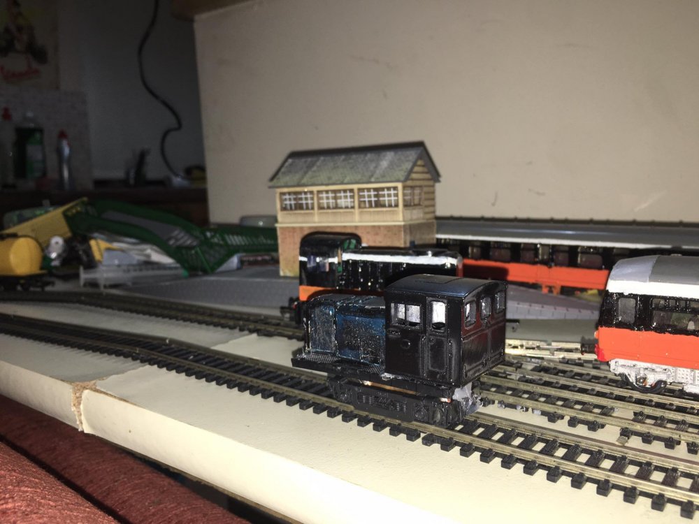

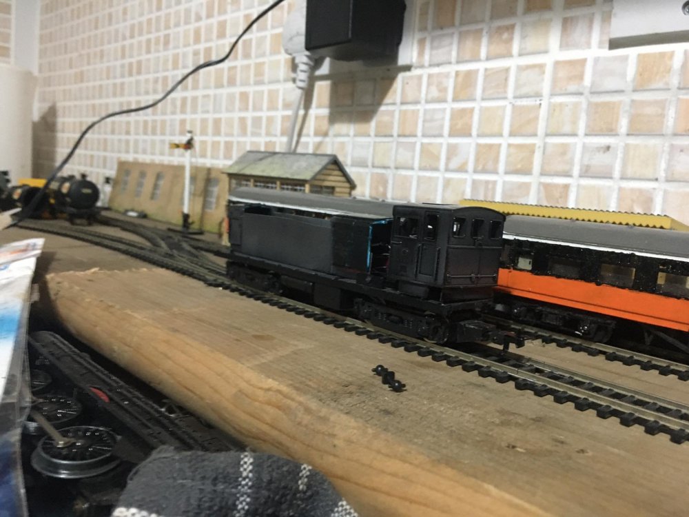

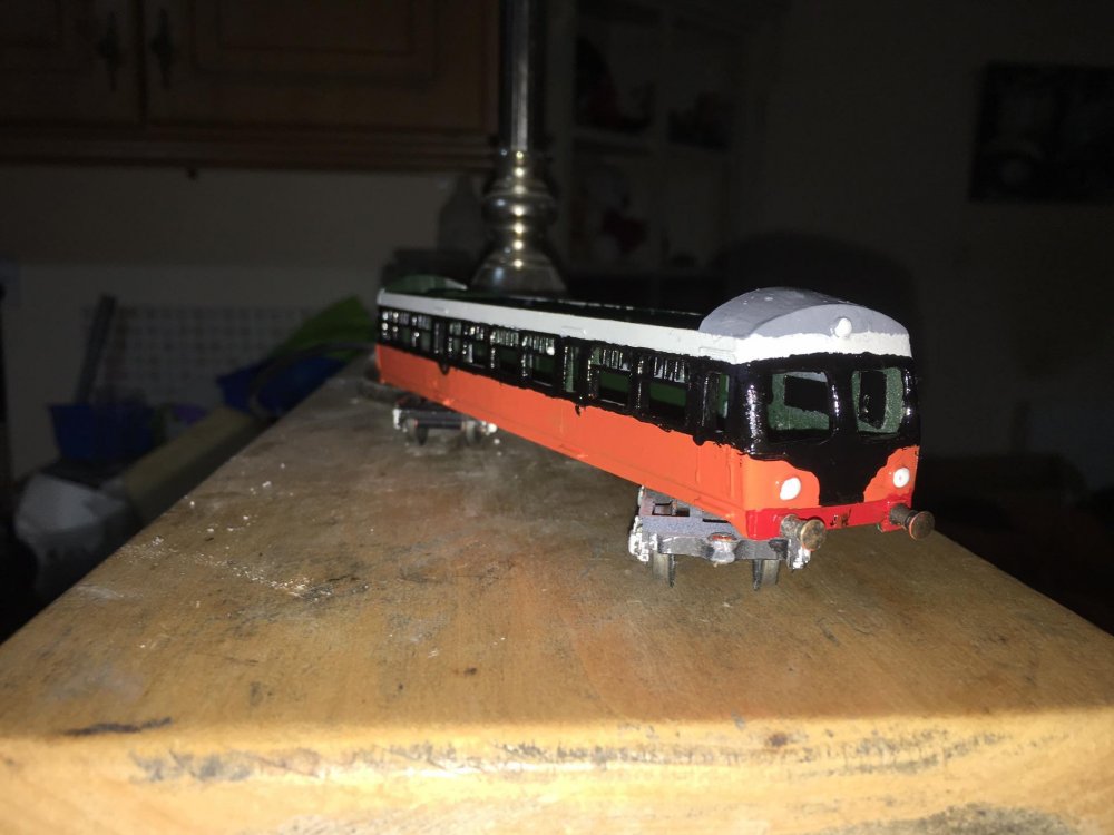

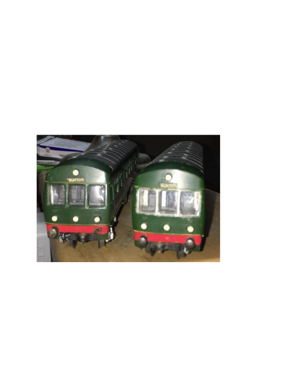

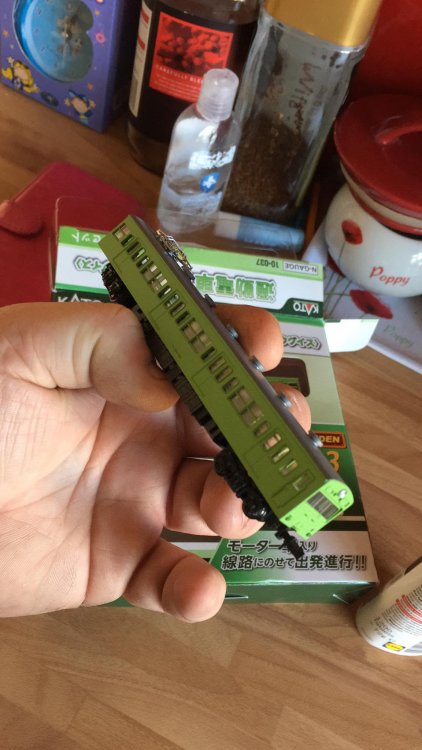

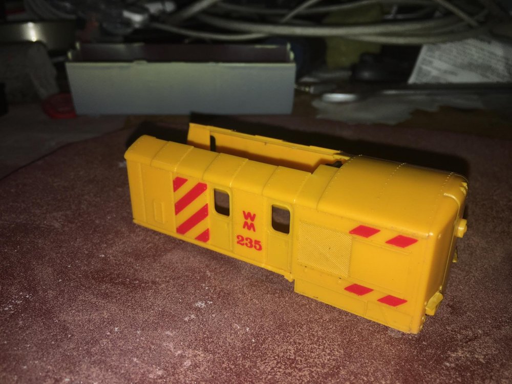

not done much on the modelling front as Ive been dedicating my spare time into trying to get some kinda playable layout together. made a little progress with 121 but i wanna play trains soon!
118083697_333107744716397_4442093449031248471_n(1).thumb.png.82e4f0cc9c1e9d42fd45454a0796eb71.png118126231_348116146574904_7189334369617604796_n(1).thumb.png.b0023c702831deb41ccd80a01f545312.png118212463_814795725737539_5921719339843587456_n(2).thumb.jpg.ecc13d8d8b6e1847609b3a4b5a614546.jpg

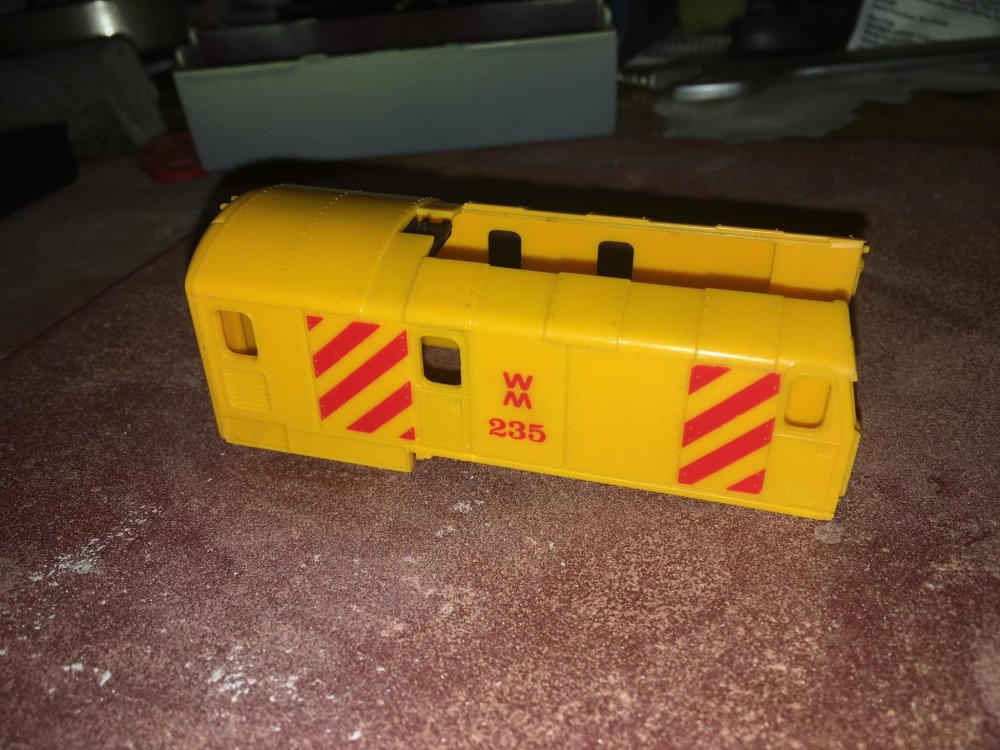

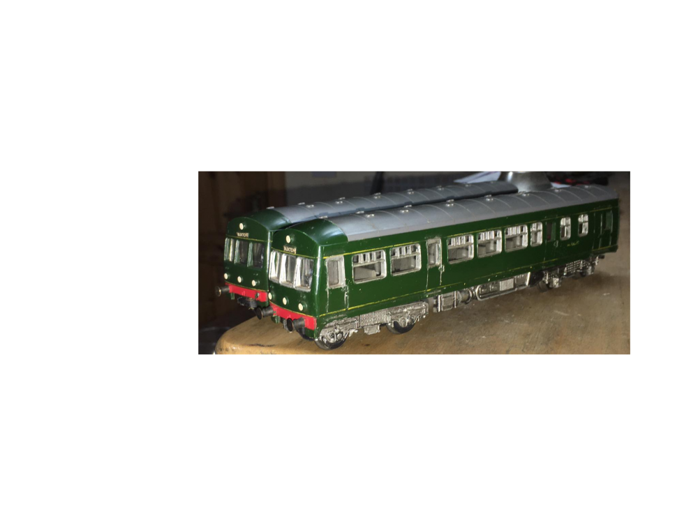

got this old class 101 on ebay a good few years ago in the condition its in here, not the best of paint jobs and the thing barely creaked when put onto a powered track as the wheels were black, its running decently now though after a good clean and lubing. seeing examples of this set on ebay for around £30-40  so its another one thats easily picked up, it does have those ugly large flange wheels again though.
Push-pull_train_at_Howth_Junction_station.jpg.d4750c6e6e7dc90b1cab40e143af8761.jpg1570193591_Screenshot2020-08-19at02_30_10.thumb.png.fd1e6416dd16a523c8002f57096ee02c.pngkk
I reckon it would not be too difficult to turn it into one of these AEC 2600 railcars, conversion to a one pillar windscreen would be the main thing and the headlight setup, but the gear under the carriage would also need to be changed (not too difficult with some plasticard) the main standout detail would be the profile of the roof but it could be moulded into a more roud profile if i was inclined later....
the door and window layout isnt far off
Edited by Sean
118173704_350647296099729_3093875203298102867_n.thumb.jpg.bfd3c6e449bf84ec2b24ac3e45b66a22.jpg
noted from info on here that the open plank wagons werent all nessesarily the same size in a given train so decided to bash out my last 3 wagons into cie livery ex thomas the tank engine this time, did not yet add the buffer details but they definitely look missing in comparison to the front wagon, I think the brake van is definitely needing to go grey now as well.
117996434_689224385010570_2165739635673615397_n.thumb.jpg.fbef6707a7281dd2b69222a4353295f2.jpg
dying to increase my fleet of these vans,  followed by a few of the oil tankers, one is an old triang model with modern wheels and the other is another thomas the tank engine model but they are both essentially the same tanker. model
118211481_782986135805587_941974226170228874_n.thumb.jpg.083bf33cfd2b88ccb0329c816cfacc42.jpg
AEC under construction...... will do a more detailed post when doing the power car. quite a straight forward conversion. still havent painted the other side of those coaches lol. and yes, this is going to be made go around those 18" curves :D
Edited by Sean

118455194_302833667618067_8763641563370482301_n.thumb.jpg.1da49ea95fc7689850ef089c65b65201.jpg
finishing up some coaching stock tonight. hopefully all masked around the same heights :D not as many guide lines on the dmu but followed a guide on here for keeping the striping in line so should be ok, the + shape on the doors seems to be at the same level as the guide on the other carriage white top stripe is the same height but a different width on the dmu
Unfortunately there is no clear way to easily get the glass out  of the coach so unfortunately it will take a little bit of extra time to paint around all the windows etc
Edited by Sean
118428452_305787690689371_7684069444781512862_n.thumb.jpg.b9a39ba6f22b3862b2f38635c95826d1.jpg
as usual the orange band will need sharpening up when the paint dries,as well as the white bit at the front(although the camera is slightly exaggerating that)  but overall gotta say im really pleased with the looks of this one. already passing the 2 foot rule with flying colours and satisfys that dmu desire on the layout.
Edited by Sean
AEC back together and being pushed by its power bogie, paint tidied up a little bit. this should be a great little runner if crawling like this on a standard hornby controller
This design is decades old but after cleaning up the wheels and loosening it up its quickly becoming one of my favourite motors that i own. that double worm drive seems to be putting loads of power down too. nice to be able to watch the open motor in action too.  Can anybody point me towards proper servicing info for these motors? it was a bit seized and barely running  since i bought it a few years ago but think it might deserve a proper service after coming back to life so nicely.
well this is rather unexpected.............
118543596_308006810486585_3217039859443185675_n.thumb.jpg.ac09ec853e78aa62546eb3ac5d8f75a8.jpg
but a running g class has been cobbled together.....
118569703_225919808847214_2293239496926574991_n.thumb.jpg.84a71f890a4daad7ade81f7a5831f63e.jpg
the only space to put the weights was into the cab,  so now it wobbles at high speeds, probabaly just like the real thing XD.
the 121 i started earlier in the thread wasnt really interesting me anymore, i had used the wrong type of plasticard for the job and it would never work on this layout anyway, and besides i can buy a nice one of them if i really want to..
so i dismantled it for the cab and body parts to form a new loco and noticed the bogies would come out easily, and when they came out i noticed that they were both the exact same moulding of plastic casing except one is wired for power pickup and the other has gears inside to drive 2 of the axles so i soon realised i could install the pickups onto the drive pickup without any mods at all (the bogie has all wheel pickup now). the problem now is that there is a swivel joint between the motor and the gearbox that moves the motor into the center of the chassis but after some fiddling i can see that with the plastic joint pulled off the gearbox shaft  its the same sized shaft as the motor, so i start to wonder if i can just press this motor into the gearbox and leave it sitting ontop of the bogie to run things.
so at this point i decide to pry the gearbox apart, there is a worm gear driving a small litle gearbox to drive 2 axles. i pressed the shaft off the wormgear and much to my delight the motor pressed straight on,  and this is where we run into issues as i cannot get fit the motor onto the side of the gearbox without it sitting at a bad angle that would stop the mechanism from working anyway.
I ended up grinding away the side of the plastic gearbox until the motor was sitting ontop of it with the shaft pointing straight into the box at a perfect angle. this meant i had to discard a gear and the bogie is now only one axle drive, but it was probabaly the only way to make things work.
next problem the bogie had traction tyres in the past but they are long gone, so i reassemble using a drive axle and a pickup axle, and it works, but is wheelspin crazy, the loco is barely moving..... to combat this i have taken a couple of measures, the old chassis had a 50g weight from the factory, I reused this within the new loco, it was too big to fit in so i had to cut it in half and hot glue it into the cab body. the other thing thing was to replace the old traction tyre wheels with 2 off of the spare pickup axle as i dont think i could reliably run any tyres on this yoke now regardless. they literally just pressed off the spare pickup axle and onto the drive axle. its kinda funny now, cos if you jam the speed open too fast on the controller the little loco is more than capable of doing a little wheelie or flipping itself over! only when you rapidly go from like 0-70% speed in a second or somthing though, its perfectly usable at slow speeds otherwise. just need to add couplings too it now :D the modelling can wait till another night, didnt expect to get the mechanics done so fast like that anyway.
steps and buffers will need to be sourced from some other scrap heap. although im begging to run out of scrap heaps!

not much done on the actual modelling front since ive been working on and playing with the layout itself more but i did get around to finishing off a conflat today by removing the footboards etc that are usually present on the long hornby wagons. and cut it down to have more similar apparatus to an actual 20 foot skeleton. the plastic was very easy to cut through with the normal craft knifes.
118703458_1014822159032183_2402467523405817027_n.thumb.jpg.9ef40024e4cc56d62082a949bb705d41.jpg
it actually cleaned the look up a good bit,  a couple of the mroe delicate details i could of kept got broken so i just cut them off.
118654189_724925788072333_103657224821749706_n.thumb.jpg.f92fe09f2e7b9338ffb27f94d9110788.jpg
since this yoke really is just a cobbled together lump of plastic and hot glue its needed a few adjustments internally to improve the workings of my home made mechanism and so i havent done too much modelling work on it.  i have done a few cosmetic adjustments as ive been rebuilding the insides of it again and again, I did add some buffers tonight though and redistributed the weights around the caband its running more and more reliably all the time.  I think the next step will be adding the 2 little headlamps on the flootplate at the front.
cutting out the right sized windows however may be problematic as the cab has a few large bits of metal inside so not sure how im gonna deal with that just yet.

Here are a couple of Dapol Esso tank wagons which were the first rolling stock I built about 8 years ago to run with the MM baby GM's before the current layout was started. They were unmodified since at the time I had very little information about the prototypes. They were painted using brown auto body primer for the underframe and grey primer for the tanks. Some day I might get around to extend the tanks however due to the affordability of the kits starting from scratch is probably a better option.

Hey guys so its been a long time since i updated this thread,a lot of the building stuff has fallen by the way side and with such a healthy array of OO rtr stock on the way i do not know if i will be making anything new in OO for a while.
that being said I am a few weeks into a new n gauge layout build which was initially intended to be continental. however after seeing the potential of what can be done with Irish n gauge the focus has shifted into building an irish layout with a few suitable items of rolling stock to go along with it.
 so far I have kept things mostly simple. however i do have shapeways stuff and some farish mk3's to refinish with vinyl on the way which will be interesting.

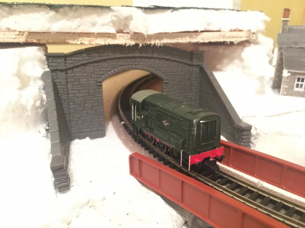

157041586_449424979446711_962630956141698564_n.thumb.jpg.ddd9606fc6b02e123105918fadecbaaa.jpg
first on the chopping block is the farish 08. as the body of these are die cast, not a while lot can be done except for a respray and the correct decals applied.
I have had this as part of a set for a good few years now but it has not seen regular use until lately and it is a little cracker of a unit. happy to plod along at a walking pace.

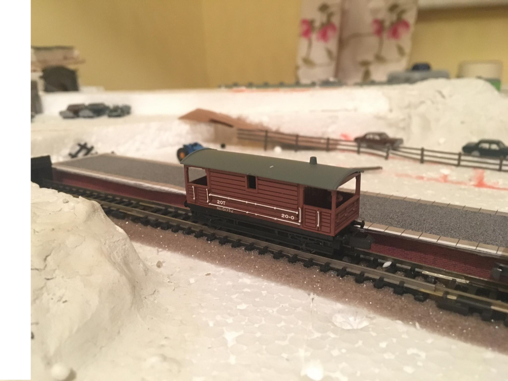

157164310_230739428769772_3160678537091484555_n.thumb.png.4127b7029aa03259976a0ec12609c0b8.png
from this same set, the brake van, in need of a suitable respray and a few details changing to make it feel more irish.

I do have a soft spot for box vans, and when i seen that peco offer these rtr for around the same price as  a dapol OO kit, I had to grab like 7 :D These come complete with slightly shorter looking couplings which peco say space the vans out properly to scale.  they do look really nice in a train.
the roofs pop off for easily repainting in grey. however as can be seen here. I have not been able to remove the white LMS lettering without taking off the greay paint so i reckon i will need to simply paint over it, these should look great when i get my hands on suitable transfers.
