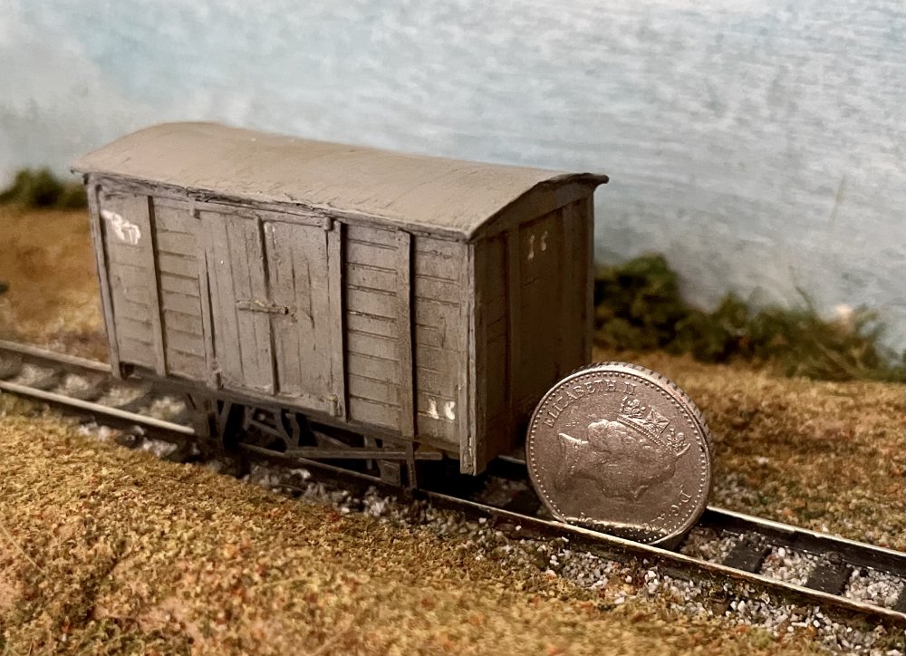

Galteemore Posted May 12, 2021 Share Posted May 12, 2021 (edited) A request for an Irish layout at a local show has got me thinking, and creating. Desiderata : The layout has to be small and light Allow continuous running Opportunity to try out new techniques. Irish in gauge ...just couldn’t bring myself to ignore the gauge issue! I decided to try narrow gauge as I’ve been drawn that way of late in recent book purchases. That just left the choice of scale/gauge. 7mm is too big for a 2nd layout. So 4mm ? 12 mm motor bogies etc are rather hard to pick up right now so that’s out. A chance visit to Shapeways suggested TTn3. 3mm scale, 3’ gauge on 9mm track.... Scenario will be based on one of the 19th century schemes to link the Clogher Valley with the Cavan and Leitrim. Final layout plan awaits decision but it will have a roadside tramway feel, set in Leitrim, with CV/C& L stock mingling. Small station with a hamlet nearby. Early work includes a small diorama to test ideas and a scratch built wagon. All a bit crude but still getting my eye in. The size comparators may garner some sympathy I hope! More updates to follow. Edited May 12, 2021 by Galteemore 8 1 1 Quote Link to comment Share on other sites More sharing options...
David Holman Posted May 12, 2021 Share Posted May 12, 2021 Now that looks interesting. The thing is, is that a 5p or a 10 p coin? Love the small scale stuff, but definitely sticking to 7mm scale! Quote Link to comment Share on other sites More sharing options...
Galteemore Posted May 12, 2021 Author Share Posted May 12, 2021 Thanks David - it’s a 5p! The one good thing about going this small is the wonderful Japanese chassis that one can use...more on that anon.... 1 Quote Link to comment Share on other sites More sharing options...

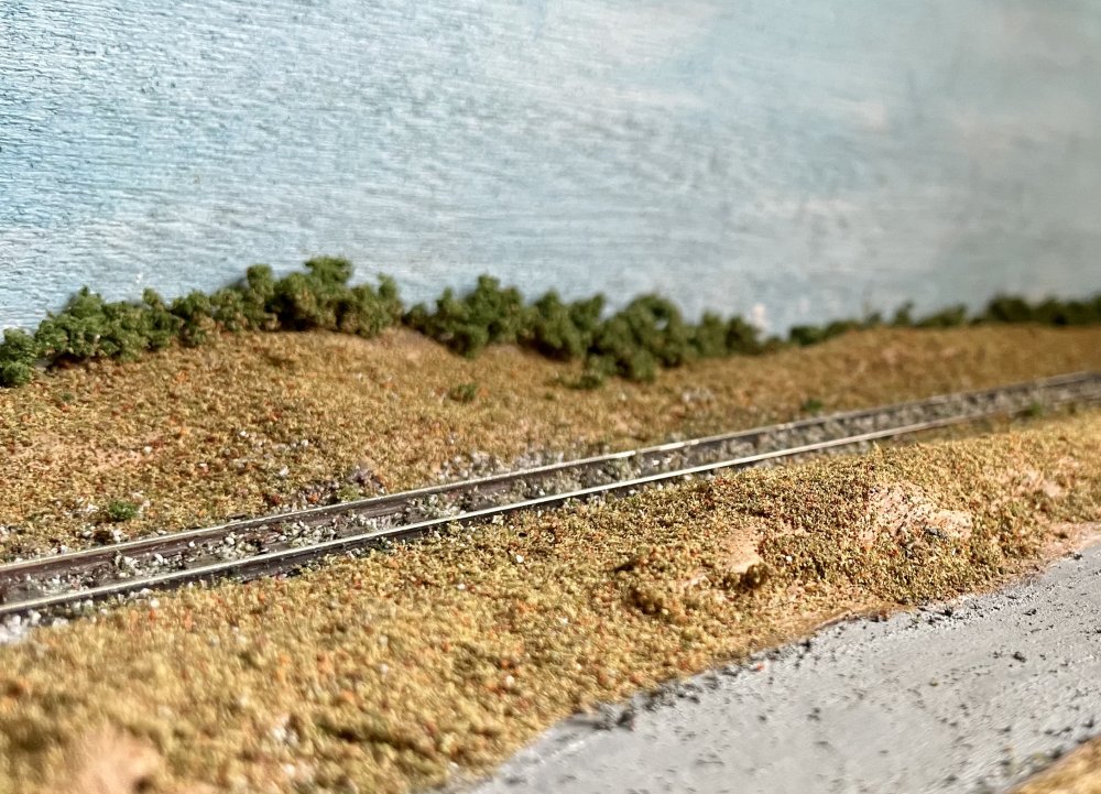

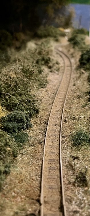

Galteemore Posted August 21, 2021 Author Share Posted August 21, 2021 (edited) Ballasting under way. Hopefully impression of a 3’ byway emerging. I had originally been going to use 009 set track throughout but decided on flexible for scenic front half of layout. You can see the transition curve here in the distance as it begins to segue into the set track curve Edited August 21, 2021 by Galteemore 14 1 2 Quote Link to comment Share on other sites More sharing options...

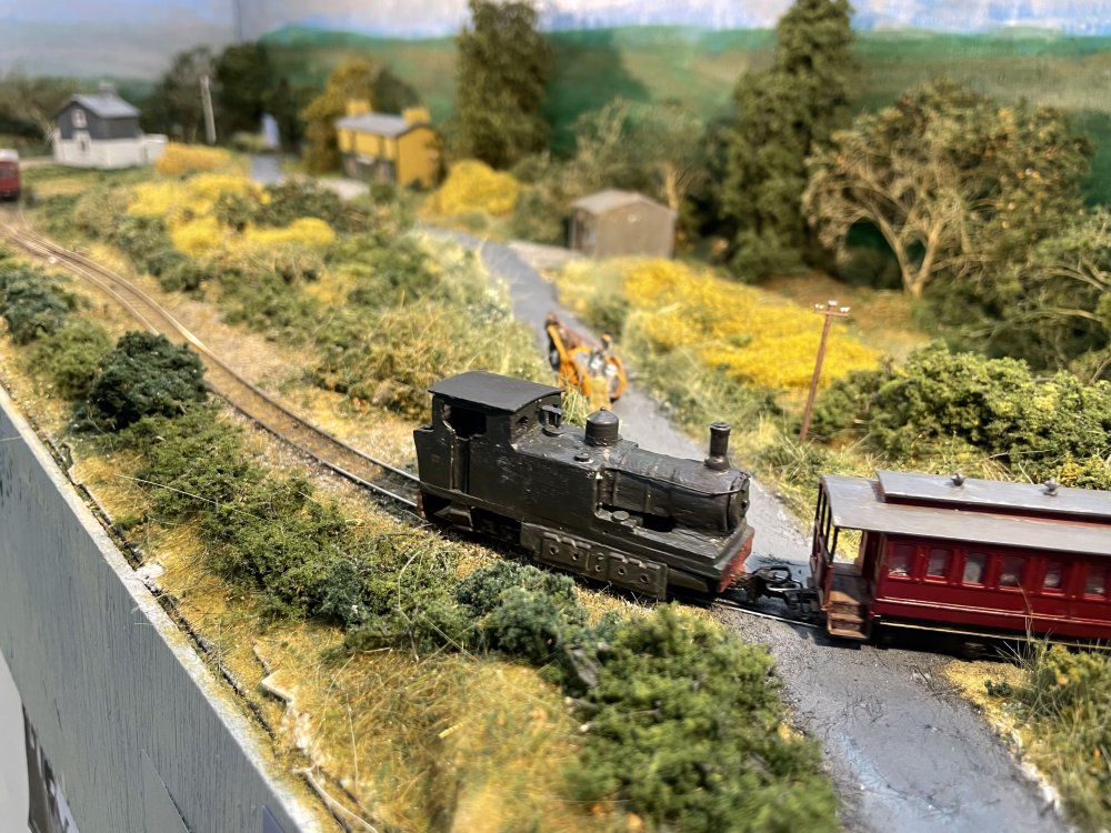

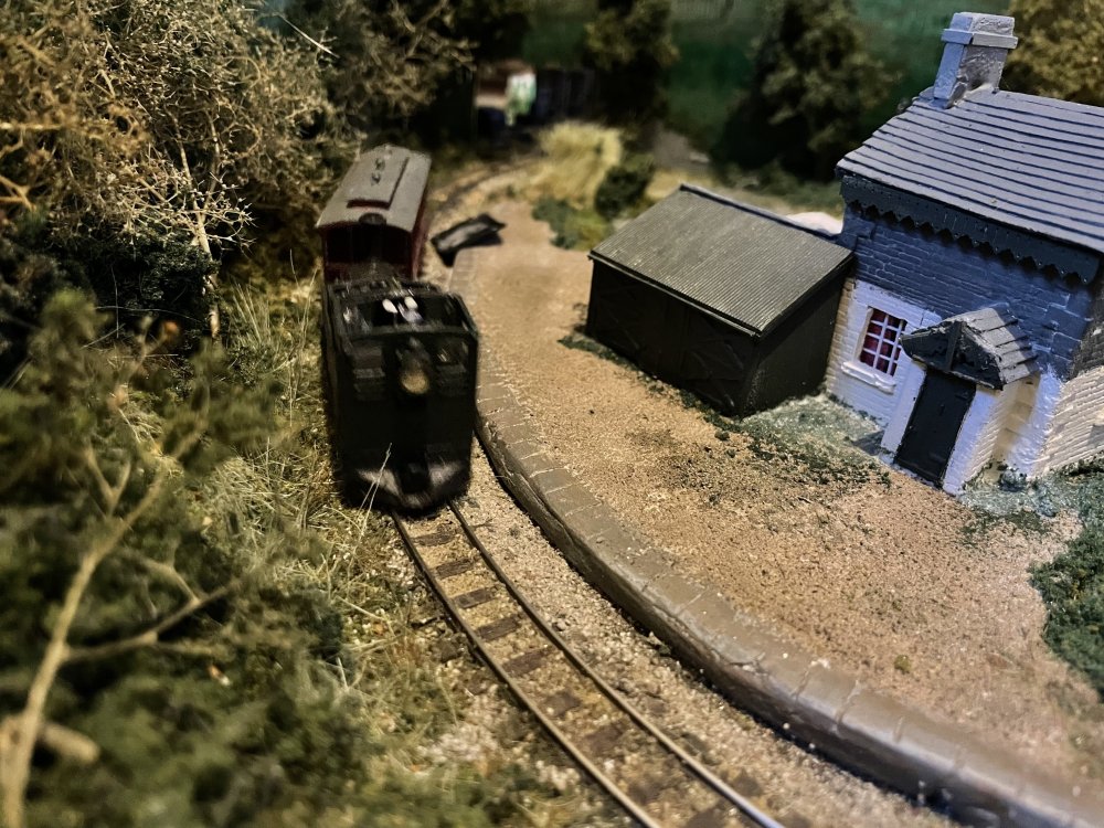

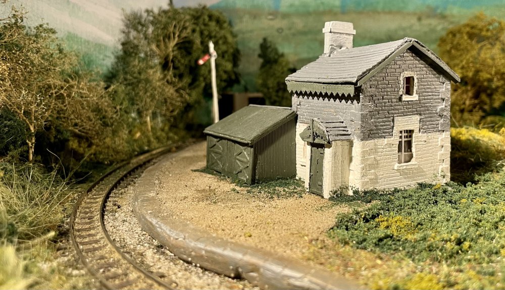

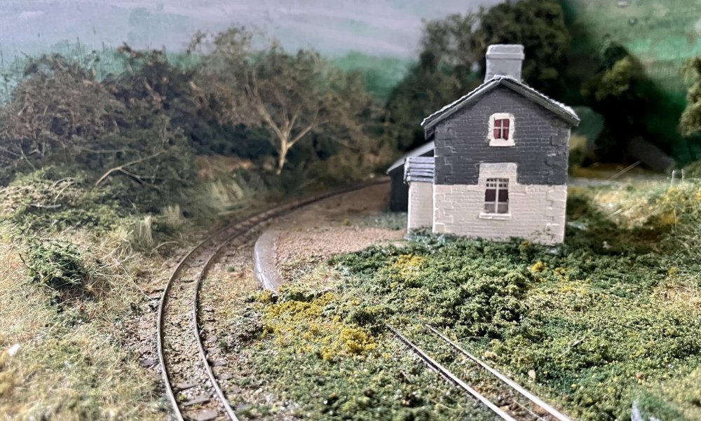

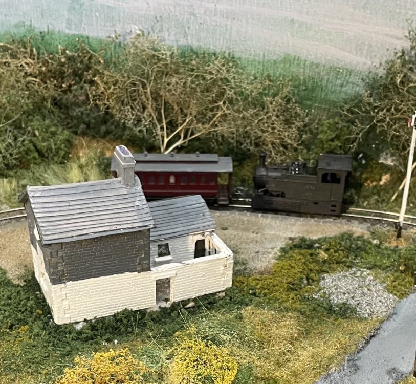

Galteemore Posted August 30, 2021 Author Share Posted August 30, 2021 (edited) Thanks everyone. Bit of Bank Holiday spare time means that Drumkeeran Road station is now more or less done..the inspiration from Kiltubrid on the C and L is probably clear !! You can just see the corrugated waiting shelter beyond the station house. The whitewash was done in this way to assist sighting on curves. Various C and L stations were painted various ways, some being white overall, but I liked the distinctive 2-tone Kiltubrid style. The freight siding clearly sees little traffic…. Edited August 30, 2021 by Galteemore 11 1 Quote Link to comment Share on other sites More sharing options...

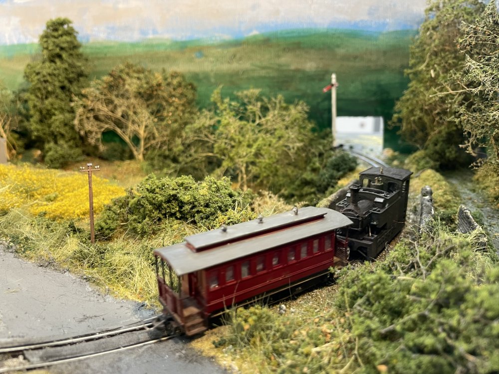

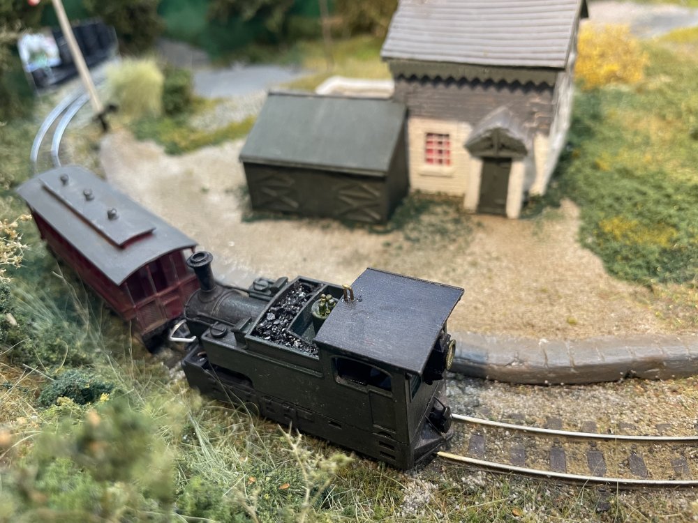

Galteemore Posted August 30, 2021 Author Share Posted August 30, 2021 (edited) With the vast bulk of heavy duty scenery now done - mostly set dressing left - it was time to bite the bullet, clean the track and see if trains actually ran after months of blasting the layout with glue, ballast and scenic fibres. Mercifully yes. Although some 3mm scale tree surgeons will be required as ‘Fury’s’ roof was knocked off by a branch - it can be glimpsed lying at the far platform end….The crew have parked their train in the overgrown siding and repaired across the road for a restorative after that shock ! That siding is very handily placed for bringing in kegs of the black liquidation - it may be in use more often than it looks… Edited August 30, 2021 by Galteemore 11 2 Quote Link to comment Share on other sites More sharing options...
jhb171achill Posted August 30, 2021 Share Posted August 30, 2021 Lovely little scene. 1 1 1 Quote Link to comment Share on other sites More sharing options...
Mayner Posted August 31, 2021 Share Posted August 31, 2021 Certainly captures the spirit of the place with the sharp curve and overgrown siding I had planned to include Kiltubrid on the tramway section of the narrow gauge layout, I managed the sharp curve and bridge but the baseboard was too narrow to fit in the road, railway and Halt Keepers house. perhaps some day I will get round to building a new scenic section or mini layout incorporating Kiltubrid and Drumcong Post Office the two signature scenes on the Tramway. Currently I am thinking of a small OO9 layout to replace my N gauge American end-to end layout that has not progressed during the past year or two. I am thinking on a continuous run layout with a Welsh Narrow Gauge theme an excuse to buy a Bachmann WHR Baldwin 590 and Peco slate wagons and dispose of more of my American N gauge stock and locos. 9 Quote Link to comment Share on other sites More sharing options...

J-Mo Arts Posted August 31, 2021 Share Posted August 31, 2021 I love all the scenic detailing you've added to this layout, it really places the trains in the landscape. The station looks excellent, is it a scratch build or a 3d print? 1 Quote Link to comment Share on other sites More sharing options...
Galteemore Posted August 31, 2021 Author Share Posted August 31, 2021 Thanks J-mo - it’s all scratch built, using an Alphagraphix card kit as a plan. Card sheet as the core structure, with plastic stone sheet on top, and corrugated Evergreen for the shelter. Windows are individually added layers of microstrip. Card strips for roof tiles to give layered effect, and etched valances from 3mm Society. 46 minutes ago, J-Mo Arts said: I love all the scenic detailing you've added to this layout, it really places the trains in the landscape. The station looks excellent, is it a scratch build or a 3d print? 2 1 Quote Link to comment Share on other sites More sharing options...

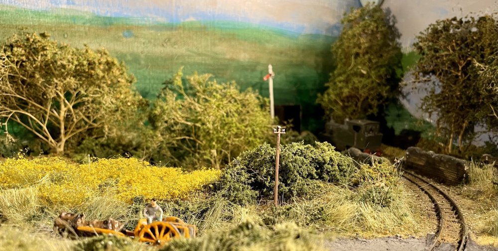

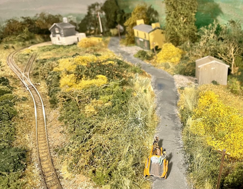

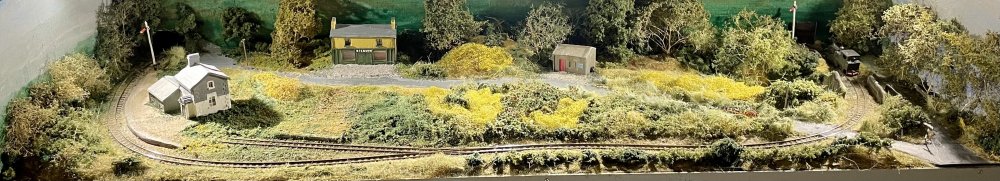

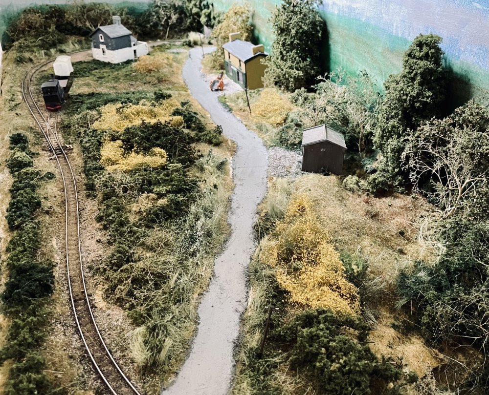

Galteemore Posted September 5, 2021 Author Share Posted September 5, 2021 (edited) Determined to crack the scenery this w/e, I set to and it’s more or less done. Just a few bicycles and chickens to add….A few Google Earth and drone type views as well as normal level ones are below…..the big job this weekend was clearing the road of all scenic detritus such as stray static grass, and recoating it in paint. As ever, photos reveal more areas needing work! But the show’s a few weeks away yet…. One obvious addition is level crossing signals, inspired by Ballyduff on the Arigna tramway. These are deliberately placed to draw the eye away from the hole in the backscene where the train dives through. So the signals indicate a crossing off-stage. They are old BEC kits, from 3mm Soc 2nd hand shop. The whitewashed gable’s purpose as a sighting aid is clear in some of the views. The cart and horse are another 3mm society kit, tricked out in traditional Irish orange and blue. I had originally planned to build this layout with 009 setrack. Looking at the flowing curves, I’m glad I didn’t - the line just seems a little bit more natural with no abrupt bends. The panoramic picture is what the viewing public will see, and shows most clearly that whilst the railway is level, the road really undulates ! Edited September 5, 2021 by Galteemore 8 1 5 Quote Link to comment Share on other sites More sharing options...
LARNE CABIN Posted September 5, 2021 Share Posted September 5, 2021 Excellent work Galteemore. You have captured the 19th century 3' gauge look perfectly. I agree, I love the natural looking flowing curves. The final two panoramic photos are the first time we've seen the overall context, and it looks terrific. I'm sure it will be a big hit at the show. Just as a matter of interest, what width is the layout? 2 1 Quote Link to comment Share on other sites More sharing options...
jhb171achill Posted September 5, 2021 Share Posted September 5, 2021 That is truly superb and captures its atmosphere perfectly. Shows the value of good, realistic scenery and surface textures. 1 1 Quote Link to comment Share on other sites More sharing options...
Rob Posted September 6, 2021 Share Posted September 6, 2021 Brilliant- scenery is very impressive in particular 1 1 Quote Link to comment Share on other sites More sharing options...
David Holman Posted September 6, 2021 Share Posted September 6, 2021 Splendid - and nice to see all the scenic section. Good job it is fairly small, otherwise would expect to read of a national shortage of scenic materials! Shows how a combination of artistic skill and careful observation really bring a scene to life. 1 1 Quote Link to comment Share on other sites More sharing options...

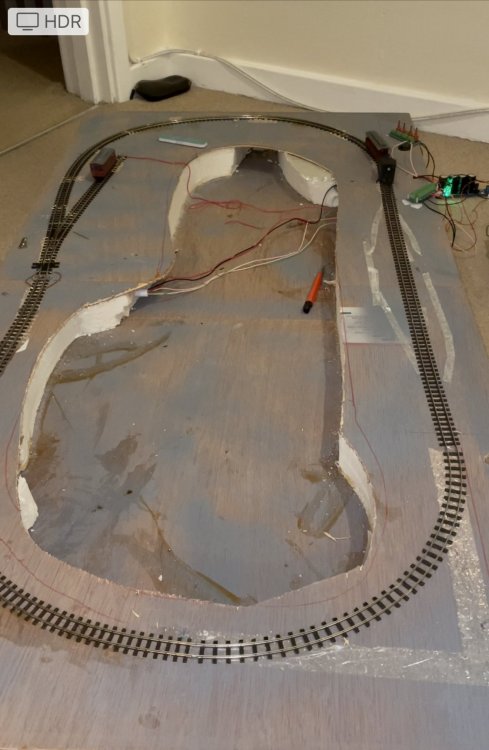

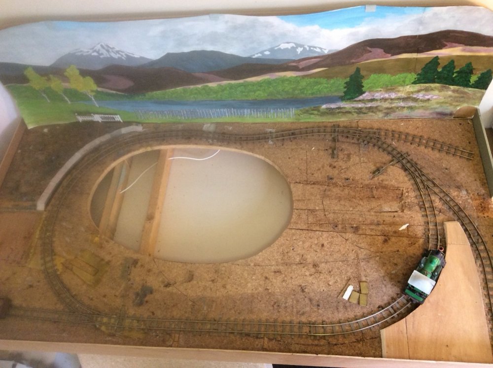

Galteemore Posted September 6, 2021 Author Share Posted September 6, 2021 (edited) 10 hours ago, LARNE CABIN said: Just as a matter of interest, what width is the layout? Thanks everyone. Been a nice project in many ways, and learnt lots. Entire board is 4’ by 2’. You can see how the foam insulation board permits contouring a landscape. The pub and corrugated store buildings sit on small raised platforms and the landscape flows around that. The red pen is sitting pretty much where the pub is. You can also see where I used Setrack for the curves leading into the offstage/back scene - just to give a tight radius but with a definite 9” radius rather than my own estimate! Edited September 6, 2021 by Galteemore 5 1 Quote Link to comment Share on other sites More sharing options...

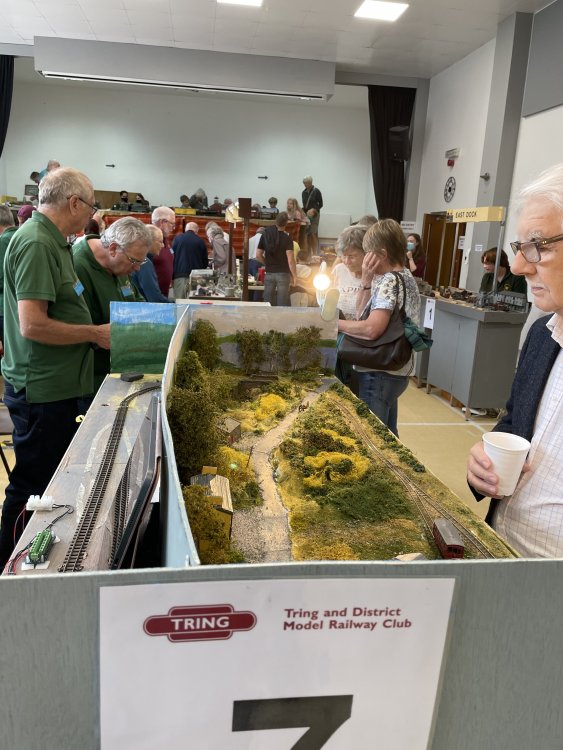

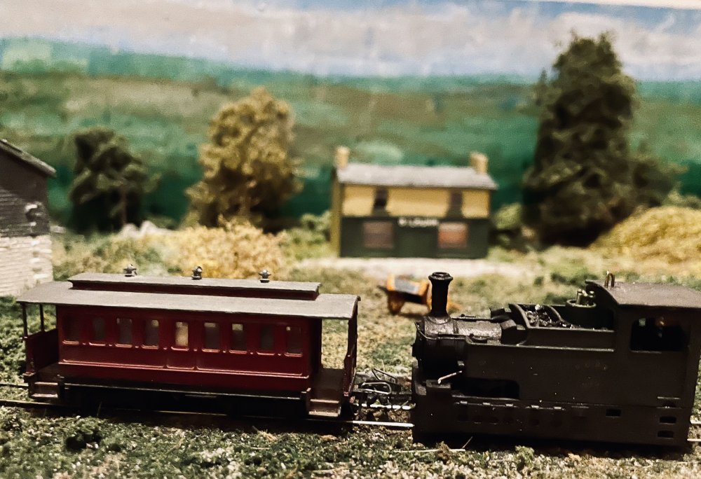

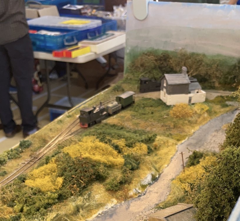

Galteemore Posted September 25, 2021 Author Share Posted September 25, 2021 (edited) Drumkeeran Road had its show debut today. A nice local show - so local I could leave house at 9 and be home by 5. Layout has performed well with just a few glitches but nothing dramatic. Lovely to meet lots of people who took an intelligent and often informed interest in the layout. A few photos, including a rare passenger working by Blessingbourne….. Edited September 25, 2021 by Galteemore 10 1 1 Quote Link to comment Share on other sites More sharing options...
