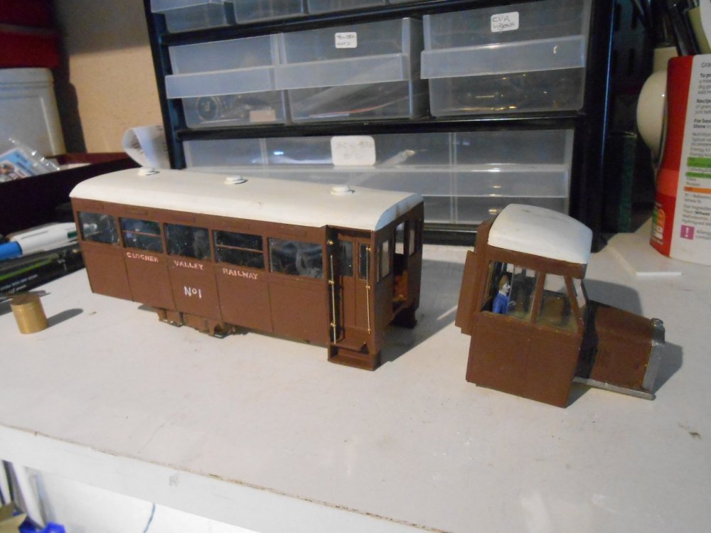

So, from a might have been to an actual, with the Donegalification of CVR Railcar 1. Had the privilege of exhibiting Fintonagh in front of Railcar 10 at Cultra's last show a couple of years ago, but like the Unit, it was made in 2017 and is covered from page 11 on this Workbench thread. Unlike the Unit, it was a scratch build, owing to the Worsley Works etches not being available at the time. The chassis is brass & nickel silver, but most of the bodywork is plasticard sheet and strip. As far as I can tell, the main changes in going to the Donegal involved moving the headlight from the bonnet to the cab roof and adding a luggage rack and ladder to the roof. Needless to say, it wasn't a quick paint job & has been going on at the same time as work on the Unit. Being a dark brown on the Clogher, the first step was to paint the whole model in Precision Paints Donegal cream, to act as a kind of undercoat. Several coats were needed of this colour as it is not very opaque. The same makers Donegal red is much better and only needed a couple of goes over the cream for the lower panels. Transfers are as per the Unit and overall think the model is now looking very dapper in its new livery. Returning to the Unit, followed Galteemore's excellent idea and cut a suitably sized piece of thin red card and used Blutack to fix it to one wagon side. However, as well as this Plan B, also thought of a Plan C, which simply involves painting the top two planks cream - essentially matching the cab. Must admit, I quite like this, but will throw my self at the mercy of the jury, so please let me know!

When the Clogher Valley Railway closed in 1941, Henry Forbes of the County Donegal Railway purchased three items of motive power. The Atkinson Walker tractor became Phoenix, while Railcar No1 became No10. Then there was 'The Unit'. Essentially a second tractor unit for the Railcar, it was fitted with a wagon body & indeed the loco parts were interchangeable. I guess Henry Forbes was hoping to continue the idea, though one of them was badly damaged, so there was only ever Railcar 10. Shame, as the Unit proved itself very useful on both passenger and freight work for the Clogher. Converting Fintonagh to a Swilly/Donegal branch means I can repaint all three of my CVR models just mentioned, so decided to make a start on the Unit. Working on the principle that, being a bit of a 'Rail-Lorry' decided to do the cab in red and cream, with wagon body in grey. The only other work has been moving the headlight from in front of the radiator to the cab roof. Not entirely sure about this livery combination & am wondering if the lorry bit would be better in red - as per a 'red van'. Let me know what you think. The cab side crests and numbers are from an LMS sheet of transfers by the way. Not too bad under the 'two foot' rule, I hope. I've given it the number 5, as this appears to be vacant by the time the CVR stuff went to the Donegal, though given the Unit's interchangeability with the railcar, may 10A might also be appropriate. The model was originally built in 2017, using a set of Worsley Works etches and if you go back to that time in this thread, you'll see a few posts on its construction.

Clogher Valley Railcar No1 went to the Donegal, becoming their No10. They took the 'Unit' too, which was exchangeable with the power unit of the railcar. Indeed, I believe the latter soon became part of Railcar 10, following accident damage to the other power unit. However, what if the Unit had survived as a separate tractor/loco, complete with its wagon body? It could have been very useful for light freight or even passenger haulage and if so, what would the livery have been? Am assuming the cab would have been as per Railcar 10, but what about that wagon body? Would this have been painted in the geranium red, or left in wagon grey? Am in the process of converting both my CVR models to Donegal form, along with the Atkinson Walker tractor to Phoenix, so any ideas welcome please.
