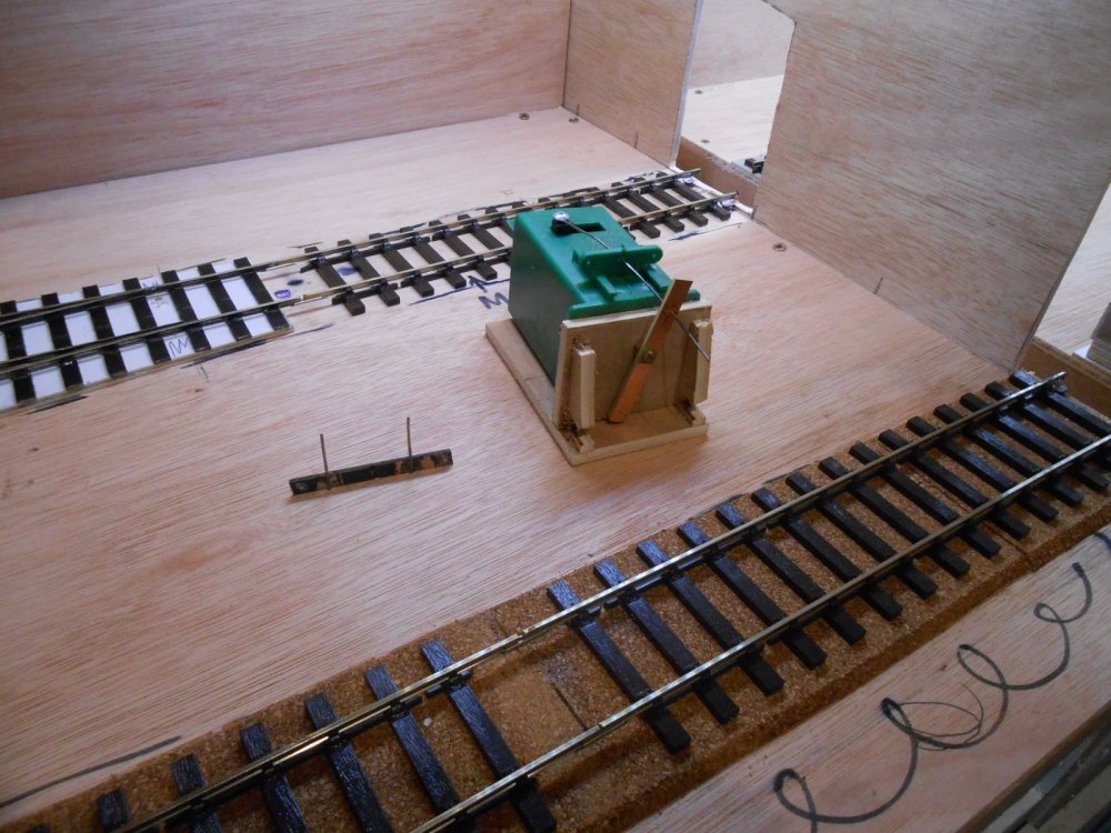

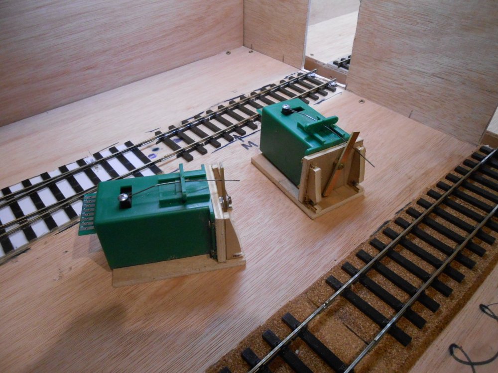

Interesting and thank you both. Looking at the instructions again, they suggest a curved, rather than an angled bend to the dropper might work better. Further experimenting certainly required though, including: Building a test rig so stock can be pushed back and forth on the work bench Try altering the height of the magnet. I use the Dingham ones and on 15v, instead of 12v, as this works better with AJs, so maybe there is an issue there. Vary the length of the dropper as the shorter it is, the greater chance for the loop to fall back down on its own weight Find some way of ensuring the loops don't go beyond the vertical, as once they do, then there is no way they can fall back again. As for loops just at one end, am doing that with some of my trains as it works well with fixed rakes. However, as soon as haunting is involved, it all goes to pot because having a turntable means you soon get a loopless loco with a loopless wagon. Overall, I'd happily use three links and the hand from the sky, but for front operated exhibition layouts that is not practical for the paying public.

Had my first experience exhibiting with these at Tolworth over the weekend and nothing like 13 hours continuous operation to shed light on things. Mostly, they work well, but (as my school reports often said) could be better. So interested to hear about the following: The coupling loops can sometimes get in each others' way. Is just having a loop at one end best, or are there ways round this? Found that the loops can stay up after uncoupling, because the iron wire dropper has stayed down after the magnet is switched off. I have not fitted loops to any of my locos, so this caused problems at times. Plus see above. Should I try shortening the dropper wire, make the front the loop heavier, or even mount the coupling so it sticks out less and the loop can't go beyond vertical? Other things I found were: Though nice and discreet, the etches are a bit lightweight, so a thump from a half kilo loco can upset alignment - especially if there is a buffer stop at the other end... Several times, a loop came partially out of the etch. Ideas on preventing that welcome. 2mm and 3mm versions clearly work very well from what I've seen at shows, so it would be good to learn how I might refine my 7mm ones - including how best to set up and test them.

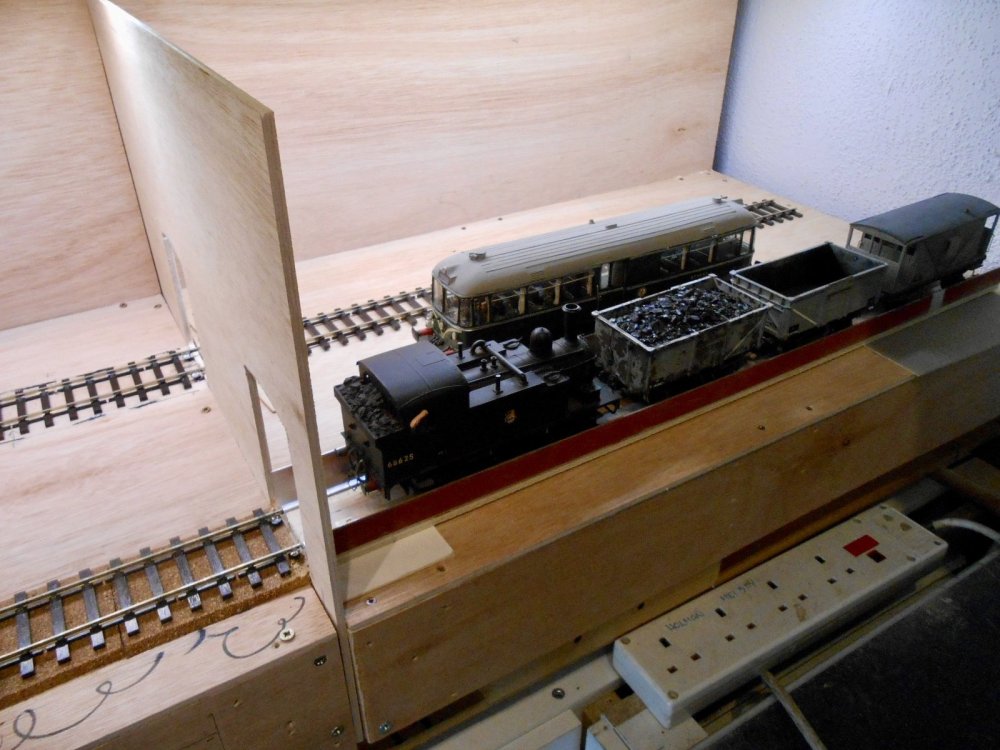

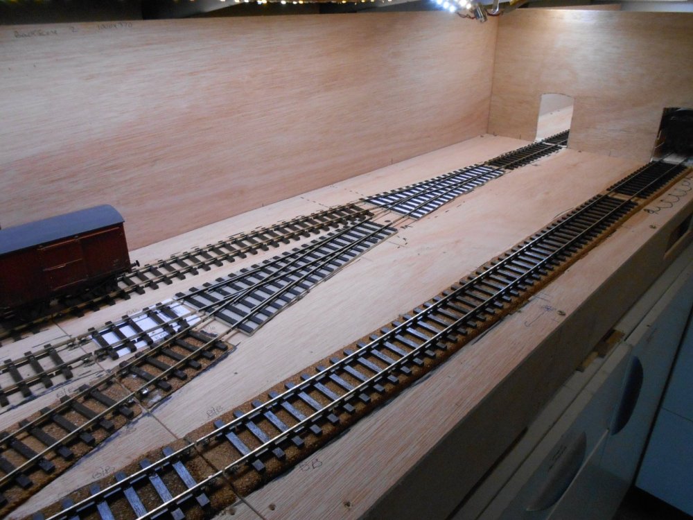

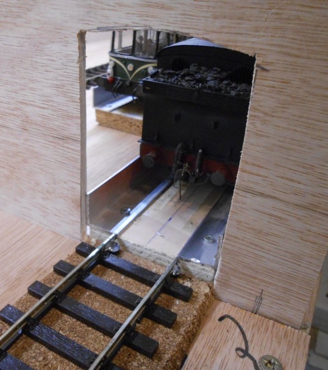

With Swillybegs rehearsals proceeding a pace, thought it time to review the stock and trains that make up the 'new' layout. Fintonagh's last show was over three years ago, so perhaps not surprising that some of the locos needed a bit of attention. Railcar 10 - seemed decidedly sticky and had needed a new [High Level] motor gearbox after its Mashima failed. However, a general clean up and adjustment of pick ups soon had it running smoothly again and it copes well with its new trailer. The Unit - leads the goods train. One wagon shorter than Fintonagh as the new Donegal wagons are longer and bigger that the Clogher ones. Phoenix - has two shunting jobs, the first sorting out the goods, while the Unit rests on the turntable. Phoenix arrives with a single wagon from the front siding, pushes this up to the brake van of the goods and then moves both of them to the train shed. It then runs round and collects a wagon from the front of the out going train, before retiring off scene. In this way Donegal wagons are rotated on successive moves. After turning, the Unit returns to its train, ready for departure. West Donegal Tram - my repurposing of the Clogher Valley 0-4-2Ts. One works the tram, while the other acts as a spare loco, though both are decent runners. The tram comprises three 4 wheel coaches based on Schull & Skibbereen ones. It runs into the front tram platform. After the loco runs round and is turned, it returns whence it came. The Swilly trains The two new locos have caused me a fair amount of grief, but at long last I think I might be getting there. Both have what appeared to be free running chassis, but both stubbornly refused to run well on the track. Thought I'd solved the Barclay 4-6-0Ts problems when I found that two of the outside cranks had worked loose, destroying the quartering in the process. So, the motion was once again dismantled and Loctite 635 used to [hopefully] secure everything. Again. However, running was still erratic and likewise the Kerr Stuart 4-6-2T. The latter is currently running as a 4-6-0T after I removed the rear pony because it kept derailing. This improved things, but still not enough. Salvation came when I realised that both locos were actually not balanced and had too much weight at the cab end, despite both having their tanks packed with lead. Removing the bodies [yet again] and putting heavy brass weights on each end of the chassis suddenly made running much smoother. So, adding a fair bit of weight inside both boilers has made for well balanced locos which now run well. Sigh... Swilly Fish - the 4-6-2T heads this. Just a bogie brake third and a bogie fish van. A simple move: train arrives, loco runs round, turns on the 'table and departs. Swilly Mixed - this move is more involved and suggests that, with their Joint line to Swillybegs, the Donegal and Lough Swilly are co-operating a bit more. The Barclay 4-6-0T arrives with its brake third and two vans, then retires to the turntable. Phoenix now does the shunting, bringing in a new van and removing one from the incoming train. These vans are a mixture of Swilly and Donegal, with the shunting moves similar to the ones on the goods. So, there we are & hopefully ready for Tolworth next weekend. Wish me luck!
