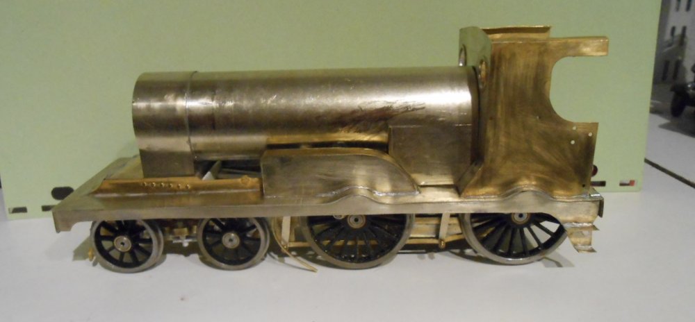

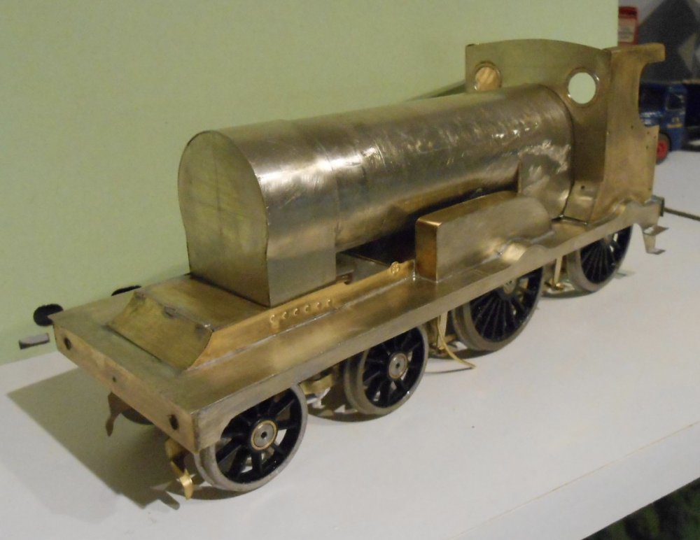

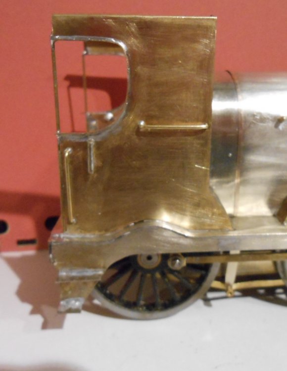

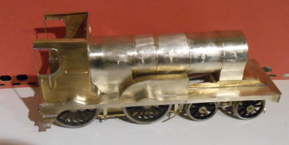

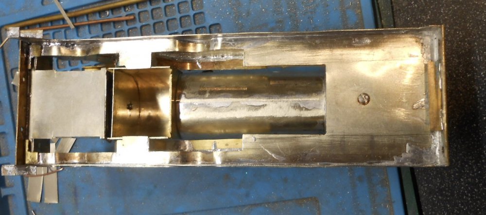

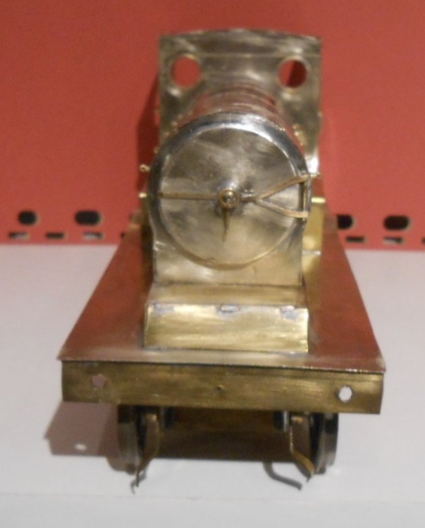

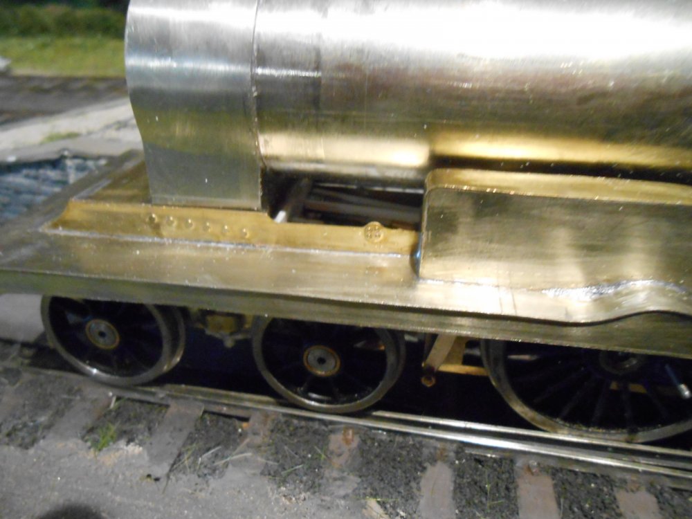

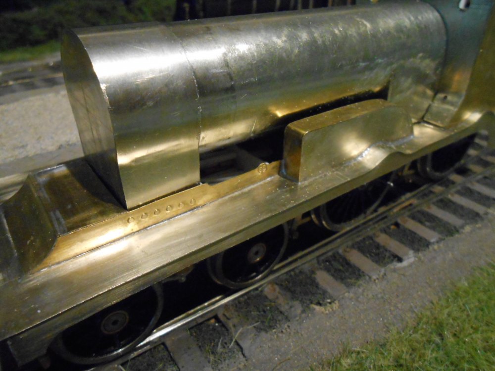

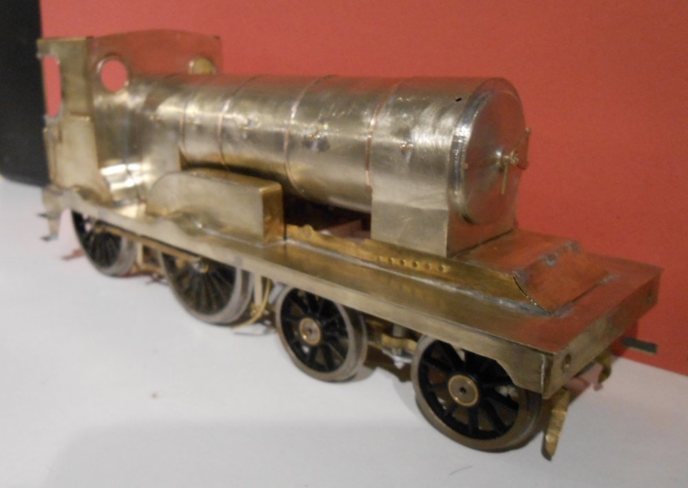

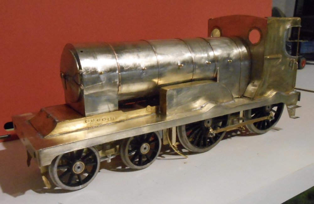

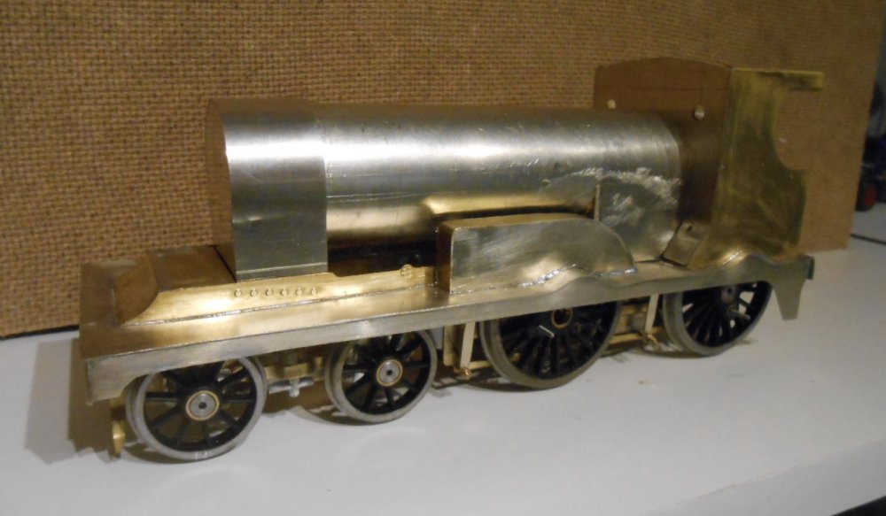

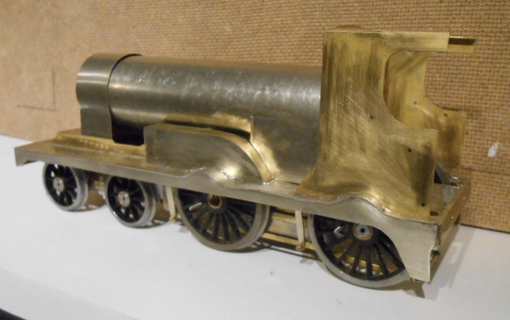

Getting there With the addition of the chimney, dome and cab roof [the latter albeit not fixed and unpainted], the little 4-4-0 is finally taking shape. The list of things still to do is still quite lengthy, but Wolf Dog is certainly starting to look the part. Thus far, it has occupied exactly 100 days, so though I haven't worked on it every one of these, it must be pushing 200 hours of my time. Indeed, the dome and chimney have taken the best part of a week to turn on my little lathe, along with what seems endless filing to get them to sit on the boiler. The whistle is piece of 2mm brass rod, turned up in the drill, with some .8mm wire for the pipe. Nevertheless, it is really nice to get these fittings in place, because they certainly bring the loco to life. Speaking of which, it is now a runner too, with the motor gearbox fitted, together with the pick ups. This has also enabled me to add the brake blocks and secure the rigging. Today, have added the boiler band lining - a challenging process, considering I'd thought it would be pretty simple. Painted the smokebox black too, but it looked far too dense, so added some ivory white to soften it a little, while a bit of light weathering will eventually go on too. Smokeboxes were rarely clean on any loco. Stuff still to do includes the handrails, plus all the lining on the other side. Then there's the cab roof, glazing, lettering, coal in the tender rear coupling, vacuum pipe, etc, etc. No sooner do I tick something off the list, than I notice something else to do, but that's scratch building for you.

Thanks Paul, can't argue with the new purchases - am sure you will enjoy them. Dare I ask what the 7mm loco is? Sounds like I'm not a million miles from what Trevor does with boiler fittings. Have never used a peg in a hole with castings, as prefer to simply wrap sandpaper round the boiler and scrub away. After, fix with 5min epoxy, which allows me to tinker while it is going off. No doubt that 7mm scale is very addictive, but equally, if I could start again, then S would be very tempting!

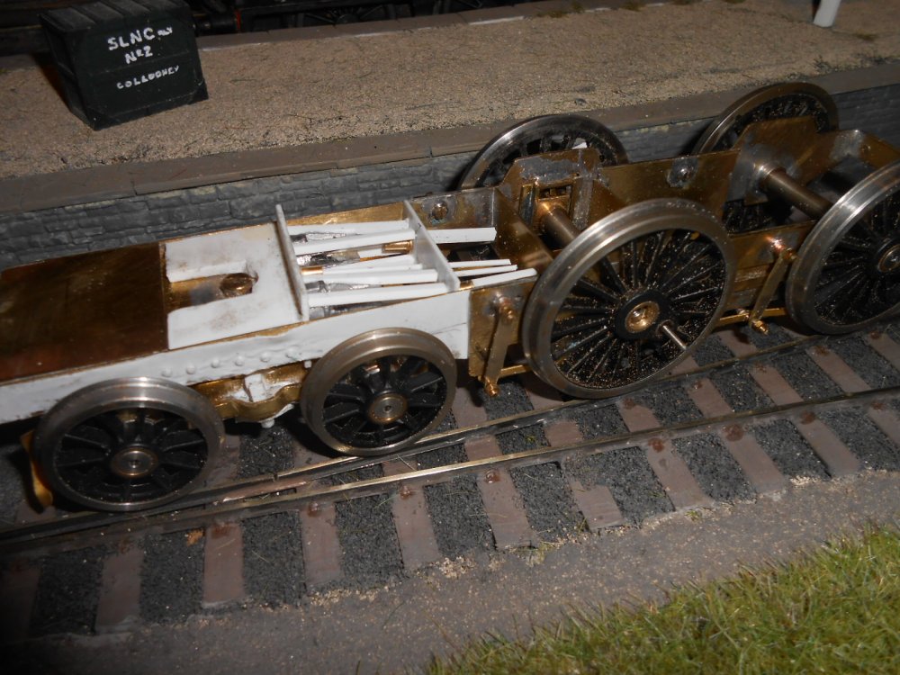

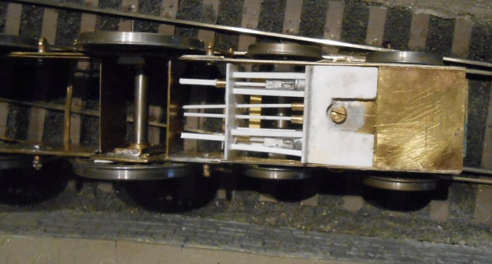

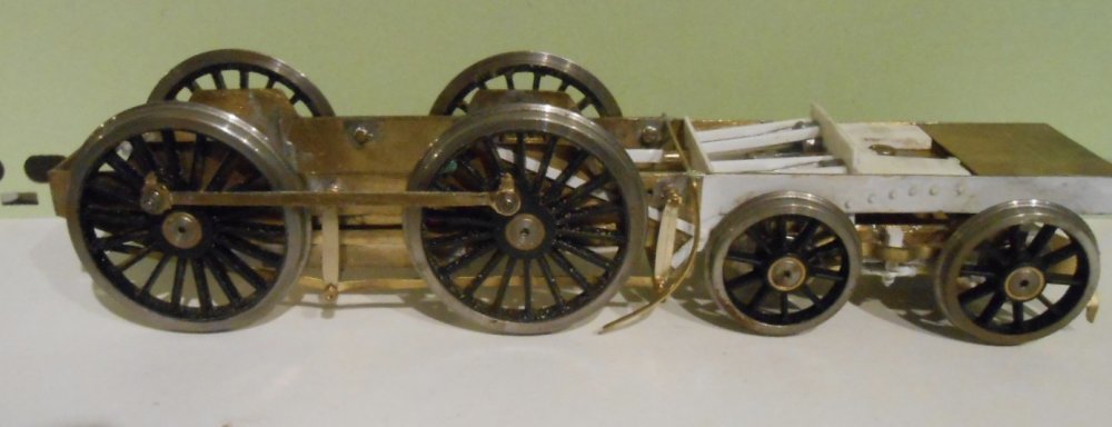

Slowly, slowly... Progress boosted by the arrival of some brass rod and the long awaited ABC motor gearbox. The latter is a very fine piece of engineering, with the motor being a Maxxon 16/26. Small, but powerful, while the gearbox actually 'drives back', meaning you can turn the driving wheels even when fixed in place. It fits nicely too, with plenty of space all round beneath the cab floor and in the firebox to add lead sheet eventually. Not cheap though at £135, but it is quality. I've completed one side of the loco's lining now. A decidedly fiddly job, especially that inner panel on the cab side! One aspect that still needs attention though is that some of the lining is just one black and one white line, but hopefully that won't be too hard to remedy as this mainly occurs where it meets things like the edges of both the cab and footplate. And so to the dome. Ideally, a slightly smaller diameter piece of brass would have helped, but I could only get 25mm, while the dome itself is only 22mm where it meets the boiler, reducing to 18.5mm, which of course means lots of material to turn off on the lathe. Initial setting up was a bit of a trial and many rude words were expended on the ether while I tried to get my head round how to reverse the three cast jaws that make up the chuck. The instructions require you to open these up until they drop out, whereupon you put them back the other way round. Easy enough you'd think, but if you do that, the jaws don't centre and I spent a frustrating time trying to get it sorted until I finally found a tiny note on the diagram which showed that jaw 'B' stayed the same, but A and C needed to be reversed. Oh well... Anyway, once done, things progressed reasonably well, but taking it slowly is essential. On top of this, a lot of finishing and polishing is still required, plus the base of the dome also needs to be filed to the profile of the boiler. Geoff Holt's book suggests using a fly cutter on the lathe, but this is beyond my ability at the moment, so instead have laboriously done it by hand. It still needs a bit more work, but that can wait until another piece of brass rod [18mm this time] arrives so I can do the chimney.

As I'm still waiting for brass bar to arrive [hopefully next week], decided to make a start on the painting. The loco and tender chassis have been done in matt black, though the inside faces of the loco frames are red, as per practice in the early 1900s. Must admit that I'm more than a bit disappointed with Precision matt black paint, which shows brush marks, despite my best efforts and doesn't look as good as Humbrol. The loco and tender body is Halford's 'Garden Green' - the nearest I can get to what I'm told is MGWR green, apparently Great Central green is close, in the absence of colour photos, though a Google search does throw up a model loco in this shade. Initially, it looked very bright indeed, but as is often the case, once things like the tender top, footplate top, axles boxes and so on are picked out in black, it does change things. Likewise when paired with the chassis, where the wheel spokes are green, but the rims and centres black. The boiler/smokebox is a separate unit, so will not be painted until the chimney and dome are made and added. Have also ordered etched name and number plates from Diane Carney - not cheap at over £40, but as bespoke items, still a fair price I think. So to the lining! The main reason I haven't posted anything for a couple of weeks is that my attempts with a bow pen proved a miserable failure, even on just the relatively simple tender lining, so I really couldn't see me mastering the horrifically complicated loco lining, especially on the cab. Hence put in an order to Fox Transfers for some white/black/white transfer lining sheets, including various curves. Even so, it is proving very challenging, so the photos just show progress thus far, including the cab interior.
