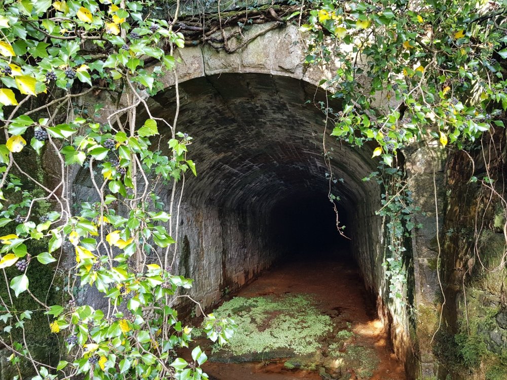

  7. Eoin, Many thanks for that - I had neglected to look to Shepherd & Beesley and was using an article published by the Mineral heritage Trust of Ireland (https://mhti.org/uploads/2/3/6/6/23664026/the_avoca_mineral_tramway_a_further_look_into_an_early_co._wicklow_mineral_tramway._waldron_a_et_al__2004_.pdf ) which also noted that the section between Ballygahan and Arklow was 3'6". The run of the mineral railway to Avoca was sold to DWWR who used the trackbed for their own line with a new mineral line was installed away from the river. A transfer siding was provided in Avoca, to which the tunnel above connected, the tramline being elevated above the rail line to allow easier transfer. What has raised this query is a photo I discovered on the NLI which shows the ore wagons on track to the South of the station and bridge (https://catalogue.nli.ie/Record/vtls000338942 ). Any photo I have seen shows a twin 5' 3" line under this bridge, so I am a little unsure of how these ore wagons get to the South side of the bridge if they are 3'6" gauge, hence the query on the tramway gauge. What is also interesting in the NLI photo is engine shed and turntable - the turntable looks more like a glorified wagon turntable & it is noted that DWWR had responsibility for maintaining and housing the locomotives, so perhaps this is the tram loco shed? Sadly the OSI historical maps do not show any tramlines . I am in the process of building a model of the tram loco and wagons based on the 3'6" gauge, and from dimensions the wagons could have carried 2 tons of ore as noted by Shepherd & Beesley so these elements tally. Assembled temporarily with pinpoint axles - these will need to be trimmed before fixing. These are really small, the ore wagon being 22mm long - for context that drill in the background with the red collar has a 3mm shank. The intent here is to develop a model of Avoca station with the tramline in the background with the tipping wagons on the transfer siding in the background. I'll post more in the Layout section once I get an opportunity to make some progress. Ken

  10. Just doing some research on the ore transfer between the mines and the DWWR line at Avoca. A tramline with associated locomotive and wagons ran from the mines down to a transfer siding in Avoca station. From my research, this ran from c. 1864 to 1900, and I have managed to source some photos through the NLI online archive (can't show the photos here now due to negotiations with NLI re copyright) but I have managed to source some photos of the 1872 3 plank wagon and tipping wagon I am currently making models of. What would be nice is to develop a model with the tramline and ore loading in Avoca. I have some details on the tram ore wagons & a sketchy outline of what the tram loco may have been. Where I am struggling is the gauge of the tramline. I have some information which notes that 7' sleepers were used. A tunnel under the road leading into Avoca carried the tramline which is still there, and there does appear to be some sleepers left, albeit seriously covered on debris etc. Photo taken 03/03/2022. Tunnel & some remnants of sleepers are still there a minimum of 120 years since it was last used which was impressive to view. Would be nice to bring this back to awareness, so if anyone has info on track gauge of the tramway, it would be much appreciated. Ken

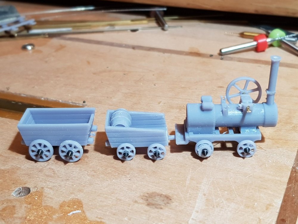

  22. A little late to this party, but one worth joining!! One of the goods engines ordered in 1863 & delivered in 1864. Lasted in operation until 1924 before being scrapped in 1925. It's compatriot No. 21 was re-built as a tank engine in 1905. It's a model I should build, and will get to it in time; too many other projects on the cards at the present to make any meaningful progress. As to the 2-2-2 WT, they seem to have been well covered in the comments above. Quirky locos, but appeared to have provided good service in various guises from 1865 to 1923. It's a loco that I'm planning on building to run with the small side tipping wagons built earlier. Design is proving difficult due to the lack of space for motor, gearbox, battery, etc, so I am developing in 3D first before building in Brass. Model is 96mm over frames with no tanks or other hiding places so an enclosed cab version is the only way to proceed. This will be a model of No. 35 built 1873, withdrawn 1923, so should work well with turn of the century rolling stock. Agreed, they had quite a number of tank locos of different sizes and that particular example became the GSR 423 Class - nice loco & good model. I am proposing to build another of these and may go down the etching process to develop a kit. Fittings can be 3D printed as suggested above. A little bit of fine tuning will be needed to ensure the etch version can be built in OO and 21mm versions. @jhb171achill JB, if you have any more photos of the DWWR / DSER, it would be most appreciated. Those posted by you, and others here are most appreciated. Ken
