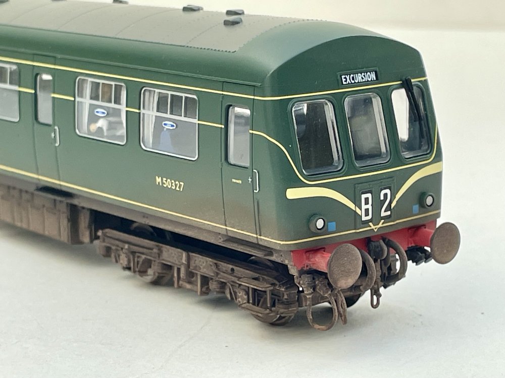

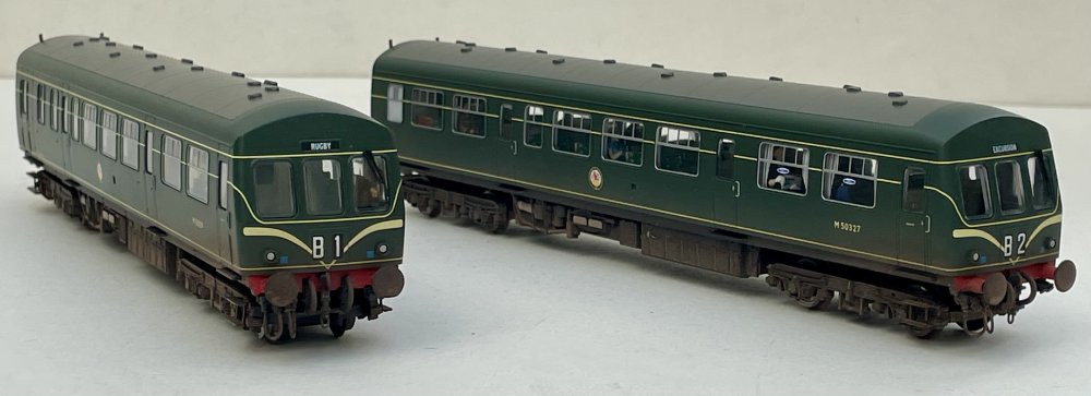

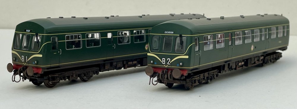

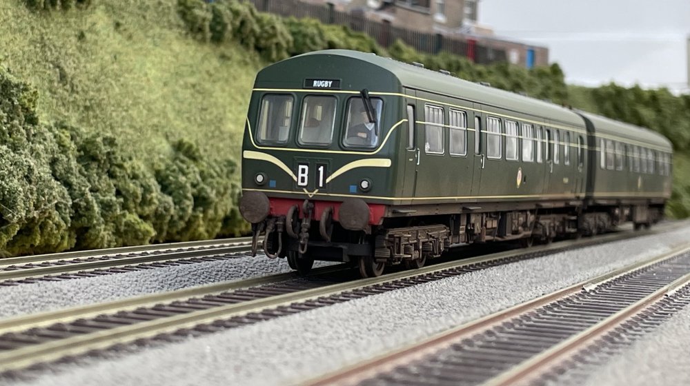

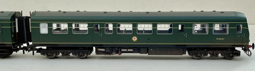

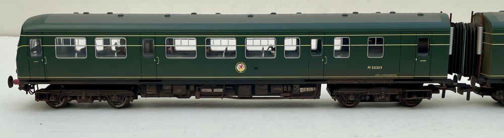

Obtained an unboxed Hornby Class 101 centre coach from eBay in blue/grey livery.
I detached the coach body from the chassis and removed the interior.  The window glazing was carefully removed and the body masked for painting into Regional Railways livery.
The first class logos were removed from the window glazing using the end of a cocktail stick dipped in white spirit.
The wooden cocktail stick is abrasive enough to remove the painted on sign but soft enough not to scratch the clear plastic.
Fox Transfers lining decals applied and glazing re-fitted.
Coach interior upholstered and gangways fitted.
Light weathering of chassis to finish.
Cheers
Darius

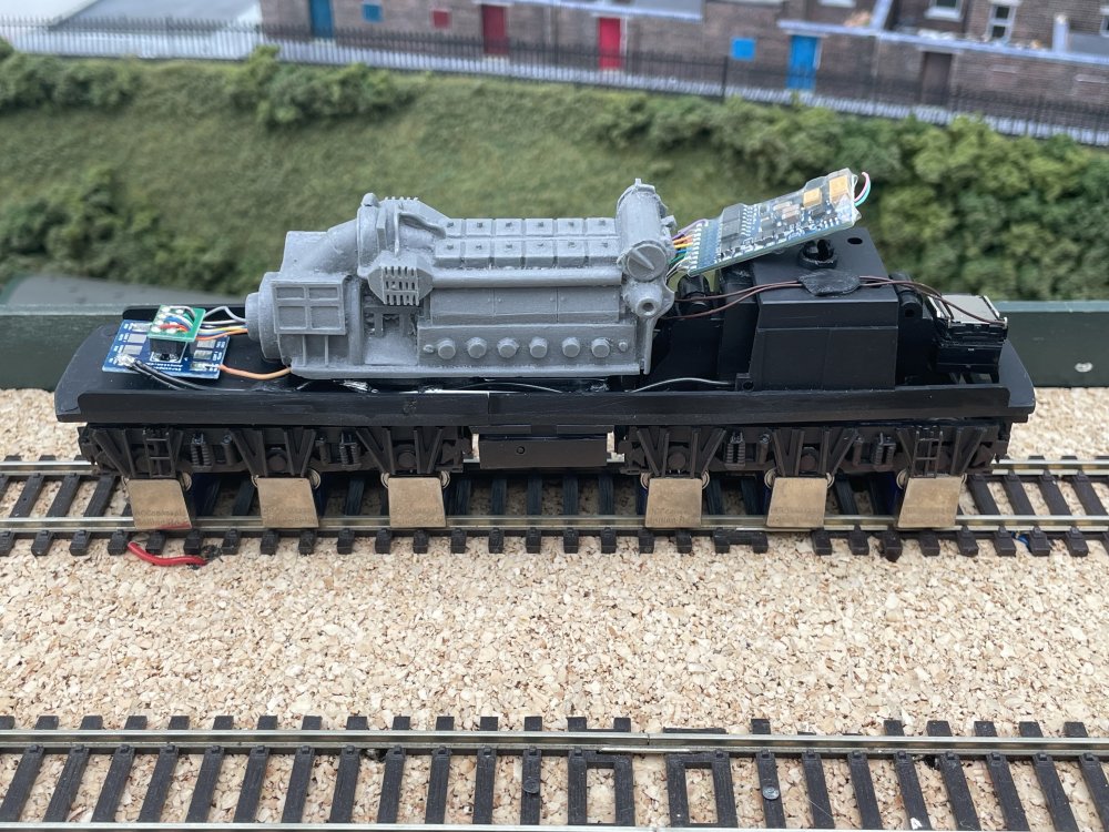

Back to the B Class locomotive.  I fitted a resin Sulzer powerplant to remove the see through effect and squeezed in DCC sound courtesy of Roads and Rails.
Cheers
Darius

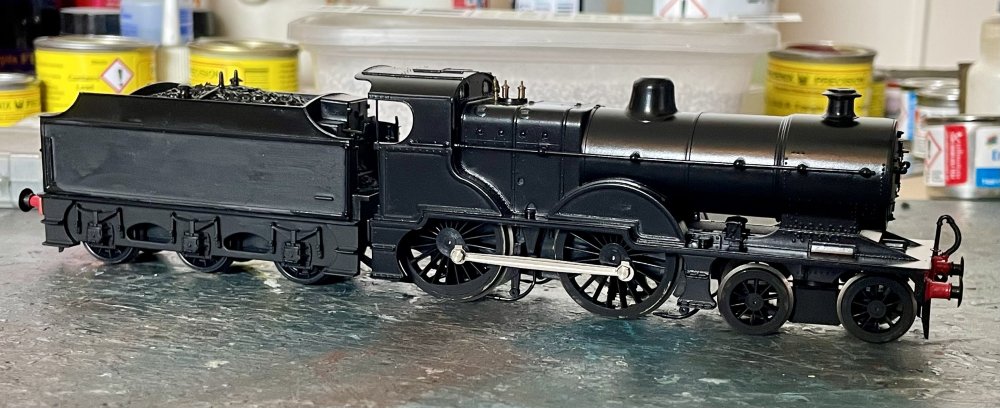

On 30/9/2022 at 7:14 AM, Darius43 said:
Painting completed.
Cheers
Darius

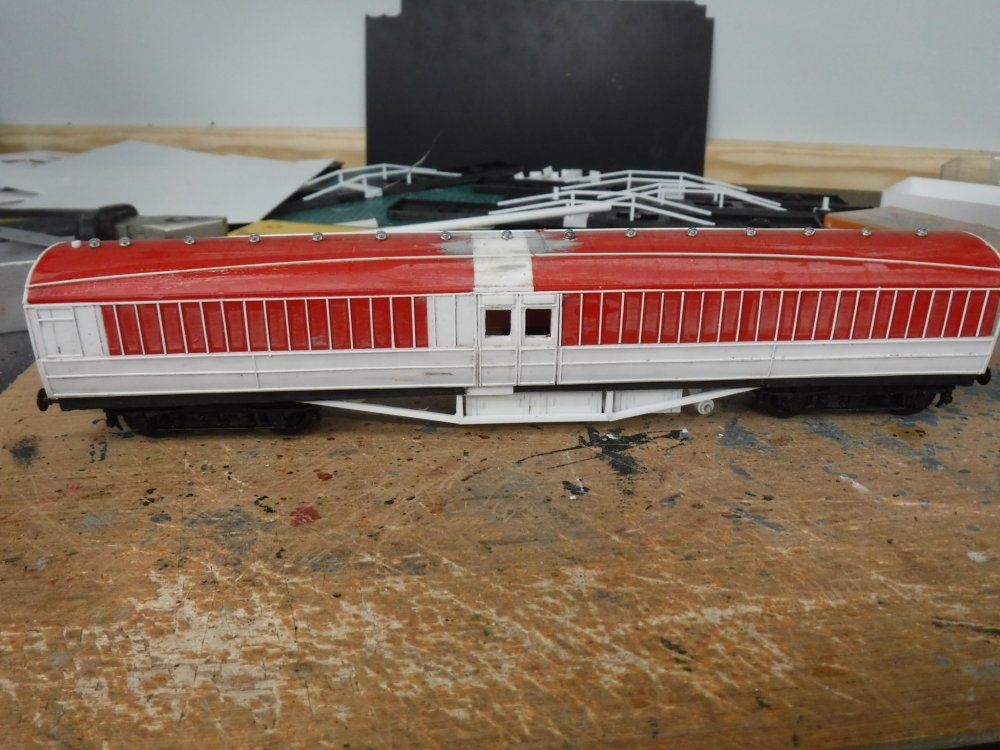

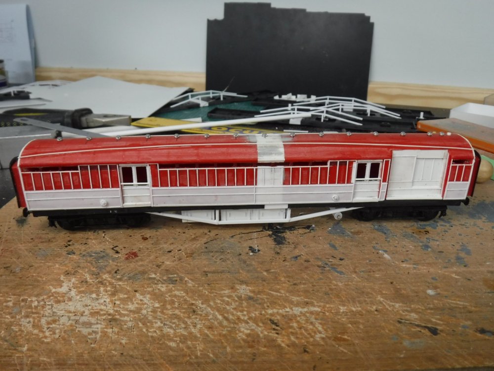

Looking through your past work it seems we think somewhat alike in some ways, here is my version of an LNER POS diagram 165.
My version is a somewhat hacked about Hornby LMS mail coach which was suitably lengthened. It is shewn on BR B1 bogies as it was sent on to a friend who had some LNER Gresley bogies and he painted it maroon also.
Net side.
Sorting side.
Gibbo.
