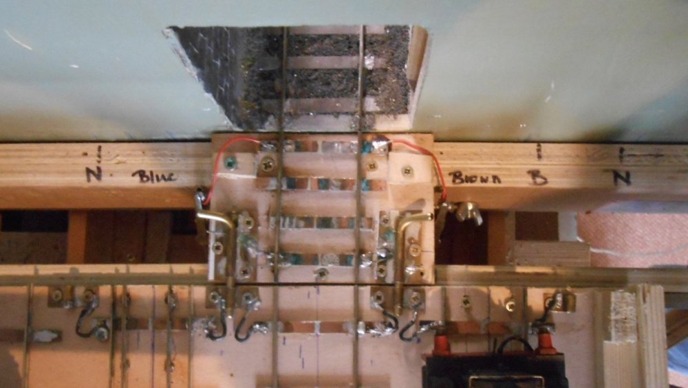

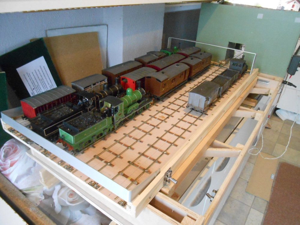

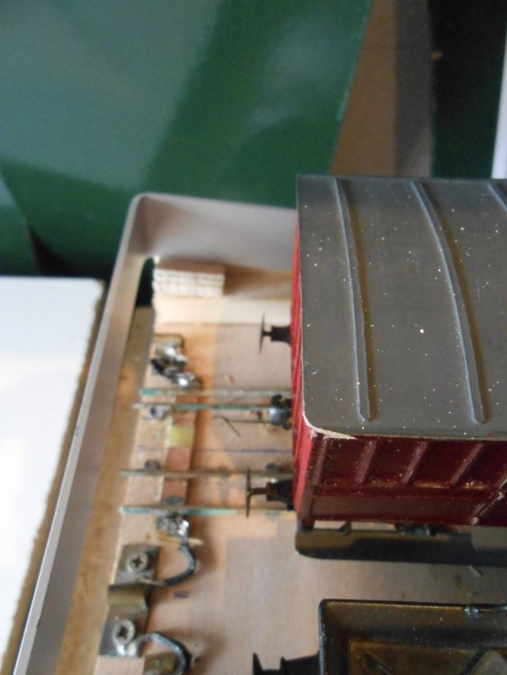

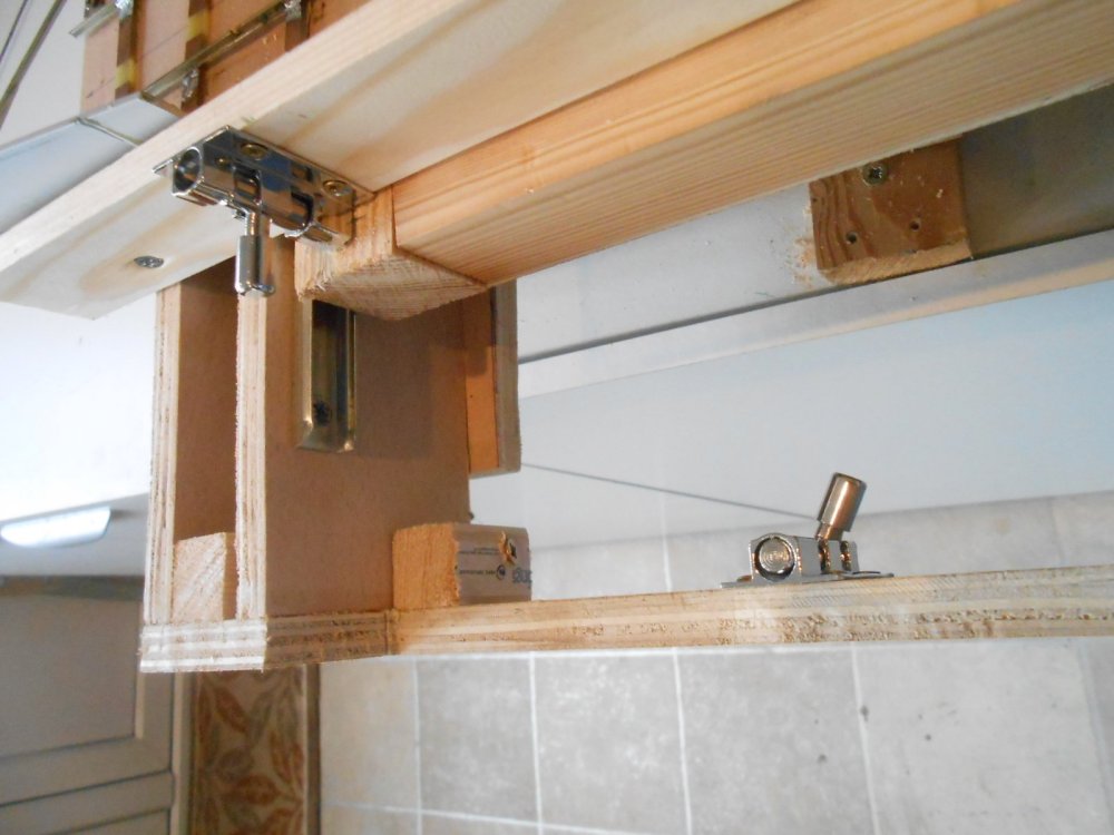

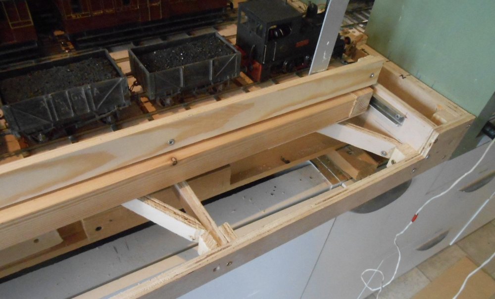

David Holman Posted May 24, 2024 Author Posted May 24, 2024 Finally got the new fiddle yard hooked up to NPQ today, enabling trains to be run for the first time in months! Just as well really, because the layout's next outing is the Chatham Show, at the end of July, which isn't that far away now. The main work was wiring in all the bolts - two wires from each one to the adjacent rails, meaning only one track is ever live. Power to the track comes from two wires from the layout, which each have a crocodile clip on them. These go on a screw each side of the short bridging track & a single wire from each screw goes to the rails, with another from the rails to each bolt. Safety next, with the hinged aluminium strip buffers at each end of the train table. Small blocks of plywood mean the buffers will clear the Alex Jackson couplings when lowered. The main frame of the fiddle yard was flexing a bit, so I cut some strips of 12mm ply and fitted these as diagonals between the intermediate frame pieces, which nicely triangulates things and adds some all important rigidity. Also replaced the oversized bolts, which ensure the table remains parallel to the frame when being slid from side to side. After that, it was time to put trains on the table and do a few test runs. Happily, all seems well, though care is of course needed when turning the table, once everything has been out & back - but then it was the same with the previous model. Some priming and painting now required, so everything matches the layout boards, plus I really must work out where to fit the all important coffee/tea cup holder. 12 7 Quote

DonW Posted June 18, 2024 Posted June 18, 2024 Looks good. I did make something like that for a layout but it turned out to be very heavy to transport and in order to be able to turn it restricted the length. So I have gone back to cassettes this time. These are 1m long but if away from the modelling room I could use longer ones say 1.2m. Don Quote
David Holman Posted June 19, 2024 Author Posted June 19, 2024 Yep, hence the rebuild, Don. Have used cassettes extensively in the past and found they work best when there was a separate loco cassette so the actual train only needed sliding from side to side, with just the loco lifted and moved to the other end. Quote

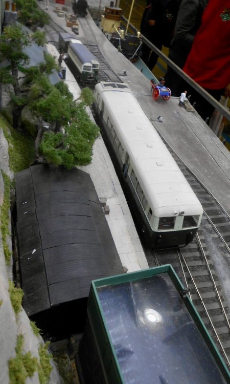

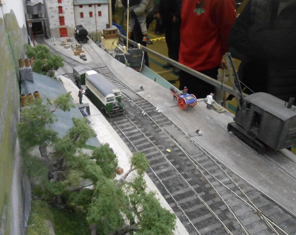

leslie10646 Posted November 10, 2024 Posted November 10, 2024 @Galteemore and I turned up at the Tolworth Exhibition today to run our respective trains on David's wonderful Northport Quay. I overheard, David remark to one admirer that there were THREE people in the World modelling on 36.75mm gauge and that they were all in present in front of him - so having been given this not-inconsiderable accolade, I arranged a photo shoot! Of course, the two David's are the modellers, I am just an owner and runner! Not only did David let me place my little MGWR train on his hallowed turf, but he even let me drive it! A very serious business it is driving a train into a station which you haven't "signed for". I was terrified! 13 Quote

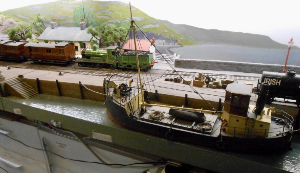

leslie10646 Posted November 10, 2024 Posted November 10, 2024 (edited) Despite what @Galteemore says above, his little JT DID get her SLNCR coach into the Quay! A very busy line that you run @David Holman, trains from 3/4 Irish Railways rushing in and out - maybe it's the Salmon Season? By the way, I thought that the way the background melded into the foreground, as you can see behind No.92, was very finely done. Remember to put up some video of the dock crane on the move - a super extra which I forgot to capture. Terrific layout. I wish that I had your patience and half the skill. Thanks for having us! Edited November 10, 2024 by leslie10646 9 1 Quote

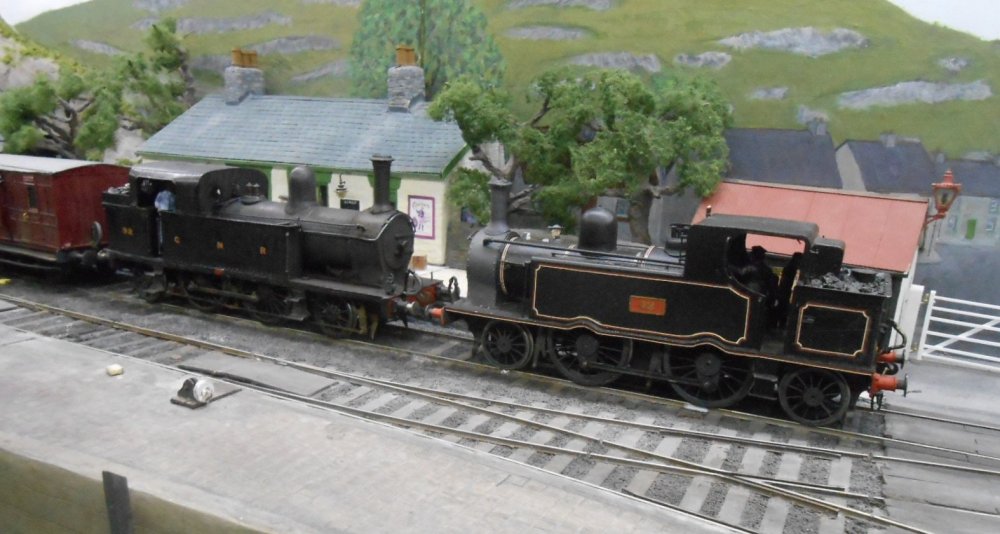

David Holman Posted November 10, 2024 Author Posted November 10, 2024 Great fun this afternoon at Tolworth with David, Leslie and David's fine models including a Sligo railbus, Small Tank, JT 2-4-2T and E class 0-6-0T. NPQ had a bit of a mixed weekend - issues with the baseboard joint and AJ couplings causing problems in Saturday, but slowly improving. Will post some photos tomorrow. 2 1 Quote

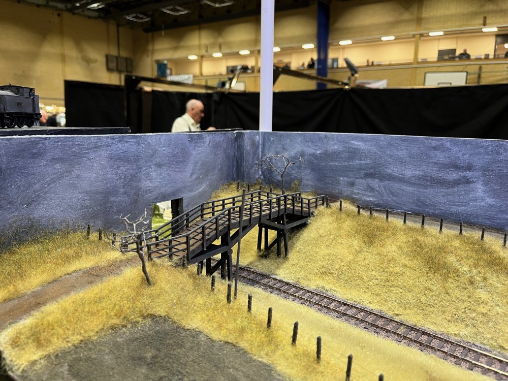

leslie10646 Posted November 10, 2024 Posted November 10, 2024 I was very taken by this ittle accomodation bridge, which Andy assures me is fairly typical of the NBR. Amazing what you can do with a box of matches .... Only joking, Andy, a very nice piece of modelling. 11 Quote

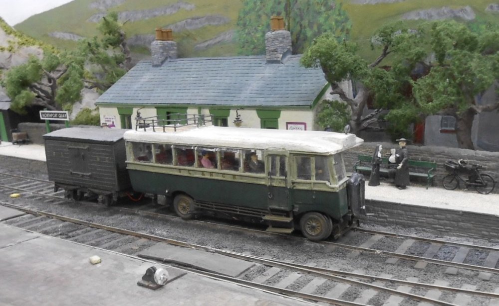

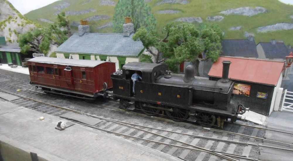

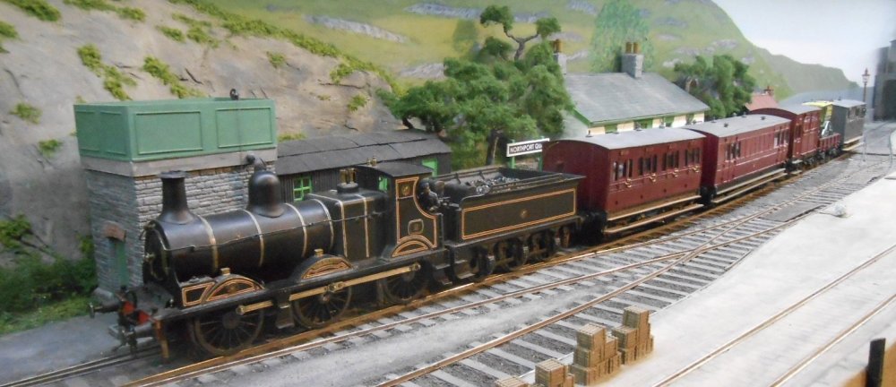

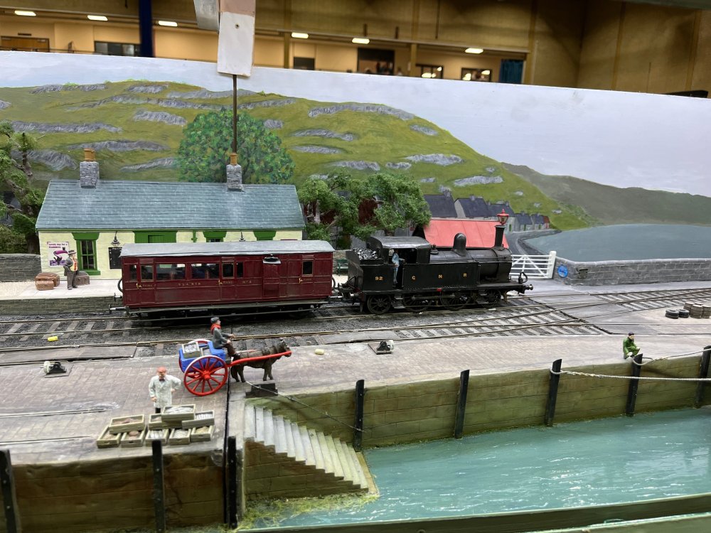

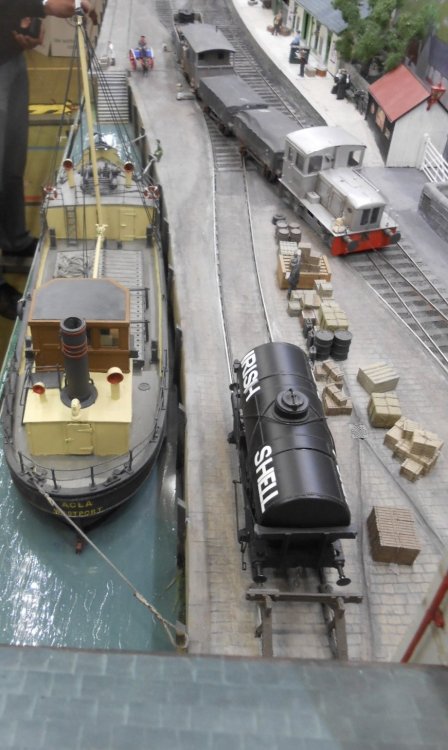

David Holman Posted November 11, 2024 Author Posted November 11, 2024 As promised, a few pictures from Tolworth. It was lovely to meet with David, Leslie and Andy over the weekend. Northport Quay, despite operating well at home the week before, struggled for much of Saturday - some of which was undoubtedly down to being loaded in the car overnight and then finding itself in a very hot and humid exhibition hall. However, repeated derailments in the loop, over the baseboard join were frustrating, as was the failure of a push to make switch for one of the uncoupling magnets. Later the wire in tube connection to the signal came adrift - a two minute job to fix at home, but not at a show. Take my word for it, David's models are every bit as good in the flesh as they are in photos and it was great to have visiting 7mm broad gauge locos on my layout because the fact is, we are a very small group. I had the delight and privilege of having Richard Chown's Lissadel run on Arigna Town at the Manchester show, but David's model's are the only other ones [including those owned by Leslie], so it was a rare treat to have them along. Surely, we aren't the only two people in the world modelling 7mm scale Irish 5'3 though?? Back home today, did a bit more investigating and found that one of my trestles was a centimetre taller than the other [!] - so no wonder some engines were struggling to get out of the fiddle yard. Across the baseboard join was a definite ridge, which needs sorting, as does a section of out of gauge track into the left hand siding. Nothing derails here, but it nevertheless points to why my AJ couplings can come undone because there is too much sideways movement on short wheelbase stock. Anyway, a few pictures of my stuff, taken from unusual angles not normally available. And now the visitors. Couldn't resist having the GNR JT alongside my F6 and likewise the rail buses. Sadly my photo of Leslie's E class was out of focus. 9 8 Quote
Galteemore Posted November 11, 2024 Posted November 11, 2024 (edited) Sounds like your layout is taking on SLNCR PW characteristics David! Hope all gets sorted out without too many dramas. Given the hard life exhibition layouts lead, it’s amazing how often things go right! love the photos, and it’s a real treat to pose stuff on NPQ. The track plan is just enough to allow decent operation but sparse enough to allow space and perspective. The brown van isn’t quite finished yet but I couldn’t resist running it (and finding that its B2B needed a tweak). By coincidence, a photographer caught Lurganboy about to leave Enniskillen on the 12pm to Northport earlier that day…;) Nice to see she made the journey safely across! Edited November 11, 2024 by Galteemore 10 1 Quote
Galteemore Posted November 11, 2024 Posted November 11, 2024 @David Holman - any pics of the 1900 era from Saturday? Much as I love the 50s stuff it’s great to see the MGW/GSW stuff on show. I do think you need a WLWR loco at some point….;) 1 Quote

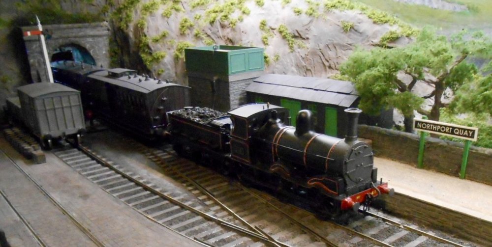

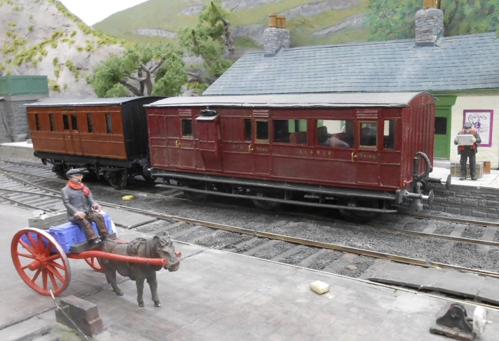

Popular Post David Holman Posted November 11, 2024 Author Popular Post Posted November 11, 2024 Here's a few... ... the glories of pre-grouping - including a certain WL&WR loco by the amazing Richard Chown. 17 1 3 Quote

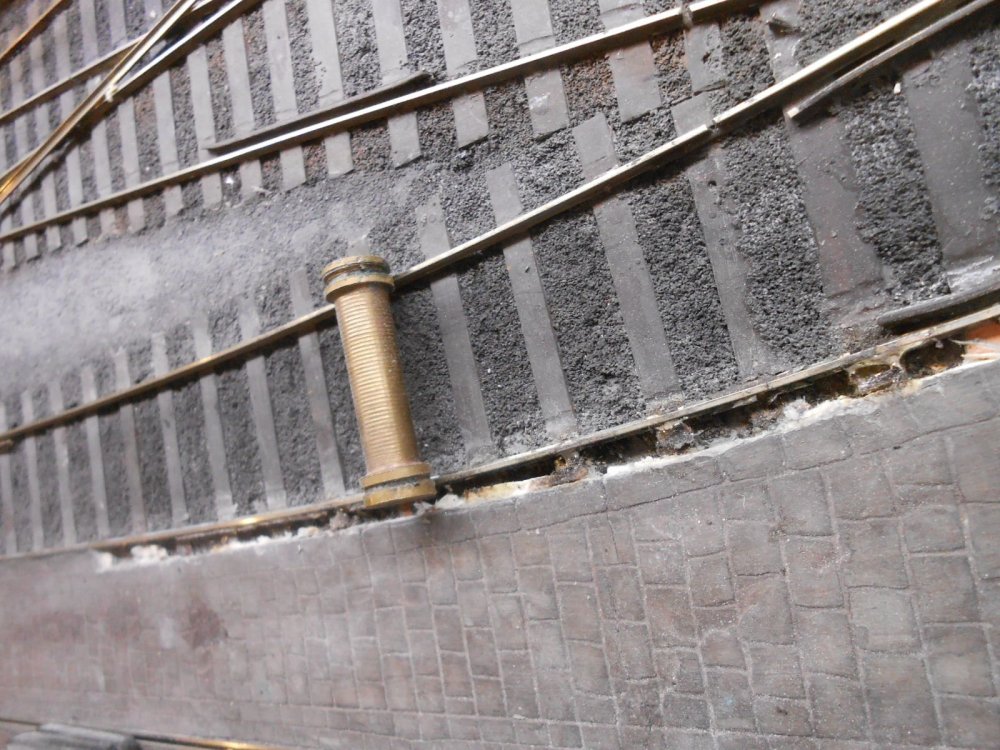

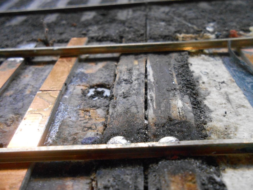

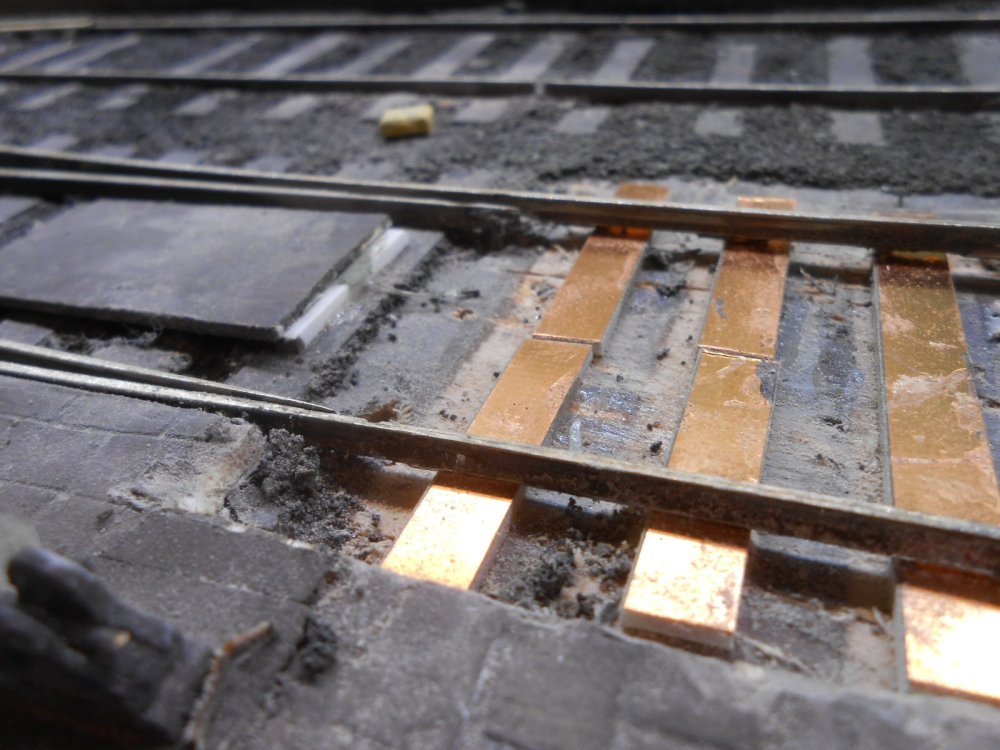

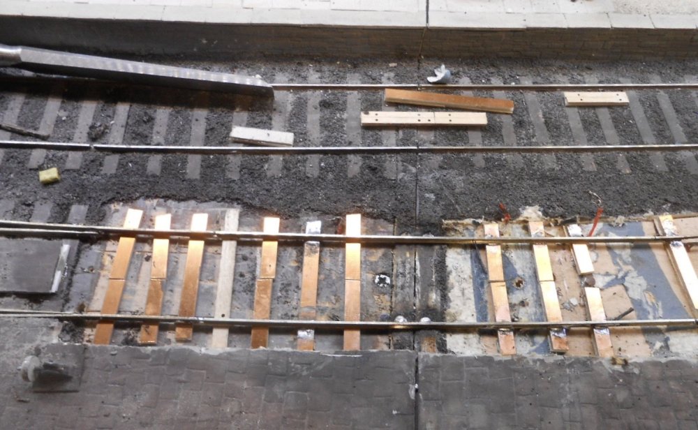

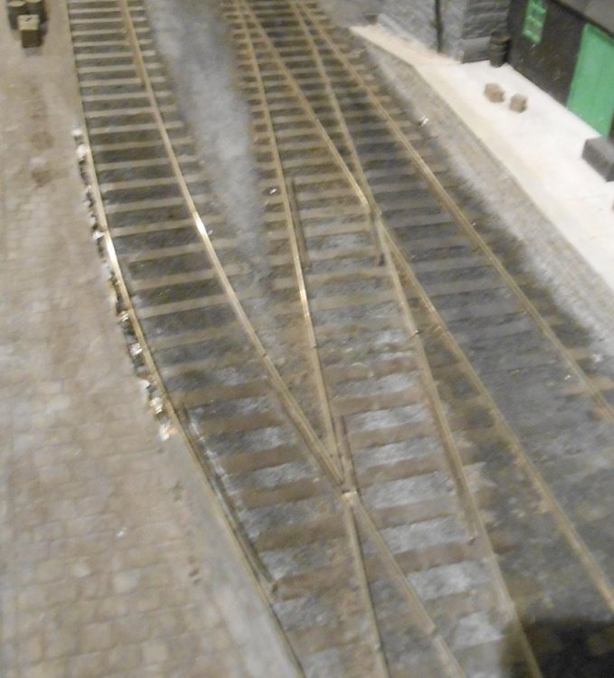

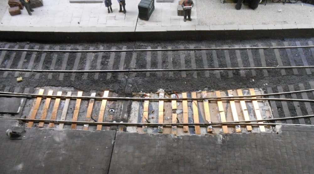

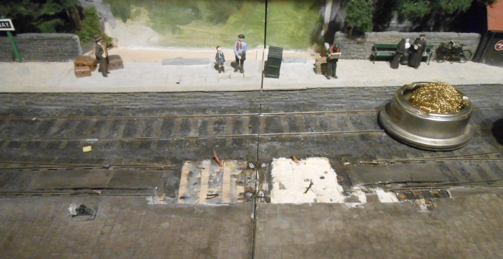

David Holman Posted November 15, 2024 Author Posted November 15, 2024 He did indeed! however, since getting back home, have spent much of the week doing yet another investigation into some on going annoyances. The layout operates at about 90% reliability, but it is the remaining 10% which sticks out like a sore thumb. Most of it stemmed from that ridge that I somehow contrived to create at the baseboard joint in the loop. I first tried adjusting the track and a bit of judicious gauge widening seemed to be doing the trick, but putting a 30cm steel rule across the join gave at least a 3mm seesaw at each end. Really NOT good... The only option was to first remove the rails between the two points and then dig out the sleepers and ballast, back down to baseboard level. However, the problem extends further than I thought & I ended up having to remove half the sleepers from both points either side before I could get the rails level across the baseboard join. There are four, countersunk screws, to which the rails are soldered at the join & then new sleepers were fitted beneath them, packing to the right height and constantly checking for being level with a steel rule. After that, it was out with the track gauges and, eventually, I can now run my locos through the loop without derailing - at pretty much full speed too!. The AJ couplings seem to work a lot better, so hopefully I can now put the ballast and other ground cover back and enjoy running trains. Alignment of the left hand siding left something to be desired, with a serious dog leg causing the loco to uncouple. Sorting this involved a bit more digging, but far less drastic than with the ridge. Am really hoping that I have at last cured the problems, because it has been a pain in the primary orifice at times. A clear fault is one thing, but an intermittent one can be SO frustrating! Talking at length with Andy Cundick [whose knowledge is simply encyclopaedic] over the weekend, he said he thought that Worsley Works, not only produced the Swilly Barclay 4-6-0T, but also the Kerr Stuart 4-6-2T as well. Couldn't find anything on the website, but a quick email to Allen Doherty not only revealed that it was indeed part of his portfolio, but could do one for me, chassis included, for just £100. Having expected to scratch build one, this comes as a very nice bonus, so many thanks Andy and indeed Allen! 14 Quote
Mol_PMB Posted November 15, 2024 Posted November 15, 2024 Excellent work - it's always frustrating to pull apart things that were 'finished' but I'm sure it will be worth it for the improved reliability. 1 1 Quote
Galteemore Posted November 16, 2024 Posted November 16, 2024 Must have been heartbreaking to rip up all that work, David, but will hopefully pay dividends. Great news about the Swilly tank: anything that saves time drilling and cutting is great news. 3 1 Quote
David Holman Posted November 17, 2024 Author Posted November 17, 2024 Hindsight is a wonderful thing. A year ago, on the previous page, I dug up the platform line because of a similar problem. At the time felt the loop would be okay... 1 Quote
