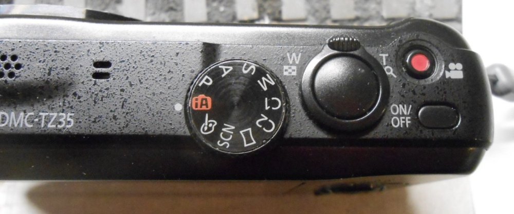

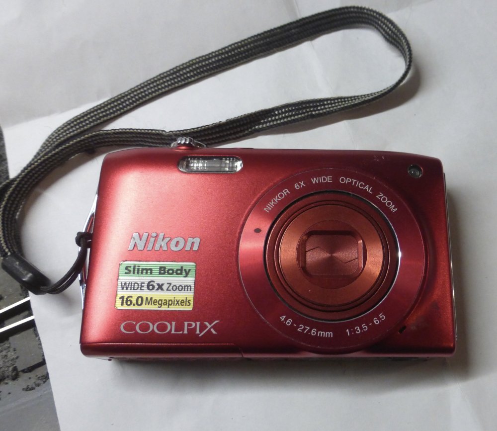

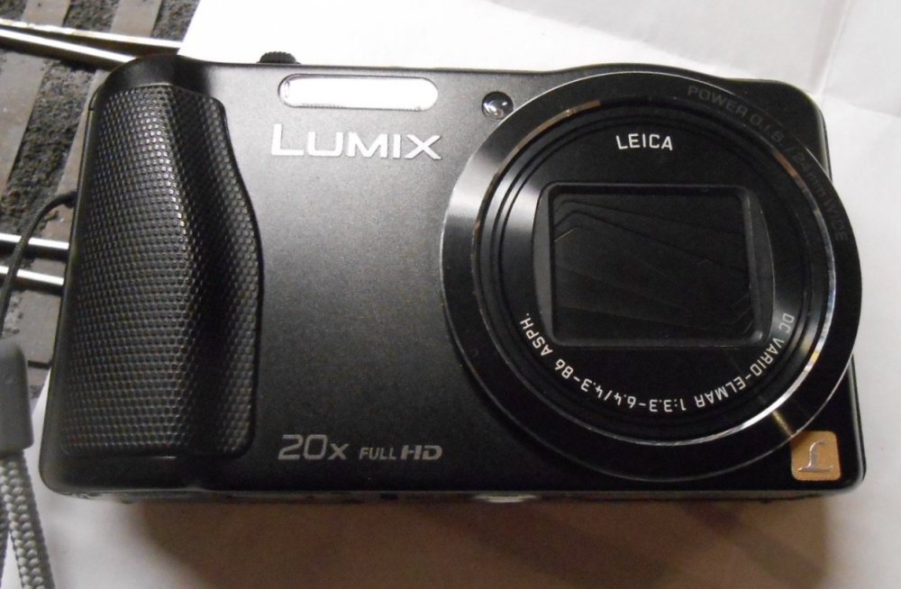

David Holman Posted February 13, 2022 Posted February 13, 2022 Not bad at all, JB! However... Below are two of my three cameras. The Coolpix is what I use for general 'proof reading' photos of models and for this forum, where minimising the megapixels makes for easier uploading. Equally, with a 6x zoom and 16megapixels, it dwarfs my first digital camera for little cost. Pretty much automatic though, so for more detail work [and holiday snaps], I use the Panasonic Lumix. 20x zoom and 15 megapixels, it still fits in the palm of your hand - unlike my beloved Canon SLR 'film' camera which sadly lies unused in the drawer. Note the magic word 'Leica' on the Lumix though - a proper piece of glass for the lens. Do mobile phones have such things? The third picture is of the control on the Lumix - a dial which allows you to stick with the all too good automatic settings, or be more creative by varying aperture and speed settings. An SLR it ain't, but am almost ashamed to say it will nevertheless do pretty much all I ask of it, though it did cost me £200. One more thought - given that a one megapixel photo will still look ok blown up to A4, you have to wonder about the other 15 million AND how on earth do they fit them all [and hundreds more] on a memory card little bigger than a postage stamp? Amazing.... 3 Quote
