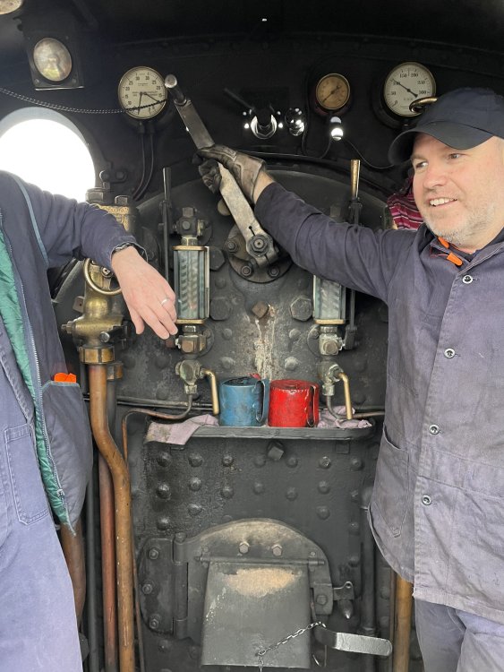

I'm still trying to work out whether the two items in the centre of the picture are oil cans, teapots or mugs.
  • Funny 1
That depends on whether you enjoy drinking oil or applying it as a lubricant ;) Loco tea mugs tend to be white enamel. The colours may denote different grades of oil. For certain high temp applications, for instance, you need to use heavy grade steam oil which won’t separate under heat. A memory from my days in 16mm live steam when we used heavy oil for cylinder lubing and light oil for bearings.

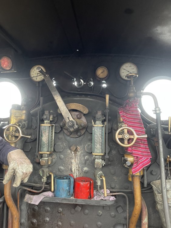

That little backhead needs some asbestos tape secured over the piping from that right hand injector not a piece of old rag!
  • Agree 1

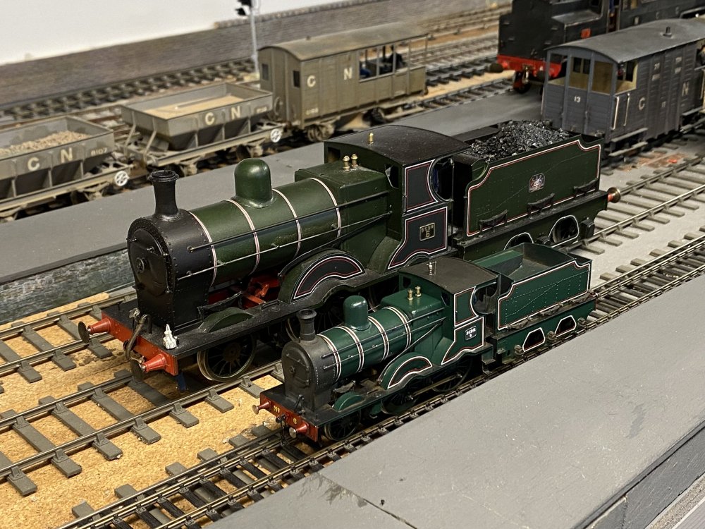

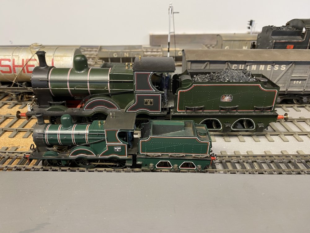

The long and the short of it. One of the inspirations for the building of No.6 in 4mm and a source of many clues and references was this 7mm version built by Tony Ragg using the Alphagraphix kit as the basis. Contrasting interpretations of BCDR green!
  • Like 7
  • WOW! 6
One (fairly) straightforward Alphagraphix kit v a total scratchbuild. Fine work by Tony, but no contest in the difficulty stakes, methinks. As for colour, one is clean and ex works, the other has been cleaned with the proverbial oily rag, but both look stunning.
  • Agree 1

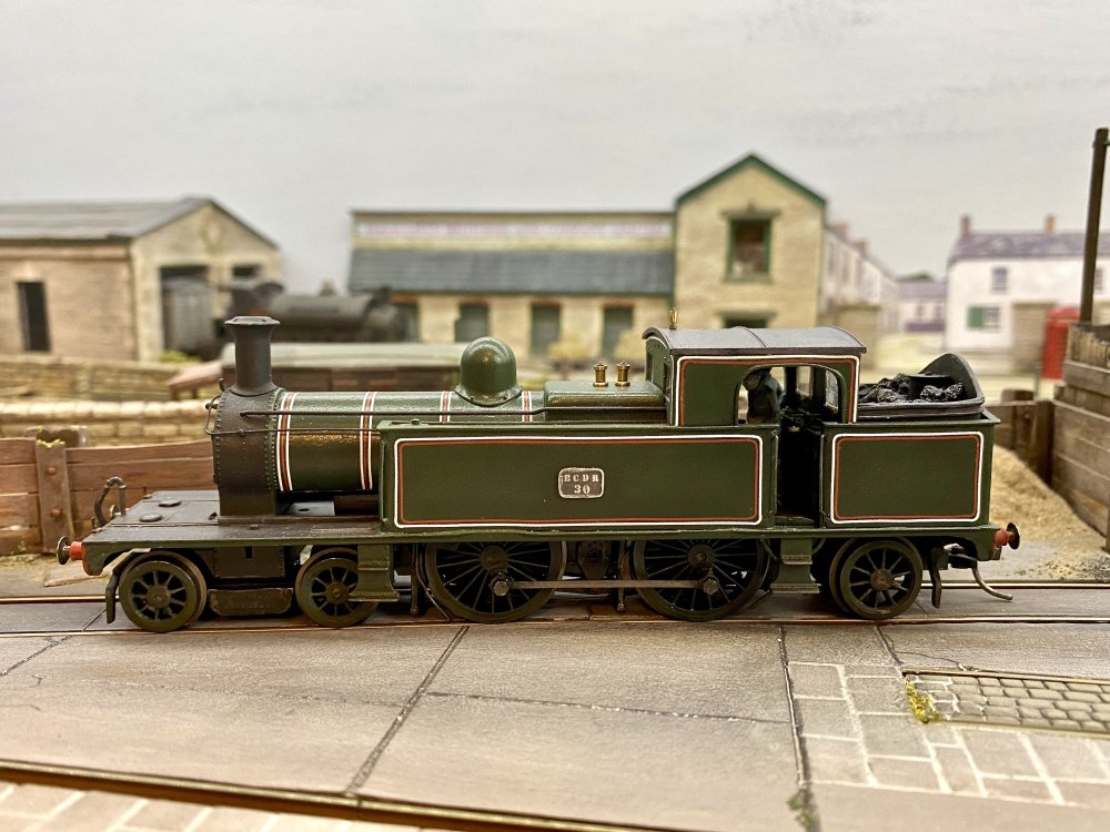

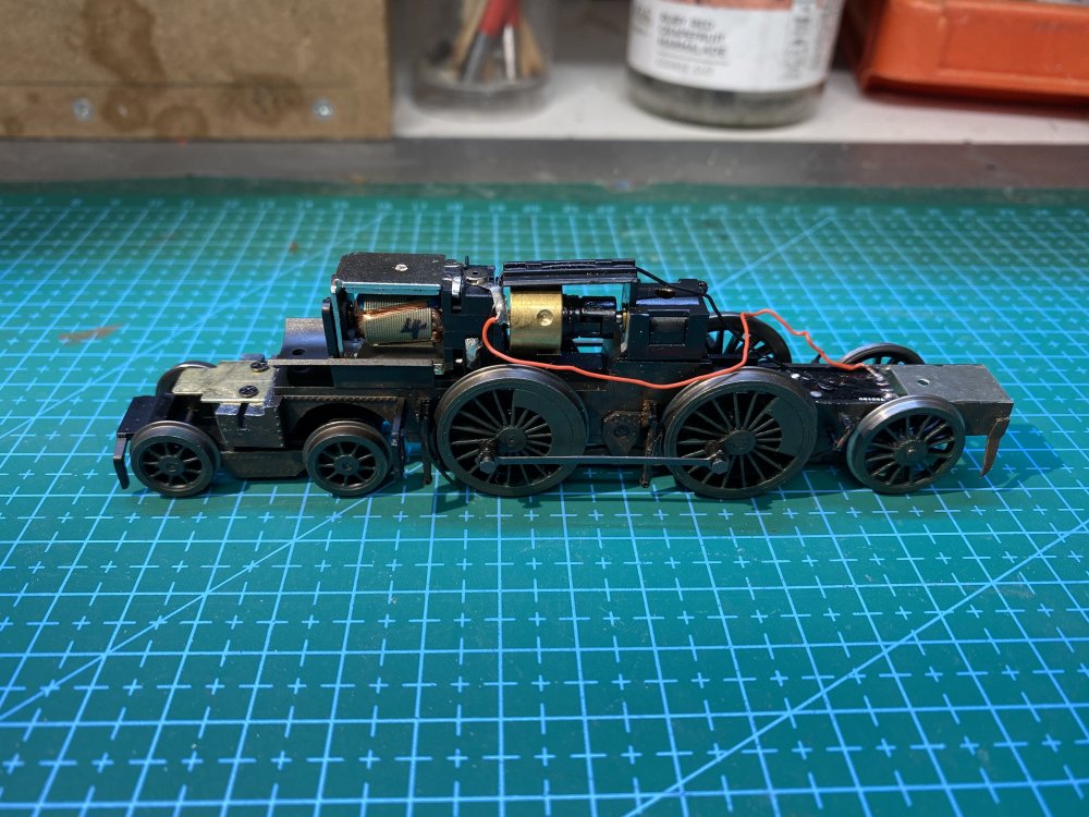

Something slightly different. My first attempt at a Belfast and County Down locomotive a few years back was a model of 4-4-2T bogie tank No. 30 (the one preserved at Cultra) using an Oxford Rail Adams Radial as the basis. Apart from removing the outside cylinders, the chassis was left as was.  The superstructure was remodelled in plasticard. I was reasonably happy with it and it's a nice runner but in truth it strains the limits of the 2 foot rule.  The proportions aren’t right.
At the time I bought a second Adams Radial with the intention of doing another one and it’s lain in a drawer until now. Time to have another go.

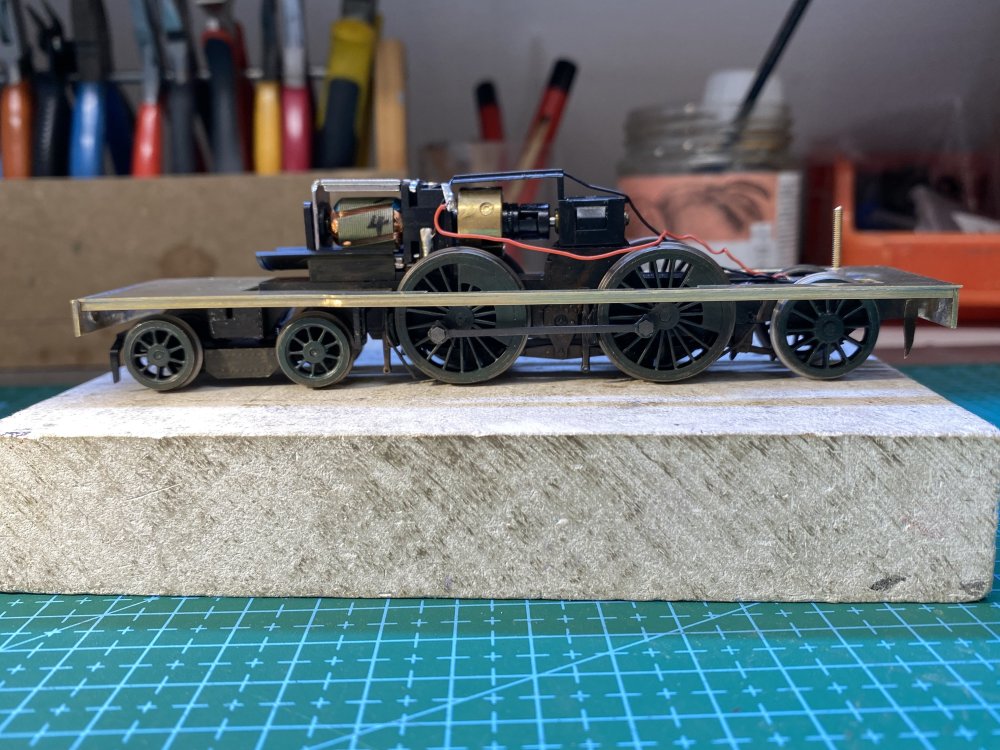

Comparing the Adams chassis with a BCDR bogie tank, we can say that:
  • the driving wheel diameter and wheelbase are fairly close. Best left alone. May as well scratch-build a new chassis as tackle that, which defeats the object of this exercise.
  • the leading bogie is too long and its leading axle too far ahead of the leading drivers.
  • the trailing truck is too far behind the rear drivers and the wheels are too small.
These things ought to be remediable.

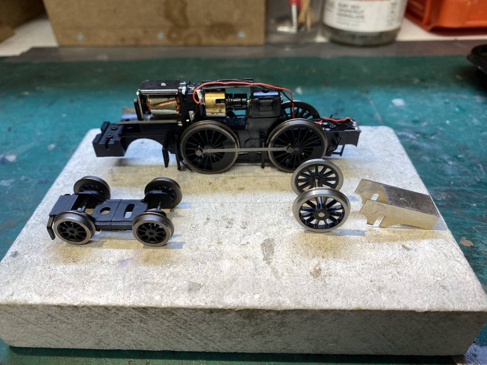

Starting with the front bogie, it was cut in two across the middle, 2 mm removed from the centre and the two halves glued back together. Being plastic, it was fairly easy to do. The front of the chassis block needed cut back to allow clearance for the front bogie axle.
The rear of the chassis block was cut off and discarded about 10mm aft of the rear drivers and replaced with a new section made up in nickel silver to bring the axle line forward. This is glued and pinned to the chassis block. The Oxford bogie wheels were replaced with larger 17mm 12 spoke wheels (Alan Gibson 4851). The new axle is sprung with 0.33mm brass wire.
Sawing through the chassis block destroyed the printed circuitry attached to it so the chassis is no longer ‘DCC ready’ but that’s not the end of the world.
The intention is to discard the Adams bodywork and scratch-build a body in brass & nickel silver. A running plate in 16 thou brass with valances made from 1.5mm square brass rod is as far as I’ve got.

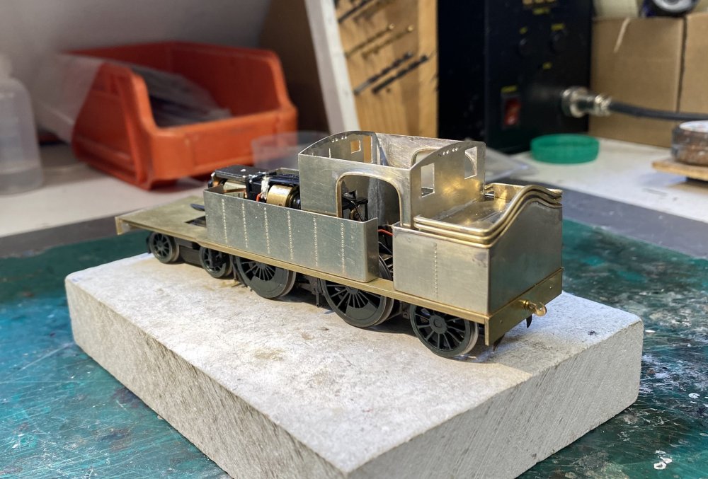

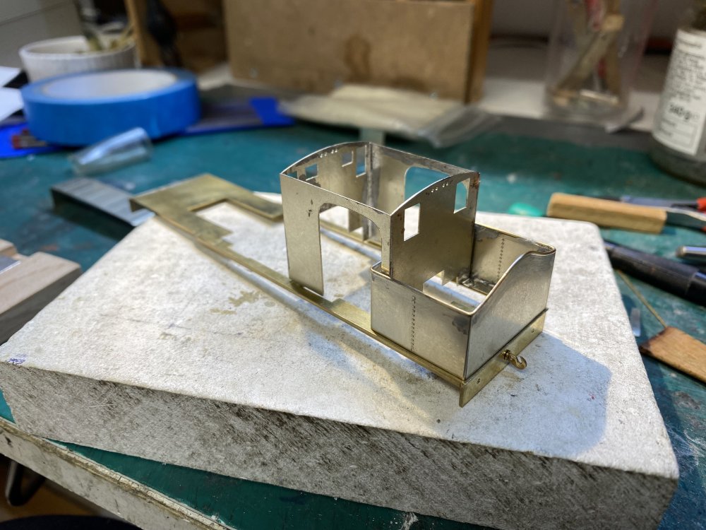

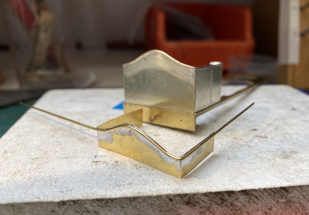

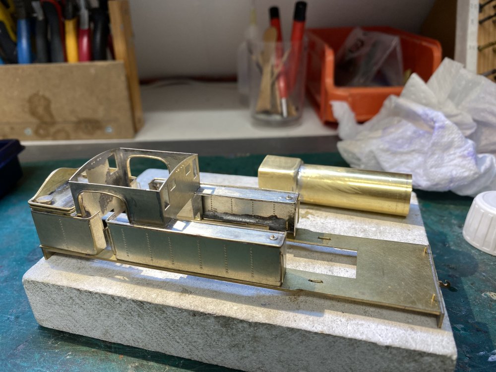

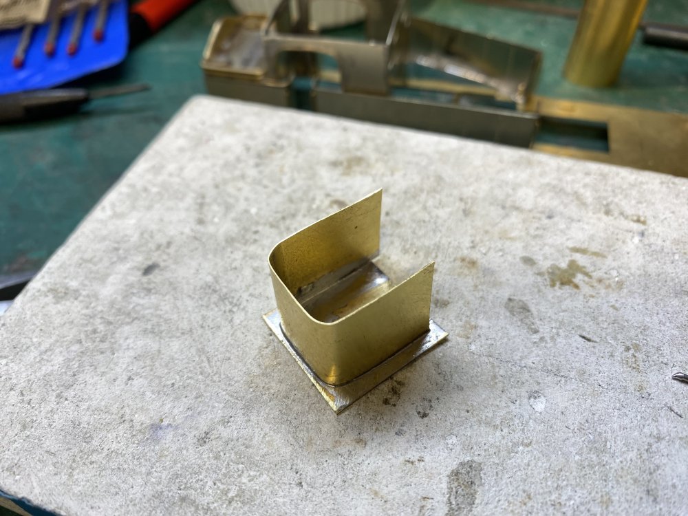

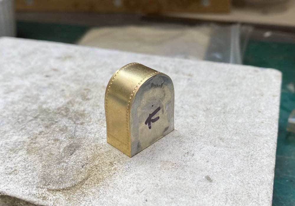

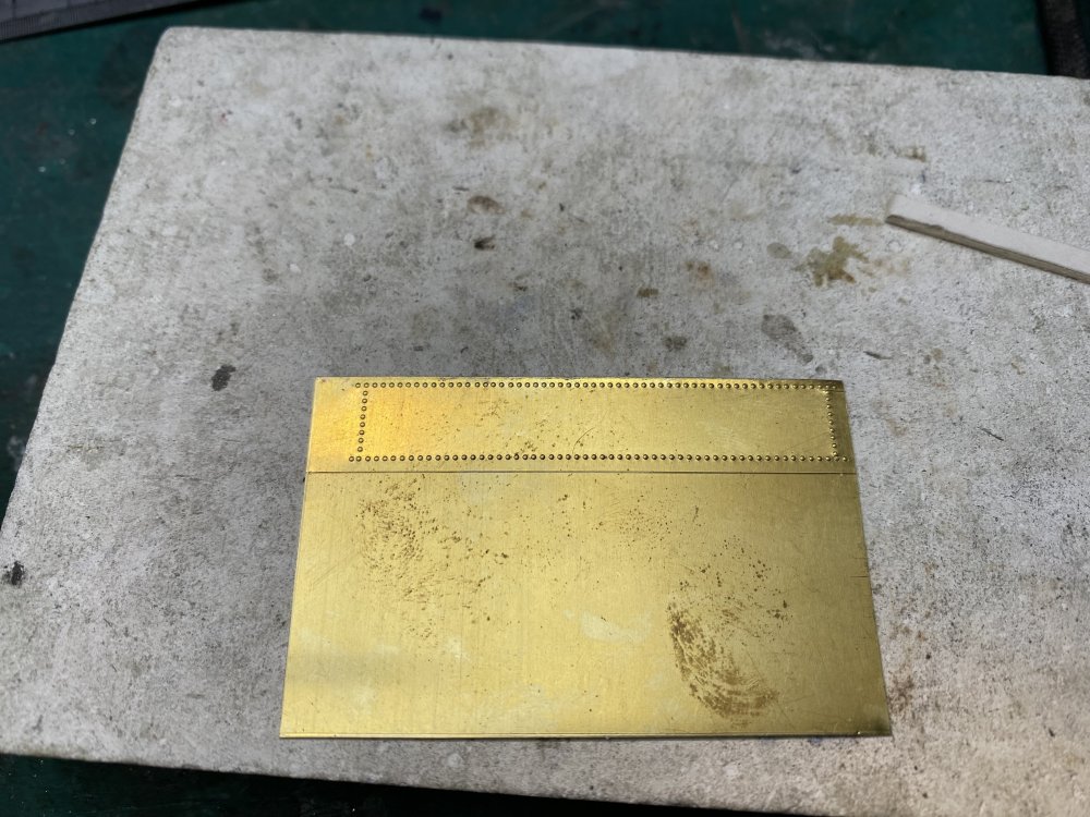

Some progress on the superstructure for the BCDR bogie tank. I'm using 15 thou nickel silver in preference to brass for most of it. Here's the cab flatpack - fairly simple shapes but the cutting and filing takes ages and soldering them together is always entertaining.
The beginnings of tanks and bunker. Some of the rivets have been embossed but I shied away from embossing rivet lines close to edges for fear of the metal distorting. I'll use resin transfers for these.
The curved back sheet on the bunker made attaching the beading (0.7mm brass rod) tricky. Plenty of toasted fingertips.
Matching the curve with the coal rails (0.9mm brass rod) was even more of a challenge.

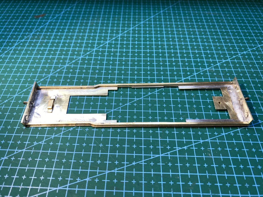

The rtr Adams Radial chassis takes up a lot of space and large sections of the running plate had to be cut away to clear it, so anchor points for the superstructure were hard to arrange. Got there in the end. There are 2 captive nuts in the floor at the back of the tender, and each tank has one at each end. (12BA, I've given up on 14BA. I can't see them any more) The bunker and cab are soldered together and when the tank tops are in, the tanks can also be soldered to the cab making one strong unit.
Edited by Tullygrainey
typo
  • Like 11

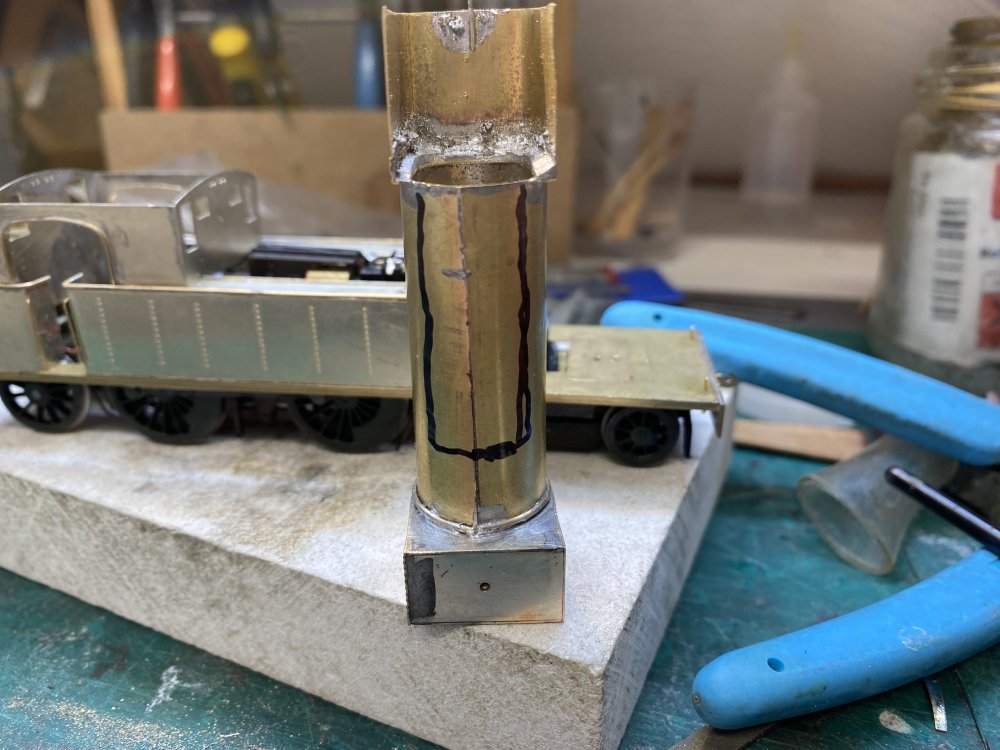

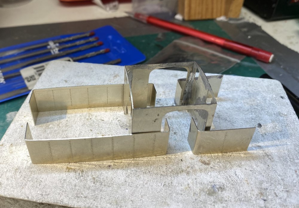

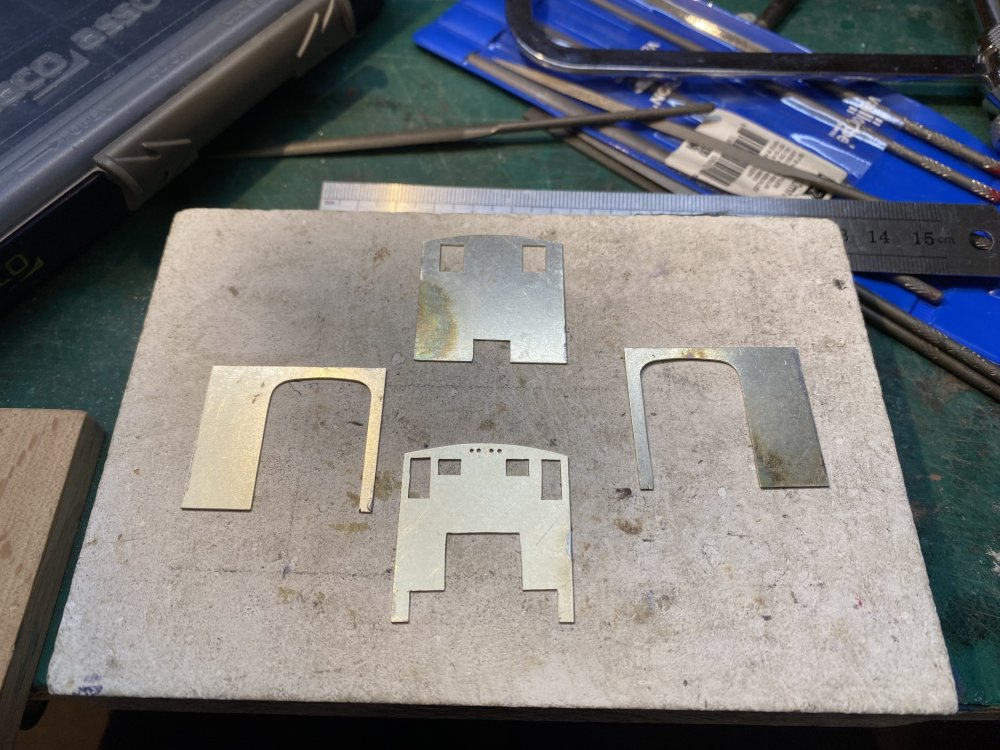

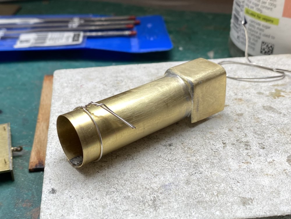

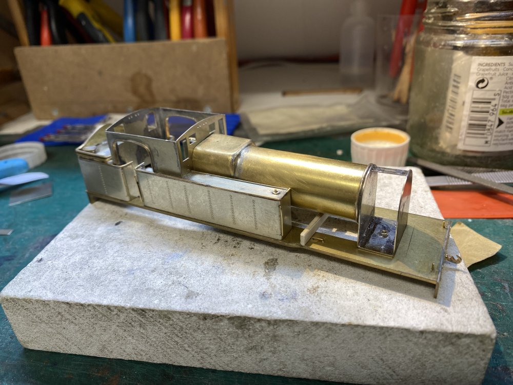

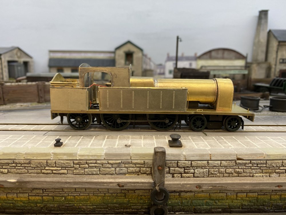

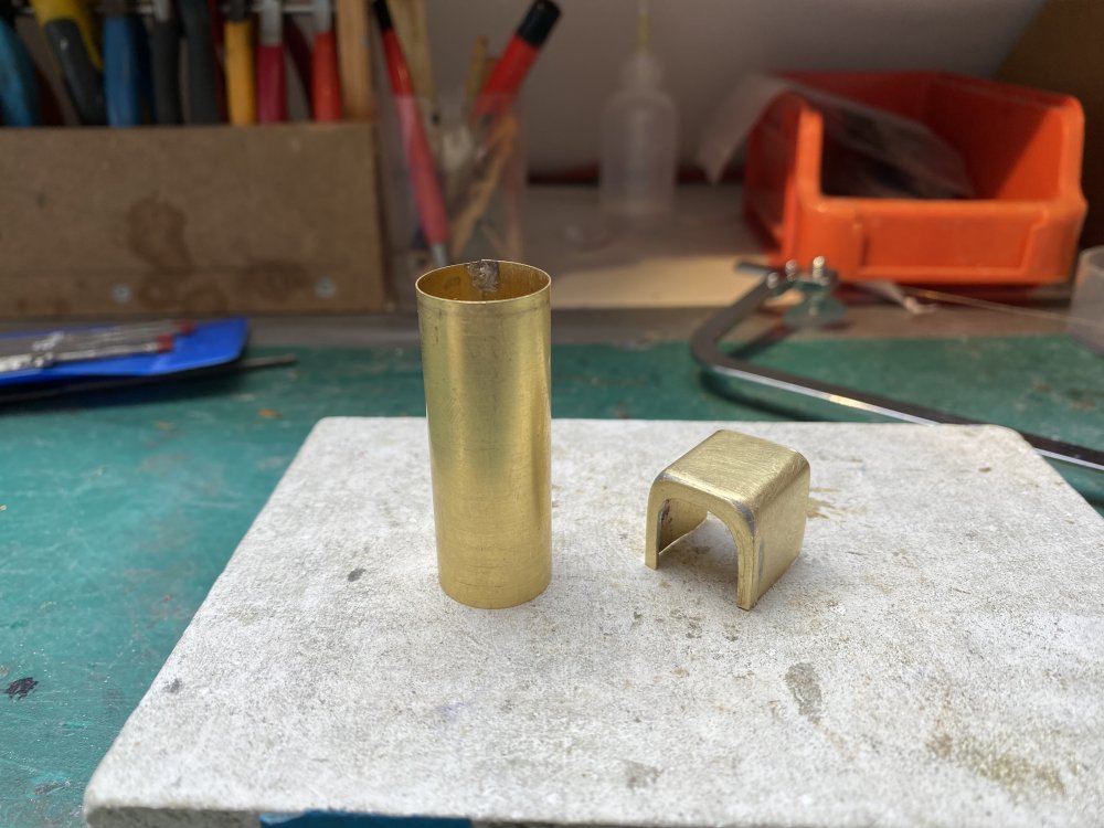

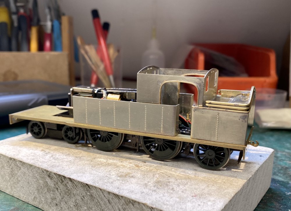

Still making progress despite the usual scratch-building shenanigans  - boiler too long, then boiler set too high, then lowered boiler fouling wheels. Among other things.
I rolled the boiler (10 thou brass) before adding the tank tops so I knew how much space would be needed between them. Having the boiler also allowed me to get the firebox (more 10 thou brass) the right width to match. This has plumber's solder puddled inside the joint to give some meat for filing its curves.
Tank tops, fitted and soldered to the cab front.  0.45mm and 0.7mm brass rod for the beading.
Smokebox saddle is 15 thou nickel silver with a captive nut in its baseplate. Smokebox wrapper is 10 thou brass.
The boiler had to have a very large hole hacked in it to clear the rtr chassis, even bigger than this in the end.
Beginning to look like a locomotive at last. The chassis will need some TLC. It's full of brass filings 😱

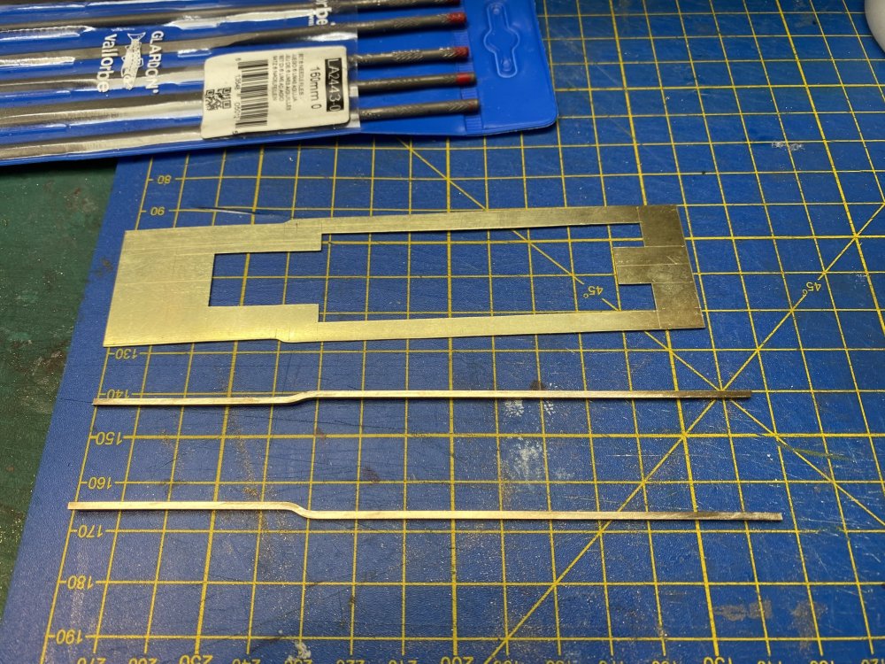

18 minutes ago, Galteemore said:
Looking fab Alan. Sorry to go back again, but how did you cut out the footplate aperture so neatly? David
Thanks David. After marking it out, I drill a few strategic holes and roughly cut out the unwanted bits with a piercing saw, a little way inside the lines. Then I file the edges back to the lines. This is where those Valorbe Swiss files earn their keep!
