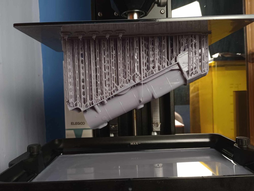

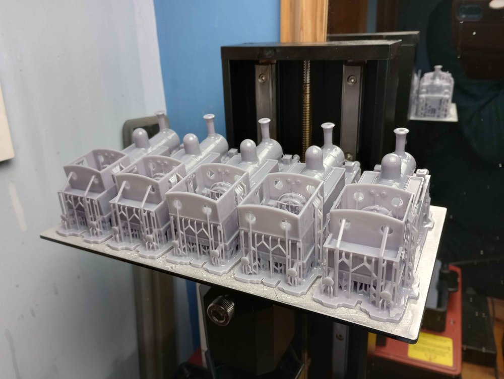

Killian Keane Posted March 9 Author Posted March 9 Latest 800 off the printer, Ive done more of them than Inchicore now 7 6 1
Horsetan Posted March 9 Posted March 9 One thing I forgot to ask about 3D printing generally: what happens to all the leftover waste sprue? Can it be recycled?
Killian Keane Posted March 9 Author Posted March 9 11 minutes ago, Horsetan said: One thing I forgot to ask about 3D printing generally: what happens to all the leftover waste sprue? Can it be recycled? Unfortunately no it cant be reused in resin printing, it gets thrown out
Horsetan Posted March 9 Posted March 9 1 minute ago, Killian Keane said: Unfortunately no it cant be reused in resin printing, it gets thrown out Ah. Shame.
GSR 800 Posted March 9 Posted March 9 1 hour ago, Killian Keane said: Latest 800 off the printer, Ive done more of them than Inchicore now Deirdre or Grainne? 1
Rob R Posted March 9 Posted March 9 Think of it more like the chippings that a sculptor chisels off a block of stone to produce a work of art. There is not much you can do with the little bit of waste you get from FDM printing, but at least the PLA filament I am using for the track bases is plant based so we rest easy there 1

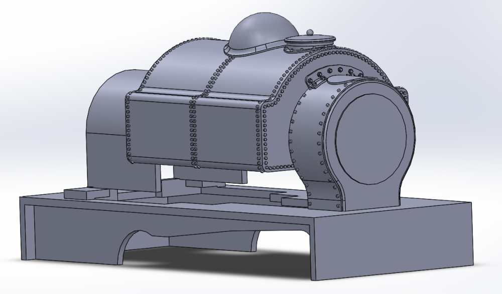

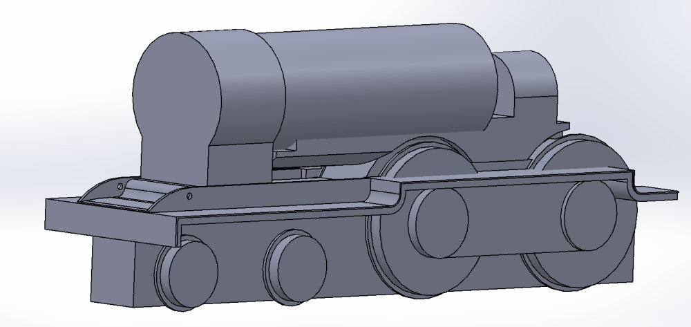

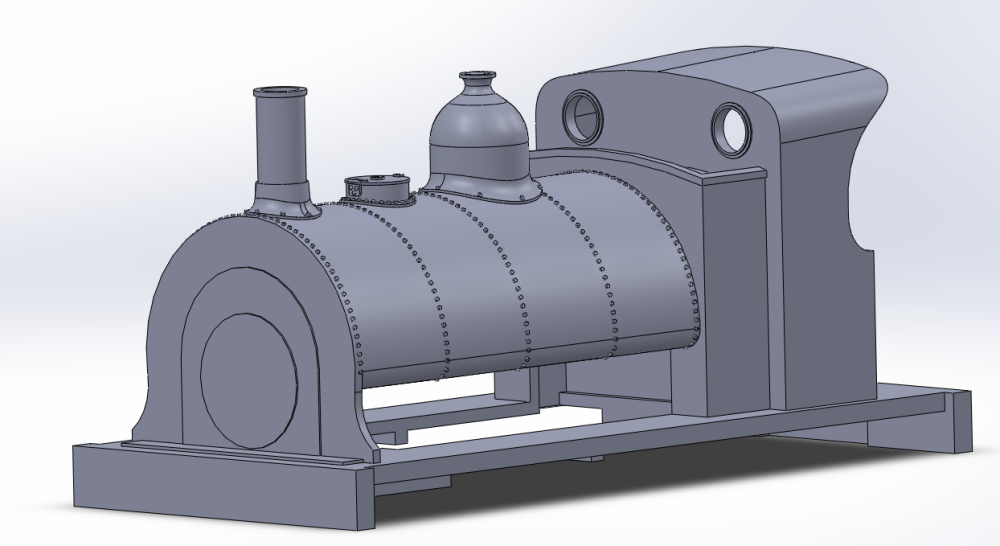

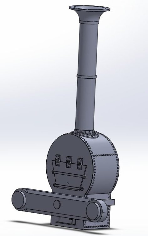

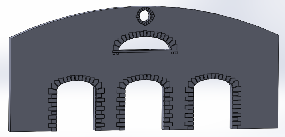

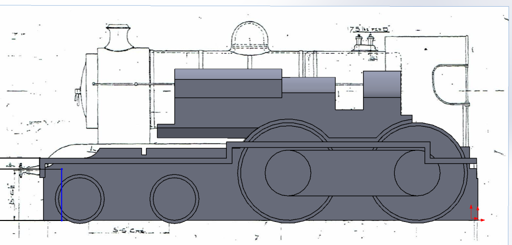

Killian Keane Posted March 13 Author Posted March 13 (edited) Latest musings on Limerick works.. Edited March 14 by Killian Keane 7

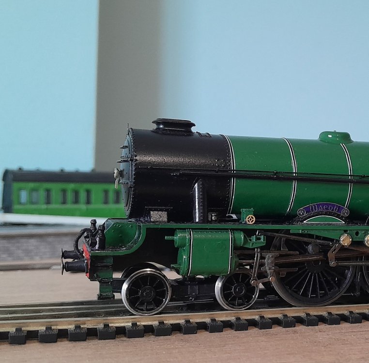

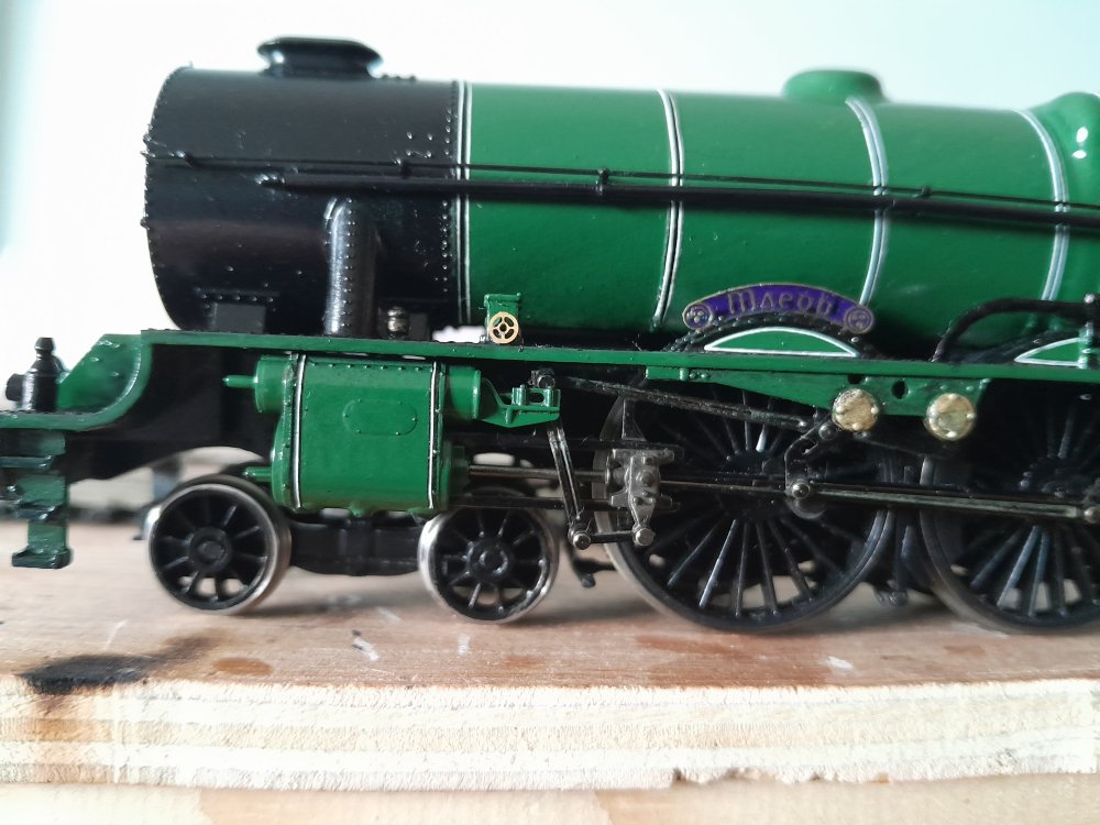

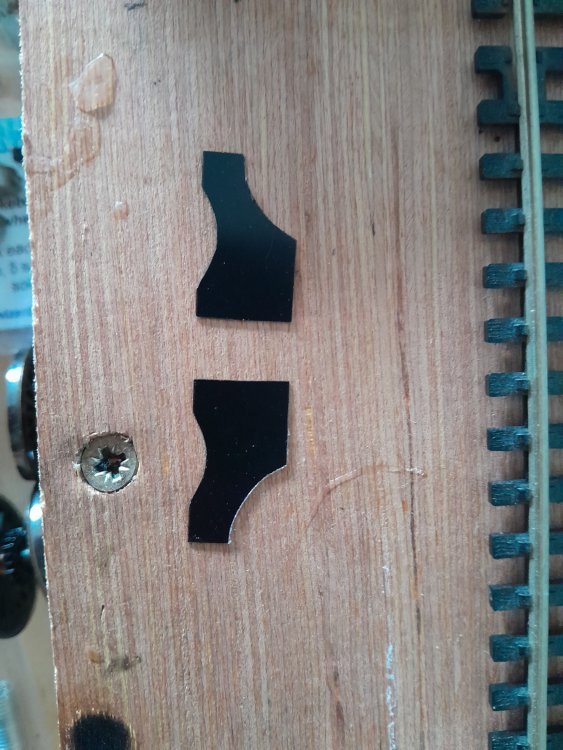

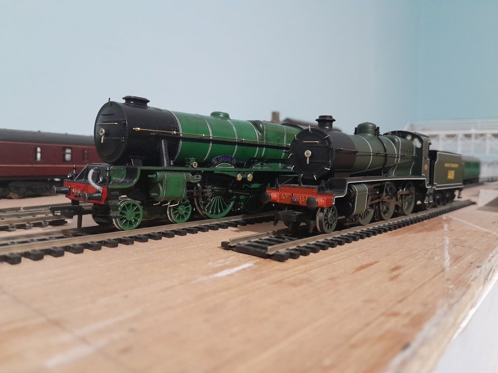

GSR 800 Posted April 4 Posted April 4 A bit of work done to Maedbh over the last week or so. The Royal Scot has many similarities to the 800s, but the 800s have a much longer front end and bogie, along with smaller bogie wheels. Changing to smaller wheels meant a large air space was left between the wheel and chassis. This became a bit of a knawling bug for me To sort the issue, I fabricated some fau frames from plasticard, painted them black, then applied them to the sides I then karate chopped the bogie and placed a plasticard spacer to increase its length. I think this improves the overall appearance of the front end considerably. 12 2 1

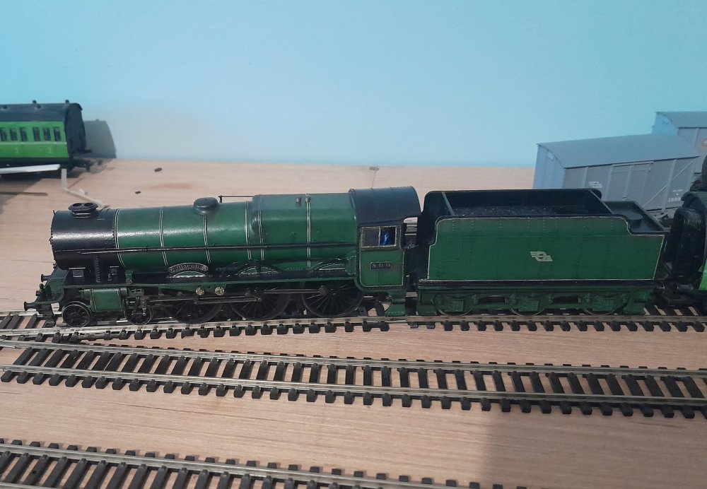

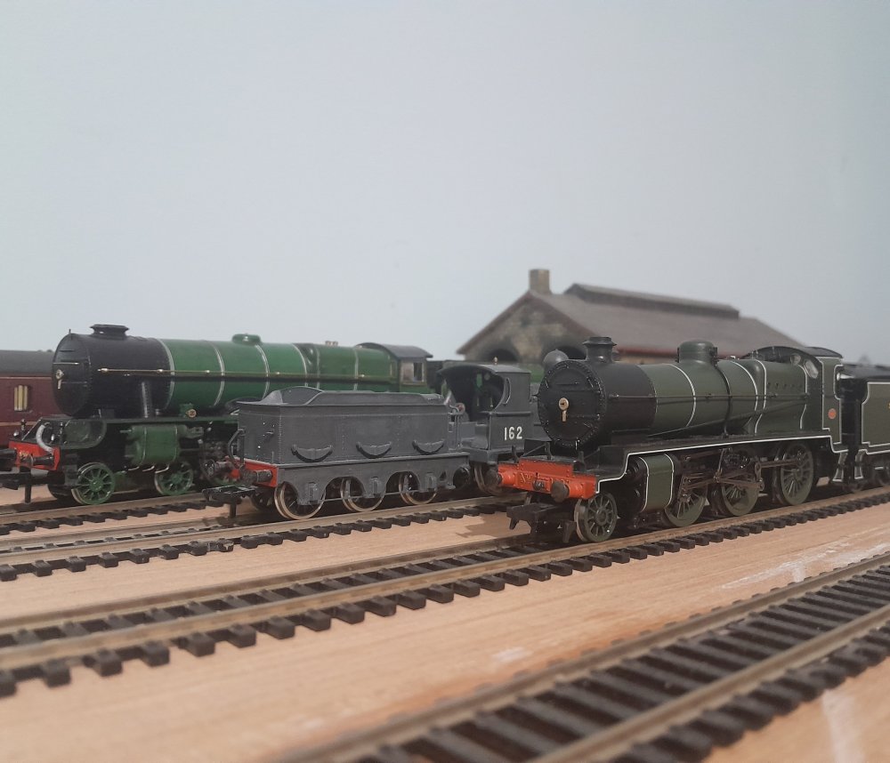

GSR 800 Posted April 22 Posted April 22 (edited) Maedbh has gotten a bit of weathering. There's not a great many photos of Maedbh in colour during her working life in CIE. The vast majority I've seen are taken after she was earmarked for preservation and received a fresh coat of paint. It's unlikely she did almost any work after 1958. There's two colour photos of her at work in later years. One is of her at Limerick Junction in 1955, the other at Thurles hauling a train of horsebox vans. These show her relatively clean but with some black grime in certain areas. In their earlier years they were kept almost spotlessly clean, but I intend to model the end of steam. Macha was utterly filthy toward the end. For reference I also looked primarily at the VS class in the 60s. Still kept quite clean, but far from spotless. The domes and corners of the belpaire firebox were almost always blackened! A mix of black and umber wash was used, with excess removed using a cotton bud. Edited April 22 by GSR 800 13 4
Galteemore Posted April 22 Posted April 22 (edited) Terrific job. Subtle but effective. For a lot of my own work now all I do is a MiG dark wash with a few powders. Seems to do just enough. Might you consider a soupçon of dark powder on the smokebox? Edited April 22 by Galteemore 2 2
GSR 800 Posted April 22 Posted April 22 20 minutes ago, Galteemore said: Terrific job. Subtle but effective. For a lot of my own work now all I do is a MiG dark wash with a few powders. Seems to do just enough. Might you consider a soupçon of dark powder on the smokebox? Many thanks. Funny enough for Macha's last tour they had the smokebox shining! It has a bit of grime on top nonetheless, don't wish to overdo it. 1
Galteemore Posted April 22 Posted April 22 Fair enough Harry. Have had a similar inner monologue myself when finishing the PP last week. Some pics show a gleaming smokebox, others don’t! You can certainly take pride in her 1 1
GSR 800 Posted April 22 Posted April 22 (edited) 22 minutes ago, Galteemore said: Fair enough Harry. Have had a similar inner monologue myself when finishing the PP last week. Some pics show a gleaming smokebox, others don’t! You can certainly take pride in her It's one of those things I consider myself, whether to go matt or more satin for the smokebox. Usually it's more matted than the rest, but locos being cleaned, especially with oily rags, would show some shine. I've given a bit of matting at the top for soot around the chimney. Recently I've seen a br shed layout with locomotives kept glossy clean, but with smokeboxes matted and almost grey! I note modern cleaning practices at Connolly, which focus on keeping the "front" of the locomotive/railcar clean. The rest is less of a concern! Edited April 22 by GSR 800
David Holman Posted April 23 Posted April 23 Apparently clean front ends is a bit of a health and safety thing, especially in BR days when the yellow ends were meant to be clean(er) to improve their visibility. 1
Killian Keane Posted April 23 Author Posted April 23 Thats some extraordinary weathering, very realistic, one of the nicest builds Ive ever seen done from a print of mine! 2 1

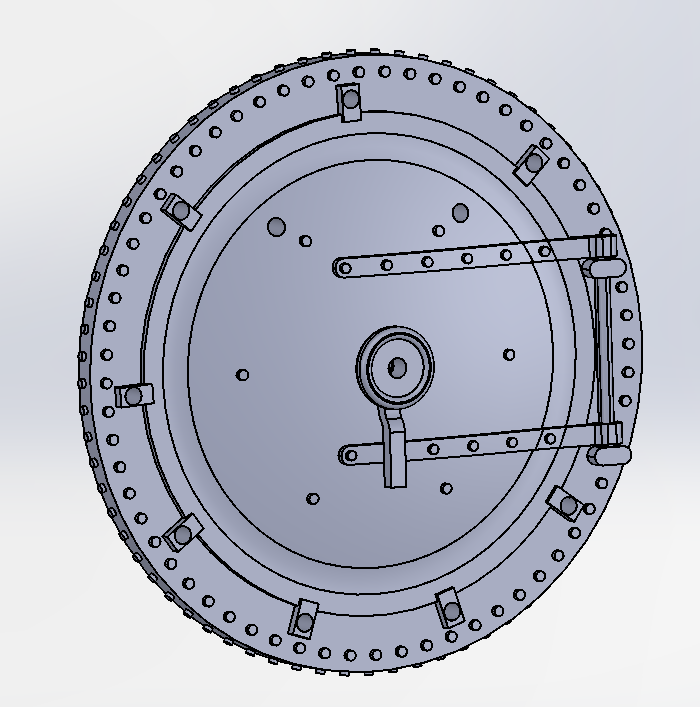

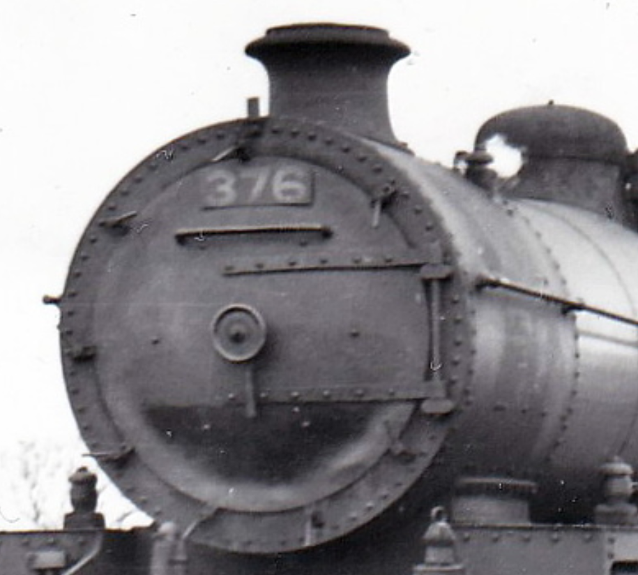

Killian Keane Posted June 29 Author Posted June 29 Latest 3d printed item consists of a replacement smokebox door for the Bachmann N class that's more representative of what they had in Ireland, again with gratefully received help from @GSR 800 6

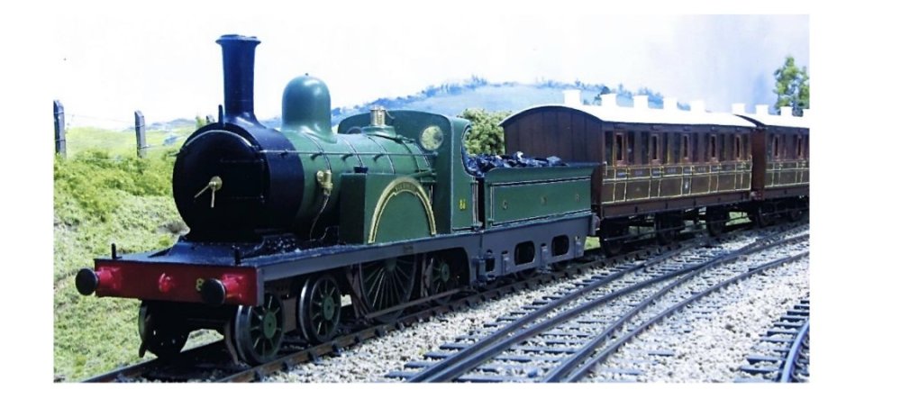

GSR 800 Posted June 29 Posted June 29 (edited) 13 minutes ago, Killian Keane said: Ive legitimately had a request for Dublin and Kingstown coaches recently so that shows you the mental space Im in lol It is truly fascinating that many of our generation of modellers have turned toward a much earlier period to model after. In many ways it makes sense, locomotives and rolling stock are smaller, making layout building somewhat more manageable. Many very obscure prototypes with all the elegance of victorian and edwardian design, and in some cases absolutely no elegance whatsoever! I must confess I'm very partial indeed to the GNR Park J class 4-4-0s and JS singles of 1885, some of the most handsome locomotives to have ever run in this country. Edited June 29 by GSR 800 3 2 1
Galteemore Posted June 29 Posted June 29 Phil Aspinwall made a JS. I have a J part built - rolling chassis. Even compared to a PP it’s tiny!! 3
jhb171achill Posted June 29 Posted June 29 We’ve an 0 gauge model of one in Malahide in the Fry museum. You’re welcome to come and examine it. 1
Westcorkrailway Posted June 29 Posted June 29 1 hour ago, GSR 800 said: It is truly fascinating that many of our generation of modellers have turned toward a much earlier period to model after. In many ways it makes sense, locomotives and rolling stock are smaller, making layout building somewhat more manageable. Many very obscure prototypes with all the elegance of victorian and edwardian design, and in some cases absolutely no elegance whatsoever! I must confess I'm very partial indeed to the GNR Park J class 4-4-0s and JS singles of 1885, some of the most handsome locomotives to have ever run in this country. Infairness. Modern stations and stock don’t allow much for variety. For instance how many places had large and interesting layouts for them not to even have a loop in 2025. Equally how many of those places are exclusively served by an ICR and not much else. Even now, the days of 2 car railcar formations is coming to and end in the short/medium term the late 50s-early 60s is the best era. Change my mind
