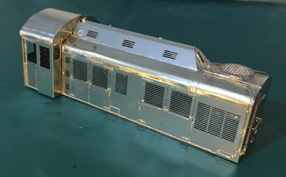

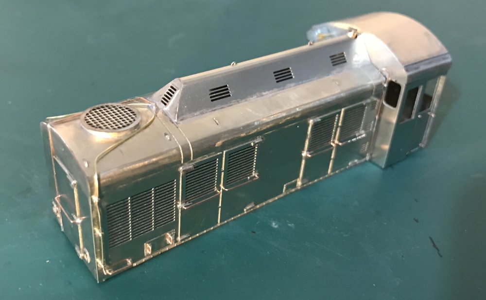

Mol_PMB Posted February 6 Author Posted February 6 Here's the next section of the instructions, as far as I've got in reality! Making an E401 - the bonnet top and exhaust cowl.pdf Busy day at work tomorrow, but I'll try and finish the last two steps of bonnet plumbing after work, and then I'll have some model photos to illustrate those stages too. The next build stage after that is the cab. When I received the etches today, I actually got an etch and a half. It looks like there had been some sort of production problem with the first one and so they had re-run the job. They sent me the duff bit anyway, nicely gift-wrapped! The full etch I received was perfect, but I also have a free spare bonnet etch. So I do have the option to repeat everything I've done so far but with some of the other design options, such as the later grilles and no exhaust cowl. I get the impression a few people might be tempted to build one of these for themselves. Possibly one or two others might like me to build one for them. And there have been noises (OK, whispers) about a 7mm scale option. Early days yet, let me get a complete prototype first. I'm sure we can work something out. I have a full time day job so there are limits to what can be offered. Cheers, Mol 6

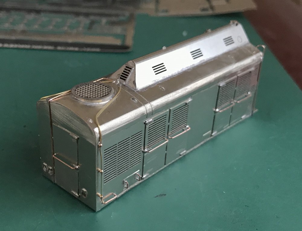

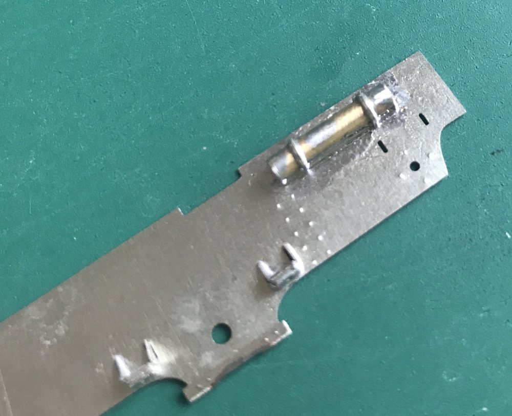

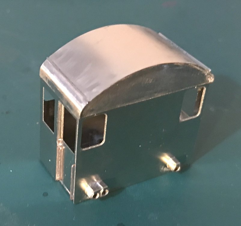

Mol_PMB Posted February 7 Author Posted February 7 Some more progress to report. I have added the plumbing to the bonnet: And I have made a good start on the cab: Next job is the cab headlights. I have also found the first mistake in the etch. Fortunately it's a minor one and easily corrected. 14

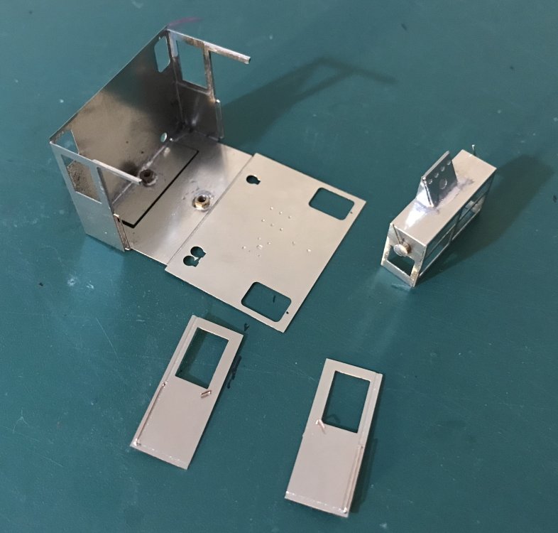

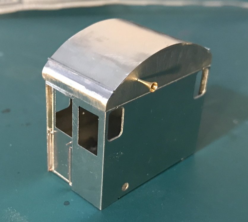

Mol_PMB Posted February 7 Author Posted February 7 I've got the cab assembly virtually completed now, and we can begin to see what the loco's going to look like. The cab headlight parts turned out to fit perfectly and were much easier than I expected. They were a tricky detail to reproduce. Tomorrow, the footplate and frames... 10 6

Mol_PMB Posted February 8 Author Posted February 8 Attached are a completed set of the bonnet top instructions (including the plumbing) and a newly-written set of instructions for the cab. Making an E401 - the bonnet top and exhaust cowl.pdf Making an E401 - the cab.pdf Now I can start work on the footplate and frames. 4

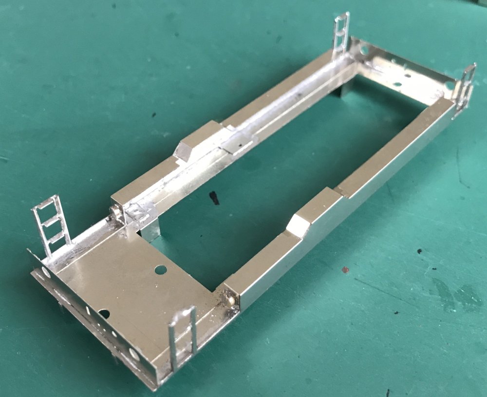

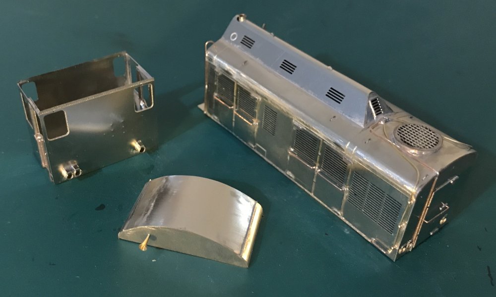

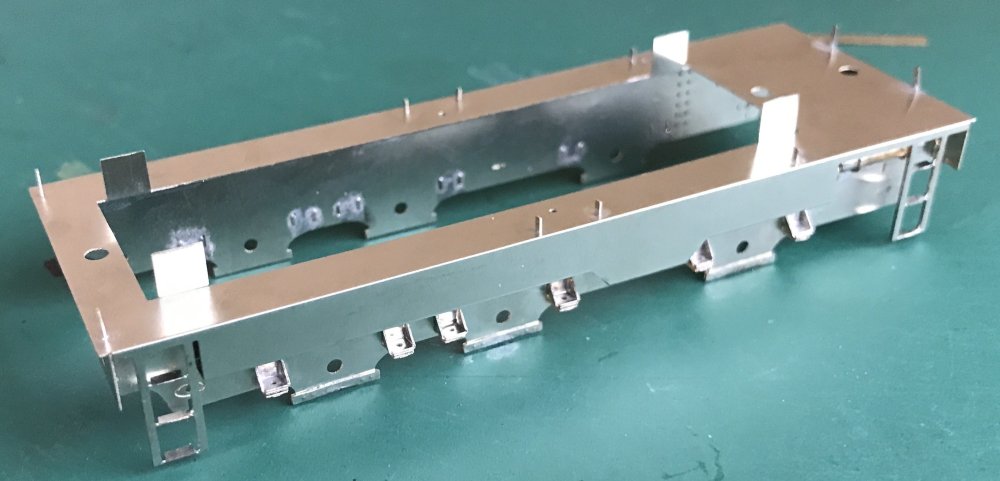

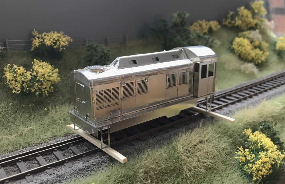

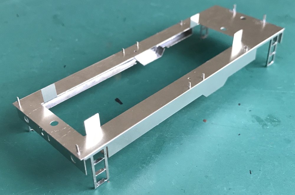

Mol_PMB Posted February 8 Author Posted February 8 This morning I've done most of the footplate and fuel tank subassembly. Quite pleased with how this has worked out, especially the steps. I still need to tackle the cosmetic frames and a few other details, as well as writing the next chapter of the instructions. However, I couldn't resist bolting together the main parts to see how it looks. I'm sure there will be some more fettling needed but this gives the right sort of impression I think. 9 7
Mol_PMB Posted February 8 Author Posted February 8 44 minutes ago, jhb171achill said: Outstandingly good! Many thanks. I have to confess this is going together better than I expected. There are a few minor issues I would change with the benefit of hindsight but nothing major so far. Just waiting on IRM to piss on my chips with an RTR version! Seriously, I don’t think there will ever be a mass market for an E401 but maybe there’s a handful of people on here who might be interested in making one, and I could mention it on RMweb I suppose. Once I’ve finished the body kit I will have to develop the chassis. Several options and that will depend on who is interested and what gauge they are working in. 1

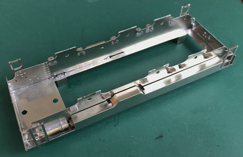

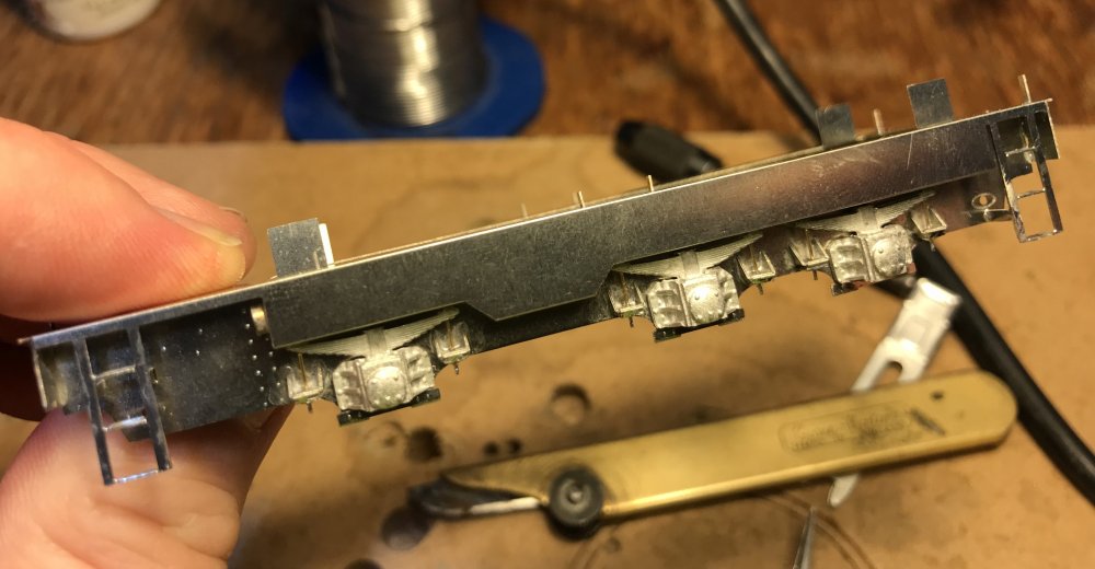

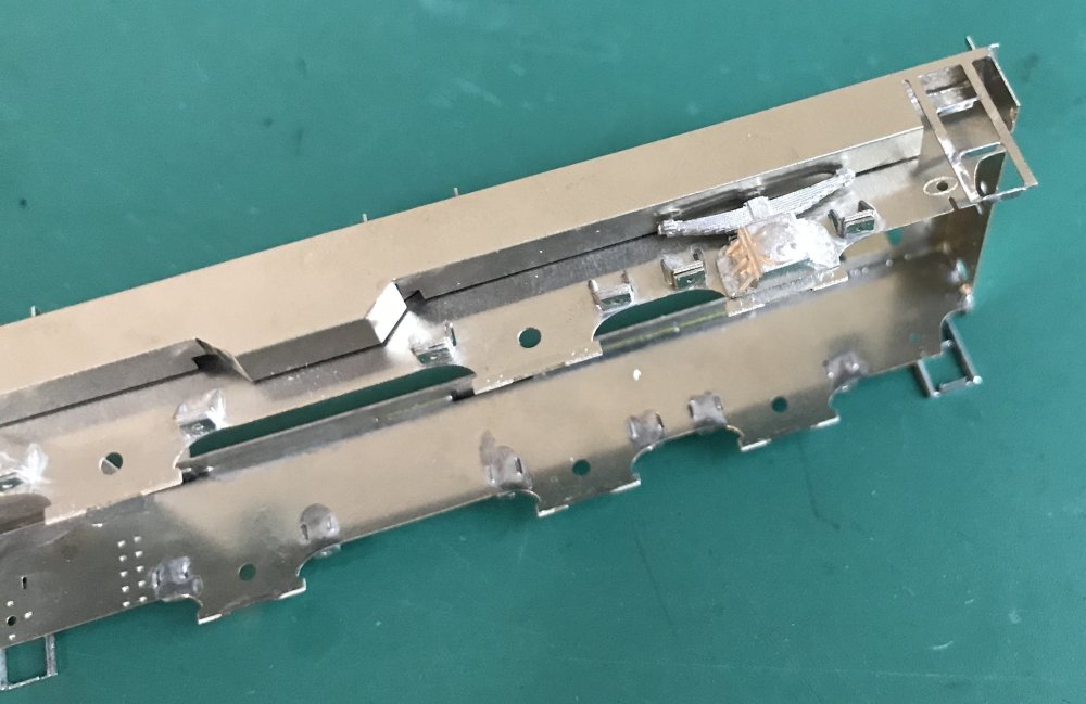

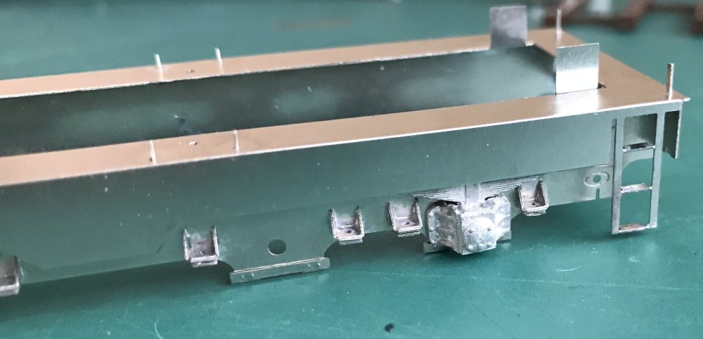

Mol_PMB Posted February 9 Author Posted February 9 I've been making some progress on the frames this afternoon, though I'm not going to get them finished today, which had been my target. Some of the details are a bit fiddly: the spring hanger brackets seemed to be particularly prone to pinging off somewhere and being eaten by the carpet monster. Fortunately I had forseen this and included some spares on the etch! They look neat when done though. I've also put some strips of lead flashing into the fuel tanks which have added a useful 25g to the weight. The underside now looks like this. By design, there is a compromise in the position of the frames - they ought to be about 2mm closer together in reality, behind the buffer centres. In the model, the combined effects of 21mm gauge wheelsets with slightly overscale width treads, the extra sideplay needed for a 3-axle loco on trainset curves, and the need for the wheels to be electrically insulated from the frames, all meant that I had to place the frames a bit further apart than the prototype. That does have the secondary advantage of the buffers not being directly aligned with the frames, thus enabling sprung buffers to be fitted. However, for a 16.5mm gauge model the frames could perhaps be placed closer together. I've now started playing with the axlebox castings. These are intended for LMS Ivatt tenders and they are the closest I could find, but they're a little bit too deep and wide for the E class. I'm sanding them down to fit. Combined with the frames being slightly further apart, the axleboxes seem to stand out a bit more than on the prototype, but I hope it won't be too noticeable when complete and covered in some grime. There are still quite a few fiddly details to add to the frames and footplate; this stage is taking longer than expected but I'm still pleased with how it's looking. 14
Mol_PMB Posted February 9 Author Posted February 9 Axleboxes soldered in place, and wire fitted for spring hangers. That's all for this weekend, there may be more tomorrow evening. 8

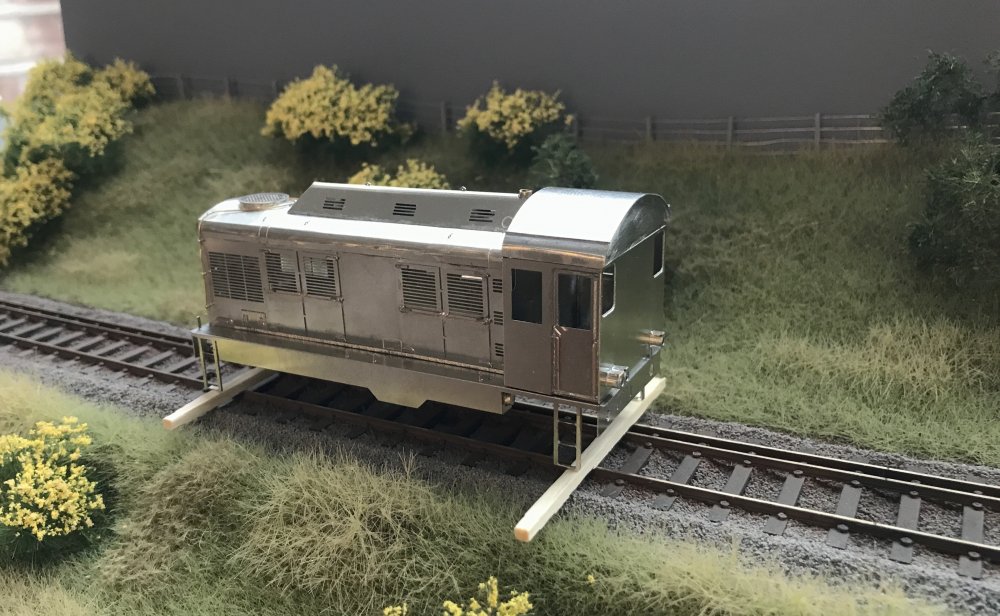

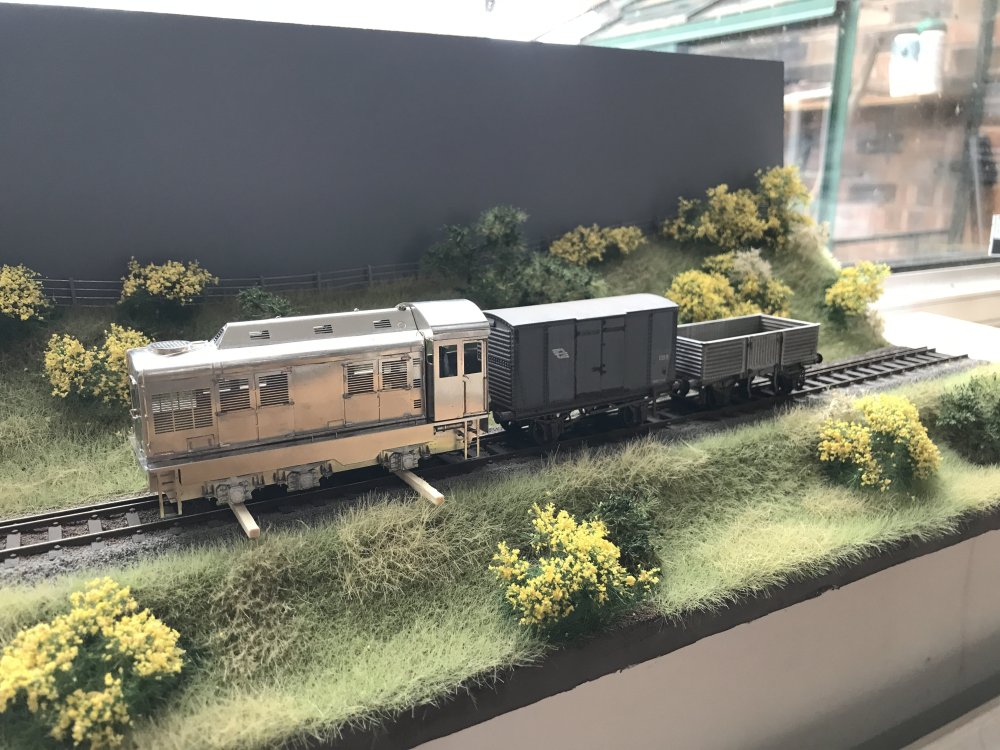

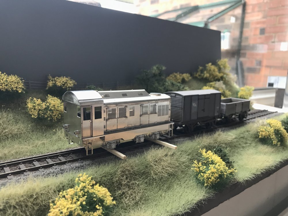

Mol_PMB Posted February 10 Author Posted February 10 A quick reassembly to pose with a couple of trucks. Looks big compared to the van, but they were, as shown in Ernie’s photo: Suppose I’d better turn it round… 11 4
