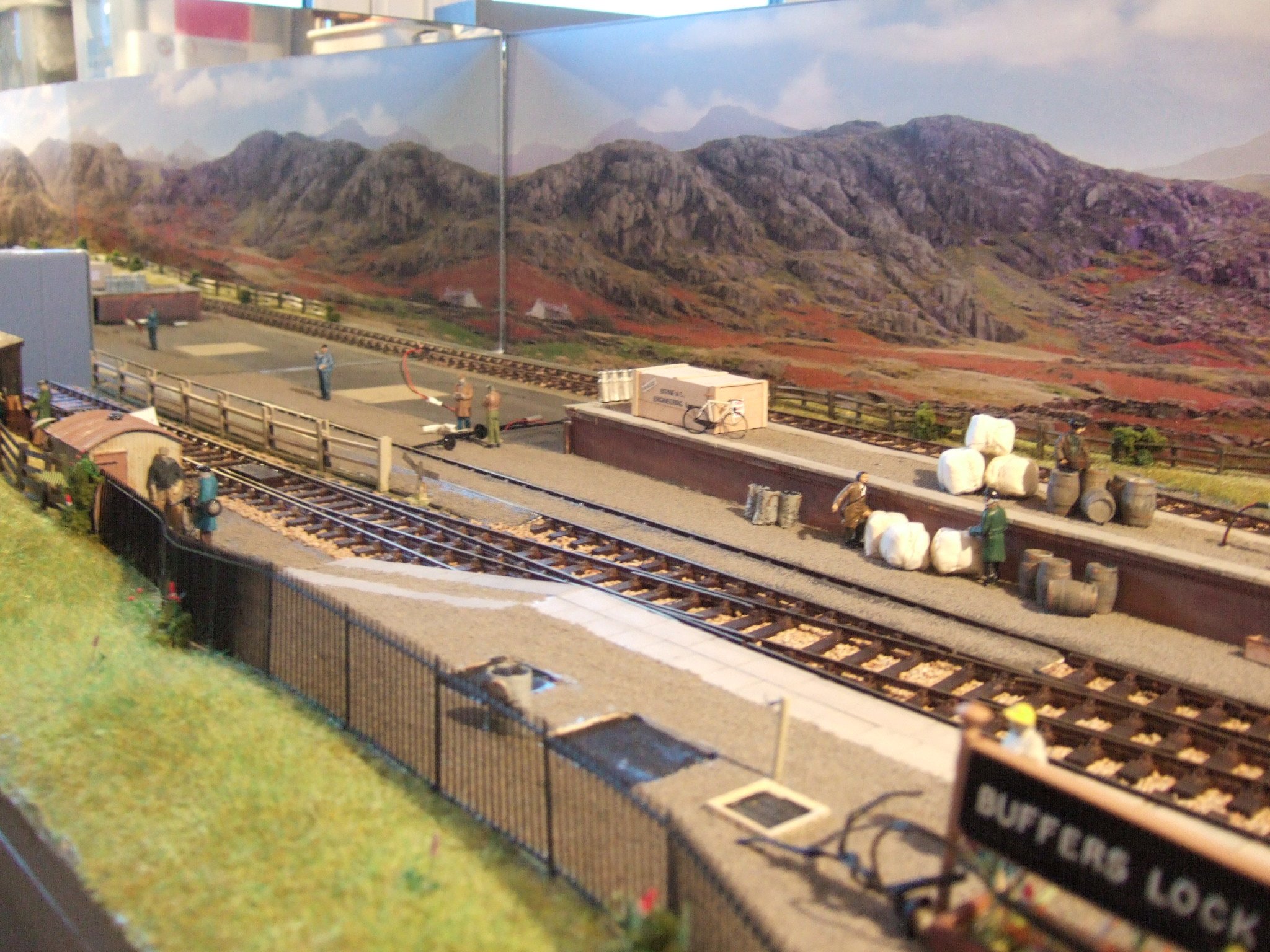

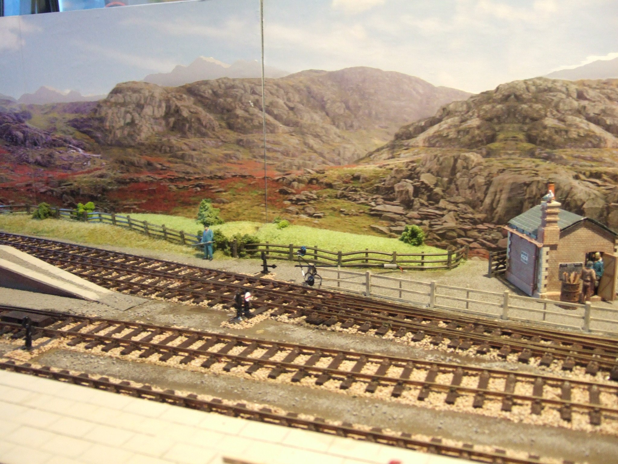

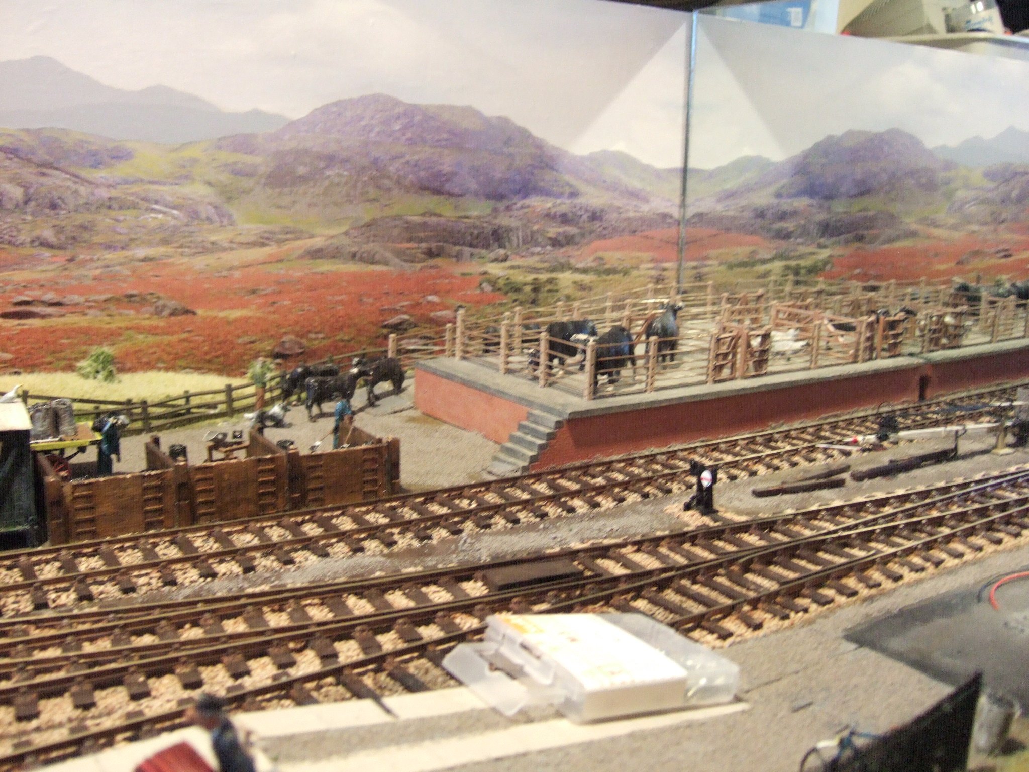

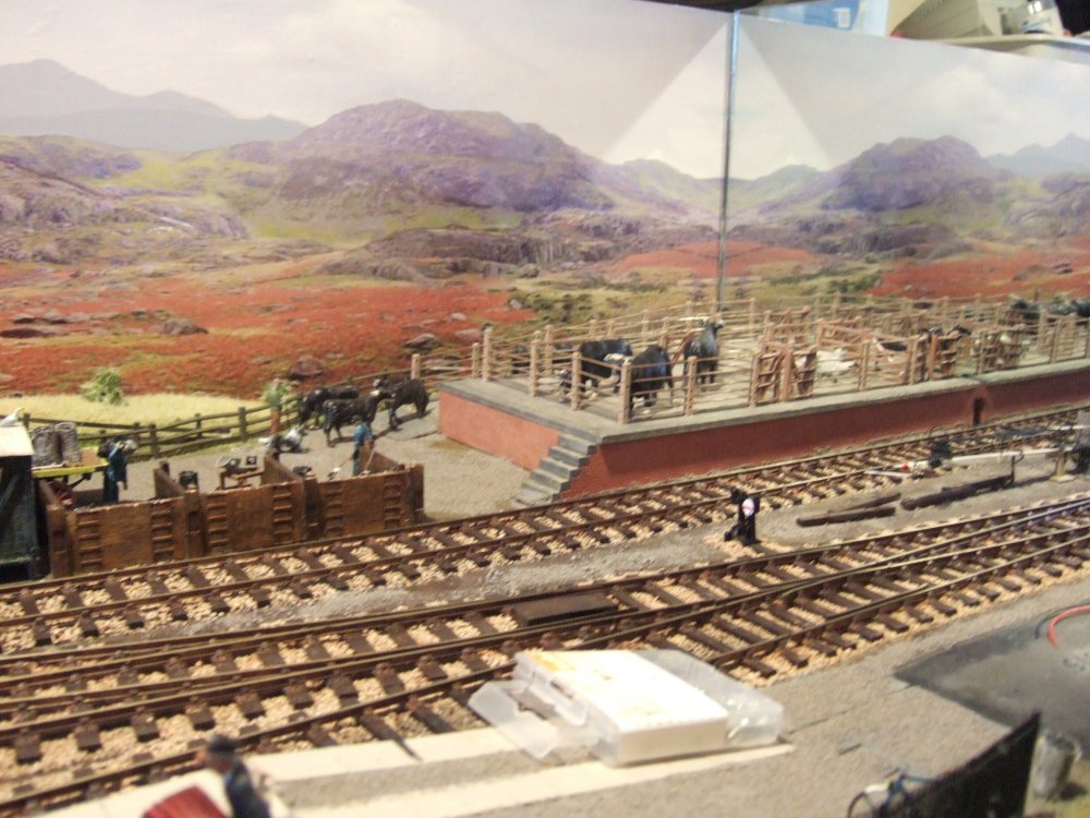

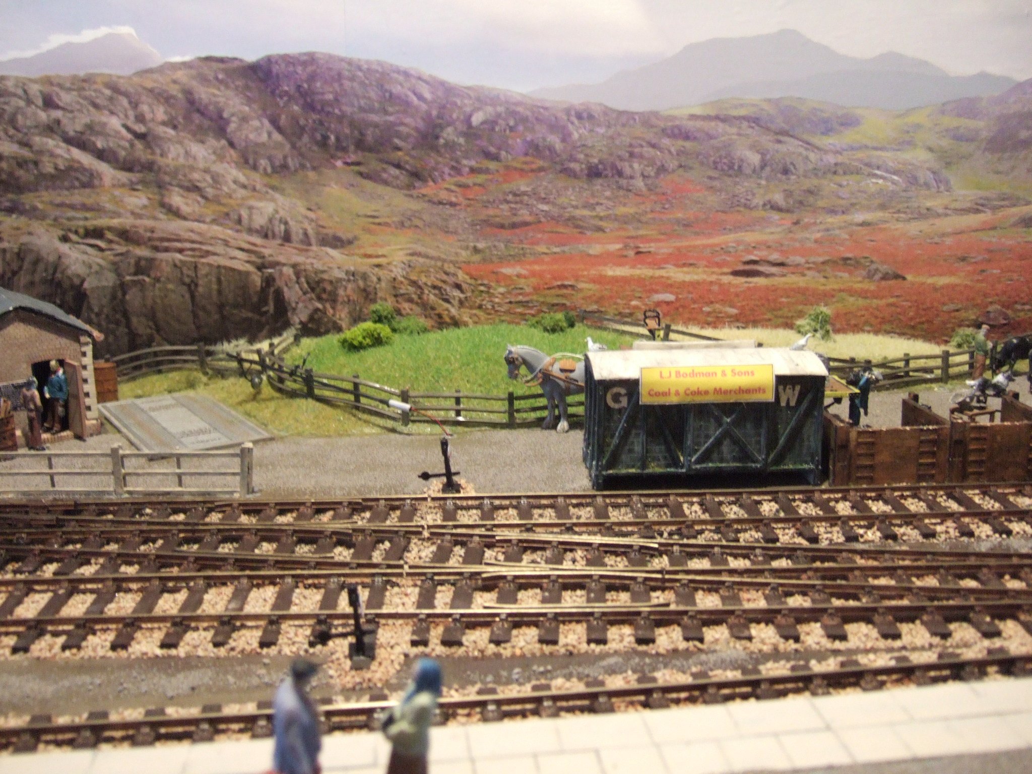

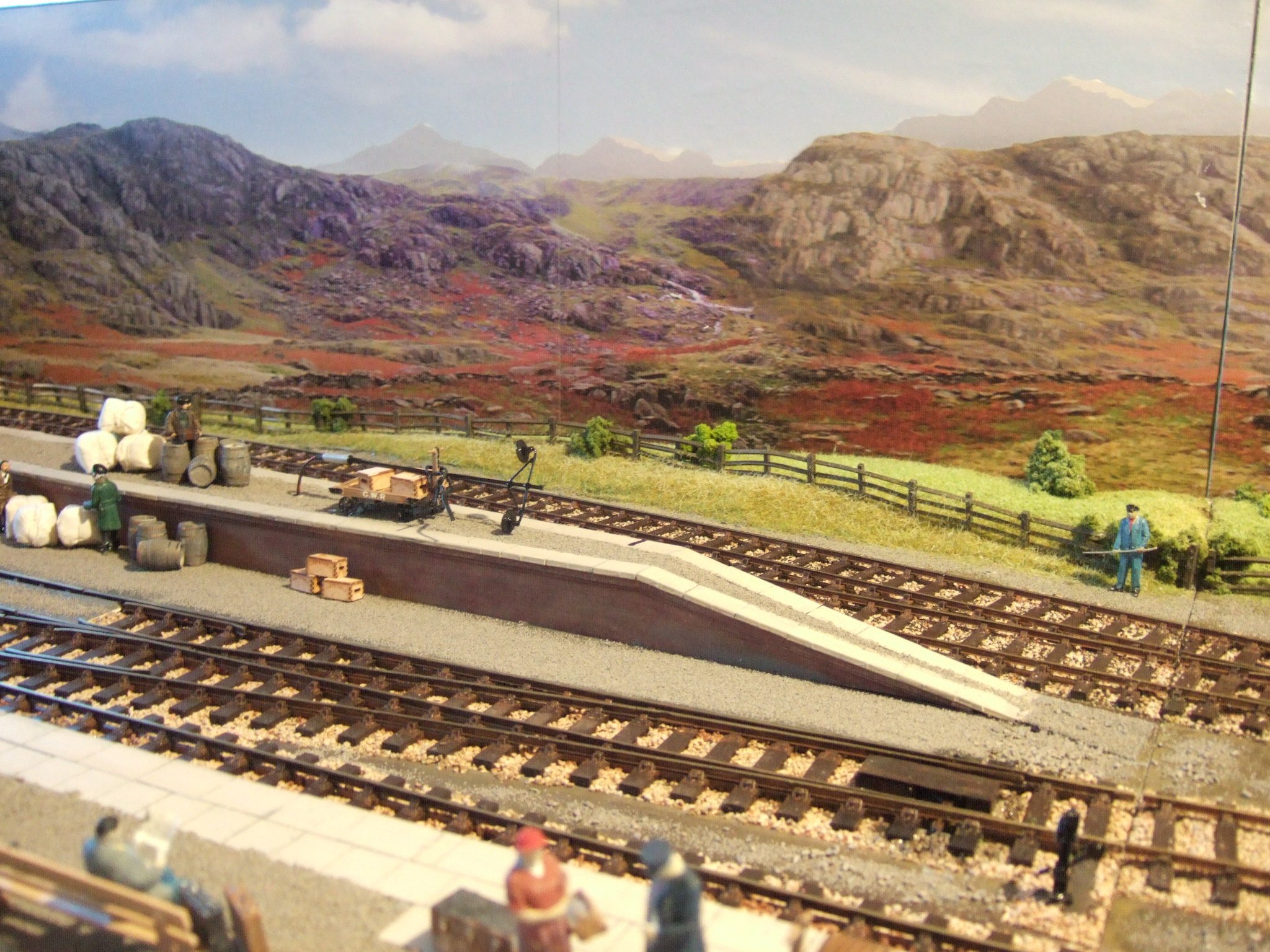

Irishrailwayman Posted December 6, 2025 Posted December 6, 2025 Some of you may know of my GWR UK outline O gauge layout "Buffers Lock". I have detailed the story of it's build and exhibition life elsewhere on irm.com (see: Buffers Lock). Basically, this is a 16.5 feet long exhibition layout with a scenic area of 8.5 feet by 26.5 inches. Two four foot long fiddle-yards (three lines each) feed trains from either end allowing through trains to be run. One fiddle-yard is a traverser and the other is a train turntable. Originally the electrical set up was DCC to run trains and the point motors/semaphore signals. The "brick" outline station building, signal box, goods shed and other fittings are all typical of GWR practice. The backscene is of a UK village in the middle distance (Ross-on-Wye I believe). I have now started a project to develop the layout to allow for alternating use as an Irish outline layout. To accomodate a variety of rolling stock that might become available, I have rewired the layout to be easily changed from DCC to DC use with Double-Pole Double-Throw switches. DCC control will continue to use the Roco/Fleischmann's Z21 system while DC power is now supplied by a Morley Controller Vanguard Zero One unit delivering 2.5 Amps per track. In either mode the signals and point motors will be controlled by DCC. In time, I am working to have suitable alternate buildings developed with a "stone" outline matching actual Irish prototypes. These will fit directly in place of the GWR outline buildings when running in irish outline mode. CK Prints (Enda Byrne) has developed Irish outline brake vans in flying snail grey and roundal brown versions. Enda plans to produce other Irish outline wagons in time including beet and other wagons. Alphagraphix have a range of MGWR outline locomotives and passenger carriages available in metal kits which are worth considering. Once the layout is further developed, I plan to invite other modellers to run their Irish O gauge rolling stock on this layout perhaps attending exhibitions together as a joint venture. The alternate layout has been named "Maam Road" translated in Irish to "Bóthar an Mháma" (which means the road to the mountain pass). Many rural irish railways had stations some distance from the towns they served and so had the "road" designation. My idea is to situate the layout somewhere in the West of Ireland within a wild mountain landscape similar to those the Clifden or Achill lines ran through. There was a station at Maam Cross/An Teach Dóite but my layout is not intended as a copy of that station. I have mounted a suitable backscene on new boards (to alternate with the existing "Buffers Lock" backscene). I attach a few photos to show what the scene looks like without buildings. 16 1

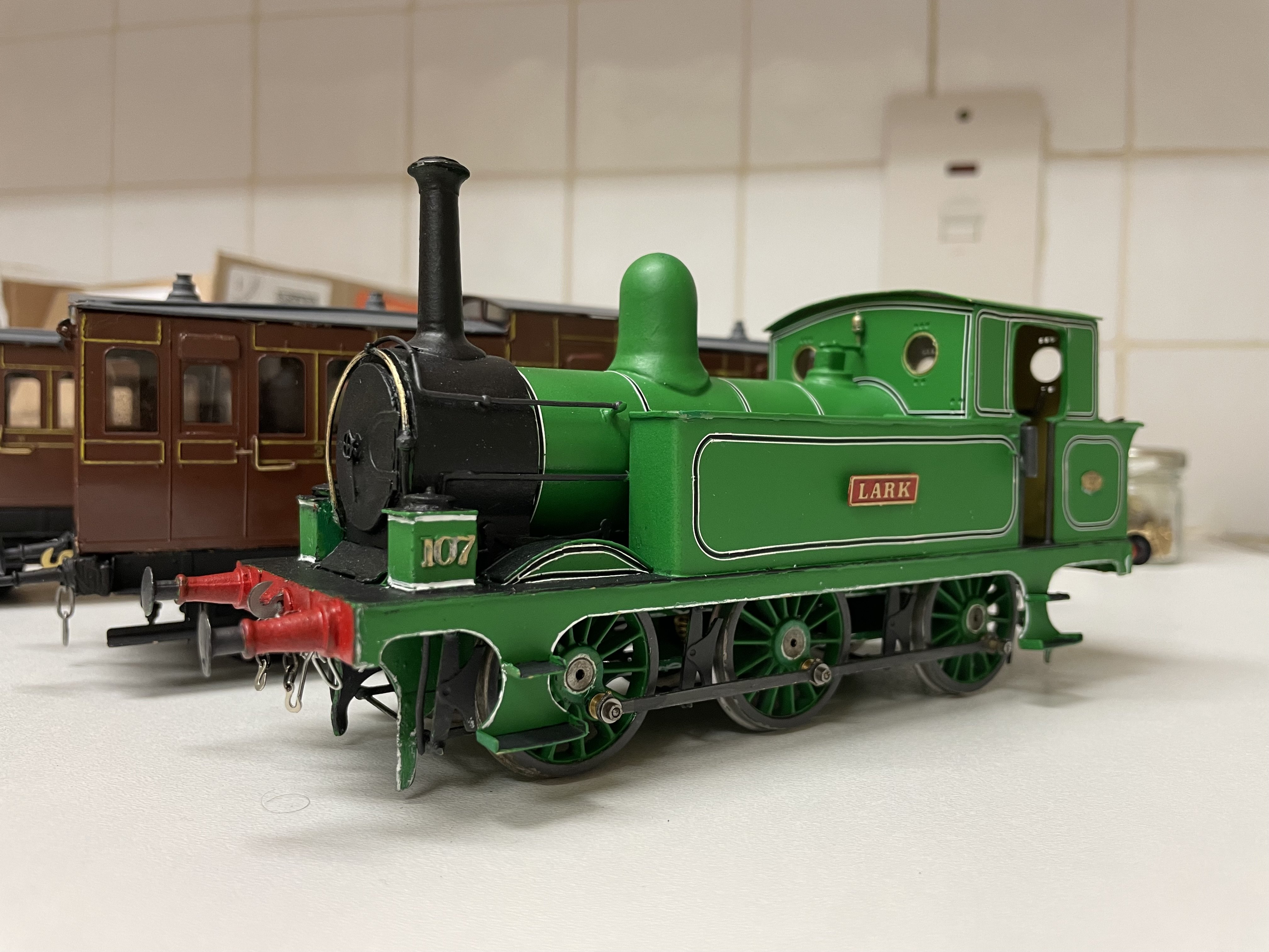

Galteemore Posted December 8, 2025 Posted December 8, 2025 (edited) 1 hour ago, jhb171achill said: I’ve seen a couple of these made up and they look great. A word of css as union on Alphagraphix coach kits; in almost all cases, the liveries are badly wrong! Won’t matter as they are brass so you’ll have to paint it yourself anyway - is not like the card preprinted kits. I have made up a J26 and 2 MGW coaches. Straightforward as David says / they are also designed for 32mm primarily rather than 36.75, and most of my building heartache came from the 5’3 bit! Edited December 8, 2025 by Galteemore 7 2
Irishrailwayman Posted December 8, 2025 Author Posted December 8, 2025 4 hours ago, Galteemore said: Won’t matter as they are brass so you’ll have to paint it yourself anyway - is not like the card preprinted kits. I have made up a J26 and 2 MGW coaches. Straightforward as David says / they are also designed for 32mm primarily rather than 36.75, and most of my building heartache came from the 5’3 bit! Wow, these look great! Thanks for sharing. 1 1

Tullygrainey Posted December 9, 2025 Posted December 9, 2025 21 hours ago, Galteemore said: Won’t matter as they are brass so you’ll have to paint it yourself anyway - is not like the card preprinted kits. I have made up a J26 and 2 MGW coaches. Straightforward as David says / they are also designed for 32mm primarily rather than 36.75, and most of my building heartache came from the 5’3 bit! What a little beauty! 1
Galteemore Posted December 9, 2025 Posted December 9, 2025 (edited) 28 minutes ago, Tullygrainey said: What a little beauty! Thanks - first effort at lining a loco! Hopefully some day it will appear at a show alongside Mr Hs! . @Northroadermade one too, so there’s a few about! Edited December 9, 2025 by Galteemore 6 1

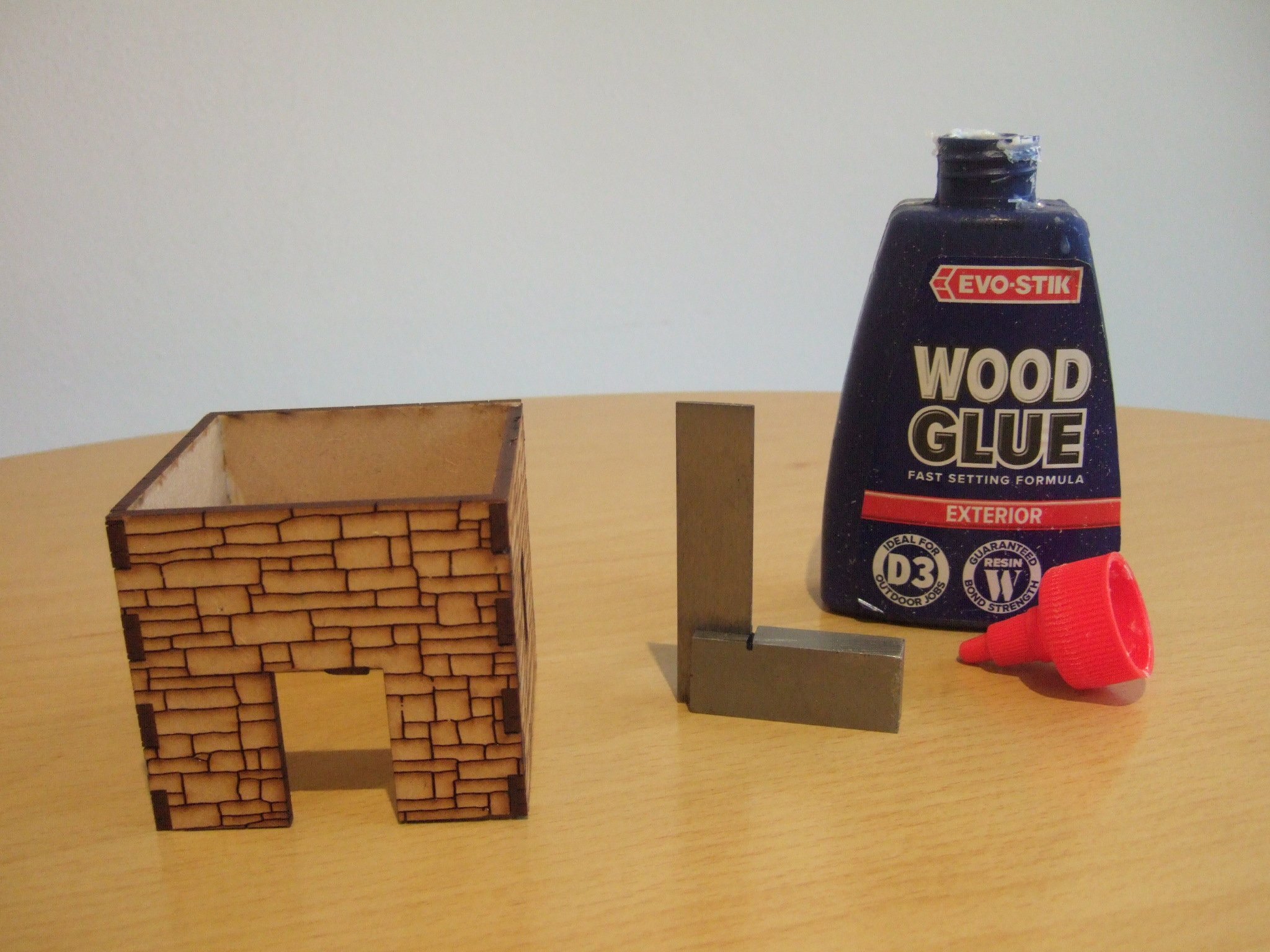

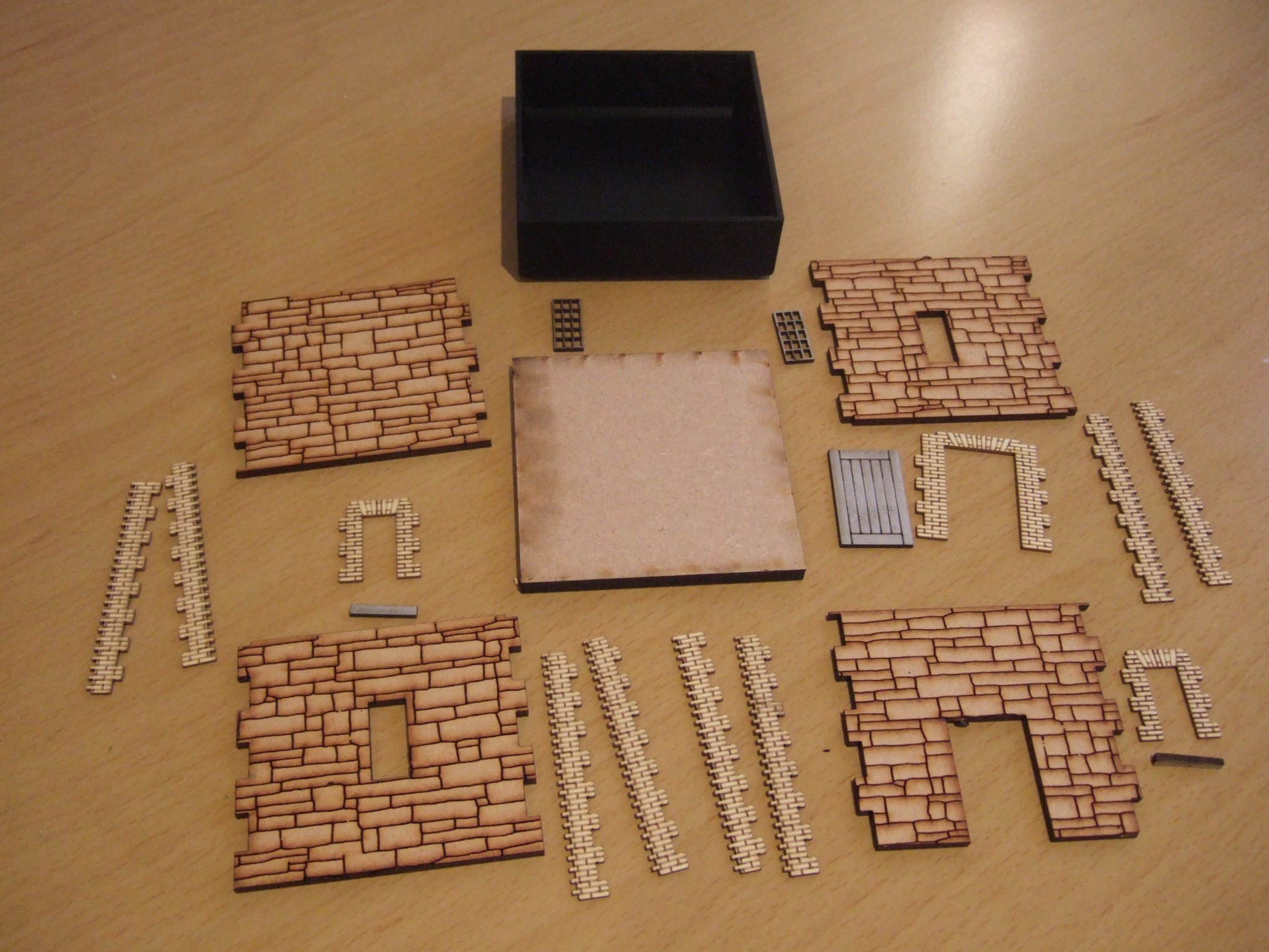

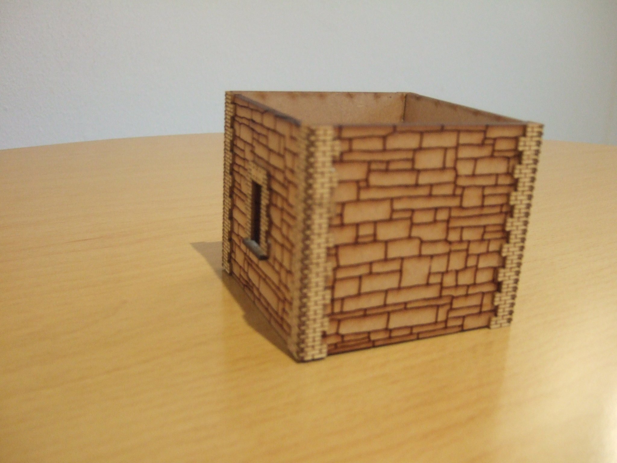

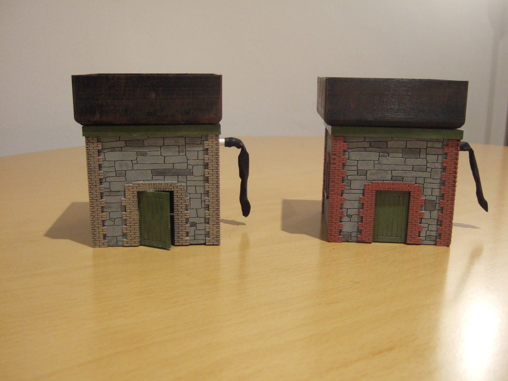

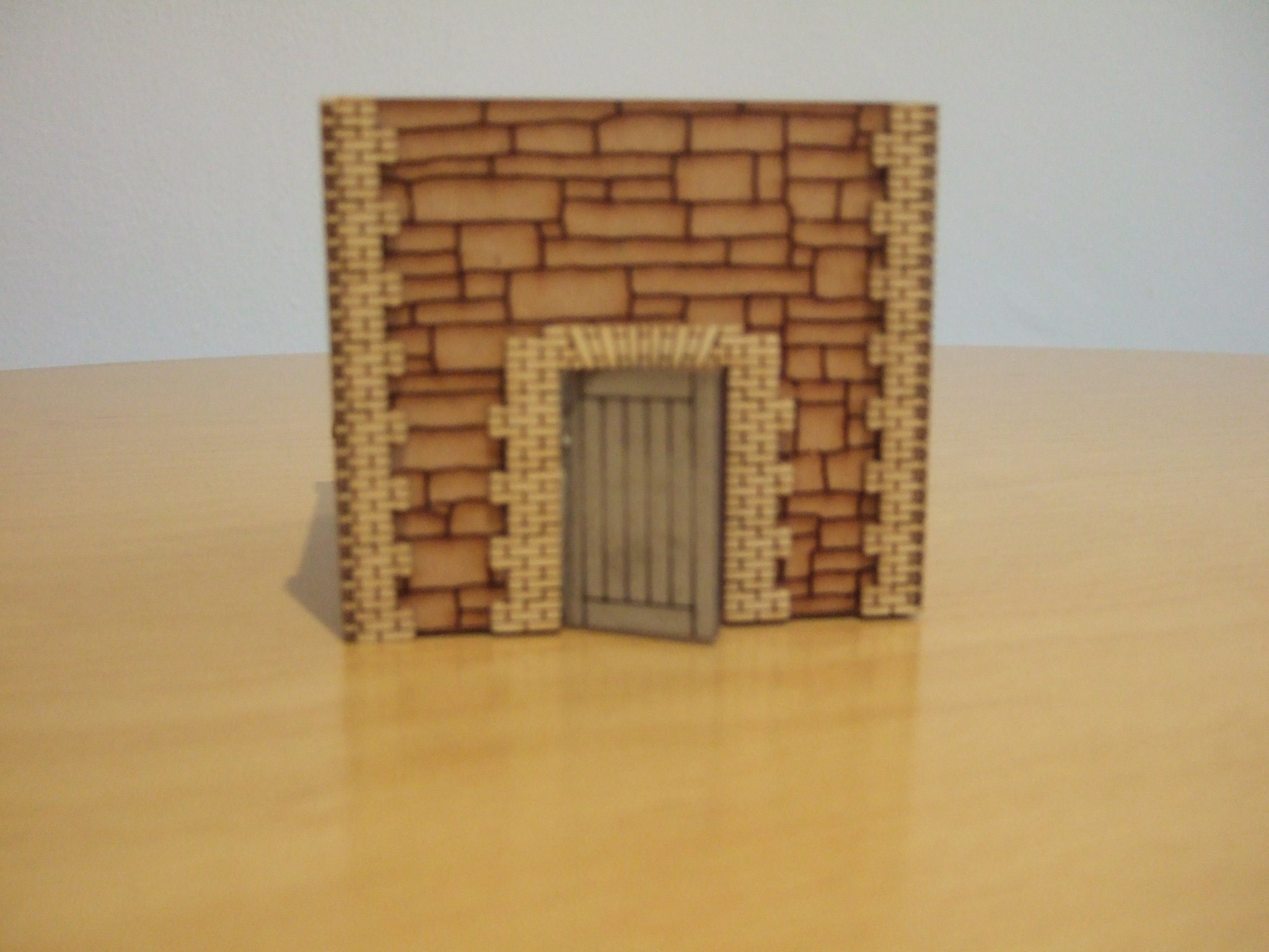

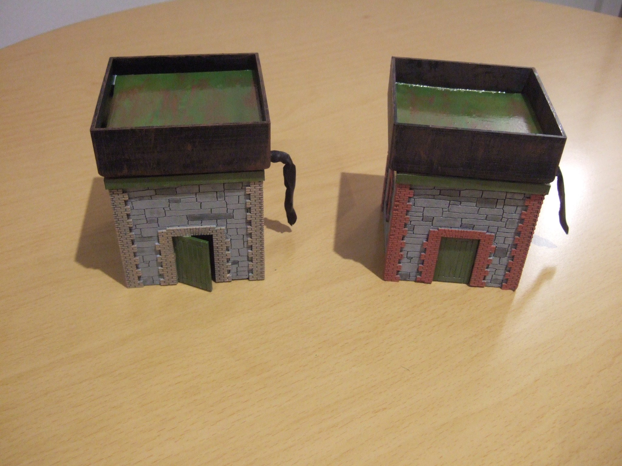

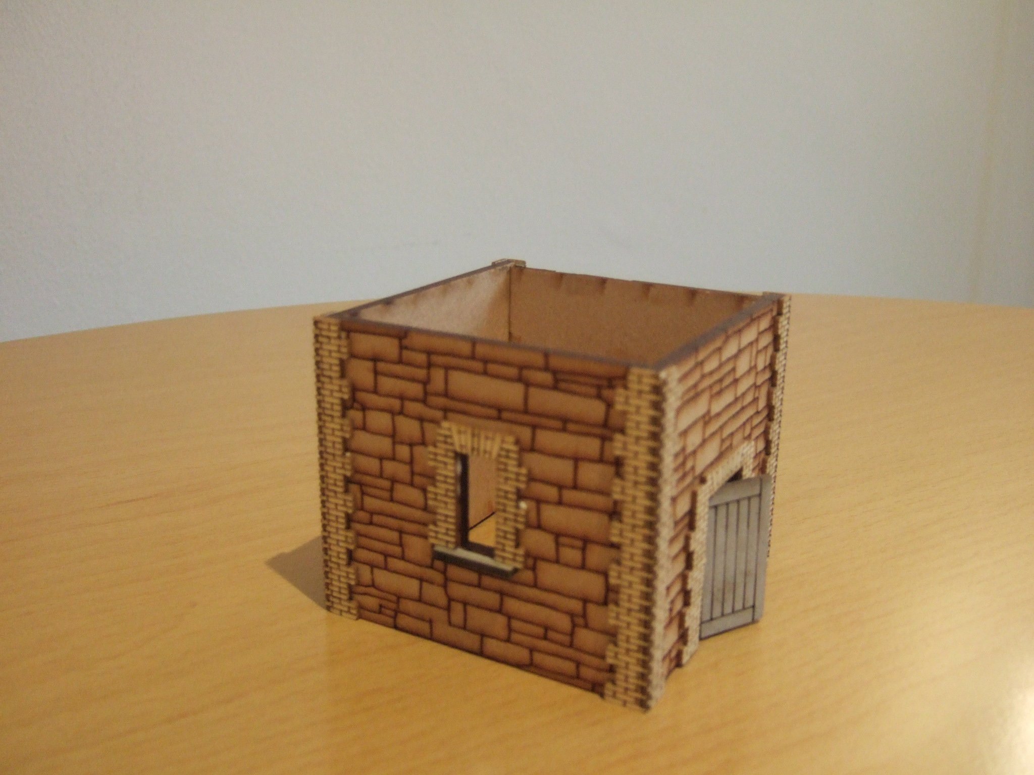

Irishrailwayman Posted December 16, 2025 Author Posted December 16, 2025 I am working with a good friend Redmond O'Hanlon to develop laser-cut wood model O gauge buildings for "Maam Road". First up is the water tower based on an example at Gorey station with some details from buildings originally at Manorhamilton. Redmond has produced a lovely kit which fits together easily with wood glue. I assembled one and painted/detailed two examples per the following photos. BTW Redmond attends the monthly Bray Modellers' Meet at Bray Wheelers' clubroom: next one is on Sunday 21st December 2025 if you want to chat to him about his work on this and other irish outline buildings and structures in a variety of scales. 14 1
jhb171achill Posted December 16, 2025 Posted December 16, 2025 These look amazing. May I ask if an 00 gauge version is likely? 1
Irishrailwayman Posted December 17, 2025 Author Posted December 17, 2025 11 hours ago, jhb171achill said: These look amazing. May I ask if an 00 gauge version is likely? Yes JB! Redmond is working on a OO version at present. You could chat to him at the Bray event if you are free on the 21st am? I hope to get a OO kit and paint it up as an example. Next steps on the Maam Road project is to develop similar O gauge Irish outline signal cabin, station building and a goods shed to match in style the water tower. All may be available in OO in time. 11 hours ago, Patrick Davey said: Wow! Great stuff!!! Thanks. I will post up the painting scheme used shortly. 1
Mol_PMB Posted December 17, 2025 Posted December 17, 2025 How is the distinctive shape of the tank itself made? Presumably that isn't laser-cut? For the stonework, you could enhance the appearance by dabbing Matte Medium onto some of the stones. That would better represent the rougher stone typical of these water towers. It doesn't take long and doesn't require any finesse - just blob it on and leave to dry, then paint over it. I did that on my laser-cut mill building. 2
Irishrailwayman Posted December 17, 2025 Author Posted December 17, 2025 1 hour ago, Mol_PMB said: How is the distinctive shape of the tank itself made? Presumably that isn't laser-cut? For the stonework, you could enhance the appearance by dabbing Matte Medium onto some of the stones. That would better represent the rougher stone typical of these water towers. It doesn't take long and doesn't require any finesse - just blob it on and leave to dry, then paint over it. I did that on my laser-cut mill building. Redmond 3-D printed the water tanks. Good idea on the rougher stones thanks. 1
Galteemore Posted December 17, 2025 Posted December 17, 2025 Looks really good. Iain Rice recommends a coating of talc on such things to blend all the colours together 1
Irishrailwayman Posted December 17, 2025 Author Posted December 17, 2025 (edited) Just a note to file on a suggested painting scheme for the water towers. First coat all exposed wood with Rustins grey primer/undercoat. Next "dry brush" with Humbrol #64 Light Grey matt (ie use small amounts of paint on a flat brush wiping it almost dry on kitchen paper before skimming across the "stones" avoiding flooding the "mortar" lines between). Pick out individual stones with Humbrol #27 Sea Grey matt. For woodwork, windows and door use Humbrol #80 Grass Green matt. For "yellow" brickwork lightly paint to avoid flooding the "mortar" lines with RailMatch #606 GWR Light Stone (Humbrol #121 Pale Stone matt would work either). For red brickwork use sparingly 50:50 mix of Humbrol #73 Wine matt and #62 Leather matt. For the 3-D printed water tank streak sides with Humbrol # 113 Rust; insert clear plastic to fit, paint underneath with Humbrol #80 Grass Green matt and streak with Humbrol #113 Rust matt (could also paint blue/brown as colour in reality would be dictated by overhead light conditions). I used a section of 5 mm plastic tubing and some heat-shrink tubing to represent the water outlet leather bag which flops in to the receiving steam engine water intake point. I fitted small sections of clear plastic behind the windows with DeLuxe Glue& Glaze as glazing. Edited December 17, 2025 by Irishrailwayman 4 1
