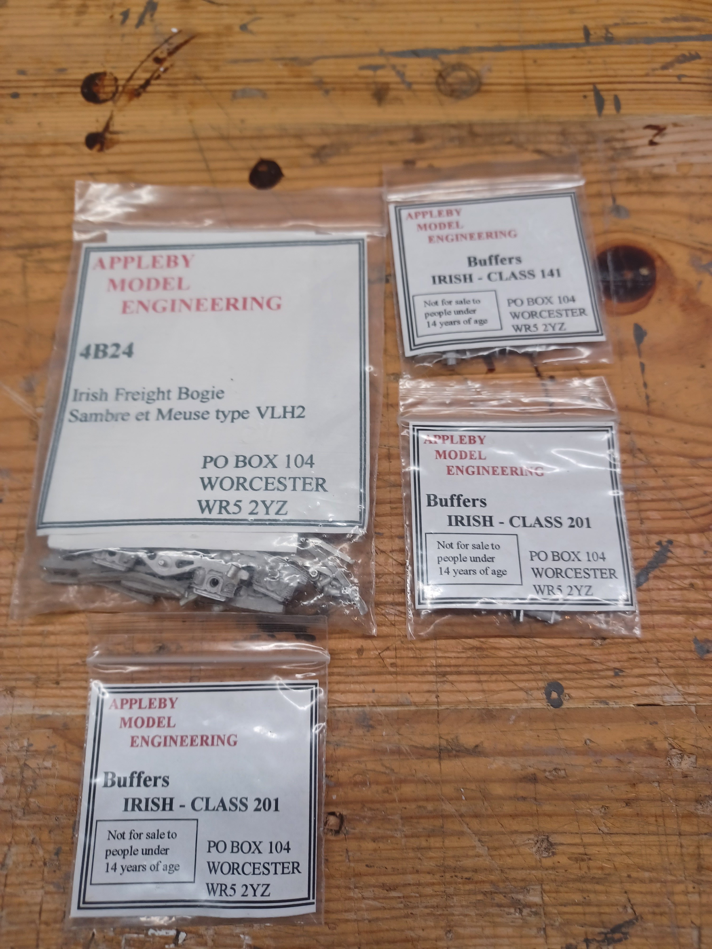

A long long time ago I commissioned Appleby Models(John Talbot) to produce the following before any Irish outline bits were available. Memories.
Warb
  • 0
Warb
Aha! So that's the origin of them. The supply has now dried up, sadly. Though I'm sure modellers around these islands have some sets stashed away in boxes.
