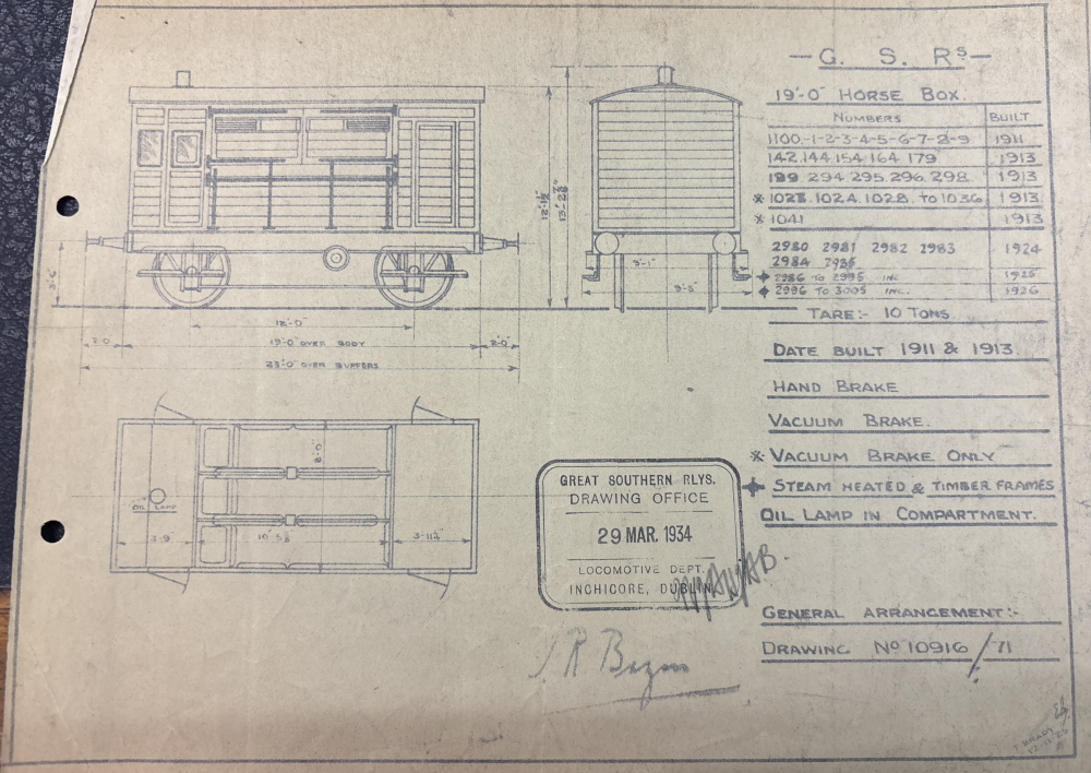

seagoebox Posted January 21 Posted January 21 A couple of MGWR horseboxes, 5m at Albert Quay, May 1960 and 32m at The Broadstone (solebar is marked Inchicore 7-1930) 6 1
Mol_PMB Posted January 21 Author Posted January 21 Many thanks @seagoebox - an excellent view of each of the main types of MGWR horsebox, and a different example of GSR livery. I've found a few more horsebox photos in my trawl through the library, and can offer the following references: Railways in Ireland Part 3 DSER/MGWR etc (Bairstow) page 62, dated 1914, monochrome: MGWR horsebox (early type with dogbox) in MGWR livery. Railways in Ireland Part 4 GSWR (Bairstow) page 41, dated 1914, monochrome: 3 horseboxes GSWR diagrams 101, 100, 103 being shunted at Kingsbridge. Railways in Ireland Part 3 DSER/MGWR etc (Bairstow) page 35, dated 1954, monochrome: at least 3 horseboxes at head of train, 2xGSWR diagram 103 and another older type maybe diagram 100. Railways in Ireland Part 4 GSWR (Bairstow) page 87, dated 1955, monochrome: 3 horseboxes MGWR later type and 2xGSWR diagram 103 attached to rear of a Tralee-Limerick passenger train. Railways in Ireland Part 4 GSWR (Bairstow) page 87, dated 1955, monochrome: GSWR diagram 101 horsebox in Foynes passenger/mixed train. Irish Railways since 1916 (Baker) page 96b, undated, monochrome, Sulzer 1101 with a short passenger train, diagram 103 horsebox immediately behind the loco. Irish Railways in the 1950s and 1960s (McCormack) page 151, dated 1957, colour: loco 800 leading a 'horse van train'. Only one and a bit horseboxes are in shot, the first a very tatty diagram 103 and the second (only just visible) appears to be similar but freshly repainted in light green. Irish Railways in the 1950s and 1960s (McCormack) page 154, dated 1957, colour: End view of a diagram 103 with black end but side colour is hard to make out. 1

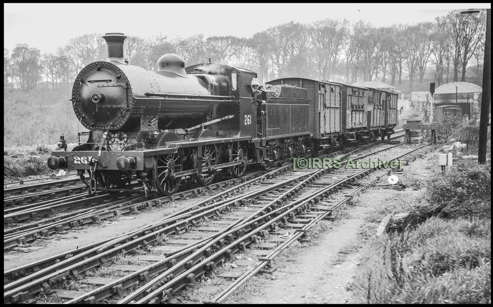

Wexford70 Posted April 11 Posted April 11 Ex-works CIÉ J4 Class 0-6-0 No. 261 emerges from Phoenix Park Tunnel with four horse boxes from Amiens St, February 1954. captured by the late David Murray/IRRS Archive. #irishrailarchives #irishrailways 5
Patrick Davey Posted April 11 Posted April 11 Very nice - such an incredible resource is the IRRS Flickr archive! 2
Mayner Posted April 12 Posted April 12 13 hours ago, Wexford70 said: Ex-works CIÉ J4 Class 0-6-0 No. 261 emerges from Phoenix Park Tunnel with four horse boxes from Amiens St, February 1954. captured by the late David Murray/IRRS Archive. #irishrailarchives #irishrailways The J4/257 & similar J9 351 Class 0-6-0s appear to be reasonable candidates for a 3D printed body to run on a Bachmann 3F or 4F chassis. Both classes have a coupled wheelbase of 7'7"+8'6" compared with 8'+8'6" for the British locos. The J4 257 Class introduced 1913 appear to have been highly regarded locos suitable for both goods and secondary passenger work and a popular choise for both cattle and horsebox specials (A Decade of Steam and Locomotives of the GSR). The J4 was basically an updated superheated verison of the J9 introduced 1903 first batch of J9 had a low running plate with slotted splashers similar in appearance to J15, 1912 batch J9 similar in a appearance to J4. J9s also carried out main line passenger work1951 photo of 353 (1903 batch) on Rosslare-Dublin Mail Wexford Nth Aug 1954 (A decade of Steam) 1
Mol_PMB Posted April 12 Author Posted April 12 30 minutes ago, Mayner said: The J4/257 & similar J9 351 Class 0-6-0s appear to be reasonable candidates for a 3D printed body to run on a Bachmann 3F or 4F chassis. Both classes have a coupled wheelbase of 7'7"+8'6" compared with 8'+8'6" for the British locos. The J4 257 Class introduced 1913 appear to have been highly regarded locos suitable for both goods and secondary passenger work and a popular choise for both cattle and horsebox specials (A Decade of Steam and Locomotives of the GSR). The J4 was basically an updated superheated verison of the J9 introduced 1903 first batch of J9 had a low running plate with slotted splashers similar in appearance to J15, 1912 batch J9 similar in a appearance to J4. J9s also carried out main line passenger work1951 photo of 353 (1903 batch) on Rosslare-Dublin Mail Wexford Nth Aug 1954 (A decade of Steam) Jack O’Neill has this to say on the J4 class:
