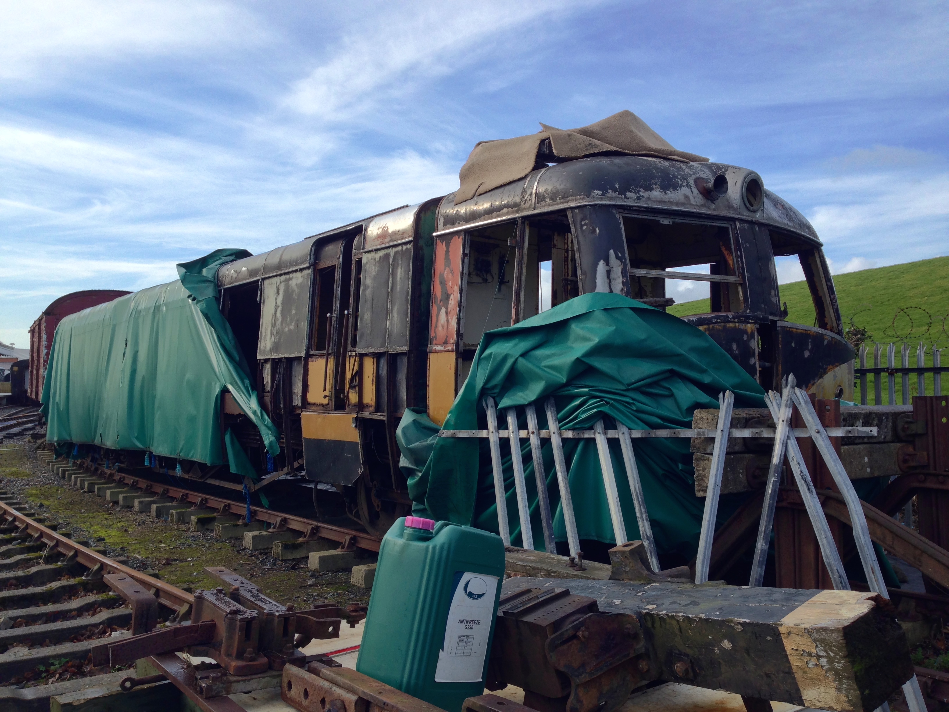

Jawfin Posted February 16, 2014 Posted February 16, 2014 Looking great, David Sorry if I'm going OT, but the wind blew the tarp off the real railcar B, revealing much of the driving end Railcar B by Jawfin110, on Flickr I have some interior shots if you want them, but there isn't much left!
heirflick Posted February 16, 2014 Posted February 16, 2014 great pic Jawfin ...good to see the old girl having a look at the world!
