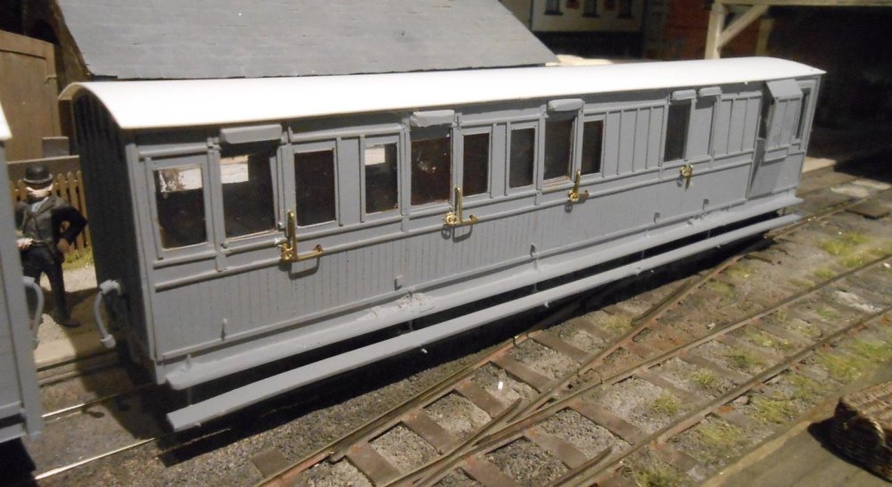

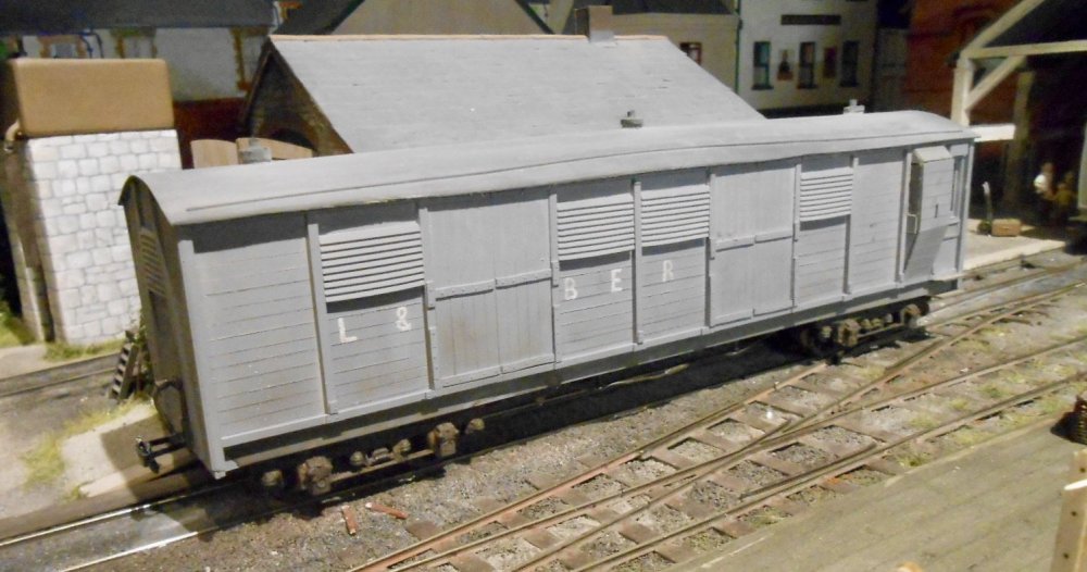

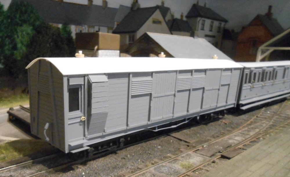

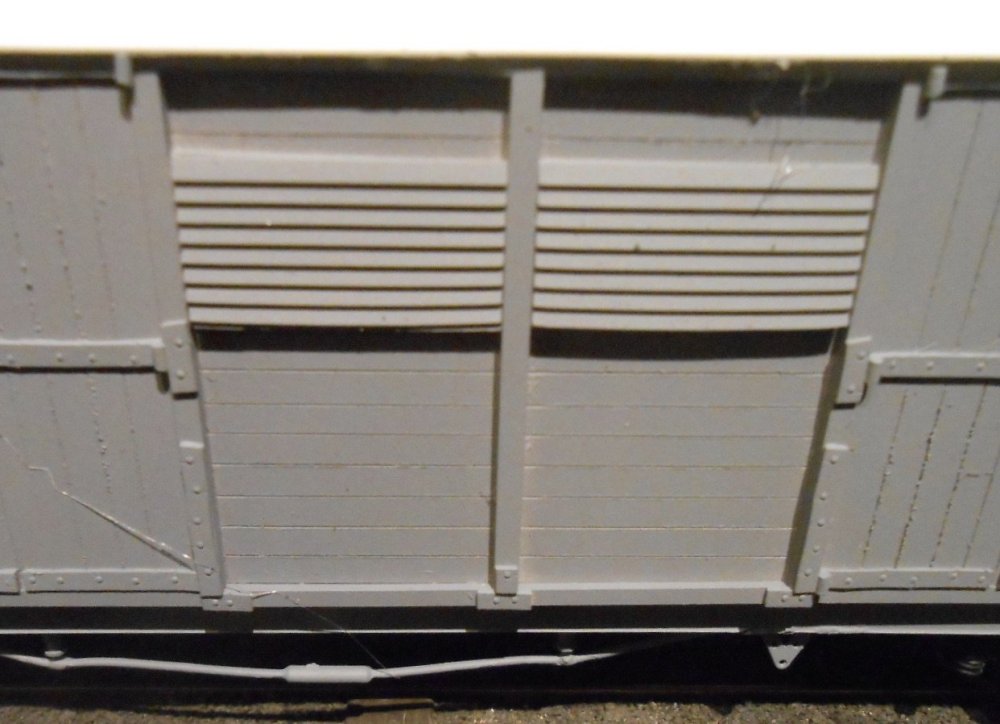

 After a bit of a pause, while I had some louvres 3D printed, the Swilly bogie brake now nears completion. My first experience of such things, they look the part, though I soon found out they needed filing to shape, rather than cutting with a craft knife - far too brittle.
 While waiting for the prints to arrive, I made a start on another Swilly brake third, which will go with the bogie brake for the train for a Kerr Stuart 4-6-2T. Progress has been pretty good - enough to pose the two vehicles together, albeit with final details still needed.
 The brake third is pretty convention - a 40 thou plasticard shell, overlaid with micro strip for the outside strapping and frames. Bogies are from Alphagraphix, while took an idea from Tullygrainy for the roof vents, which are wooden dowel, shaped with files in an electric drill.

Very nice indeed! Looking forward to seeing these completed and the loco started 😍

I've come to the computer to get a better look at these on a bigger screen. Great coach work as always, David. Crisp and with lovely attention to detail in the panelling and metalwork. These look the business even in grey primer.

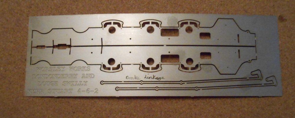

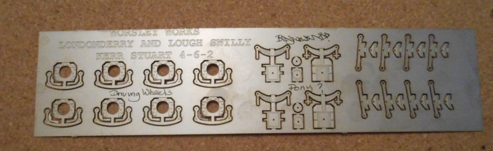

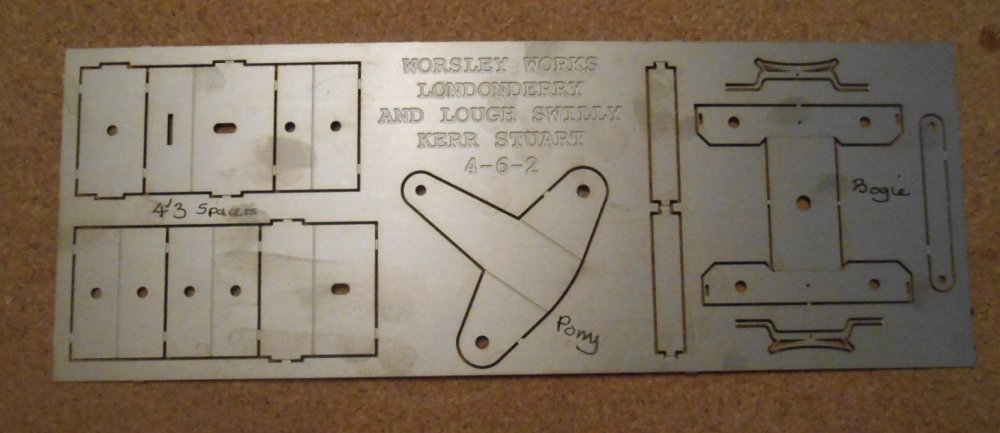

A short pause on the Swilly bogies, because the Worsley Works etches for my next loco arrived today. Much as I would like to dive in and get started, the first thing you always need to do with Worsley stuff is to work out what all the etches represent and then make a list of all the other things you need, so for anyone interested in Worsley products, hopefully the following might help.
 First, the loco itself. This will be a Lough Swilly 4-6-2T, built by Kerr Stuart, as shown below.
  Unlike my previous Barclay 4-6-0T, this set of etches includes the chassis - or most of it anyway.
 First lets look at the frames:
  Nickel silver - nice - for all the etches, although unfortunately the holes for the axle bearings are 3/16" [0 gauge] and I'm using Gibson wheels on 1/8" axles, because, as far as I can tell the correct 3'6 wheels are not available to go with the extended axles needed for outside frames. Hence, am thinking I will need to plate over & fill the current holes somehow so I can fit 1/8 bearings.
 Next we have the frame spacers and etches for the rear pony truck and front bogie. Mostly ok, though the spacers are 4'3 wide and [after several rebuilds] those on my Barclay are now 3'9, so looks like things will need cutting down a bit here.

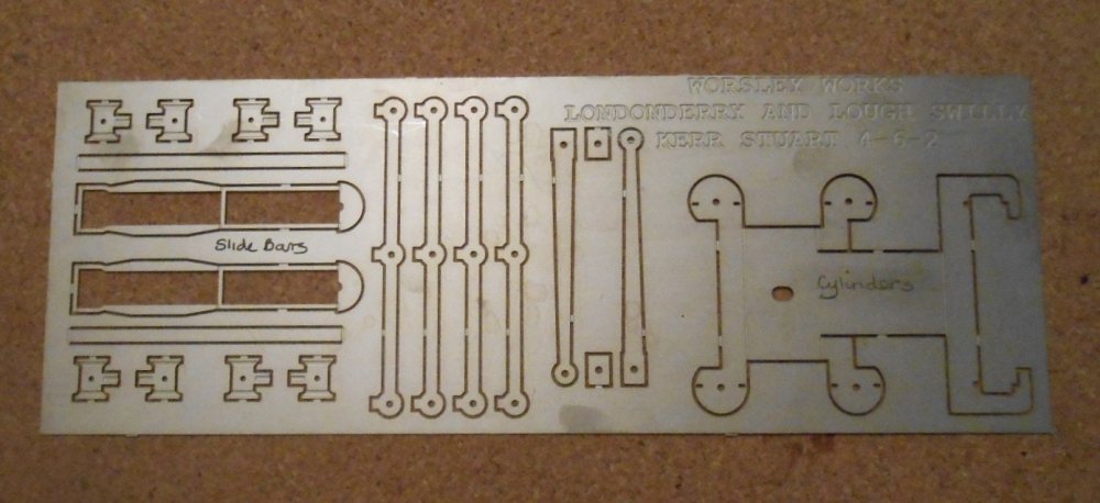

 Always nice to have the coupling and connecting rods. Also on this fret is a one piece etch for the cylinder/motion bracket, plus the slide bars too. Real timer savers here, compared to making things from scratch.
 The fourth chassis etch has overlays for the outside frames [driving wheels] and what I think is the pony truck, along with the brakes.
 So far, so good. What you don't get are:
  • Wheels - the aforementioned Gibsons, including bogie and pony
  • Motor & gear box, from High Level
  • Outside cranks from Slaters
  • Slater's 0 gauge wagon axles for the driving wheels - see the section on the Barclay as to why.
  • Axles box castings for the bogie. Ideas welcome here!

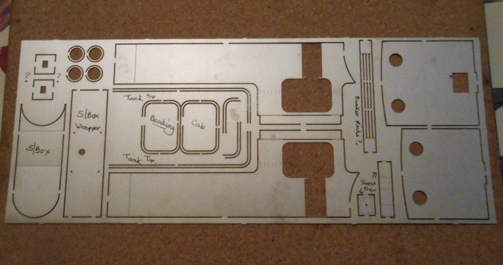

 Now for the bodywork:
 First is the footplate etch, which also contains the buffer beams, a couple of etches for the firebox inside the cab, along with cylinder ends and a pair of steps.
 The main body etches are the cab/tank sides, cab front/rear, smoke box frame & wrapper, bunker rails and a sand box. We also have some useful beading for the cab and tank tops, plus rings for the spectacle plates - though quite what the two square etches, top left, are I'm not sure. Suggestions welcome!

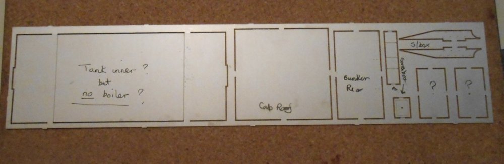

 Finally we have a bit of a mystery etch. Cab roof and bunker rear, plus the other sandbox are fairly obvious, as are the two front frame extensions, top right. No idea what the two rectangles below these are for, while I fear the large rectangle on the left is a bit of a bodge, posing as a filler between the tanks, as per the Barclay.
 You may have noticed there is no sign of a boiler! This will probably be rolled from a piece of flat sheet, though it may be possible to use a piece of tube.  Also needed is  the following:

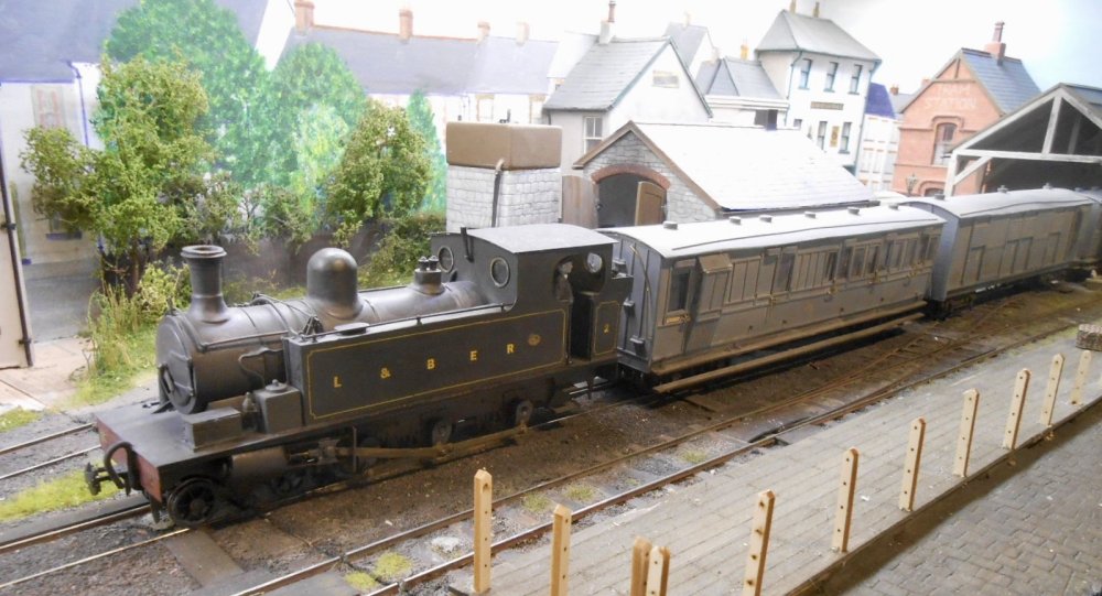

Still a bit more titivating needed, but the two Swilly bogies have made good progress.
  Hand lettering [white gel pen] and a few transfers, plus some weathering [enamels and powders], completes the scene, so have paired them up with the Barclay, below:
 Have also decided to have another go at trying to fabricate a cosmetic addition to the tension lock couplings to make them look a bit more like narrow gauge choppers.
 Just bits and pieces of plasticard, arranged to go on the inside of the buffing plate. A bit crude, but once stuck in place, with a bit of judicious filing and painted black, they are a reasonable upgrade. That said, in the latest Gauge 0 Guild Gazette, EDM Models have announced they are taking on production of the Zamzoodle Chopper couplings, which are much more accurate and can be made to work automatically too. If they are not too expensive, I could be tempted.

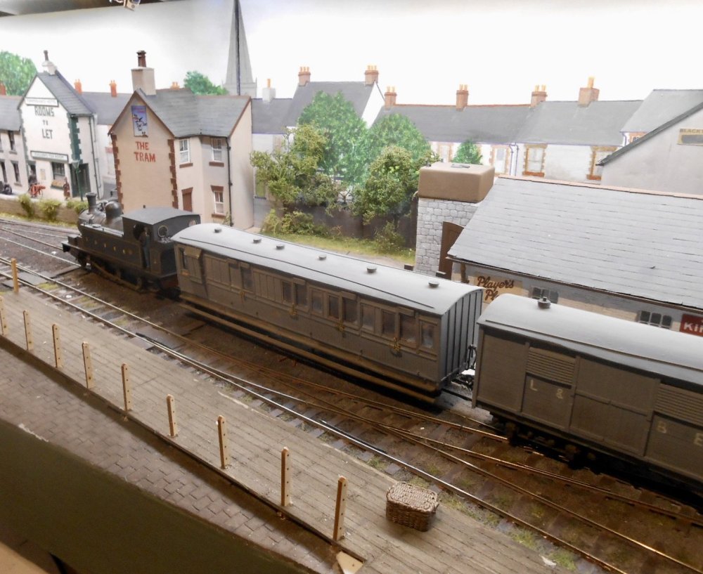

Looks fabulous David. Very different to the CVR tanks and clerestorys that used to populate Fintonagh. Funny enough I thought of you when I saw the Zamzoodles in the Gazette!

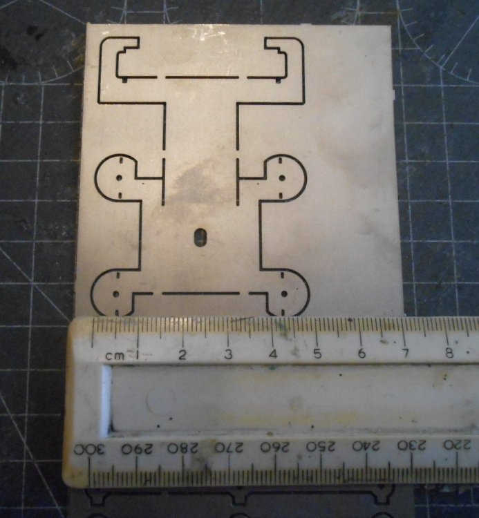

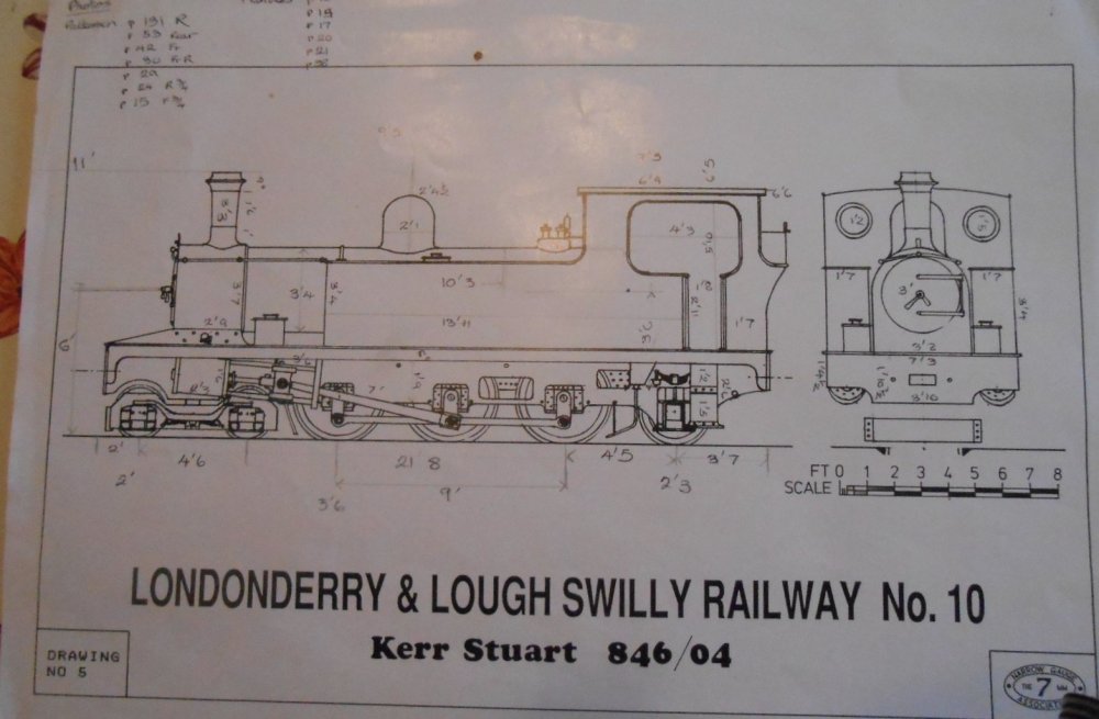

 Couldn't resist the thought of a new project any longer, so this morning sat down to evaluate what I need to do to get started. Having a set of parts is nice, but without any instructions, in effect you need to devise your own and as already mentioned in a previous post, work out what else you need.

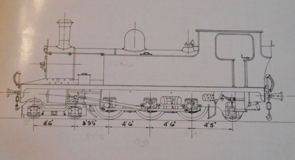

 Found a scale drawing from the 7mm Narrow Gauge Society, though unfortunately not all the dimensions agree with the etchings. Nothing too drastic though, so guess I'll stick with what arrived.

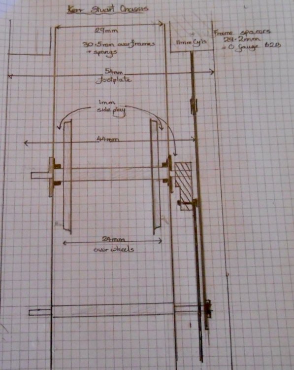

 Those of you familiar with my Barclay Tank adventure will know the chassis caused me a LOT of grief, so decided I really needed a better plan of attack this time, starting with an oversized drawing to check clearances and so on:
 A good two hours was spent with ruler and vernier gauge checking parts and materials, from which I discovered, among other things that:
  • The frame spacers at 29.2mm wide exactly match standard 0 gauge wheel back to backs. This is interesting, because the 0 gauge wagon axles I use with the Gibson driving wheels have nice extensions on them that will take square section brass tube to fit in the Slater's outside cranks, which helps with quartering the wheels. It is also a bit of a shame, because I discovered some Slater's 1/8" 0 gauge axles which fit nicely in the cranks and would have given perfect quartering with zero effort. Unfortunately, they are shorter than the wagon axles and would have made clearances far too tight.
  • I really can't go through the hassle of  trying to fit the Gibson drivers inside the frames as per the Barclay. Hence have sent off to High Level Kits for a set of horn blocks, so wheels and axles can be dropped out of the frames for painting etc. This does mean though that I need to find a way to make those dratted underslung dummy springs removable. A further point here is that talking to Dart Castings at the Tonbridge Show yesterday, it seems High Level could be the only supplier left for 4mm scale horn blocks. Dart can't get the square brass bearings, while Markits future is very much in doubt following the recent death of the proprietor...
  • I fear the cylinder etching is too narrow. As the photo shows, it comes out as about 45mm, whereas the footplate is 54mm wide and the cylinders go right to the edge. They need to as well, to give space for the slide bars and con rods as can be seen from my drawing above.
 Without doing all this preparation, building the chassis would be fraught to say the least - been there and got the T shirts [plural] after all. However, it has helped me get my head round things and while I'm waiting for the horn blocks to arrive, I can get on with some of the bodywork, not least the footplate where it is important to find out where some of the spacers on the etch might fit and how they relate to where the motor/gearbox, body fixing points, bogie and pony wheels etc fit.
 As ever, life is complicated - which is why it is fun. Allegedly...

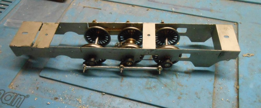

 After deciding which of the half dozen frame spacers to use, I first tack soldered the frames together, so I could cut out rectangles for the horn blocks. These are 6mm wide and extend 4mm above the centre line of the axles. Once the frames were separated and cleaned up, I assembled them with spacers at each end with another in the centre, though this may need moving as other bits are added.
 The axles came next, Slater's coach/wagon ones, to which I added square section brass tube, which was then filed down to fit in the outside cranks. This nicely takes care of the all important quartering.
  High Level horn blocks are neat, if rather fiddly for a 7mm scale modeller like me, while fitting them needed much thought too. Rightly or wrongly, I used my Poppies Woodtech jig to set up the middle axle, then used two springs to hold the outer horn blocks in place, while I fitted the coupling rods. These were held with hair clips and [after checking multiple times to everything was square] soldered the remaining four horn blocks in place.
 I could then take out the square, brass bearings and fit the wheels, which go inside them. With the wheels back in the chassis, I then held my breath as I put the chassis on the track to find that all the wheels were turning - meaning everything was level. Phew!
 Crank pins and their bearings could now be added, along with the coupling rods, followed by another test on the track with happily, no signs of any binding. Double phew!!
 There's still lots more challenges, with the cylinder/crosshead/conrod unit to add, plus the bogie and pony wheels, all of which have the potential to cause me pain. However, it has been good to get this part done and while waiting for the horn blocks to arrive, I got the basics of the bodywork started, so I have a reasonable idea of how this will fit with the chassis.

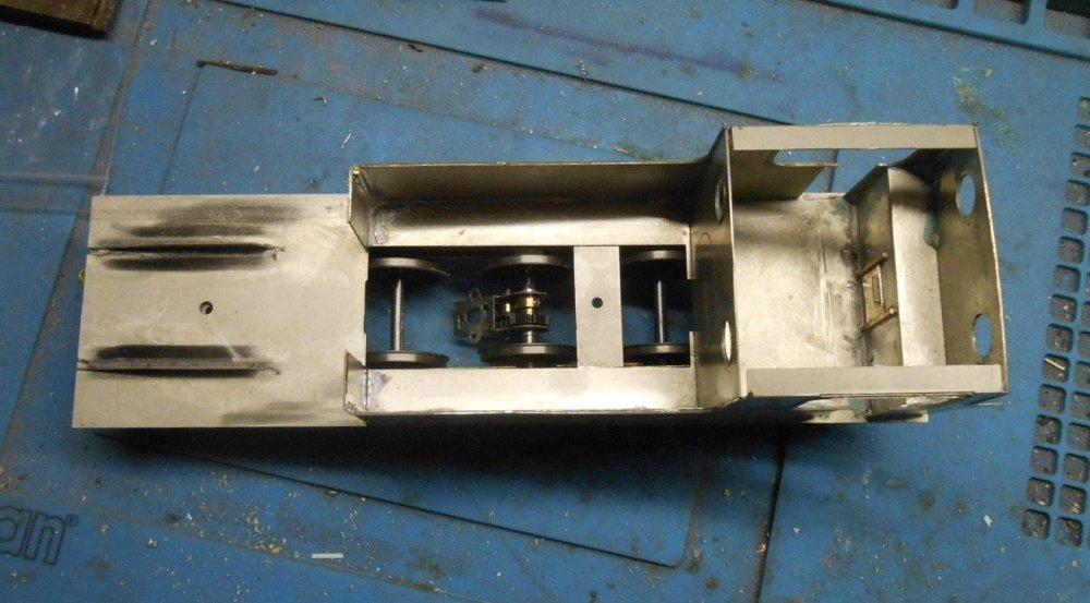

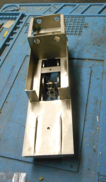

 This week, I've managed to, sort of, get the chassis together, but clearance problems are everywhere.
 First up, there's the usual problem of outside cylinders being very close to the crankpins of the lead drivers. I've slimmed down the crankpins as much as possible, but things are still tight at the moment, so I may well need file down the the outside cranks as well.
 On the Barclay 4-6-0T, I had the frame spacers much narrower, but can't do that with the removable horn blocks. Even with the slimline High Level versions, they still take up a couple of millimetres, plus experience with the Barclay chassis taught me I need a millimetre of side play on the rear drivers, while the dummy outside springs need another as well.
 As you can see, the cylinders, slider bars and motion brackets have been added, though at times I've wondered if it would have been easier to make these myself, as the etchings have needed a lot of work. The cylinders and motion bracket were a single etch, designed to fit into slots in the frames, once folded up. However, this would have been way too narrow to clear the cranks, while the motion plate section fouls the driving wheels. Hence cut out the centre section and mounted them separately on each side. The motion bracket has needed a fair bit of fettling too and I've had to mount it slightly forward of the etched position as the front outside cranks were fouling it.
 The slide bars were similarly awkward. I think they were designed to be a folded up unit, but again, I decided to cut them up and assemble them separately. Indeed, if I'd had the right section brass strip to hand, I would have used that instead.
 It is perfectly possible that the Slater's outside cranks are too big for how the etches were drawn. However, Gibson 4mm scale cranks are too small, while I certainly don't want to make my own.
 Overall, the hornblock/bearings are proving their worth, as while trying to sort out clearances, the wheels have been in & out multiple times and fingers crossed, this is keeping the driving wheels tight on their axles.
 So, lots more fettling needed, but getting there. The picture below is upside down, because the bearing retaining wires aren't fitted at the moment and I don't want the wheels to fall out!

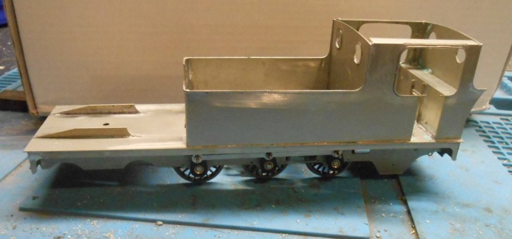

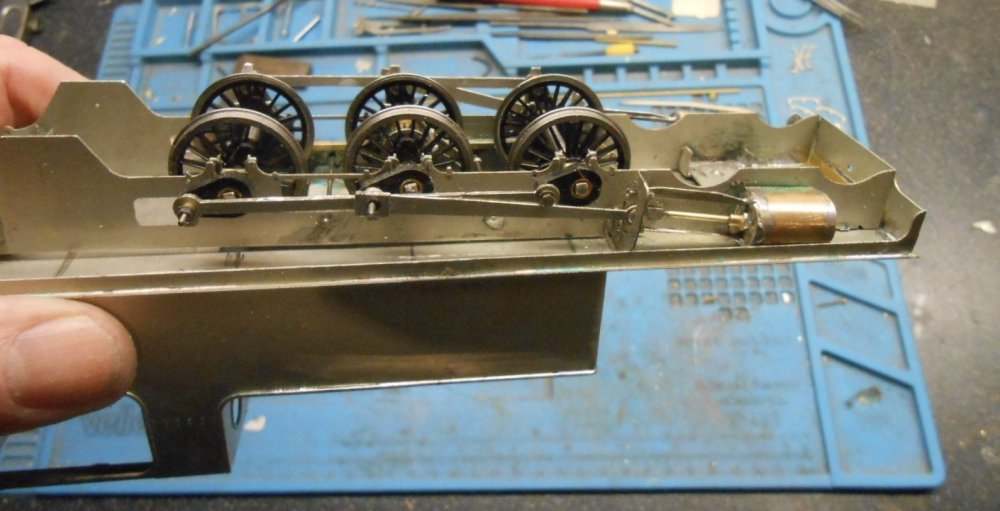

 It's been a hard day's night - and I've been working like a dog. Well, not quite, but I do at last have a smoothly working chassis for the Kerr Stuart.
 After that previous post, I sat down and made a list of all the things that needed attending to, then stripped everything off the chassis to go through it all bit by bit.
 Started by moving out the slidebars, so the crossheads would not foul the leading crankpins and at the same time moved the position of the motion brackets forwards so the crankpins didn't foul them either. While I was at it added the cross wires for the top brake hangers, leaving the latter loose until the wheels were fitted.
  Thought it was time to add the motor to the gear box and then refitted the wheels, adding the retaining wires to the horn blocks, so nothing falls out.
 I'd hoped to add the etches depicting the actual horn blocks, but even after significant thinning down with a file, there just isn't room, so they will have to be omitted. Fortunately, the cranks will mostly hide this, especially with everything painted black. Did drill holes for the underslung springs to eventually be fitted.
 Before this, I'd sprayed the chassis with primer & then matt black
 So far, so good, but that was the easy bit, as the last week has been spent fettling and fine tuning the chassis. As I'd said earlier, clearances are tight all over the place.
 The slidebars need to be set so the crosshead works smoothly and doesn't foul the motion bracket and the piston rod doesn't hit the cylinder.
 Fag paper clearances here, as shown above.
 The front crankpin nuts needed to be filed really thin, with the base of the crankpin bearings similarly thinned to a minimum. Both the front and centre cranks are fitted close to the frames, to give minimal side play. The rear cranks allow about a millimetre each each way and this also helps the fact that the slide bars have had to be set so they are gently angle away from the frames - again to clear the front crosshead. This at least allows the piston rod to be in the centre of the cylinder, the common alternative to this is to place it off centre.
 Annoyingly, despite the coupling rods working nicely on the ends of the axles, once the cranks were fitted, things got tight, so a lot of time has been spent gradually opening out the holes in the rods, which meant repeatedly  taking them on and off - risking the wrath of the carpet monster should I drop any of the 12ba fixing nuts and washers, both of which I have very few spares at the moment!
 Finally, about 5pm this afternoon, everything was at last running smoothly. The temptation to pour a stiff drink and then lie in a darkened room for a while was considerable!
Edited by David Holman
  • Like 8

Would be interesting to test the compromises necessary to assemble a 7 or 4mm---5'3" gauge model of an outside cylinder loco like an 800 or Compound with the same or similar wheel profiles to the current generation of rtr models.
Edited by Mayner
  • Like 5
Thanks John and also useful to see how you arrange the bogie and pony swivels too. Reassuring to know that folk with your experience and expertise also have these challenges. Did wonder if I'd need to reverse the crankpin bush, but there is just about enough room - with a slight crank to the conrod.
 At least the position of the bogie on the Kerr Stuart is largely out of the way of the cylinders, because it is inside the frames, though as the next job, that may yet try to bite me.
 Hats off to the P4/S7 and 2FS folk. Really can't contemplate working to such fine tolerances!
It's those tedious little details that take the time and tax the patience! And there's always that moment when you think "Why am I doing this? Isn't there something decent on the TV I could be watching instead?" But then there's the great sense of achievement when it comes good and you remember why you do it. Great work David. The stiff drink and the lie down both well earned!

Bogie and Pony
 Not an interesting name for a pub, just the next stage in the Kerr Stuart's chassis, with a fair bit of faffing and fiddling along the way. Both units are simple fold up etches, though in the case of the bogie, one side broke off while I was folding it. Not to worry though, because it turned out that it was a tad too wide, so I filed a bit off before soldering it back.
  The Gibson wheels are on 2mm axles, so it was just as well I had some 2mm brass wire, along with the right bearings. The outer plate, on the left. is intended to fit in slots on the side frames, but doing this means it fouls the wheels, so had to adjust that. The etches have a bogie pivot plate, so that was soldered on, as were four pieces of square section brass tube as part of fabricating the outside axles boxes.
 There are several spare frame spacers in the etches, so used one of these as mounting point for the bogie swivel, putting it just in front of the leading drivers. Notice how the bogie frame spacer has a slot filed in it. This is to go over an 8BA bolt soldered in the main frame spacer.
 Tried using another spacer for the pony swivel, but this fouled the rear drivers, so made a new one from some brass strip, which sits on top of the frames, just clearing the rear drivers. Looks like I'll need to line the inside of the frames with 10thou plastic to avoid the pony wheels shorting out. Both bogie and pony are full of lead, hopefully to help them stay on the track.
 At the moment, both units appear to sit nicely, but no doubt adjustment will be needed. Indeed, already had to cut away sections of the front frames to clear the bogie wheels.
 On the real locos, it looks like the pony wheels lived in some sort of radial axle boxes. On the model, they pivot inside the frames, with etches enabling you to build up dummy axles boxes on the outside of the frames. There are four separate layers to give a nice bit of depth.
 Was hoping to find some white metal castings to represent the outside axle boxes on the bogie, but couldn't find anything suitable, either on line or in the scrapbox. So went back to John Ahern's book for ideas & realised that with that square section brass tube & some plasticard, I could make a reasonable representation, as shown below. I could do with thickening up the dummy equalising beam between the two boxes, as this looks a lot heftier than a single layer of nickel silver provided in the etches.
  Anyway, so far, so good, though I'm not  kidding myself that it is all going to work first time of asking. Need to fit the pickups and wire up the motor first, but at least there is plenty of space to fit these and likewise room in the bodywork for extra weight if required. For now at least, the chassis appears to sit nicely on the track.
