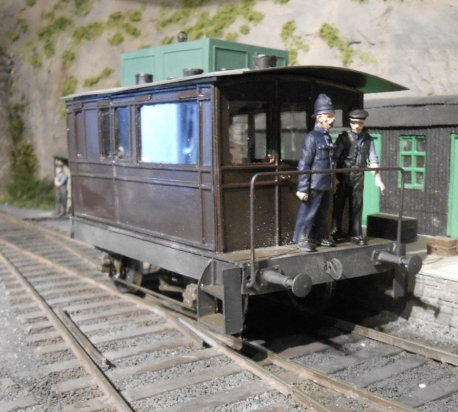

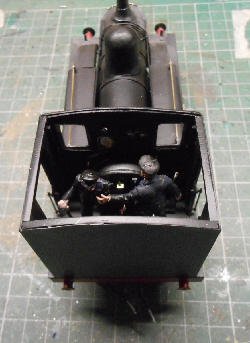

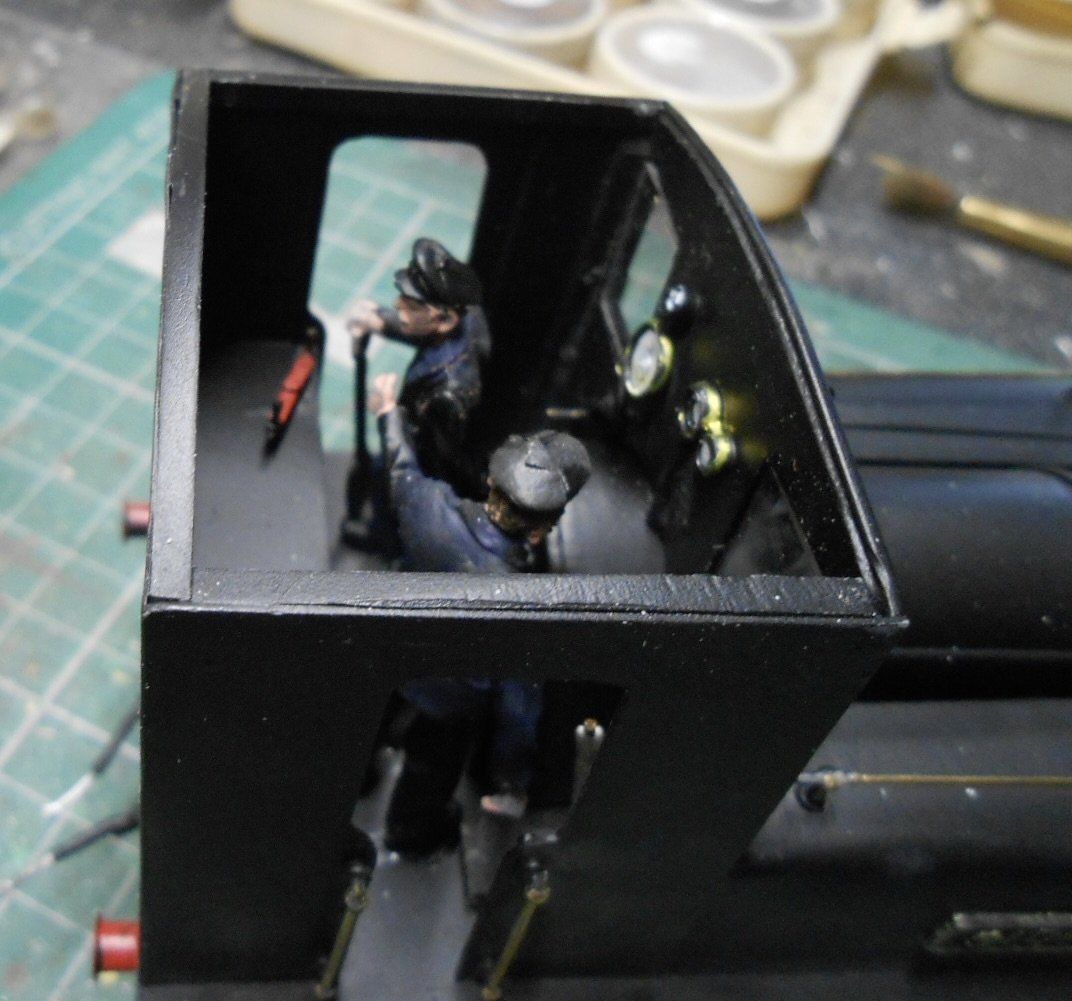

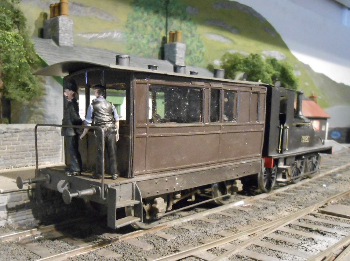

 A tad more progress with the pay train, but still keep finding stuff to do.
 Loco crew and a policeman arrived promptly from S&D Models, so they have been painted and positioned on the loco and coach balcony. However, made a bit of a horlicks with the loco cab roof, while the transfer rivets haven't turned out as well as I would have liked either. So, new roof and a sand down of the loco buffer beam and coach sole bars needed, so I can apply individual plasticard cubes to better represent the rivets.
 Meanwhile, also realised I'd missed out the the water tank filler caps...
 Ho hum!
  Have decided I won't apply lining, as judicious use of weathering powders has taken away the overall blackness which I've never liked. More weathering to do on the chassis though. At times I wonder if a model is ever finished.

Now that’s lovely. Really looks the part. I should point out that RIC uniform was dark green and tended to be topped off with a flat cap, although helmets were worn on occasion. My great-grandfather was an RIC sergeant serving from the 1890s up until 1922 - making the papers on one occasion for nicking a GNRI driver who was misbehaving at 2am on Derry’s walls…..
Yet another little job then, but thanks for the info - I just looked up Edwardian policemen, reasoning that uniforms would be the same, given Ireland was still part of the 'empire' then.
 Every day's a school day!

I think he might pass for a member of Ireland's other police force at the time, the DMP: Dublin Metropolitan Police. However, as the name implies it wouldn't have had jurisdiction down the country in places like Northport Quay

Sorry 😔 Yes, it was an unusual model of policing outside Dublin.  The RIC were armed as a matter of course (DMP followed UK unarmed pattern, later adopted by the Garda). Rifles/carbines were carried at the trail, as with Light Infantry and Gurkhas. You were never allowed to serve in your native area, as family pressure could be brought upon you to bend the law. My great-grandfather, although from SLNC territory, spent his career entirely in BNCR country. The modern Rifles regiment of the British Army looks just like the RIC on parade !

Indeed - since been looking up the history (ok, Wiki). Seems they were armed to the teeth and almost paramilitary in nature - perhaps unsurprising given that things got volatile at times, long before the Easter Rising.
 The pay trains would have been quite a tempting target, so am guessing my coach 'strong room' may have contained a small arsenal, as well as the cash! Fairly sure Henry Forbes of County Donegal fame chased off would be attackers of one of his trains - armed with a pistol, I believe.

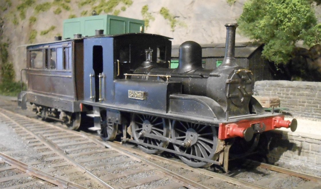

Sorry for not responding properly before. I think 'SIDHE' looks excellent, well done in creating such a unique and attractive model  which is pretty much hewn from raw materials.
I sometimes find myself looking back critically on a completed model and thinking 'I wish I'd done xyz' but I'd bet no-one else would notice the minor shortcomings, and once it's placed in the cabinet or on the layout I'm happier to move on to the next challenge.

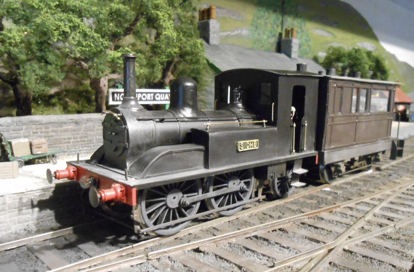

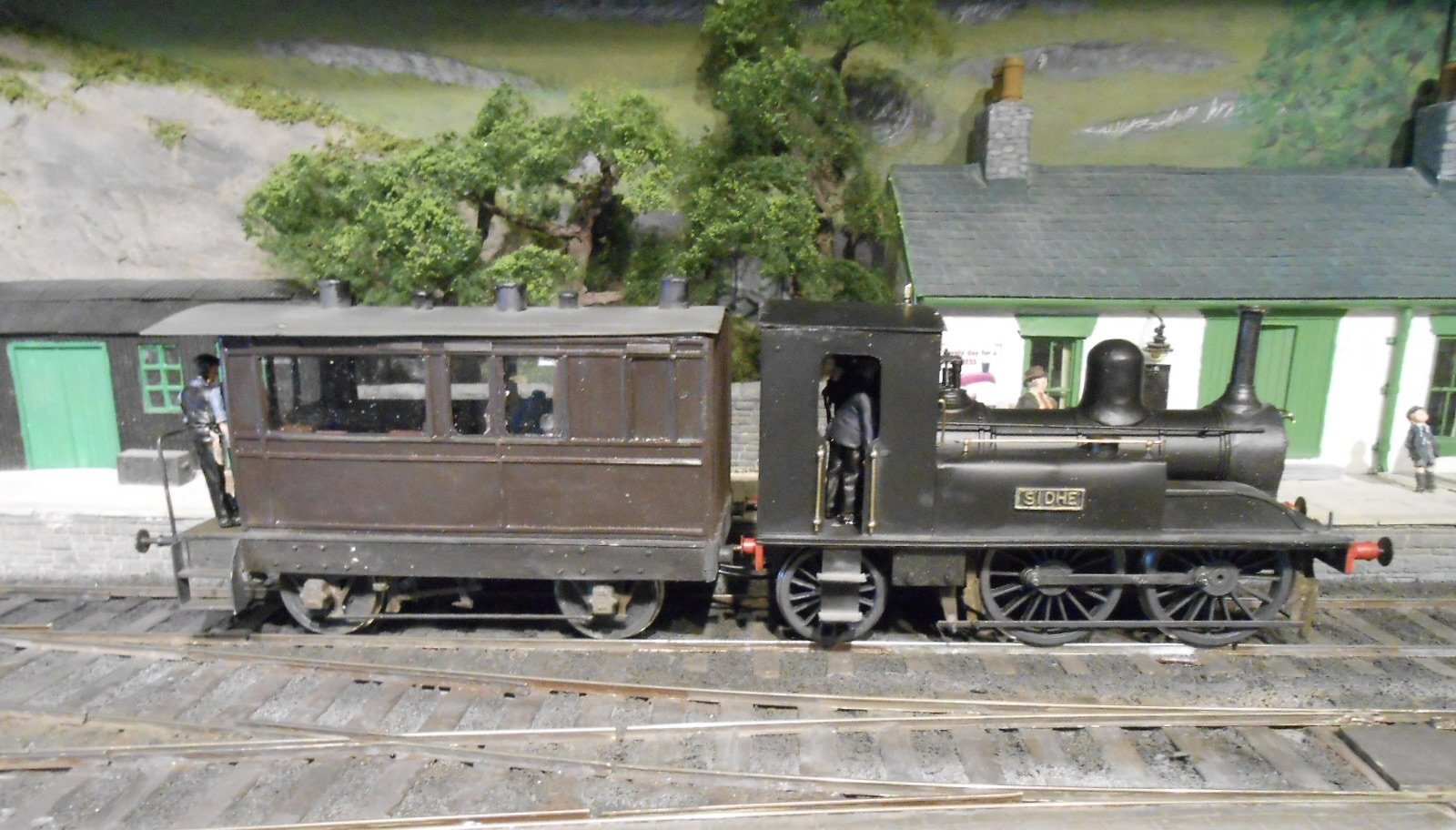

 While I will probably tinker a bit more with the pay train [the carriage windows need cleaning for one], have taken it as far as I want for now.

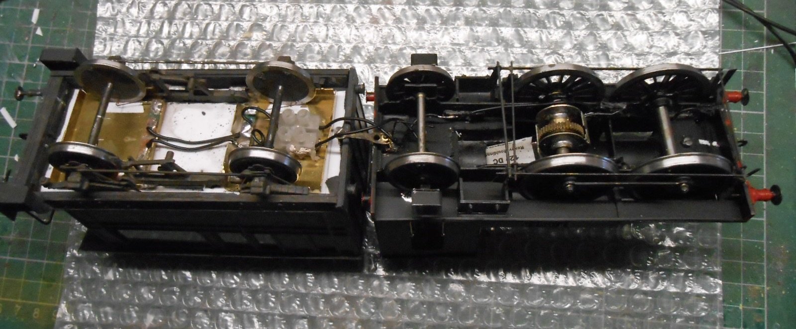

 The policeman has a dark green uniform, the loco has a new cab roof, while the rest of the work has been around wheel cleaning and testing. The latter involved a bit of fiddling - the pickups needed adjustment and the wheels were pretty paint splattered, but mostly I needed to find a way to connect the loco and coach electrically, to ensure a good length of track pick up.
 In the end used a chocolate block connector, epoxied to the underside of the coach, so I could run two wires from the motor to it, while still being able to separate for maintenance. Initially, running was a bit hesitant, but soon traced this to the trailing wheels on the loco being far too tight and the leading carriage wheels not touching the rails [!]. Eased the former and undid the nut on the draw bar a few turns for the latter and, fingers crossed, all is well. The combo runs nicely into Northport Quay's platform, though if I ever want to run it into the loop, it will need a longer drawbar. For now though I'm happy with it as it is.
 So, there we are. I'm going back to my 0 gauge cameo for my next projects, having a go at some buildings and scenery for a change. Speaking of 0 gauge, took the Battle of Britain pacific down the club last week and it seems mostly happy on the the main circuit, though It may be that the springing on the front bogie still needs attention. For now though I'm looking forward to doing some modelling that doesn't involve motive power!
