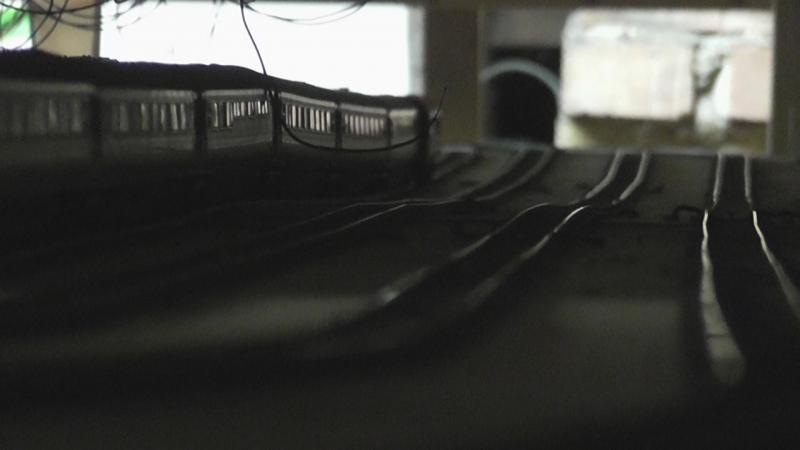

burnthebox Posted March 28, 2017 Posted March 28, 2017 For what its worth, Everard Junction has begun to strip down his layout !!! & it's not pretty ! BTB Quote
jhb171achill Posted March 28, 2017 Posted March 28, 2017 A superb layout - wonder what he's doing with it! Quote
Noel Posted March 28, 2017 Posted March 28, 2017 (edited) A superb layout - wonder what he's doing with it! He used MDF baseboards which he says warped over time in his loft. What a shame, his layout construction videos are legendary. Watching that video I'm glad we chose marine grade 9mm ply 23 years ago. Its heart breaking seeing that. Redoing the electric cabling alone would be a massive task. Edited March 28, 2017 by Noel Quote

Dave Posted March 28, 2017 Posted March 28, 2017 His baseboard construction was crap. He said it himself in the video. Even if he used ply it still would have warped because it was not supported properly. MDF gets a bad rap because people do not understand how to use it. Quote
murrayec Posted March 29, 2017 Posted March 29, 2017 (edited) Hi Yes it looks like it was an amazing layout, such a pity after all that work In my opinion its not the materials alone that caused this problem, two main points strike me- first is the location, and second is the carpentry;- Location. An non insulated attic is not the place to construct a timber baseboard and model railway layout, the temperature differentials can be extreme, in winter its like been out doors and in summer without huge ventilation, like being in a sauna. Ply, MDF, planed and wroth timber in these sizes will not tolerate these differentials, this will also cause trouble with condensation on the railway layout and the models. Insulation is required to at least control the environment and reduce extreme changes in temperature which causes expansion and contraction in timber, and dampness in models after use and left in the attic to cool down- moisture!! the more insulation the better. Carpentry. Its not the materials, beside the point above, its the method of construction and the 'proof is in the pudding' which is the video- I can see;- no box construction in large span panel, no continuous down stand support under the helix, and some really poor carpentry details. He says it himself that he has learned a thing or two but to blame the materials I believe is not correct. I would recommend the purchase of a good carpentry book and a bit of time studying it. key points I would also recommend are;- to build with box construction, think 'Box' all the time, have no boards with free edges, they have to be supported with down stands preferably deeper than wide and not square, build in sections with expansion joints especially if making fixings between a brick wall and a timber attic structure- the brick is going to stay put, but the roof structure is going to move and that could include the floor! I admire the fact he is recycling Eoin Edited March 29, 2017 by murrayec Quote
