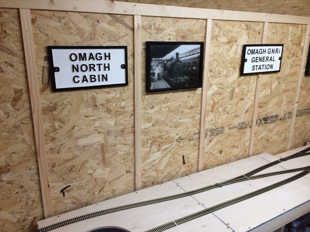

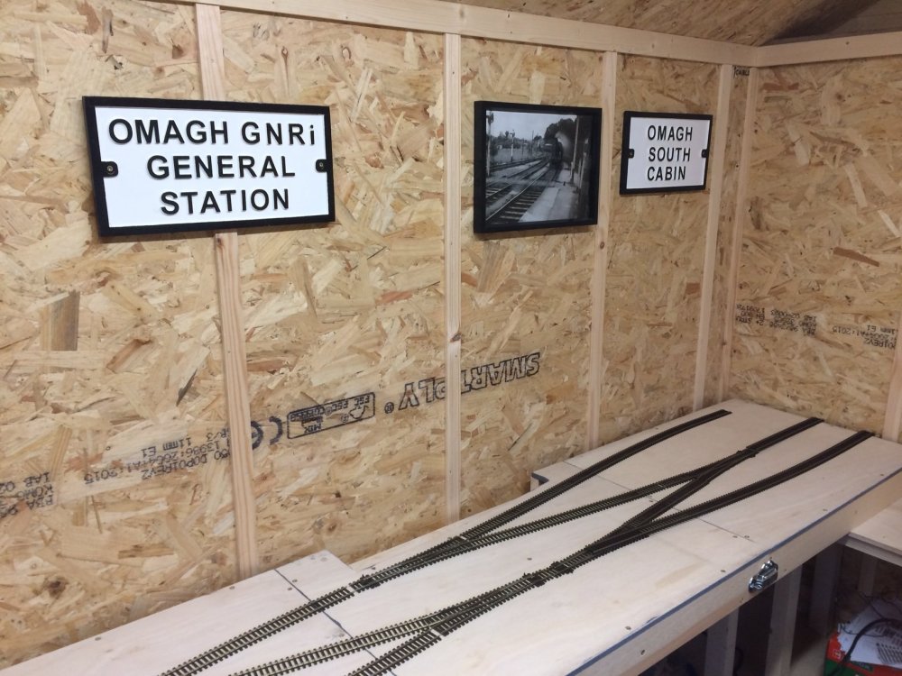

GNRi1959 Posted March 16, 2018 Posted March 16, 2018 (edited) After many months of doubt and determination, Code 75 track and pointwork was temporarily placed on my baseboards and Omagh Goods Yard took its first breath. This time I used a well thought out plan that was simple and operational, with lots of advice and guidance from many. Five sections, including a fiddle yard were all built from new with no expense spared. Brass pattern makers dowels were used on all sections for good alignment and quality sprung suitcases catches that hold all sections together. Leaving the possibility of exhibition possible, though not essential. None of the track you see is fixed so I am still open to suggestions. The layout is goods only - focusing mainly on the Yard at Omagh and more interesting the movement of loose grain from wagons to the waiting grain lorries of Scotts Excelsior in town. A dropped section will allow for unloading loose grain from chutes on grain wagons to waiting lorries below and in latter years when wagons of bagged grain were unloaded onto Scotts flat bed lorries by hand. This has been verified by both employees of Scotts Mill and ex-GNRi shunters, still alive in Omagh today. A scratchbuild turntable, will turn locomotives at one end of the layout and a small fiddle yard will allow for storage and operation when exhibiting. When the track work is finalised a 3mm cork bed will be glued in place. The replica cast-iron signs were made by a friend, who does this type of thing as a hobby. Don't they look really well! Edited March 16, 2018 by GNRi1959 3 1 Quote
Noel Posted March 16, 2018 Posted March 16, 2018 Well done Tony. You've cast off and you are now underway making way. (forgive the nautical analogy). Best of luck with the ongoing development and most importantly of all, I hope it proves an enjoyable journey for you. Quote
Patrick Davey Posted March 16, 2018 Posted March 16, 2018 Good luck Tony - great too that it might make it out to the exhibitions, that's great news! Best of luck and yes, enjoy the journey! Quote
PaulC Posted March 16, 2018 Posted March 16, 2018 Great to see this up and running again GNR. It sounds like you have a great plan for the layout with a clear idea of what you want from it and the option of making it exhibition worthy is an added bonus for us all. Is the gap at the back of that centre board to do with the drop down chutes or is it for something else entirely? Paul Quote
GNRi1959 Posted March 16, 2018 Author Posted March 16, 2018 13 minutes ago, PaulC said: Great to see this up and running again GNR. It sounds like you have a great plan for the layout with a clear idea of what you want from it and the option of making it exhibition worthy is an added bonus for us all. Is the gap at the back of that centre board to do with the drop down chutes or is it for something else entirely? Paul Thanks Paul. That drop is for the lorries that backed up against a retaining wall below the track level. The grain was unloaded from the siding above. Quote

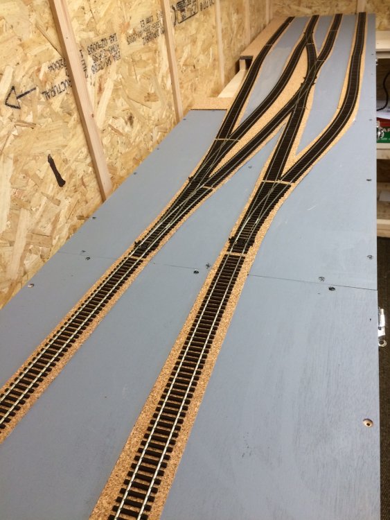

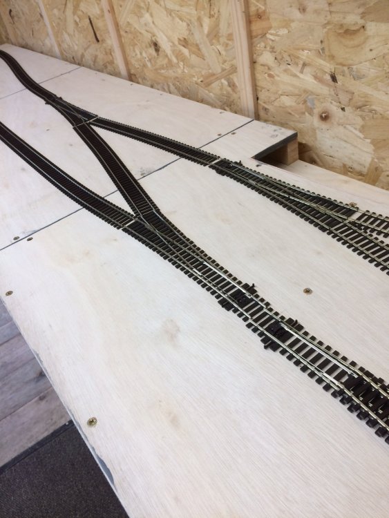

GNRi1959 Posted March 17, 2018 Author Posted March 17, 2018 I see obvious problems at the moment where in the middle photograph the sidings need lengthening. I can remedy this by moving some of the point work ‘right to left’. Quote

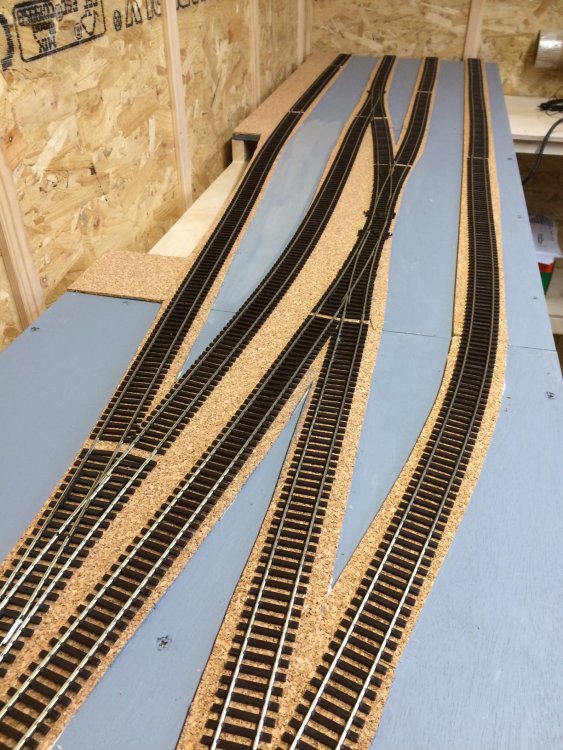

GNRi1959 Posted March 23, 2018 Author Posted March 23, 2018 (edited) Finally decided to use 3mm cork underlay which I stuck down this morning. I painted the uncorked remainder of the baseboard tops with a quick drying acrylic grey primer. Looks good, some serious track laying should start this evening! Edited March 23, 2018 by GNRi1959 1 Quote
GNRi1959 Posted March 23, 2018 Author Posted March 23, 2018 Heres what it looks like now, track is sitting loose on glued cork. I will start laying the track tomorrow. I have to drill holes to fit point motors underneath and bore for the droppers. Out of shot, to the bottom will be the turntable and line to fiddle yard. 2 Quote

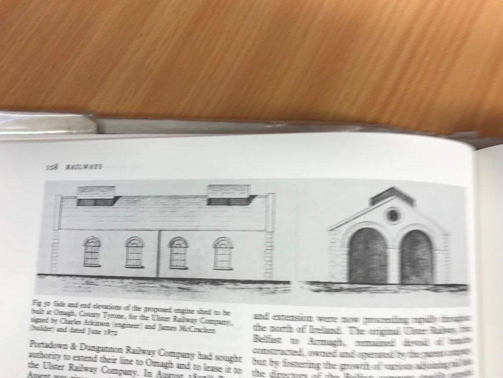

PaulC Posted March 26, 2018 Posted March 26, 2018 While continuing my quest for anything related to Ballymena railway station I was aware of the book the Industrial Archaeology Of Ireland. Now out of print the library service has one copy in circulation currently residing in its Banbridge branch. They won’t do a transfer of it to another library so whilst working in the town today I popped in to take a look. Unfortunately, there was nothing in the book that I hadn’t seen eleswhere before. This long winded intro leads me to two photos attached below I came across of Omagh. No doubt you have probably seen them before but thought I’d share them just in case. Apologies for the blurry image in the first picture, I hadn’t noticed my lack of focus when taking the pic Paul Quote
leslie10646 Posted March 26, 2018 Posted March 26, 2018 Paul (and others) The book in question is McCutcheon's "Industrial Archaeology of the North of Ireland" (only). Amazing stuff on old mills, canals etc as well as railways. A useful reference work. As you say, long out of print, but there is a copy in this house and if someone has a particular query, or wants a scan - just ask. My secondhand copy came back across The Pond from the USA. "Slasher" McCutcheon taught me at school! Leslie 1 Quote
GNRi1959 Posted March 26, 2018 Author Posted March 26, 2018 (edited) Hi Paul, Thanks for thinking of me and my interest in Omagh. The Engine Shed featured in the book was reduced to a shell during storms in the mid 50s when the roof was totally blown off. It was never replaced and the shell was all that ever remained. The beautiful stone building that was the main building stood until 1973 when it was finally demolished by Omagh District Council. Here it is in 1964 and all that remains today is the stone wall on the right hand side. Edited March 26, 2018 by GNRi1959 1 Quote

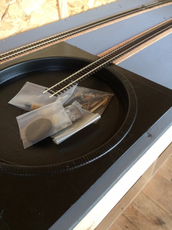

GNRi1959 Posted March 29, 2018 Author Posted March 29, 2018 (edited) Took delivery of South Eastern Finecast Turntable Kit today, looks pretty good and the components are first class. Edited March 29, 2018 by GNRi1959 1 Quote
Broithe Posted March 29, 2018 Posted March 29, 2018 8 minutes ago, GNRi1959 said: Took delivery of South Eastern Finecast Turntable Kit today, looks pretty good and the components are first class. I had the opportunity to have a look round the premises there a few years ago - a very impressive set-up. 1 Quote

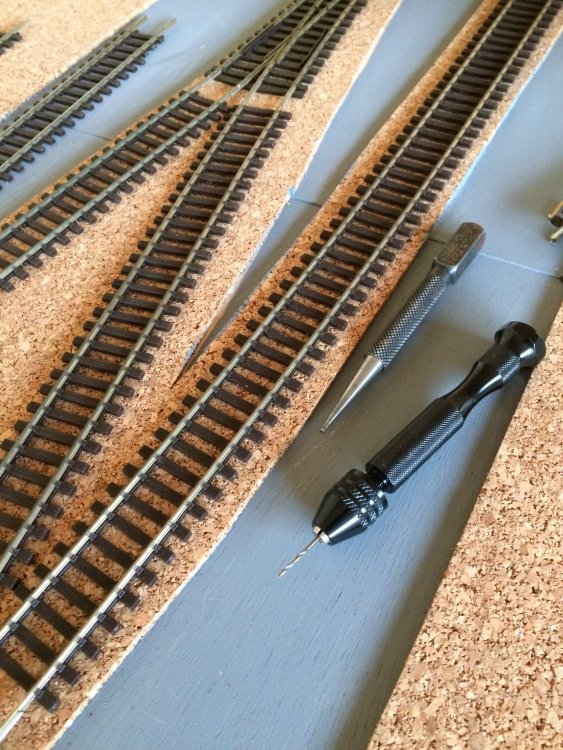

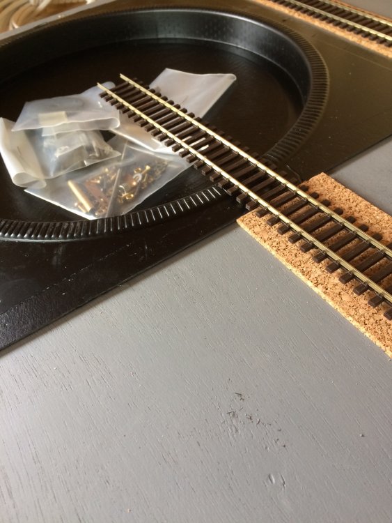

GNRi1959 Posted March 29, 2018 Author Posted March 29, 2018 (edited) Permanent Way men busy today making a start on track laying and pinning. Edited March 29, 2018 by GNRi1959 Quote
PaulC Posted March 29, 2018 Posted March 29, 2018 The turntable looks a much better proposition than the Peco alternative. Great to see the track laying started too. Quick question, your little hand held drilling tool, is there a name for it and where can I buy one? Paul Quote
Broithe Posted March 29, 2018 Posted March 29, 2018 43 minutes ago, PaulC said: Quick question, your little hand held drilling tool, is there a name for it and where can I buy one? Normally called a pin chuck, pin vice or pin vise - that one above is a real beauty! The rotating cap makes things much easier to control. There are many such things available, i.e. - https://www.ebay.co.uk/itm/EXPO-75070-PIN-VICE-with-a-3-jaw-chuck-that-holds-drill-sizes-0-1mm-to-2-5mm/312043854480?epid=782164257&hash=item48a7435a90:g:fqMAAOxyxpxQ5gEW 1 Quote
GNRi1959 Posted March 30, 2018 Author Posted March 30, 2018 11 hours ago, PaulC said: The turntable looks a much better proposition than the Peco alternative. Great to see the track laying started too. Quick question, your little hand held drilling tool, is there a name for it and where can I buy one? Paul That one of mine was bought from eBay last year for £5.99 and it really is a nice little piece of gear, I love it. 1 Quote
