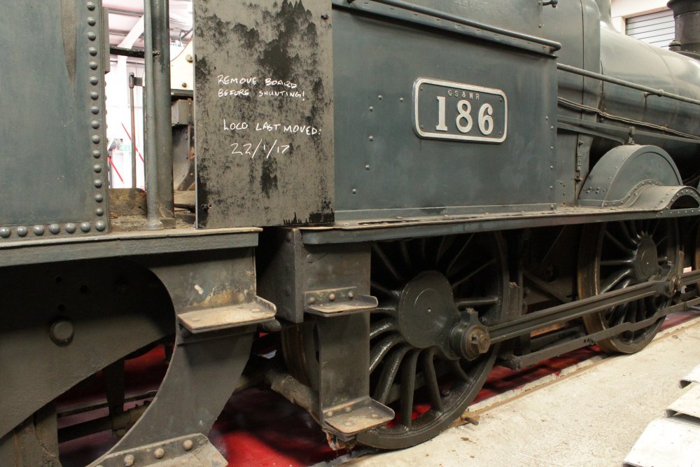

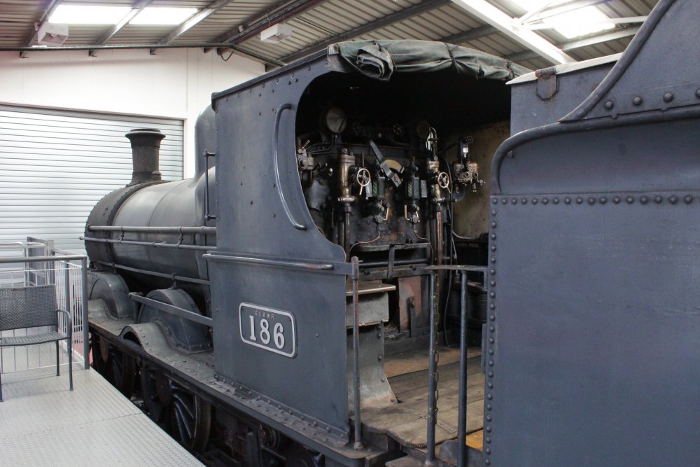

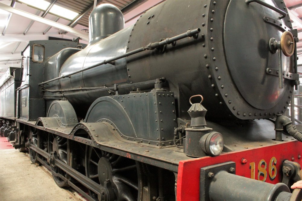

popeye Posted April 11, 2018 Posted April 11, 2018 I took some pictures a while back. Here are two that show the grey colour. 2 Quote
jhb171achill Posted April 11, 2018 Author Posted April 11, 2018 Excellent.... and if you look at the wheels in the lower pic, you can see what it looks like when oily. The upper pic shows a rare thing - what it looked like when clean in working days! Note the smokebox. It looks much darker, and it is - but this is far from prototypical. The RPSI correctly painted it grey like the rest of the loco, but because some volunteers simply thought it "didn't look right" (always a fatal mistake in historical accuracy in preservation), they "allowed" it to darken through not polishing it clean. Quote
popeye Posted April 12, 2018 Posted April 12, 2018 I was going to ask about the smoke box colour but that answers that. 1 Quote
Mayner Posted April 12, 2018 Posted April 12, 2018 A smoke box will weather differently to the boiler and smoke box cladding as its exposed to direct heat from the smoke from the fire and exhaust steam. So a rusty or burnt smoke box was quite prototypical on a hard worked loco. Quote
jhb171achill Posted April 12, 2018 Author Posted April 12, 2018 2 hours ago, Mayner said: A smoke box will weather differently to the boiler and smoke box cladding as its exposed to direct heat from the smoke from the fire and exhaust steam. So a rusty or burnt smoke box was quite prototypical on a hard worked loco. 'Tis true indeed, prototypically, but in this case the contrast is too great; the rest of the loco looks to clean to match the way the smokebox is. Quote
FiveFootThree Posted July 17, 2018 Posted July 17, 2018 (edited) Pretty sure the smokebox on 186 is just painted with matt black high-temperature paint. Same as all the other Whitehead locos. I have a RAL swatch book, I'll try and see if I can get a match sometime, though it's difficult as the paint weathers and stains from cleaning (usually the dye in red diesel sometimes used as a degreaser at WDX stains the paint a little). Edited July 17, 2018 by FiveFootThree Quote

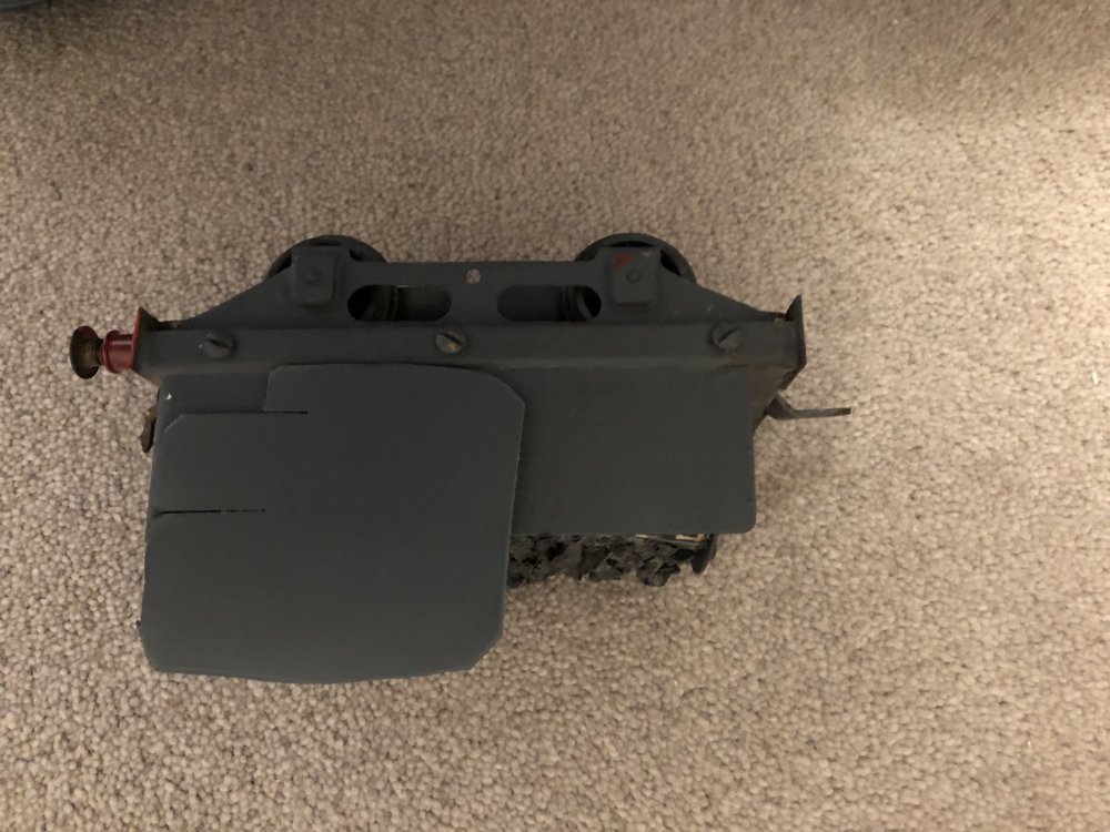

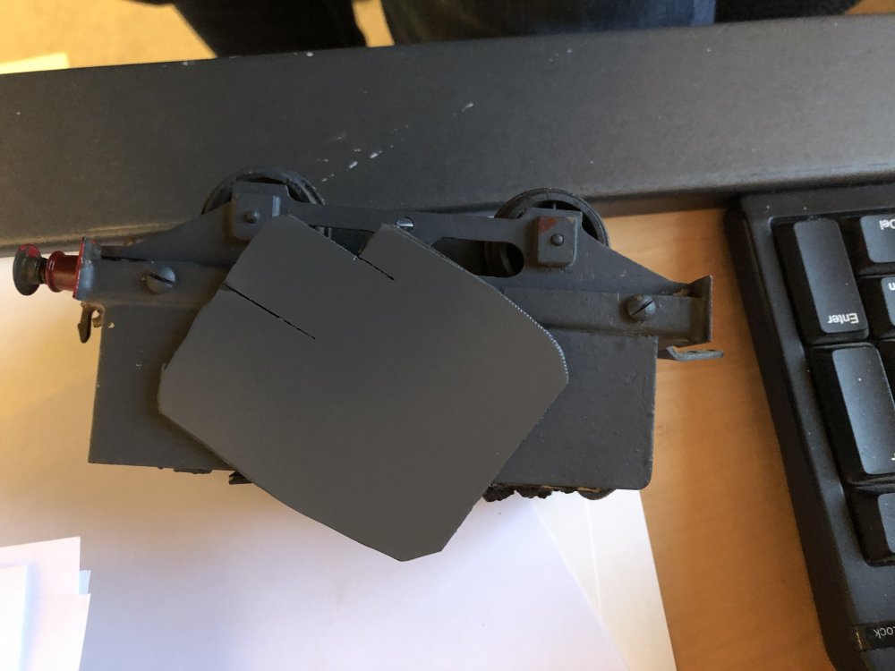

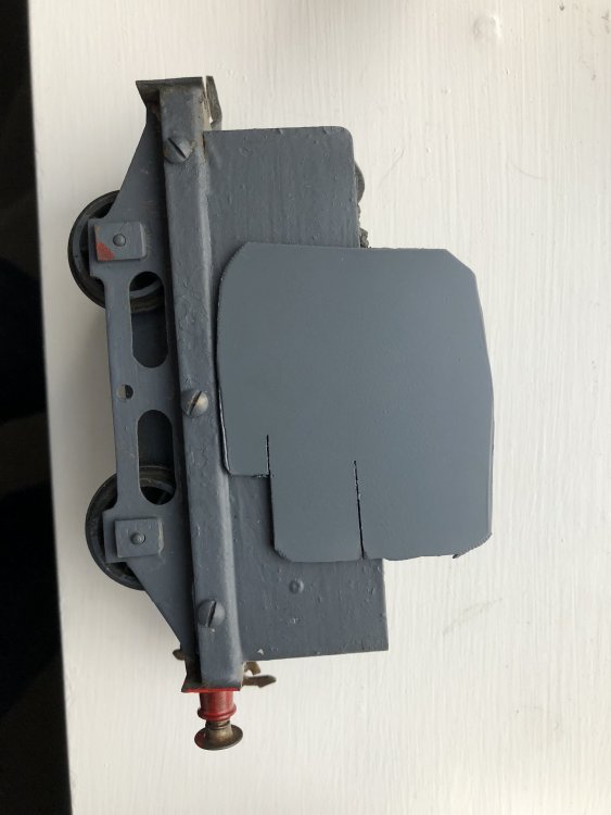

jhb171achill Posted September 8, 2018 Author Posted September 8, 2018 Finally - a correct paint match for GSR / CIE locomotive grey Thanks mainly to Roderick of 00 Works, I think we can now be sure of the closest match to what as far as I am aware, is the only surviving original sample (from about 1925 or so) of the loco grey introduced by the GSWR about 1915/8 and continued through GSR days and into CIE, right to the end of steam days in 1963. A remarkable 45 years in use, more or less equalled by CIE's various variations or orange and black 1962-2006. The model, as many will know, was built in early GSR days (and is "0" coarse scale). The paint on it is original. Roderick sent me numerous samples of greys blended from this and that. The piece of plastic seen here against the model has been sprayed with what seems the closest match, and as you can see, it matches in daylight, artificial light, and half-and-half. Presumably Roderick will now be in a position to sell this paint to anyone who wants to paint a GSR / CIE model. Naturally, upside-down reproduction of images is a necessity.....! I understand that this will be used as a model for the eagerly-awaited RTR J15. I have been trying to find, for ages, the list I got from Bob Clements years and years ago of what classes of locomotive received all-black paint in the 1955-62 period. I just can't find it! Most remained grey, as we all know, but some got lined green or black. 2 Quote

jhb171achill Posted October 15, 2018 Author Posted October 15, 2018 I'm very impressed by the colour matching and scientific approach to paint composition and so on, as practiced by the likes of Precision Paints (or Phoenix) and others. In terms of acrylic equivalents, I would contact them probably - certainly, I would be well out of my depth in trying advise on this. I've just been onto Phoenix / Precision with a string of queries, and while I await their reply, I know that I have been very satisfied with their service in the past. Incidentally, if anyone wants that bit of plastic I show above in a photo of the old O gauge tender, you're welcome to have it - I can post it. Or maybe I'll bring it to the bank holiday weekend show in Raheny and leave it with one of the gentlemen at the ECM Trains or IRM stand. 1 Quote
