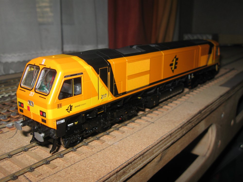

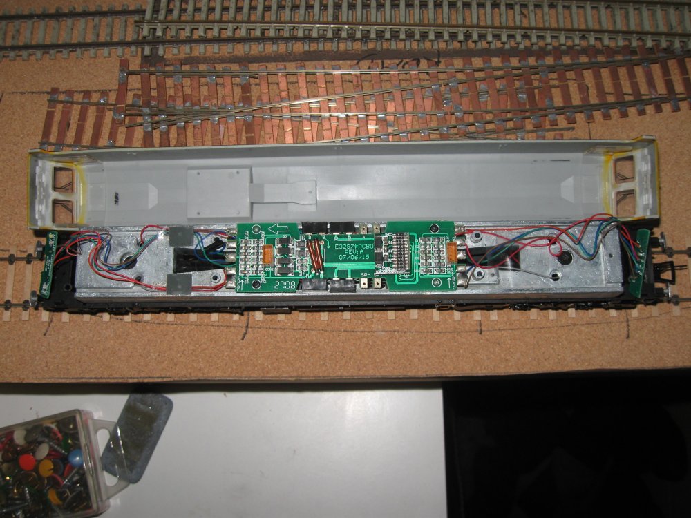

Brendan8056 Posted September 20, 2020 Posted September 20, 2020 After a failed regauging to 21mm gauge of a Lima 201 I was left with a bodyshell. I used a Bachmann class 66 chassis, which is a very good match and runs superb, and is easy to regauge to 21mm. The class 66 was a swap meet buy and I was able to sell the loco body on Ebay. I may at a future date make the lighting work. The pics tell the story. 2

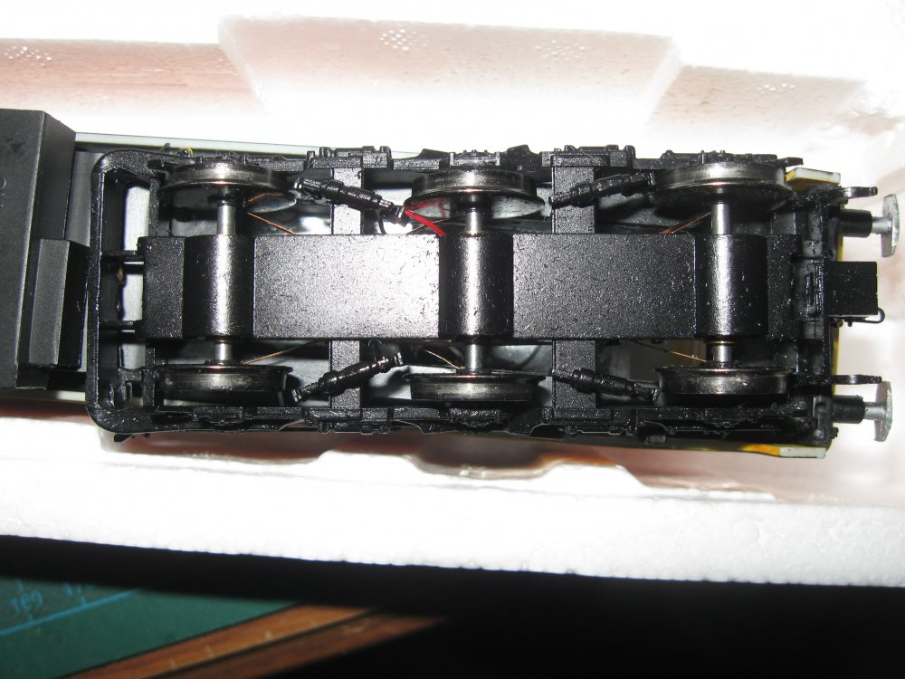

Brendan8056 Posted September 20, 2020 Posted September 20, 2020 John-r--I have turned down the Lima pizza cutter wheels on HO scale Italian wagons and railcars. The wheels are made of an easy to turn metal (brass?). Just don't try it with Jouef wheels, they really are rubbish. I use a minidrill and some files (and eye protection of course) to turn the wheels down and make the flange more shallow. DiveController--A pic of the 21mm gauge bogie on the 201 class. I used the existing wheels and gears. for the axles I used spare Romford/Maygib axles with the pin point ends filed down. 2mm steel rod would do the job as well. I recall the gear was pressfit onto the axle and I used a toothpick to apply a bit of superglue to hold it more firmly in place. There is plenty of room between the bogie sides and I moved the dampers out by twisting them slightly as they fouled the wider gauge wheels. The Murphys 141 and 071 classes have similar design bogies and can be regauged this way as well. 6
