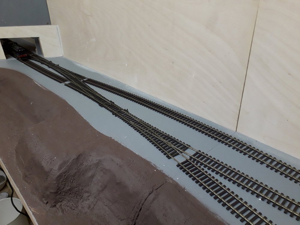

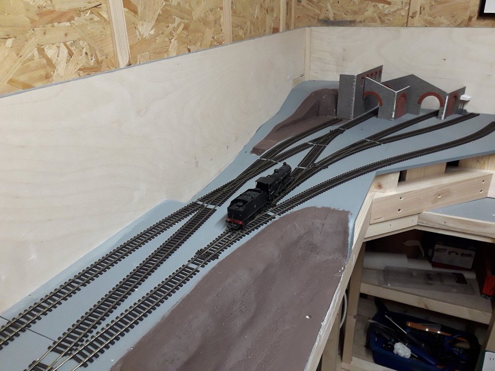

GNRi1959 Posted December 27, 2018 Posted December 27, 2018 Progress on Omagh Goods Yard is starting to take shape with the basic contours formed and track laid, though not pinned yet. The different levels give it a feeling of depth and this is something I haven't tried before, the results are pleasing. Long way to go yet but I'm taking my time and really enjoying the progress so far. 5
JasonB Posted December 27, 2018 Posted December 27, 2018 The embankment turned out well Tony. Nice work.
GNRi1959 Posted December 28, 2018 Author Posted December 28, 2018 Jason, its not bad. As you know, just a base for the scatter material and static grass to be added later!
David Holman Posted December 28, 2018 Posted December 28, 2018 Just a thought, Tony. Some of the embankment sides look rather vertical. Don't know the area at all, but grassy slopes would rarely be more than 45degrees in the real world and even a 30 degree slope is actually 1 in 2 so steep! There again modelling allows us to go steeper without much detriment to how things look, though near vertical faces would either be rock faces or require retaining walls.
GNRi1959 Posted December 28, 2018 Author Posted December 28, 2018 (edited) I actually had less slope originally, though it was pretty steep in parts..... Edited December 28, 2018 by GNRi1959

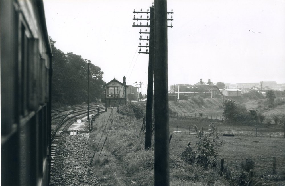

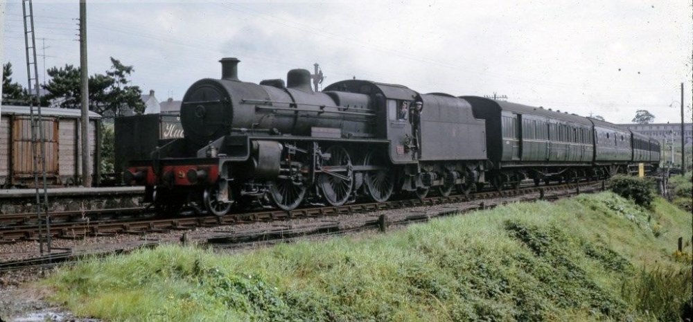

GNRi1959 Posted December 29, 2018 Author Posted December 29, 2018 (edited) 17 hours ago, David Holman said: Just a thought, Tony. Some of the embankment sides look rather vertical. Don't know the area at all, but grassy slopes would rarely be more than 45degrees in the real world and even a 30 degree slope is actually 1 in 2 so steep! There again modelling allows us to go steeper without much detriment to how things look, though near vertical faces would either be rock faces or require retaining walls. There is one part of the embankment that is very vertical and this is where a signal cabin was mounted. At this point there needed to be some sort of foundation, as in Omagh. I also recall there being steps placed in the embankments to allow easy access to the lower level where a pump house filled the water cranes for locos. However, after a sleepless night (thanks David), I was in the shed this morning reducing my slopes and adding a few more layers of plaster bandage! Edited December 29, 2018 by GNRi1959
David Holman Posted December 29, 2018 Posted December 29, 2018 Sorry to disturb the slumbers Tony, but such things are easily fixed. Looking at the photo, the slope appears to be 45 degrees or so. I'm certainly no engineer, but have a feeling that anything steeper would be in danger of collapsing on itself, which is why retaining walls are used. There's some nice thick foliage on that embankment, so longer static fibres, topped with scenic matting and scatter will replicate nicely.
Broithe Posted December 29, 2018 Posted December 29, 2018 The actual slump angle is a matter of many factors - the geology, the flora, the weather conditions, etc - this may be of some interest - https://www.newcivilengineer.com/latest/slope-engineering-uphill-rail-challenge-in-somerset/8661241.article - these days, they often 'net' slopes that worry people, even if they've been there for a long time already. A glance at local examples would be a good guide, in general.
GNRi1959 Posted December 29, 2018 Author Posted December 29, 2018 Just back in from the shed, all embankments looking less like cliff-faces. David, as you say - easily remedied now. Glad I done it! Broithe, thanks for an interesting article also. 2

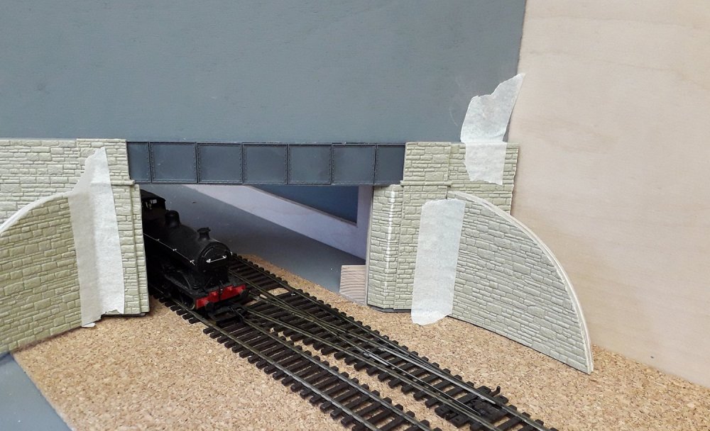

GNRi1959 Posted January 4, 2019 Author Posted January 4, 2019 Little, but some progress...... Road bridge over North Cabin end of Omagh, far from complete but getting there. Have put cork under track work - I bought it a year ago - I may as well use it. Testing track at moment and just taking my time.... 3
GNRi1959 Posted January 9, 2019 Author Posted January 9, 2019 On 1/6/2019 at 11:16 PM, Paddy Mac Namara said: like it, is that modelling clay? Paddy, no Wills Scenic Sheet glued to 1.5mm birch ply.
GNRi1959 Posted January 11, 2019 Author Posted January 11, 2019 (edited) Paddy, also Wills Scenic Sheet. I took two pieces of 1.5mm birch ply and glued them together with woodworking glue. They were clamped together and placed in a former to curve them. 24hours later they were set so l took the wills sheeting and moulded them into a similar shape by bending them gentle over the edge of my bench. I stuck the sheeting to the ply using UHU glue and when dry cut it to shape with a scroll saw. Edited January 11, 2019 by GNRi1959

GNRi1959 Posted January 11, 2019 Author Posted January 11, 2019 Paddy, if its the embankments you refer to, they were formed with plywood cut to shape as supports and paris plaster bandage draped over it. Although I used about five layers of plaster bandage I'm not really pleased with it as it is NOT rock hard like a plaster cast would be on a broken arm or leg. I think it may be because the shed was quite cold when I done it and it hasn't dried out quick enough!

Paddy Mac Namara Posted January 14, 2019 Posted January 14, 2019 Plaster is usually white when fully dry. On 1/11/2019 at 7:30 AM, GNRi1959 said: Paddy, if its the embankments you refer to, they were formed with plywood cut to shape as supports and paris plaster bandage draped over it. Although I used about five layers of plaster bandage I'm not really pleased with it as it is NOT rock hard like a plaster cast would be on a broken arm or leg. I think it may be because the shed was quite cold when I done it and it hasn't dried out quick enough!
