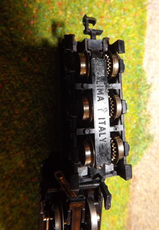

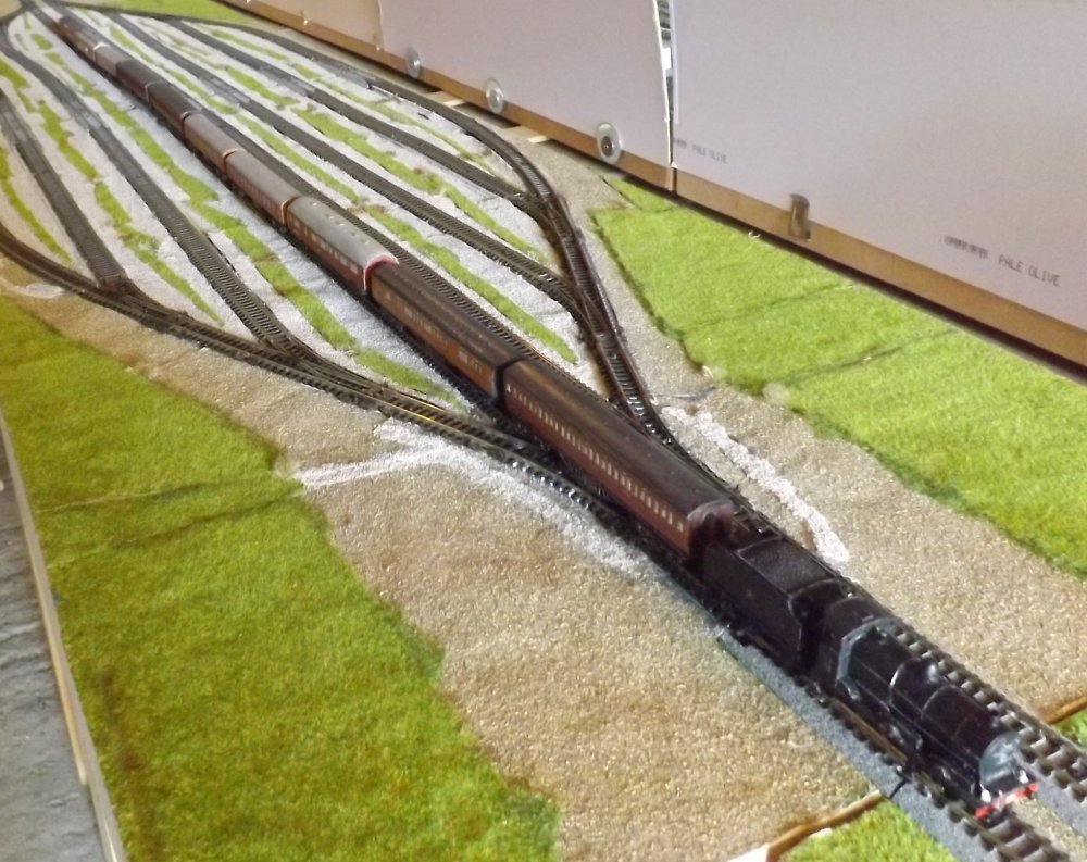

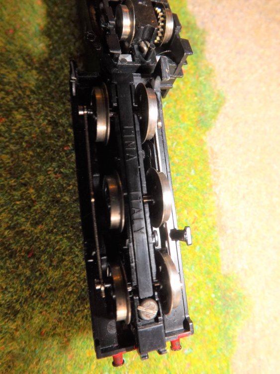

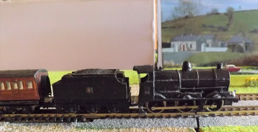

MikeO Posted June 11, 2020 Posted June 11, 2020 John You made the following comments "The Lima Irish N Gauge steam loco and passenger coaches were British outline models in CIE livery introduced in the late 70s early 80s. The Lima coaches and wagons were reasonable models by the standards of the time, but I would not recommend the locos if you want a working model. The motor, traction tyre and power pick up system was pretty poor and would cease to run reliably or haul anything after a couple of weeks use. I replaced the tender drive in a Lima o-6-0 with the chassis from a Fleischmann 0-6-0 diesel shunter which transformed the running and haulage ability." With regard to the hauling power, my experience is slightly different if I have the same type of loco being described. See photos 1 to 3 below. I have one on loan from a friend with the intention of making it vaguely Irish. I thought it resembled an SG3 so made a few changes to the original. It has always been a reasonably good, if noisy, runner. In terms of hauling power, today I had it run around my temporary layout in my garage which is 3.6m (12ft) long. It pull 10 coaches with only a little slippage staring mainly because it had not reached its optimum power setting for starting off. This is usually about speed step 6( even light engined) on my controller. I ran it around the layout several times, each loop being about 7.2m(24ft), firstly with 7 coaches then with the 10 in photo 4. The running time in total was probably only about 5 minutes. Can't show the video I took as I do not have a YouTube account. While it is fine for short runs such as this longer runs of about 20 minutes noon stop would likely be too much for it. At several exhibitions I have had it come to a sudden stop. Next day it is back to normal. MikeO 1 side view 2 and 3 shows the maker's name 4 Loco and 10 coaches Quote
Mayner Posted June 13, 2020 Posted June 13, 2020 My comments about the Lima N gauge locos are based on my experience with operating several different types of Lima N gauge locos during the 1970's including the BR AL1 overhead electric, Brush Type 2, Irish 0-6-0 and German V100/BR Clayton. The Lima V100/ painted dark blue to resemble the GNR MAK was the most reliable of my Lima diesels, these locos used the same 4w chassis with central pancake motor used in the 4w diesel shunter with pony truck at each end to resemble a double bogie loco. The Lima tender drive appears to be mechanically similar to the V100 and diesel shunter, with a reliable power pick up system and no traction tyres. I may have replaced the 4F tender drive with the chassis from a Fleischmann Piccolo 7218 diesel shunter because of motor failure or to achieve reliable slow speed running rather than poor power pick up or pulling power, I don't remember the exact circumstances as I scrapped the loco over 30 years ago. The armature of the pancake motor used in the Lima N gauge locos have a tendency to fail when the commutator work loose on the motor armature shaft and breaks away from the armature windings. The problems with power pick up and poor haulage power mainly affected bogie diesels and electrics, with a single motor bogie and pick up on the un-powered bogie, performance became increasingly poor after a couple of weeks service, with slipping as traction tyres worked loose on the power bogies and increasingly erratic running due to the poor design and choice of materials used in the power pick up system. To be fair the Lima N gauge locos were probably no worse and in some cases better than similar priced N gauge locos produced at the time for the American and UK markets. Quote
