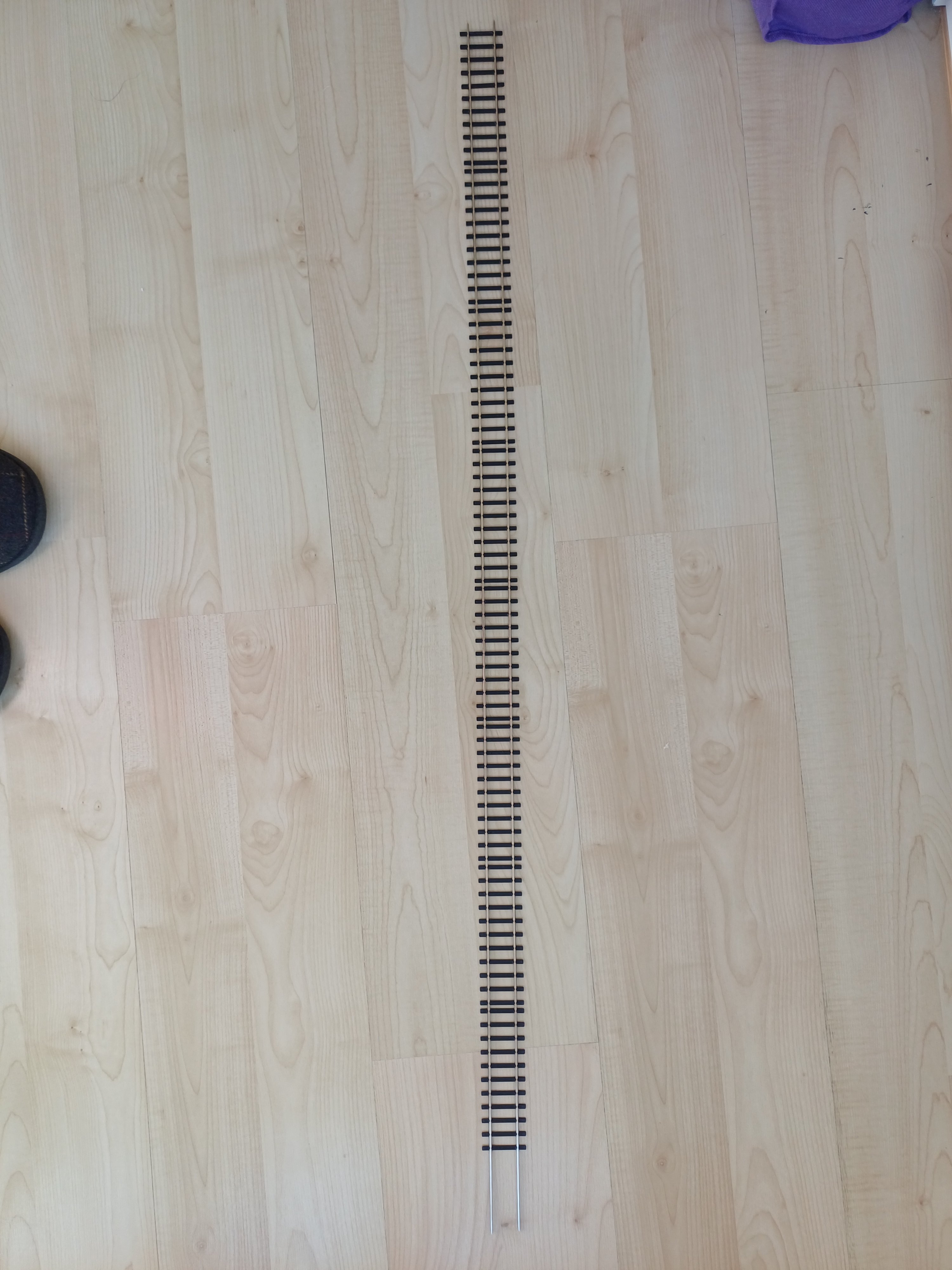

Rob R Posted March 6 Posted March 6 What does a (scale) mile and a quarter of 21mm gauge track look like? Still awaiting for one of the Beta testers to send me his postal address...... 3 2 1
Horsetan Posted March 7 Posted March 7 On 6/3/2025 at 7:45 PM, Rob R said: What does a (scale) mile and a quarter of 21mm gauge track look like? Still awaiting for one of the Beta testers to send me his postal address...... That looks suspiciously like my lot.....
Rob R Posted March 7 Posted March 7 Your lot is in there somewhere. I hope it lives up to your expectations. The last 12 metres is being posted off to the sub tropics on Monday. If anyone has any preferred specs for 21mm gauge 7mm scale (3ft) track please let me know. Rail size (code 100/83/75), sleeper sizes and spacing. Thanks in anticipation. Rob

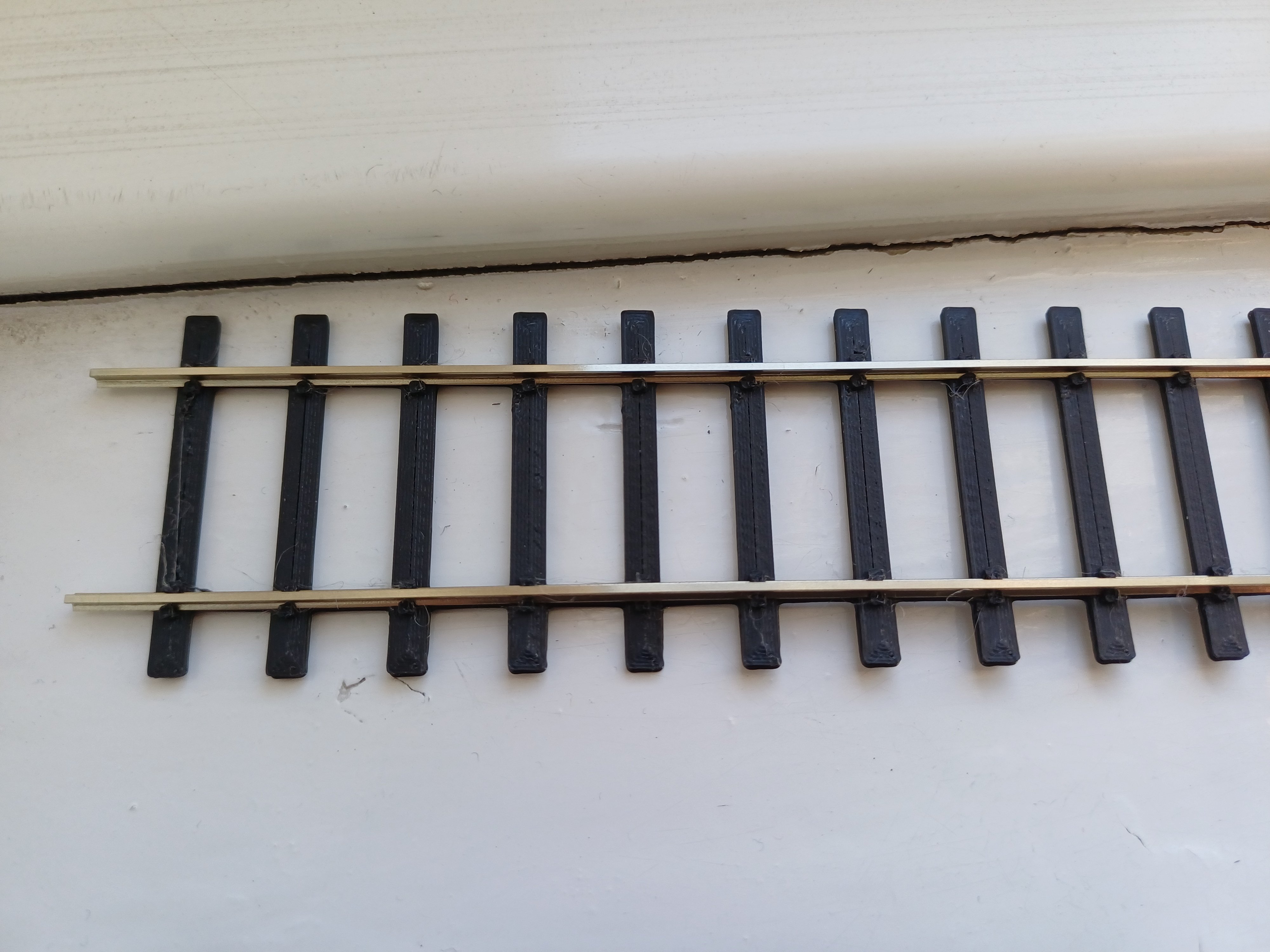

Horsetan Posted September 21 Posted September 21 (edited) Yesterday at Scaleforum, I managed to obtain a couple of lengths of Code 82 FB. Some minutes after getting it home, we had our first demo length of 21mm. This used just a fraction - just 8 panels - of the track bases supplied. I think we are cooking on gas. Edited September 21 by Horsetan Adding number of track bases sections used in 1 metre of rail 4 2
Galteemore Posted September 21 Posted September 21 (edited) Certainly surpassed the sucking diesel stage! Look forward to seeing some of your 21mm stock posing on this. Aesthetically , that 5’3” is quite captivating. I think it works especially well on FB track as the width is visually accentuated. Edited September 21 by Galteemore
Horsetan Posted September 21 Posted September 21 15 minutes ago, Galteemore said: Certainly surpassed the sucking diesel stage! Look forward to seeing some of your 21mm stock posing on this. Aesthetically , that 5’3” is quite captivating. I think it works especially well on FB track as the width is visually accentuated. If I had to nit-pick, there are a random few clips which are very loose as you feed the rail through. Whether that helps gauge-widening on curves, I don't know.....yet. That said, this is an ideal contribution to getting something running. I've loads of track bases left over, so I reckon we're going to need a lot more FB rail.... 2

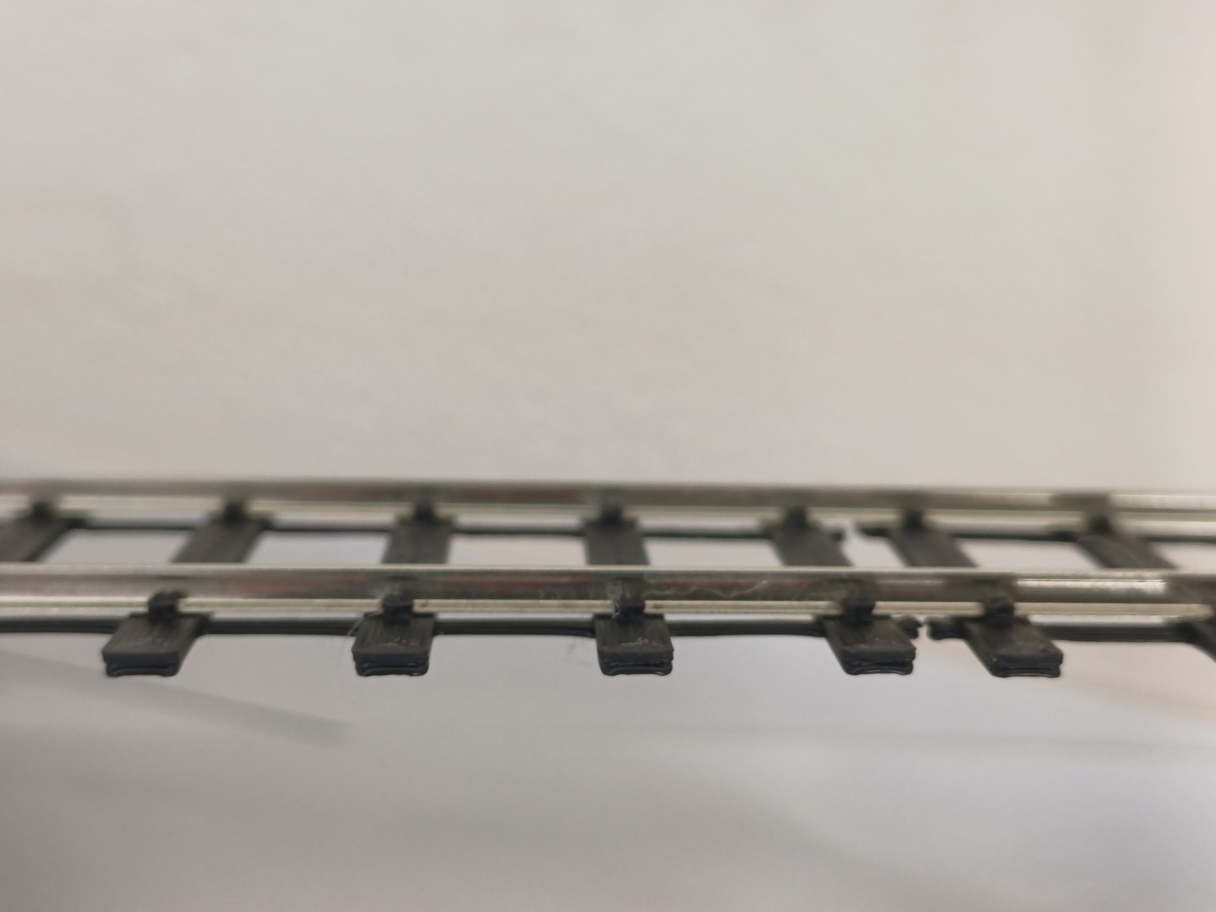

Horsetan Posted September 21 Posted September 21 (edited) Here's a side view. Doesn't look bad at all. Saves many hours of going at it with gauges and multiple packs of PECO Pandrol clips individually glued down on ABS sleepers.... I'd go as far as to say that, if you want to portray that slight air of neglect that used to hang around Irish secondary/branch line permanent way, the 3D printed bases are already much of the way there - the sleepers even have visible cracks at the end and look somewhat past their best! What would really finish it would be FB rail in phosphor bronze which has always been useful for representing corroded or rarely used rail. Edited September 22 by Horsetan 4

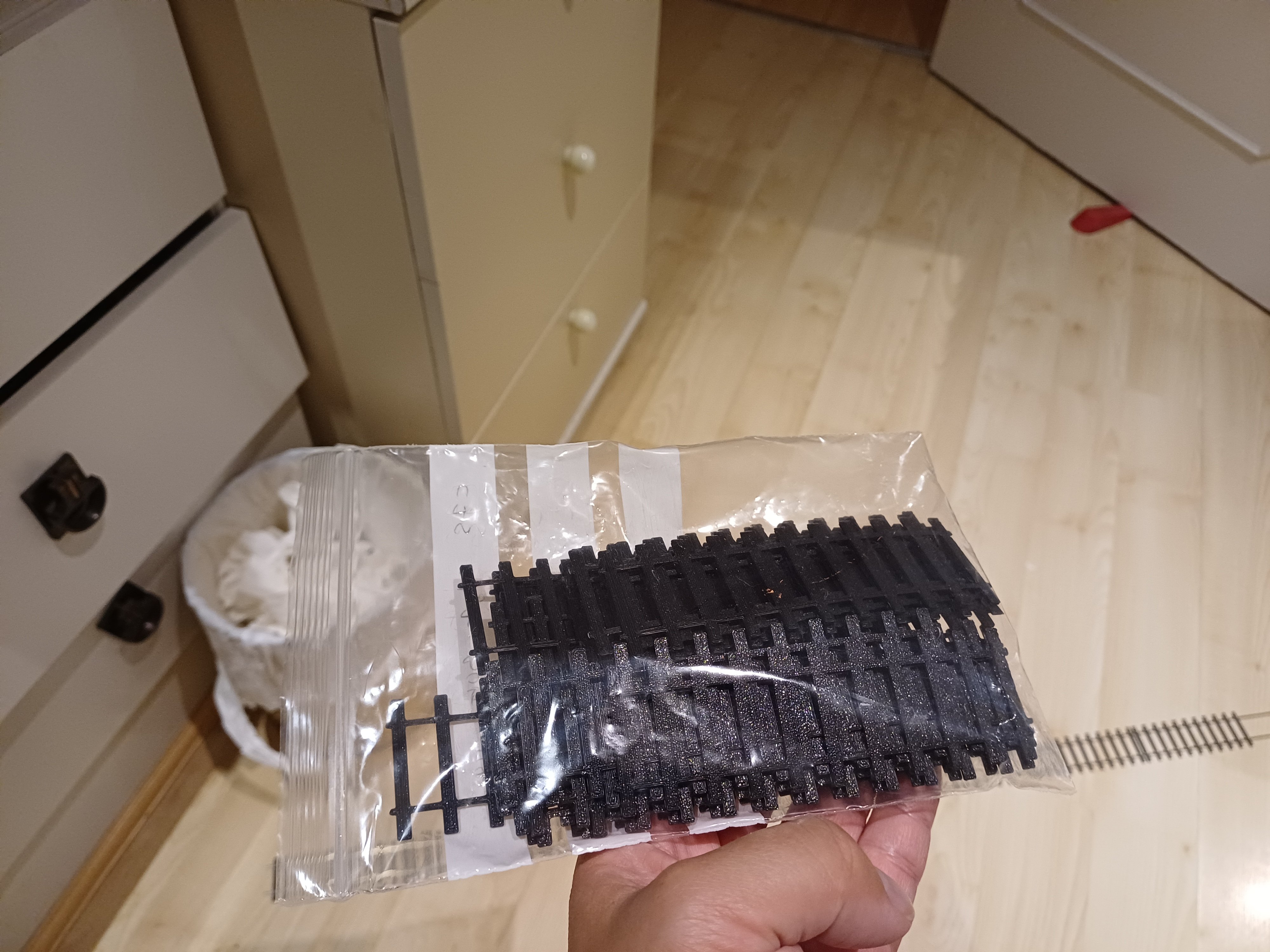

Horsetan Posted September 23 Posted September 23 (edited) 11 hours ago, Rob R said: Got another pack here if you need more.......... That's useful to know..... How many in that pack? Edited September 23 by Horsetan
Rob R Posted September 23 Posted September 23 20 I think. But I can always print more, not just yet though, flying off to foreign parts (no, not Scotland!) for a week. 1
