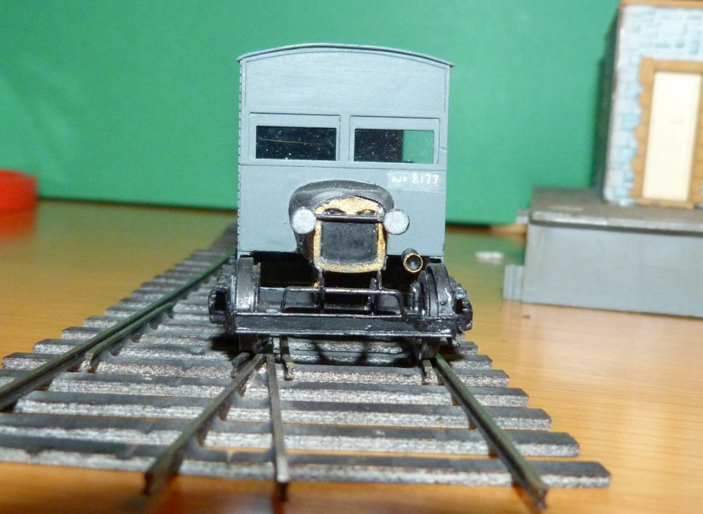

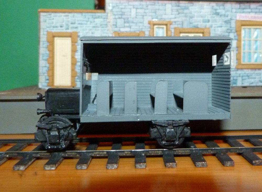

4 hours ago, WRENNEIRE said:
Found recently in the vaults
I am not sure if it is prototypical?
The writing says "Castleblaney PW Car No 8177
I will upload some stunning steam locos over the next couple of days
 GNR "Ford Platelayers Trolley" set of scratchbuilders parts available from Worsley Works for several years.
Alan sent me a photo of the fret but I never bought one!

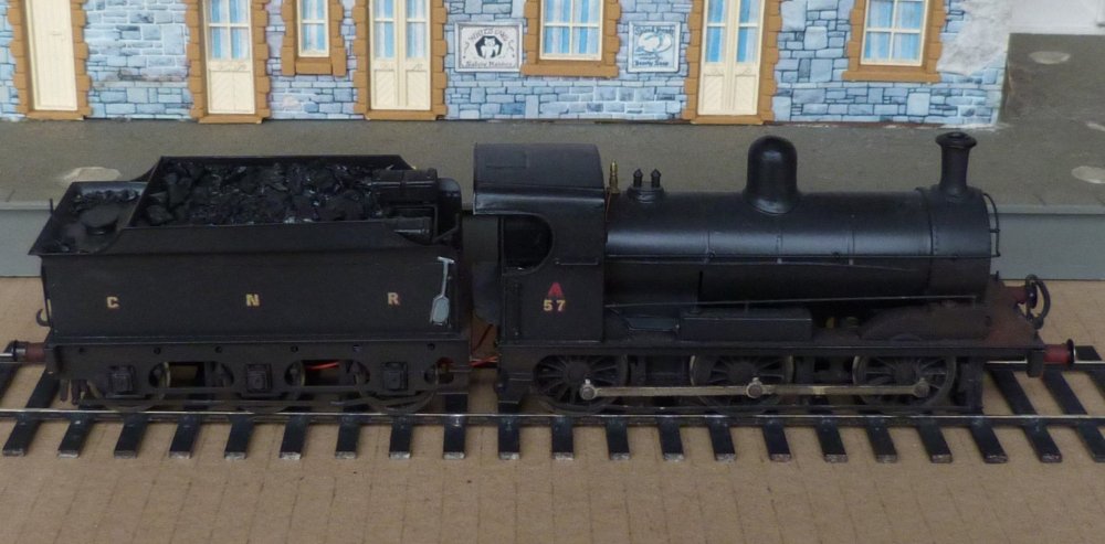

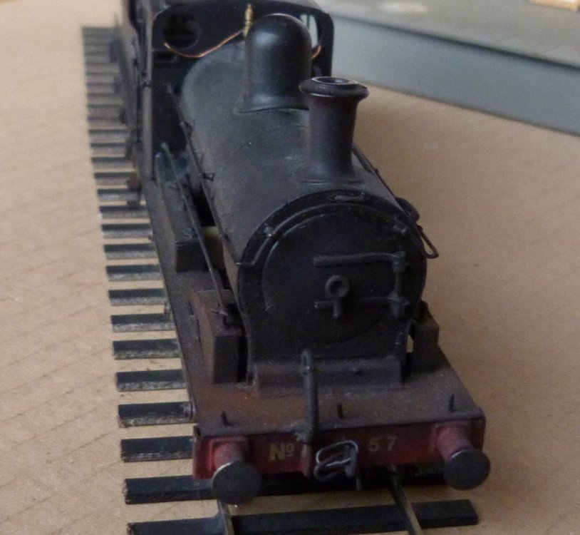

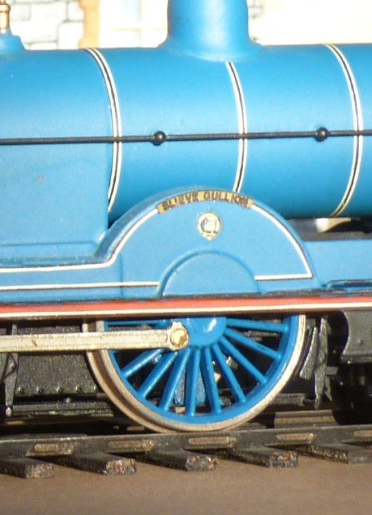

The S looks like its built from a SSM kit, I built a couple! Clearances between splashers, coupling rods and crank pins are minimal on these locos in 21mm gauge
Link to comment

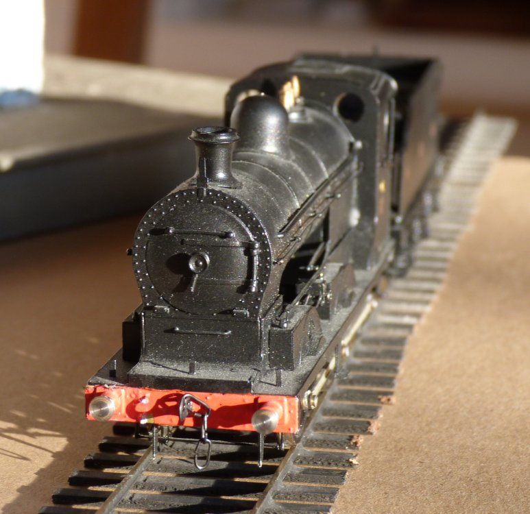

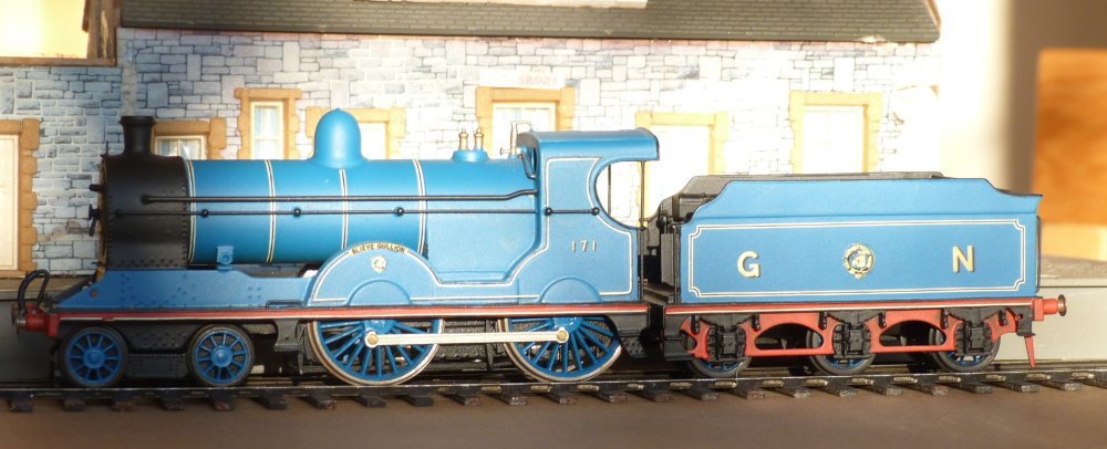

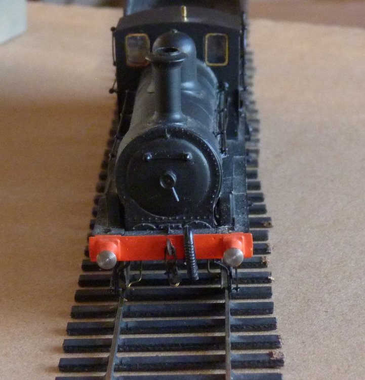

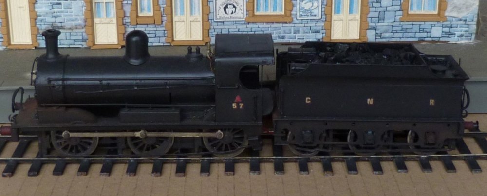

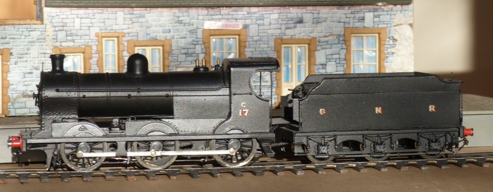

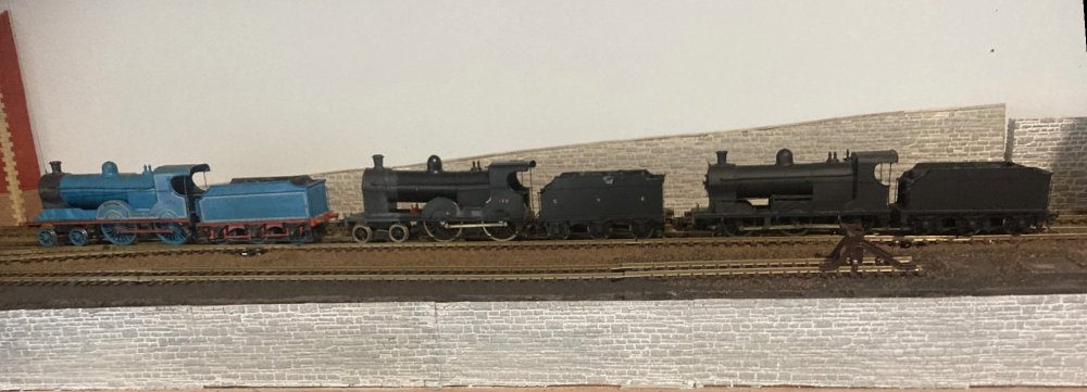

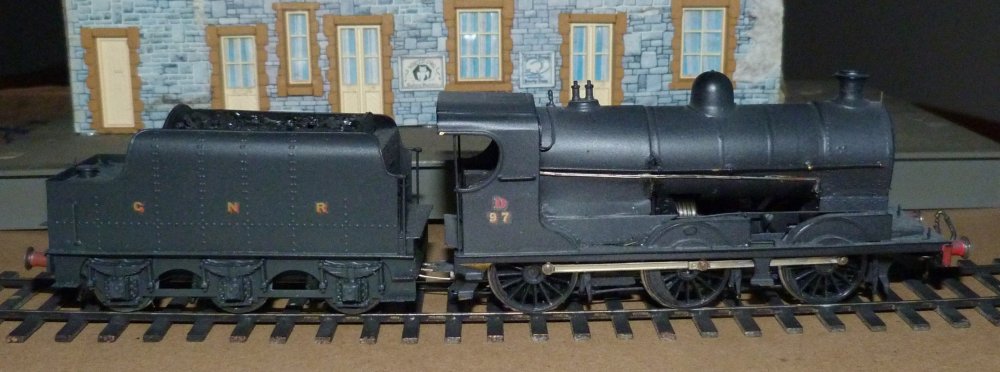

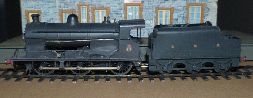

Snap! Three GNR 21mm gauge locos assembled from TMD (Terry McDermott) kits 1996-2002.
Locos probably last run on MRSI Loughrea layout during exhibition early 2000s, all three locos require repair and repaint  after 20 odd years in storage/on display. One kit bought new from Terry before Paul Greene acquired the business, the remaining locos picked up as part of a job lot of part built TMD kits at a UK exhibition.
174 Caruntuhill possibly the last S Class outshopped by Dundalk in lined blue after the CIE takeover.
An S masquerading as Qs 132. Loco is due a strip down and re-paint following damage in storage.  Grey overspray on boiler and running board following attempt to clean up smokebox.
SG awaiting lettering and numerals following re-paint
  • Like 7
Link to comment
Funny you should mention Loughrea John
We are currently reviving Dundalk works for our upcoming show in Mount Temple school this October
We then hope to revive Loughrea, and that is the main reason I bought this collection of 21mm
I also picked up some SSM Coaches and assorted wagons
Got my hands on some track also so a bit of work in the offing!
Cant wait to see them running
7 hours ago, Galteemore said:
Very nice John: works well as a Q with high boiler pitch and slightly more EXIQUOUS frames.

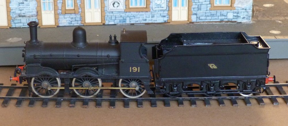

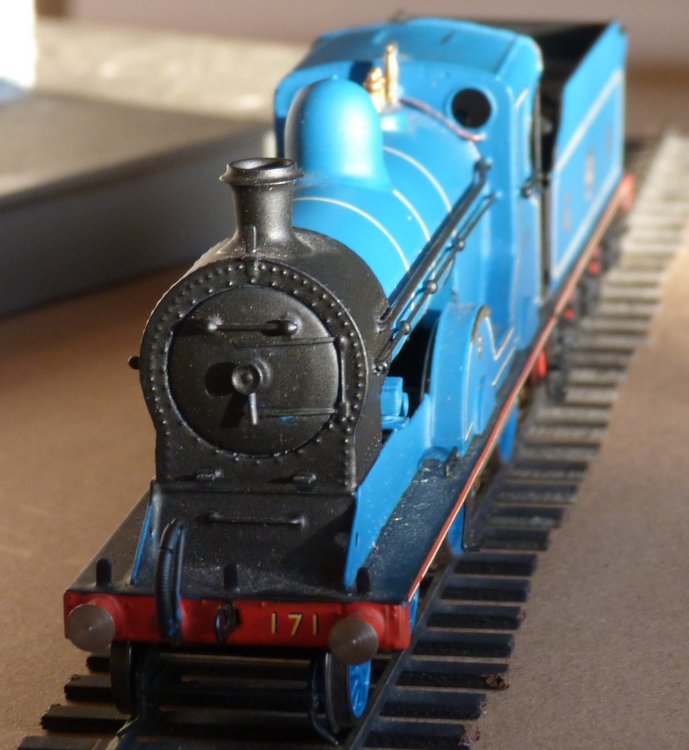

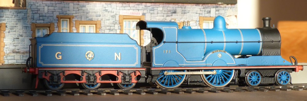

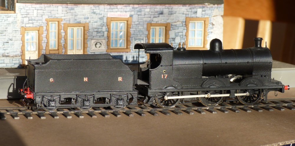

On 2/2/2024 at 2:13 PM, WRENNEIRE said:
Some more Black (J15)
Quite a collection Dave.

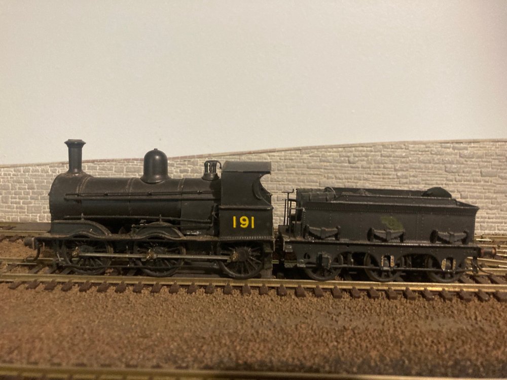

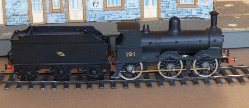

I just realised I have a model of 191 I assembled 30 years ago from the TMD J15 kit.
IMG_5902.jpg.92ea531cae274946c228a07a90ab72a6.jpgIMG_5901.thumb.jpg.6ccd12cb1ecdb8c8692129d5f83d8946.jpg
I bought a J15 and an S Class kit from Terry McDermott in the early 90s, loco won a prize kit built loco category Milton Keynes Model Railway Club. The TMJ J15 was all brass, I thinned the coupling rods to represent unpainted steel, tender axlebox castings were glued on at the time I hadn't tried soldering whitemetal.
There have been a number of changes in the long production life of the kit 1985-date? The original TMD kit was etched in brass (body and chassis) with turned brass frame spacers, chimney and dome, but no castings, later versions of the TMD kit included whitemetal chimney, dome castings and plastic spring/axlebox castings.  The body and chassis of the SSM (Paul Greene) version of the kit was etched in nickel silver with a comprehensive set of whitemetal castings.
The small GNR 0-6-0 57 was originally produced by Northstar Design (Adrian Rowland) who also produced 7 and 4mm versions of a GNR PP 4-4-0 and a 10mm Scale Tralee and Dingle 2-6-0 which passed on to SSM.
There was a transition period between TMD and Studio Scale Models. SSM marketing and selling the GNR 20T Goods Brake while TMD continued to sell its existing stock of Irish loco kits. The GNR compound was initially marketed and sold by TMD after SSM had taken over the marketing and sales of earlier TMD kits (The TMD Compound Kit included the tender from the SSM (exTMD) GNR S Class)
The GSR Bredin Coaches may initially have been marketed and sold by TMD before being incorporated in to the SSM range.
Link to comment

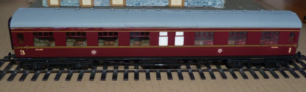

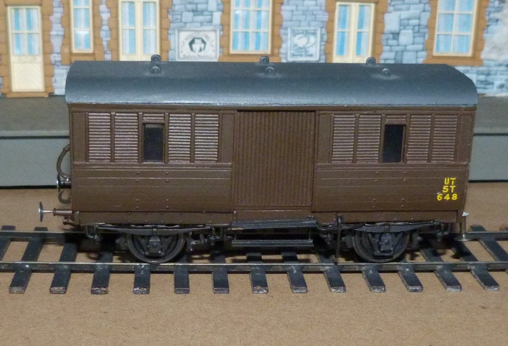

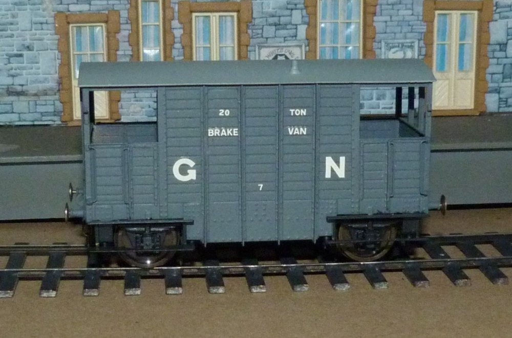

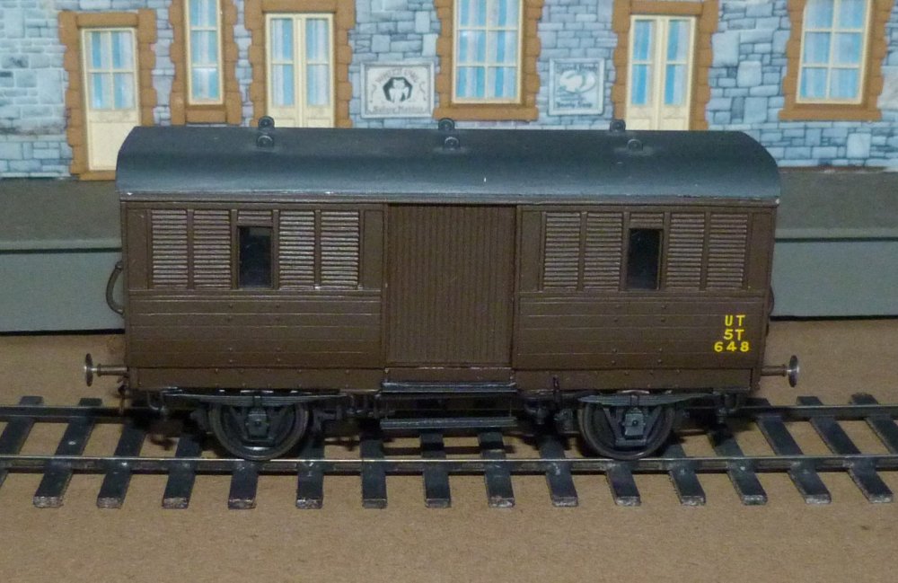

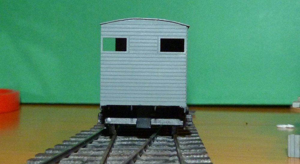

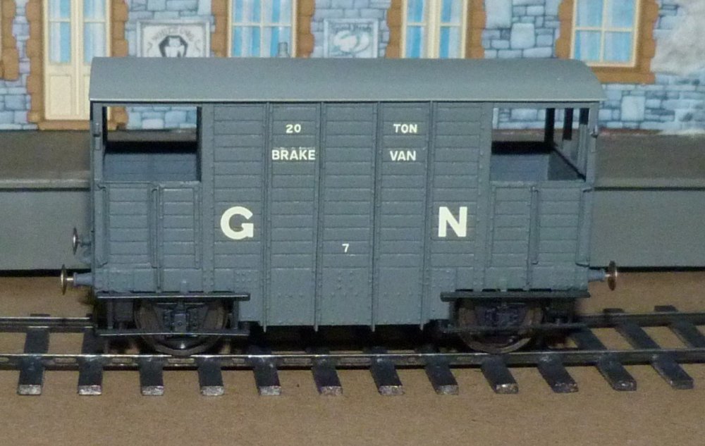

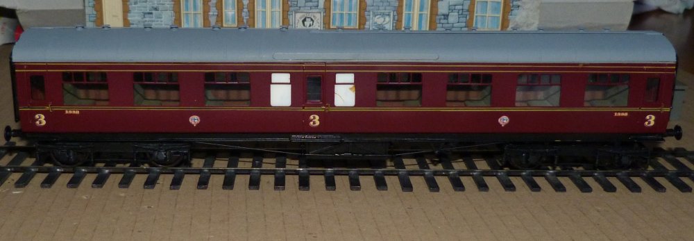

6 hours ago, WRENNEIRE said:
Some other rolling stock this morning
Quite a treasure trove!
The UT ex-GNR Bread/Parcels Van is something of a rarity a Jeremy Suter kit produced during the late 90s early 2000s.
Jeremy produced a series of excellent limited run Irish wagon kits including the UTA-ex GN Parcel Van, GN Standard covered wagon, GN & NCC versions of the Bread Container wagons used in Northern Ireland and an MGWR Coal Wagon.
TMD Kits. The TMD J15 kit released 1986 was quite advanced for etched kits of the era with built-in jigs to assist the assembly of the footplate valence assembly  a distinctive feature of Class and a tender with half etched rivet detail and slot and tab assembly to simplify assembly. The main weak point in the earlier kits like the J15, GNR T and MGWR tank was that the classis was etched in the same thickness of brass as the body. Later kits including the GNR S and SG were supplied with chassis in nickel silver and upgraded nickel silver chassis supplied with the GNR T (4-4-2T) and MGWR Tank.
Later kits including the GN SG, GSR 800 Class, Bandon Tank, GNR, GSWR and GSR coaches appear to have been designed by the late Eamonn Kearney and were designed as a number of sub assemblies to simplify assembly and painting. The coach bodies were designed to bolt together with pre-formed roofs, were effectively self jigging with minimal requirement for solder.
SSM Whitemetal Wagon Kits. A number of high quality whitemetal wagon kits were added while the business was under Paul Greene's management including the wooden underframed version of the Standard Irish Open wagon used by the GNR and by the majority of the Southern Companies from the WW1 era onwards and the GSWR and MGWR versions of the "Standard Irish Covered Wagon" (soft topped convertible)
Link to comment
2 hours ago, Mayner said:
....The UT ex-GNR Bread/Parcels Van is something of a rarity a Jeremy Suter kit produced during the late 90s early 2000s.
Jeremy produced a series of excellent limited run Irish wagon kits including the UTA-ex GN Parcel Van, GN Standard covered wagon, GN & NCC versions of the Bread Container wagons used in Northern Ireland and an MGWR Coal Wagon.....
Very occasionally these reappear on eBay. Values fortunately not high because minority interest.
Link to comment
