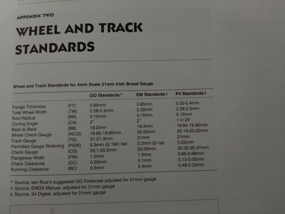

gph2000 Posted January 1, 2021 Posted January 1, 2021 I was stunned by how good 21mm looks when I saw pics in Steve an Alan's book. 2

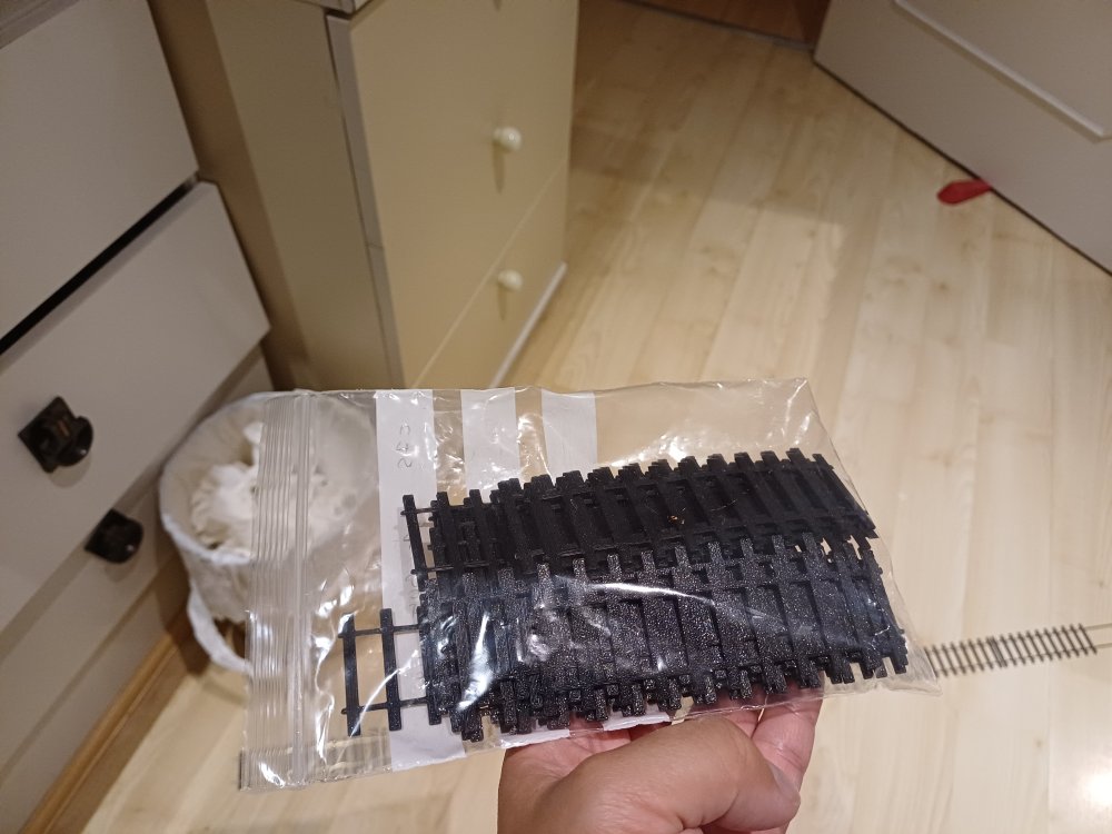

NorthWallDocker Posted January 2, 2021 Posted January 2, 2021 Yes, definitely I'd buy 21mm track and points. The sales opportunity lies in the new modellers joining. One economical approach might be to create the sleepers for RTR track using 3-D printing, to allow an adjustable print-to-order. The track could be sold as simple kits -- sleepers in strips with rails to be inserted. Meanwhile, I bought Irish broad gauge sleepers from the ScaleFour Society and bullhead rail in code 75. (Thanks, Jeremy Suter, for the help.) Just need uninterrupted free time. Working towards a combined MGWR Sligo line with Collooney Jct. to Dromod and the Cavan & Leitrim from Dromod to TBD. A now-often-cited article about "the Long Tail" of a niche market might help explain how to think about models of Irish broad gauge (and Irish 3-foot RTR on 12 mm track). You create the niche, in part, that people haven't articulated in masses -- you don't respond to an existing mass market. The idea is used for a lot of niche-market sectors, such as a rare books library or historical museum that specializes in certain research subjects. https://www.wired.com/2004/10/tail/ 4

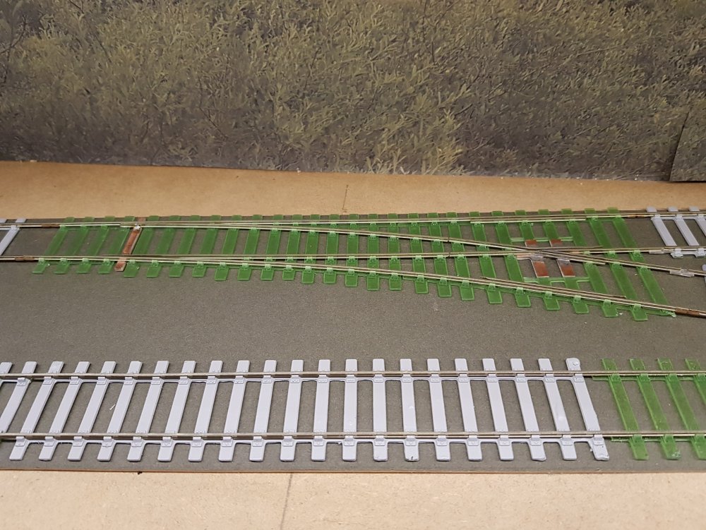

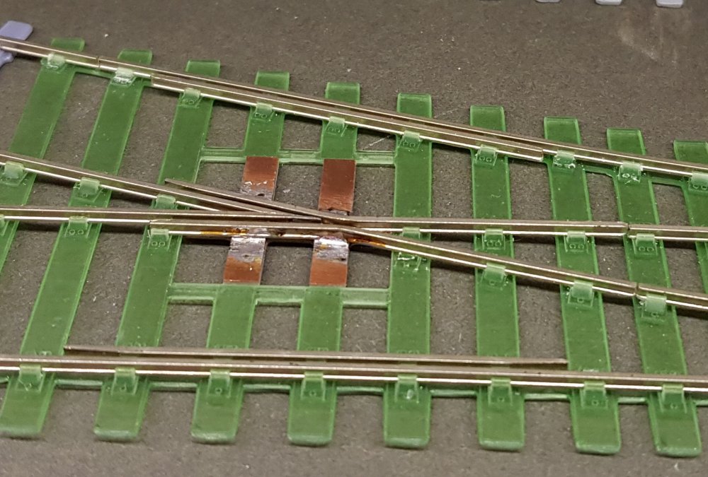

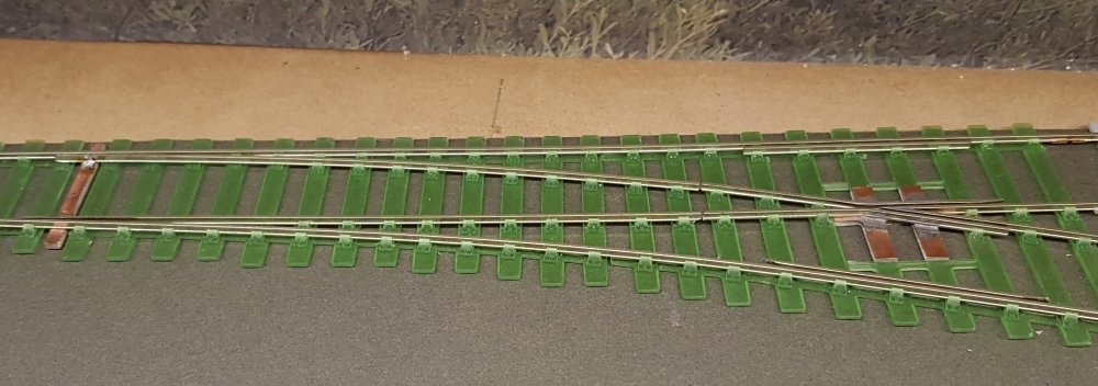

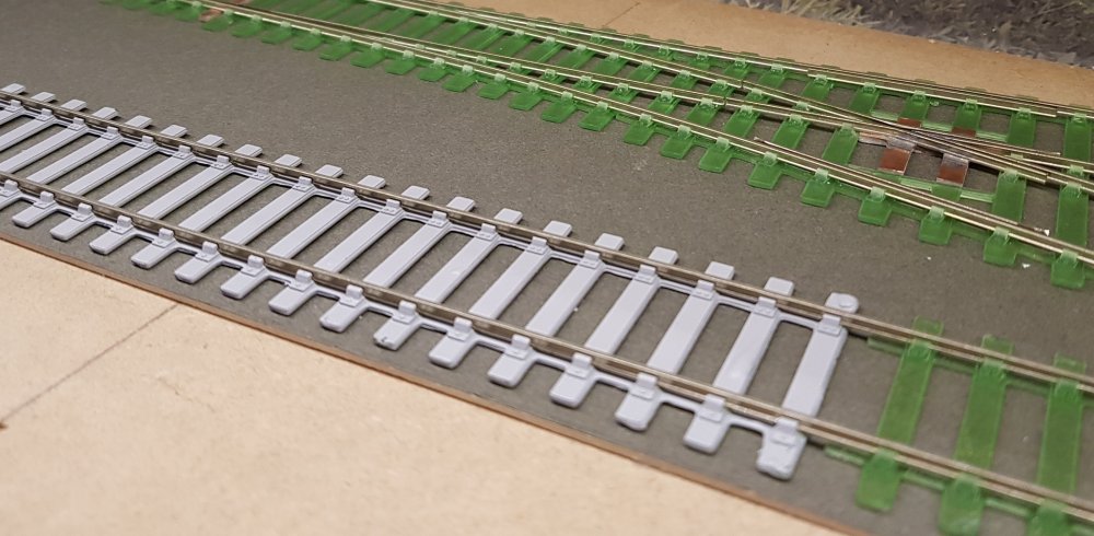

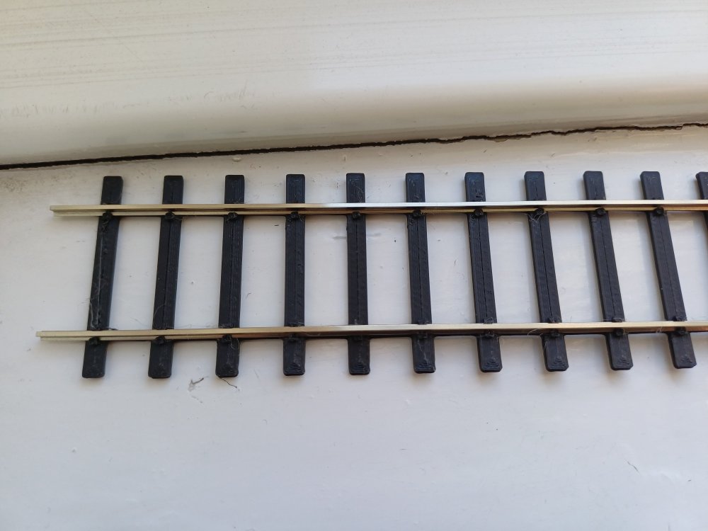

Popular Post KMCE Posted April 29, 2021 Popular Post Posted April 29, 2021 Whilst not exactly RTR, with some 3D modelling (should read a lot of modelling) and 3D printing, it is possible to develop a basic 45' straight, and a B6 point. Developed to P4 standards with the 1:20 incline inwards using code 75 bullhead rail results in this: Points proved to be a tricker prospect. Ensuring gauge widening, check rails, crossng vee and closure rails was a little more difficult. Easy to print a continuous line through the vee, but more challenging to get the vee in place, soldered without damaging the sleepers below. The compromise was to print a space for coppercald, cut it on the mill and use as a base for soldering everything in place. The upside of this is I only need one dropper to wire the complete frog. Once the sleepers are painted and the whole lot ballasted, this should not really be visible. As a B6 point, it c. 260mm long, so is printed in two parts as my build plate is only 190mm - not an issue as you cannot really see the separate element once completed. The reason for B6 is that I have found that locos more than 4 coupled will not go (comfortably) through anything less. They do take up space, but have a very prototypical look. This process does make it a lot easier to make a point, however the basics of point construct still apply, it just considerably reduces the amount of soldering. As chairs are printed to the correct gauge, jigs are not needed - just push in the rail as necessary. Still a work in progress as there the gauge widening on the diverging track exit is slightly tight - a minor tweak (I hope!!) to the CAD model should solve this problem. The track shown above is part of a test layout to see how well this process works and will be developed further in the layout section. More as time permits. Ken 12 2 6
Fiacra Posted May 1, 2021 Posted May 1, 2021 On 30/4/2021 at 12:35 AM, KMCE said: Whilst not exactly RTR, with some 3D modelling (should read a lot of modelling) and 3D printing, it is possible to develop a basic 45' straight, and a B6 point. Developed to P4 standards with the 1:20 incline inwards using code 75 bullhead rail results in this: Points proved to be a tricker prospect. Ensuring gauge widening, check rails, crossng vee and closure rails was a little more difficult. Easy to print a continuous line through the vee, but more challenging to get the vee in place, soldered without damaging the sleepers below. The compromise was to print a space for coppercald, cut it on the mill and use as a base for soldering everything in place. The upside of this is I only need one dropper to wire the complete frog. Once the sleepers are painted and the whole lot ballasted, this should not really be visible. As a B6 point, it c. 260mm long, so is printed in two parts as my build plate is only 190mm - not an issue as you cannot really see the separate element once completed. The reason for B6 is that I have found that locos more than 4 coupled will not go (comfortably) through anything less. They do take up space, but have a very prototypical look. This process does make it a lot easier to make a point, however the basics of point construct still apply, it just considerably reduces the amount of soldering. As chairs are printed to the correct gauge, jigs are not needed - just push in the rail as necessary. Still a work in progress as there the gauge widening on the diverging track exit is slightly tight - a minor tweak (I hope!!) to the CAD model should solve this problem. The track shown above is part of a test layout to see how well this process works and will be developed further in the layout section. More as time permits. Ken Wow, looks great! This is making me seriously consider 21mm for a future layout. 4 1
jhb171achill Posted May 1, 2021 Posted May 1, 2021 If that stuff was indeed available commercially, I would get some for a mini-layout. At this stage I am too far committed to 00 gauge track and models, with some 20 locos steam and diesel, once my "A"s appear, and maybe 40 - 50 wagons and a dozen carriages. However, I would get one 141 converted and a dozen wagons to do a shunting layout with. If I was starting from scratch, I might sell the car and go full 21mm. So I suppose the answer to the original question, for me, is yes - if within my budget. 4
NorthWallDocker Posted May 2, 2021 Posted May 2, 2021 I bought bullhead rail a year ago just for this possibility of Irish broad gauge track -- 3-D printed or laser-cut sleepers. So looking forward to your testing and development. 1

Tisim Posted May 21, 2021 Posted May 21, 2021 It's not just about the track gauge, though, but also about the other standards: flange ways, flanges, etc. Which standard would you adopt? When the LMS shipped out a couple of Jocko 0-6-0Ts to the NCC, they reversed the wheel centres in the tyres, and were able to reuse the axles, resulting in a flat-faced look to the wheel, but a low-cost conversion. P4 modellers could do this for 21mm gauge, but I am not sure if it would be similarly possible with other standards. It would be easier to take model in 3mm with standard 00 wheels, and produce track to 15.75mm gauge as there is a lot of slop. Any such models would run just as well on 00 track for people who didn't want to build their own, but the splashers would be in the right place! There would be interchangeability for those who wanted to run other stuff, plus a reasonable amount of support available from existing trade sources via the 3mm scale people, especially where BR designs are being used, such as the 12T vans in the 1950s. Plus N gauge would be spot on for 3' gauge. The short answer to the survey is no, but only because I don't model in 4mm scale! 2 1
