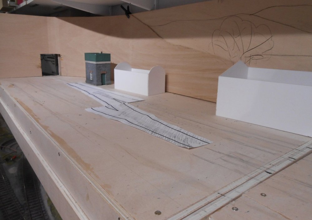

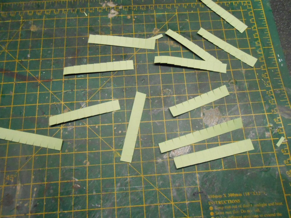

Took a deep breath and decided to move on from construction and wiring. The next steps in model railway construction often cause a few furrowed brows, though I tend to follow the artistic route and start with the background and gradually move forwards. However, model railways being three dimensional things, it is just as apt to work from the bottom up. On Northport Quay, that potentially could mean the water level and harbour walls, but am continuing with the track for now, which means painting, detailing & ballasting. Copperclad sleepers tend to be rather plain, angular things, so have used a craft knife to score their surfaces in places to represent cracks in the timbers. There are some nice photos around of SLNCR lightweight, flat-bottomed, track, including ,'Riley in Ireland', which have been trying to emulate. Have also added representations of the track spikes, using small pieces of 10x20thou micro strip fixed with cyano. Tedium personified! Before starting all this, I added check rails to the two sidings and headhunt to the pier, all of which will feature inlaid track of some sort, as yet to be decided. There is a question about this on the site. Since then have given all the track a coat of spray primer - this is because without it, the copper clad sleepers can easily show through their shininess with wear and tear.
