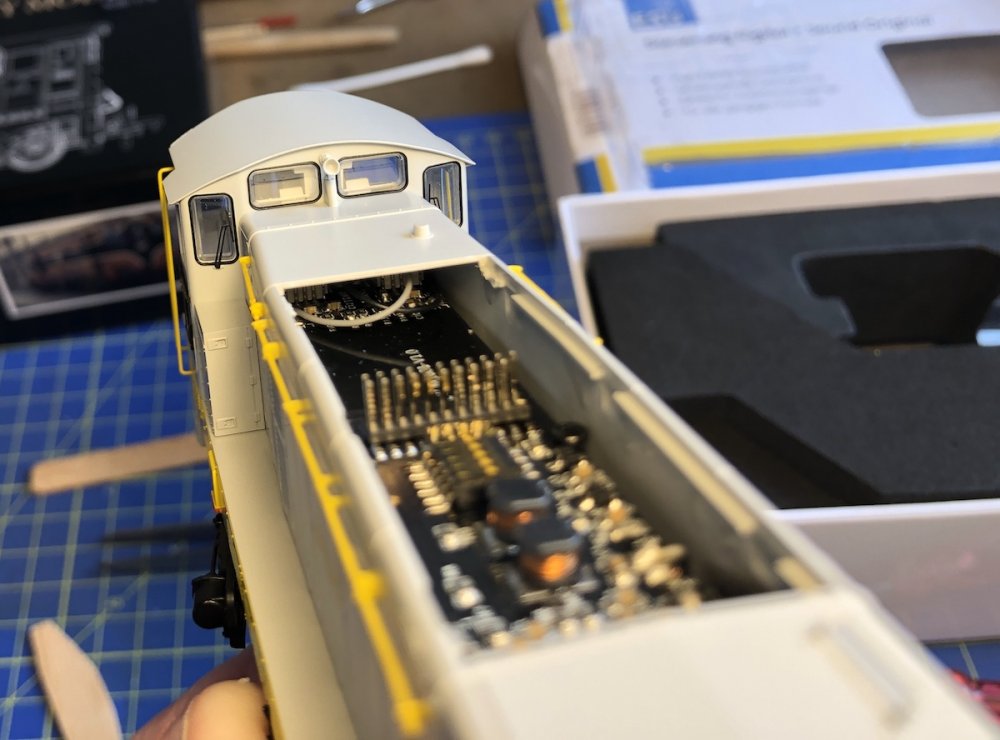

It's quite easy to mistakenly attempt to plug a decoder in upside down. Make a note of the orientation of the blanking plate when removing it and put a decoder in the same orientation facing the same way up. It could happen to a bishop. -

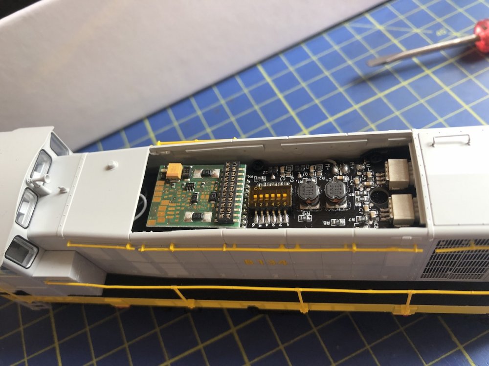

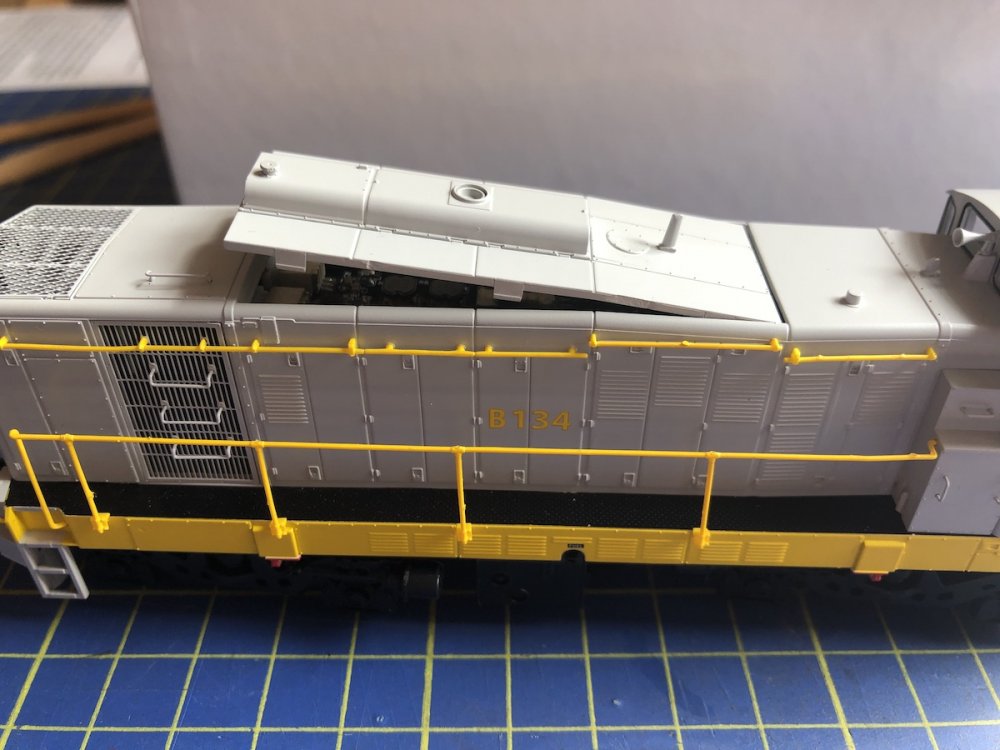

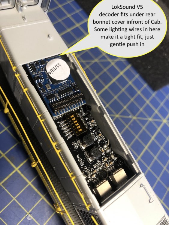

How to fit DCC decoder into MM 121 model loco 1. Access panel easily lifts off top of body 2. Plenty of space. Decoder fits under body panel in front of cab windows. Carefully remove the blanking plate - do not bend pins 3. Lighting wires under body top make it a tight fit, but gently push decoder in and it will get past the wires. LokSound V5 21 pin decoder 4. Lenz Silver+ non-sound decoder fits snugly and drives this loco very well. Cost €25 from Germany (eg Modelbahnshop lippe or Keiskemper)

I used a wooden ice cream stick cut to width like a wooden screw driver and wedged one edge of it on the screw heads on the PCP that are just 2mm forward of the decoder and the other edge under the decoder, twisting to move the decoder up and away from the pins 1/2mm at a time alternating from one side to the other so as not to bend the pins by just lifting one side of the decoder. Yes its a tight fit. A plastic blade might also suffice or a 5mm flat screwdriver head, but if using a screw driver as a wedge, beside to rest it on the hard screw head and not the main PCB surface. Both the MM LokSound v5 decoder and a LokSound V5 project by WheelTappersDCCsounds

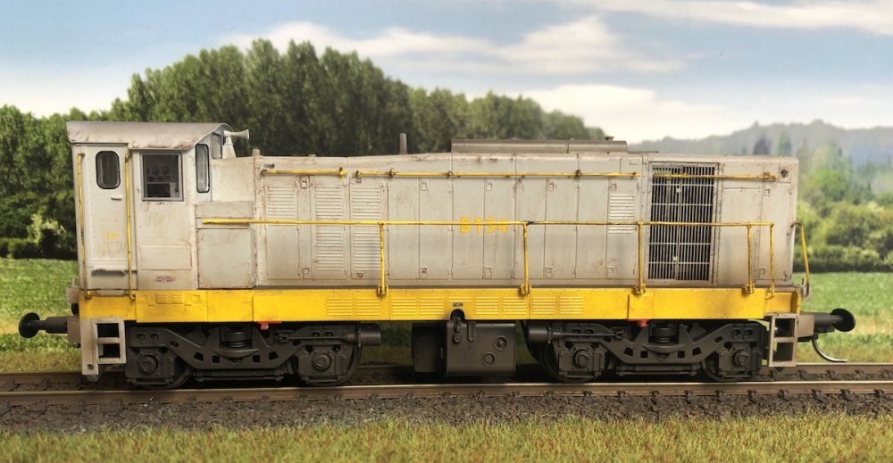

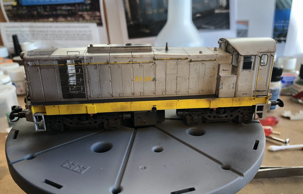

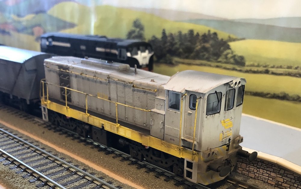

Hi Mike. Cheers, its 90% done using weathering powders in wet solution with a little airbrush for the bogies, under frame and valance plus buffer beam, a tiny bit on the cab roof and near exhaust as well. Noel

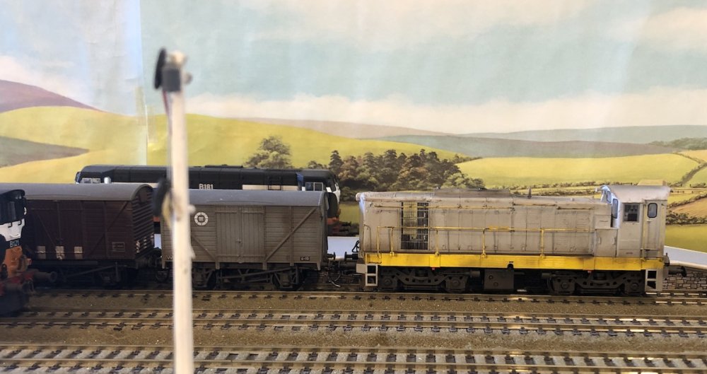

A light bit of weathering done on B134 Love this livery and these superb Murphy Models Ready to depart Woodvale Junction Local goods train about to be marshalled into the yard.

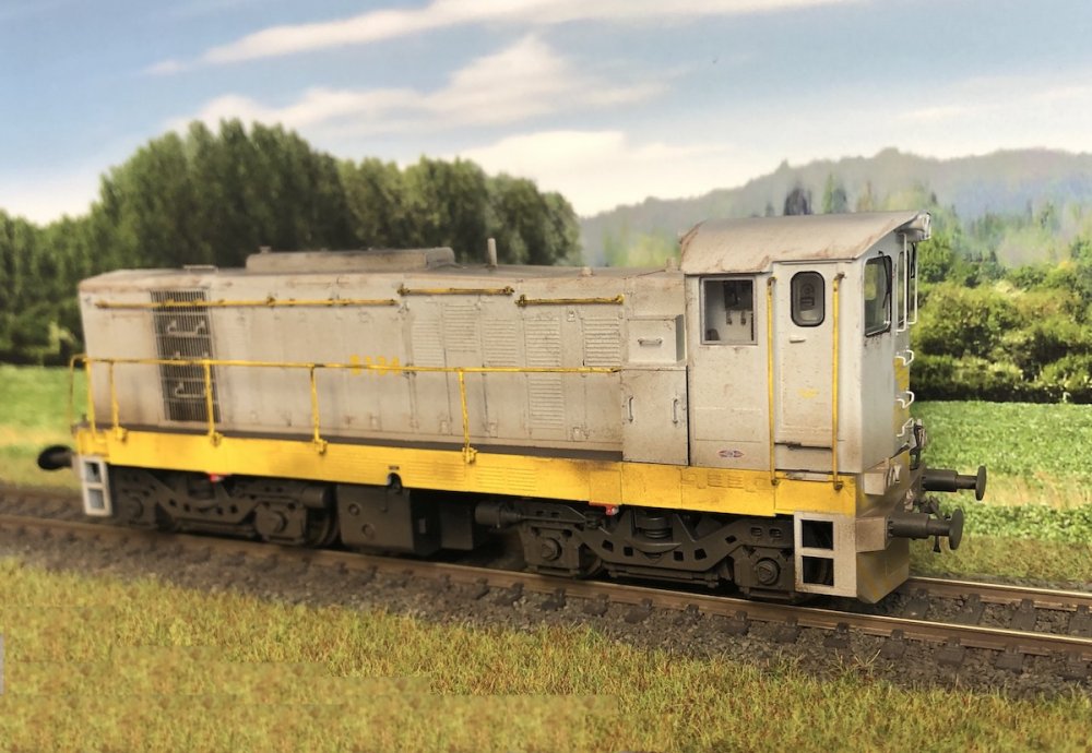

Started the process to weather this 121 this evening. Will finish up tomorrow. Took the walkway rails back off for access. Yes the prime mover (engine) and brake sounds work on DC as well as the marker lights.
