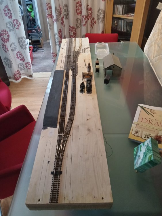

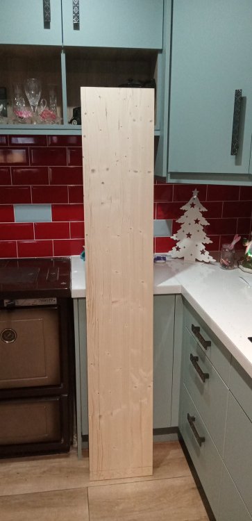

meathdane Posted December 11, 2021 Author Share Posted December 11, 2021 Quick update. Found a pine shelf in Woodies that was nearly perfect in dimensions a bit over 5ft in length and a hair under 1ft in width, little bit of trimming and that's my baseboard ready! I've decided on code 75, going with 2 long radius lefts and a long radius Y, all electrofrog. The track, the joiners and insulated fishplates can all be got easy enough, however nowhere seems to have this selection of points in stock, so if anyone could point me in the direction of some in stock, I'd be forever grateful! Thanks all! 7 Quote Link to comment Share on other sites More sharing options...

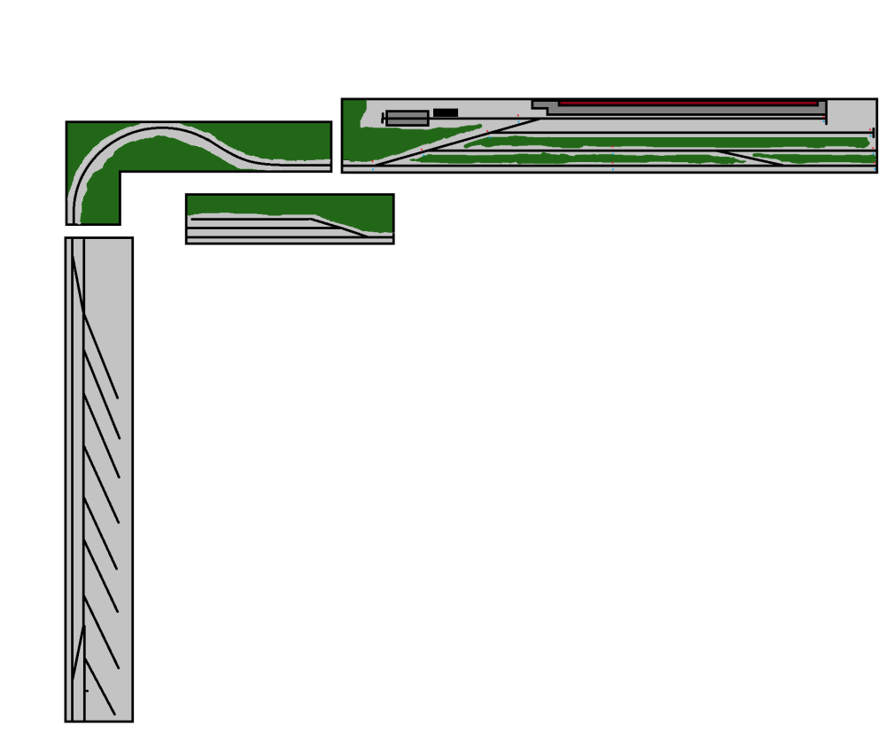

meathdane Posted February 22, 2022 Author Share Posted February 22, 2022 Hi All So, Its been a hot minute, and after a lot of thought and consideration, I've decided against my original idea, I want operations involved, so i decided on the following design, its a modular shelf layout, it can be put together a number of different ways. There are 4 baseboards, including the 'main' board, a bend, a large fiddle yard and a shorter headshunt/fiddle yard. The main board is a sugar factory, which has the ability to store 7 wagons in the loop, and the same in the long siding. It can also double up as an inglenook puzzle. Small shunter shed with a fueling point gives me the option of running a tank wagon in the scene as well as housing a shunter on scene. Plenty of operational interest involved with it, and the possibility of up to 3 locos on scene at any one time, while leaving enough space for all of my engines to uncouple without fouling any points in a standalone setting with the exception of my Mogul which would foul one point, however there's plenty of other places for it to wait. The bend is purely scenic to bridge the gap and allow the layout to wrap around any wall if needed, I'll likely include a signal and farmland surrounding the track work. The larger Fiddle yard can act as a double through baseboard accessible from either end of the board and plenty of loco/wagon storage as well and display of my locomotives when not in use, I'll likely use Peco insulfrogs for this section The smaller headshunt is for space constraints if needed and to allow trains to exit on the right and run around when operating everything together. Keep in mind this is not to scale, this is a rough sketch to see if i have missed anything and imagine how it works, as well as mapping out how many points I'll need and of what kind. Primarily going to make use of Peco Mid radius points for the main board and small fiddle yard, and short radius for the larger fiddle yard for storage, just for running characteristics of the Mogul and its dislike of short radius points. with the exception of the larger fiddleyard, all points will be live frog and motorised. Thanks all, Dane 7 Quote Link to comment Share on other sites More sharing options...
Robert Shrives Posted March 1, 2022 Share Posted March 1, 2022 Dane, Interesting ideas, my mind jumped to Westport shed if you wanted to create a diorama sort of board. However your second plan indicates a desire to expand. Having some linked dioramas could be the way to go if space tight. Many find having the loco stabling point ideal for showcasing locos and then have a set of sidings as a almost static terminal or perhaps a ingle nook shunting layout Perhaps a Waterford/ Sallypark with the viewer standing in the river might offer a possibility. with trains in passenger station and sallypark for standing wagons and the odd loco - stabled and shunting. The large overbridge being both the senic break and the linking feature - made to disguise the 90% bend. Robert 3 Quote Link to comment Share on other sites More sharing options...
meathdane Posted March 3, 2022 Author Share Posted March 3, 2022 On 1/3/2022 at 3:02 PM, Robert Shrives said: Dane, Interesting ideas, my mind jumped to Westport shed if you wanted to create a diorama sort of board. However your second plan indicates a desire to expand. Having some linked dioramas could be the way to go if space tight. Many find having the loco stabling point ideal for showcasing locos and then have a set of sidings as a almost static terminal or perhaps a ingle nook shunting layout Perhaps a Waterford/ Sallypark with the viewer standing in the river might offer a possibility. with trains in passenger station and sallypark for standing wagons and the odd loco - stabled and shunting. The large overbridge being both the senic break and the linking feature - made to disguise the 90% bend. Robert Hi Robert, Some fantastic points there, and yes there is a desire to expand, but also theres a possibility of moving coming up in the future and I'm not sure of the space I'll have, so it's a case of having it all as a modular setup, disconnecting the wiring with plug type block connectors for ease of transport. It also means I can change around the running characteristics of the layout so I never get bored, the other thing I'm trying to keep in mind is to keep as many boards as possible self contained to a degree that in the case where I have only enough space for one board, that I can still run trains without needed a full setup, even if it is less than ideal. A station board is something that has crossed my mind, with a small goods shed and a passing loop, however I'm mainly thinking in freight terms at the moment, but it's a thought process I'm going through, to possibly have a second 'main board' that can be connected to the factory module to give a nearly 11 foot run in ideal circumstances with plenty of operation. I had given thought to a stabling area, but I do need to keep the wagons in mind, I want to try and minimise the amount of stock and locos I need to put on and take off the layout, so storage space comes before scenery in that case, but I have put thoughts into it As for the bend, I do have a plan to create a scenic break to disguise it, along the lines of what you were suggesting. I'm still very much in the planning phase, and have plenty of ideas in mind. The factory board is having track laid at the moment because I'm happy with the design of it, the rest is a case of more tinkering and thinking. Thanks for your input, some really good points there Dane 3 Quote Link to comment Share on other sites More sharing options...

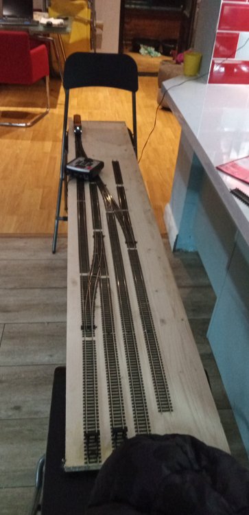

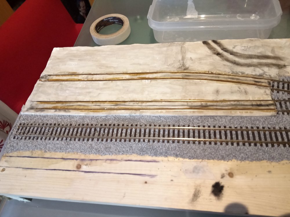

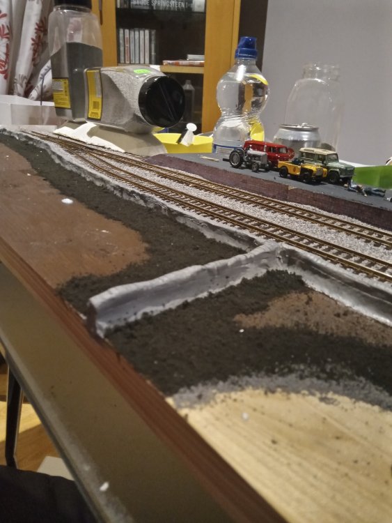

meathdane Posted March 12, 2022 Author Share Posted March 12, 2022 It's been a modelling marathon this week! First board down, tracks laid and testing underway, pleased to report no issues! On to point motors, uncoupling magnets for Kadees and then scenics! Decided to forgo laying cork, the shelf seems to absorb the running noise, possibly due to the thickness of the material. But past that, I'm very happy with how everything has proceeded so far! Snapchat-2128749771.mp4 5 Quote Link to comment Share on other sites More sharing options...
Noel Posted March 12, 2022 Share Posted March 12, 2022 Looking good. Very neat trackwork. Will enjoy watching this evolve. What point motors do you plan to use? 1 Quote Link to comment Share on other sites More sharing options...
meathdane Posted March 12, 2022 Author Share Posted March 12, 2022 7 hours ago, Noel said: Looking good. Very neat trackwork. Will enjoy watching this evolve. What point motors do you plan to use? Thanks Noel! I have a heap of Seep PM-10s I was gonna use for the main layout, but I'm going a different direction so I'll probably just repurpose them for this project to save some money and time considering I already have the motors and point switches Quote Link to comment Share on other sites More sharing options...

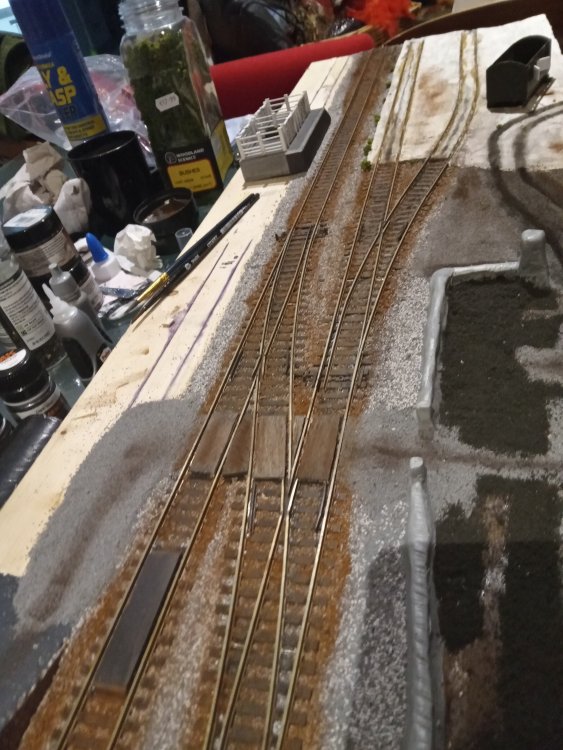

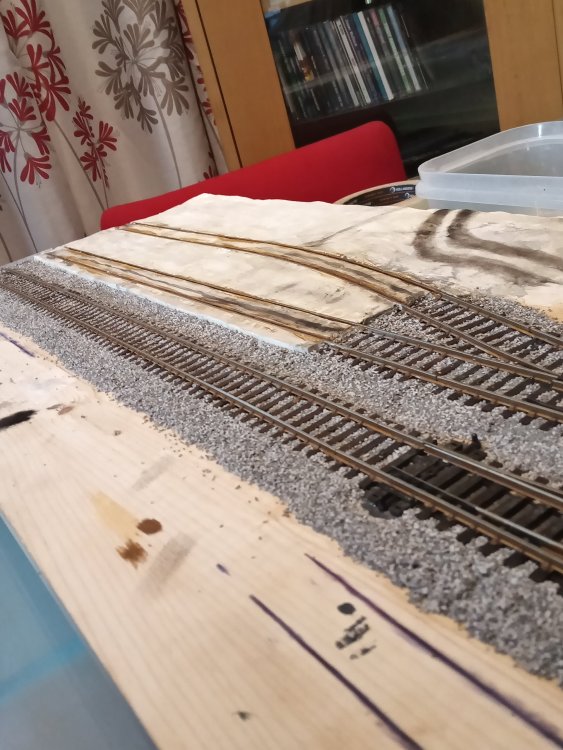

meathdane Posted May 22, 2022 Author Share Posted May 22, 2022 Back with an update at last, lots going on, including completed reworking of track number 1 million, however I finally settled with a track plan and have progressed onwards in my model railway journey! New trackplan is a small branch terminus in the Meath area, coming to the end of its life, incorporating a runaround loop big enough for loco + 2 coaches, goods shed with the ability to store 4 two axle wagons, a siding able to accommodate a further 4 and a headshunt with a capacity of 5, plenty of operations without overloading the board with trackwork Hard standing made, dried, cut and weathered to resemble concrete, using Vallejo black and burnt umber both heavily watered down for washes and undiluted for certain parts, as well as weathering powders. Thankfully all locomotives are behaving over the hard standing! So there's a win! Goods shed acquired and detailing has begun, yet to add interior decor and lighting. Sides of all rails painted brown Made a start at the ballasting, using a mix of woodland scenics light grey medium and dark grey fine Platform built and has a layer of polyfiller applied, as well as bascoated to see the highpoints in order to smooth away. thanks all! Dane 10 1 Quote Link to comment Share on other sites More sharing options...
2996 Victor Posted May 22, 2022 Share Posted May 22, 2022 Looking good, Dane, excellent track layout and nice progress. Great work on the concrete which notoriously difficult to make convincing. The shed also looks fantastic, the windows are particularly effective. Have you got any details on the build? Looking forward to seeing your next instalment Cheers, Mark 2 Quote Link to comment Share on other sites More sharing options...
Sean Posted May 22, 2022 Share Posted May 22, 2022 with smalller boards like this, it really does seem like a process whereby you design an overly complex track plan and then over time as you begin to play with stuff you come to realise that less is more without nessesarily sacrificing on operability whilst increasing realism of operations. 3 1 Quote Link to comment Share on other sites More sharing options...

meathdane Posted May 22, 2022 Author Share Posted May 22, 2022 1 hour ago, 2996 Victor said: Looking good, Dane, excellent track layout and nice progress. Great work on the concrete which notoriously difficult to make convincing. The shed also looks fantastic, the windows are particularly effective. Have you got any details on the build? Looking forward to seeing your next instalment Cheers, Mark Hi Mark, Kind words are most appreciated! I wish I could take credit for the goodshed, however it's a run of the mill Hornby Skaledale Granite goods shed I got for twenty quid basically brand new! Adding to this makes more sense than scratchbuilding as I wasn't basing this off anywhere in particular, so I could get away with it, though I may come back in the future when my skills allow me to building something more Irish looking! Thanks again! 52 minutes ago, Sean said: with smalller boards like this, it really does seem like a process whereby you design an overly complex track plan and then over time as you begin to play with stuff you come to realise that less is more without nessesarily sacrificing on operability whilst increasing realism of operations. Absolutely Sean, Kind of a Goldilocks situation, that's why it changed so many times! I stood back from V1.0 after test laying and realised I wouldn't get very much enjoyment from it, hence the industrial 2.0 attempt, but I didn't give myself enough room for scenics, it was a sea of trackwork, operationally it was great, but would have been a visual eyesore, as well as limiting me to goods only operations. This one has hit the right middle ground for me, I can run passenger only, goods only, mixed traffic, I can conceivably fit two trains on scene with an outbound goods waiting for an inbound passenger before departure, without fouling the branch line. The only thing I am missing is a cattledock, which I could fit opposite the goods shed, and store the loaded vans in the siding for cattle specials, still very much a work in progress as I build, but I don't want to crowd the scene either. 48 minutes ago, Rob said: Nice progress, Dane- good to see it. What era roughly is it based in? Thanks Rob, much appreciated, I'm trying for a 50s-60s style layout, all of my A's and my 121s are BnT/Green/Grey, I do have more modern stock, but I prefer the unfitted goods and older coaching stock myself, but who's to say a 141 with some Mk3s won't make an appearance for a GAA special 4 Quote Link to comment Share on other sites More sharing options...

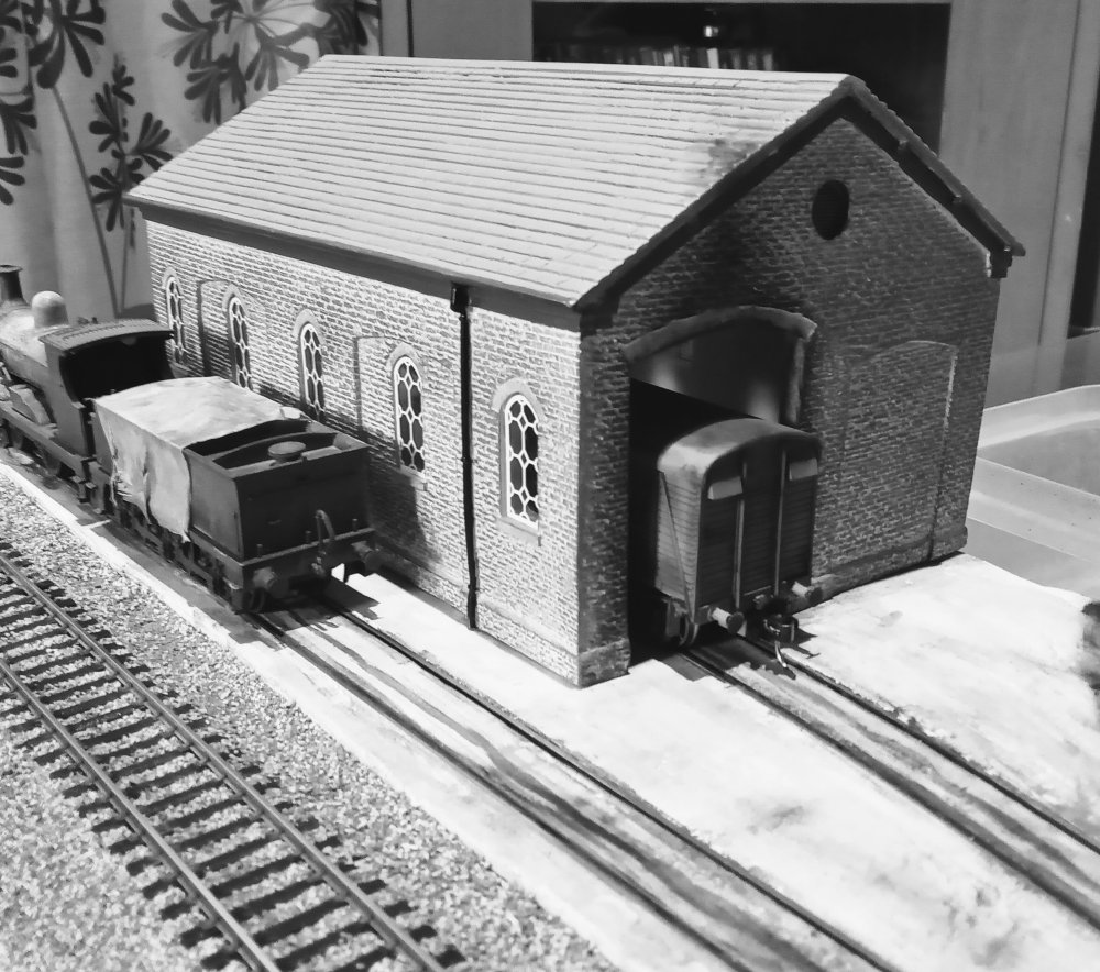

2996 Victor Posted May 23, 2022 Share Posted May 23, 2022 (edited) 11 hours ago, meathdane said: I wish I could take credit for the goodshed, however it's a run of the mill Hornby Skaledale Granite goods shed I got for twenty quid basically brand new! Adding to this makes more sense than scratchbuilding as I wasn't basing this off anywhere in particular, so I could get away with it, though I may come back in the future when my skills allow me to building something more Irish looking! Well it certainly looks the part, so why not? In fact, I'm tempted to see if I can find one for my project MGWR layout when it gets started - I think with a bit of tinkering it might fit in nicely! Great stuff - looking forward to seeing more. Cheers, Mark Edited May 23, 2022 by 2996 Victor 1 Quote Link to comment Share on other sites More sharing options...
jhb171achill Posted May 23, 2022 Share Posted May 23, 2022 Love the withdrawn steam loco….. very much a thing to be seen at certain locations in the early 1960s. Very realistically “weathered”…. 2 1 Quote Link to comment Share on other sites More sharing options...
meathdane Posted May 23, 2022 Author Share Posted May 23, 2022 3 minutes ago, jhb171achill said: Love the withdrawn steam loco….. very much a thing to be seen at certain locations in the early 1960s. Very realistically “weathered”…. Thanks JHB, it's my little nod to the changing of the guard in time period I'm aiming for. I have to admit I'm quite proud of that weathering job, did my best to hide the English-ness of the loco and make it halfway passable at a glance 5 Quote Link to comment Share on other sites More sharing options...
jhb171achill Posted May 23, 2022 Share Posted May 23, 2022 1 hour ago, meathdane said: Thanks JHB, it's my little nod to the changing of the guard in time period I'm aiming for. I have to admit I'm quite proud of that weathering job, did my best to hide the English-ness of the loco and make it halfway passable at a glance It’s actually an outstandingly great job! Among my earliest railway memories are of seeing a row of rusty wheel sets on a weed-covered track where they had been breaking up locos…. 3 Quote Link to comment Share on other sites More sharing options...

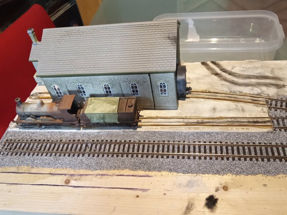

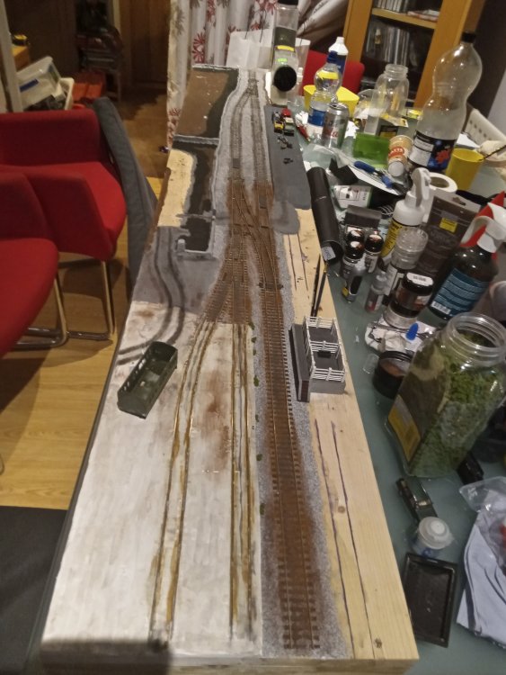

meathdane Posted May 28, 2022 Author Share Posted May 28, 2022 Please excuse the mess! Working clean has never been a strong point, but I'll clean up later! Right after I get to those dishes I left soaking a while ago.... Lots going on this week, Remainder of track has been ballasted, and weathering has begun Barrow crossing laid and painted Fields, embankment and goods yard have had a start made, just need the static grass applicator to arrive from fleabay and I can really get going there! Walls made very simply from Das Clay, nothing special, but hopefully a lick of paint will bring them to life! Decided on a position for the cattledock, little bit of ballast removal required but nothing major! Started work on a yard office/ticket booth, recycled from an old Hornby 4 wheeler, need to build a little interior for it, as well as a gate and barriers Thanks all! 5 1 Quote Link to comment Share on other sites More sharing options...
jhb171achill Posted May 28, 2022 Share Posted May 28, 2022 1 hour ago, meathdane said: Please excuse the mess! Working clean has never been a strong point, but I'll clean up later! Right after I get to those dishes I left soaking a while ago.... Lots going on this week, Remainder of track has been ballasted, and weathering has begun Barrow crossing laid and painted Fields, embankment and goods yard have had a start made, just need the static grass applicator to arrive from fleabay and I can really get going there! Walls made very simply from Das Clay, nothing special, but hopefully a lick of paint will bring them to life! Decided on a position for the cattledock, little bit of ballast removal required but nothing major! Started work on a yard office/ticket booth, recycled from an old Hornby 4 wheeler, need to build a little interior for it, as well as a gate and barriers Thanks all! An ingeniuous use for one of those things! 2 Quote Link to comment Share on other sites More sharing options...

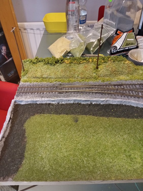

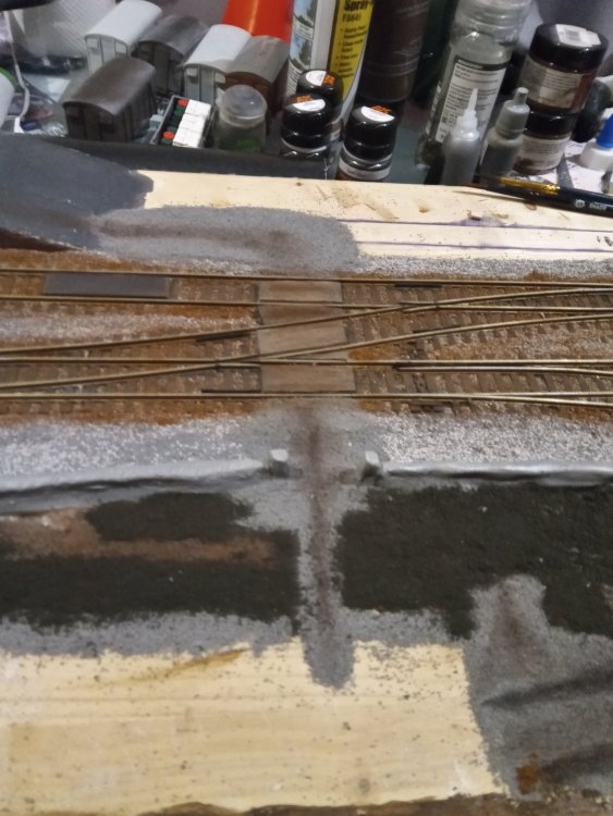

meathdane Posted May 31, 2022 Author Share Posted May 31, 2022 The static grass applicator finally arrived and I've been putting it through its paces. Embankment is more or less completed now, including power lines, hand made from plasticard, skewers and thread Field has had the first layers of grass applied, more work required to vary the tones. Track weathering has been finished off to the end of the board Overall very pleased with how it's all come out, very excited to come home most evenings to continue the work! Thanks all! Dane 10 Quote Link to comment Share on other sites More sharing options...
Sean Posted May 31, 2022 Share Posted May 31, 2022 That looks great 1 Quote Link to comment Share on other sites More sharing options...
2996 Victor Posted May 31, 2022 Share Posted May 31, 2022 Looking great! So many layouts seem to have verdant green grass, whereas it's usually much more yellowy. You've captured the look perfectly! Cheers, Mark 2 4 Quote Link to comment Share on other sites More sharing options...

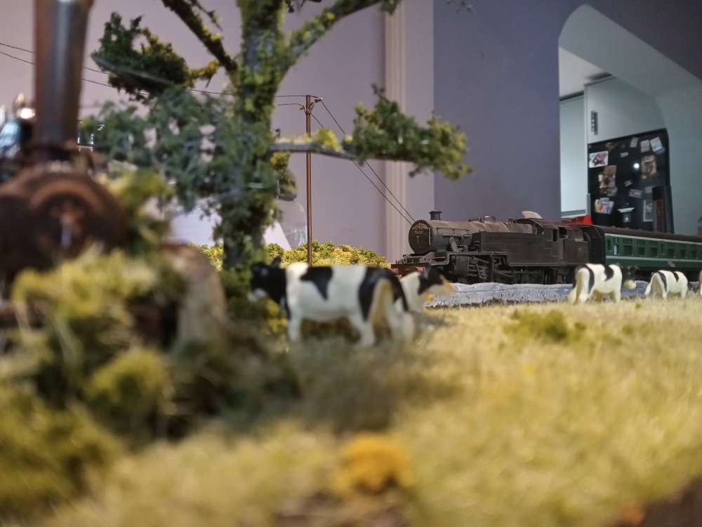

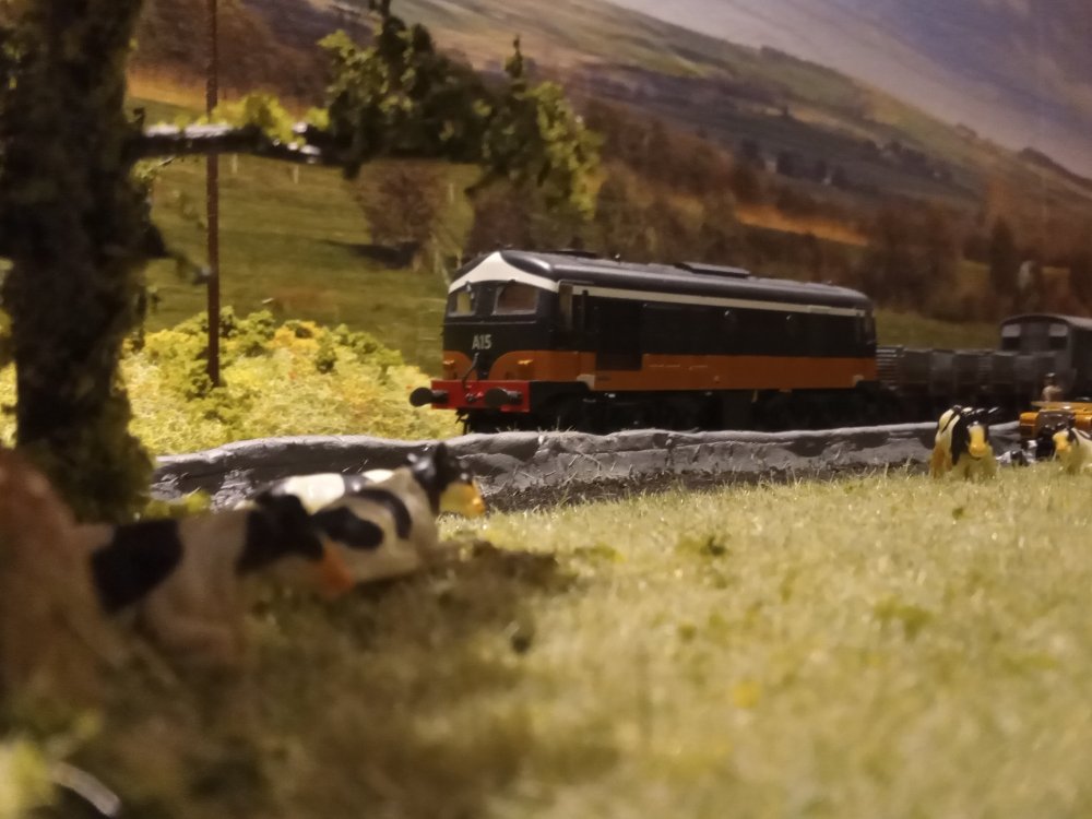

meathdane Posted June 3, 2022 Author Share Posted June 3, 2022 Decided to take a quick photo, more progress and a new engine A backdrop would help the atmosphere, hopefully should have one sorted very soon, within the next week or two. Delighted with how much the little layout has come along in a month! Thanks all! Dane 7 Quote Link to comment Share on other sites More sharing options...

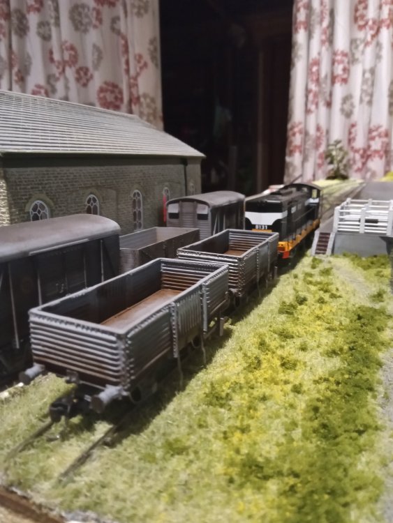

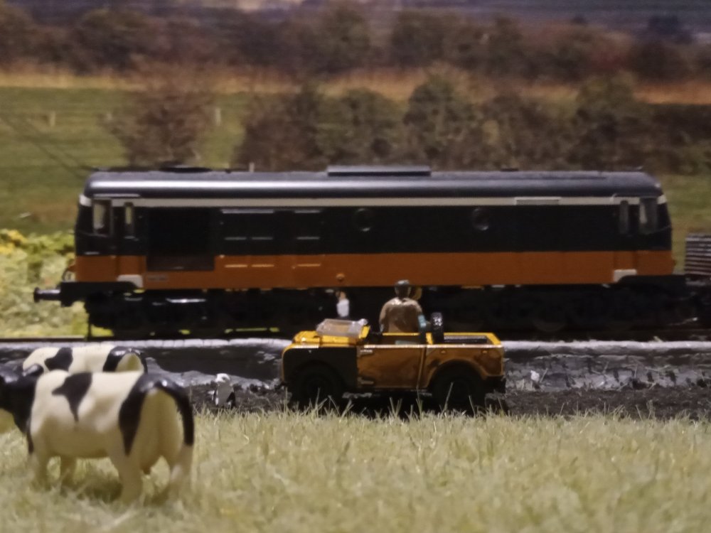

meathdane Posted June 14, 2022 Author Share Posted June 14, 2022 It's amazing the difference a backscene will make! Getting onto decorating the station and lighting next! As well as gearing up to transition fully to true Irish rolling stock! A15 with an outbound empty goods back to Navan Junction and B131 seen shunting wagons beside the cattle dock 6 1 Quote Link to comment Share on other sites More sharing options...

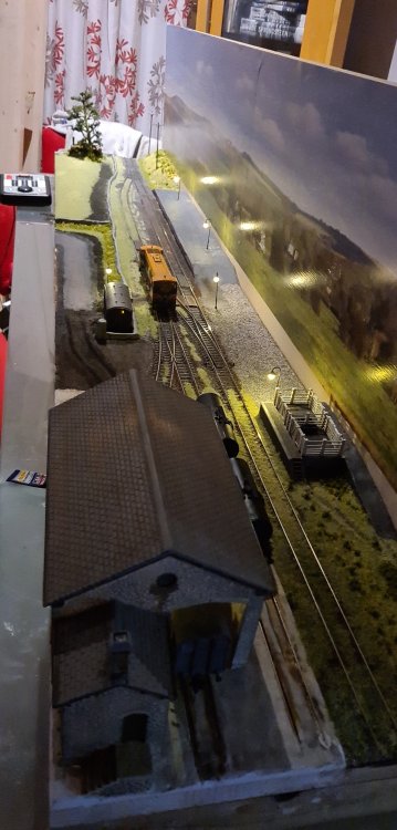

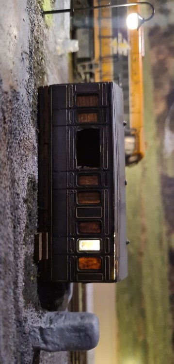

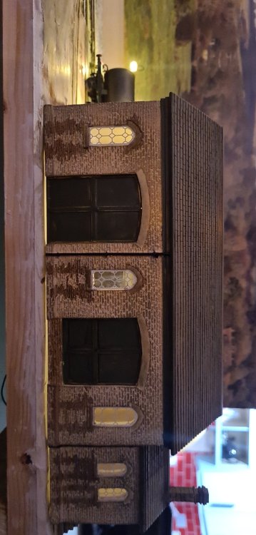

meathdane Posted July 2, 2022 Author Share Posted July 2, 2022 Late night work needs some beverages, Working away to get the layout lit up! Some light bleed issues to sort but progress is moving along steadily! Thanks, Dane 12 Quote Link to comment Share on other sites More sharing options...
Galteemore Posted July 3, 2022 Share Posted July 3, 2022 Terrific work. You should be well pleased with what you’ve achieved so far! 1 Quote Link to comment Share on other sites More sharing options...
JasonB Posted July 3, 2022 Share Posted July 3, 2022 Progressing nicely. The dreaded light bleed is a scourge for us all, but can always be fixed with a bit of work. Great modelling. 1 Quote Link to comment Share on other sites More sharing options...
