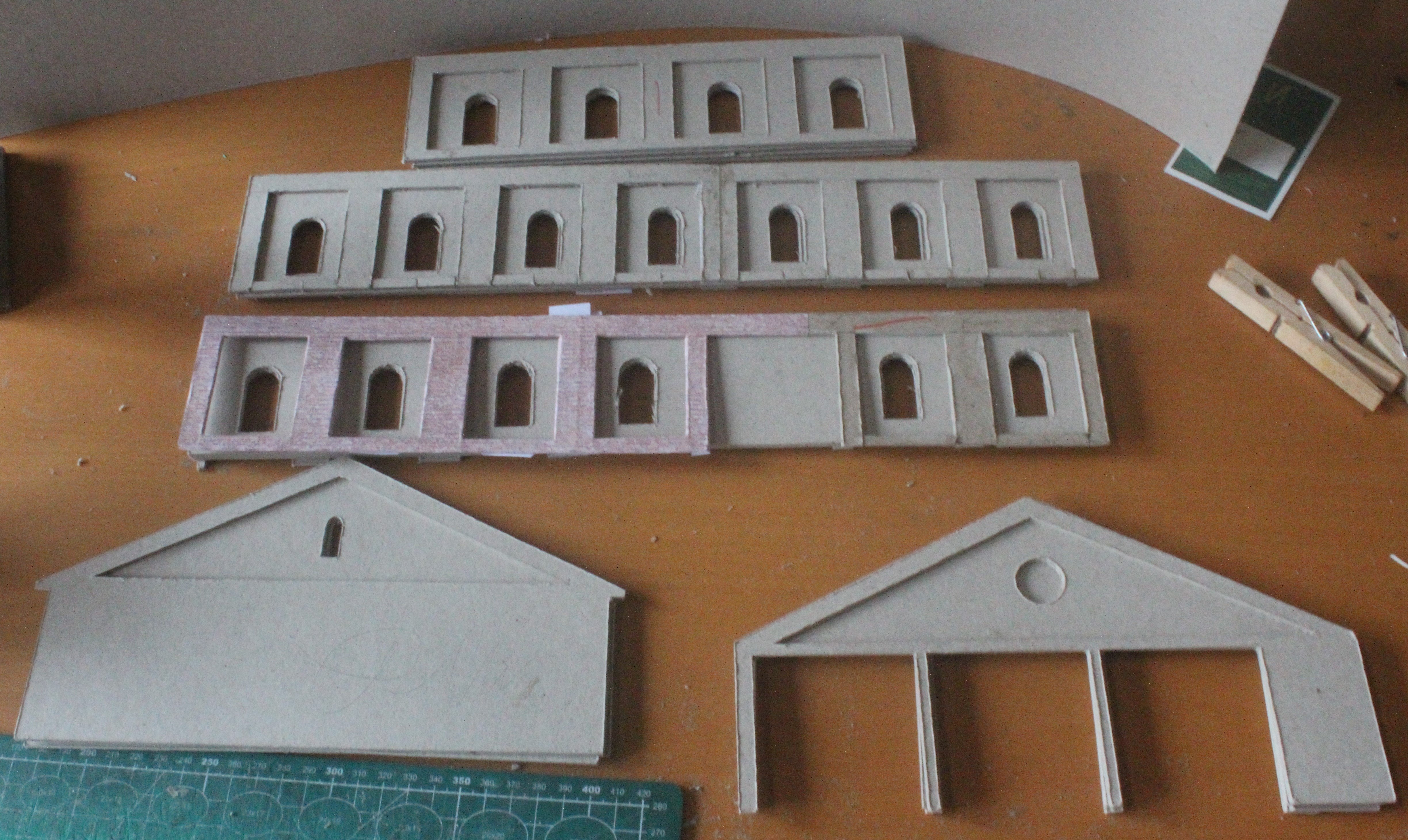

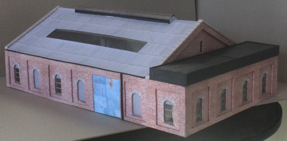

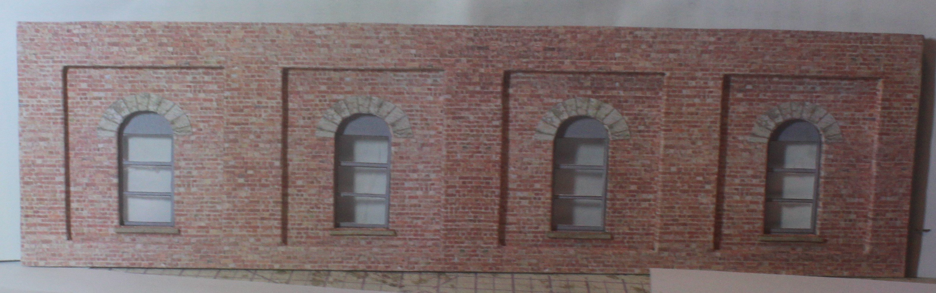

Kevin Sweeney Posted February 5 Author Posted February 5 The Connolly Engine Shed build has begun. Wall panels are all cut and the rear wall facade is done. 13 1

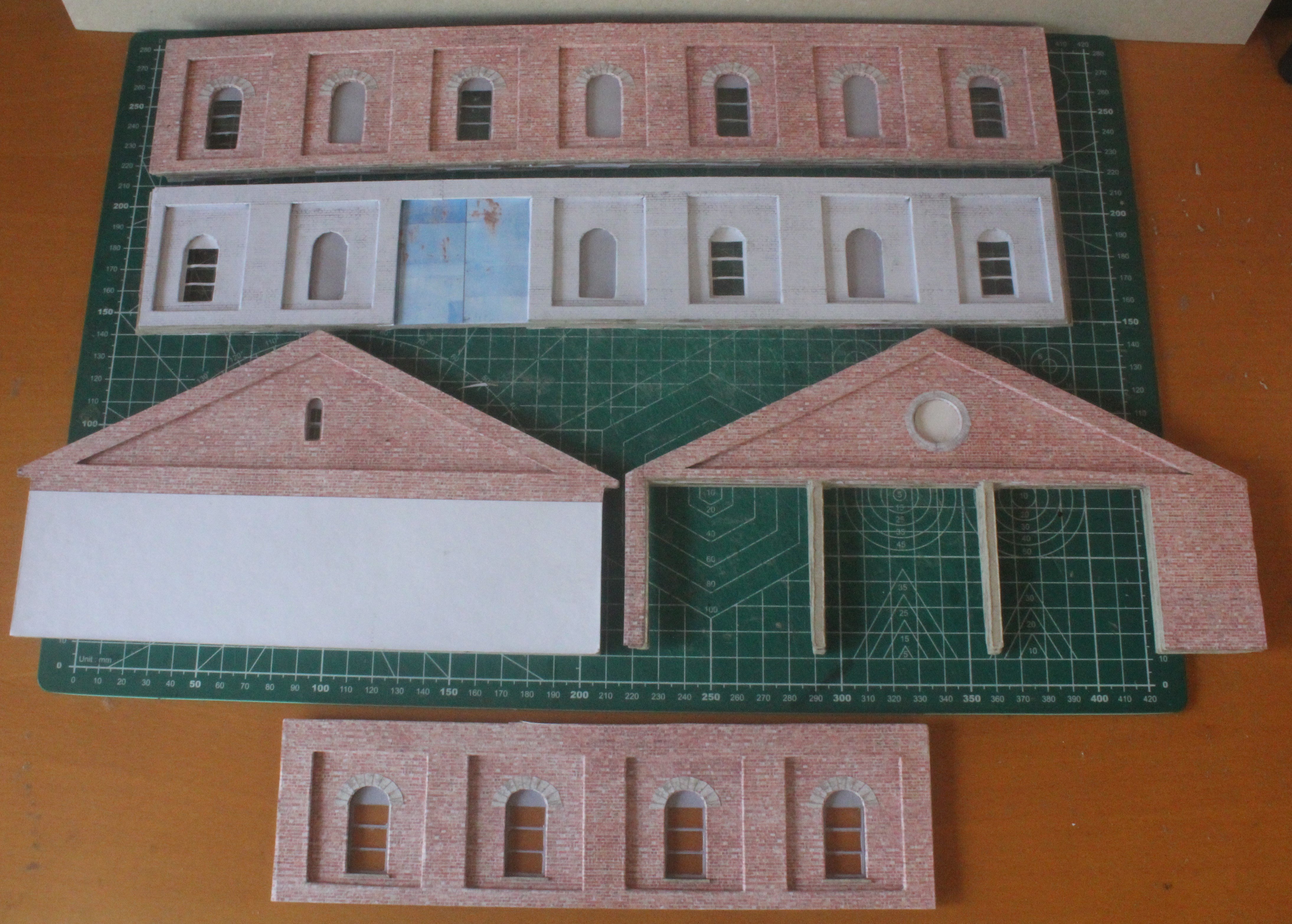

Kevin Sweeney Posted February 11 Author Posted February 11 The wall panels are done. Next job is to assemble them. Then the shed will really begin to take shape. 8

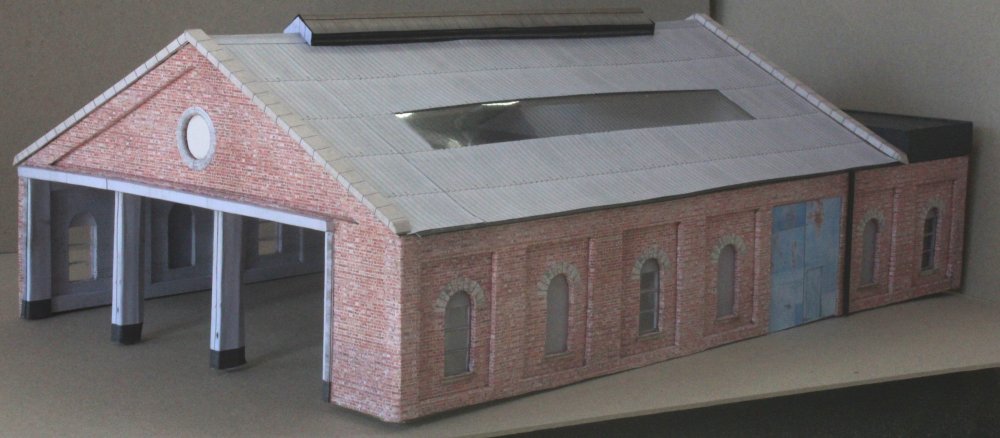

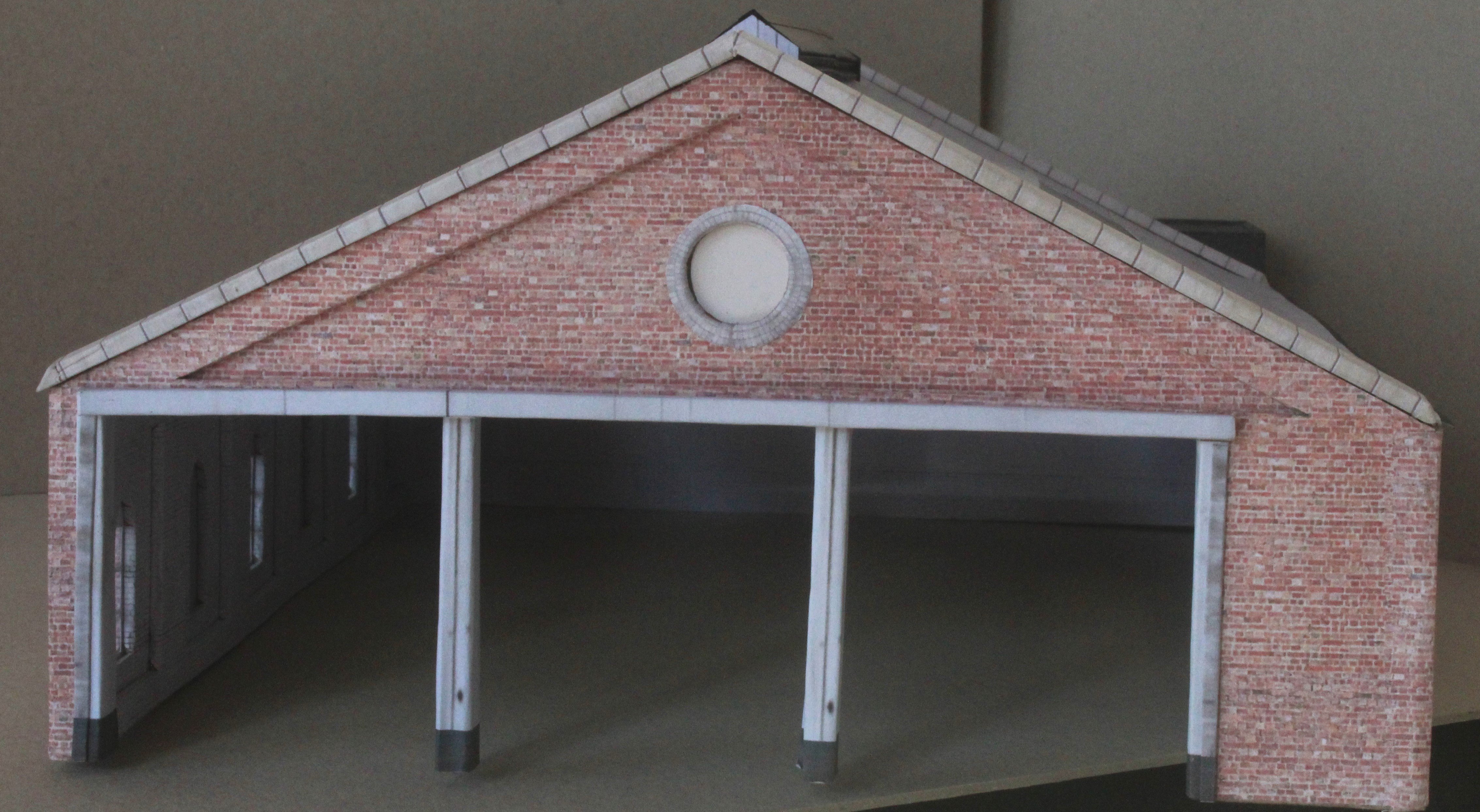

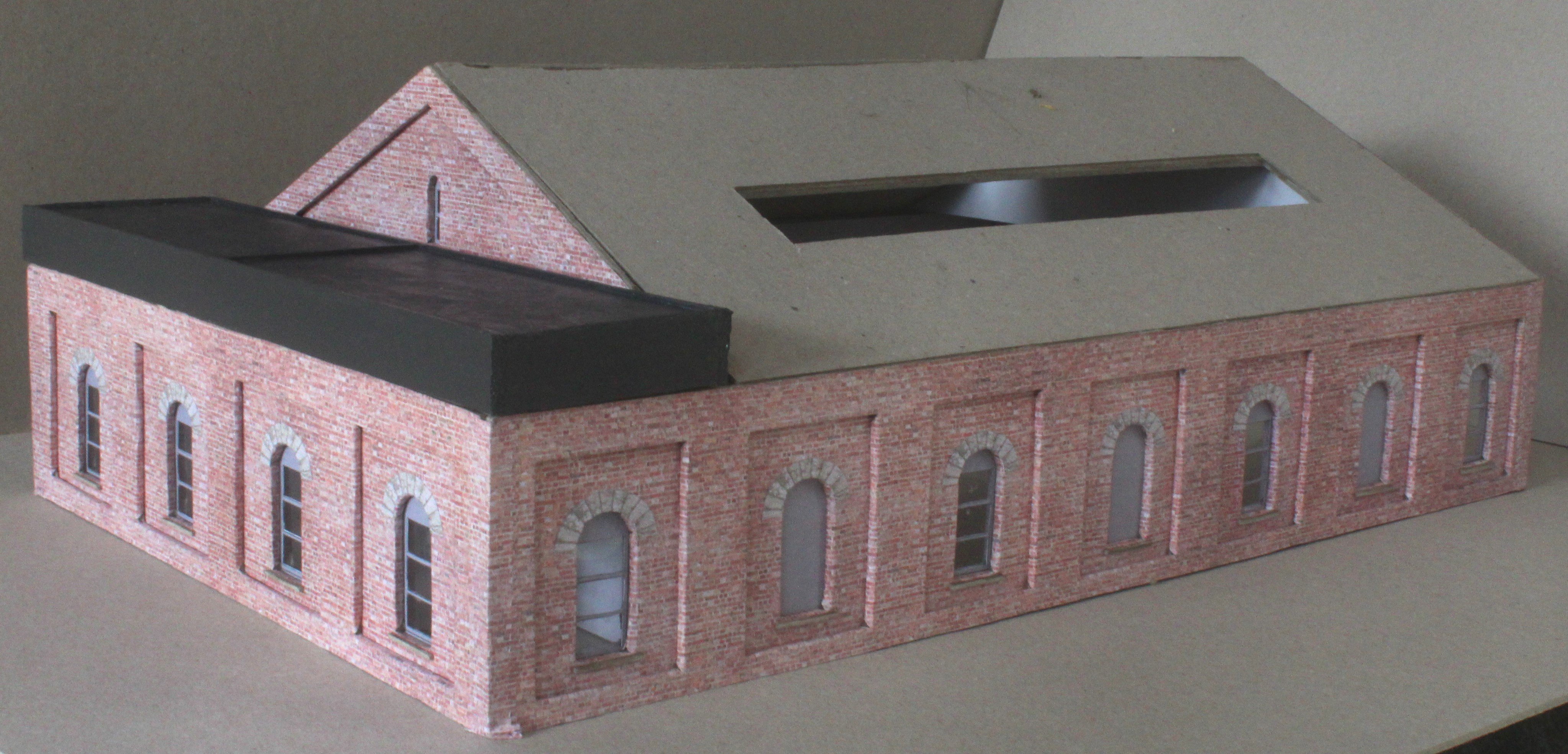

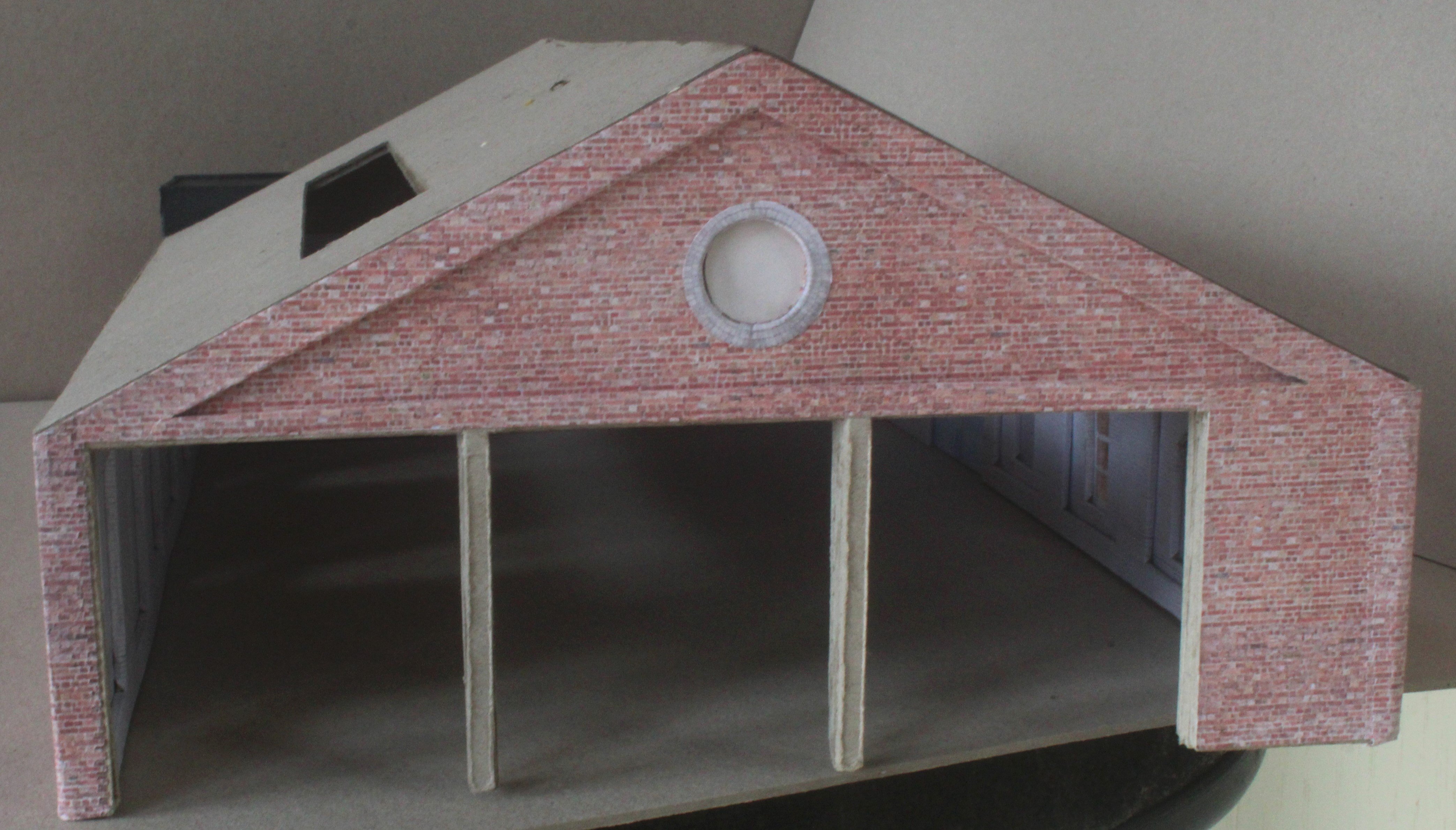

Kevin Sweeney Posted February 27 Author Posted February 27 Current state of play with the Connolly Shed. It's due for delivery to the customer in just over a week. 9 1

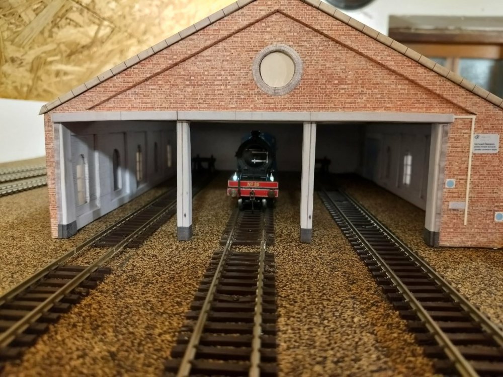

Kevin Sweeney Posted March 6 Author Posted March 6 Just a few finishing touches left to do, but basically the Connolly Shed is finished. 8 8

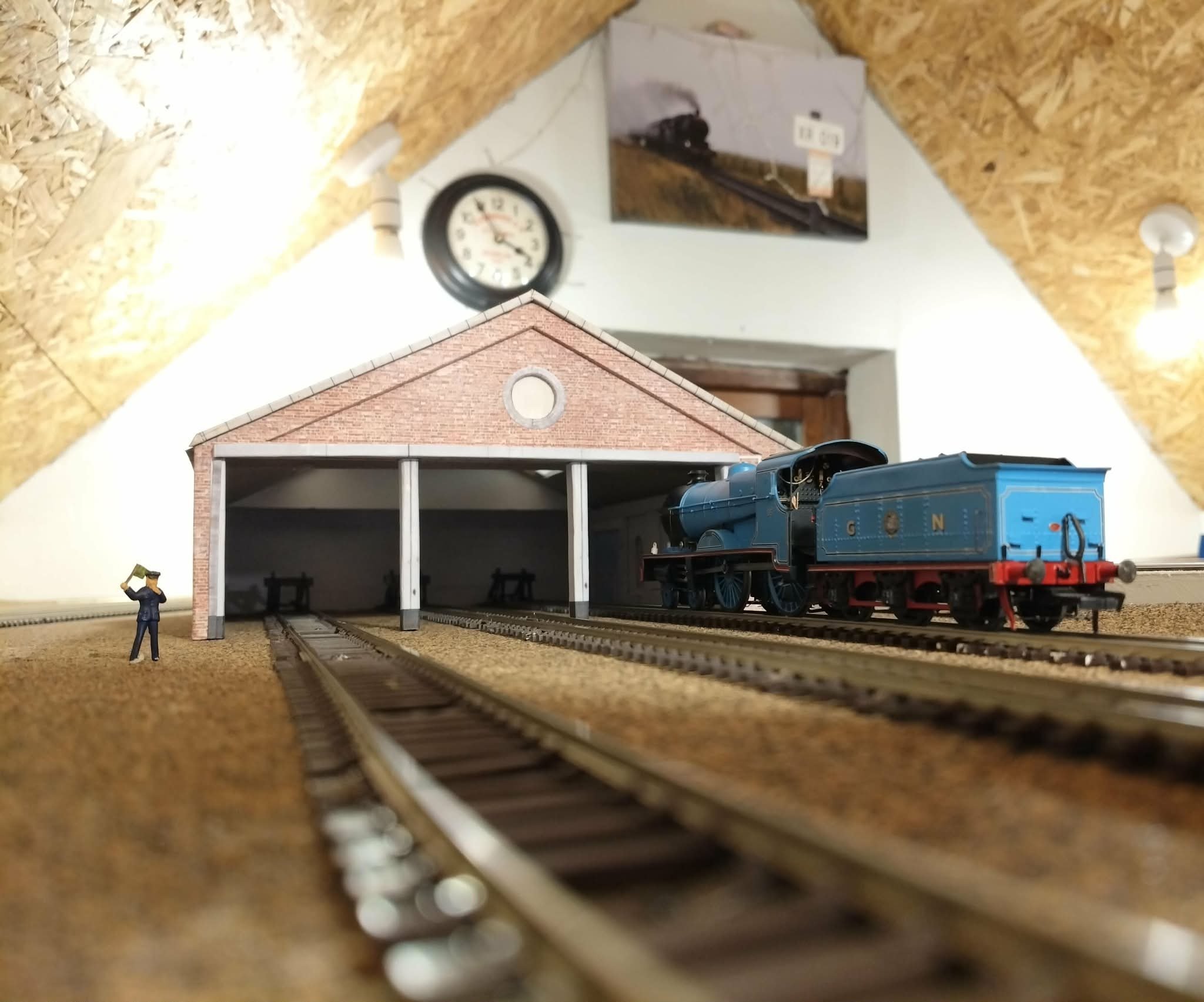

Kevin Sweeney Posted March 21 Author Posted March 21 The Connolly Shed is installed on the customers layout 7 5

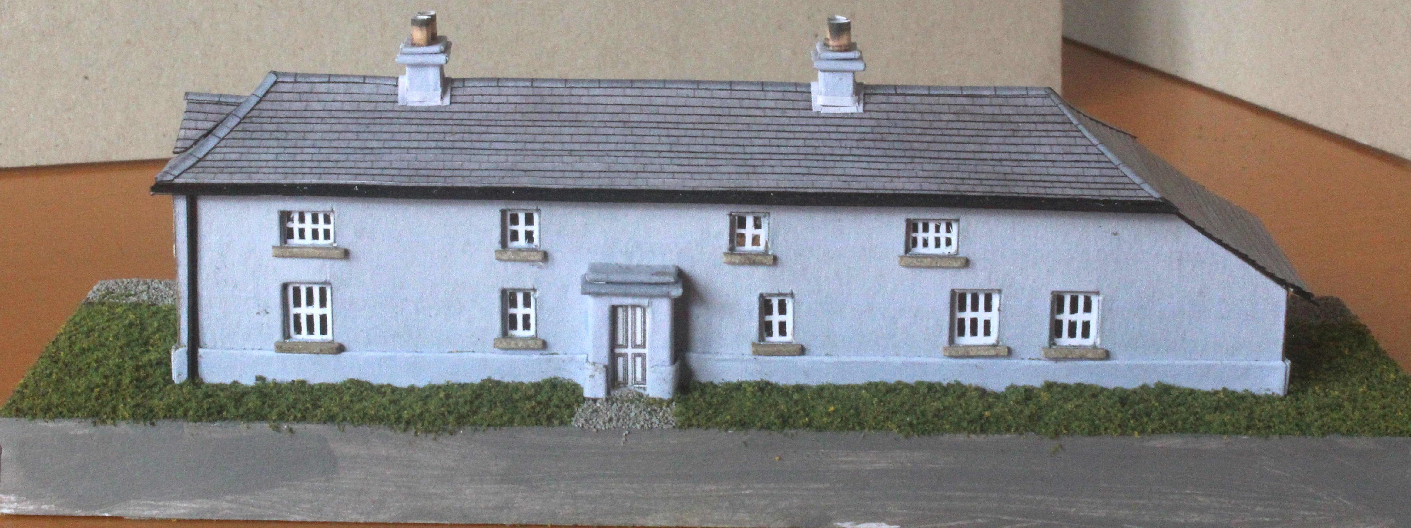

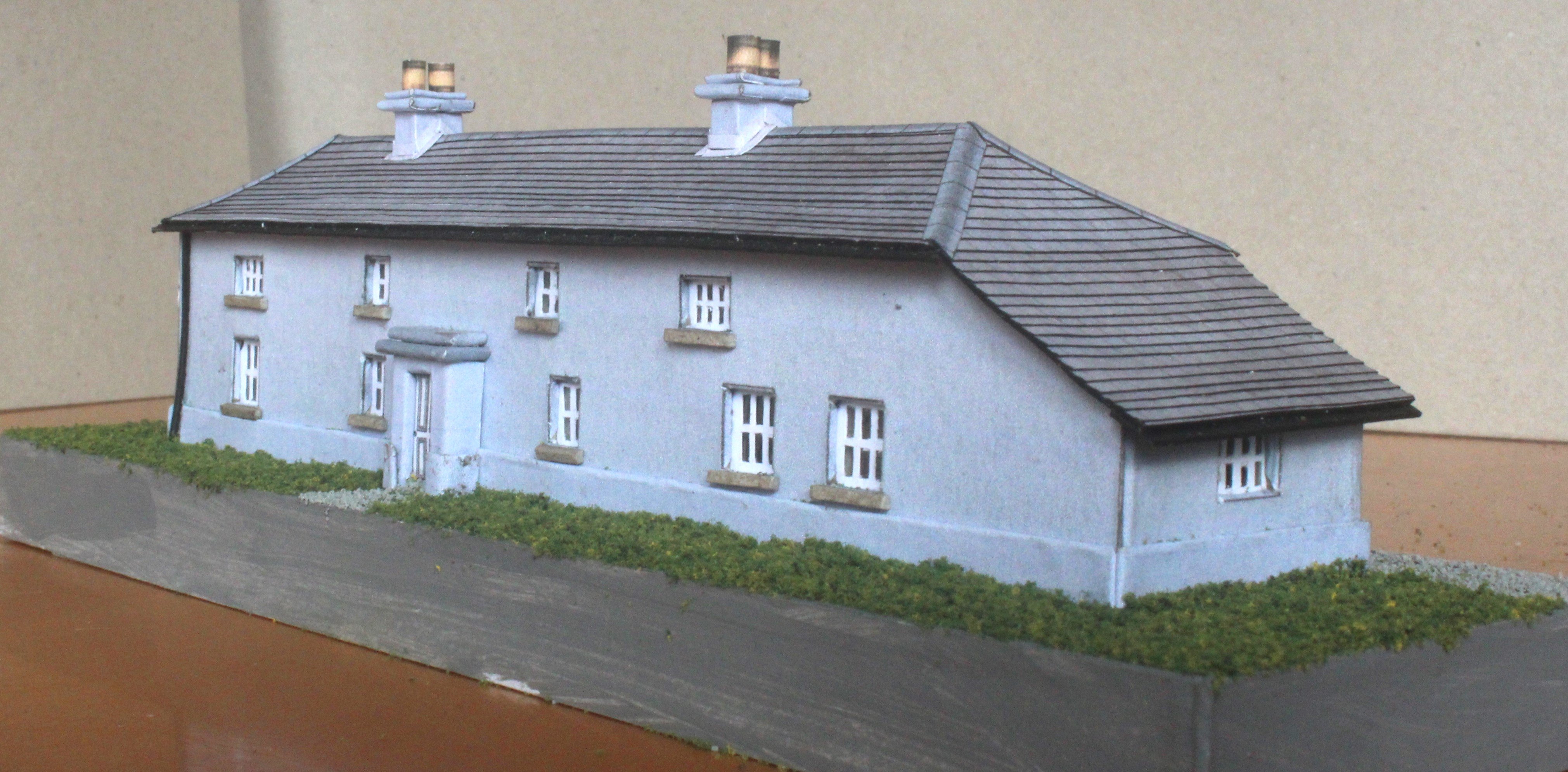

Kevin Sweeney Posted March 21 Author Posted March 21 I've also been making some progress on my next exhibition. This is a model of Nixon's House, Fortland, Ballymachugh, Co Cavan. This house was once part of the Maxwell Estate. It was the house of the Land Agent. It was here that tenants of the estate came to pay their rents. It is widely regarded as the oldest house in the locality. 8 5
Patrick Davey Posted March 21 Posted March 21 1 hour ago, Kevin Sweeney said: The Connolly Shed is installed on the customers layout That loco too!!!! Awesome work on the shed Kevin - perfect setting for No. 85. 1

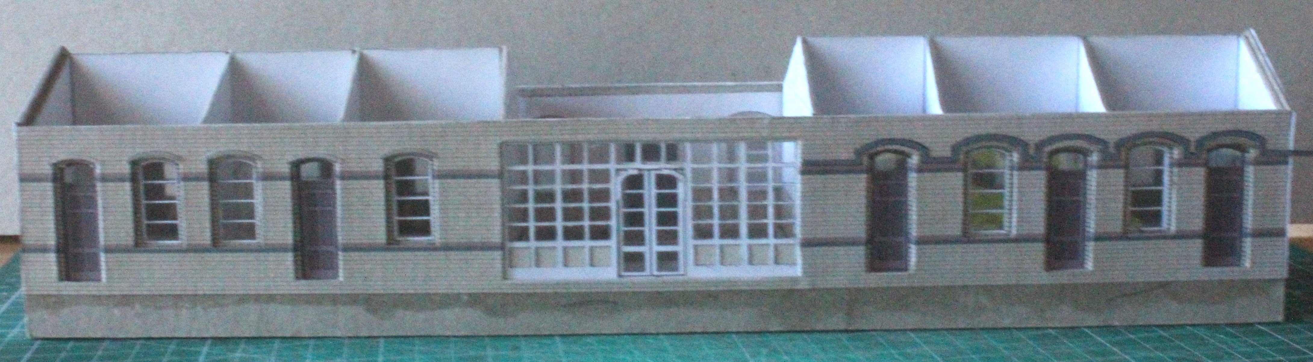

Kevin Sweeney Posted April 17 Author Posted April 17 I'm working on a OO model of Navan Station. It is my second commission. 5 8

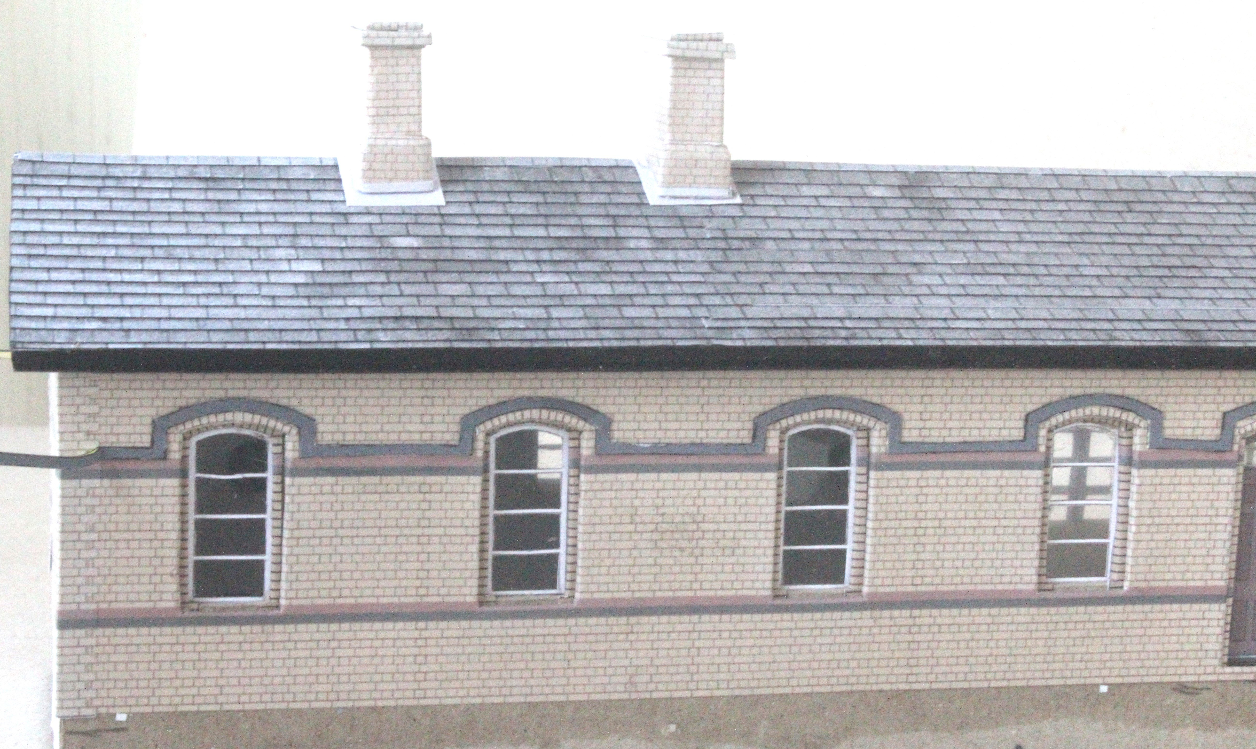

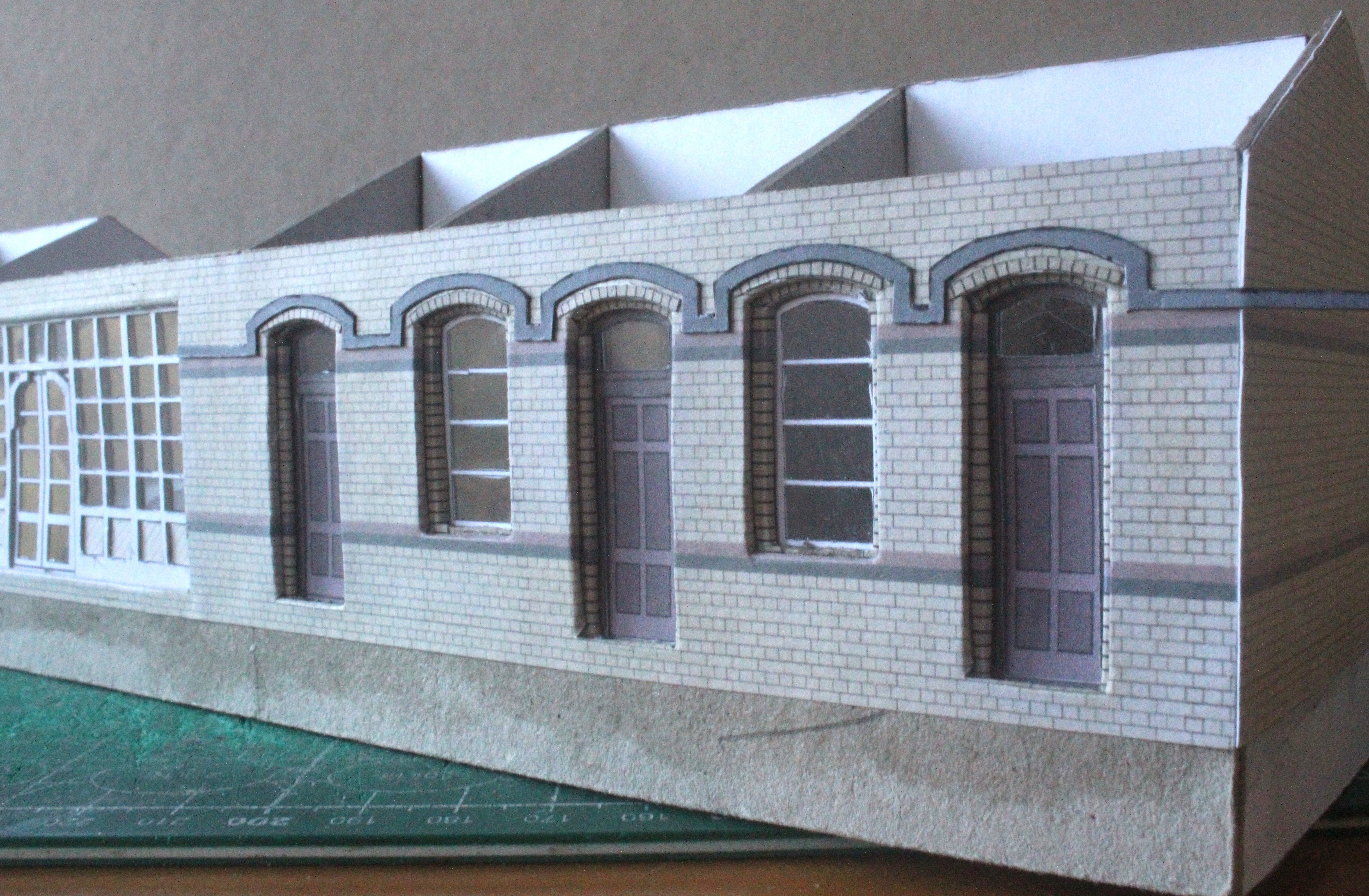

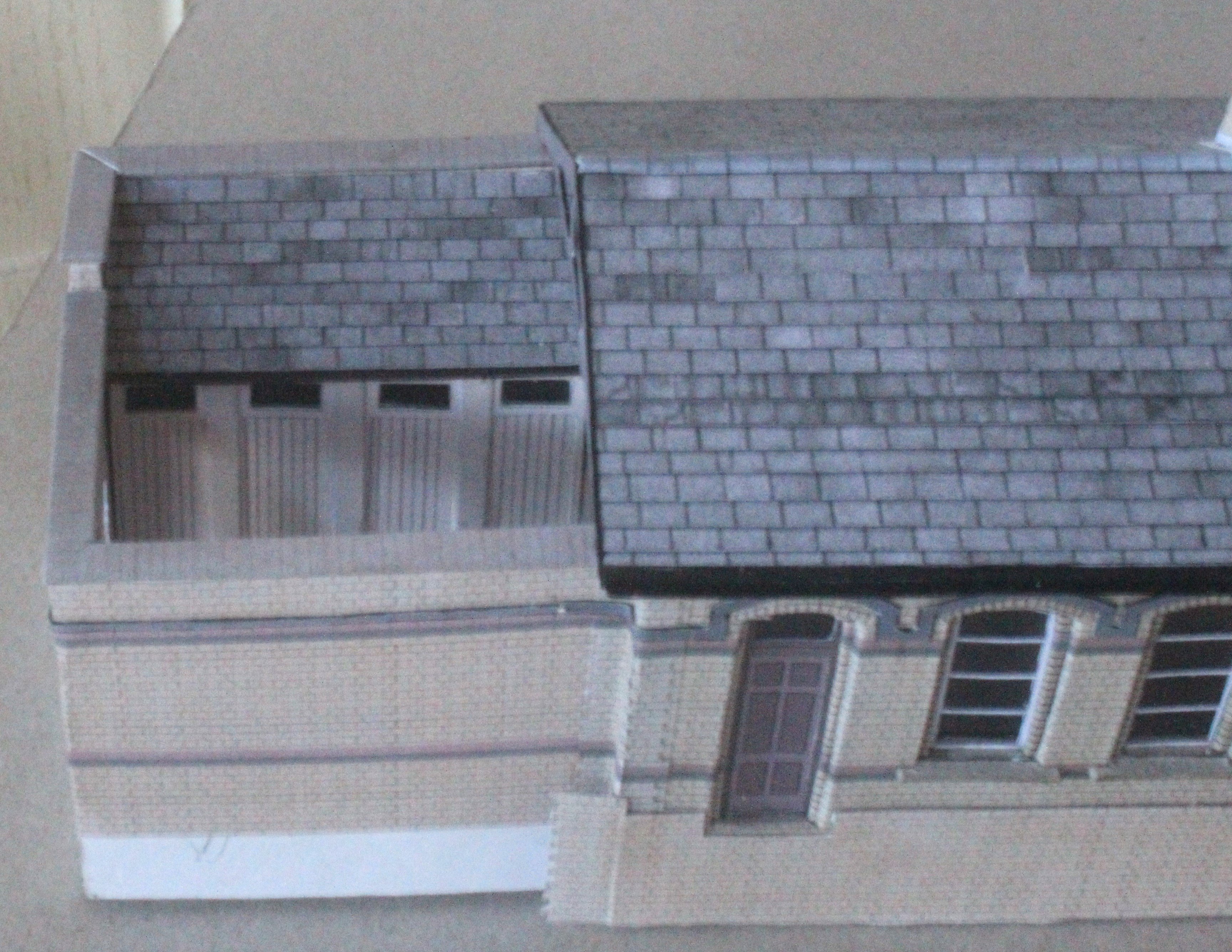

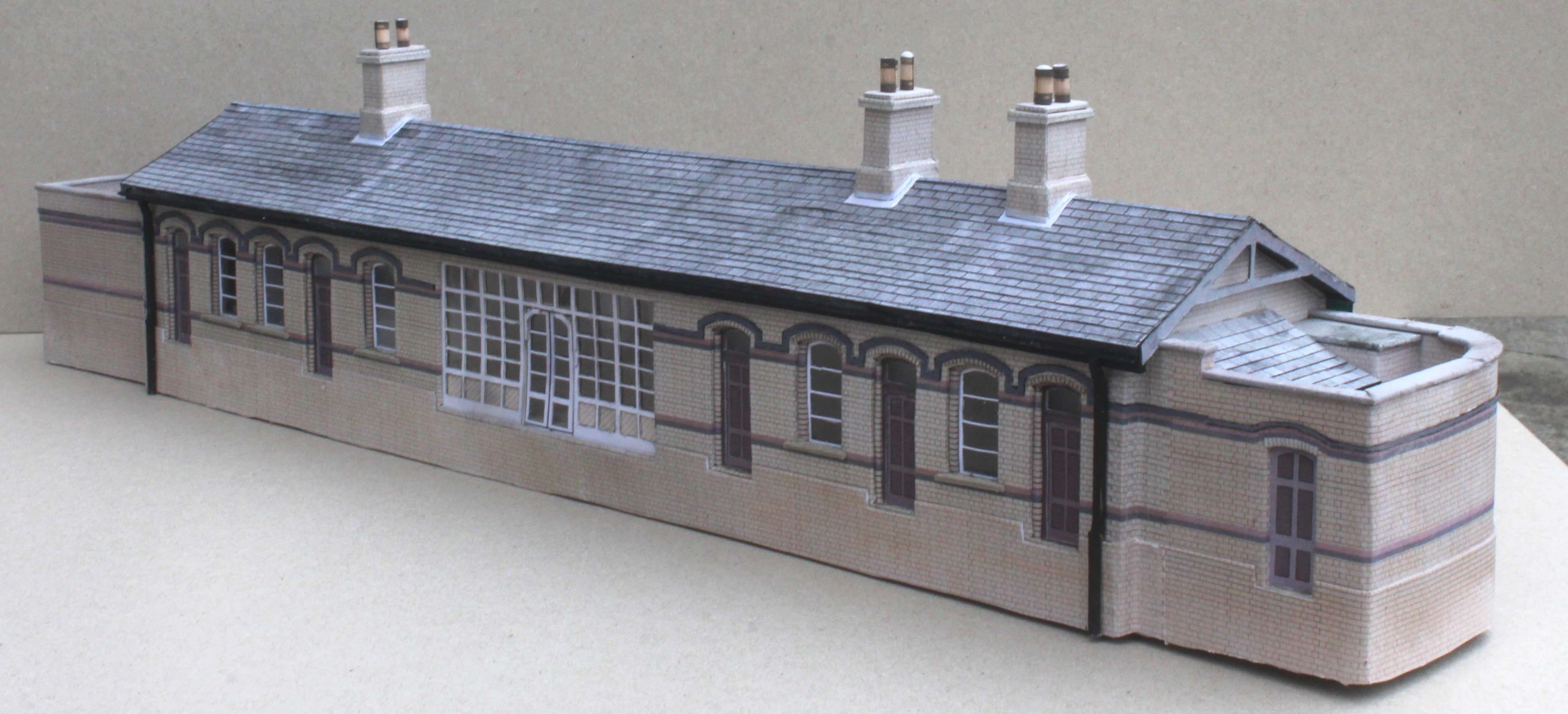

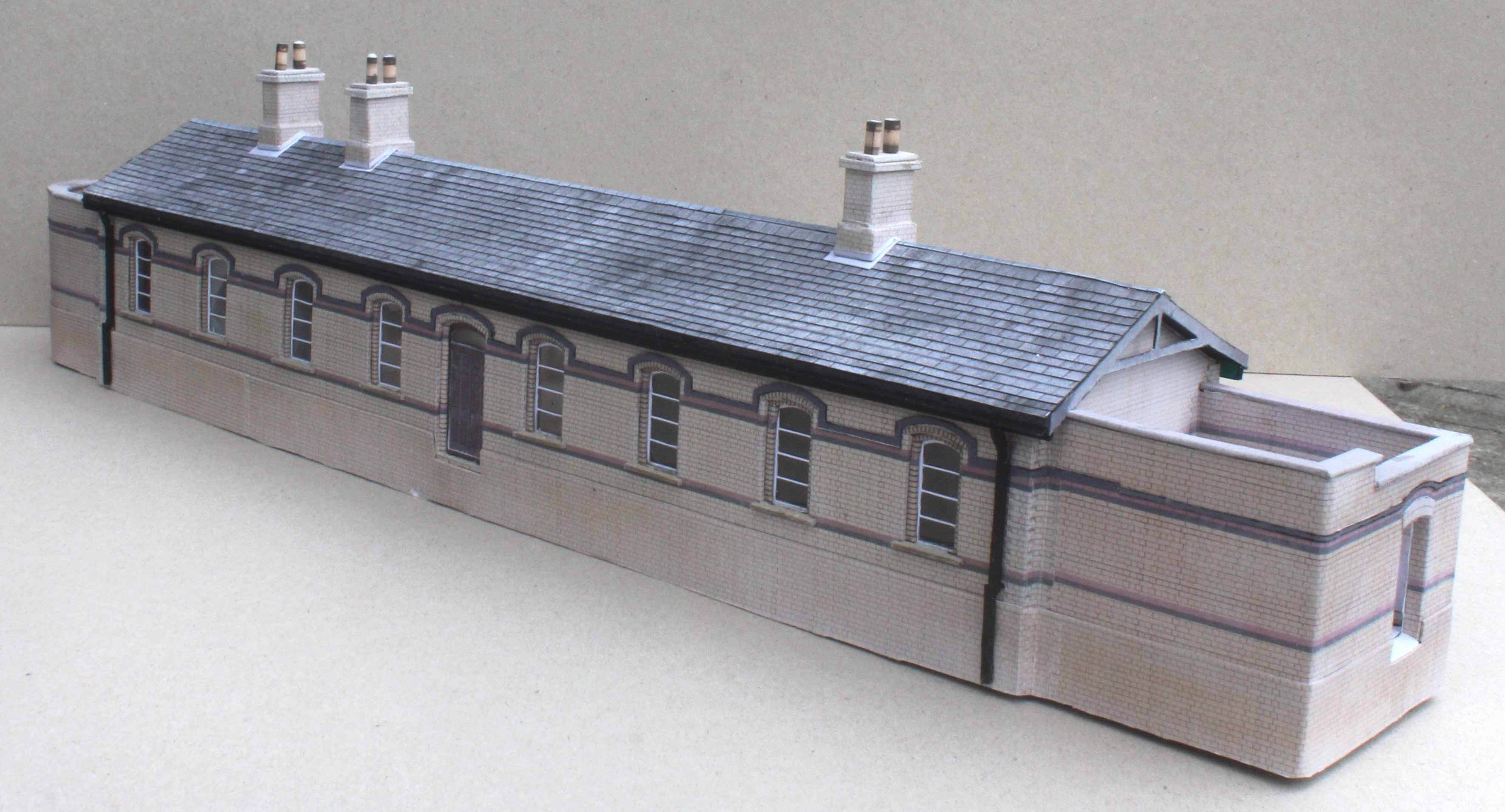

Kevin Sweeney Posted April 28 Author Posted April 28 Getting close to a finish on Navan Station. The model will not have any canopies, some plints on the wings and downpipes will finish it. 9 5

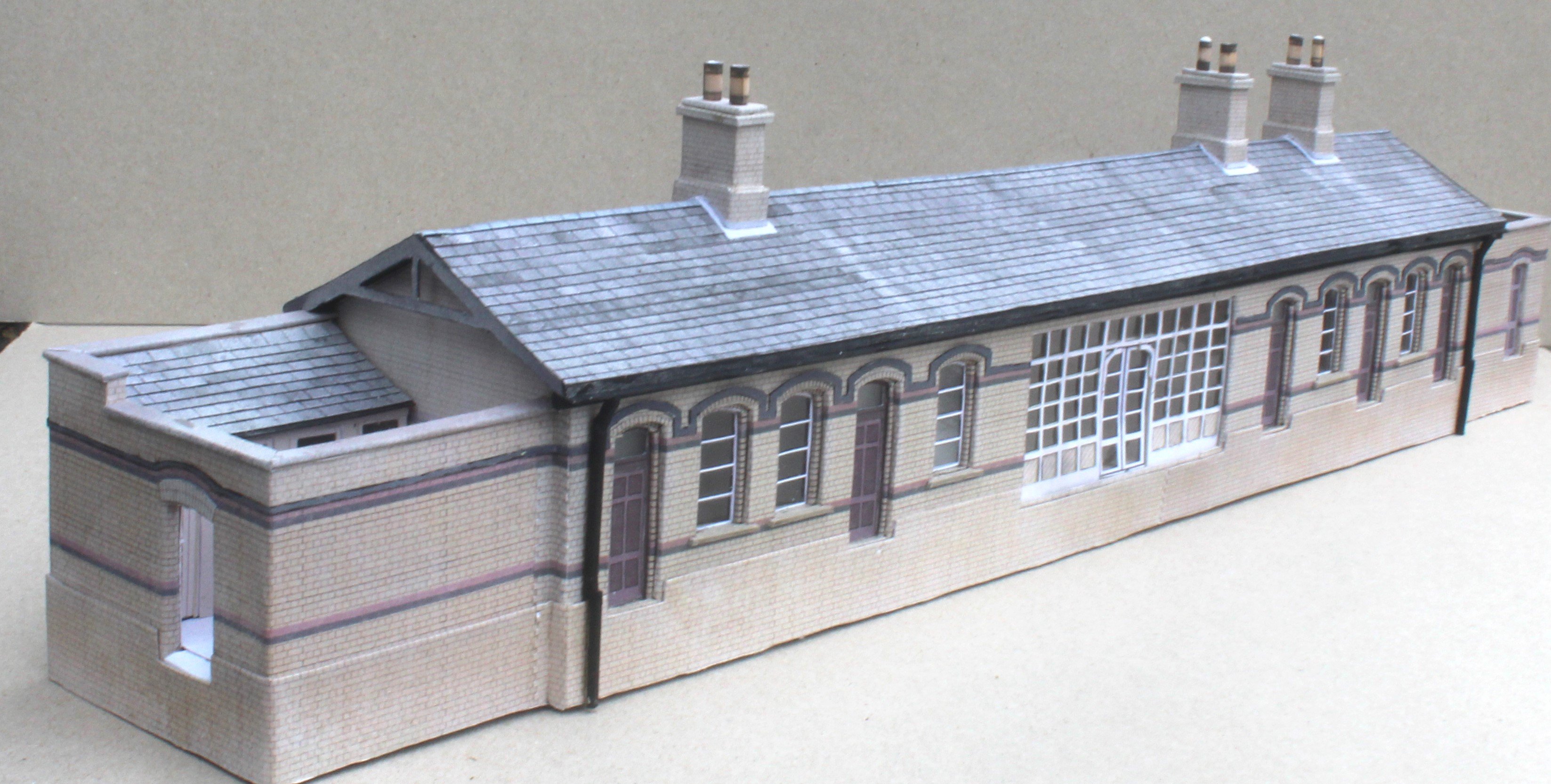

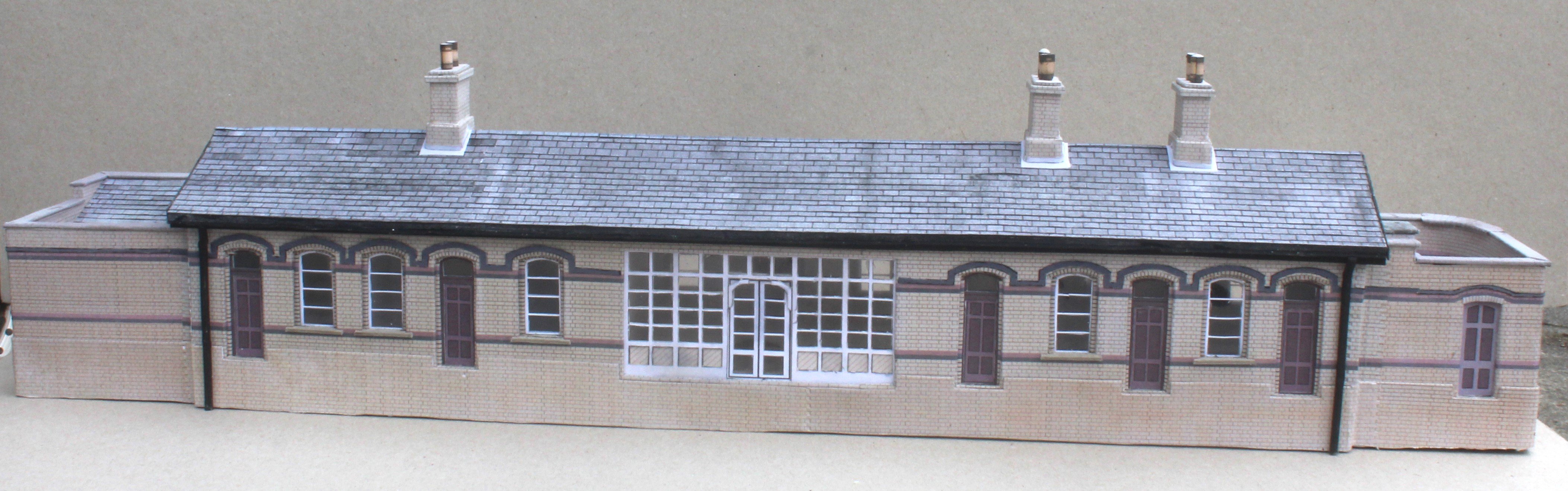

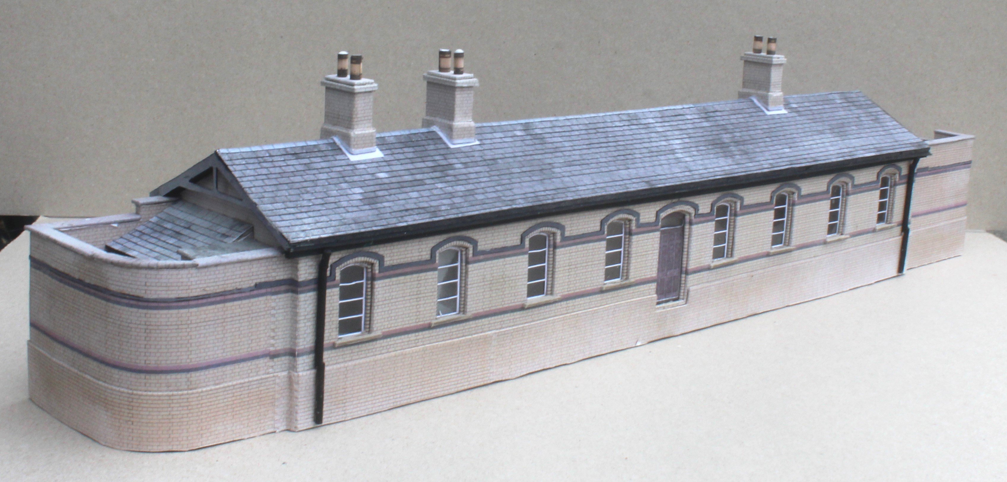

Kevin Sweeney Posted May 1 Author Posted May 1 Navan Station is finished. Customer is collecting it today 10 5
Georgeconna Posted May 1 Posted May 1 Very well done. Love the curved wall and the roof is very well done. Are those printed on or painted on?
Kevin Sweeney Posted May 1 Author Posted May 1 37 minutes ago, Georgeconna said: Very well done. Love the curved wall and the roof is very well done. Are those printed on or painted on? The roof is done with Scalescenes textures, so printed out, cut into stips and glued on.
