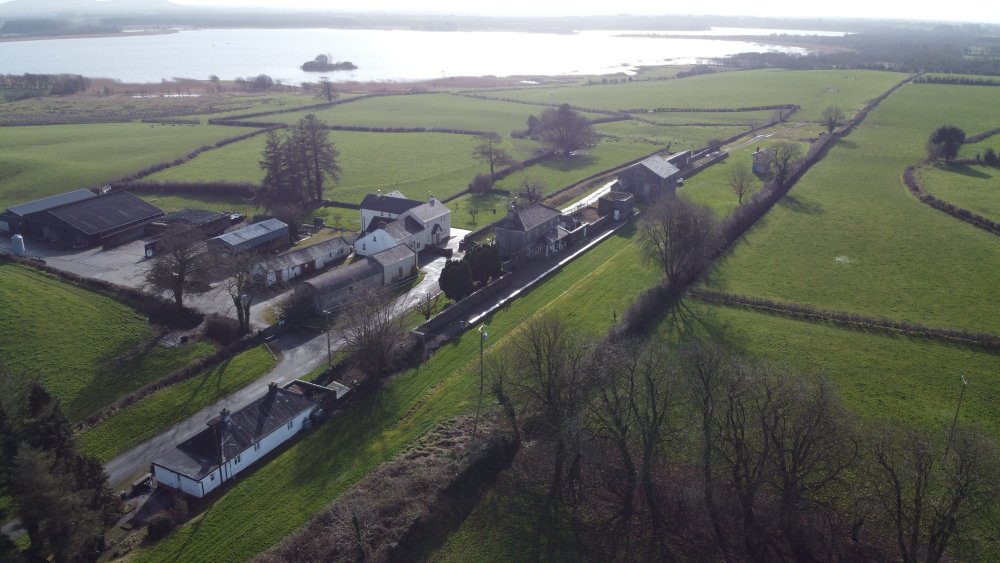

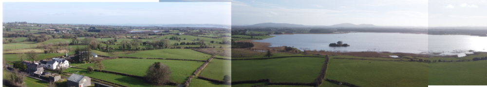

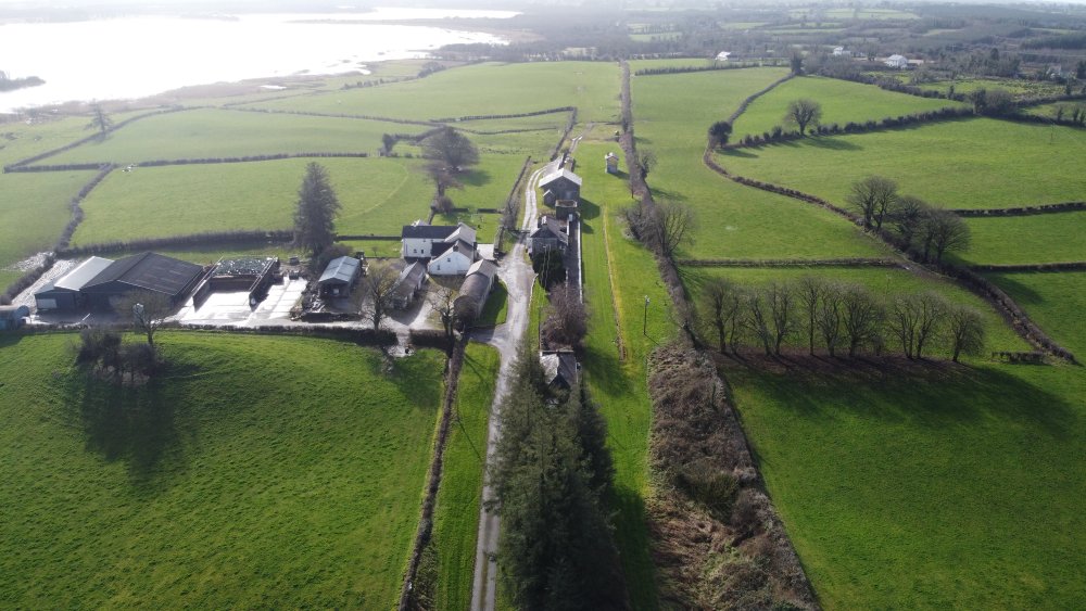

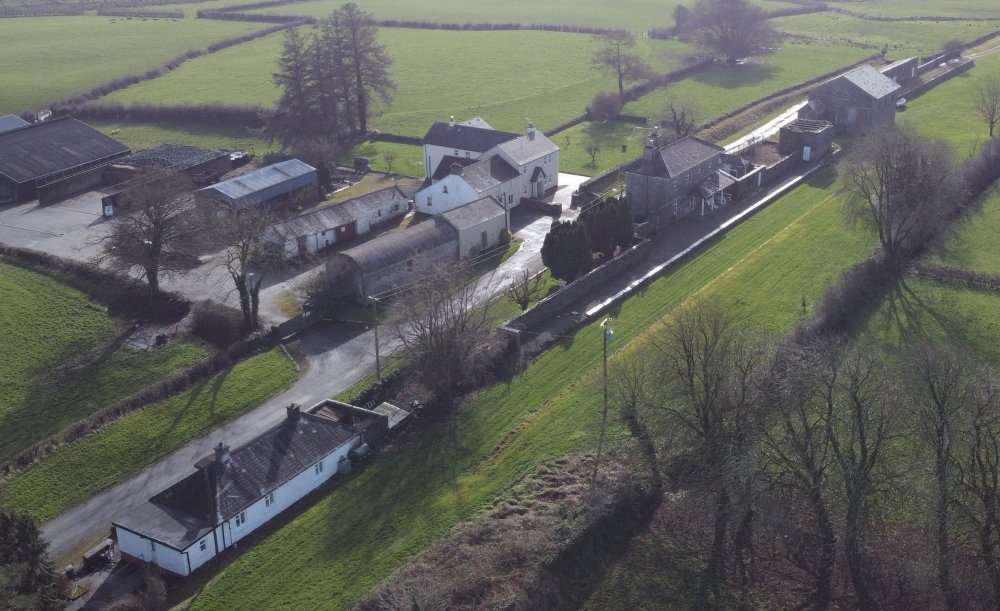

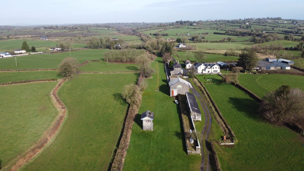

Kevin Sweeney Posted February 25, 2022 Author Posted February 25, 2022 (edited) On 23/2/2022 at 9:44 PM, David Holman said: By all means use a drone to build your backscene, but have a think about the viewing angle you want for your layout, as the horizon may be lower than you think. You were right, it took 25 meters of altitude to bring Lough Sheelin into the picture, so the drone plan is dead. I did how ever get some good aerial shots of the station. Looking south towards Inny Junction. Looking north towards Cavan Edited February 25, 2022 by Kevin Sweeney 8 Quote
jhb171achill Posted February 25, 2022 Posted February 25, 2022 Didn’t realise there was so much left of that station, including the signal cabin! Superb stuff….. 1 Quote
Kevin Sweeney Posted February 25, 2022 Author Posted February 25, 2022 (edited) 1 hour ago, jhb171achill said: Didn’t realise there was so much left of that station, including the signal cabin! Superb stuff….. All that is missing is the track, signals, water tank and cattle pens. Everything else is still there and very well preserved. Edited February 25, 2022 by Kevin Sweeney Quote
David Holman Posted February 25, 2022 Posted February 25, 2022 So, 25 metres, approx 80 feet, so 160mm above the layout in N. Not a lot when you think about it to get that view. 1 Quote
Kevin Sweeney Posted February 25, 2022 Author Posted February 25, 2022 1 hour ago, David Holman said: So, 25 metres, approx 80 feet, so 160mm above the layout in N. Not a lot when you think about it to get that view. The sun was against me, my positioning was wrong and I had no idea what I was at. If I go back for another try on a better day I should do better but this image gives some idea of the landscape I have to play with for the back scene. 1 1 Quote

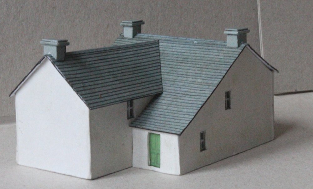

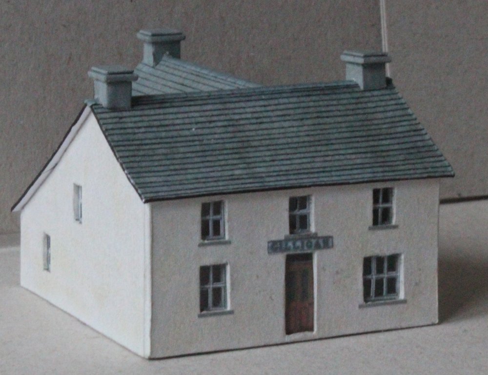

Kevin Sweeney Posted March 2, 2022 Author Posted March 2, 2022 Almost there with Gilligan's pub. Just the chimney pots, flashing, sills and downpipes, left to do. The good weather is causing serious delays in my modelling, I need some bad weather to drive me out of the garden and back indoors. 7 1 Quote

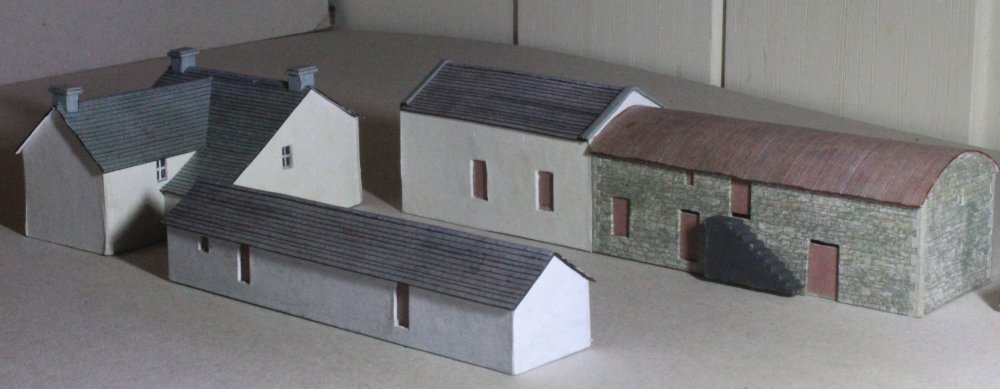

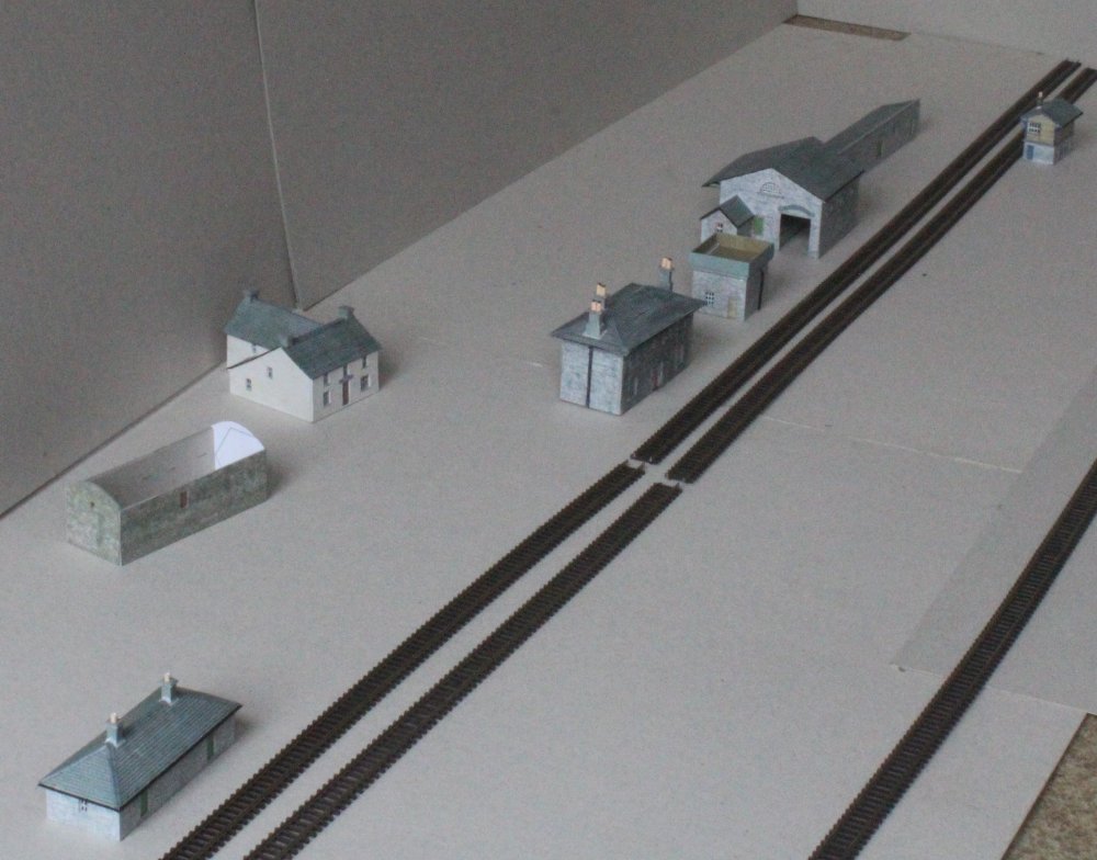

Kevin Sweeney Posted March 2, 2022 Author Posted March 2, 2022 Progress so far on Ballywillan. I've started work on the first barn in Gilligan's farmyard. 5 3 Quote
Noel Posted March 2, 2022 Posted March 2, 2022 This is shaping up to be something very special and unique. Excellent capturing the essence of a real place. Class 2 2 Quote

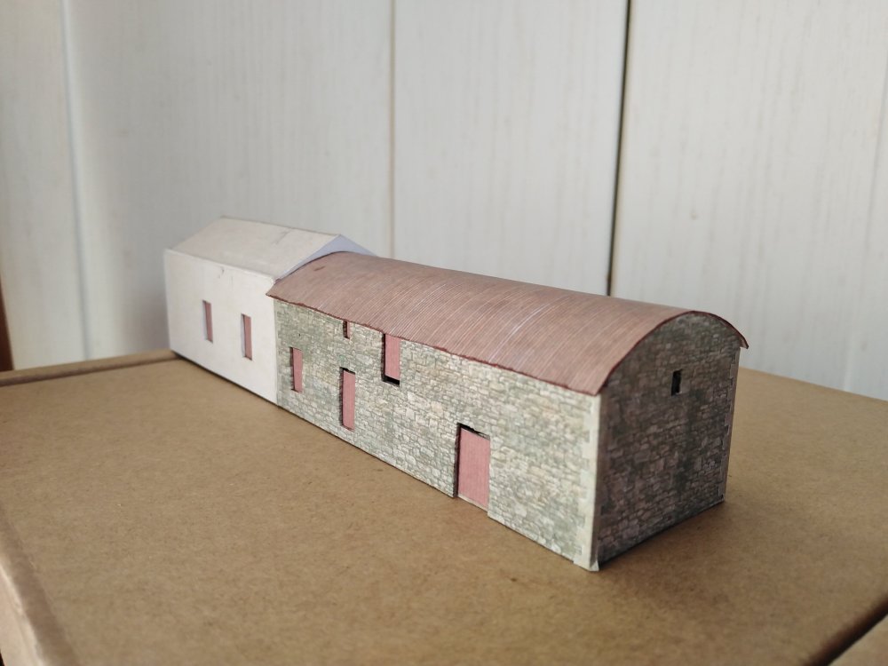

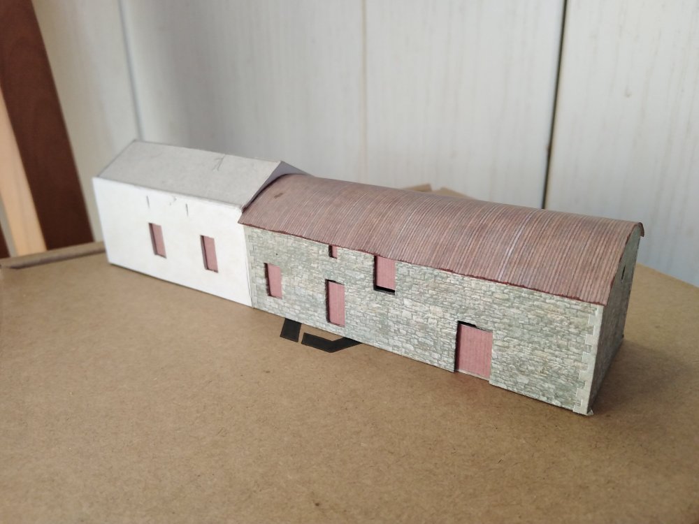

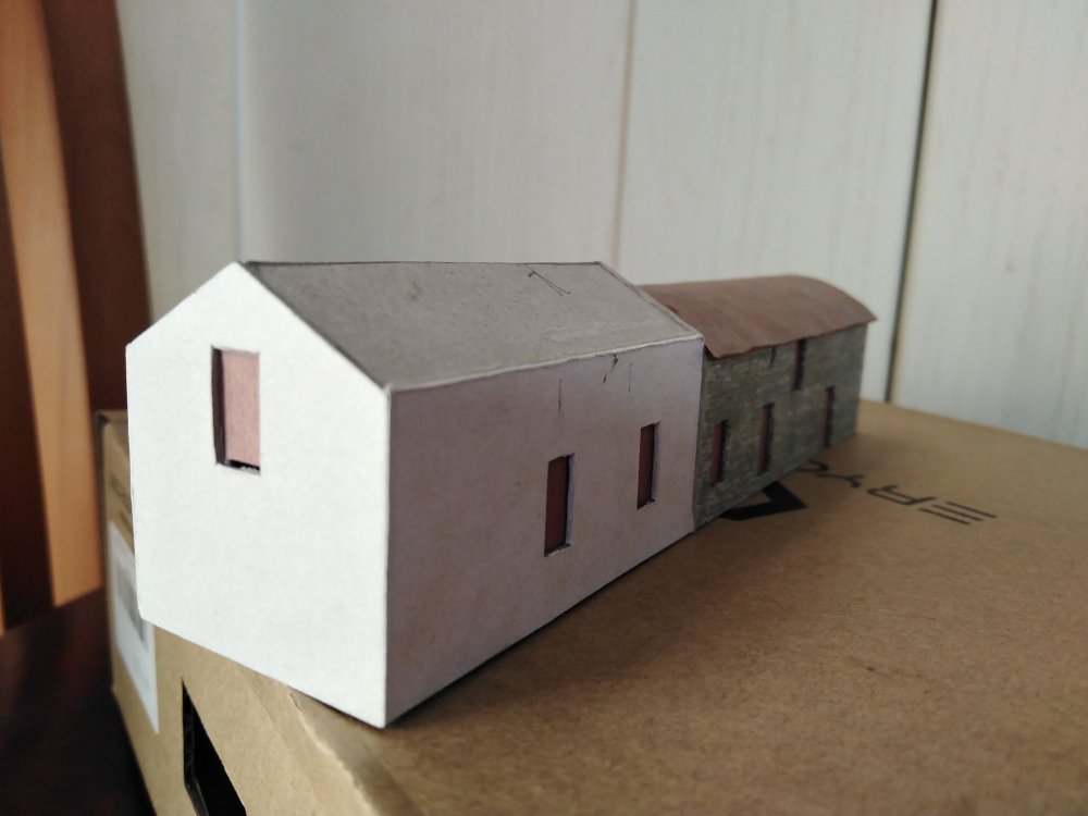

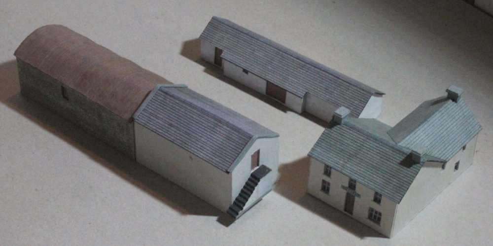

Kevin Sweeney Posted March 6, 2022 Author Posted March 6, 2022 Progress so far on Gilligan's barns. I had a day out in the big smoke, it was great to get away on the train, and I came home with a 3d printer. The plan is to make barrels, crates and other cargo. Should also be possible to make a cart and some other farming accoutrements for Gilligan's yard. Being a complete novice to 3d printing and CAD it is a very steep learning curve and so far all my output has been binned. But I'm making progress. I also visited the exhibition of railways drawings at the Irish Architectural Archive, on Merrion Square, well worth a visit if your in the area. I got some photos which may turn into future scratch builds. Irish Architectural Archive – Cartlann Ailtireachta na hÉireann (iarc.ie) 8 3 Quote
Galteemore Posted March 6, 2022 Posted March 6, 2022 Excellent. The corrugated roof has real character. 1 1 Quote
connollystn Posted March 6, 2022 Posted March 6, 2022 A former neighbour of mine lived in a gate house near Ballywillan station and remember distinctly them mentioning that they lived near Lough Kinale so that could the name of the lake in the background and not Sheelin. They moved to Longford following the closure of the Cavan branch. Looking forward to the completion of your layout. Quote
Kevin Sweeney Posted March 6, 2022 Author Posted March 6, 2022 3 hours ago, connollystn said: A former neighbour of mine lived in a gate house near Ballywillan station and remember distinctly them mentioning that they lived near Lough Kinale so that could the name of the lake in the background and not Sheelin. They moved to Longford following the closure of the Cavan branch. Looking forward to the completion of your layout. Kinale is the nearest and most visible lake, but nearby and visible in the backscene will be both Sheelin and Bracklagh lake. Thankfully we are not short of lakes in this part of the world. Strangely most locals don't call the lake Kinale, they call it Killana. Quote
David Holman Posted March 6, 2022 Posted March 6, 2022 10 hours ago, Galteemore said: Excellent. The corrugated roof has real character. Likewise! What did you use for the roof? Quote
Kevin Sweeney Posted March 6, 2022 Author Posted March 6, 2022 48 minutes ago, David Holman said: Likewise! What did you use for the roof? This is the pdf I printed from Inkscape. The roof texture is glued onto 200 gsm card, cut to size (not on this printout). The white edges are painted with a dark marker. The secret is to pre bend the card before gluing the texture sheet, use a workable glue like PVA and get all the wrinkles out before the glue is dry. 3 Quote

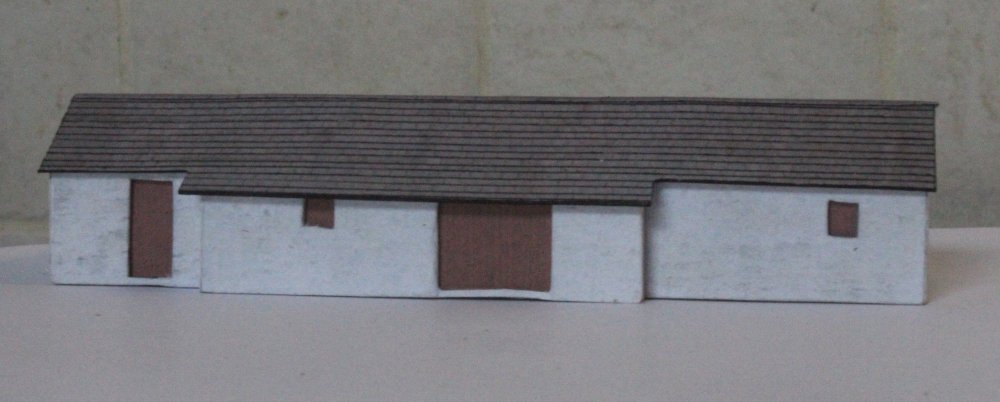

Kevin Sweeney Posted March 10, 2022 Author Posted March 10, 2022 Finished Gilligan's farm sheds. I have yet to build the sheds next to the station house, and have a few finishing touches to put on Gillian's pub and barns. I've started work on the road bridge at the north end of the station. I have completed the abutments but have no images of the bridge itself. I remember it as a child but only recall it was a metal bridge. Lacking any images I'm just going to use a Scalescenes plate girder bridge kit. Almost there with the buildings. 5 3 Quote

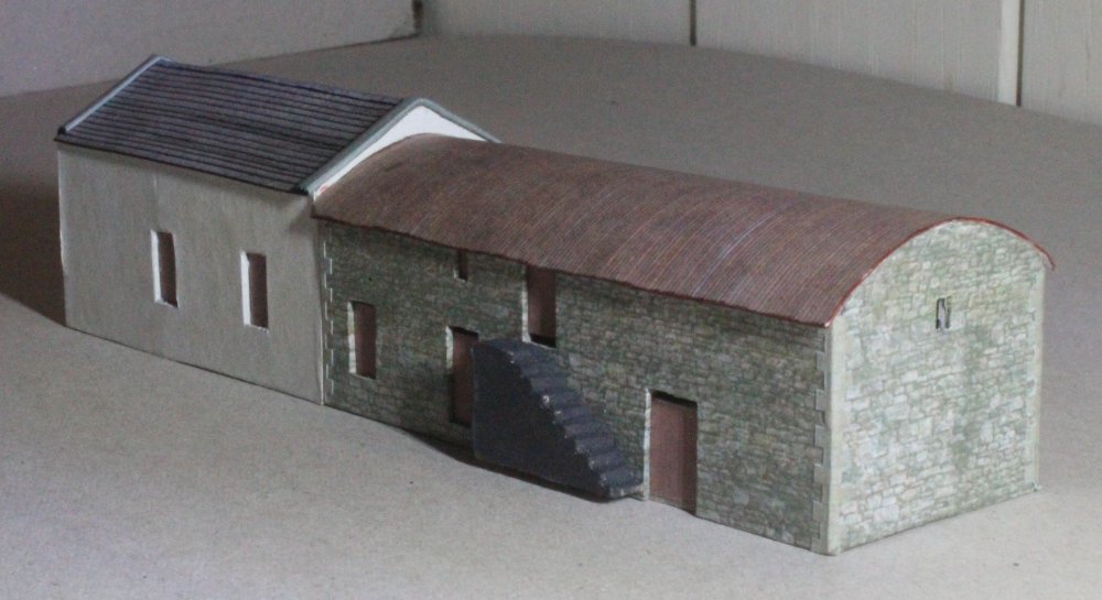

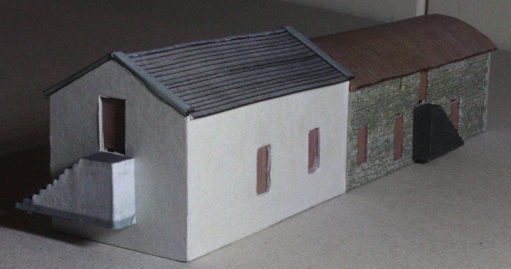

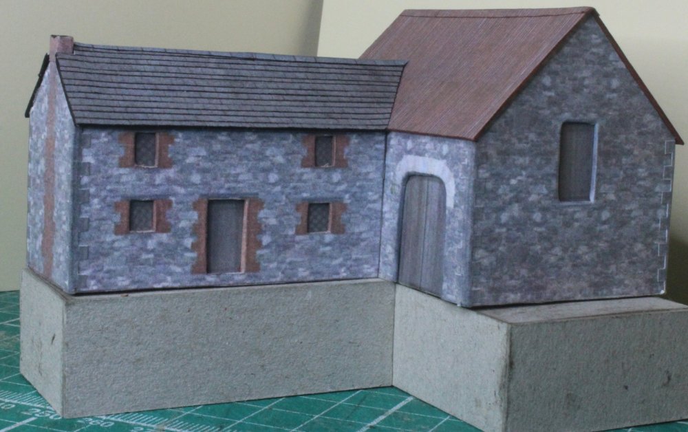

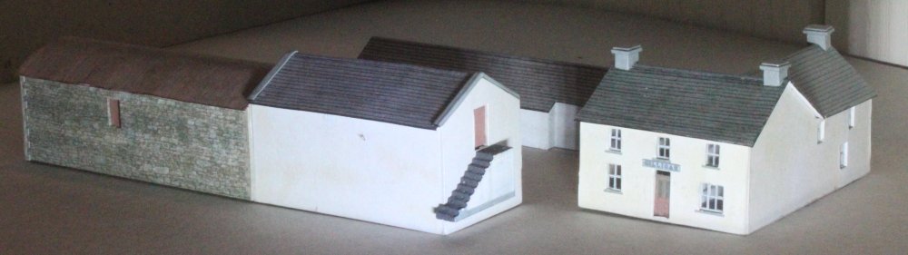

Kevin Sweeney Posted March 11, 2022 Author Posted March 11, 2022 Gilligan's barns and the current state of the farm yard. On the base board the pub will be raised higher in relation to the barn, than in these photos. 11 2 Quote
Galteemore Posted March 11, 2022 Posted March 11, 2022 (edited) Wonderful stuff. My grandparents farm had an outbuilding just like that with an external staircase. All whitewashed walls and red timber work back in the day. Really nice work and atmosphere is building well. You’d have a lot of customers if you launched this as a kit ! Edited March 11, 2022 by Galteemore Quote
Kevin Sweeney Posted March 11, 2022 Author Posted March 11, 2022 2 hours ago, Galteemore said: Wonderful stuff. My grandparents farm had an outbuilding just like that with an external staircase. All whitewashed walls and red timber work back in the day. Really nice work and atmosphere is building well. You’d have a lot of customers if you launched this as a kit ! I doubt I'll get round to making a kit, not right now anyway. In the future who knows. Vernacular farm buildings make very nice models. 1 Quote

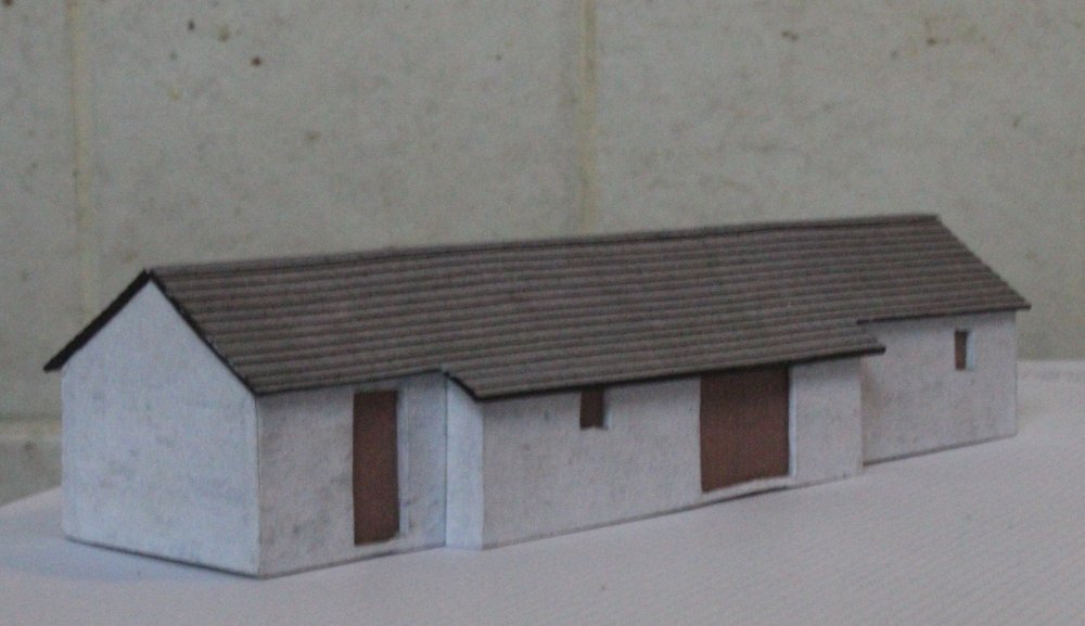

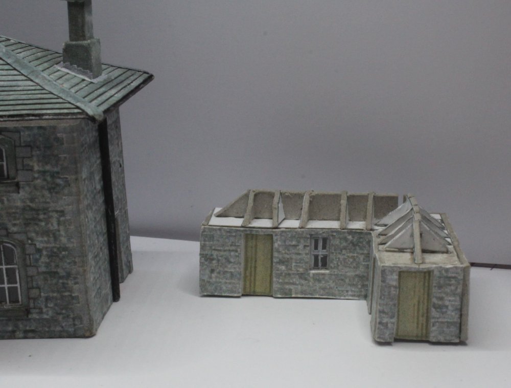

Kevin Sweeney Posted March 15, 2022 Author Posted March 15, 2022 I made some progress, the sheds next to the station, are ready to roof. Time to start thinking about the baseboard and terrain. My main distraction from Ballywillan this week was Bellmont, I'm working on a small Anglican church. 12 Quote

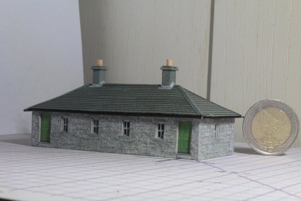

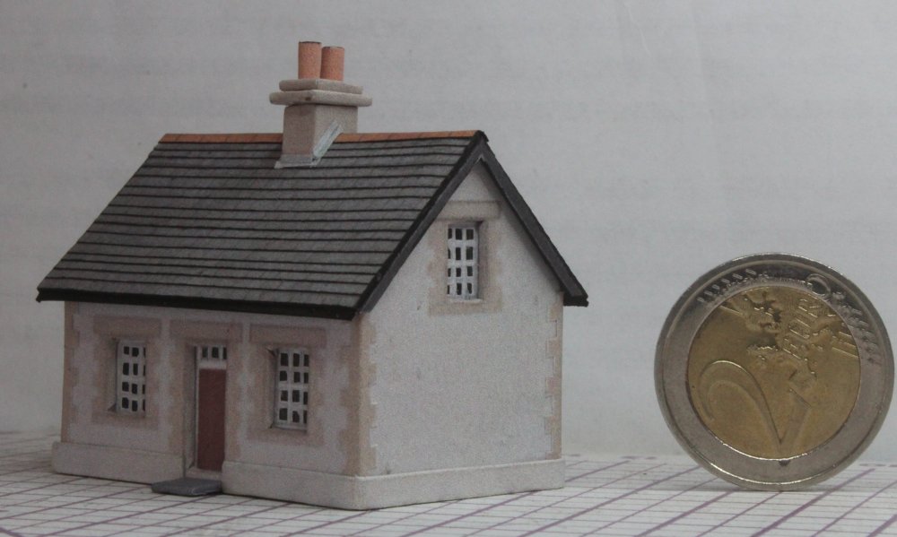

Kevin Sweeney Posted March 28, 2022 Author Posted March 28, 2022 N scale labourers cottage. Again this not for the Ballywillan layout but for the Bellmont layout. All pressure is off for Ballywillan right now, as I've completed all the buildings and I'm waiting for summer to take the photos for the backscene. So I have two months to do the baseboard and scenery. In the mean time I can keep doing new buildings for Bellmont. I'm working now on a Glebe House and farmyard. 10 2 Quote
Northroader Posted March 28, 2022 Posted March 28, 2022 Just room enough for a tidy layout in that second bedroom upstairs. 1 Quote

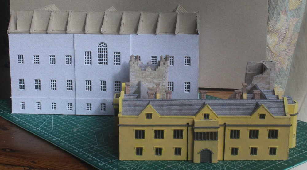

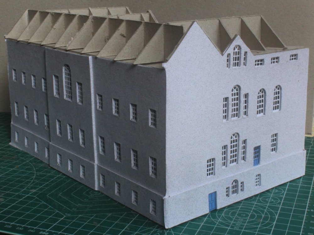

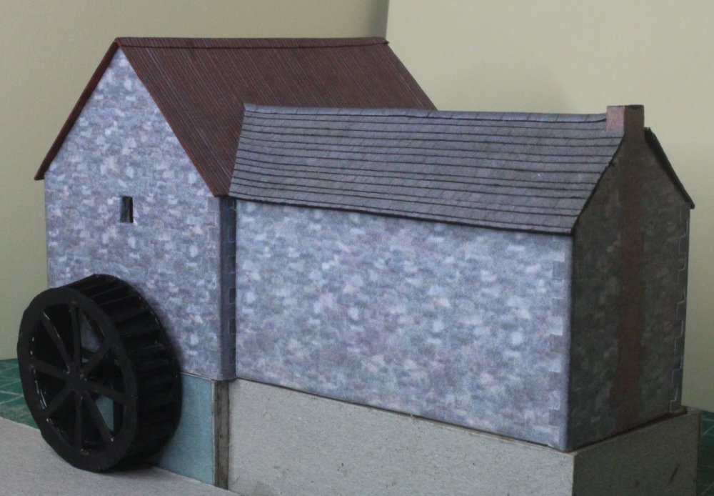

Kevin Sweeney Posted April 22, 2022 Author Posted April 22, 2022 After a break of several weeks working in the garden, I'm back doing some modelling again. Still waiting for the leaves to come out to do the back drop for Ballywillan, but will start on the base board in the next few days. In the mean time I working on some more buildings for my Bellmont layout. This is my progress so far on the mill, which is a model of Ballyheelan mill, in Co Cavan. 7 1 Quote
2996 Victor Posted April 22, 2022 Posted April 22, 2022 Just been catching up with this: absolutely amazing architectural modelling! Please keep the pictures coming Cheers, Mark 1 Quote
