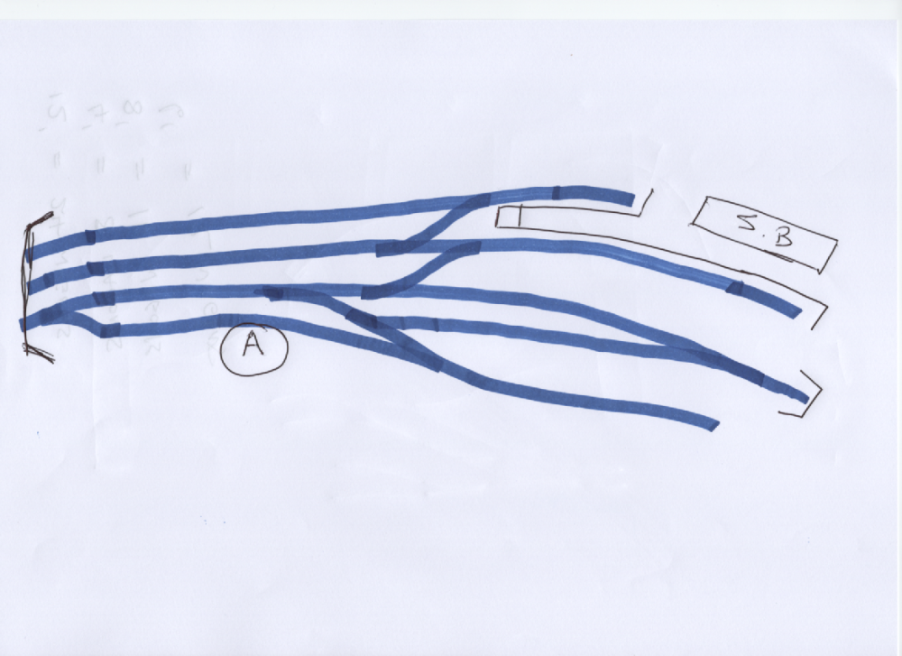

David Holman Posted January 6, 2023 Posted January 6, 2023 Welcome to Irish 7mm scale, as I keep saying - the water is lovely! Overall, 10-12 feet is about the minimum for a terminus fiddle yard set up. Northport Quay is 7'6 of scenics, indicating 30" train length. You can get away with less if you use the fiddle yard as the entry cross over, as per several of Iain Rice's designs. Check out the Alphagraphix website for cheap ( proper Irish) wagon kits and more. The loco kits are designed for 32mm gauge as well. Think you are right to stick to freight only - coaches take up a lot of room and if you enjoy shunting, then 7mm scale is much easier and more fun. Enjoy the new toys and keep us posted! 5 1 Quote

Lambeg man Posted January 6, 2023 Author Posted January 6, 2023 3 hours ago, David Holman said: Overall, 10-12 feet is about the minimum for a terminus fiddle yard set up. Northport Quay is 7'6 of scenics, indicating 30" train length. You can get away with less if you use the fiddle yard as the entry cross over, as per several of Iain Rice's designs. Hi David, Thank you for that. Below is a rough sketch of what I have in mind. 12' between the scenic breaks. It can not be seen in the photo, but the 1931 OS map shows there was a bay platform at Queens Bridge with a spur line running off it back and under the Albert Bridge. The three 4' x 2' main boards are already built and I envisage providing hidden sidings on 4' long narrow hinged end sections at both ends to allow through running. 7 1 Quote

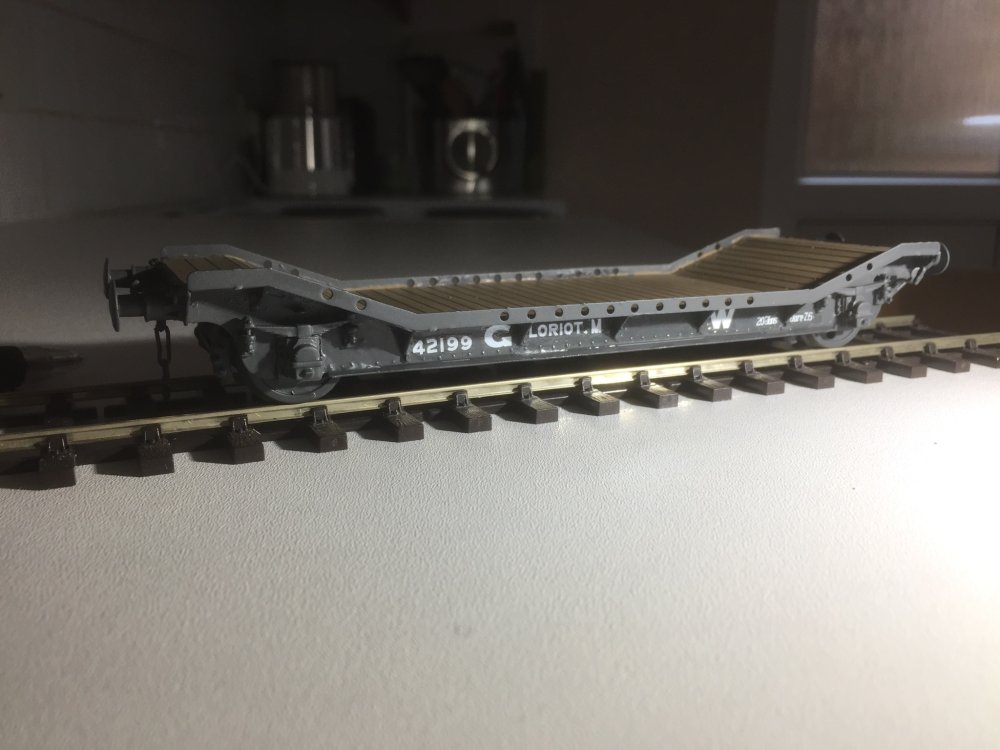

Galteemore Posted January 7, 2023 Posted January 7, 2023 (edited) We all have to start somewhere Steve. I built my first O gauge wagon five years ago - plastic kit. It rocked on 3 wheels - always build on a sheet of glass I then built this brass GW wagon kit as a starter in metalwork - loads of mistakes but in brass you can always fix stuff that would have to be thrown away in plastic. I know I’d really struggle to make an Airfix kit well…..this metal stuff is nowhere near as difficult as it seems- trust me!! Edited January 7, 2023 by Galteemore 3 2 Quote

Lambeg man Posted January 7, 2023 Author Posted January 7, 2023 (edited) Okay, back to the thread. So I hit on the idea of Queens Bridge based on one photograph and then started more serious digging. Queens Bridge passenger station was completed in 1871, but was not brought into use until 1875. It served a double track line from Ulster (later Central) Junction until 1879 when the 'Tunnel' was punched through the site. Passenger services ceased in 1885 when the GNR(I) bought the Belfast Central Railway. Thereafter Queens Bridge was a goods only station. The 1931 OS map already referred to is 'mushy' when trying to work out the actual point work in the vicinity of this station. Bearing in mind this all started with "Where would No. 19 look at home", the previously posted track plan was one of my own imagination really. On reflection, it would not be the best idea for providing 'shunting' within the 12' scenic section as the crossovers were at the ends. Tonight I found a J. Macarrenty Roobins photo on the IRRS website. Based on it I can produce this rough diagram of what the actual trackwork was in the late 1940's. Best of all, the crossovers will be roughly in the middle of the proposed 12' scenic section. The same photo shows the old passenger station platform full of goods vans and the area marked 'A' on diagram is seen to be covered in either sand or cement dust. However, no view of the Goods shed. Was it gone post 1948? So this what I will probably aim at rather than the previously posted layout. Edited January 8, 2023 by Lambeg man 7 1 Quote
