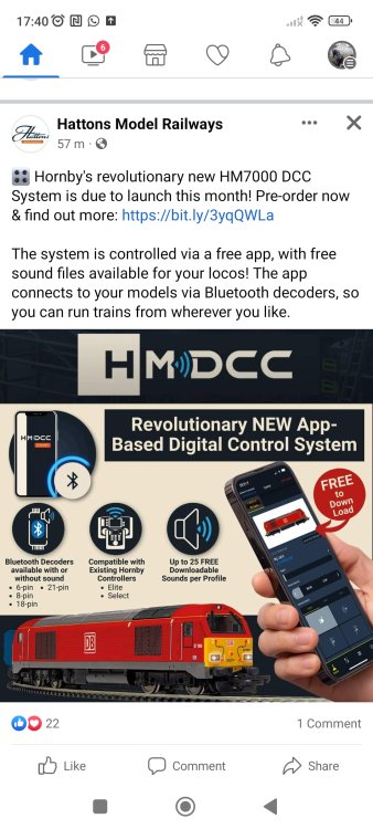

Gabhal Luimnigh Posted March 9, 2023 Posted March 9, 2023 Might be the beginning of the end for the ridiculously expensive sound chips. 1 5
DJ Dangerous Posted March 9, 2023 Posted March 9, 2023 The link: https://www.hattons.co.uk/stocklist/siteresults?searchfield=HM7000 3
Sean Posted March 9, 2023 Posted March 9, 2023 Ive been watching these for a little while and the euvirail review perfectly sums up how i feel about the current state of DCC sound. the only downside is that from what i have seen so far there does not seem to be any USA diesel sounds available so were very limited to what irish trains it will suit. another option ive been looking at for a while; https://soundtraxx.com/products/econami-digital-sound-decoders/eco-21pnem/ These should work out a lot cheaper but by the time you add in shipping and customs you are almost at the price of a loksound anyway so they are hard to justify. Hopefully it is a good thing in the long run but being a hornby DCC product who knows 2
Blaine Posted March 10, 2023 Posted March 10, 2023 Its Hornby who have a rather poor reputation as a manufacturer of DCC equipment. The Roco Z21 system offers phone/app control and is a far better system overall. Hornby is a rapidly diminishing brandname now 2

Dave Dawes Posted March 15, 2023 Posted March 15, 2023 On 9/3/2023 at 6:01 PM, DJ Dangerous said: The link: https://www.hattons.co.uk/stocklist/siteresults?searchfield=HM7000 Soundtraxx are also going down this route. It could be good as DCC has lagged behind in tech. Just need a decent Bluetooth connection . Also wouldn't need a base unit just 12 to 16 volts going to the track 1
Noel Posted March 15, 2023 Posted March 15, 2023 Problem is modelling railways set in Ireland means almost exclusive use of diesel locos, therefore prime movers for GM/EMD diesel engines employed in 12,141,181,071 and 201, and Irish diesel loco horns, none of the Hornby nor budget US sound decoders facilitate this combination. Unfortunately perhaps not a game changer. In the mean time purchase ESU decoders direct from Germany for €95 and upload free diesel sound projects onto them using a LokProgrammer rather than paying €120 for a pre-programmed ESU decoder. Its not rocket science. I don't see the benefit of bluetooth for control data comms, when through track works just as well and offers almost wire free control of DCC accessory decoders for point control, signals, etc, rather than having to buy bluetooth hardware accessories. A game changer with be an ESU LokSound quality decoder selling for €50 with an open NMRA compliant standards for programming and integration. Vanilla sound projects just don't cut it for Irish Diesel locos, perhaps 260 and 460, and 060 steam locos assuming half decent whilst sounds might get away with it. 1
