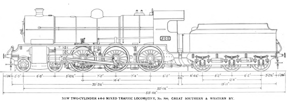

jhb171achill Posted March 12, 2023 Share Posted March 12, 2023 (edited) A much-neglected, but superb locomotive. Scratch-build, anyone? From a 1924 edition of the Railway Engineer magazine. Edited March 12, 2023 by jhb171achill 7 1 Quote Link to comment Share on other sites More sharing options...
Mayner Posted March 13, 2023 Share Posted March 13, 2023 The 500 Class were one of the first successful classes of modern Mixed Traffic 4-6-0s in the British Isles the nearest preceding the much larger GWR Hall and LMS Black 5 Classes. The 500 Class cylinder and valve gear arrangement was used as the prototype for re-building 40o Class from a 4 to a 2 cylinder loco, unfortunately only 402 received the full rebuild with new-frames and 500 Class motion on the grounds of cost. Although it was apparently planned to build further members of the Class, Inchacore only built three 500 Class 4-6-0s, the purchase of an additional 16 sets of parts from Woolwich Arsenal was a much cheaper option. Probabably have to be a scratchbuild, there is unlikely to be enough demand for a rtr model or a kit of a relatively small obscure class that had all gone by the mid-1950s 4 1 Quote Link to comment Share on other sites More sharing options...
Galteemore Posted March 13, 2023 Share Posted March 13, 2023 The class gets an honourable mention in ‘A Decade of Steam’ - Driver Bill McDonnell says that a 500 was in especial demand for heavy passenger specials and they were his favourite CIE class. Once a 500 had lifted a train to 50-60mph, ‘she could lope along on a whisper’. 2 Quote Link to comment Share on other sites More sharing options...

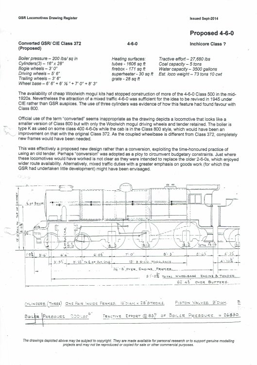

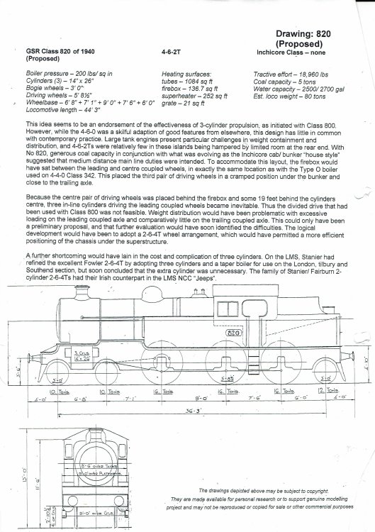

Mayner Posted March 17, 2023 Share Posted March 17, 2023 The GSR developed a obsession with 3 cylinder locos during the late 30s early 40 including a "rebuild" of Woolwich Moguls as a 3 cylinder 4-6-0 and a 4-6-2T for the Kerry Road. The 372 Class rebuilds may have been intended for the Midland, where the Woolwich were overloaded on Dublin-Galway Passenger/Mail trains. The rebuilds were intended to combine a 400 Class boiler with Woolwich driving wheels & 800 class motion the Irish equivalent of a "Baby Scott" the 3 cylinder drive would have been less severe on the track than the 2 cylinder Woolwich and 400 Class rebuilds. The 820s were based on the boiler used in the Rosslare "Bogie" 4-4-0s and in a way is an update of an early GSR proposal for an outside cylinder 4-4-2T for the South Easter with an additional set of driving wheels. There was little or no prospect for the development of new steam classes after the Emergency the CIE Chairman quickly convinced the Board that dieselisation was the way forward. The First Diesel programme included proposals for a luxury "Diesel Tourist Train" to promote Ireland as a tourist destination and a single ended diesel not unlike an American A unit, the First Diesel programme failed because the UK manufacturers did not have the capability to take on the CIE order in the immediate post war era, CIE instead ordering engines and electrical equipment for 5 Diesel Electric shunting locos with Mirrlees engines and Brush Electric Equipment, 2 Mixed Traffic diesel electric locos with Sulzer engines and Metropolitan Vickers Electric Equipment and 6 Large Diesel Electric Locos for Kingsbridge-Cork services powered by two Sulzer Engines with Metropolitan Vickers Electrical Equipment. The CIE Chairman was forced to resign and the order for the 6 large diesel electric was cancelled as a result of political pressure, the engines and power units were stored and later used in the B101 Class possibly the most reliable and useful of the CIE 'modernisation era' classes of main line diesel locos. 5 Quote Link to comment Share on other sites More sharing options...

Galteemore Posted May 13, 2023 Share Posted May 13, 2023 Easily capable of 70 mph according to Donaldson. Bogie wheels 3’, drivers 5’8.5”. Loco length 37’, 1.25”. Wheel base 6’8, 5’10.5, 7, 7’4. Tractive effort 23780 lbs. 1 Quote Link to comment Share on other sites More sharing options...

Mayner Posted May 13, 2023 Share Posted May 13, 2023 Apart from the outside Walschaerts valve gear a 500 Class would be a relatively simple scratchbuilding project. Plenty of room for a large can motor and gearbox simple geometric shapes no pesky curving running boards and crankpin splashers that make 19th Century locos so challenging to build. Building a rake of matching GSWR/GSR 1920s side corridor coaches used on trains like the "American Mails" and "Tourist Train" in GSR days would be more challenging, though SSM produce very nice kits of the GSR Bredin coaches used on the "Steel Train" during the 1930, strictly speaking the forthcoming Park Royals are too modern 500 and 501 were withdrawn in 1955, 502 was withdrawn in 1957. 3 Quote Link to comment Share on other sites More sharing options...
Colin R Posted May 14, 2023 Share Posted May 14, 2023 5 hours ago, Mayner said: Apart from the outside Walschaert's valve gear a 500 Class would be a relatively simple scratchbuilding project. Plenty of room for a large can motor and gearbox simple geometric shapes no pesky curving running boards and crankpin splashers that make 19th Century locos so challenging to build. Building a rake of matching GSWR/GSR 1920s side corridor coaches used on trains like the "American Mails" and "Tourist Train" in GSR days would be more challenging, though SSM produce very nice kits of the GSR Bredin coaches used on the "Steel Train" during the 1930, strictly speaking the forthcoming Park Royals are too modern 500 and 501 were withdrawn in 1955, 502 was withdrawn in 1957. Hi John do you of anyone producing an etched Walschaert's valve gear suitable for the 500 class? Colin Quote Link to comment Share on other sites More sharing options...
Horsetan Posted May 14, 2023 Share Posted May 14, 2023 (edited) 4 hours ago, Colin R said: .....anyone producing an etched Walschaert's valve gear suitable for the 500 class? You'd have to mix and match. The 7' x 7'4" wheelbase is slightly unusual but I think Alan Gibson Workshop produces a set of etched coupling rods for that wheelbase. Even if not, AGW also produces a universal set of coupling rods that you can trim and adjust to obtain 7' x 7'4". A similar, if slightly more developed, universal etch is available from Lanarkshire Model Supplies. For the connecting rods and valve gear, AGW has about ten different types of Walschaerts valve gear etch for various British classes including the S15. The important one is that the connecting rods should come out at a scale 11' (44mm) between little end and big end centres. It's a matter of trying to work out which one needs least modification. You may end up using more than one etch to cobble the various other rods together. Edited May 14, 2023 by Horsetan 1 Quote Link to comment Share on other sites More sharing options...
Colin R Posted May 14, 2023 Share Posted May 14, 2023 3 hours ago, Horsetan said: You'd have to mix and match. The 7' x 7'4" wheelbase is slightly unusual but I think Alan Gibson Workshop produces a set of etched coupling rods for that wheelbase. Even if not, AGW also produces a universal set of coupling rods that you can trim and adjust to obtain 7' x 7'4". A similar, if slightly more developed, universal etch is available from Lanarkshire Model Supplies. For the connecting rods and valve gear, AGW has about ten different types of Walschaerts valve gear etch for various British classes including the S15. The important one is that the connecting rods should come out at a scale 11' (44mm) between little end and big end centres. It's a matter of trying to work out which one needs least modification. You may end up using more than one etch to cobble the various other rods together. What can possible go wrong then Quote Link to comment Share on other sites More sharing options...
