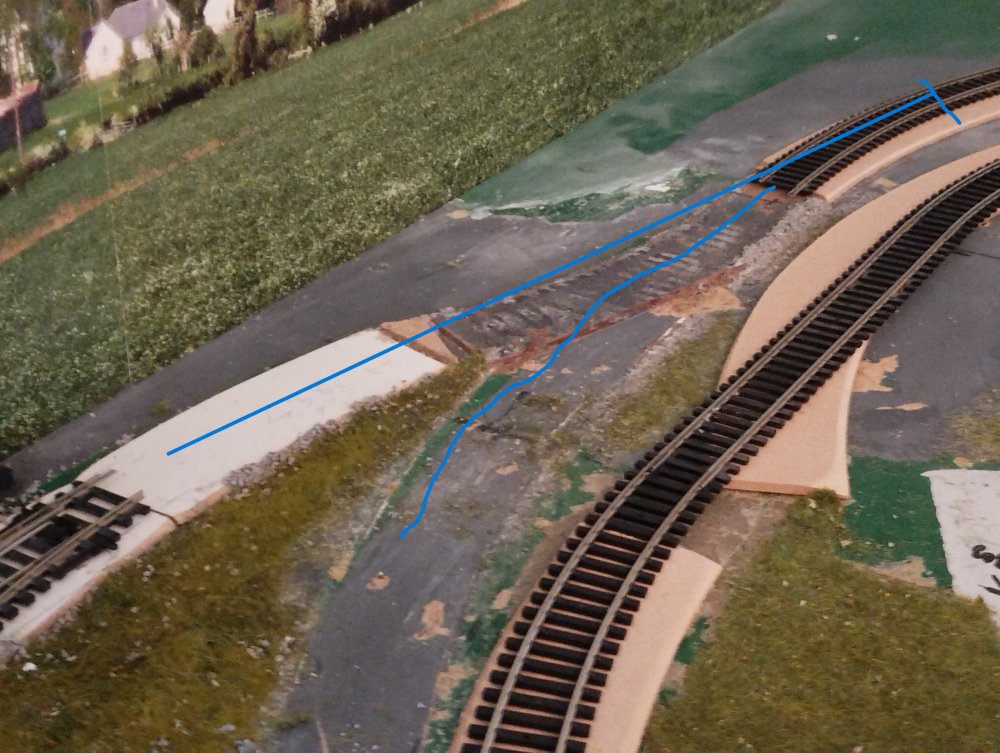

derek Posted October 30, 2023 Author Posted October 30, 2023 (edited) 26 minutes ago, Broithe said: You could end the bend a few inches earlier and then have long single bend to approach the points. Think I will just go with extending the straight before the bend, (as explained badly above) and then just have a straight from the bend to the points. Edited October 30, 2023 by derek 1 Quote
derek Posted October 30, 2023 Author Posted October 30, 2023 17 minutes ago, DJ Dangerous said: Is there any way of building in a large radius curved point, having a crossover before that, then having two shallower curves like this? Excuse the crudeness but I'm not the best digital artist. The inside curve wont be joining the points. It will just loop back around as it is now. The problem is with the outer bend. I think I am resigned to the solution I explained. Seems simplest now. Thanks for all the suggestions lads. 1 Quote
amdaley Posted November 1, 2023 Posted November 1, 2023 On 30/10/2023 at 1:00 PM, derek said: I think I might have to do just that. Problem is I had planned another S bend in the goods yard. I tried the procedure with an S bend 3rd radius track and it went fine, so I might use that in the yard. Cant do it on the outer loop though as I dont have the space. Think I will extend the straight section before the curve, thereby letting me connect with a straight track to the points. Confused ?. I am confusing myself. Pics might make it a bit clearer. Its still very annoying that the wagons wont run over the 2nd radius S bend though. Especially after pulling up the old layout because of derailing problems. Sigh...... Modern stuff being engineered too finely in my humble opinion. Older stock never seemed to present these kind of problems. Hi Derek. What you could do is put a left hand point where I have marked on the photo. That would eliminate the s bend. 2 Quote

derek Posted November 1, 2023 Author Posted November 1, 2023 6 hours ago, amdaley said: Hi Derek. What you could do is put a left hand point where I have marked on the photo. That would eliminate the s bend. Thanks Tony, but the problem with a points is that I will be replacing the tunnel I removed during my wrecking ball phase. And a points in a tunnel is just asking for trouble. Thanks again 7 minutes ago, DJ Dangerous said: You have @leslie10646's new wagons already??? Sure do. I also got 2 cattle wagon kits and a brake van kit. Busy busy. 4 1 Quote

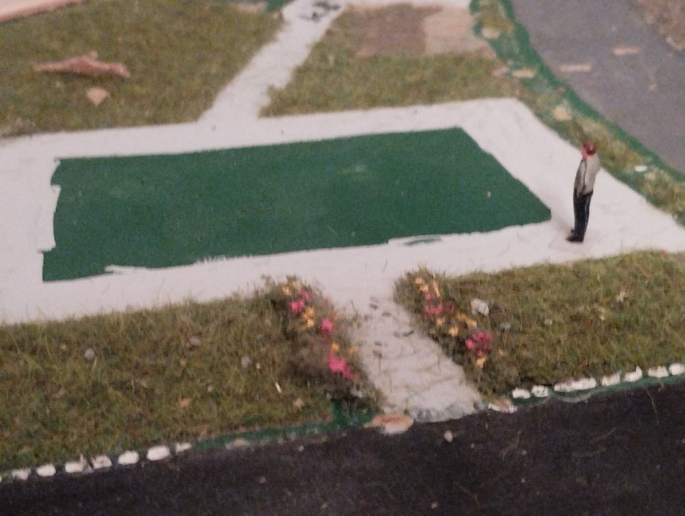

derek Posted November 1, 2023 Author Posted November 1, 2023 This guy arrived home to find his house gone! Fell victim to progress. Flowers are still there though. 2 Quote

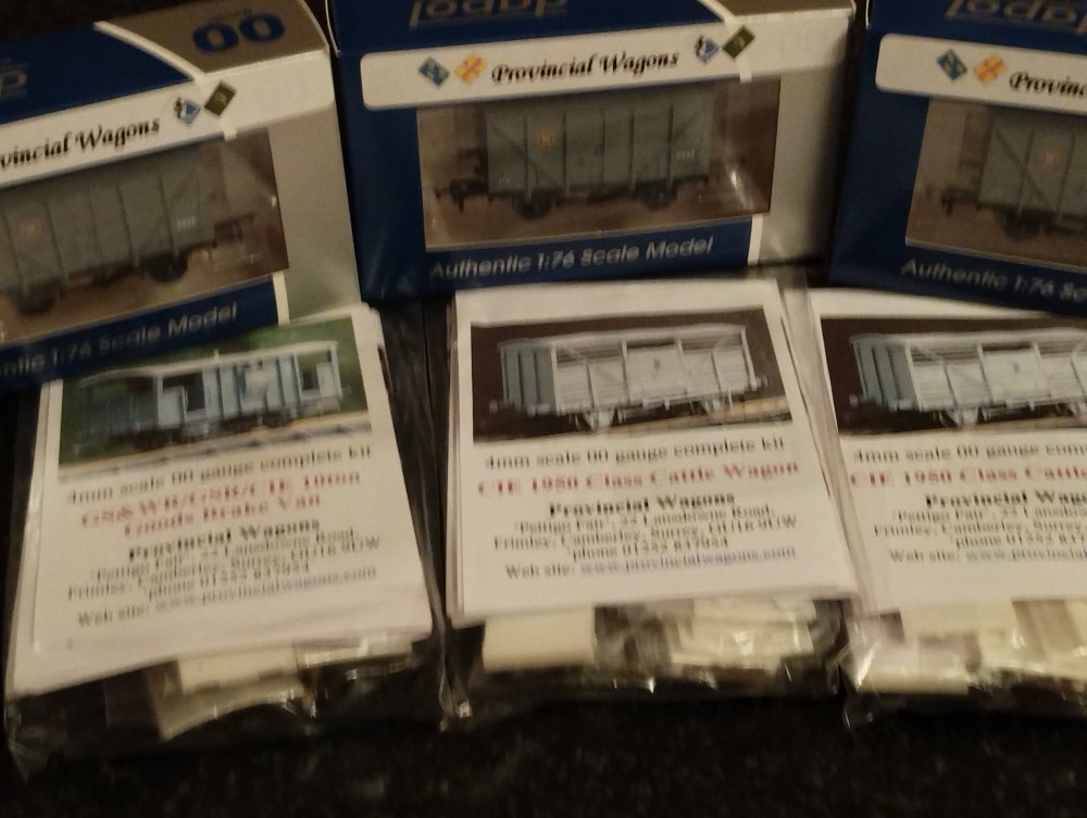

DJ Dangerous Posted November 1, 2023 Posted November 1, 2023 49 minutes ago, derek said: Thanks Tony, but the problem with a points is that I will be replacing the tunnel I removed during my wrecking ball phase. And a points in a tunnel is just asking for trouble. Thanks again Sure do. I also got 2 cattle wagon kits and a brake van kit. Busy busy. Mine are still up in Spain, waiting for Customs to let them through. Probably be a few weeks before they get here. Jeez. And who did you shoot near the end of the video? Quote

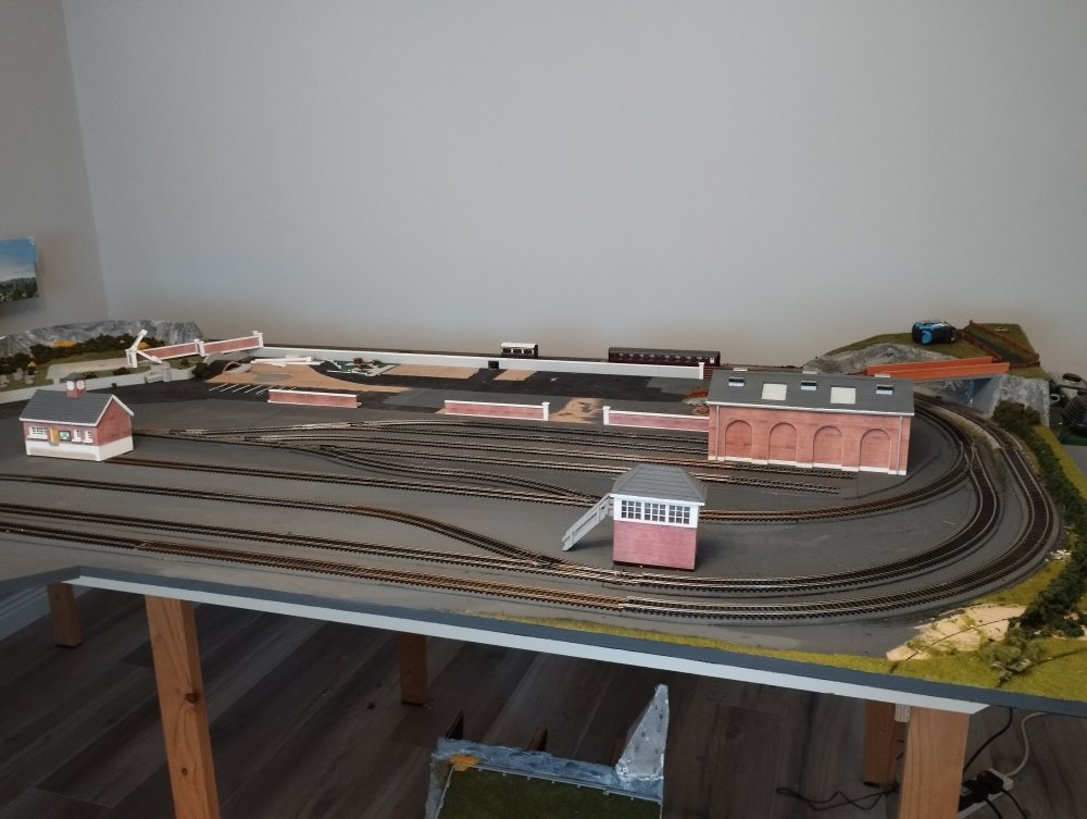

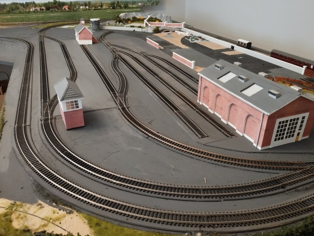

derek Posted November 19, 2023 Author Posted November 19, 2023 Layout looking a bit more civilized at last. Track "underlay" fixed down and the board painted the obligatory grey. The track is just laid loosely in place ahead of sticking down and the dreaded ballasting. Think I will "rustify" the track before sticking down this time. Bit of a pain to do after its in place. I have also put in a few of the old station buildings to give some perspective on what I am planning. Have to rejig the tunnel that was in the corner too. The old facings wont work with the new track radii. Busy busy.... 10 Quote

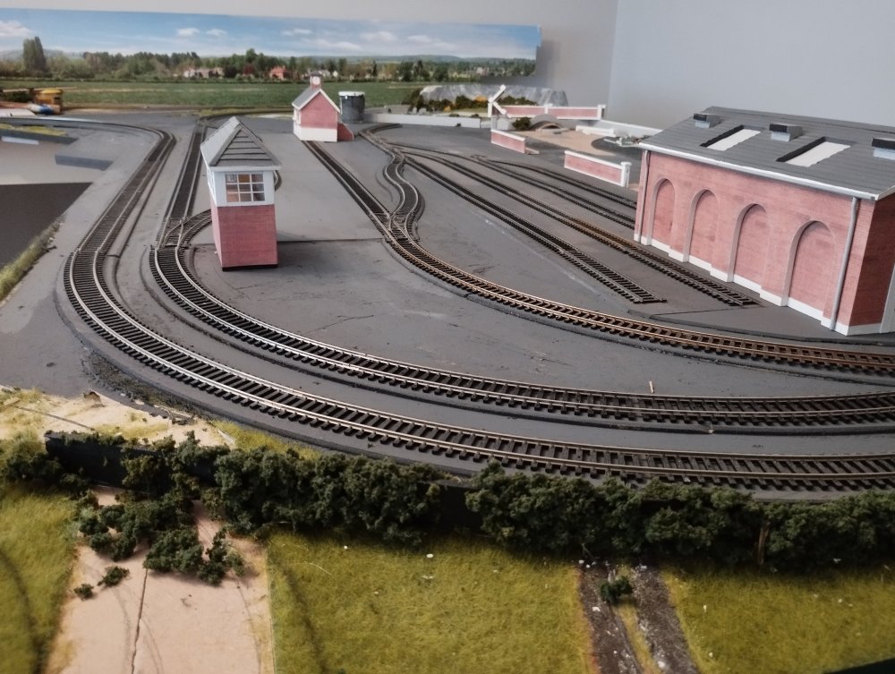

derek Posted December 3, 2023 Author Posted December 3, 2023 Bit the bullet and started ballasting during the week. Outside loop is pretty much done, just need to fill in a few spots where the ballast didn't take to the double sided tape. "Rusted" up the rails as well before sticking down. God I hate ballasting. Also, I used Woodland Scenics markers to rustify the track. Easy to use but they really need to supply more than two tips with each marker. The two I got with the last order are in bits even though the marker still feels half full of paint/ink. Or else they need to make the tips more hard wearing. Gonna have to order more just to get the fresh tips. End of rant 9 Quote

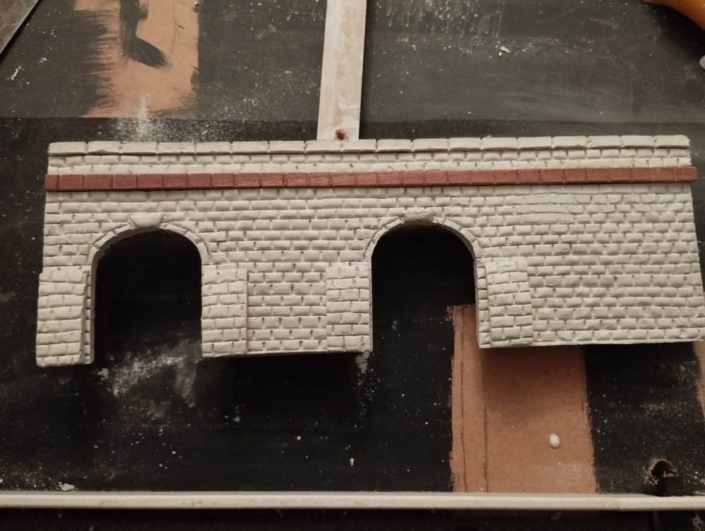

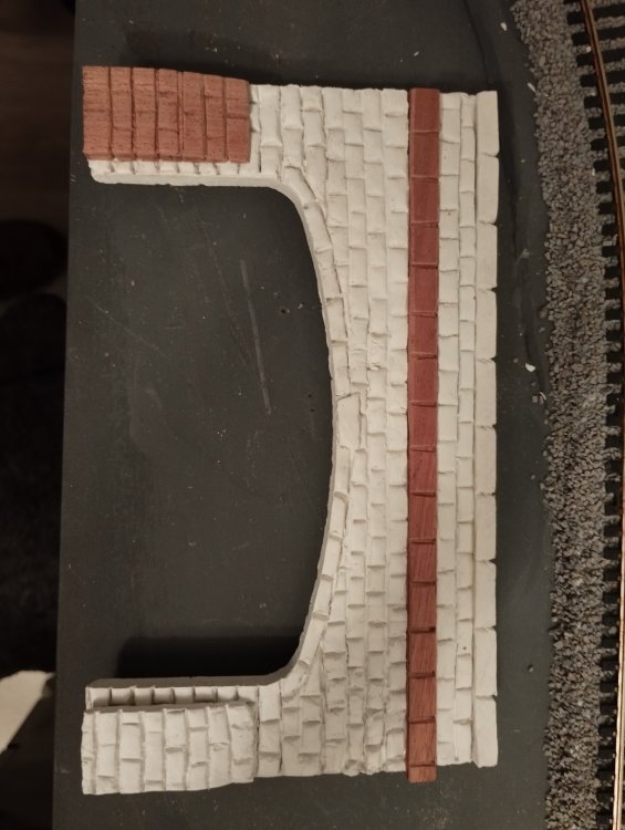

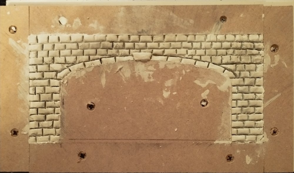

derek Posted December 9, 2023 Author Posted December 9, 2023 Took a break from the bloody ballasting and made a start on the new tunnel facings. Made these two templates and have one filled with Das clay and "stones" lined in. Much more enjoyable, I have to say. 8 Quote

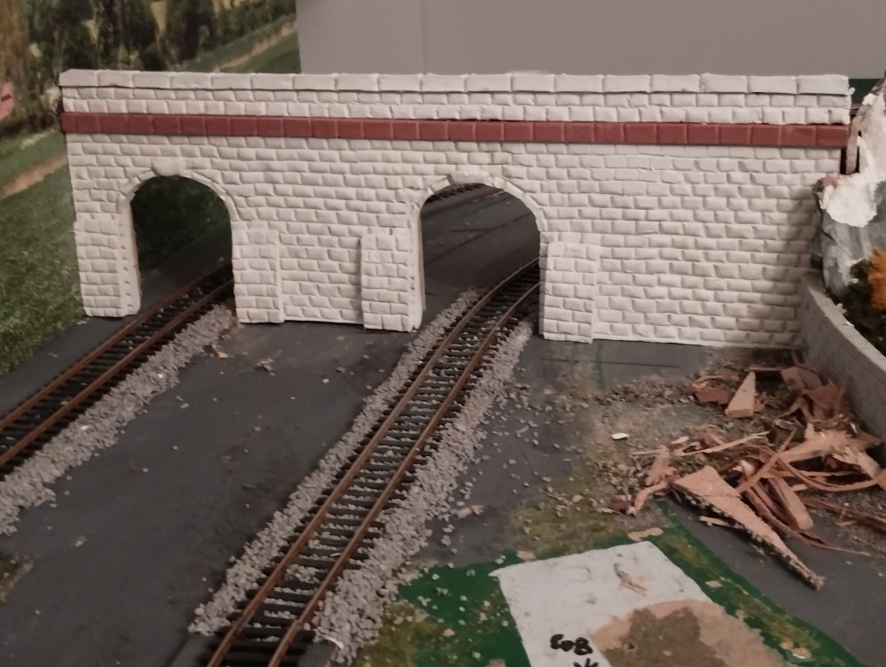

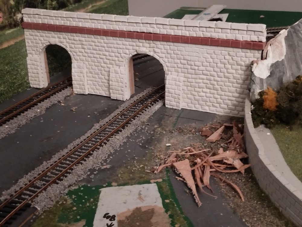

derek Posted December 20, 2023 Author Posted December 20, 2023 The tunnel facings are coming along. @David Holman has nothing to worry about so far. There is going to be a LOT of filling, sanding and then rinse and repeat. Ah they will look fine when the twenty foot viewing rule is applied (or should that be two feet?) I ran out of DAS just at the critical moment, so I had to resort to shaping a couple pieces of mahogany. Its why God invented paint. Should be ok hopefully. 9 1 1 Quote
