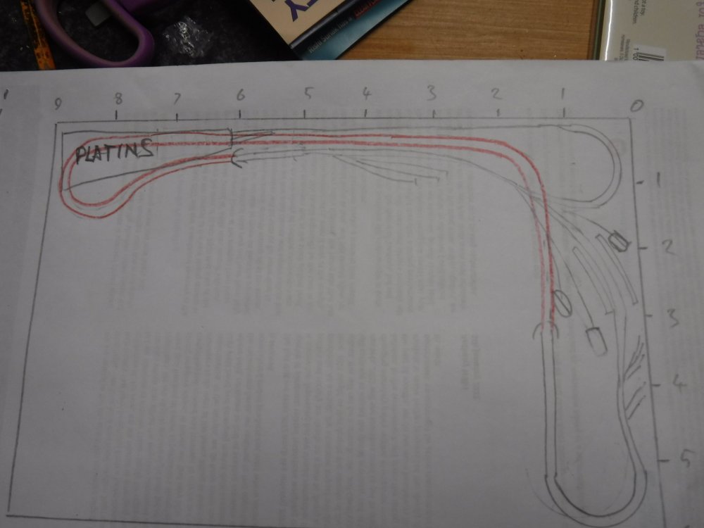

Layout plans
Here is what yous have been looking for. This is a dream layout, where storage for the layout and skill to model it is in abundance ( I wish ) . This is a rough plan but shows the main idea
The layout will be made up of a double oval which will represent the Up and Down of the Belfast line. The layout will be broken in two main segments: 1) MacBride station 2) Platin cement factory
I had made track plans for both using Any Rail software and have saved photos from 1990s which ill attach in the next comment to prevent this being one majorly long text
Please feel free to give your Comments, opinions and  recommendations as I keep yous updated on creating Drogeheda MacBride and Platin

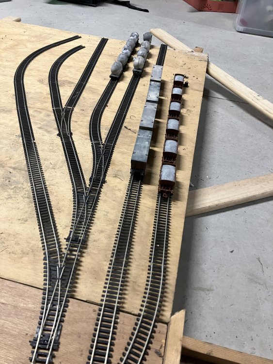

Below is attached my track plans of the above photos. 1) A general track plan 2) The names of each of the sidings which I was informed by a Form Loco driver and colleague of Dad 3) Any rail plans
Please excuse my Bad handwriting, Here is a plan view of Platin and the loading roads. I am aware in the real life platin there is slight curve to the  right but it was just easy to draw straight lines
Platin Cement Works near Drogheda
As you can see from my second diagram and the photo above, each type of wagon had its place in Platin. The pallet cement were on the left hand of the yard that led up to the rolling door of the warehouse. The bulk cement and Bogie bulkers generally were on loading roads underneath the cement Silo  the gypsum was kept on the right in two sidings (the second one is kind of hid by the rockface to the right )

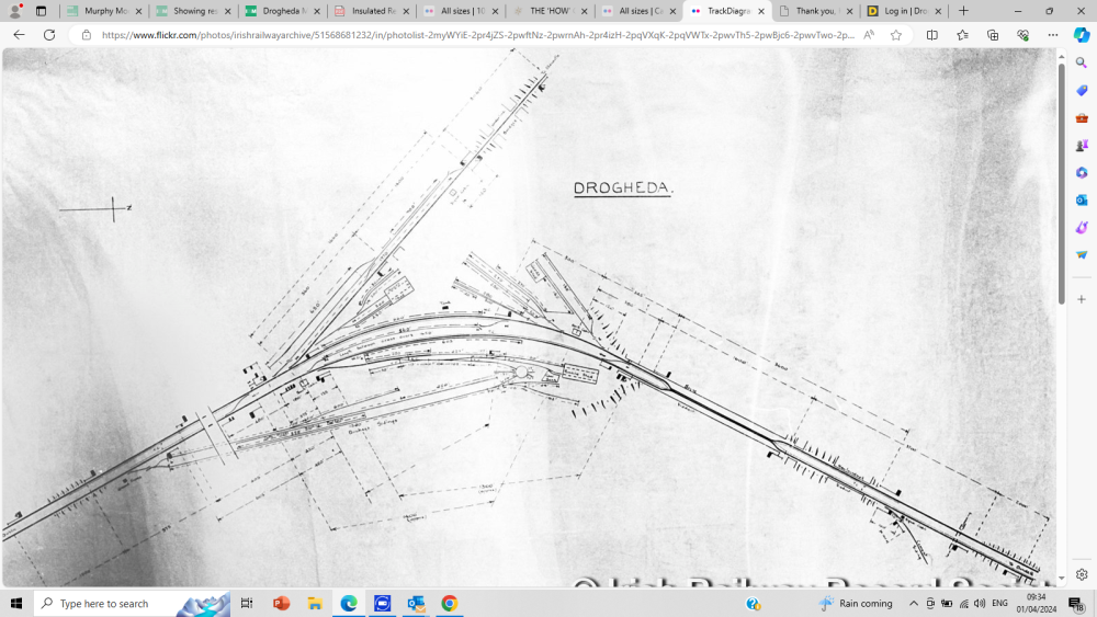

You have probably seen this track plan on the IRRS website, but just in case...  Another source for the original layout is the Ordinance Survey website OSI.ie

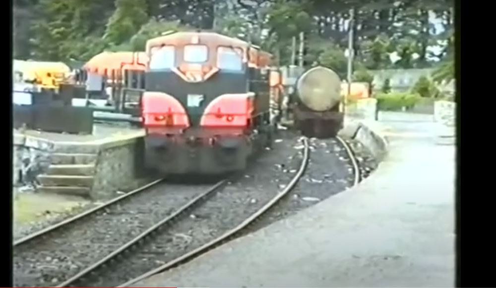

Its the 3 road sidings in the last diagram that has 13 and 14 labelled on it. The loading bay was made up of very unique 3 way point. This was thankfully captured in the video below in 1995
above is a screen grab of the you tube clip below, you can see that the point goes in 3 directions, Peco were the only model manufacturer who made such a point, but it will cost me a Arm and leg with the point being around 65 euro alone
In the 1990s, this loading dock was home to another oil tank for refullling, aswell as Bullied wagon and a few 20ft flat wagons. 141s seemed to generally parked here as well. Even ore reasons to buy IRMs Oil tankers

On 30/3/2024 at 8:02 PM, derek said:
This looks like it will be fantastic Dave. Best of luck with it. Can I just ask one thing? Your freehand plan looks to be quite deep ( front to back). Without measurements it's hard to tell for sure. My concern would be "reachability". In other words, will you be able to reach all areas of the layout once it is in place. I'm sure you have it all in hand , but thought I would mention it. I speak from experience here, as , since extending my own layout, when working near the tunnel/ church area I have to take to a set of steps with my calf muscles screaming from the strain of stretching. But I am only three and a half foot tall  after all😃 Best of luck again
Thanks very much for all the support Derek 🙌🏻and as well as keeping reachability in mind,last time we want is wagons detailing and can’t be accessed or pulled calf of hamstring muscles 😂😂
whenever I get a new base board,the plan would be to have two main base boards separated in the middle but they would be connected with a narrow channel  at the bottom (basically like a U shape). the double loop of the mainline and Macbride station on one and platin on the other baseboard ,with the navan branch line connecting them.
i will draw a diagram up of it soon.
Many thanks 🙌🏻
Thanks very much for sharing this, I actually haven’t seen this diagram before, is it on there Flickr website ?
I’ll go have a look at it now,thanks 😀
Yes on Flickr. Put in "Drogheda" on the search and the track diagram will come up along with many useful photos. I'm doing something similar to you with Castlebellingham. Unfortunately only the platforms remain but using photos and taking measurements of the station house in Dunleer I have a reasonably good representation under way. I remember the station well from my youth when trains were still stopping there, and like you it brings memories of my own father. I'm just finishing the Castlebellingham signal box at the moment. You are fortunate that most of Drogheda station is unchanged. You will get great satisfaction from constructing your project and even more by running your rolling stock.  Keep us all up to date with your progress as there is huge interest and help out there.

A layout combining Drogheda station, Buckleys Siding and Platin is very ambitious for a first layout, on the plus side a lot of the locos and stock are available or announced in ready to run form, the challenge is likely to be fitting a workable layout into the available space and considering train length and degree of compression to achieve a workable layout particularly if your focused on prototypical train working.
The other thing to consider is that apart from a double track continuous run or some degree of automation we can only control/drive one loco at a time, during solo operation you could become fully occupied shunting wagons in and out of the wagon-repair shop at the old loco depot and you don't have the time of inclination to shunt Buckley's sidings, or simply time to run the layout.
It might be worth contacting the Model Railway Society of Ireland.  The society built and exhibited a OO Gauge model of Drogheda which included the station and viaduct which was one of the clubs principal exhibition layouts during late late 80s/90s. Its possible that some of the buildings and structures may exist.

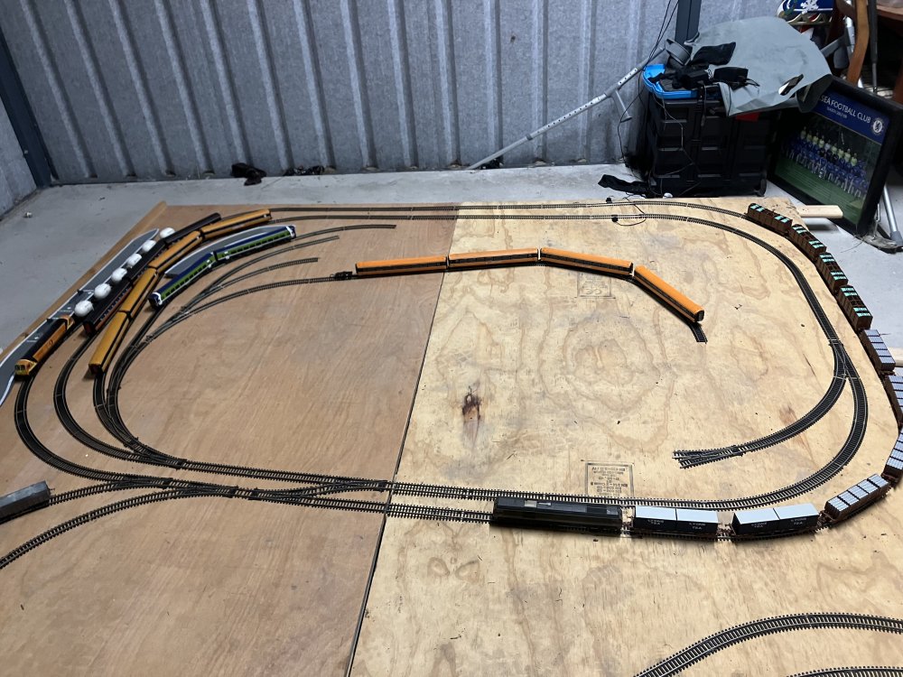

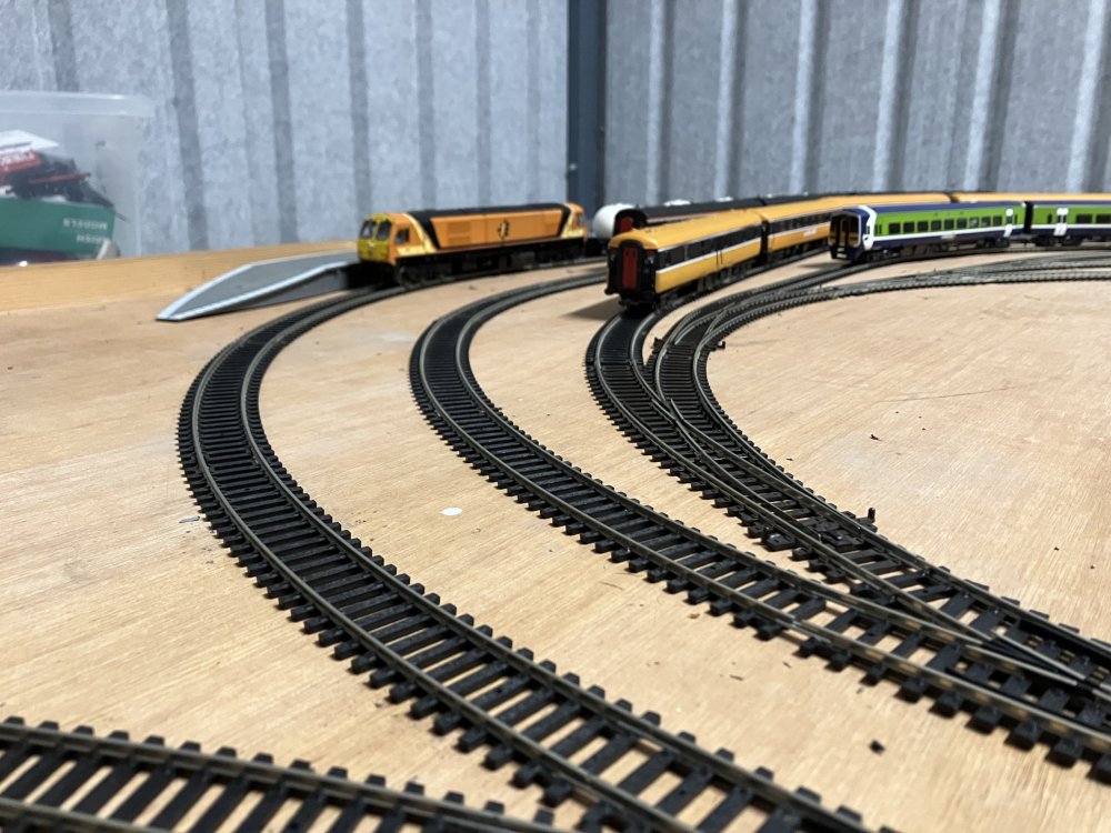

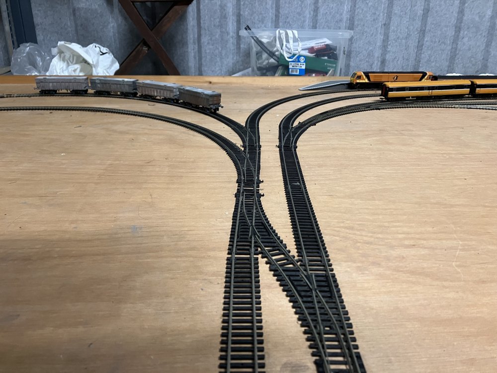

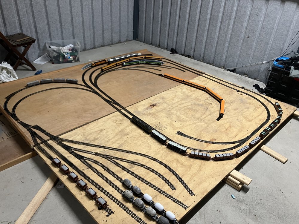

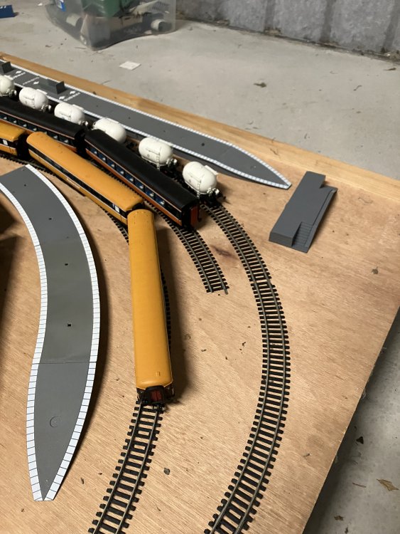

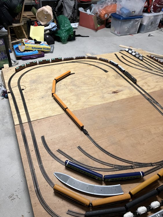

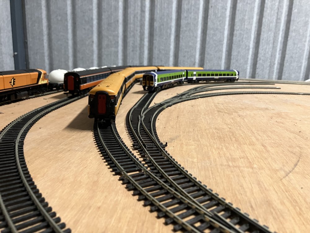

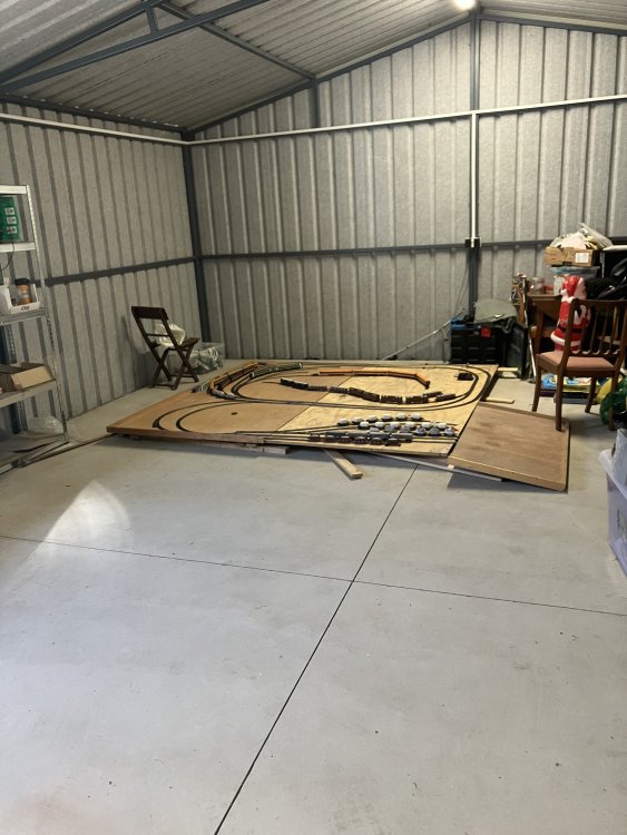

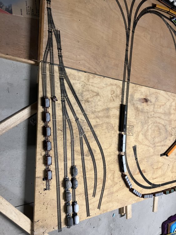

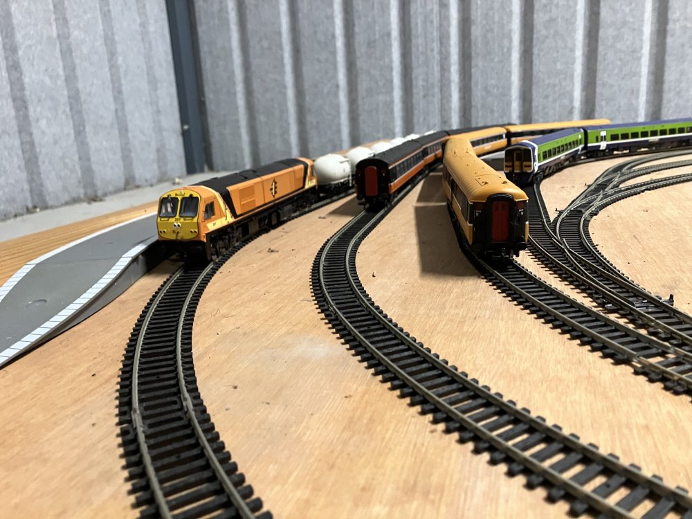

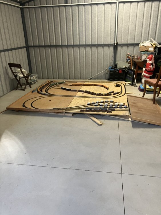

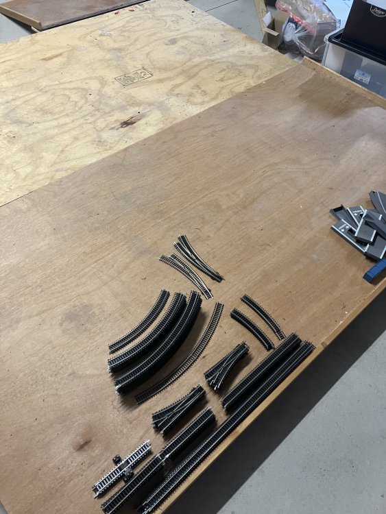

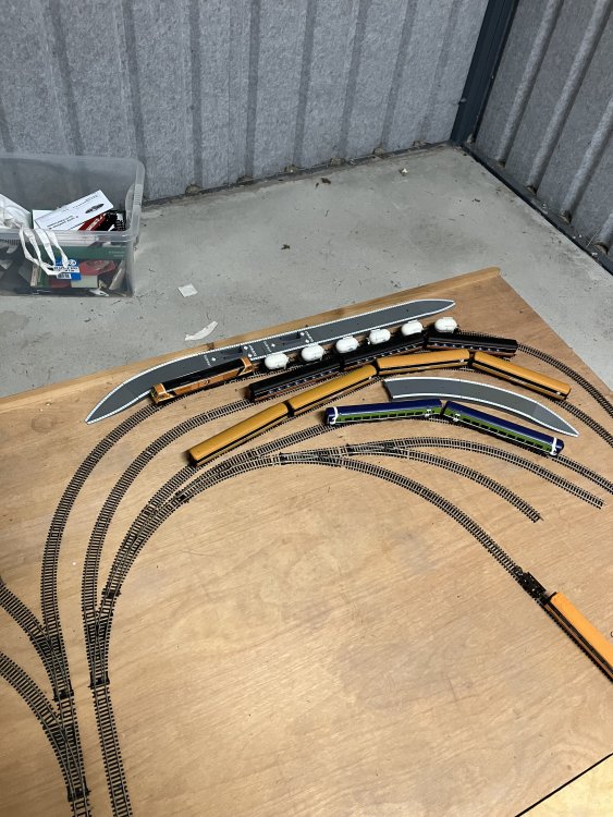

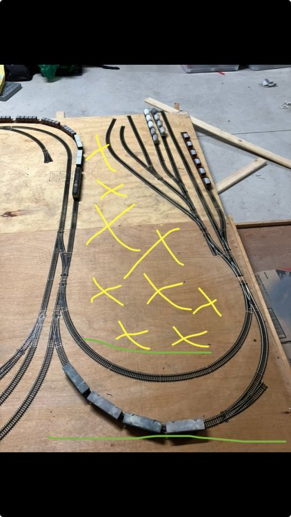

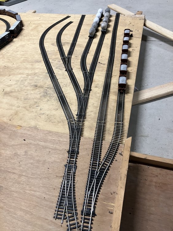

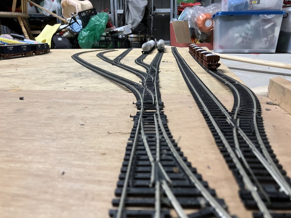

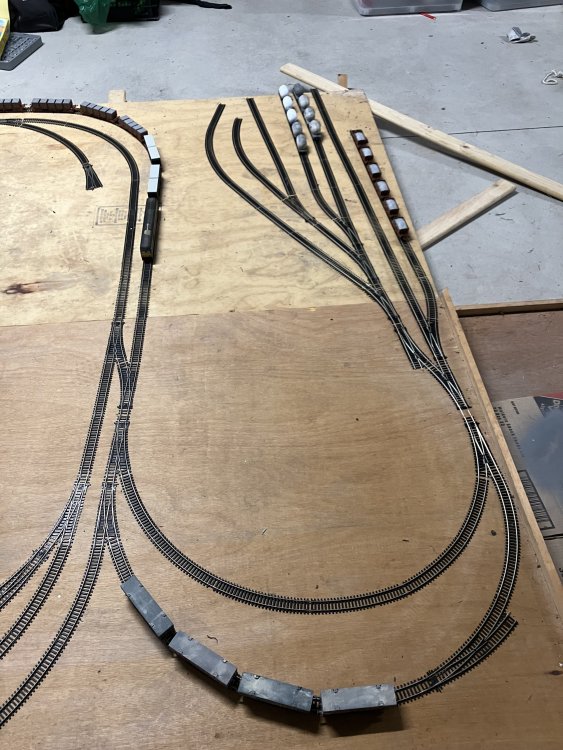

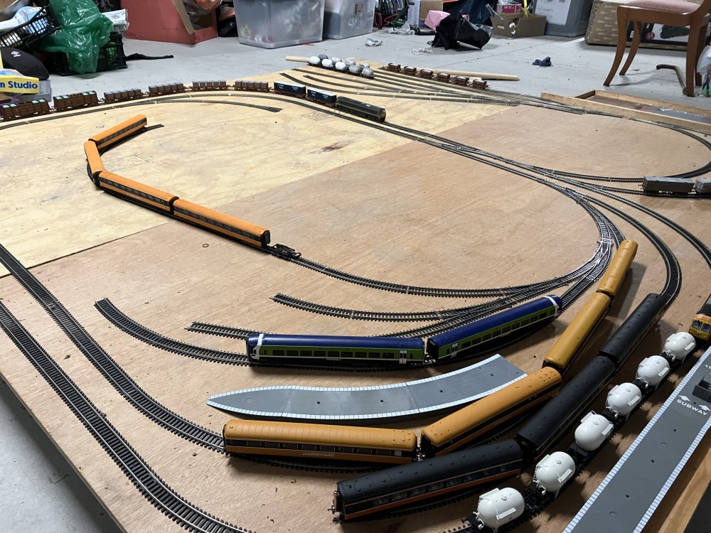

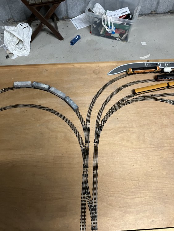

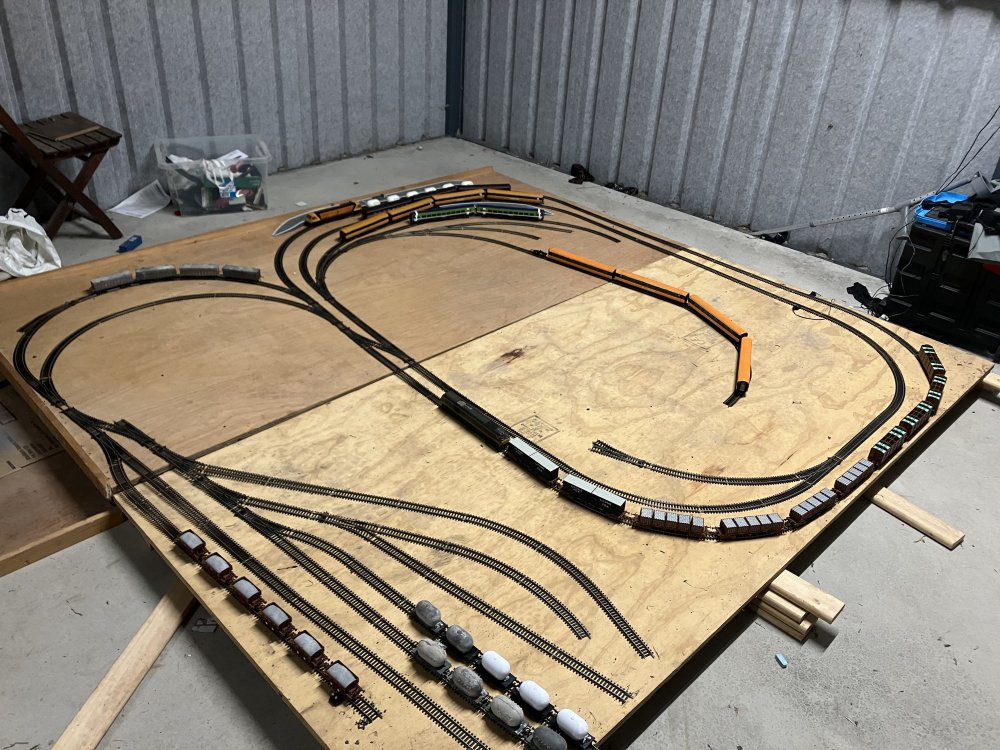

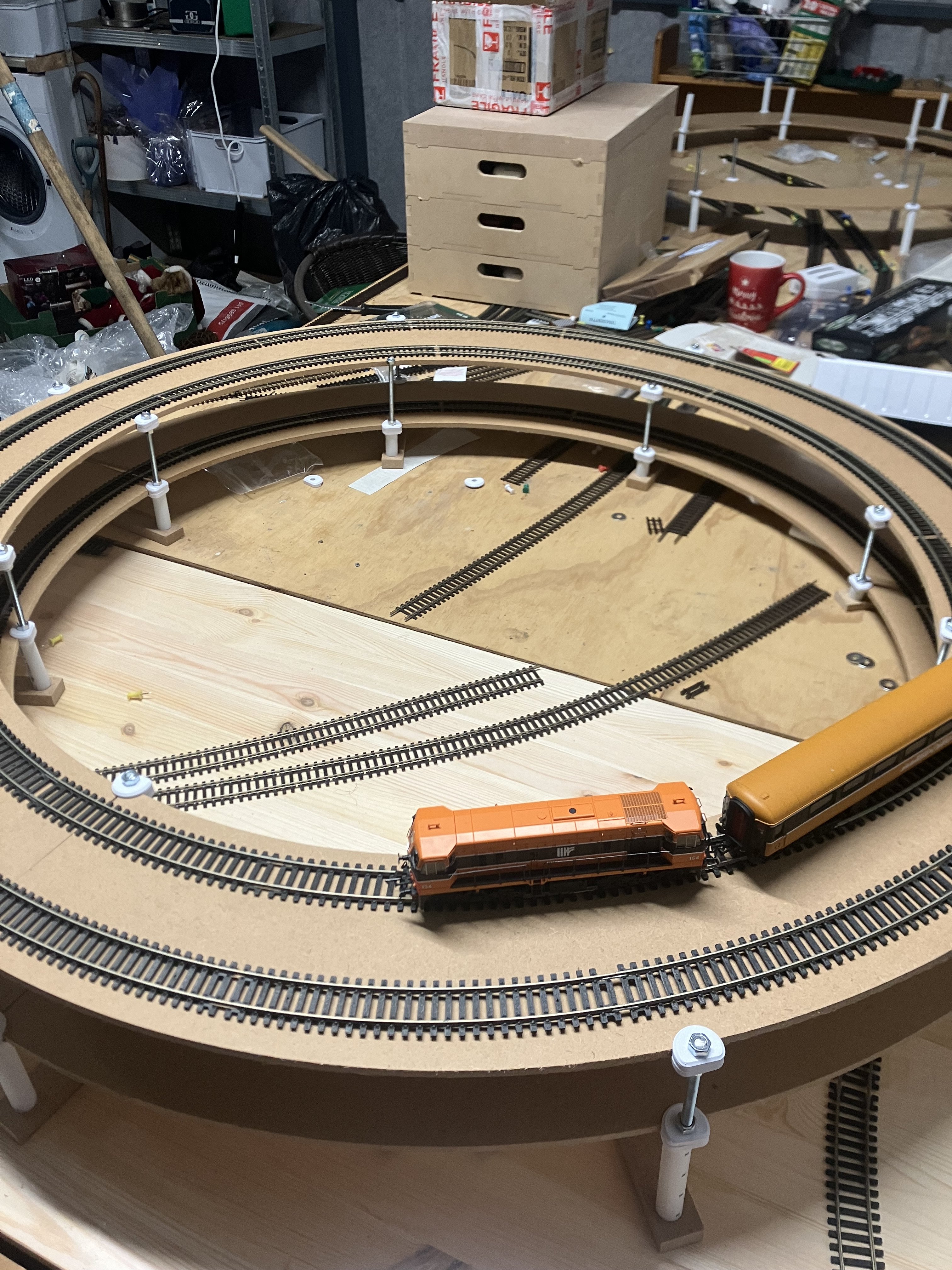

Pre existing layout: The start of the Journey
Finally got around to taking pictures of my current makeshift layout before I started planning this project and writing this forum:
a couple of things to note

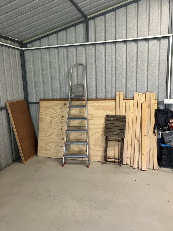

space for future layout: fortunately im quite lucky to have a large garage 6m x 9m shed to set up shop for my layout.( see pictures below)
this gives me a great foundation to start and to give ample space to plan and built the future baseboard for this layout. I plan on having two baseboards joining together( I’ve marked baseboards on my original drawing of the layout in picture 3 below)
the main baseboard which will have the majority of the layout -Drogheda Macbride station and Buckys siding (red baseboard on layout plan in picture 3)
the additional baseboard will go off the main baseboard at an angle which will include the navan branch line from the station all the way out to Platin and the Platin sidings.( green base board in picture 3).
This then gives plenty of space between two to walk around and access to track, or as the the scholar @dereks coined it “reachability”
The current baseboard: in the picture below is the left over baseboards from my childhood layout that my dad built for me many moons ago.
This is currently just thrown together to allow me to run the trains for fun and to enjoy as I built my collection
why is the layout on the ground you may asked ? Well the layout sat on four trestles but unfortunately are missing in action since I returned home from Uni 👀😂
Future baseboards :
Thankfully with the garage there is a lot of space to spare, this will allow me to construct an even bigger baseboard and allow me to be smarter with the shape of it. Currently pondering about buying a baseboard from Modelrailsbaseboards,especially as you can take them apart quite easily. This will decision will be made after I fix a number of track plan issues that I currently am experiencing
current track plan and parts of the layout.
Below I’ve attached photos of the current layout and protypical photos of what McBride was like in the 90s. The track I have available is what I had to make do with from my childhood collection
Above the 3 roads of drogheda station including the famous middle row,filled with 201 and bubbles,cravens in the middle row and some IE mark 2s. Below is some image of the 3 roads from the southbound  section of the platform
** issue- I feel like on the layout these three roads should be closer to together
Drogheda 19-6-92 (3) GM Super Power
Drogheda 6103 & 183 June1996 s702
access to the Yard: which is a curved point off the inside main line vs what it looked like in real life below
DL passing through Drogheda 047 in Drogheda
issue- as you can see in this pic where my Bachman 2700 is parked, the sharpness of the the running line radius restricts the length of the yard,in future I may have to invest in flexitreck to made the the running line where the mark 2s are parked to be longer and less sharp to give more inside room for the yard
** Currently struggling with connecting the middle row to the outside bend, I think flexi track is going to be needed in order to connect the middle row and outside bend. The prototypical looks so easily connected 🥲
Steam Age International Mainline
Notice the points inline with the 1st mark3 carriage how it curves out of the outside bend as the platform starts
Drogheda 14-6-92 1981-08-20 Drogheda Drogheda 19-6-92 (2) 189 at Drogheda
084 at Drogheda 189 - Drogheda
The view from what will be buckys bridge… think I’m looking forward to modelling this part the most as it will be give me a chance to do a lot with the trees both sides of the track
below are pictures of the navan branch and platin section of the current layout :
The navan branch will need to be longer and required a less of a curve
Platin: I’m currently quite happy with the track plan of platin bur will need to make the sidings longer,again will come in due time when a more permanent baseboard arrives
enjoy the pictures,any tips or tricks would be greatly appreciated and I’ll accept with open arms 🙌🏻🙌🏻
Thanks
Dave

Looks fabulous. I know this is a temporary board, which will help you think about how to access centre of board on  the ‘production version’ for track cleaning and - not that this will happen of course, derailments.
thanks very much for the feedback @Galteemore, I was thinking on the production version I would cut out the board to in the middle as shown here in the picture marked with yellow X’s.
It would give access to both baseboards.
also thinking of making the navan branch which is marked in green in this photo - longer so I could park the Tara’s, bulk cement and gypsum at meeting of the branch line and Belfast line just like what they do in real life

Hi Anders,
You asked for tips and tricks a couple of posts previously. From what I see of your track plan could you not place the Drogheda part of the layout in the corner of the garage and have the Navan branch double back along the other wall behind a scenic break where Buckie's sidings would be placed and pop out in the far corner at Platin's. The return loop could run underneath where the tracks are shewn in red.
The tight curves are approximately 3rd and 4th radius which are 505mm and 572 respectively you could save a little by using smaller radius curves. All the other curves could be done in flexi track to suit and the board might be just over 1m wide at the widest point. Having the layout on an "L" shaped shelf leaves you with about 7m X 4M of floor space left in the garage.
It should give you roughly the same amount of track joined up by long thin bits on shelves around the edge. You could put loops in along the joining bits or underneath where the track is marked in red.
Gibbo.

Are you planning on adding some insulation in the shed? Otherwise you might need your gloves for nine months of the year!

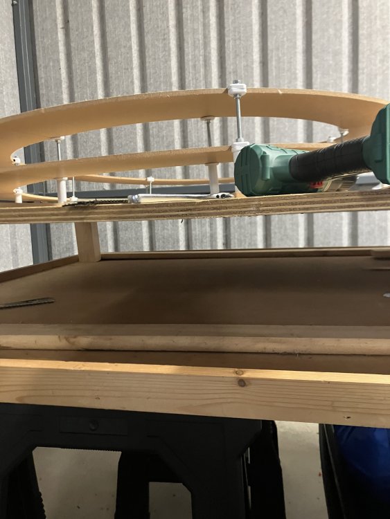

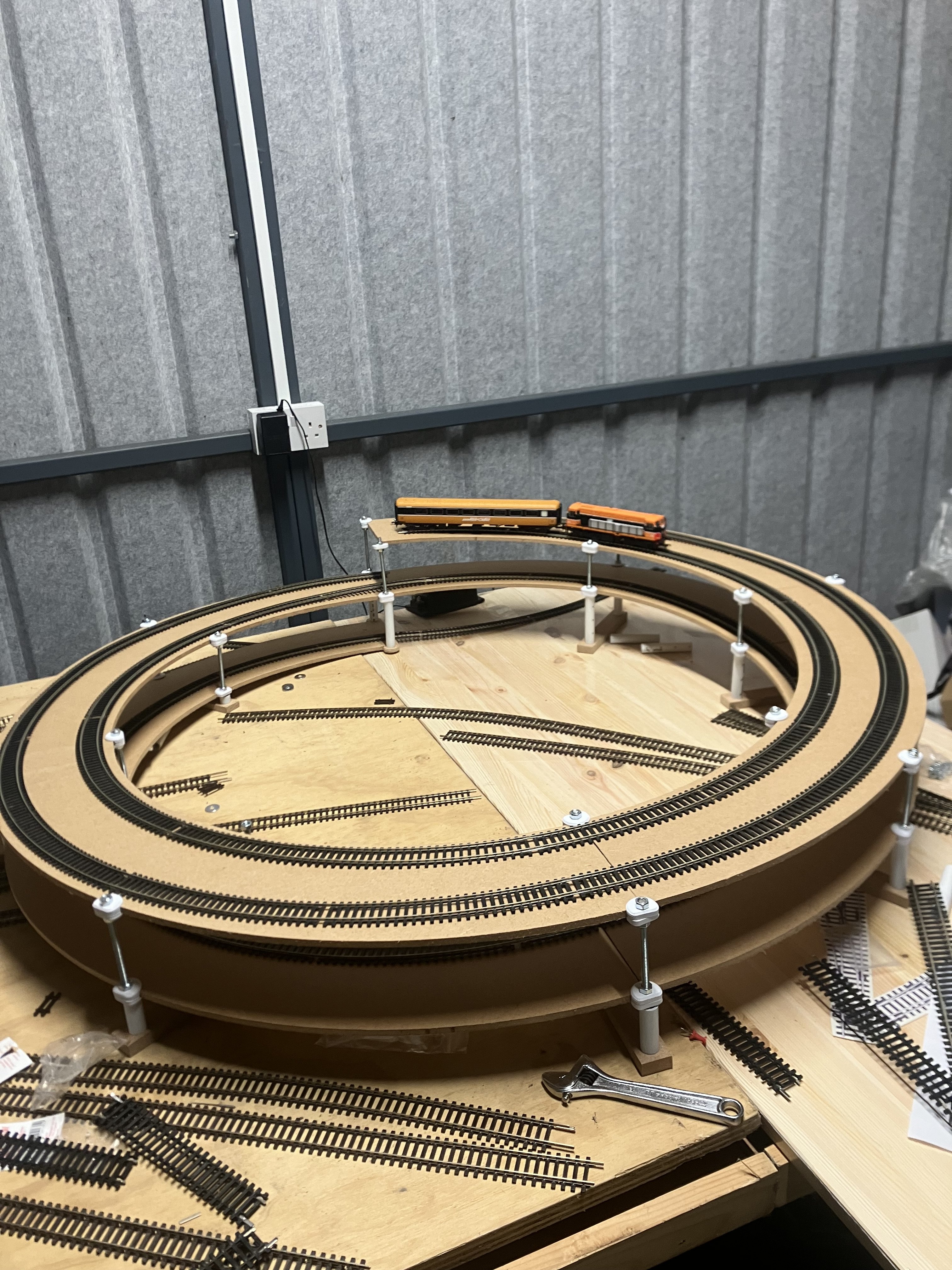

Layout and research.
while I might have been away, the plans for the layout have been throughout and looking forward to sharing with yous soon what I have planned for it 🙌🏻even more as fans of the this forum,I have more maps and images form archives to share of drogheda.
All the best
Dave
Edited by Anders112

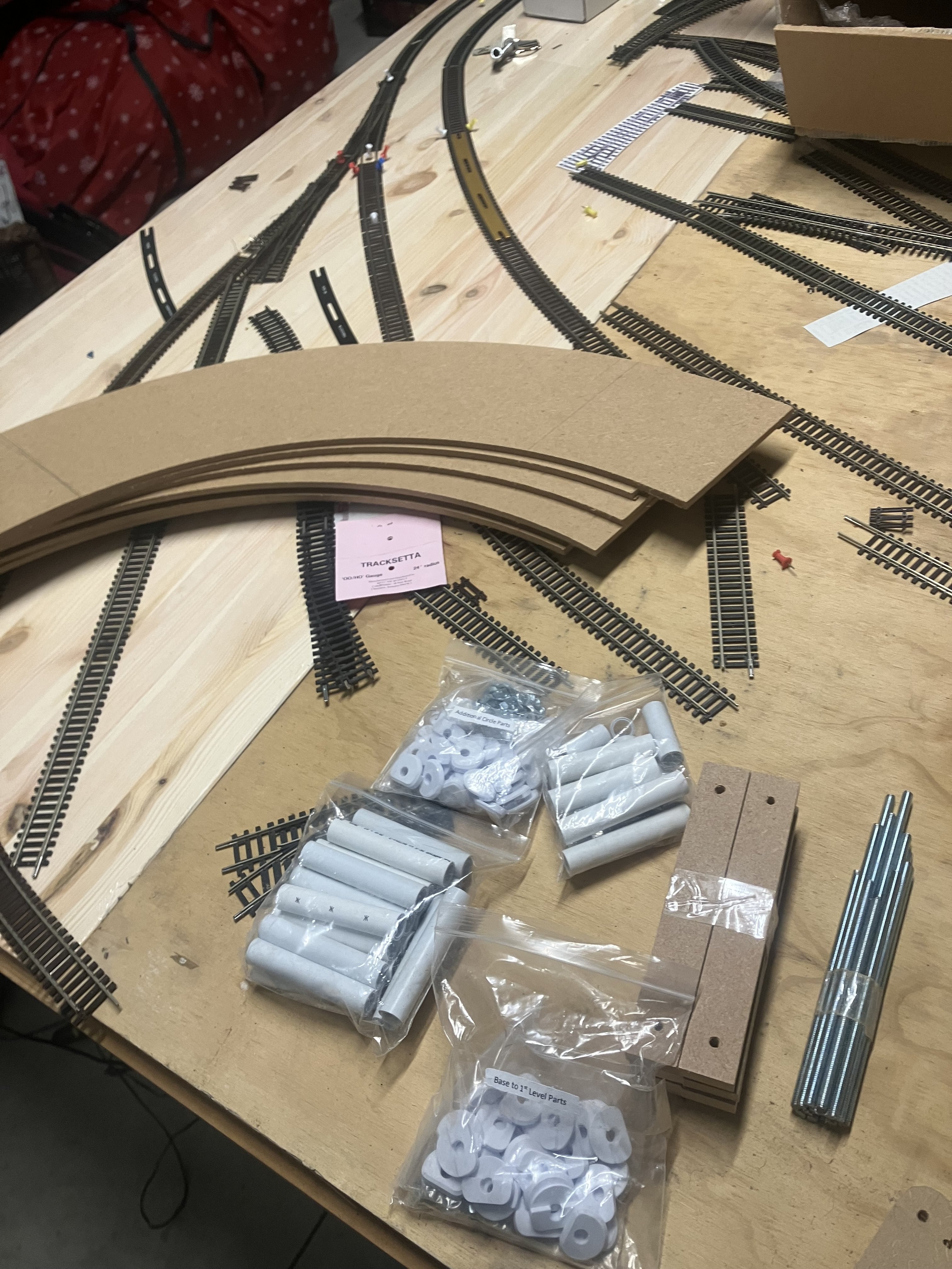

On 21/2/2026 at 10:00 PM, dropshort105 said:
Just spent my day building one of those myself, 👍
Yours is a little neater than mine
Pardon the pun but building it drove me around the bend…
Took a couple of attempts,lots of cups of tea (with biscuits of course)  and several “re-reading” of the instructions .
Mine was a kit off eBay,that took several weeks to come but on the home stretch with it now 🙌🏻IMG_9512.thumb.jpeg.dd075d25defacfd1cea50d916d9f73b3.jpeg
@dropshort105how did you get on with yours ? Was it a kit or did you make it from scratch ?
I didn’t realise the amount of track they eat up, currently on eBay looking for cheap second hand hornBy R609 and r607 curves as I’m short a few.
Wishing you best of luck with yous and looking forward to hearing how you got on with it 🙌🏻
