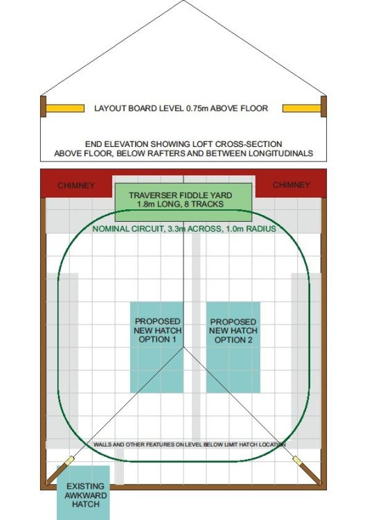

I am mulling over ideas for a built-in layout in the loft space. This would require some work on the loft first, which has been part of the general plan for the house for a while. Perhaps a layout plan would spur me on to fitting out the loft?
The sketch below shows the plan view of the loft-space and an end elevation. The basic space is 3.6m (12') wide and 3.75m (12'6") long, extending a further 0.25m between the chimneys. This alcove would favour a traverser-style fiddle yard which could be 1.8m (6') long. It looks like it's quite feasible to have a circuit 3.3m (11') across in each direction, with 1m radius curves. Obviously it could be more complex and with a more natural trackplan, but it gives an idea of what's feasible:
The space is too small for a worthwhile 7mm scale layout (which is my main scale for non-Irish stuff), which is probably why it has remained unused. However, I think it looks quite reasonable for 4mm scale.
The fiddle yard length would allow realistic length Irish passenger trains of 5 coaches (Cravens/Park Royal etc); alternatively freights of 8 bogies or nearly 20 traditional 4-wheelers. Potentially up to 8 tracks on the traverser would give scope for a couple of passenger trains and a good mix of freights.
I think I could fit in a station with passing loop and simple goods facilities on any of the 3 sides not occupied by the fiddle yard, although the ends of the station would have to bend round the curves. The remainder of the layout could just be single track through scenery, allowing a view of the whole train.
Having spent a lot of my childhood visits to Ireland in and around Ennis, I'm wondering if a representation of that station and yard (in early 1980s state) could be squeezed in. Station on the left side of the plan, north end road bridge at the top, the south end throat would have to curve round in the bottom left corner. I think it would need only 5 or 6 points. Scenery-wise, Clare Abbey bottom right and the Fergus bridge middle right? Some trains would run through, others would stop and shunt before continuing in the same direction, while some would come from Limerick direction, terminate at Ennis and later return to the fiddle yard.
Of course there are a load of practical issues to deal with including fitting out the loft and the temperature fluctuations.
