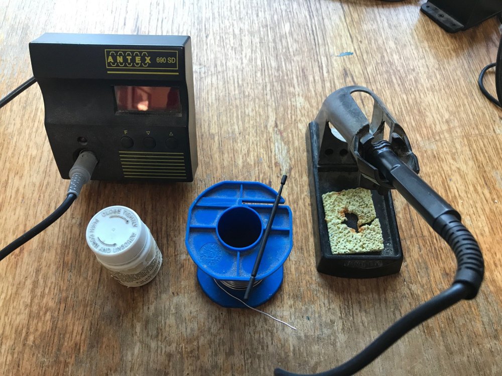

Soldering is a key skill, and it's well worth learning about this from books or online tutorials - whatever format suits you best - and lots of practice. I would encourage you to learn to solder first, which you can do with any old offcuts of thin brass (I expect anyone into brass kits could give you a free pack of etch fret offcuts). Don't glue the first kit - soldering is far better and it's a skill you need to learn at the start and develop over time, rather than being scared of it.
The right iron and temperature, the right solder, the right flux, and cleanliness of the metal are all important. Get those right and it's easy!
Different soldering jobs may call for different tools/solders etc, but for 99% of my etched kit building I use these:
25W temperature-controlled soldering iron with interchangeable bits, Carrs green flux, leaded 145 degree solder, and a fine brush for applying the flux.

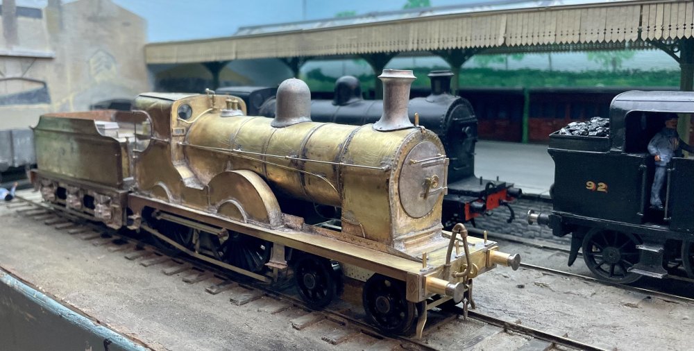

While we're on tools, I gathered together the tools I've used for building the E class. I think I've got most of them here:
Not shown are a small vice, and an ultrasonic bath for cleaning up after each soldering session. Also various odd bits of wood etc.
As you progress with building your skills on etched kits, you will gradually build up your toolkit too. And your stocks of brass offcuts, wire, small nuts and bolts etc.
It's very rewarding to make a nice brass model. Start simple, gradually build up towards your dream loco.

One of the tricks with soldering white metal is to use phosphoric/water flux, douse the area to be soldered with the flux, load the iron with 70deg solder and just stick the iron tip into the flux and in a millisecond when the heat gets into the metal the solder will flood the join. No touching the metal just the flux....
Eoin
  • Agree 1
  • Informative 4
Whitemetal soldering is a different art.
For me, extreme cleanliness and red flux. Iron set to 200C (!) with 70C solder and be VERY quick - the solder will flow like water and fill the joint. But this takes some bravery…
  • Agree 1

I generally solder whitemetal kits using a special 'temperature controlled" soldering iron (expensive) with 100º solder & phosphoric acid flux not really practical or wroth while for assembling one kit.

I first tried my hand at scratchbuilding using plasticard when I was around 14-15 and later moved on to tin scrounged from food tins, usually on second hand Triang chassis none of these early efforts were exactly successful. I started my first reasonably successful efforts at model making in my late teens after I began working after finishing secondary school including a reasonably successful "Irish' N gauge layout before returning to 4mm and attempting to model in 21mm gauge in my Mid-20s. I assembled my first Etched Brass loco kit a TMD/SSM Midland Tank in the Mid-80s but it took me approx 8 years to become reasonably proficient in kit/scratch building.
Like training for a profession or "serving your time" as a trade its takes time to become reasonably proficient in model making.
  • Like 5
