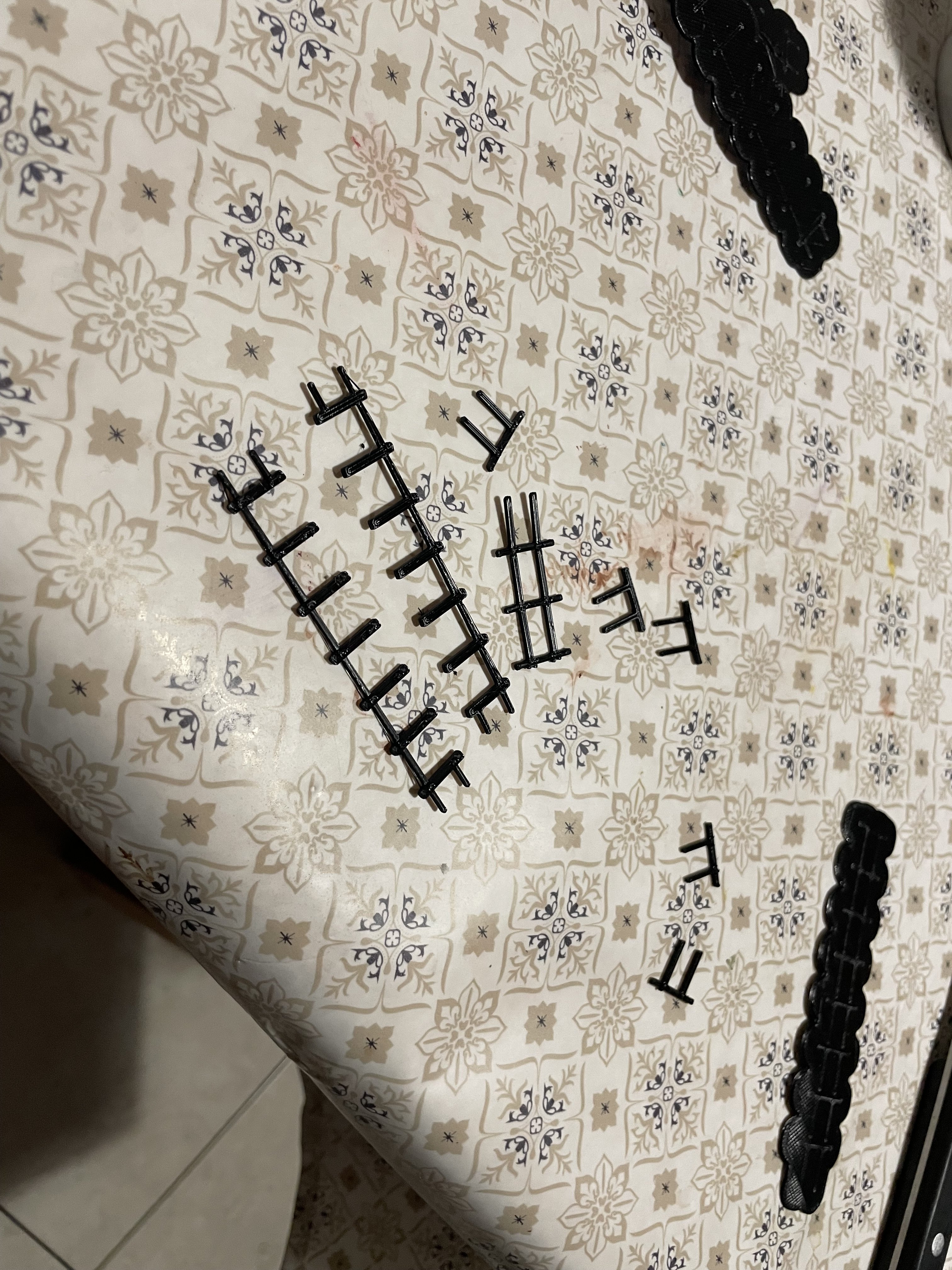

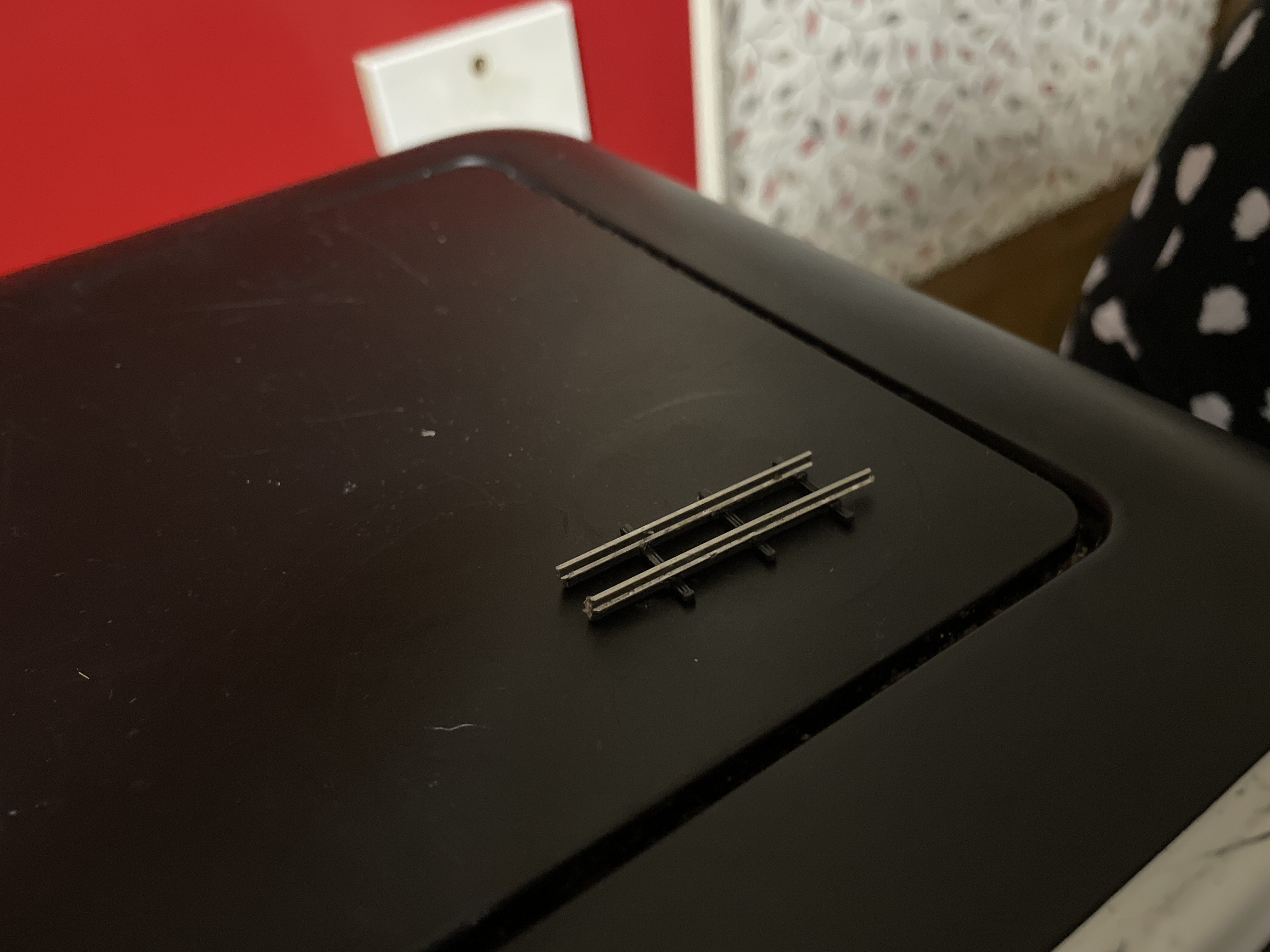

Sean Posted October 18 Author Posted October 18 did not expect to update so soon, but there has been a development! Sent 3d files off to my library at around 10 am and was told it would be a 2-3 day wait for the bits to come back. I was pleasantly surprised to get an email to come and pick them up at half 4! The schwellenband design did not work well at all for me, the enlarged rail chairs were too flimsy and broke off in my pocket as i was walking around. the tim1mw however was a different story. the tim1mw however was a different story. half of the sleepers were not attatched and this will have to be fixed in the next revisions, I only got track panel that was 3 sleepers long! I was under the impression that code 75 meant code 75 and scale would play no part in the rail profile. I was wrong about this and all of the H0/00 code 75 that I do have is actually way too big. so I picked up a random piece of straight n gauge track, removed the rails, offered it up and fit snugly into the chairs! perhaps this was a measurement fluke, but it has proven to me that this track system works and will be workable going forward, which is great because there are 3d. printable points as well since i cant use the code 75 rail I have now I will order the proper z scale rail which is designed to work with this system and other h0f systems for interconnect ability. 600mm x 6 comes to a grand total of 15 euro which beats any other option by multiples! 1 1

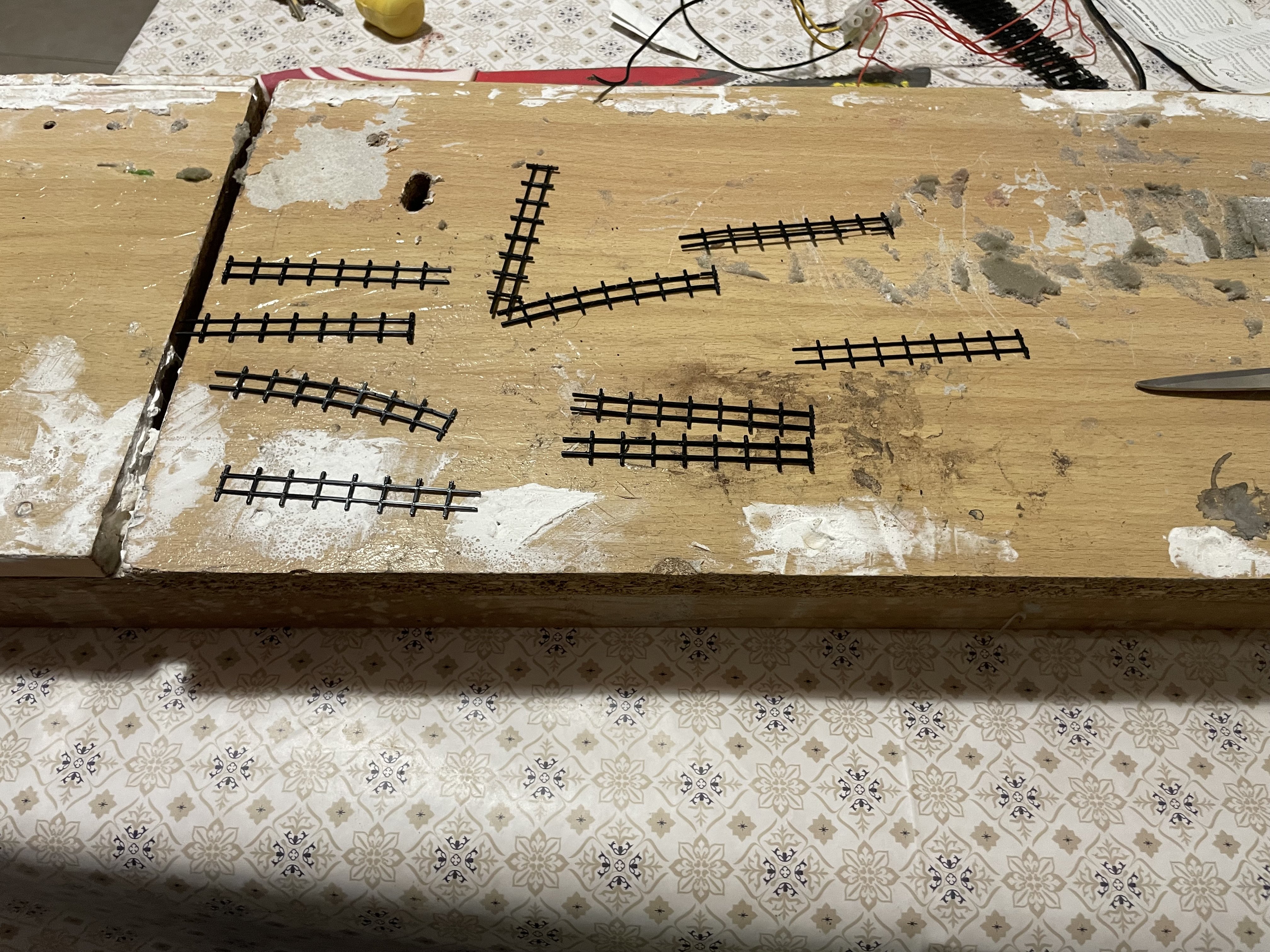

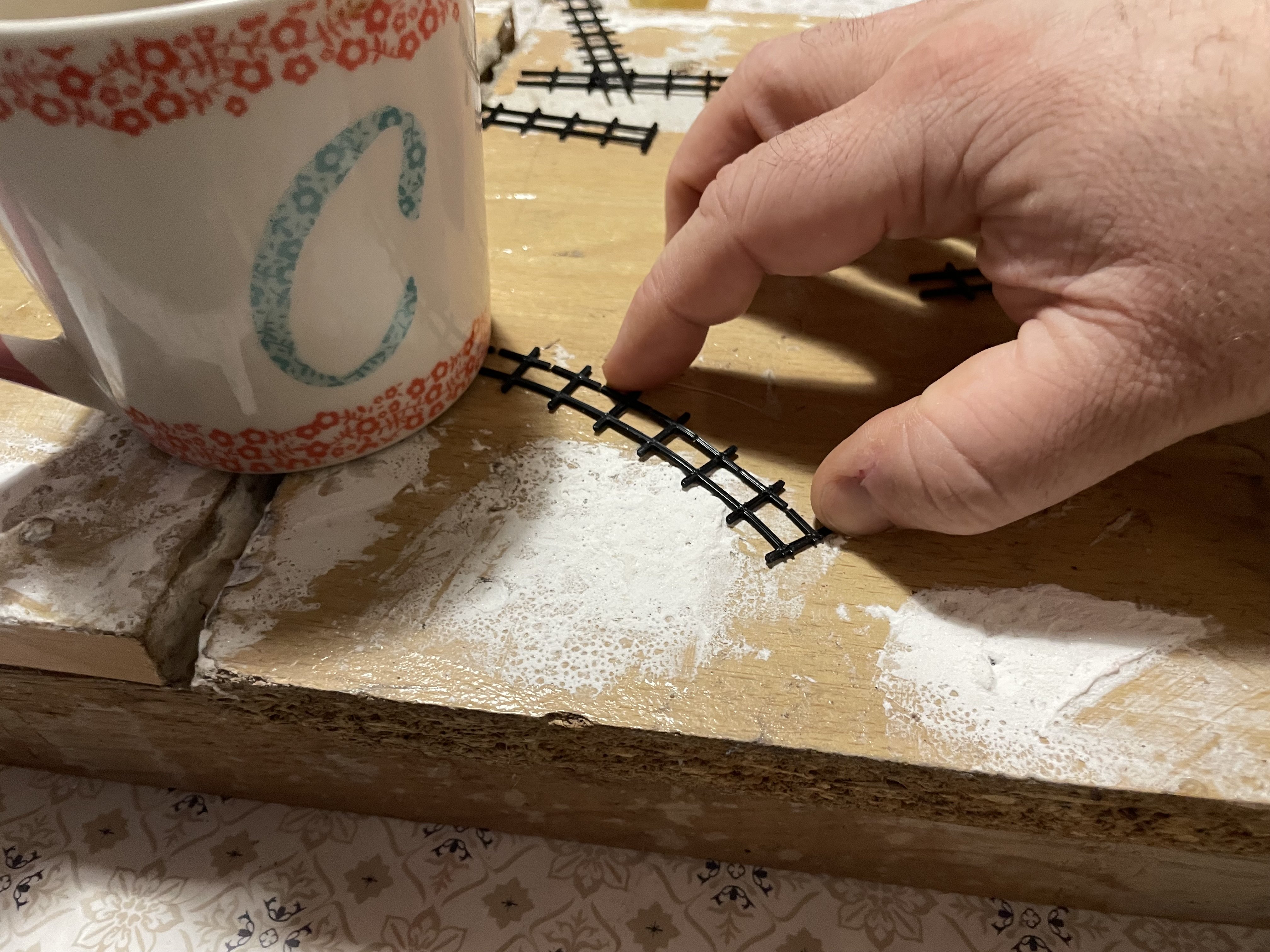

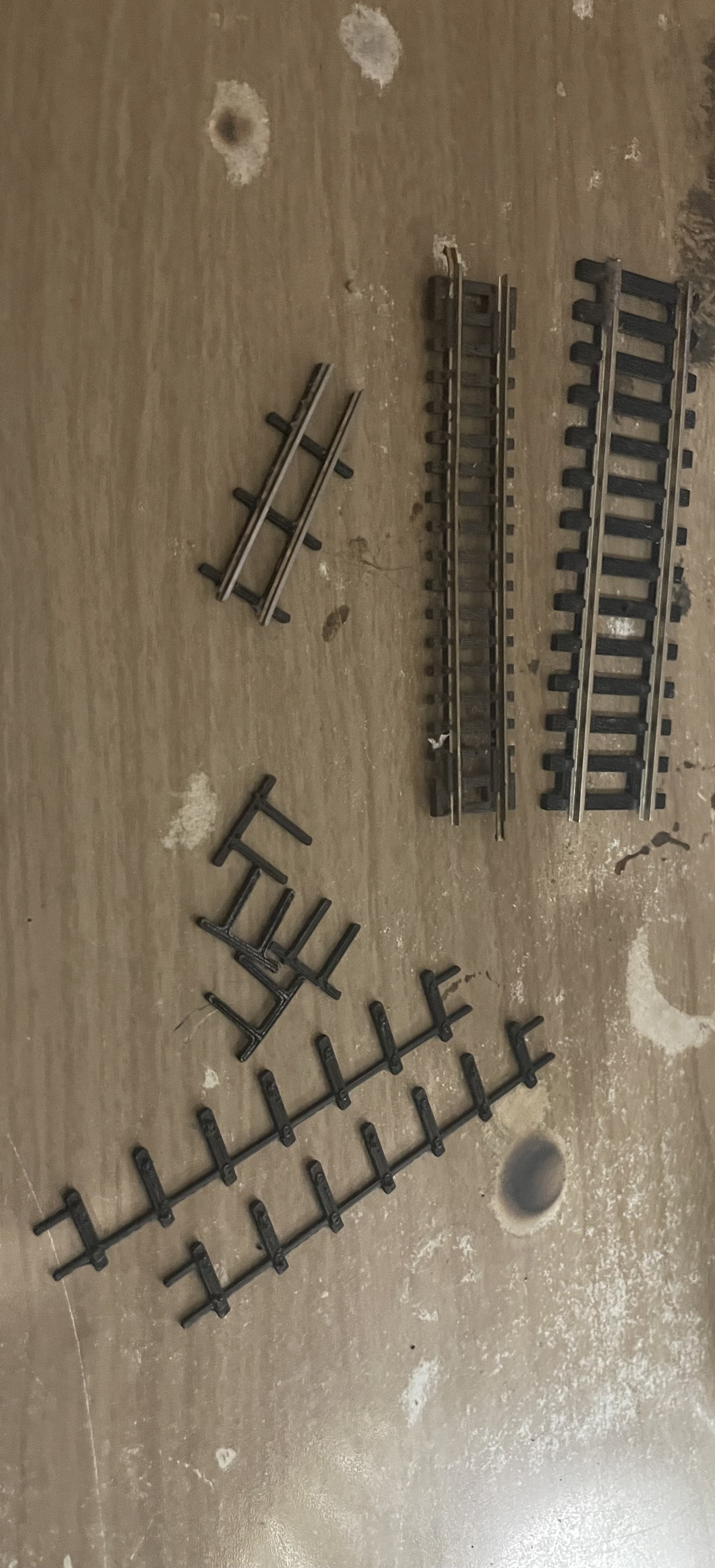

Sean Posted October 20 Author Posted October 20 Back to the library today and asked for 5 pieces of the unmodified track design as I have now ordered the correct rail for this design. Went in and they had 10 pieces as they had tried 5 on different settings for me. Some slight issues with the chairs on these that were not present the last day, but also they were printed by another person who may have changed the settings. Still it was good to be able to experiment with these. It is pretty impressive just how flexible this material is and its not a million miles away from the shiny abs plastic that flextrack is actually made out of. I will go back in with todays and saturdays prints which had great chairs and show them the issue, I think they should be able to get it right for me then :) I wont have the rails for another couple of days so i can trick around with this until then. 1

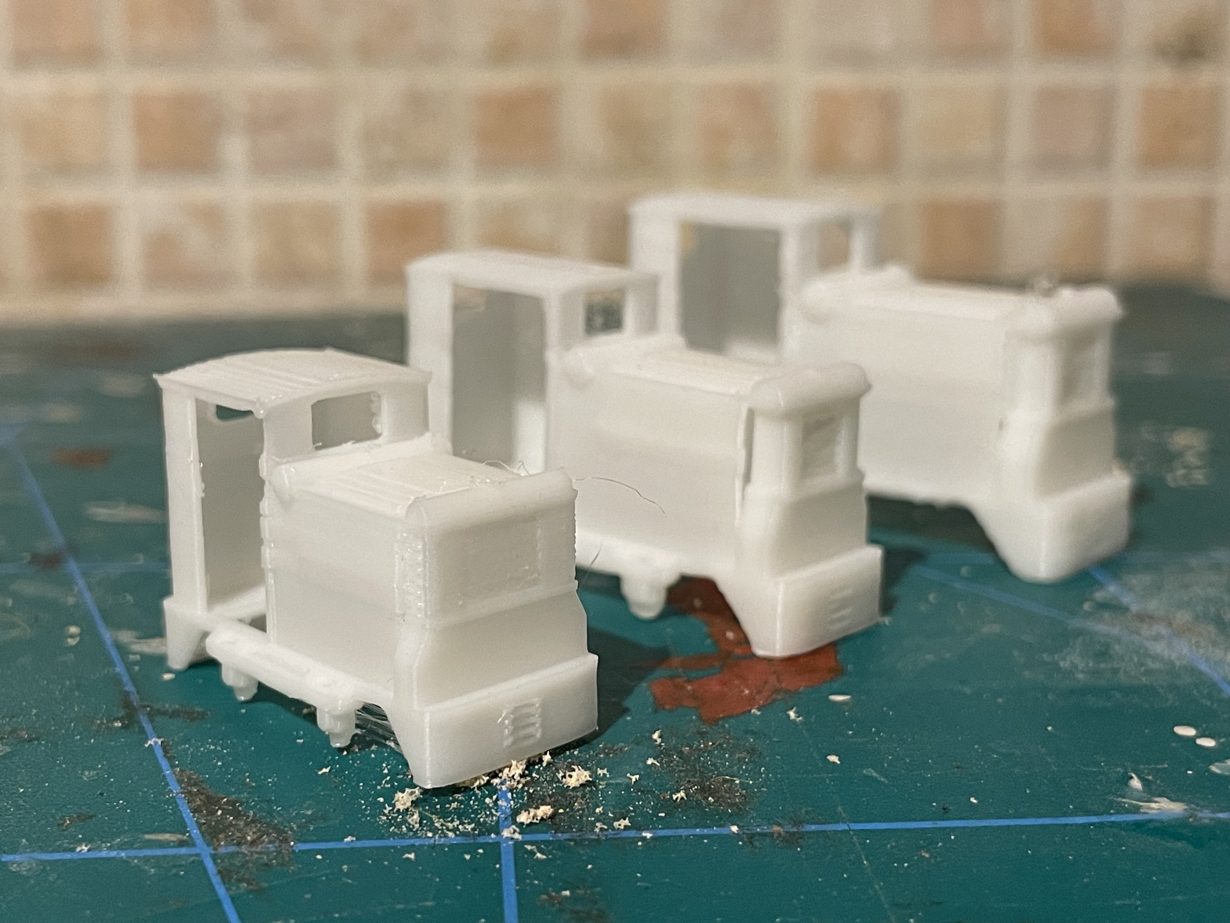

Sean Posted October 24 Author Posted October 24 First attempt at a ruston 13DL. scaled down from 00 to h0, bit rough around the skirt, alas i think redoing it with supports with take care of that, 3
jhb171achill Posted October 25 Posted October 25 2 hours ago, Sean said: First attempt at a ruston 13DL. scaled down from 00 to h0, bit rough around the skirt I’d be wary of ladies like that….. 1

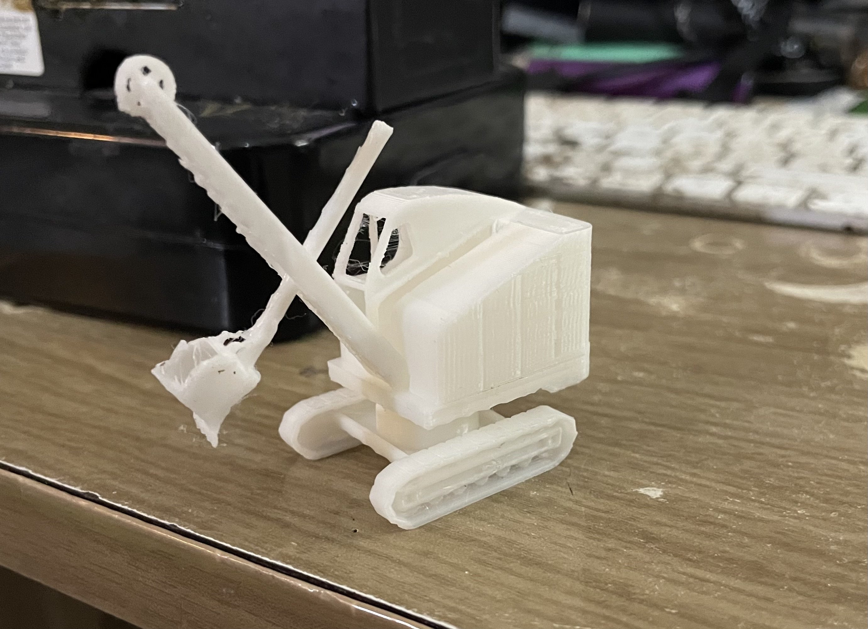

Sean Posted October 25 Author Posted October 25 Ruston bucyrus rb10 which I’ve been needing for another layout I’m secretly planning 8

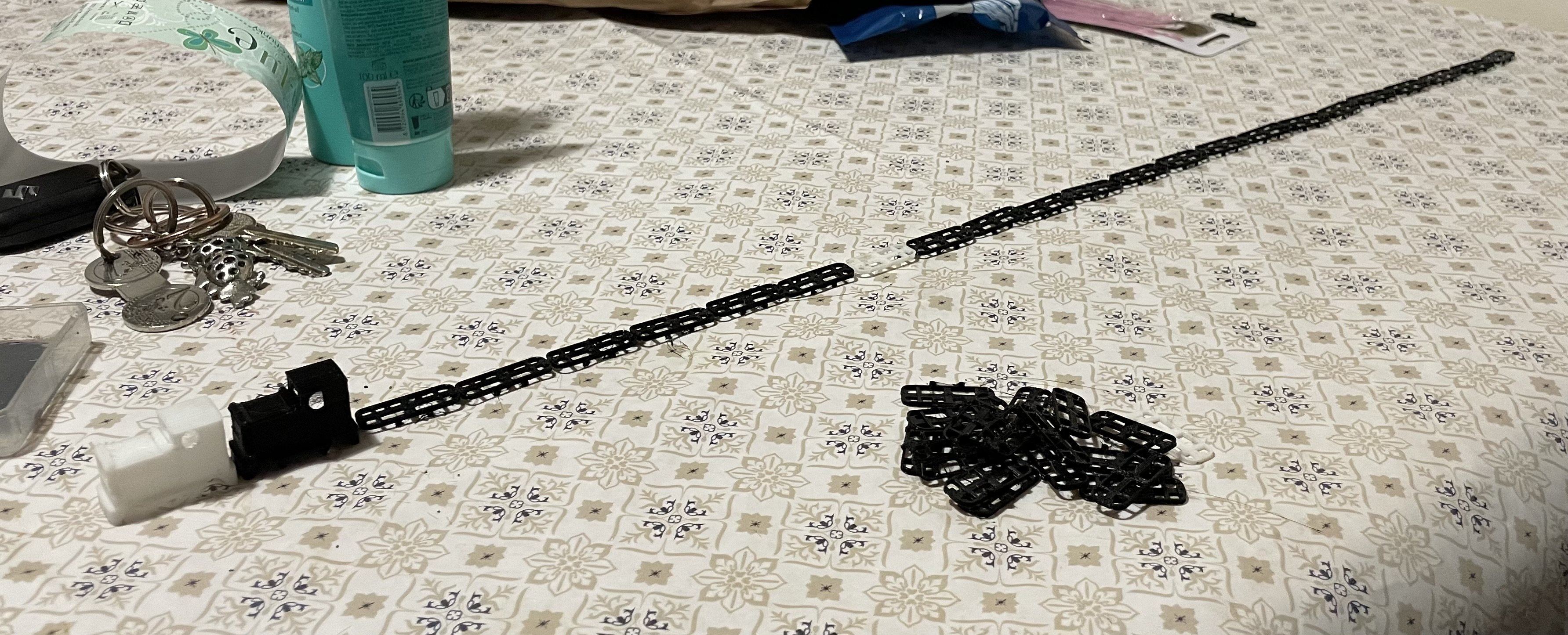

Sean Posted October 27 Author Posted October 27 have been considering the practicality’s of running a full rake 2

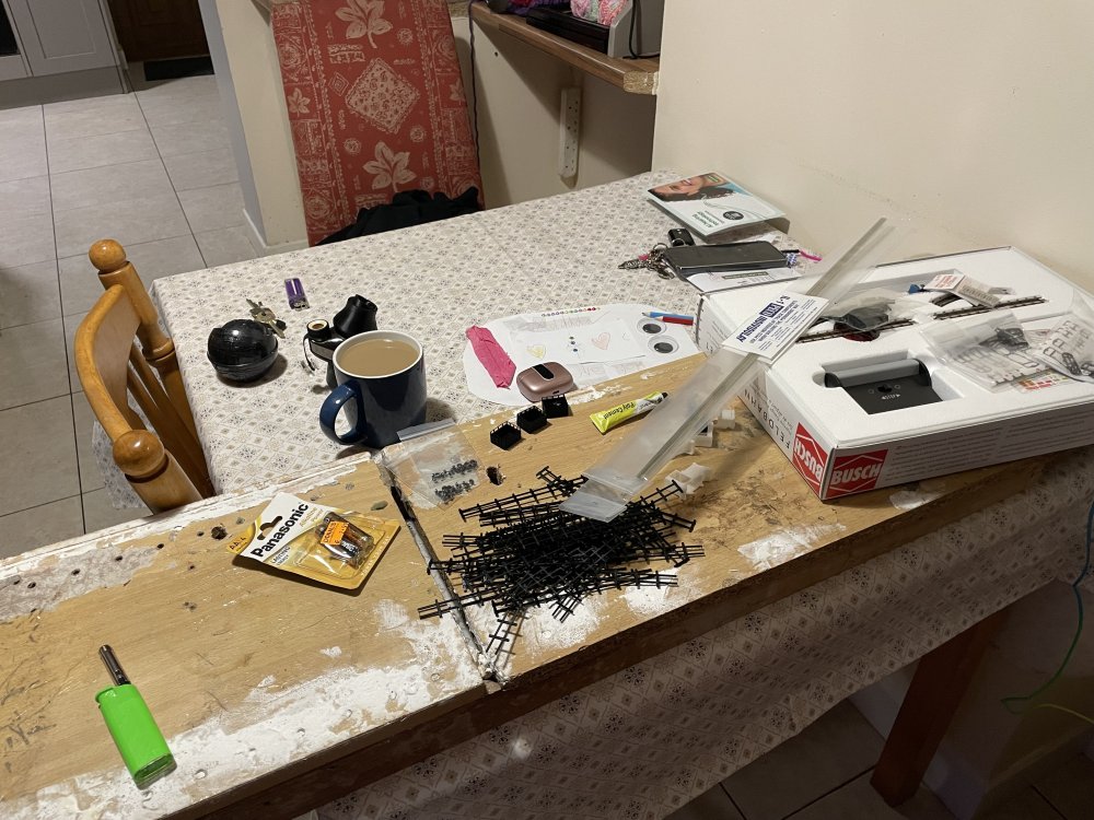

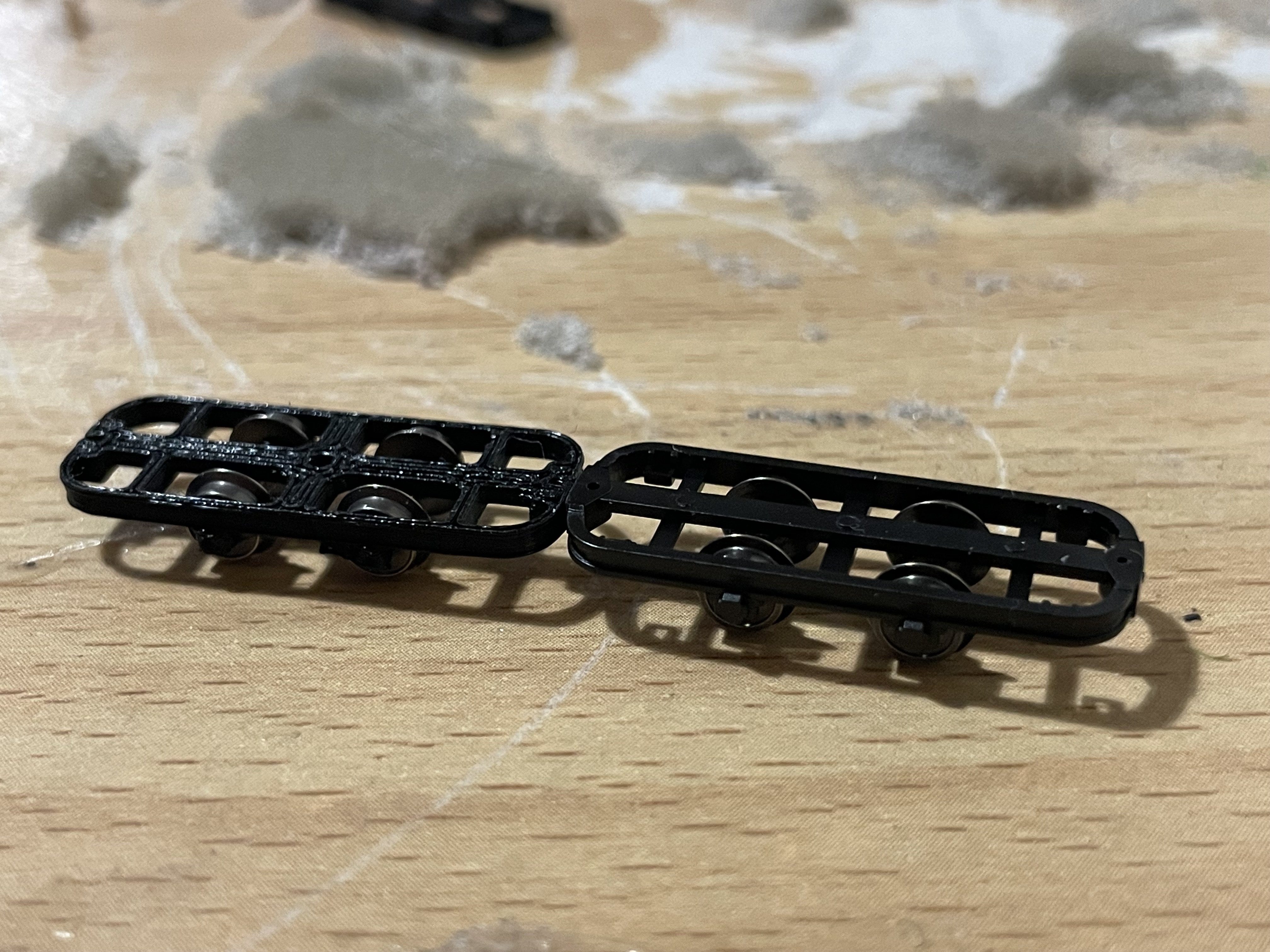

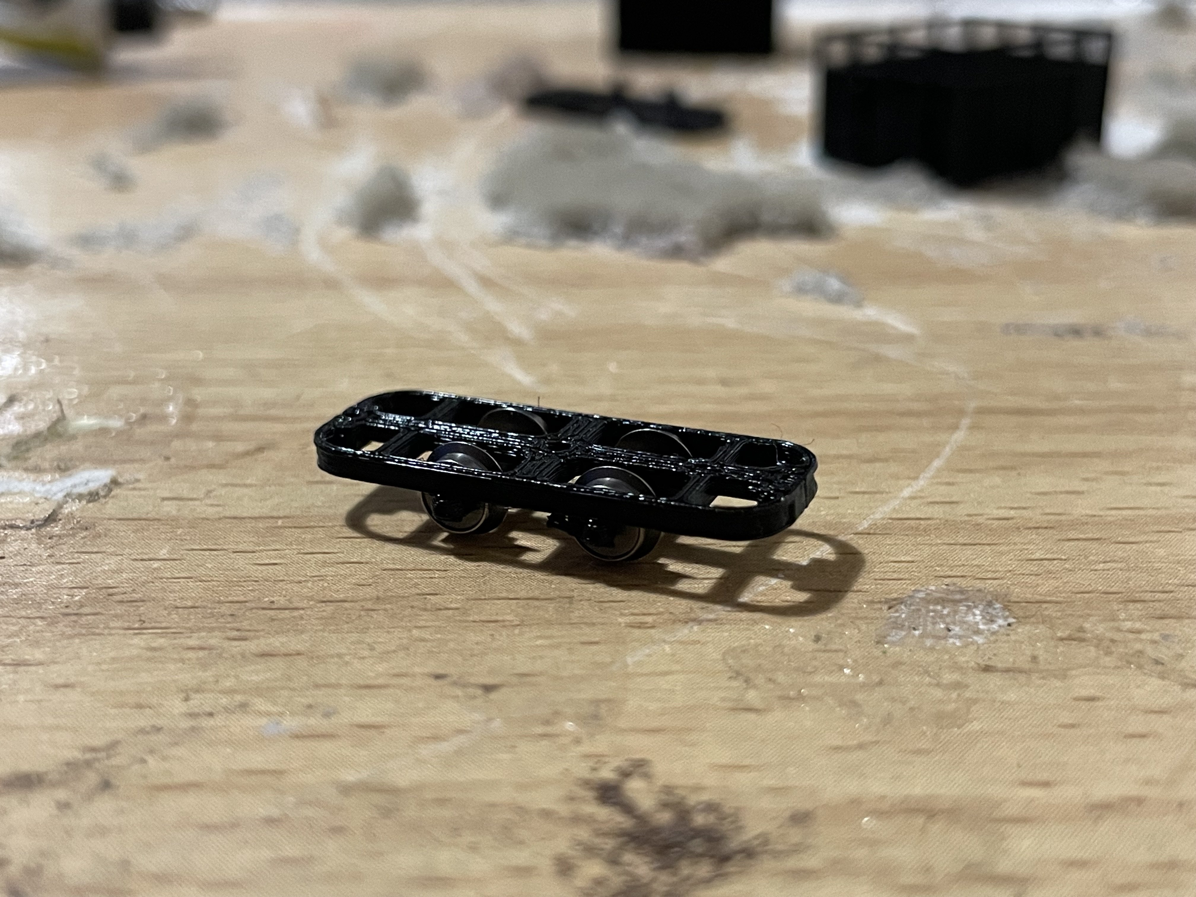

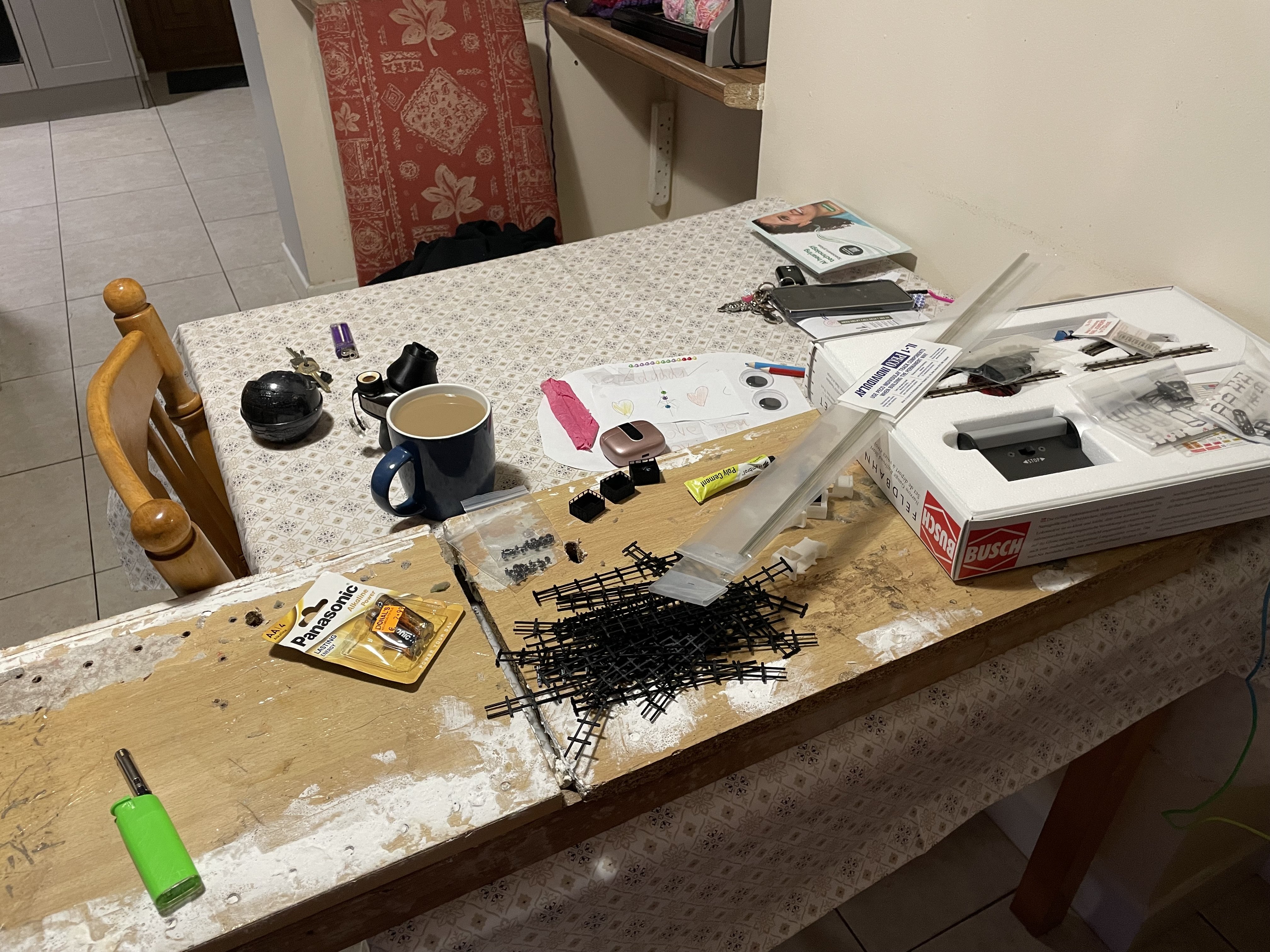

Sean Posted October 28 Author Posted October 28 finally the larger delivery came in from Germany and I can start to have some fun. decided to buy a starter set as it was almost the same price as buying the loco and controller and few wagons outright. The track is also slightly non standard so I wanted to see how this system worked for when I am building up my own z gauge wheels fitted to my printed chassis. Rolls decently. i also bought a few Busch wagon kits before I pulled the trigger on the printing as I wanted to be able to compare the two. There’s very little difference in it really. 1

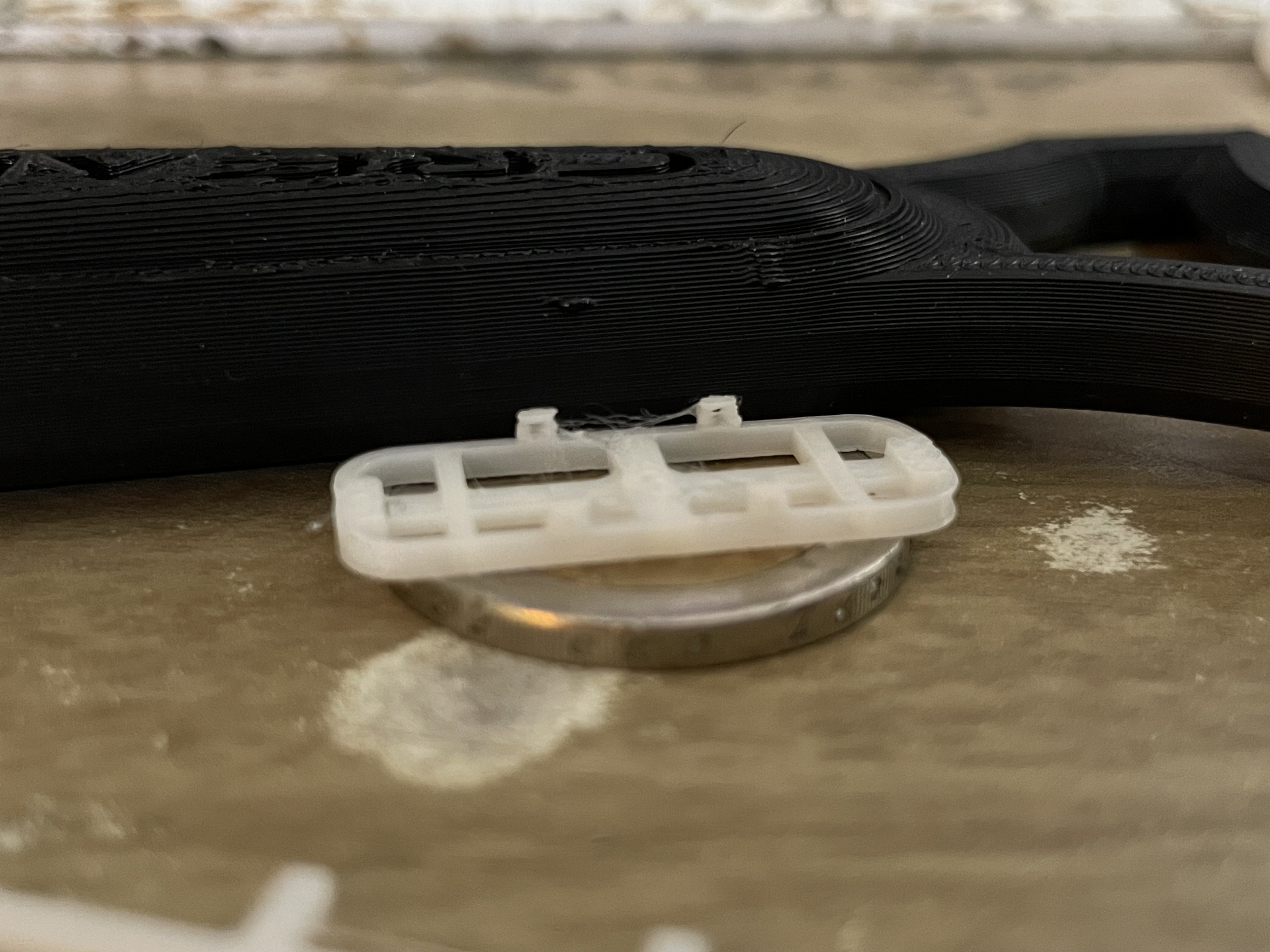

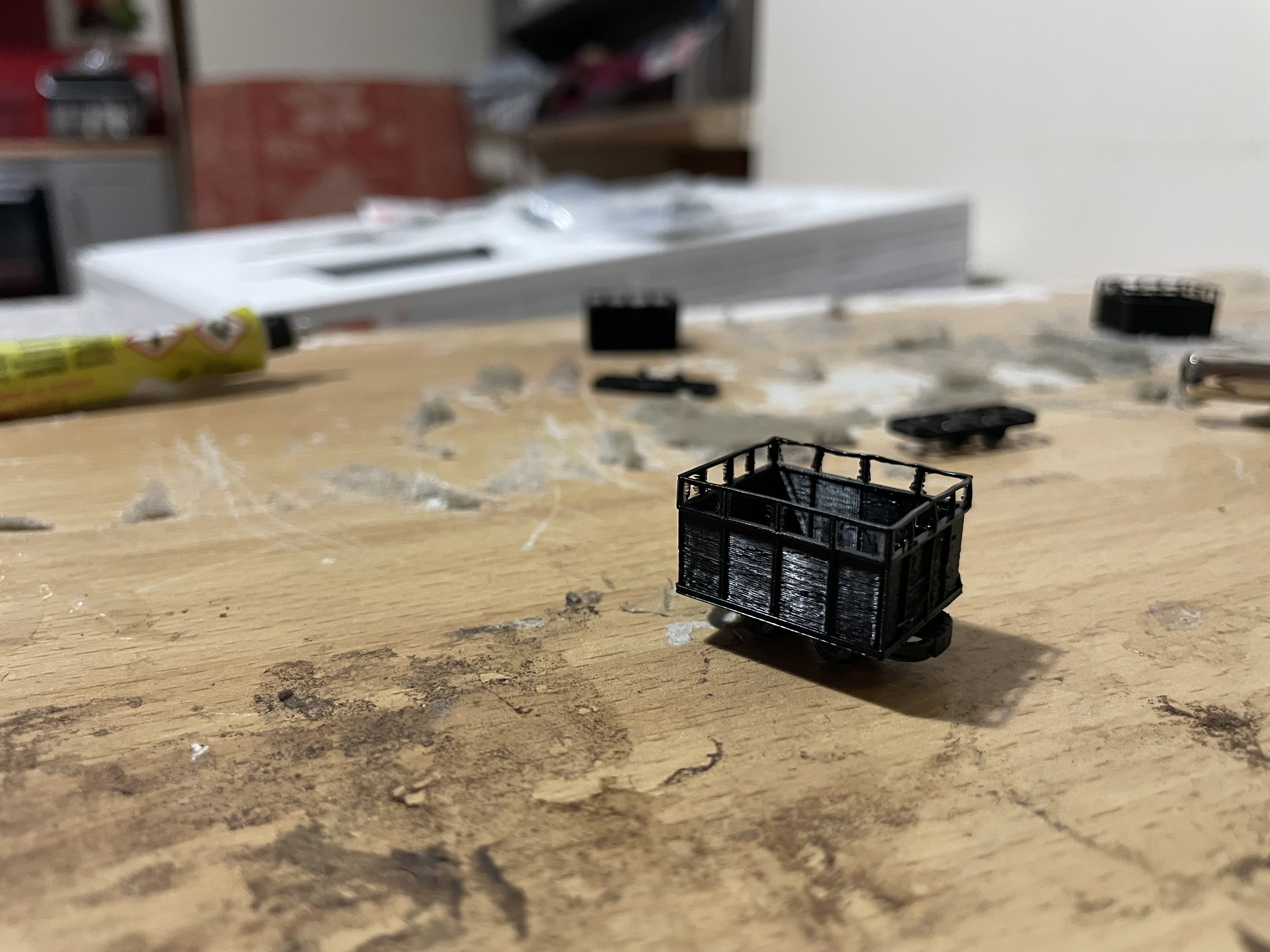

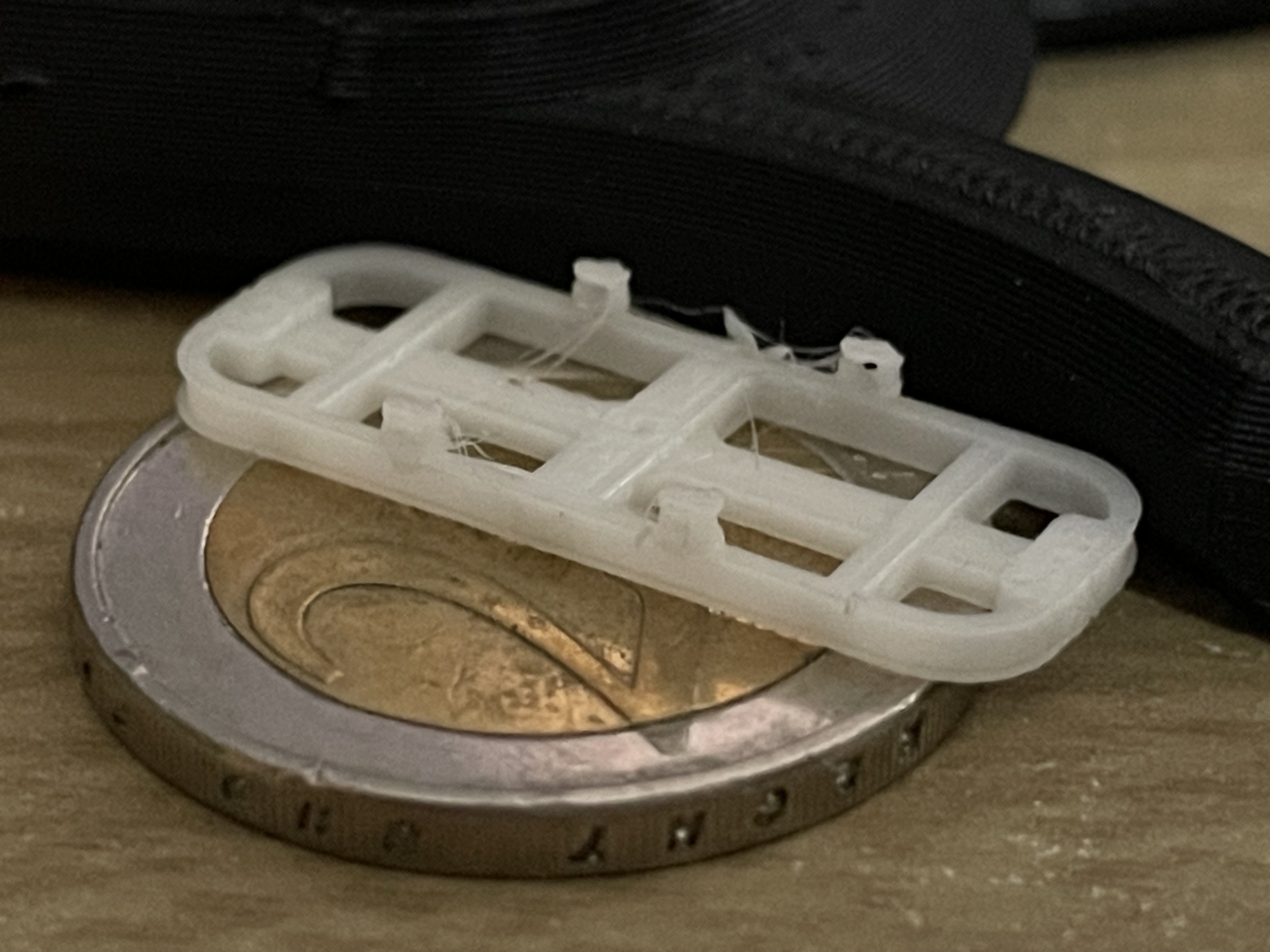

Sean Posted October 28 Author Posted October 28 my own first self design is this very tiny turf tippler to sit ontop of the h0f chassis. I need to order different filament before proceeding as this black stuff doesn’t feel as clean as the white stuff that came in the sample box. overall I’m delighted with my results 2
Flying Snail Posted October 28 Posted October 28 Its very impressive to see the level of detail you're getting with FDM printing

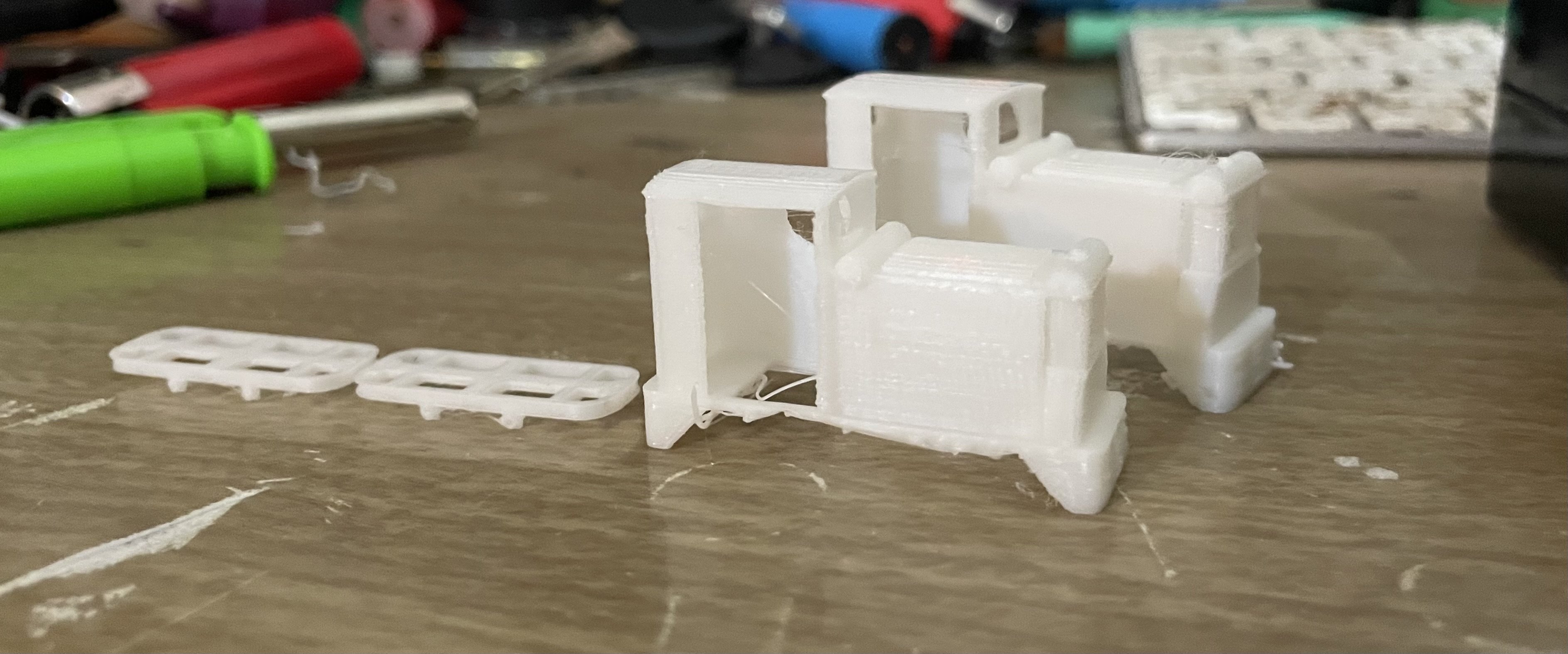

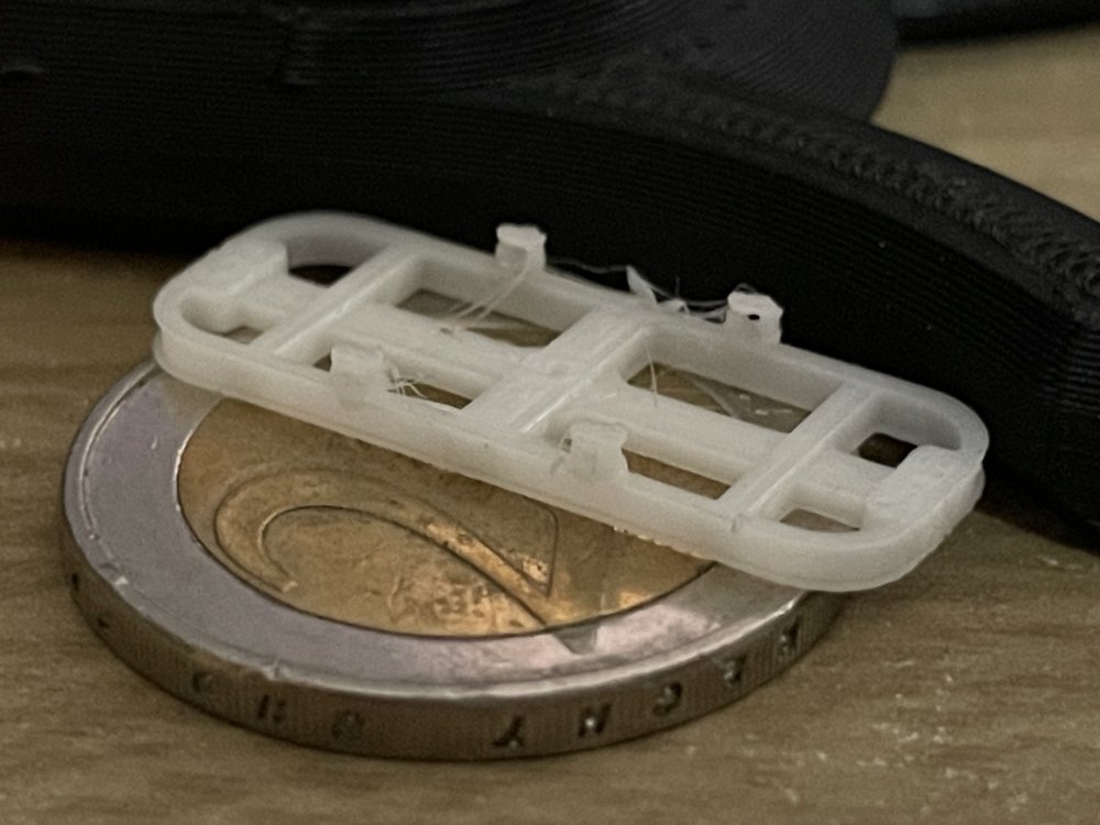

Sean Posted October 28 Author Posted October 28 (edited) 36 minutes ago, Flying Snail said: Its very impressive to see the level of detail you're getting with FDM printing It has certainly surpassed my needs and expectations. this was a bit of a torture test last night! sadly the white filament ran out and the last little bit had to go black ive ordered a 0.2mm nozzle which should actually increase resolute detail even further but the print times will double and this little guy took 3 hours as it is! still not too bad once your patient. Edited October 28 by Sean 2
