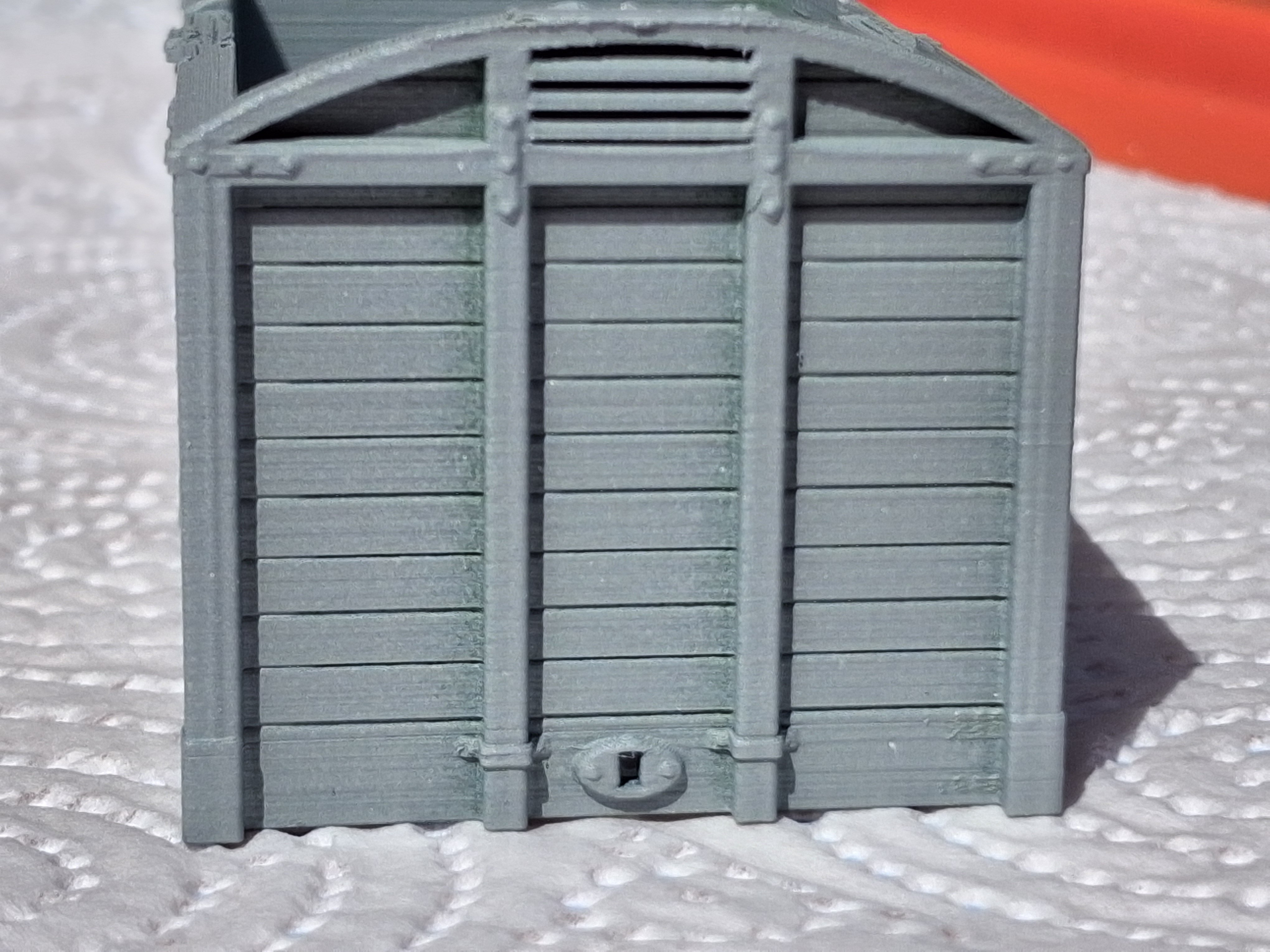

Very nice - I am tempted by a 4mm scale one when you go into production 😉

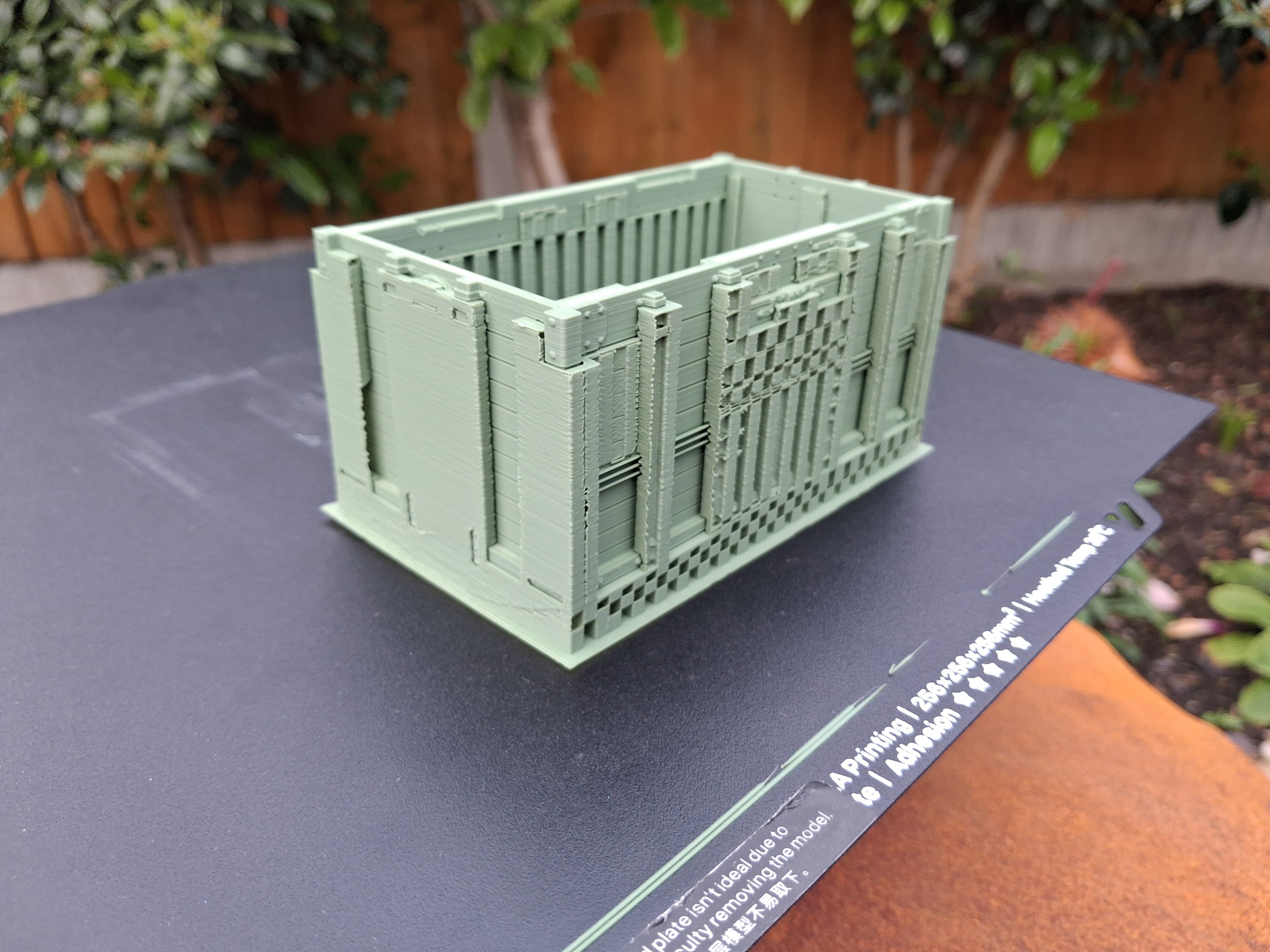

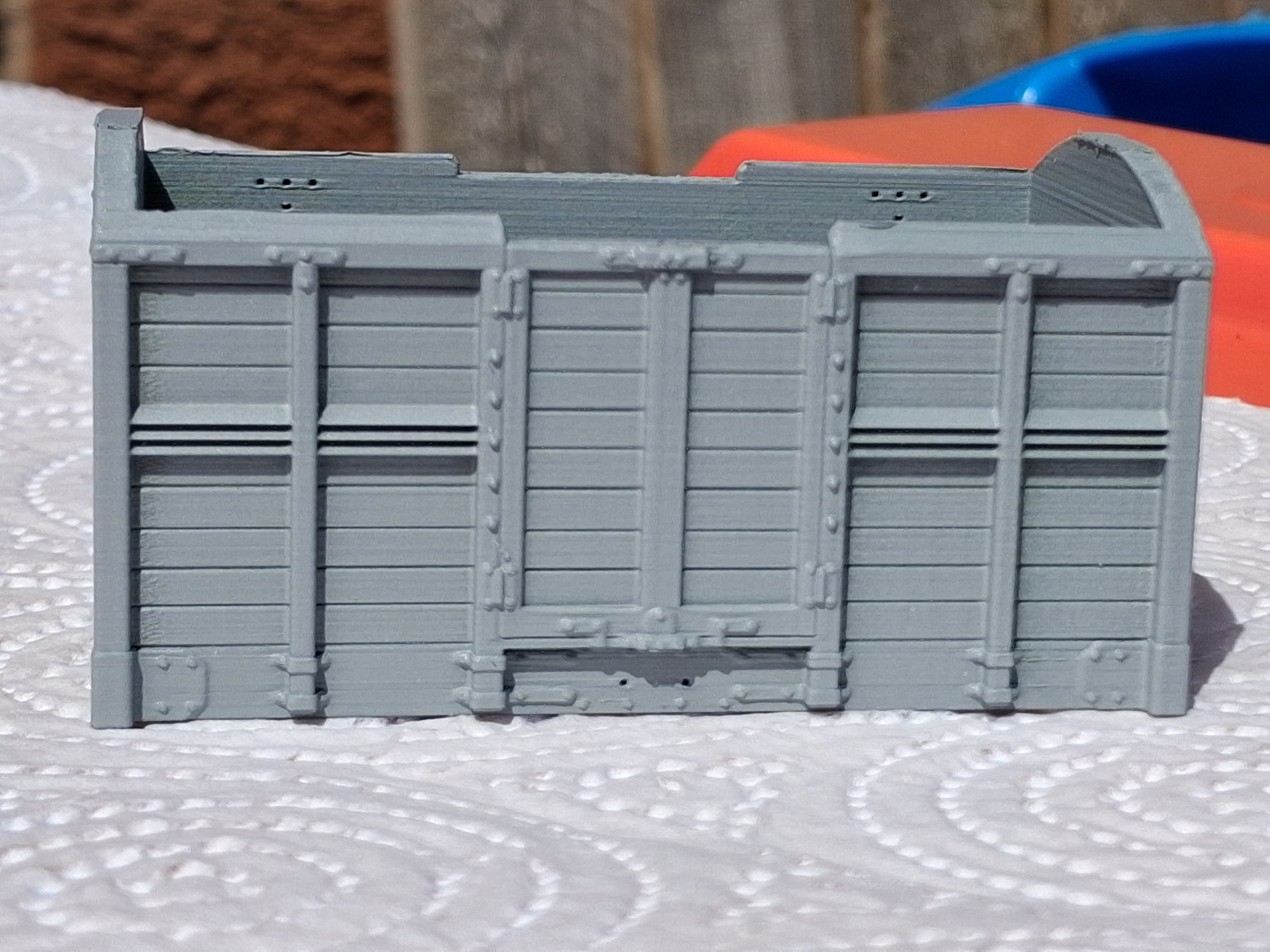

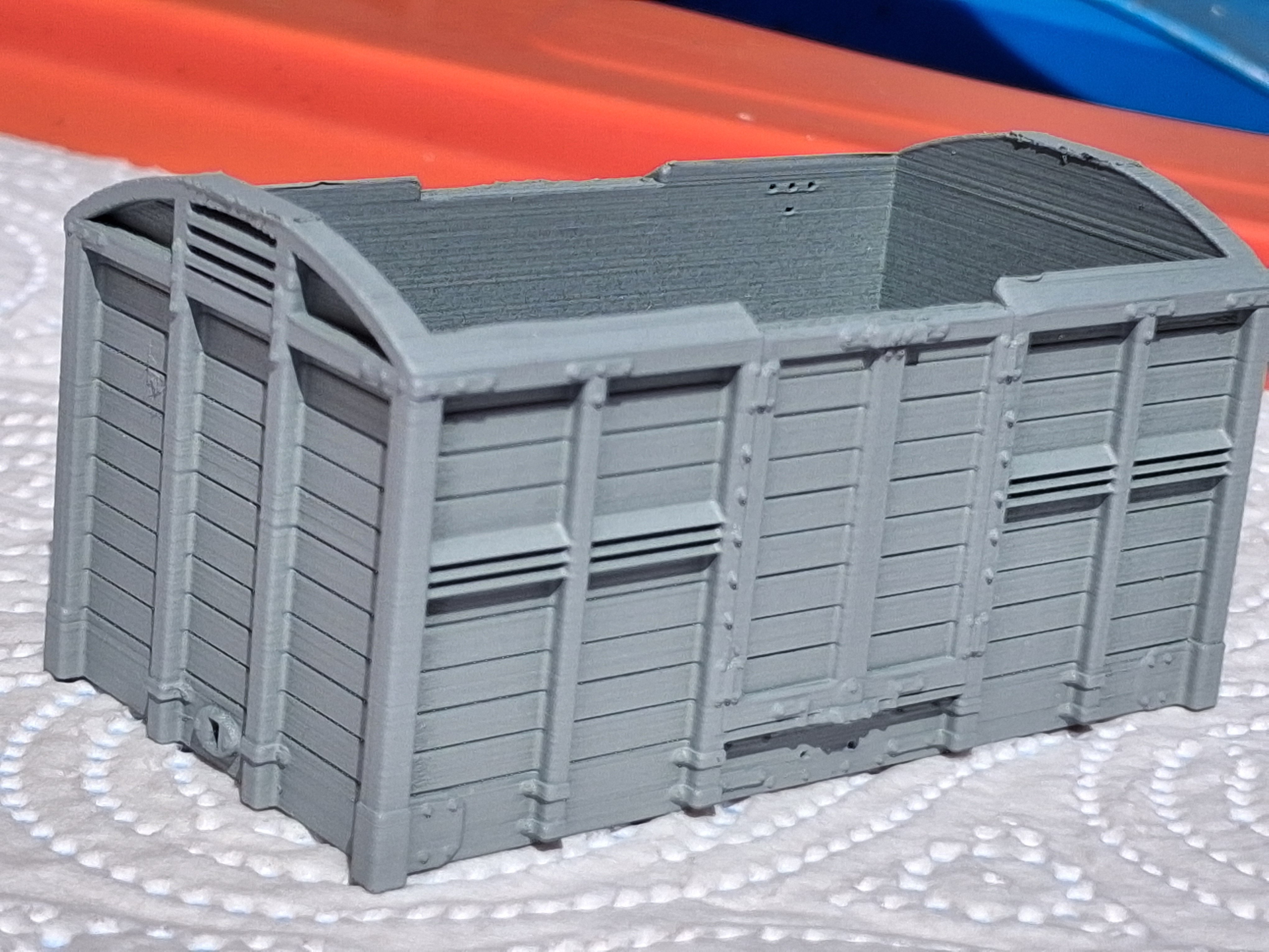

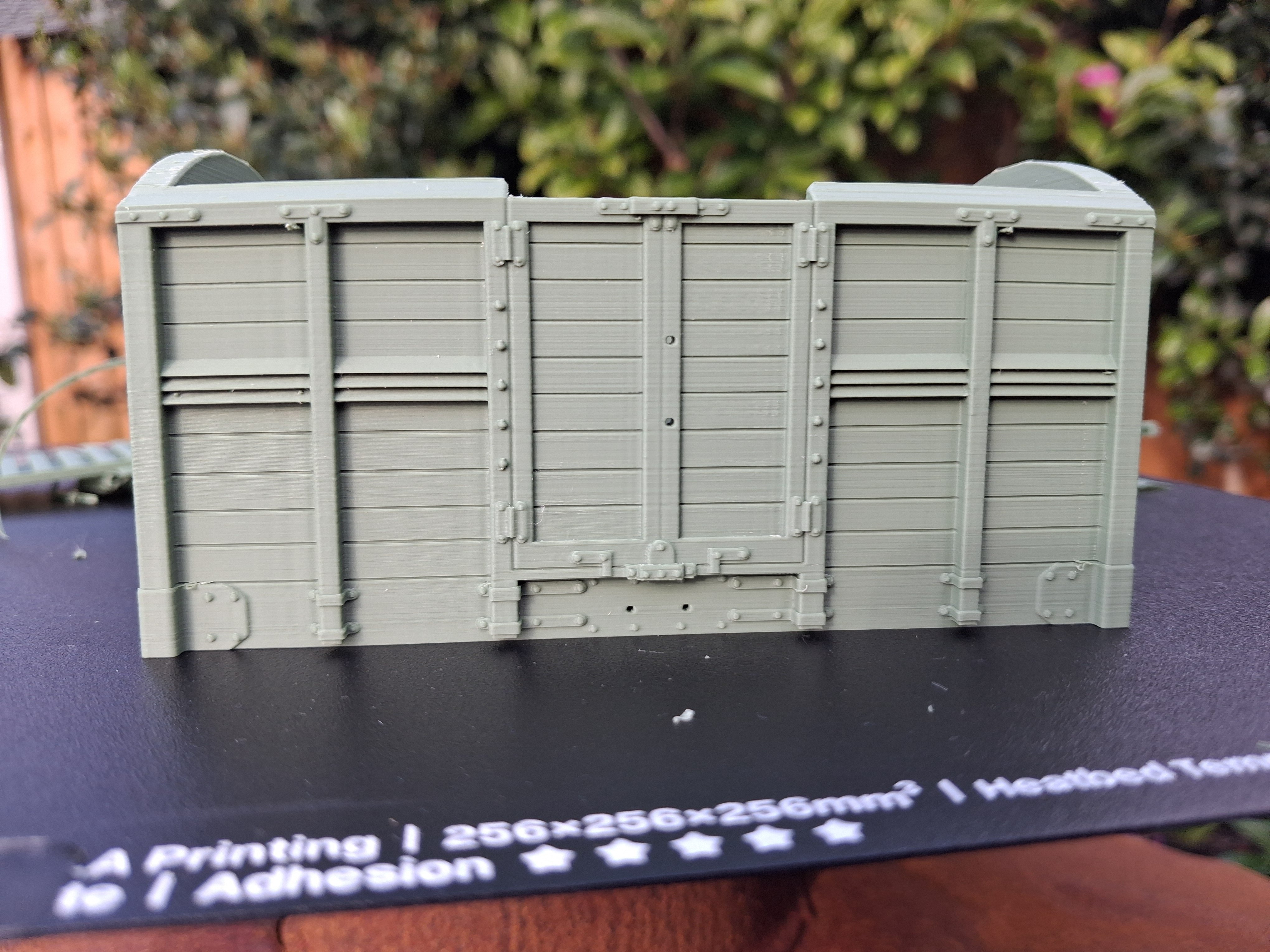

Because you have printed it flat, the layer lines on the horizontal planks don't look out of place - they could be wood grain.
If it were mine I'd lightly sand the outer faces of the vertical timber ribs to remove the layer lines where they run across the grain. Only a few minutes work, hopefully.
Beware, there are a million and one more variables to play with in FDM printing than resin - you still need a bigger bin.....

Unpainted,  you can't see the layer lines in the flesh.
Lets see what it looks like with a coat of paint.
Might print a 4mm one tomorrow.

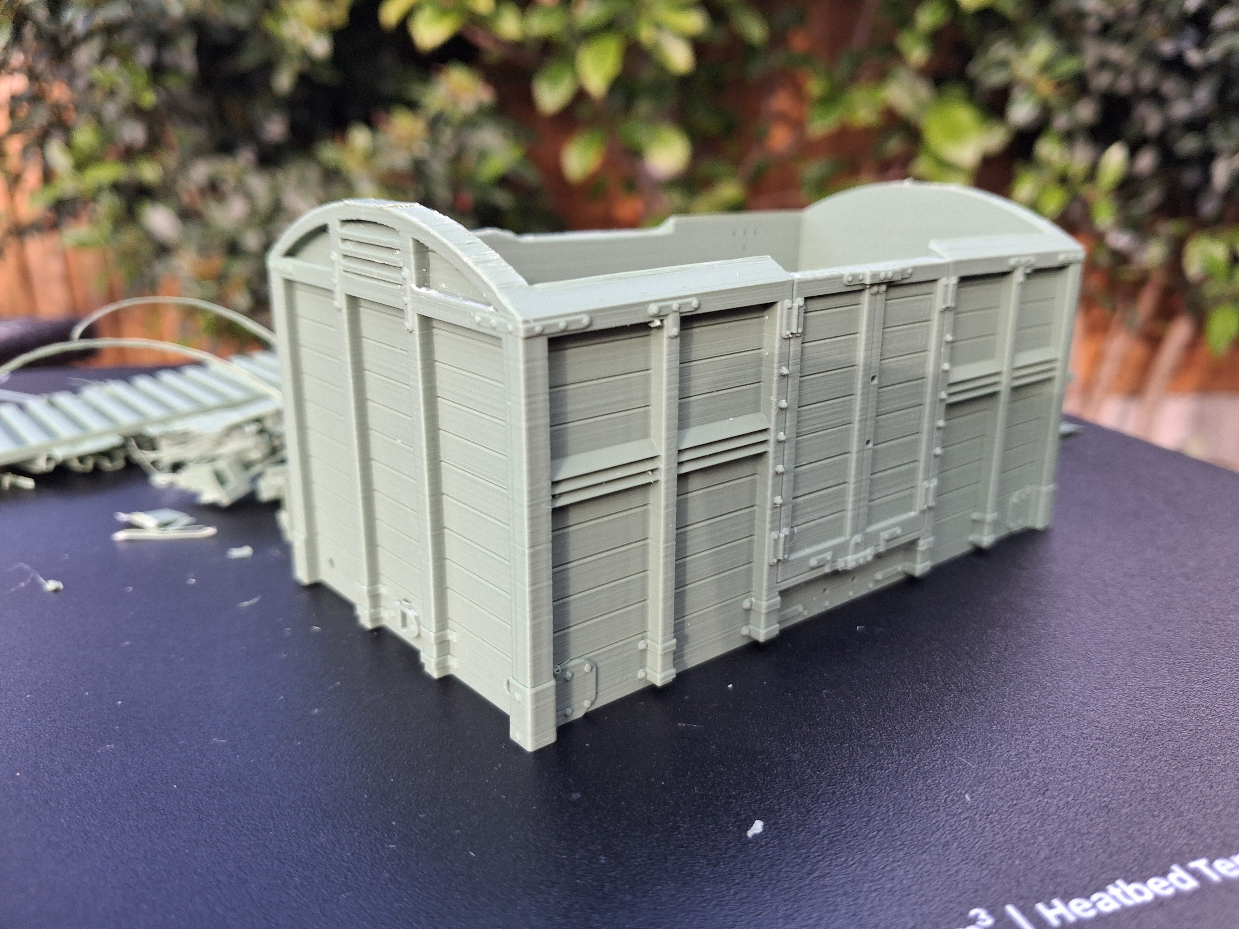

The layer lines give it a bit of a wood effect. But at some point the buffer holes vanished. I'll fix that in Github.

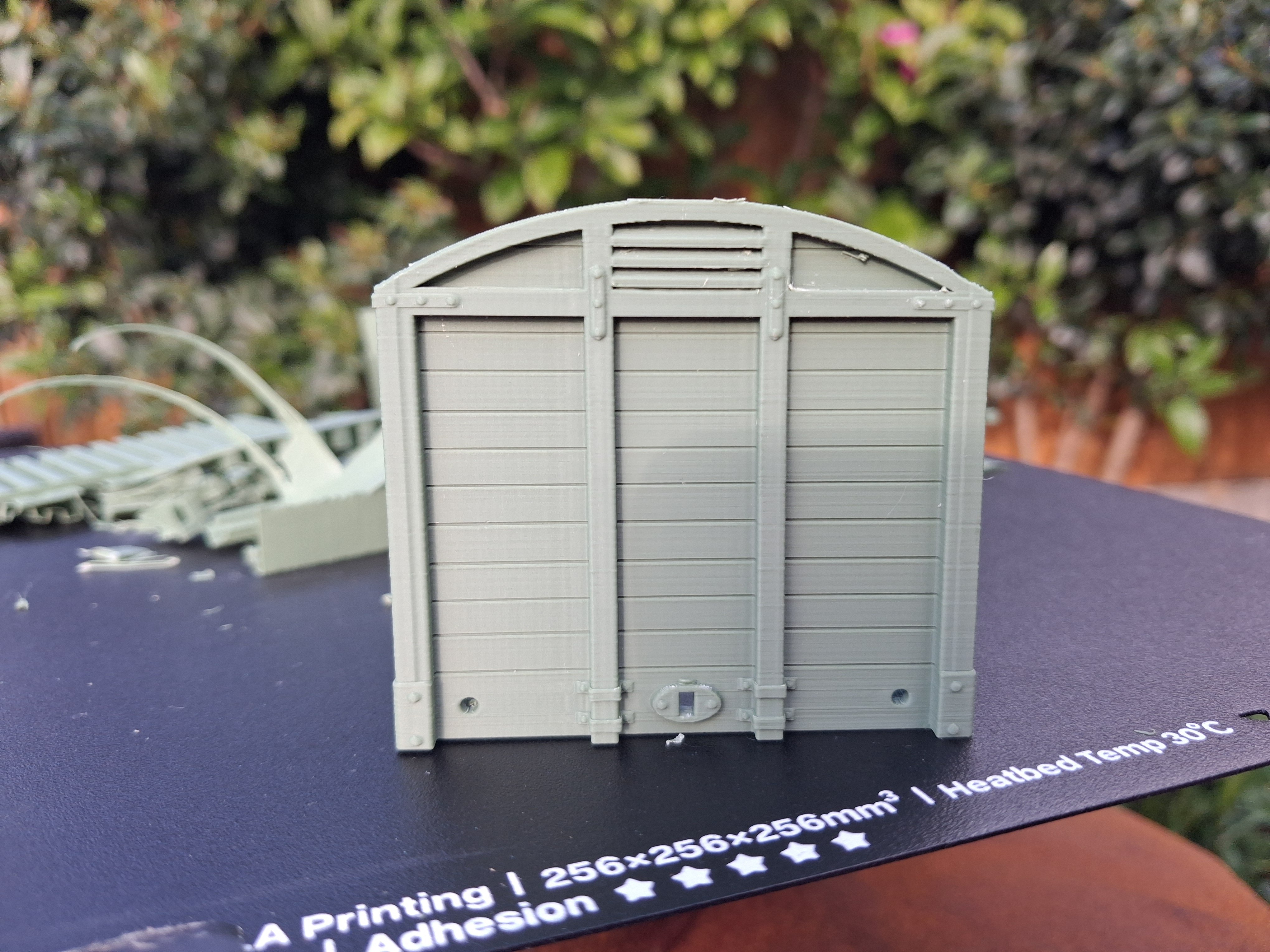

V0.3 with buffer holes now in Github.
Doh!
I didn't spot that!
Looks fantastic, so well done that man who did the artwork. However, as it seems with all 3D printing, the issue is time, so if we all want Rob to do a few, I suspect there might be a long wait.
 On the other hand, how much is a 3D printer and if the process of home printing is becoming a realistic proposition, are we about to cross a Rubicon in modelling where what we do in future is not buy kits to make models that are unlikely to be mass produced, but buy files to print them ourselves?
 The issue will then be how popular a model might be, because the more it is, the more a larger manufacturer might step on the toes of the file artist, leading to legal issues about rights of production.
 Nevertheless, when prints can look as good as this AND be readily adaptable to other scales, then exciting times are ahead.

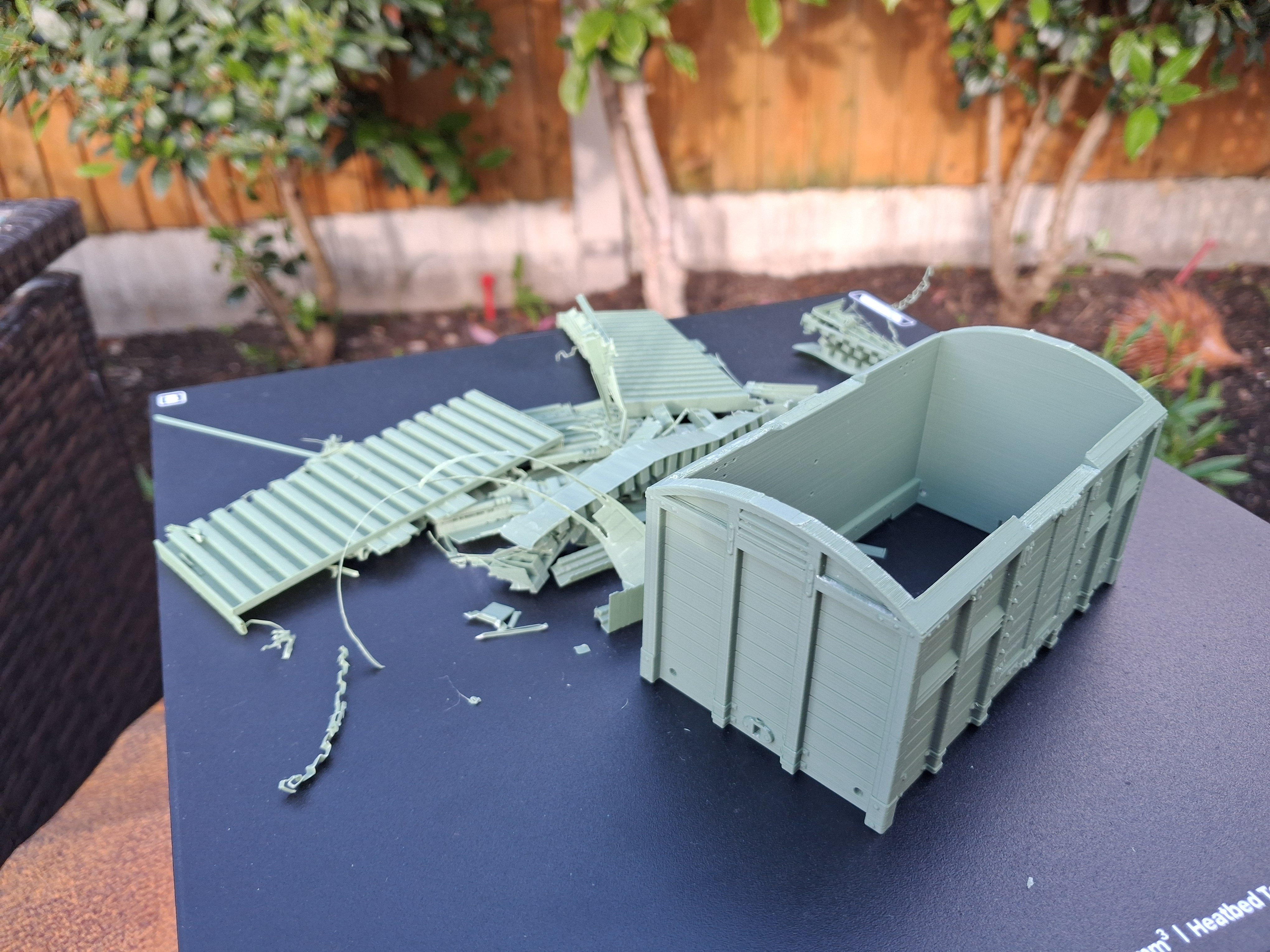

After a quick squirt of primer.

7 ton van on hold until the file gains some buffer holes.

For me, the faint print lines are a good representation of wood grain. As for the missing buffer holes, nothing a drill won't fix  - likewise door handles. Anyone who needs the buffer holes in place will like as not struggle with fitting a chassis, while spacing of said buffer holes might be an issue anyway: 16.5 or 21mm gauge/32 v 36.75 etc.
 In other words, nothing wrong with leaving a few bits for the kit builders to do!

4 pin holes could mark the 16.5 and 21mm buffers

After 12 hours you end up with a square lump.
and after removing the supports (a bit like shelling a prawn) we have a 7mm 7 ton van.
This was done at 0.08mm layer, anything finer would have taken far to long.
