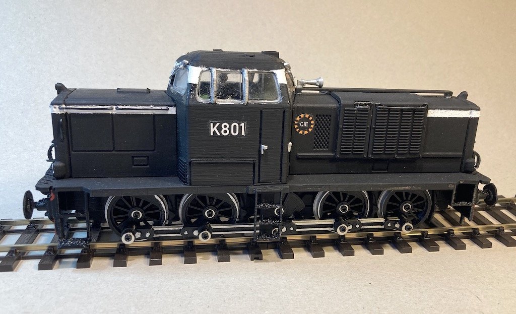

A modeller who largely pioneered 3D printing for model railway use in New Zealand has transmissions parts (gears and flywheels) and gear boxes 3D printed in aluminium from his own CAD work and I have had lost wax brass castings produced from my 3D CAD work (brass details castings JMD 52 Class /D17 (buffers, raised firebox step ring etc).
I was lucky/spoiled in that the Auckland 3D print shop that produced the prototypes for the JM Design CIE Goods Brake in 2020-1 produced consistent high quality prints in a suitable resin, down side was printing 'small scale models" was more bother than it was worth!
Eventually selected a Chinese print shop that consistently produced high quality prints using a similar resin,  after trialling print shops in New Zealand, Singapore and China main issue was original Auckland and current Chinese supplier used a suitable resin (stable and not too brittle!)
Protototype and production models printed with separate roof body and (rigid) chassis (detaiul added in production version) no sign of warping/distortion after 5 years.

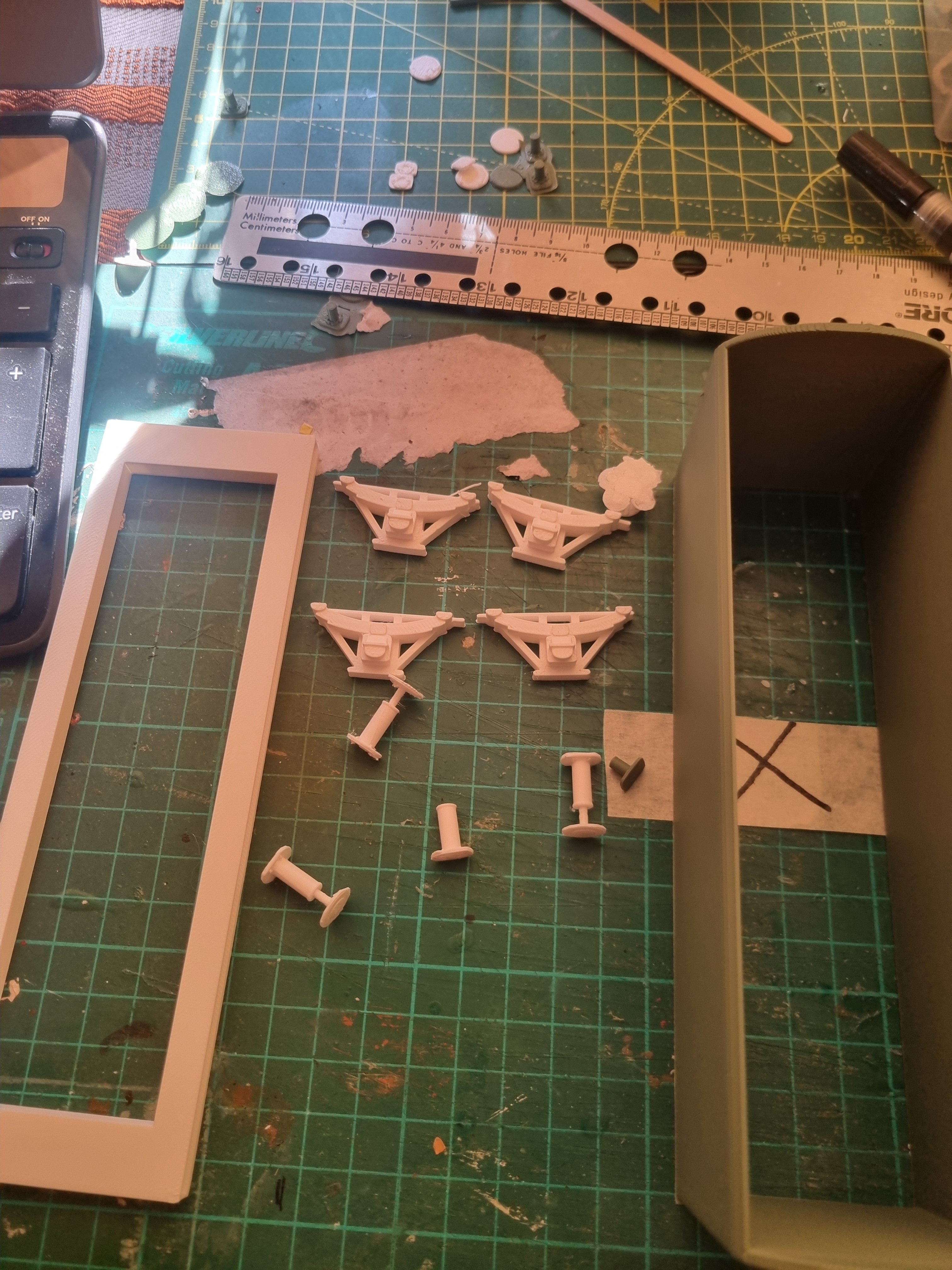

One piece Chinese printed wagon chassis. (this was a spare/reject on of the brake levers broke most likely during clean up stage)
Having had a few of @Mayner's kits through my hands, I can testify to the excellence of his Chinese "printer".

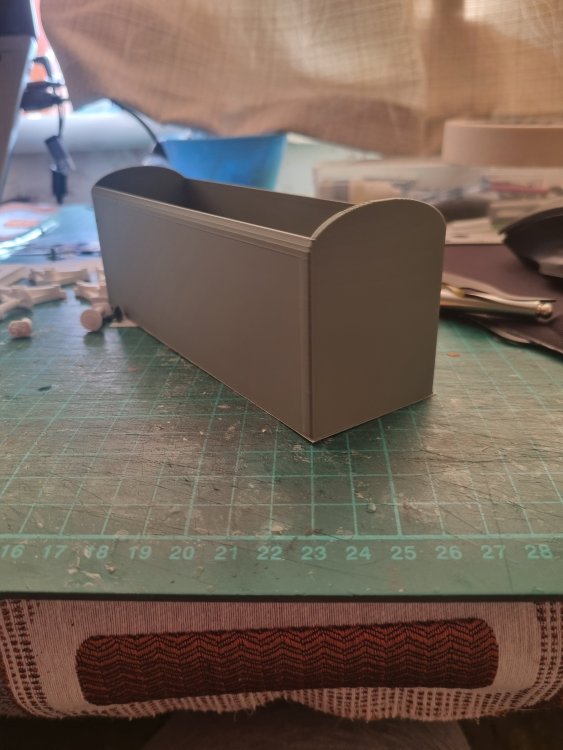

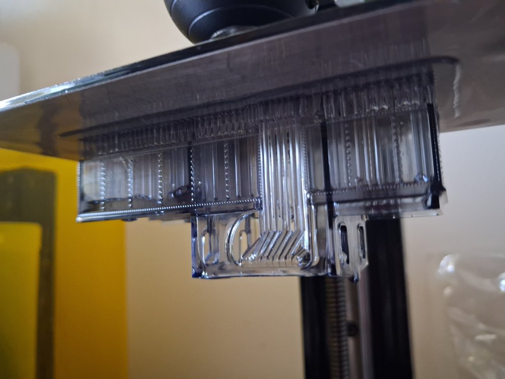

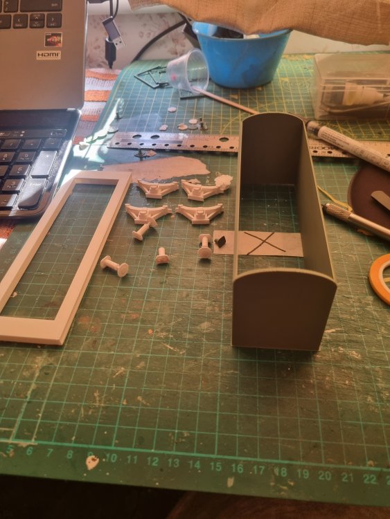

Not exactly achieved perfection so far. Suspended until I get a whole load more IPA and wife is out (she doesn't like the smell - of the resin, I mean). This was done with the Mono 4, standard resin and settings as Photon Workshop default (the biggest lump of loco body printed so far), then with thinner layers (0.03 v 0.05) and bigger support contact areas for the rest. It didn't seem to make much difference. In both cases I ended up with a lot of resin stuck to the FEP film.
One problem seems to be that the print eventually peels away from the build plate. Levelling? I wonder if tightening the levelling screws - necessarily done with one hand holding the plate down - is moving the plate slightly. Perhaps a spring in there somewhere would help. Some sites recommend slightly roughening the surface with fine emery paper. I've got a small sheet of glass somewhere to ensure it stays flat. Also I'll try PTFE spray on the FEP film to encourage it to let go.
Room temperature hovers around 20 at the moment (this is the cool side of the house) but it won't stay that way, and I can't wait for a heatwave every couple of year. It was probably about the same yesterday when I did the prints.
The detail achieved isn't phenomenal - the rivet detail on the tank scarcely shows up against the build striations and the ironwork on the van is missing in places. On the upside, the strength of the product is alright. Throwing it across the room didn't break it.
Hmm....
I don't know your machine but for the van I would increase the initial layer exposure time, making sure the build plate is extra clean.
My build plate is quite rough (but level) now after 3 years or so of use. You can also tweak the retraction speeds and acceleration, slow them down a bit.
For the loco, try putting it at an angle (front at about 25 degrees up for starters). The photo doesn't show the layering 'cos it's a bit dark but a vertical face like the tank sides shouldn't really show any layering at all.
Are they medium supports on the loco?
If they are try adding some heavy supports to keep it in place.
I have not tried using a ptfe spray so I can offer no help there.
I am also (usually) using a Transclucent water washable resin which is runnier than the grey stuff and not far off the 16k resin which is almost like water, to me the various standard grey resins all seem a bit gloopy.
I suspect the "grey" is just an inert filler - slate dust?
Keep plodding on.
Try printing some of the standard Test Pieces to fine tune the settings a bit, small changes can make a big difference.

Don't rely on the "auto generated "supports being right.
For the world of fantasy miniatures they work great.
For model railways, full of straight lines, right angles and smooth flat surfaces they are a starting guide at best.

About supports: I'm pretty sure Photon Workshop uses AI to create the supports. For a start, it supports things like individual rivets, but nothing like consistently, , and it doesn't do it on both sides of a mirrored design. It puts in little support branches that, like the Leek and Manifold, start nowhere and end at t'same place. But I haven't a clue yet where to put them manually, so I've got to start somewhere. I might try a downgrade to Photon Workshop- it's possible the latest release is a bit experimental.
As for accelerations etc, I haven't found them in any setup yet.
Don't worry about the vertical lines, I suspect they will vanish under the first coat of paint.

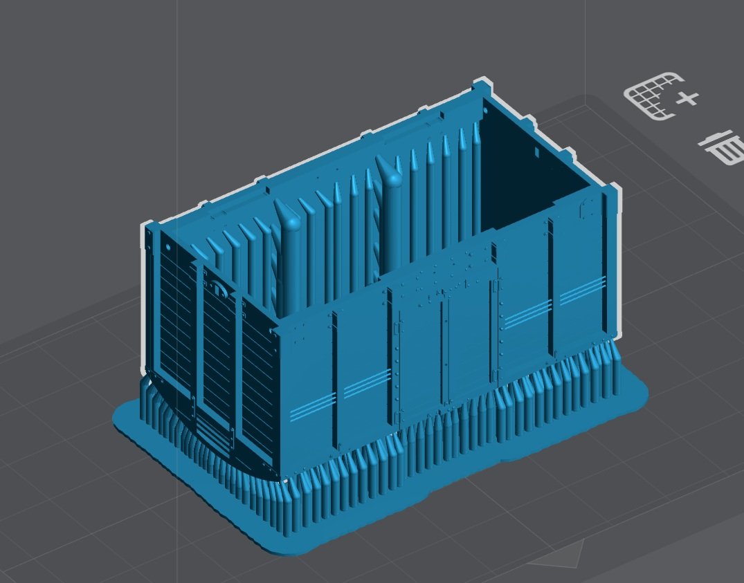

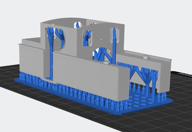

Supports.
Think of resin printing more akin to growing crystals (copper sulphate in O level chemistry?).
You need somewhere to start growing it from but that some where has to be strong enough to resist all the peeling and suction forces.
I usually use a good curtain of medium supports, sometimes with the odd heavy or 2 to beef it up and light supports for the delicate details, bridges etc.
As you can see, things the size of rivets are not supported.
There are some really good youtubes on supports, explaining it much better that I can and from first principles. Have a browse.
R
ps.The file in the screenshot 119% bigger than yours....

Lift and retract speeds are the beasties. Usually found in the Resin set up page of your chosen slicer. Also not all slicers are equal.
The slower they are, the lower the forces on the print. Downside is increase print time. A fine balance.

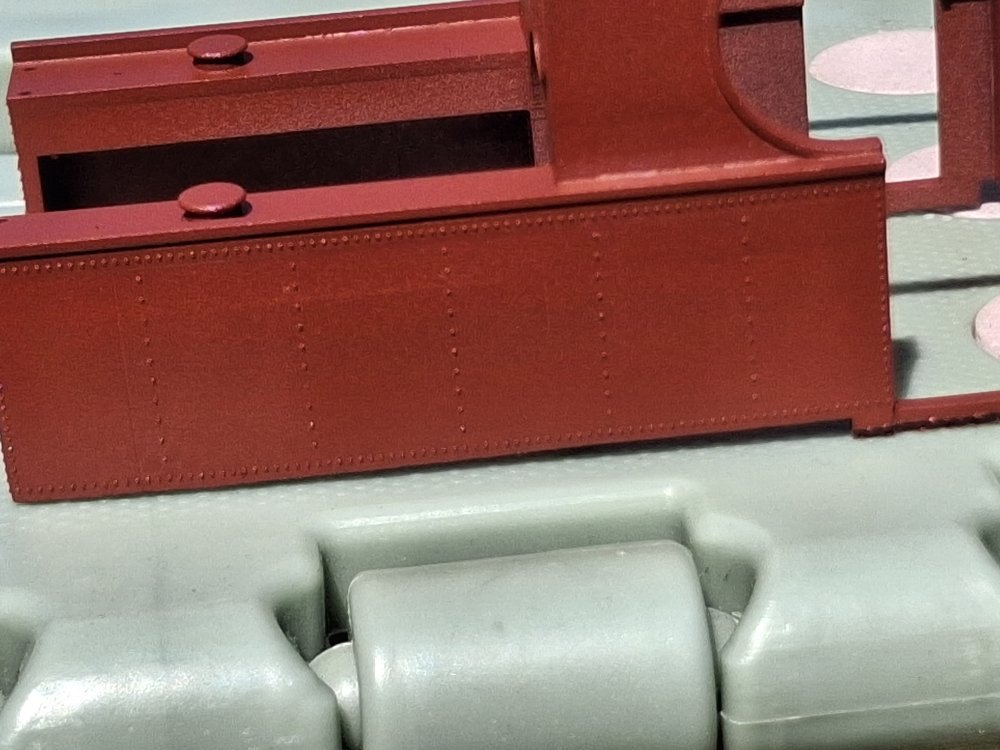

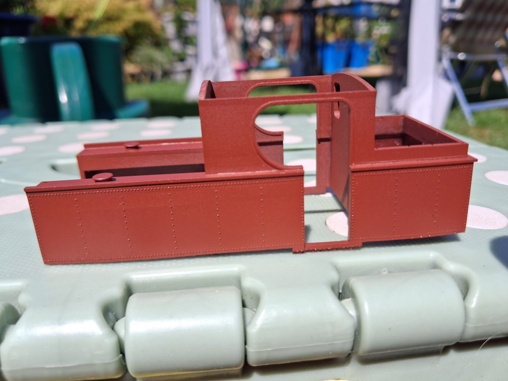

A quick squirt of primer.
There is a crease in both sides where the cross sectional area changes at the start of the tank inner. Printing at an angle should sort that but may introduce other issues.
The rivets are superb.
Thank you Maitland
Edited by Rob R
  • Like 6
At least I know what I'm aiming for. I'll thicken that whole side up. Sacrifices some of where I thought electronics might go though.
Don't thicken it.
Put a chamfer on the bottom of the inner tank (inside the tank) so there isn't a sudden change in CSA.

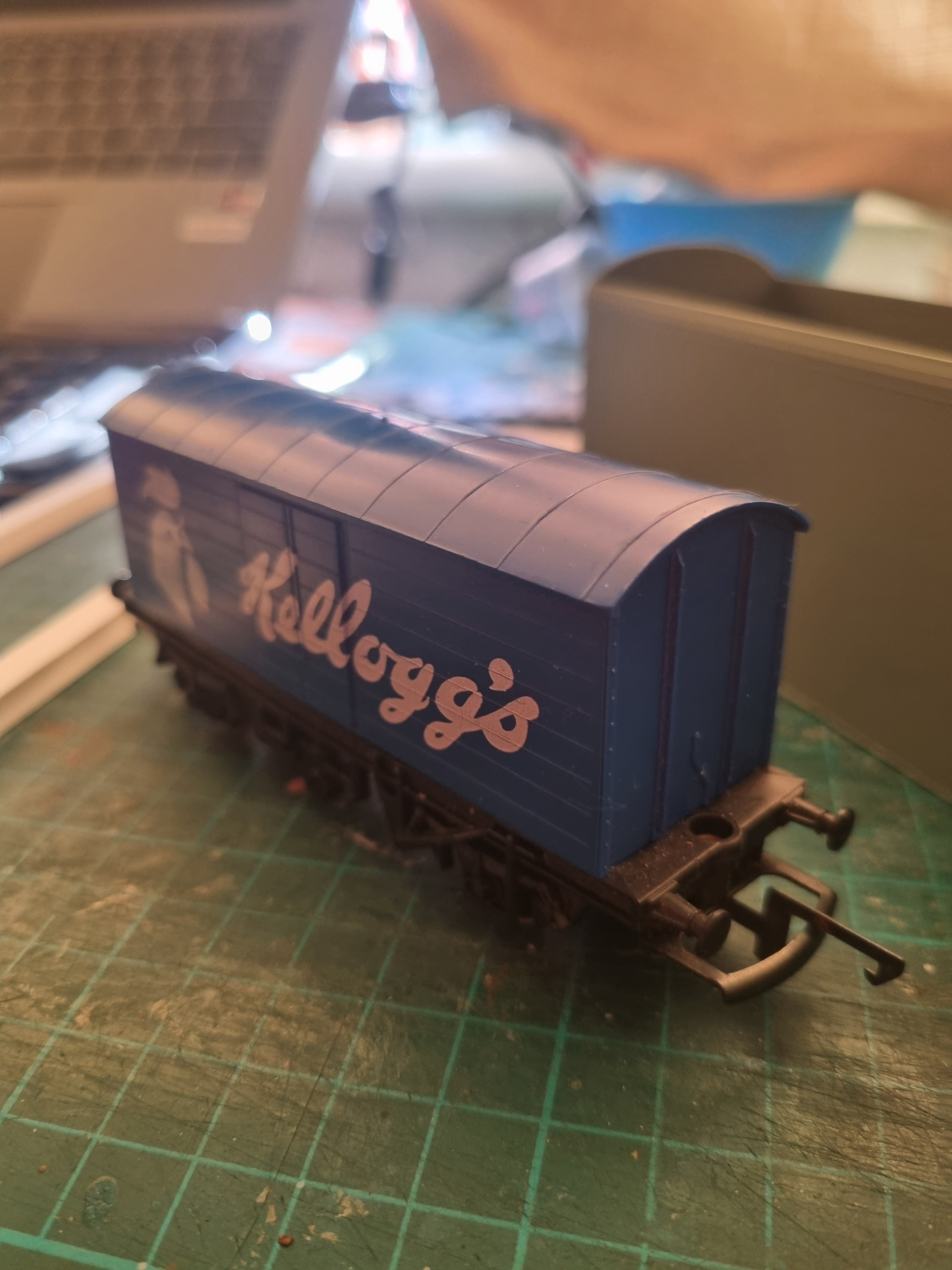

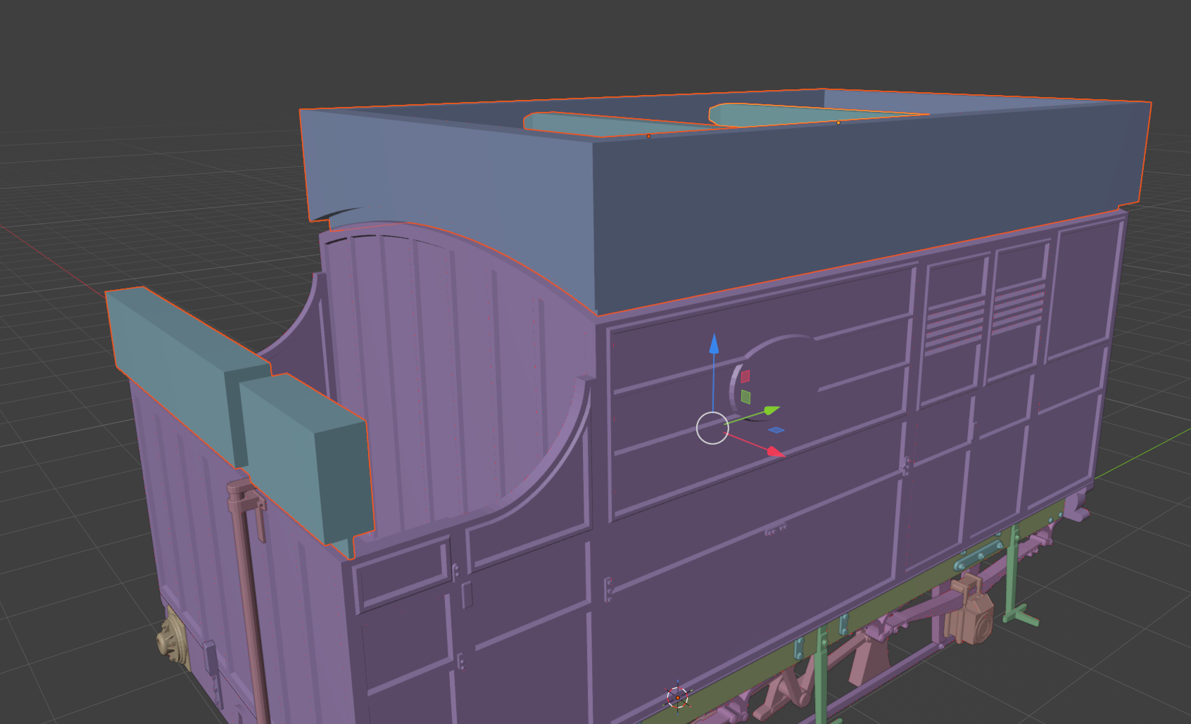

I'm trying to replicate a 70s hornby wagon for 0 gauge.cant get the roof right at all.has anyone any suggestions?
Dont print it, Use a cut open Beer Can for material instead.

Looks to me like the Hornby van has a single radius arc, but your van seems to have a multi- centre or elliptical end.

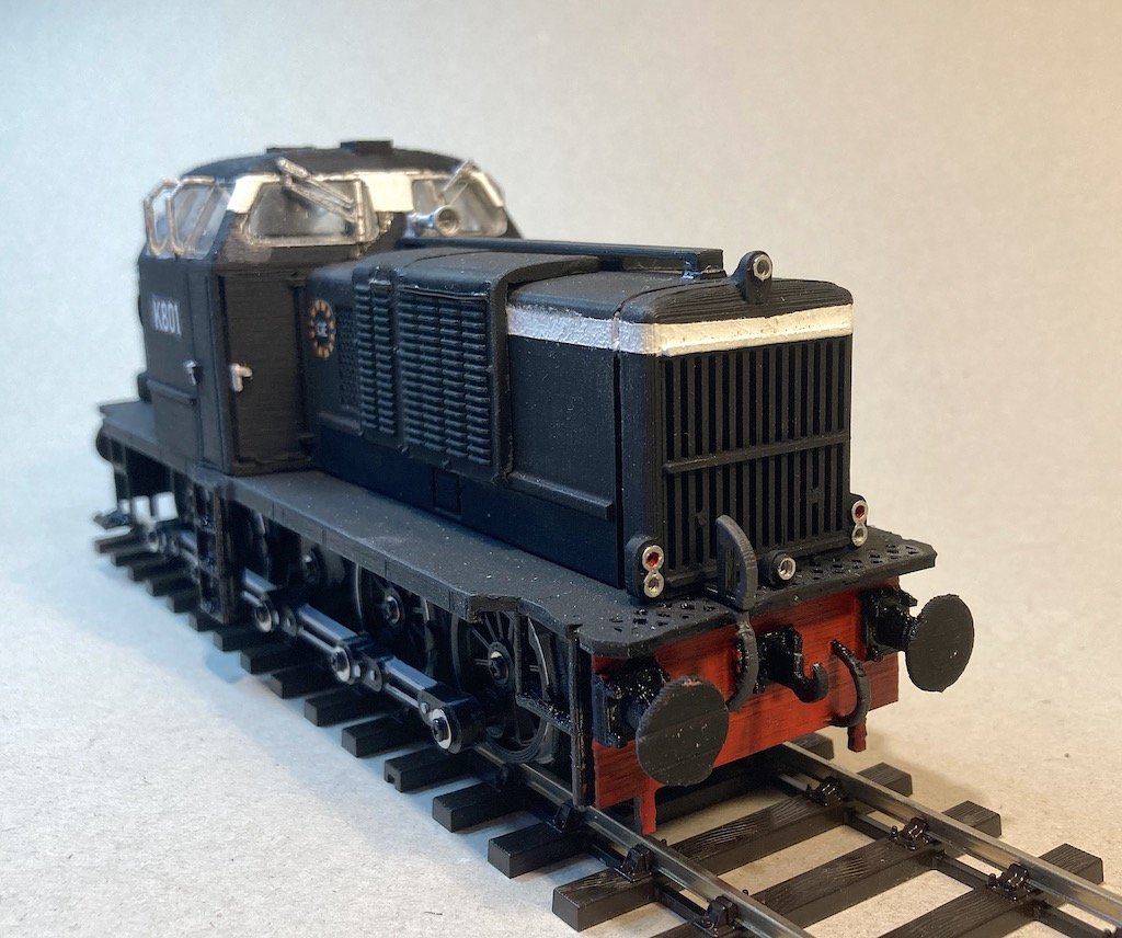

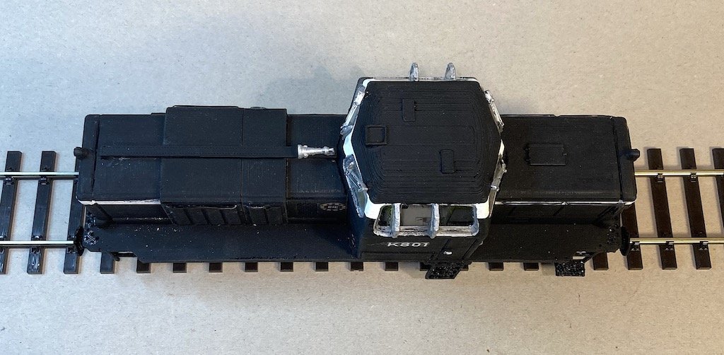

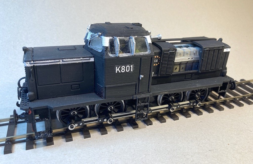

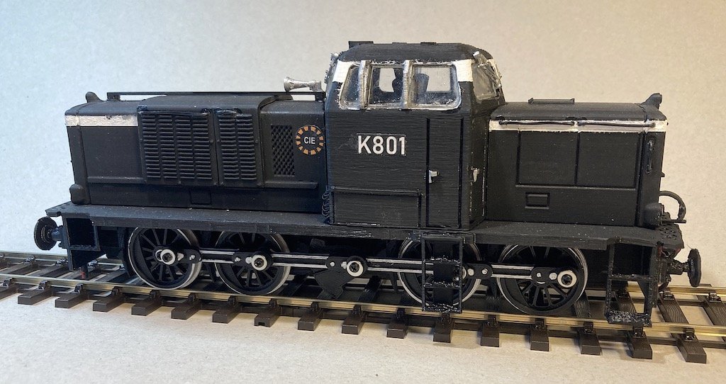

a friend of mine is a gifted 3D designer of technical components, and he’s a railway enthusiast specialising in O gauge. He loves creating exotic series of diesel locomotives in 7mm.
Johannis currently lives in Finland, but speaks fluent English. One of his most recent designs was the German MAK 800 D, a four-axle diesel-hydraulic shunting locomotive. He has produced various national variants in O gauge, so it was only natural to create the CIE K801 in 1:43,5 as well.
It is a non-motorised but rollable model produced in 3D using a filament printer.
As a special feature, he has included a driver’s cab interior and a posable cover with a replica of the diesel engine.
He does the colouring himself using the simplest of methods; there’s still plenty of scope to improve on it.
The model is 237 mm long over buffer. Gauge is 32 mm.
He posts about his activities in the English-language section of the German Spur Null Forum. You can also contact him there if you have any further questions. Johannis uses the name ‘Globalzero’ there.

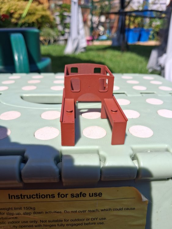

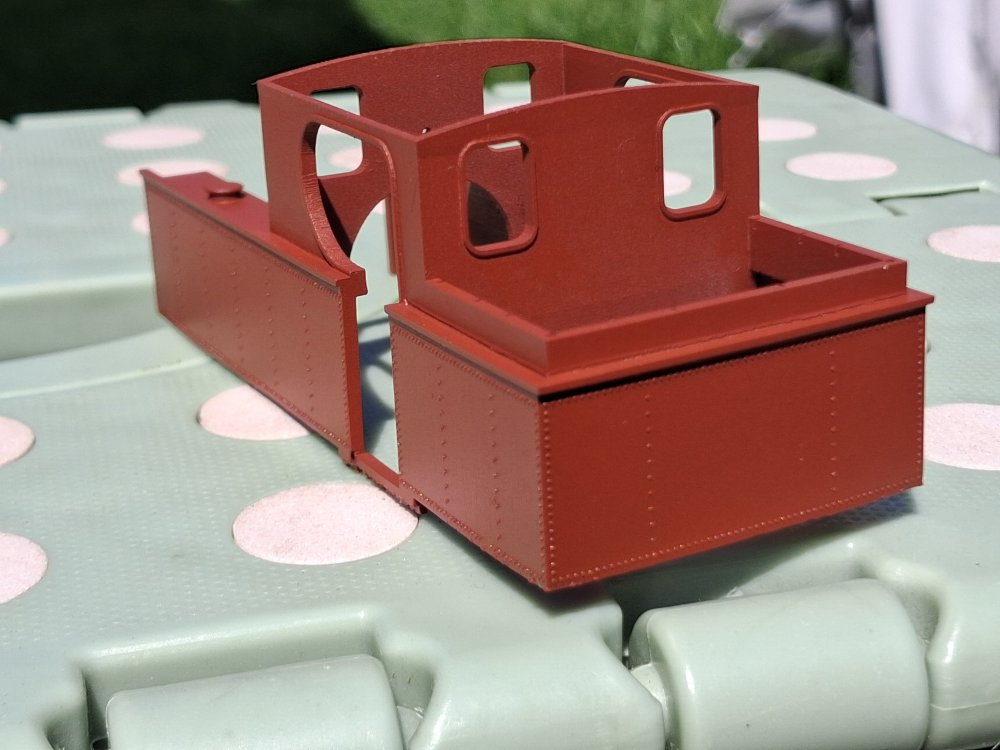

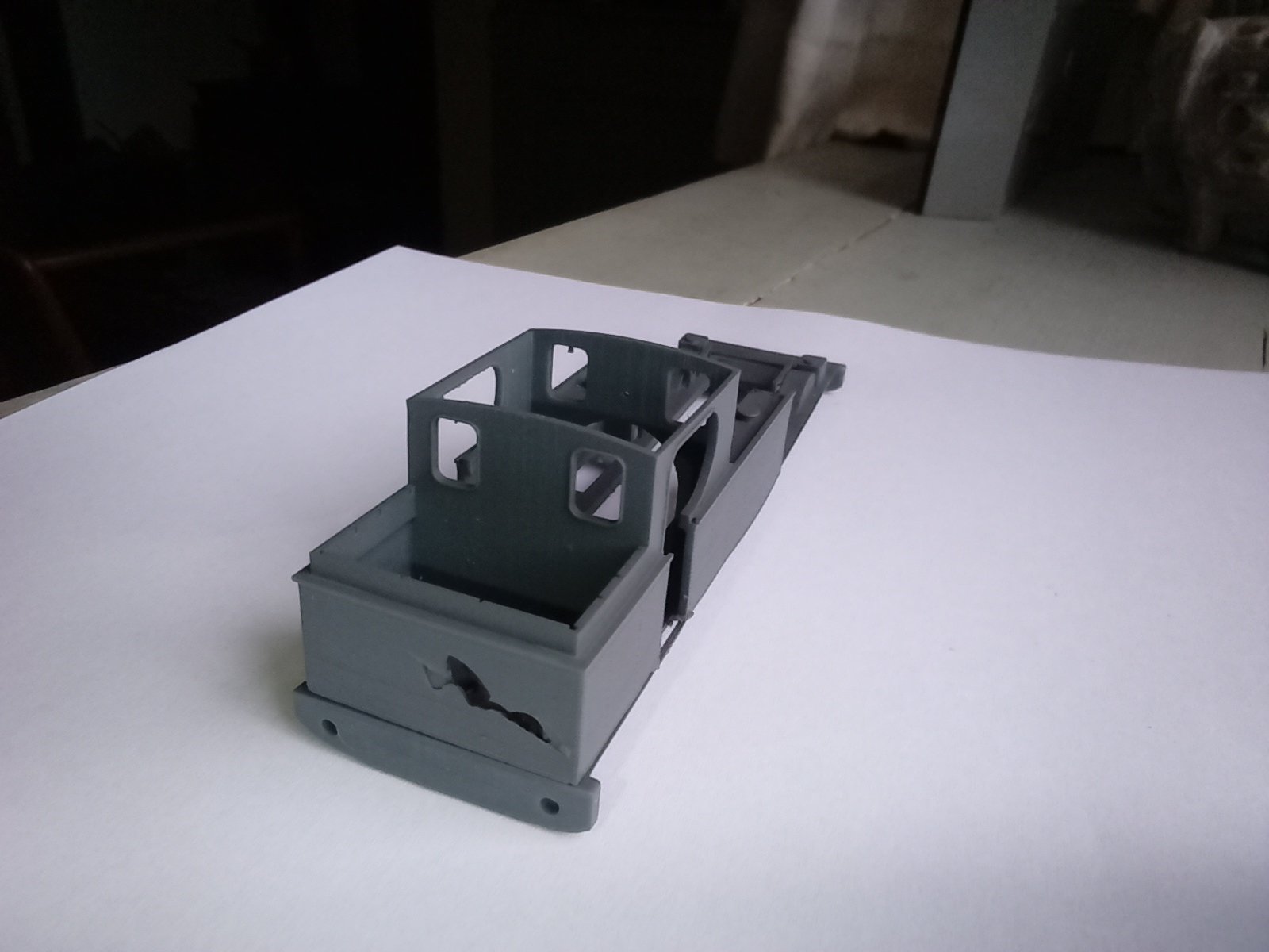

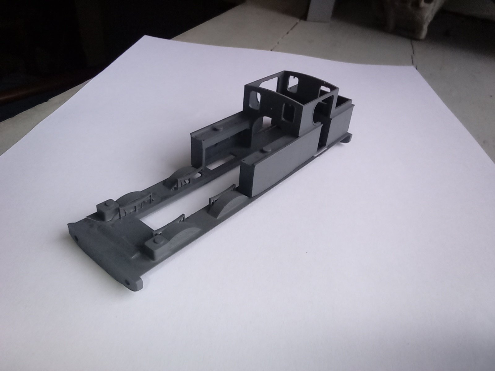

Close, but no cigar...
Apart from the hole in the bunker back, which is my fault (I dropped it while releasing it from the build plate) the faults are:
  •  the flaws in one side of the tank - it curves slightly at the front corner.
  • The location tab under the cab door failed to print on one side
  • the buffer beams have that "interesting" curvature on the bottom edge - it's supposed to be straight.
  • The deck isn't rigid enough - it droops.
The location tab serves the secondary purpose of making the cab itself a bit more rigid instead of depending on the thin connection over the door, so I'll make it into a flat plate recessed into the floor.

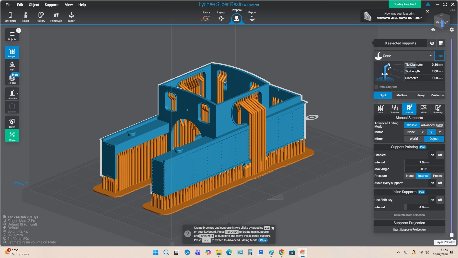

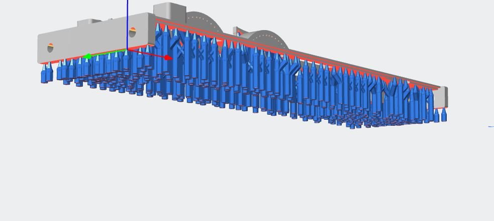

I used automatically generated supports from Photon Workshop, don't understand enough to do my own yet! Some obviously silly supports were edited out. The supports inside the tanks and those inside the splashers were a right b*** to get out.
Per ordure ad astra..
For drooping like that I've found it helpful to add sacrificial strip supports to objects, as below. I generally go for 0.25mm thickness at the connection point, with the main strip 2-2.5mm thick. This provides enough strength to hold the part to the strip, while being easy enough to score and break off with a scalpel without damaging the model. I also print on an angle, and this has the benefit of countering just about any angle-based twist in the model before it reaches the actual model, which is the reason for the depth of them; for a flat-to-build-plate design it may not need so much height. All my designs are printed as one piece body+chassis with separate roofs, with the bodies printed roof-to-build-plate.
Not an Irish model (still working on my first, but this one is for 21mm BG) but this is how I've done the arrangement on one of my models. I then put all the primary supports onto the support strip - minimising slicer-based supports on the actual model, except where absolutely necessary, as this reduces clean-up. I expect a support similar to the one furthest to the left in this screenshot would do the trick to keep your buffer beams nice and straight.
