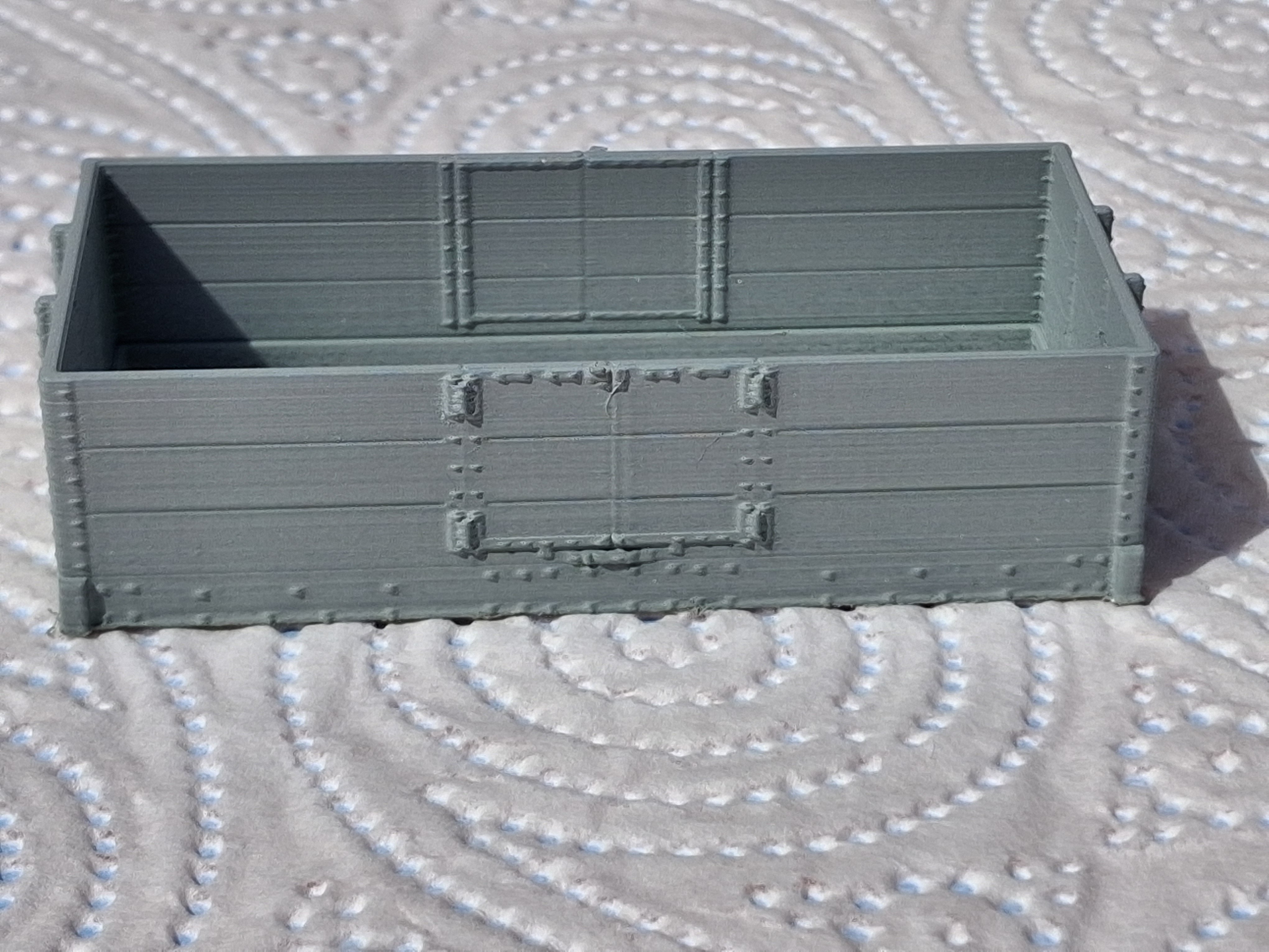

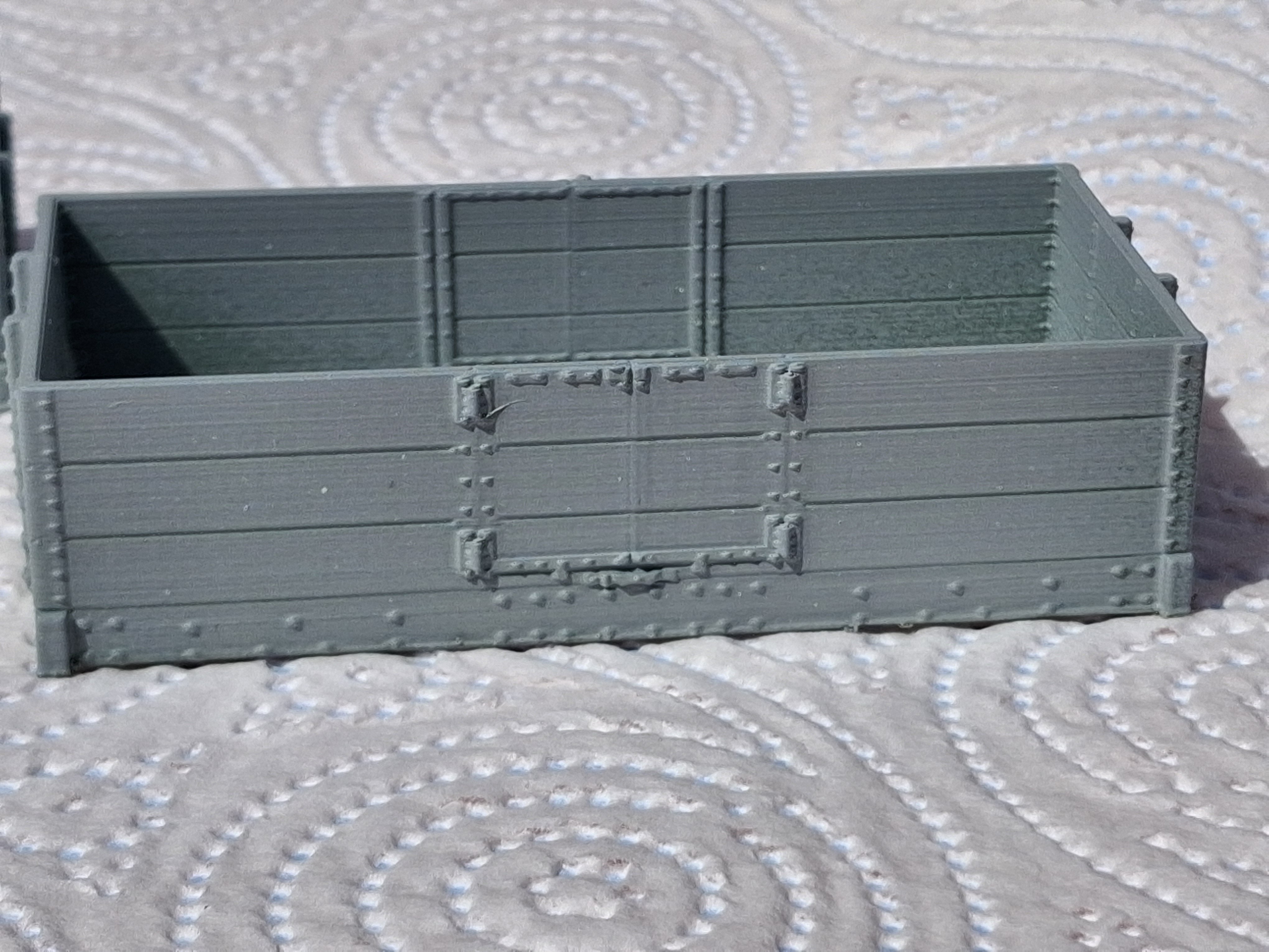

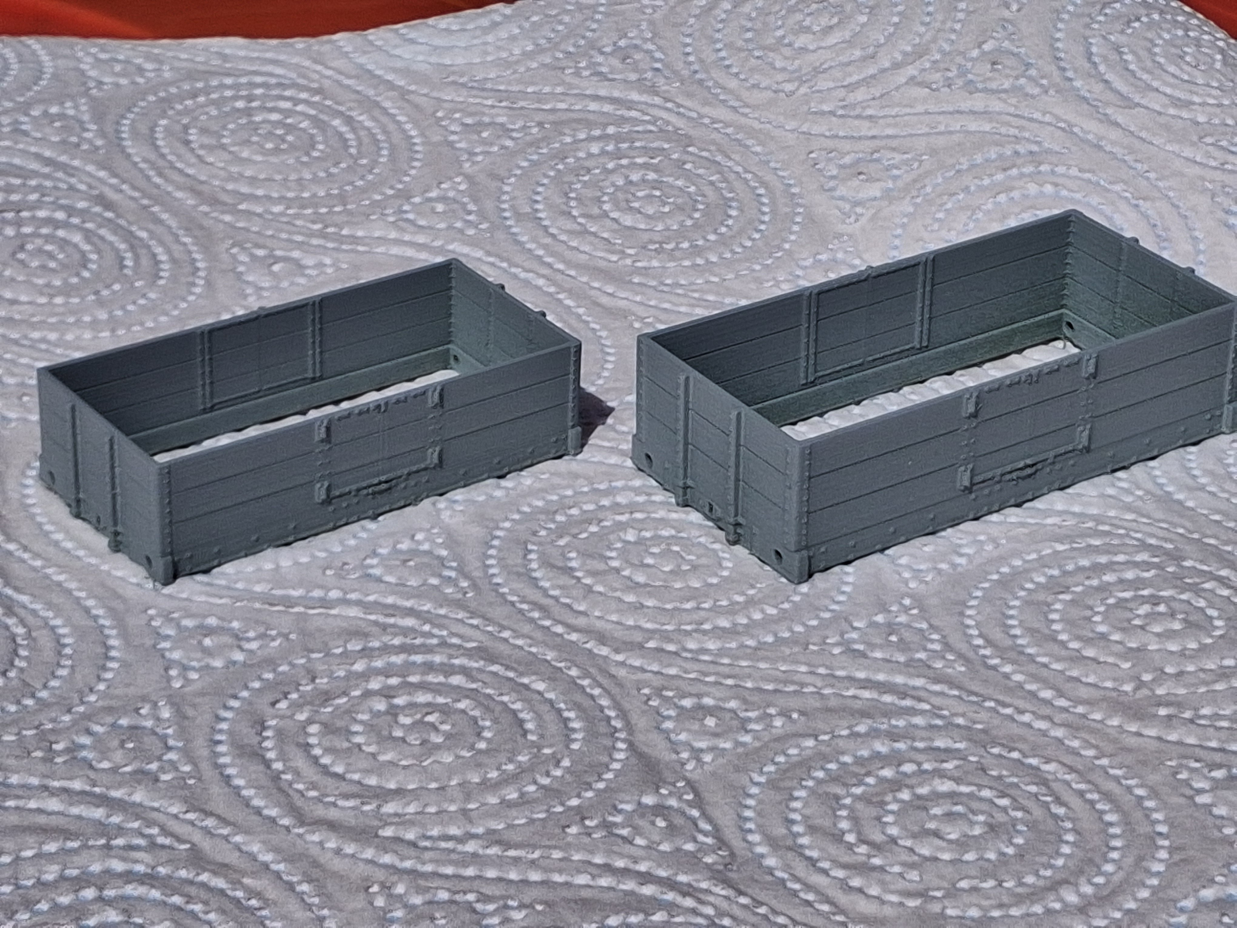

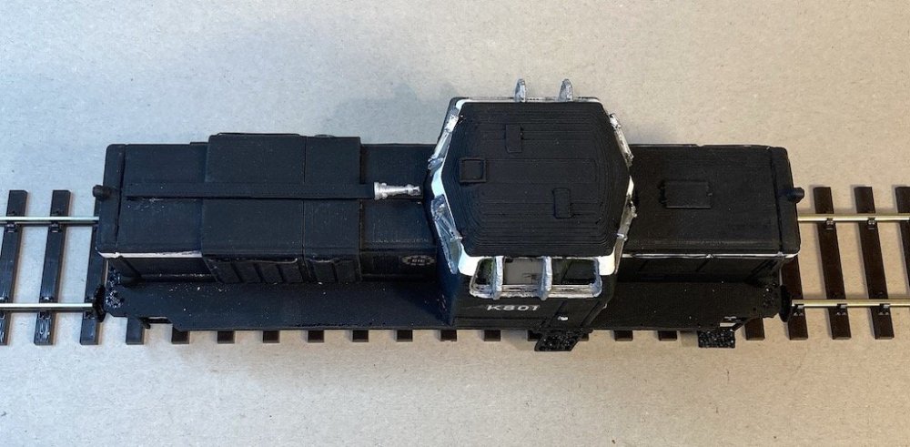

First off, with the 7 ton MGWR update elsewhere, a couple of photos of the latest FDM printed MGWR open wagon.
4mm and S scale.
A bit more work needed yet but we are not too far off.
20260514_112146.thumb.jpg.3f94cef02328e135850d54b7084da644.jpg20260514_112156.thumb.jpg.5bed0893e63ddda89c94919f84f03612.jpg20260514_112204.thumb.jpg.ca62baddd9d84c9c0a5567e07053bf6c.jpg
Edited by Rob R
  • Like 10

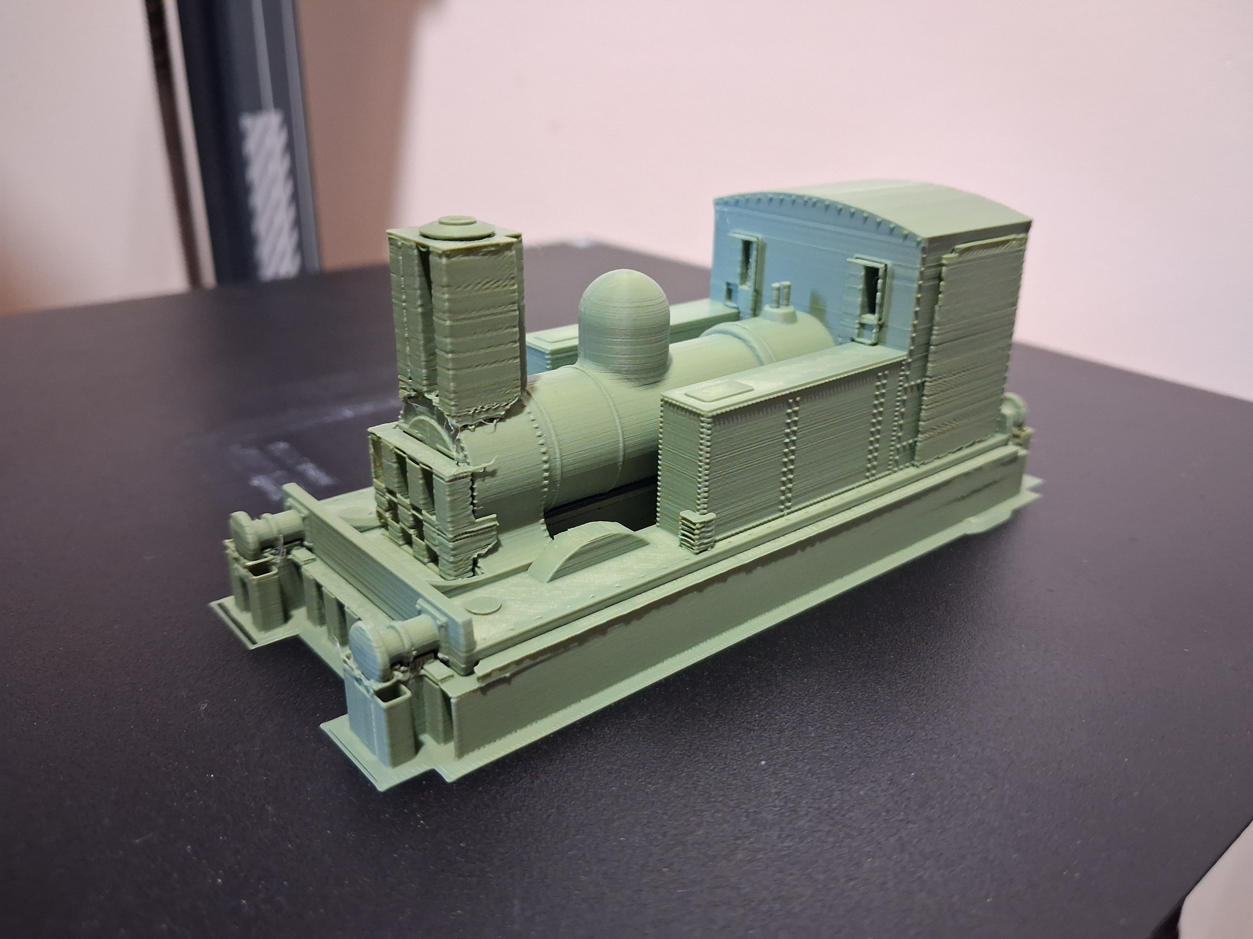

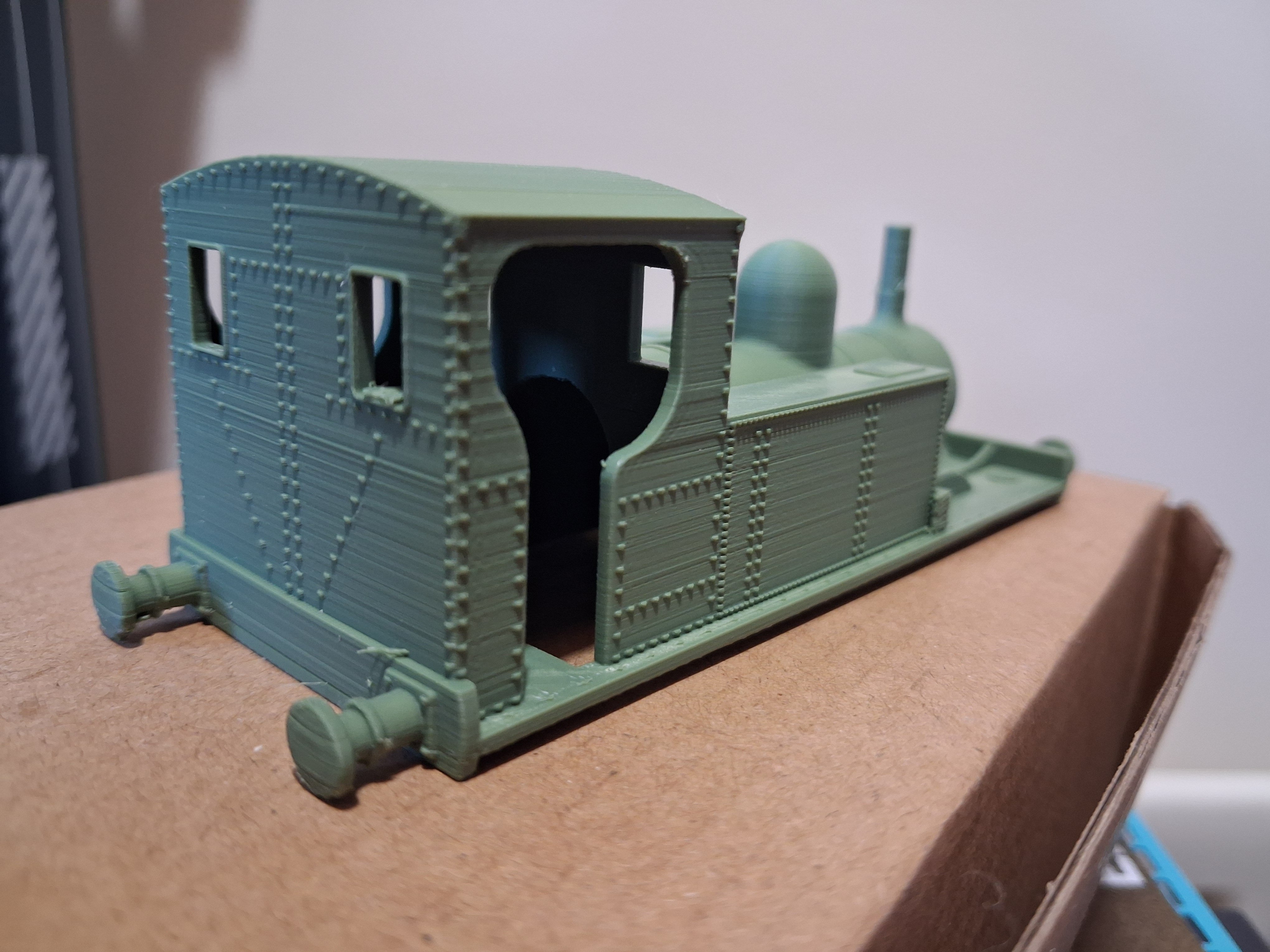

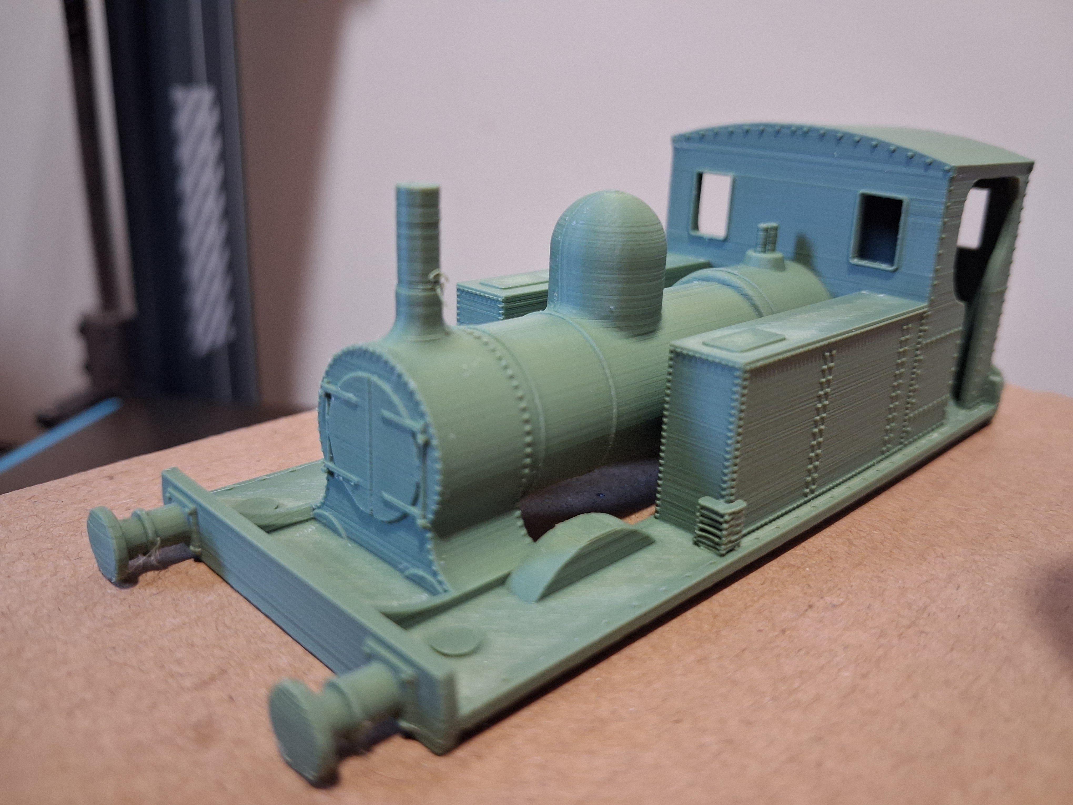

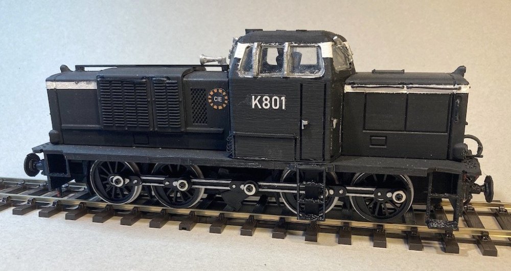

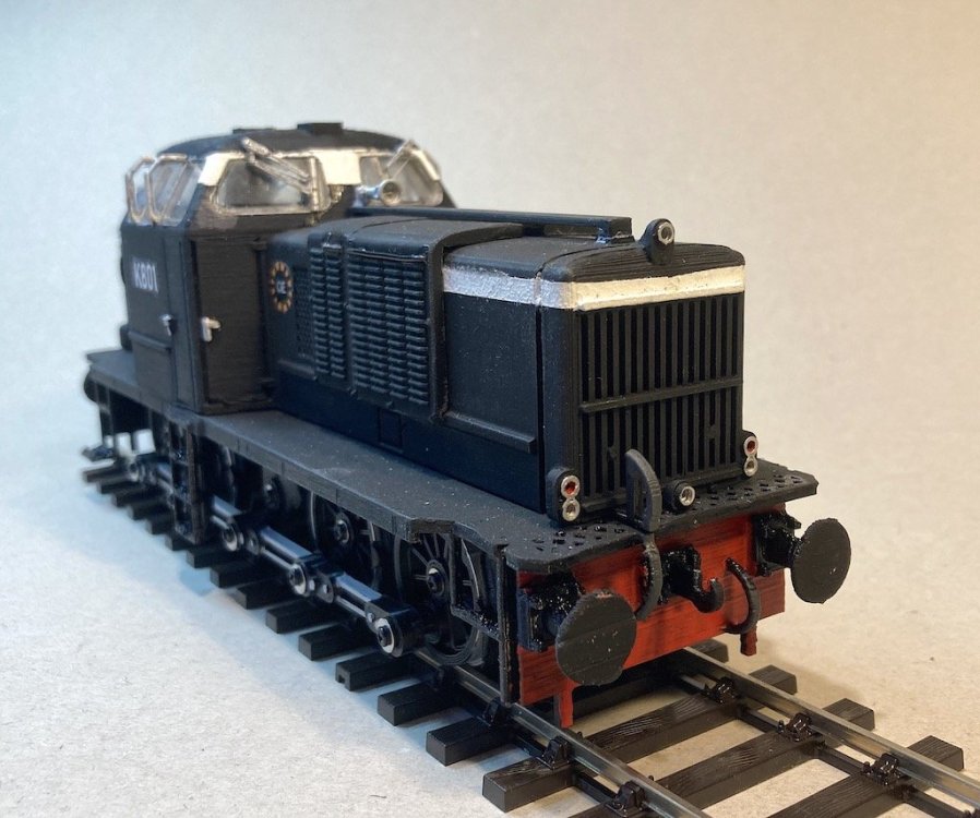

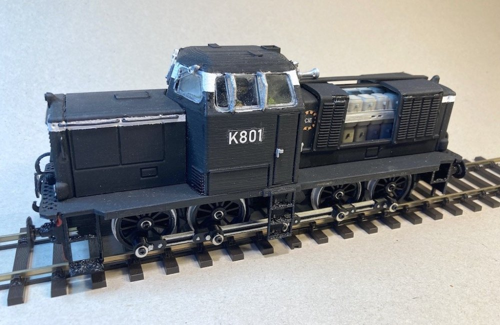

Got bored playing with wagons
From a Recreation 21 file to be found on Cults 3d.
It's not the best but useful as a test to see what can, and cannot, be done.
8 and a half hours later.
The eagle eyed amongst you wiĺl have noted that I broke the chimney and the cab steps while getting the supports off.
No great loss as they were going anyway along with the splashers - far too close together.
Ok for a first attempt, might have another go at 0.4 layer height but this was just a "quick" test because I really wanted one of the railmotor versions. Probably heading for 15 hours with the smaller layer height.
Not sure what is going on with the cab side and end either. More playing needed.
Good fun.
Edited by Rob R
  • Like 6
I'm still astounded by the fact that people try to print everything in 1. Yes I know it can but,
Don't bother with the cab roof, A cut up Coke can still works, It's thinner and no layering detail.
Think of a kit , The Cab Sides and Back and the Tank Side's would all be better if each part was printed Horizontally. (Other than Rivet detail its all 1 layer) So nothing to smooth.
Also if it's in bits it is easier to paint.
  • Agree 2
I know, but that is how the file came and it is too big to stick into my usual cad program to chop it up.
Was only playing to test the limits of the machine anyway.
Would also really need to print things in PETG 'cos you can stick that with MEK.
Edited by Rob R
  • Informative 2

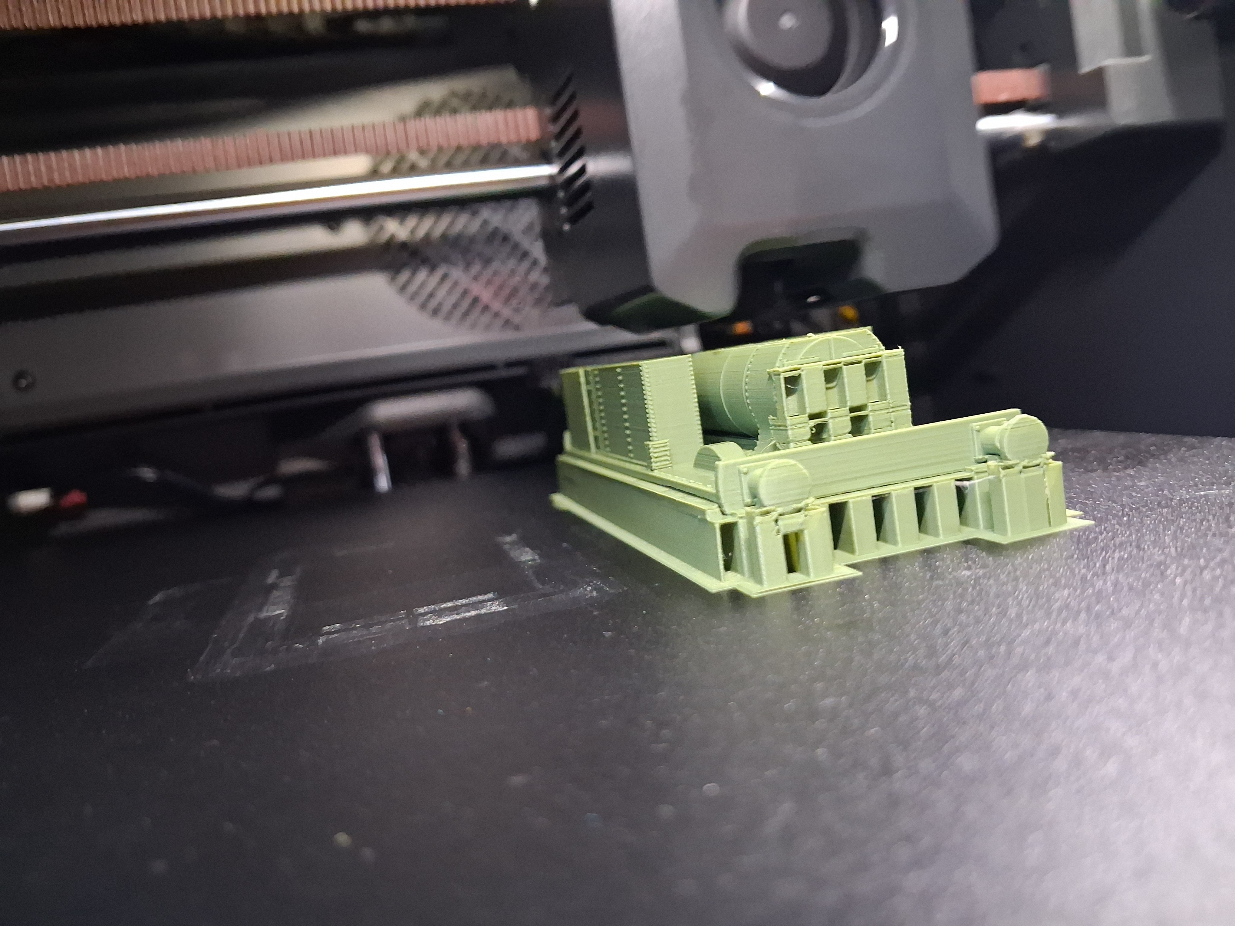

I should be printing stuff for the SSMRS stand at Railex but I have been distracted again.
Broken window pillar was ham fisted me getting the supports of.
Never mind, it was only a quick trial print.

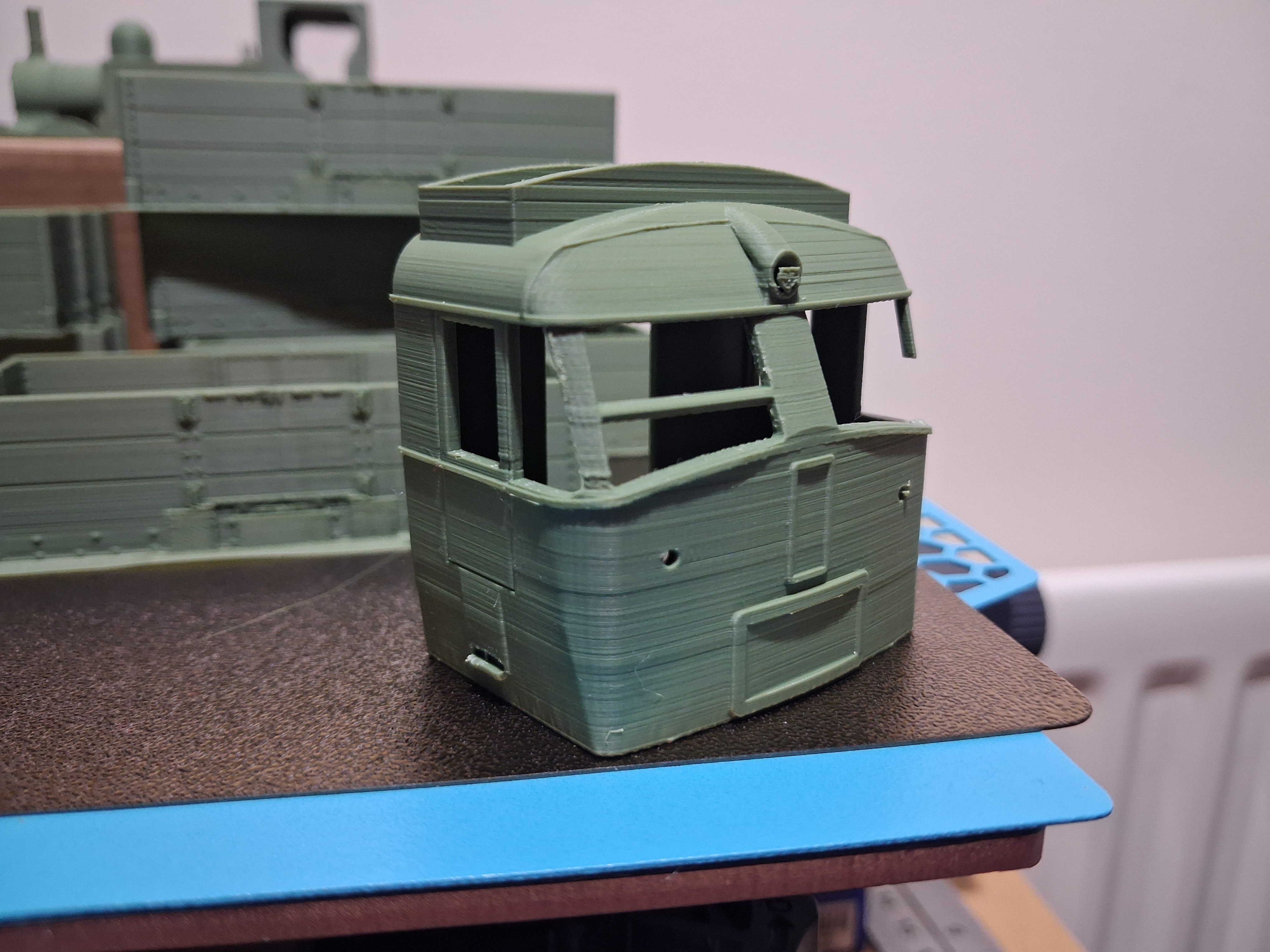

SLNCR Railcar B if you were wondering.....
The test print, from a Recreation 21 file, has done it's job.
Looks nothing like the real thing so I won't bother with the 18 hour print for the rest of it. 😞

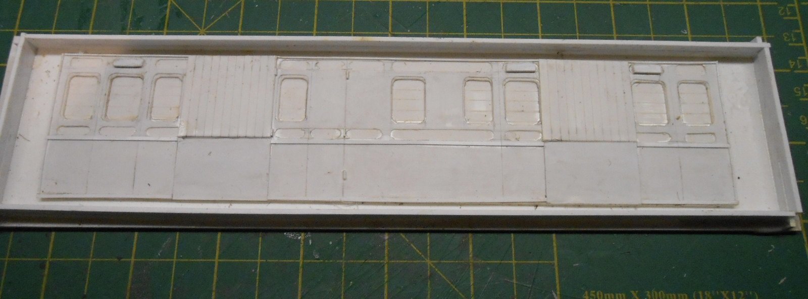

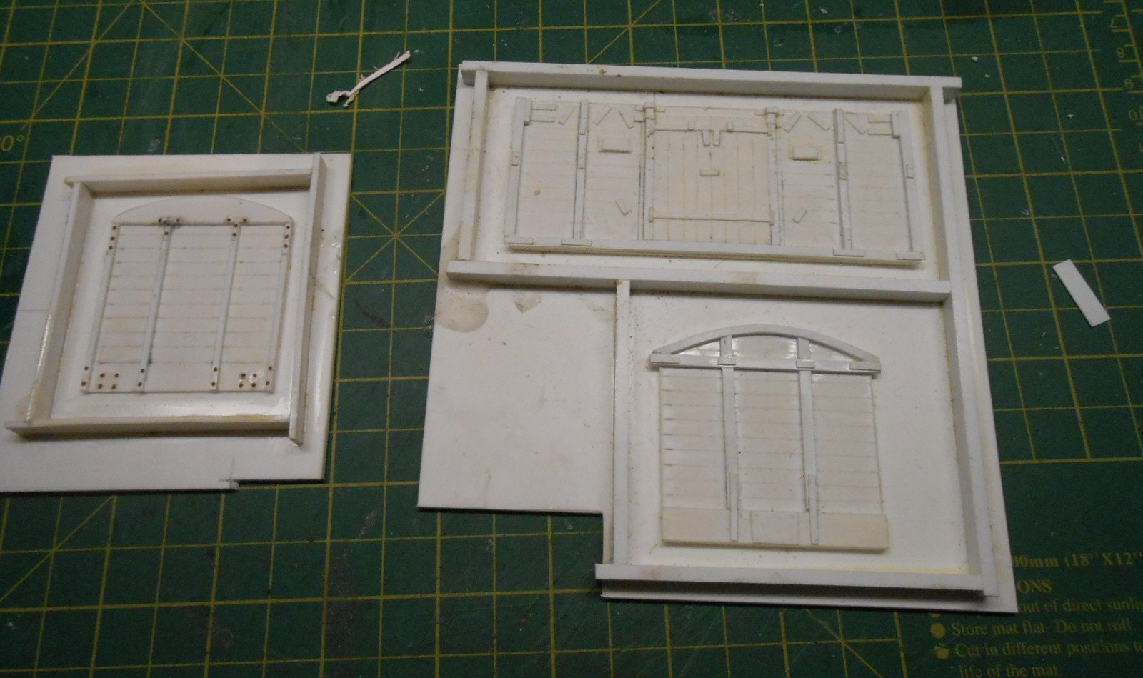

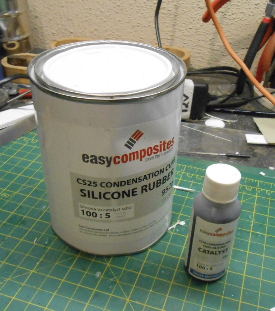

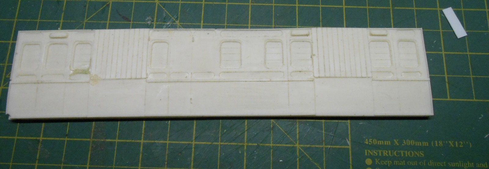

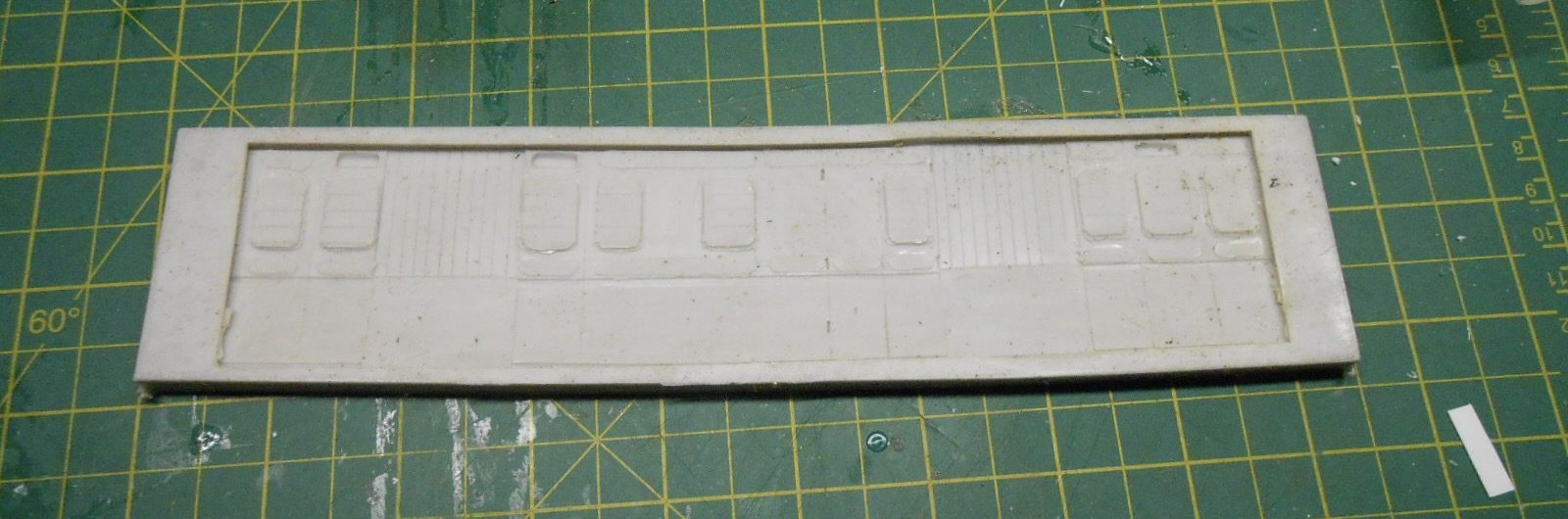

 Further to this morning's post, here are some photos of the basics of resin casting.
 First the 'stuff': below is what you need to make the mould - a tin of 'goo' and the setting agent/catalyst. One part of the latter to 20 parts of the former. Mix and wait 24 hours for it to set.

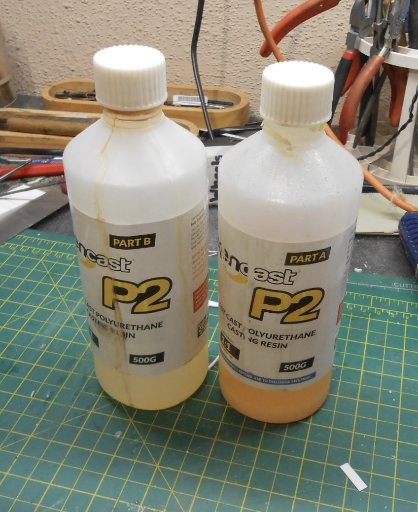

 The other stuff is the resin - two parts mixed equally, which take well under an hour to set, so you can cast multiple copies in an afternoon.

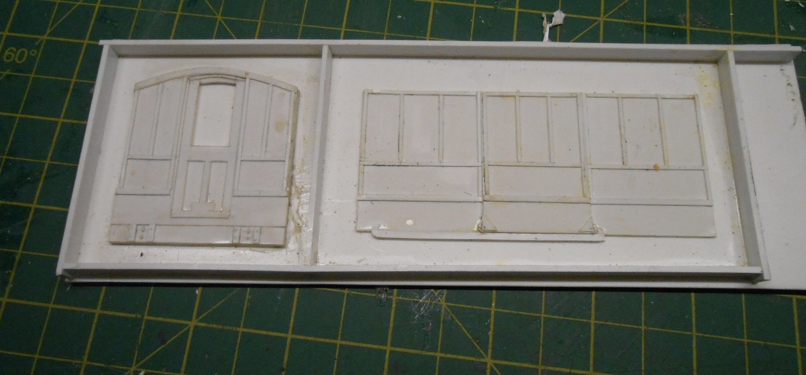

 Above is the master for one side of an ex WL&WR six wheel coach which was converted to carry turf during the Emergency [aka WW2]. Made from plasticard sheet & strip, it was quite a few hours work, but worth it in terms of then being able to make multiple copies. When finished, it was mounted in a low walled box [more plasticard] to take the moulding material.
 Here's said mould, ready to take the resin and below is one cast side.
 Another side, two ends and a floor, assembled with cyan, and you have the coach body, which then had an Alphagraphix etched brass chassis attached as shown with the completed models below.
 Have done all sorts of other models, mainly wagons, for both broad and narrow gauge, as per more masters below.
 If you are not ready for 3D printing yet, would say resin casting is definitely worth a try.

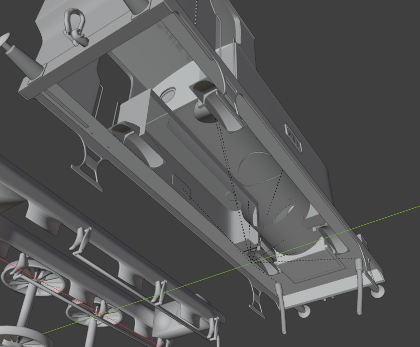

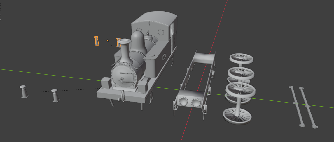

I'd be happy to throw my hat in the ring here, haven't had any experience 3D printing, but am decent at digital modelling! Give me a prototype diagram and I'd be happy to have a stab at creating a model for 3D printing, bit of trial and error! Metrovik was kind enough to do a test print of my J26 model (I'll let him share the early results here if he wants to), and for a test print it came out pretty decently! I redesigned the model a little bit to hollow out the inside for potential mounting to a ready to run chassis and motor.
As for me I'd be happy with a static model, so I split it up into the different components here that would make that up. Reading through this thread though, I wonder would I be better off splitting the model up further, to be later assembled?
Probably a sort of flatpack version if that makes sense. Little details like coupling hooks and vacuum pipes might be better done through a different medium, but for a base engine to build off of I reckon it could be a good start?
  • Like 7
  • WOW! 3
I can sympathise with Mol_PMB, I too was trained in the world of 2D drawing, (both hand drawing and early CAD systems) and have the ability to visualise 3D objects.  It is a steep learning curve, however, I’m following tutorials on the internet and I’m able to recreate the item in the video.  I have to rewatch the footage several times over, due to trying to keep up with the speed of the operator.
Bullet_Wanderer, your recreation of a J26 is impressive.  If you were to split it down further, consider separating the cab/bunker and probably the chimney.  It would allow different versions to be created.
One question, what wall thickness have you selected?
Kind regards
Paul

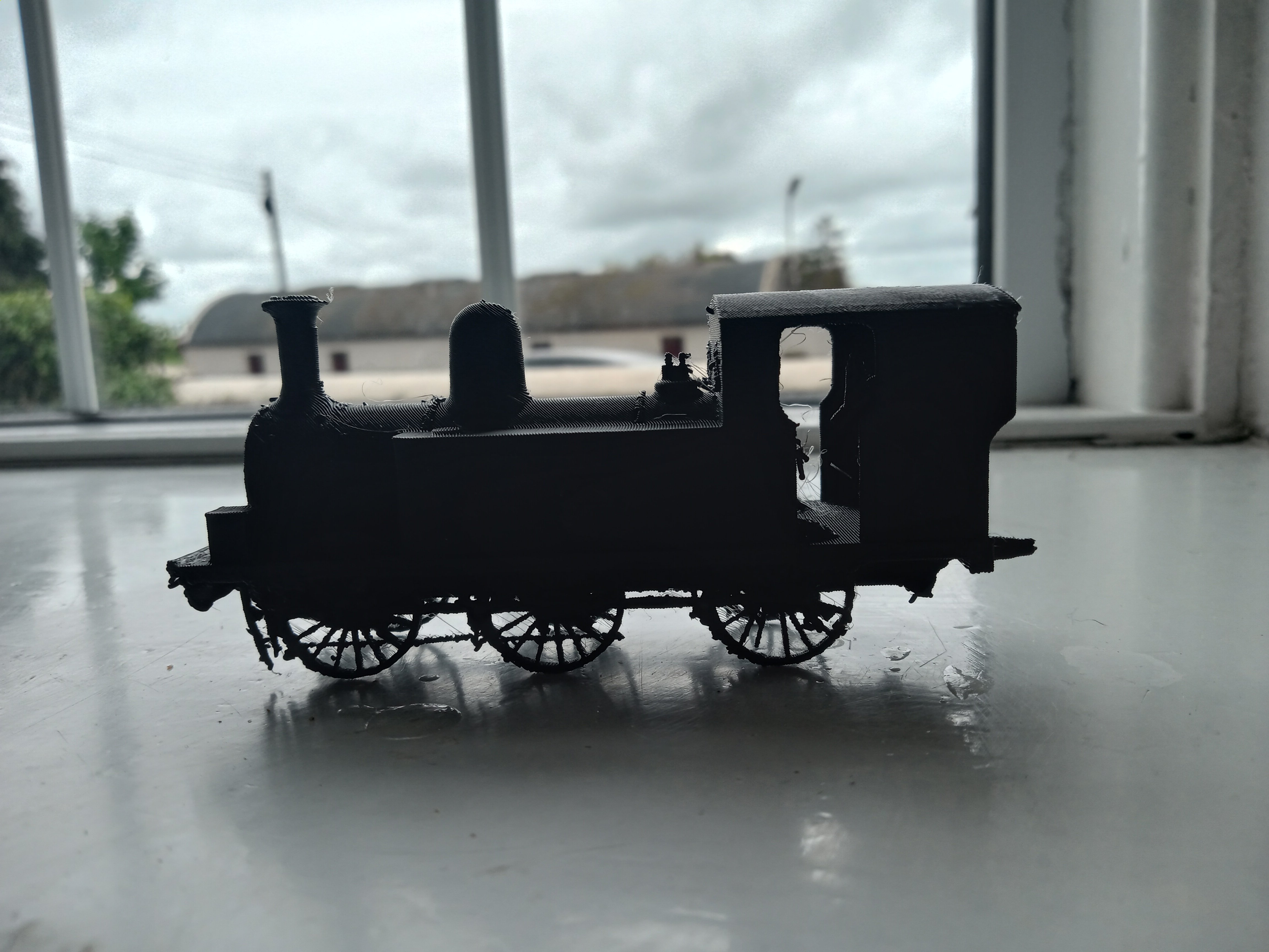

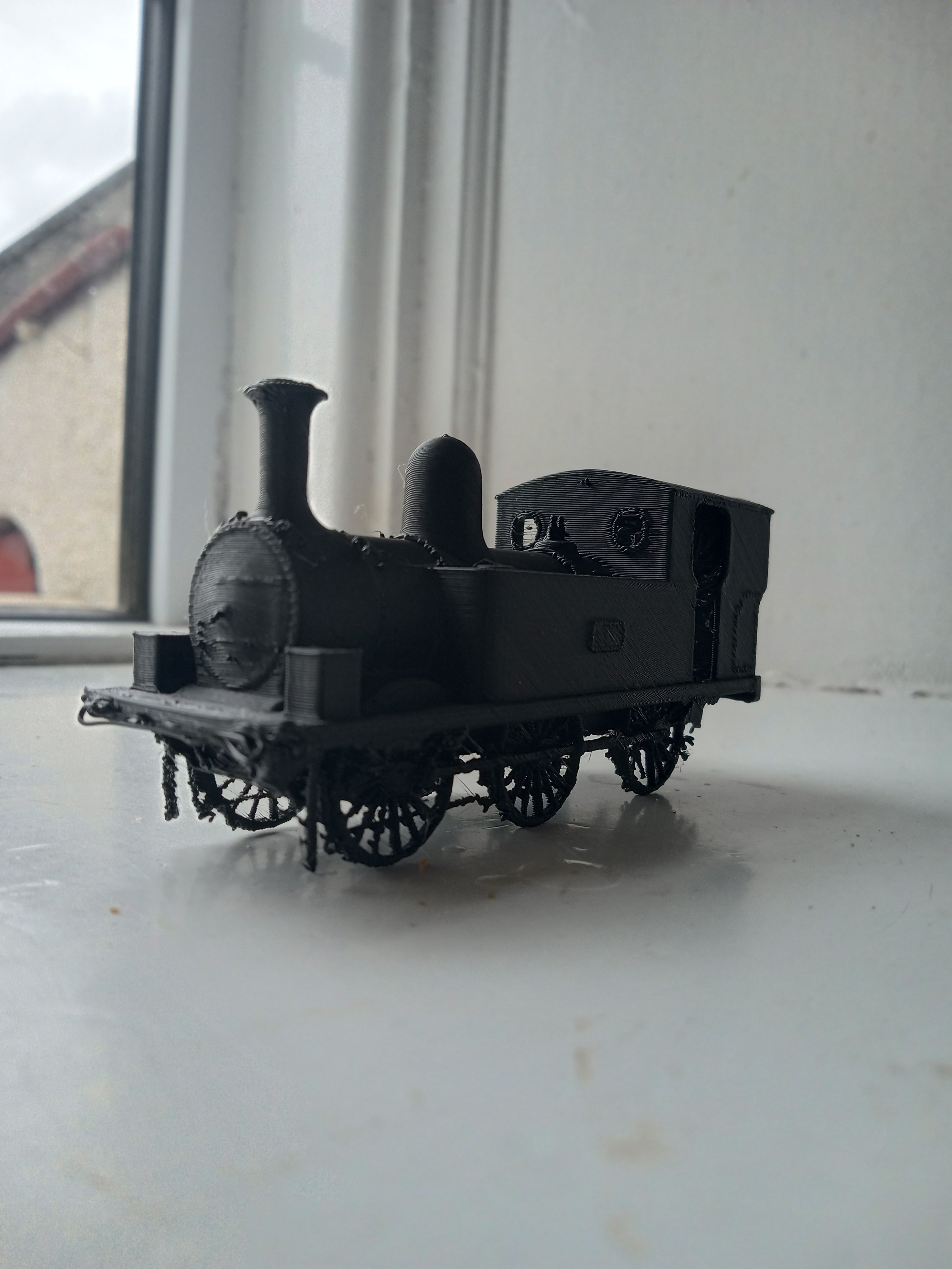

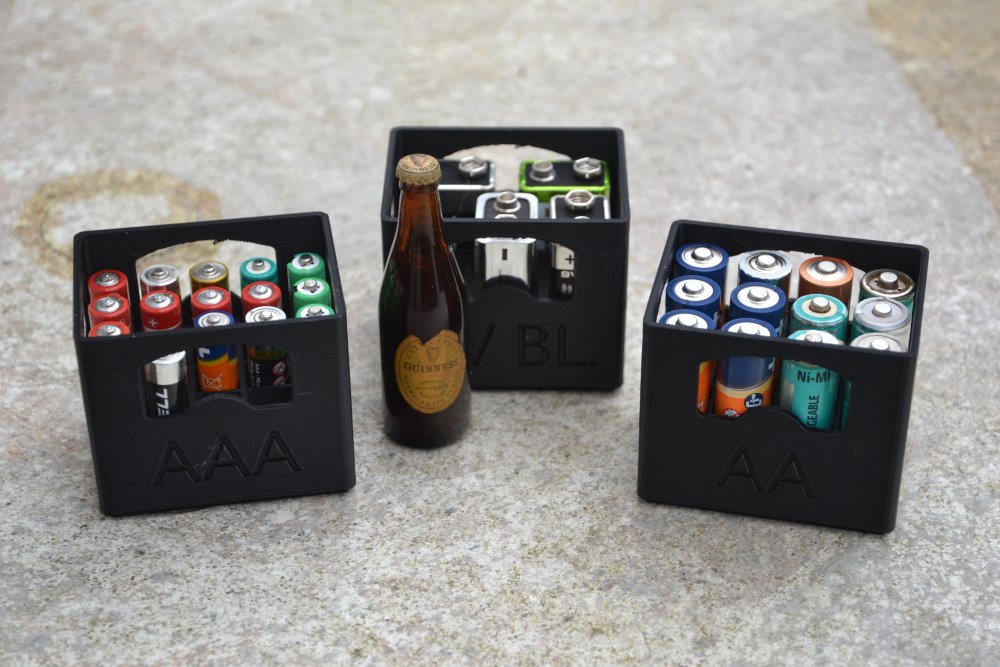

1000005532.thumb.jpg.e2d1ce869add51f5d03283f1be88c4d4.jpg1000005530.thumb.jpg.e1635be7a08c0577610bda5619cb9c9e.jpg
I printed out the loco use my cheap creality ender 3 and despite the obvious imperfections, I believe it came out rather well. The only advice I can give is the use of tree supports rather than walls and a top z distance of 0.22mm seems to yield the best snap off results. Must emphasize the above is merely a test print, resin would no doubt have better results. How lucky I am to find W&T rolling stock files as well as the gentleman that is Bulletwanderer.

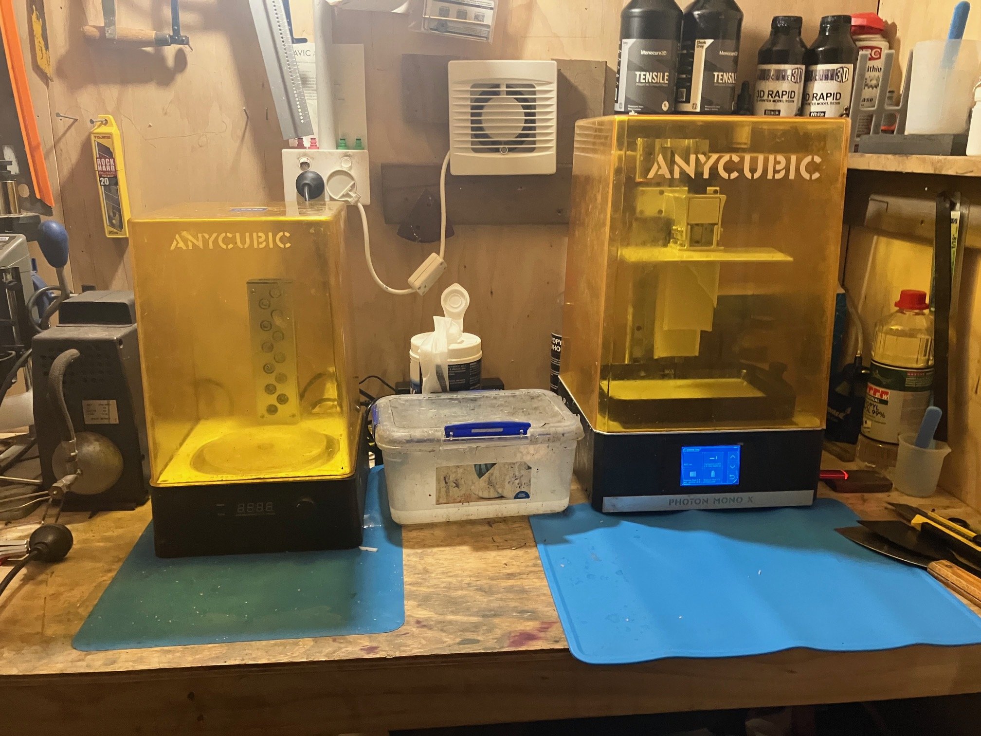

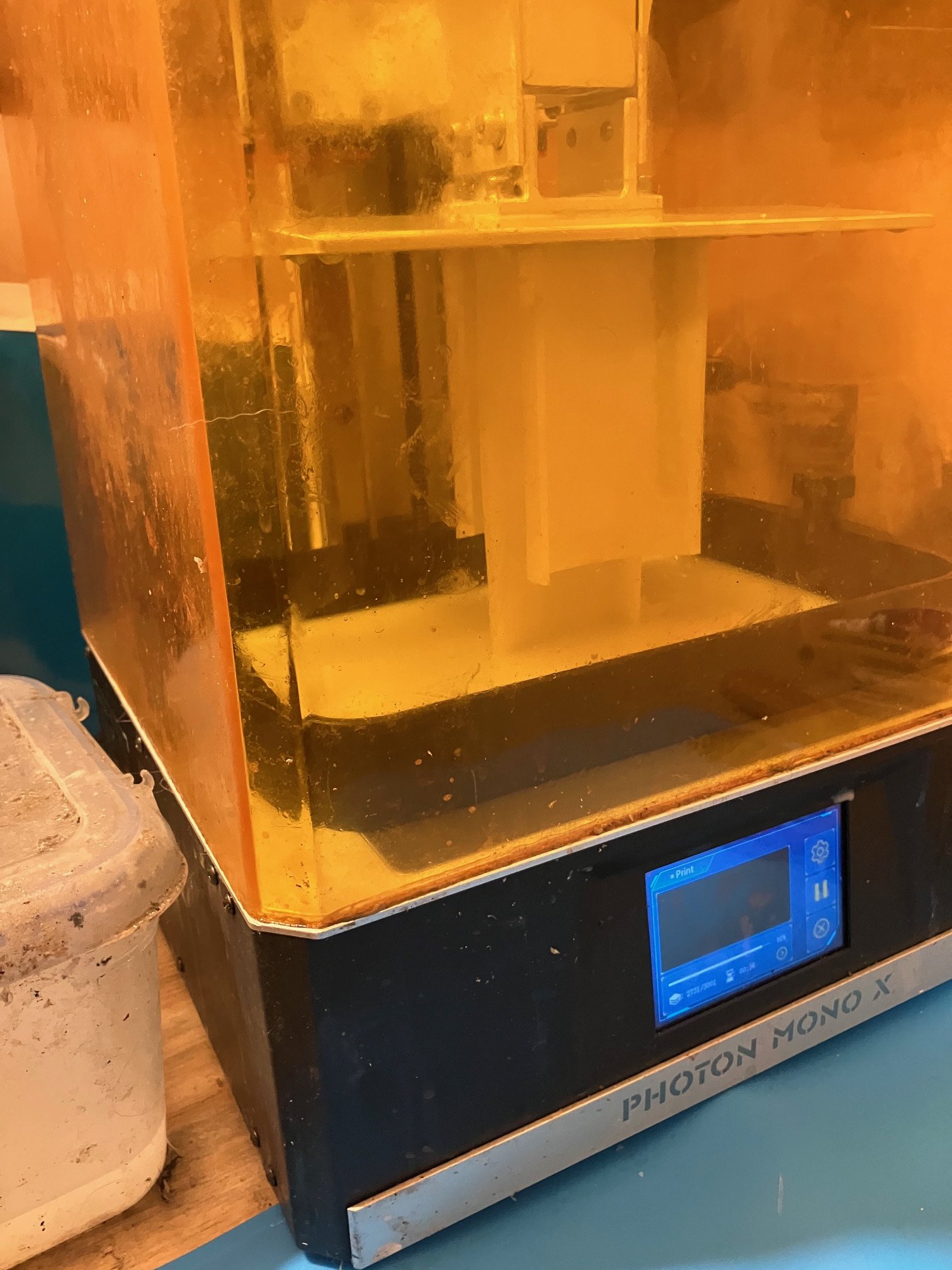

Some trials and Tribbleations with resin printing.
I am currently experimenting with a (cheap) watershable for 3D printing some buildings as an alternative to my usual combination of plasticard and Wills Material sheets.
I usually use a solvent based resin and wash up with "Resinaway" a non-flamable less hazardous alternative to IPA.
Day 1. One print failure and two defective prints for no apparrent reason after approx 6 hrs print time. Last week I successfully completed test prints of plain and curved corrugated profile, though interestingly we had one failed and two successful prints of the curved profile.
Printer and curing station set up in workshop/tool shed in garden.
Day 2.  Three successful prints following some minor modification to the CAD work
Roof was printed vertically in three sections including gutter to minimise the stepped effect noticeable when printing a curved or circular oblect horizontally or a shallow angle.
Next job is to print the walls!
So far the waterwashable resin seems to be working out nicely with reasonable print quality, more easier clean up and significnatly faster curing 5min Vs 45-50 minutes solvent based resins.
One major issue was that the Spec Sheet for the waterwashable resin was only available from the manufacturers website and the print settings on the 2021 sheet appeared odd/did not make sence. While the print quality at these settings appeared reasonable, but the settings seemed to be 'messing with" the printers brain the machine thinking it was halfway through the print cycle after successfully completing a print batch😵‍💫
I eventually tracked down a Sep 2022 Spec Sheet with more realistic print settings, print quality continues to be reasonable and machine now appears to be behaving normally.

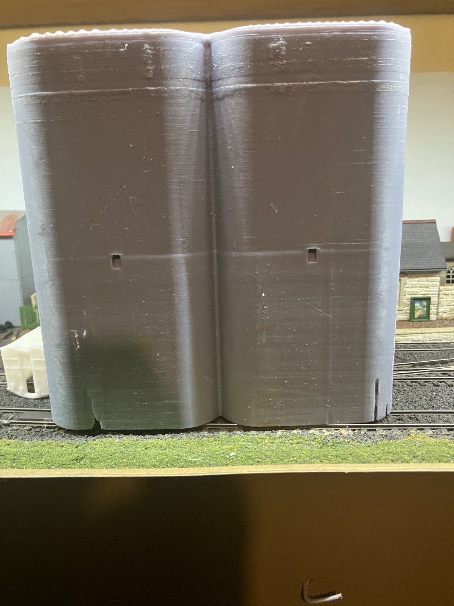

I originally printed large tall items including this concrete grain elevator horizontally partly to fit on the print bed & keep the concrete 'lift lines' (as the shutter/concrete rose) horizontal.
I 'discovered' the distinctive concrete elevator at the terminus of a disused branch line while exploring the network of branch and secondary lines that criss-crossed the Valley Region of North Dakota while en-route to New Zealand 20 odd years ago.

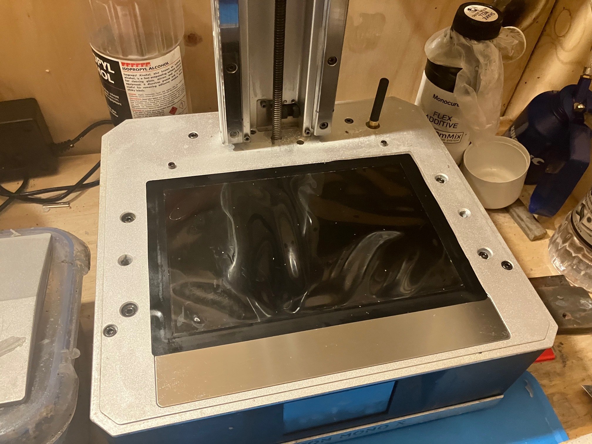

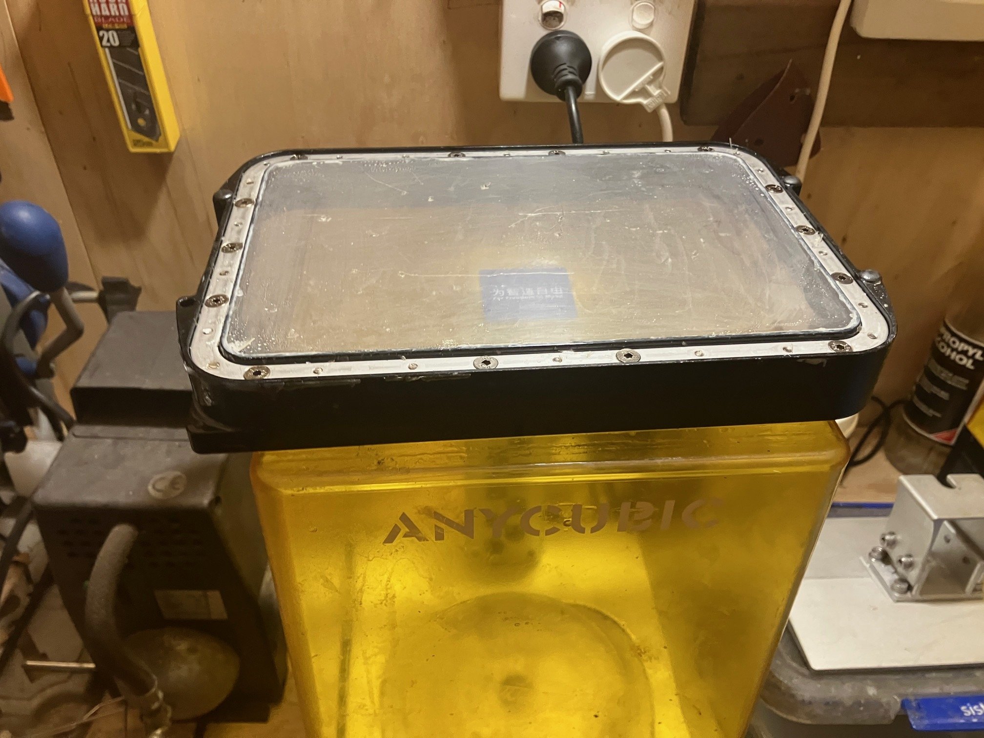

Major risk of print failure and rupturing the PF fim in the bottom of the resin tray (with resin leaking onto the LCD screen) can occur when printing items horizontally or at a shallow angle.
Occurs when the 'peeling force" of lifting the model/cured layer of resin clear of the PF film exceeds the physical limits of the film. Apparrently cured resin can become trapped between model and screen as the build plate descends punturing the film
Majority of resin suppliers recommend printing objects at an angle 15-45º to minimise the risk of punturing the film and potentially damaging the LCD screen.
Protective film to protect LCD screen from resin in the event of spillage or punture of PF film.
Also carry a stock of replacement PF film! Screens become dirty damaged as a result of cured resin sinking to bottom of vat.
Replaced PF film following photo!
Problems with too shallow a print angle/poor set up.

I've been resin printing miniatures for quite a while. I dabbled in fusion 360 to make a Dutch van and encountered some printing issues that stemmed from my lack of cad skills so I shelved it, resin print failures are quite demoralising to deal with, the cleanup is a pain for successful prints never mind the failed ones.
One of the big things that increased my success with resin printing was adding a chamber heater. Chitubox produce a kit that I fitted to my Elegoo Saturn 2 quite easily. Lots of newer resin printers are coming with vat/chamber heaters as standard.
  • Informative 2
Lightly coating the PF film with PTFE lube every time you fill the tray to print prolongs it's life and makes for easier cleaning!
Eoin
  • Agree 1
  • Informative 2
Also I have been mixing my own blend of resins to suit my needs. I'll usually go with ABS like along with some tough resin.
Exposure tuning is also important. I use this method https://www.tableflipfoundry.com/3d-printing/the-cones-of-calibration-v3/
A UV pen torch is also handy, especially when you get a spill and want to stop it spreading everywhere. Brief flash of the torch cures the surface and keeps things contained while you get ready for clean up.
Still not found a way to extend the life of my IPA wash that I am happy with. I've been taking the dirty IPA and sitting it under a UV lamp to cure the resin then strain it. It's better to than disposing of it but not great.

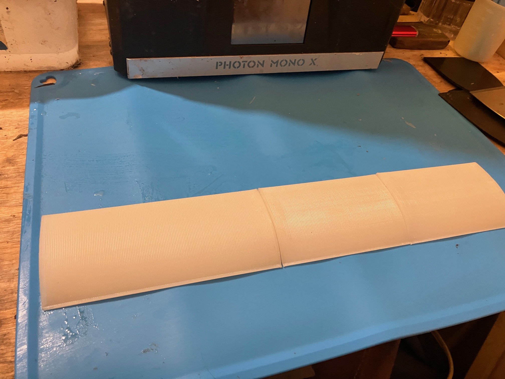

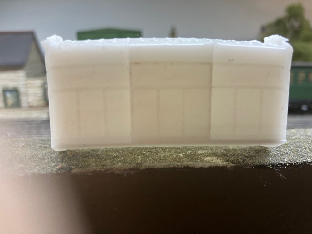

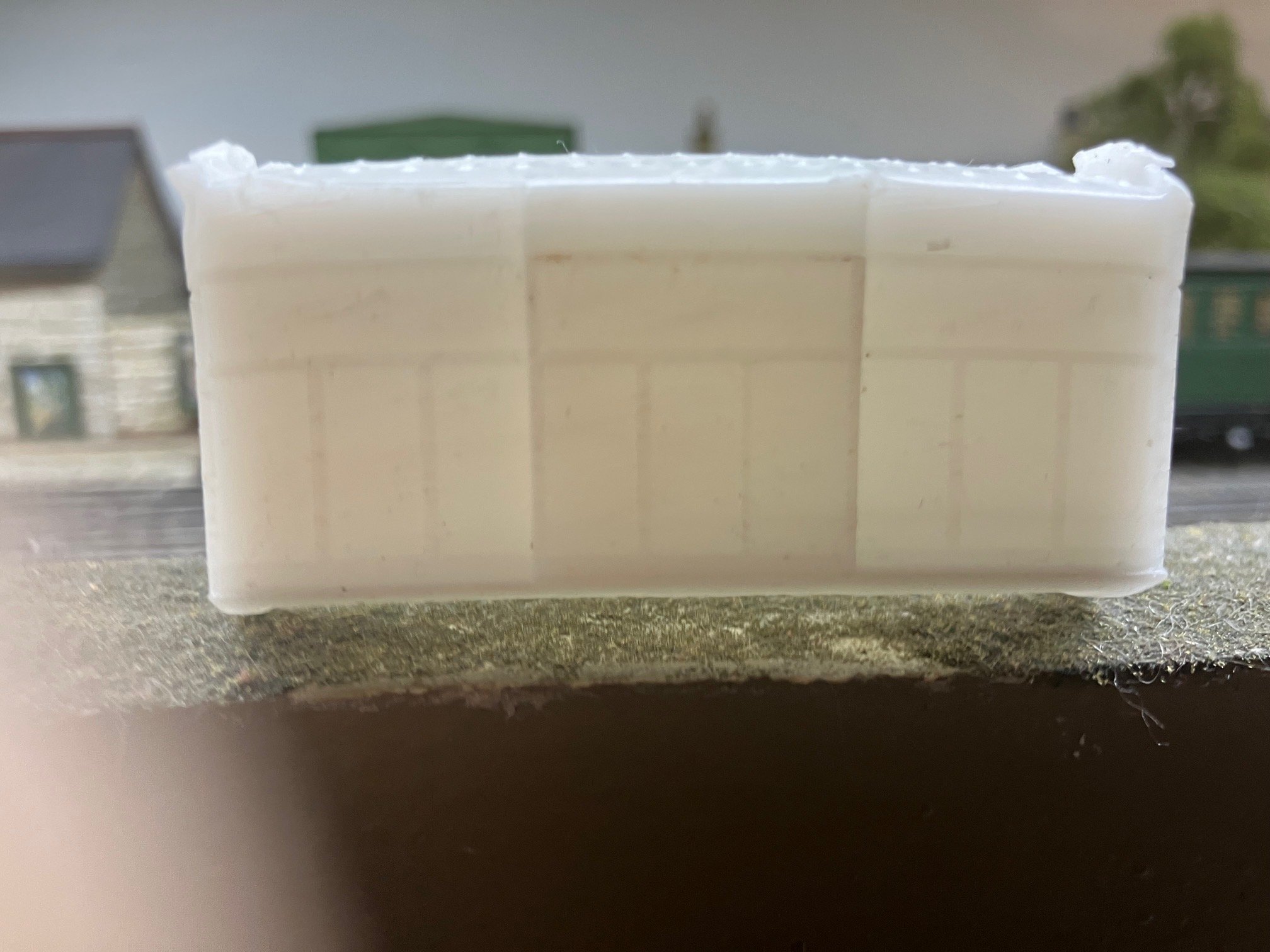

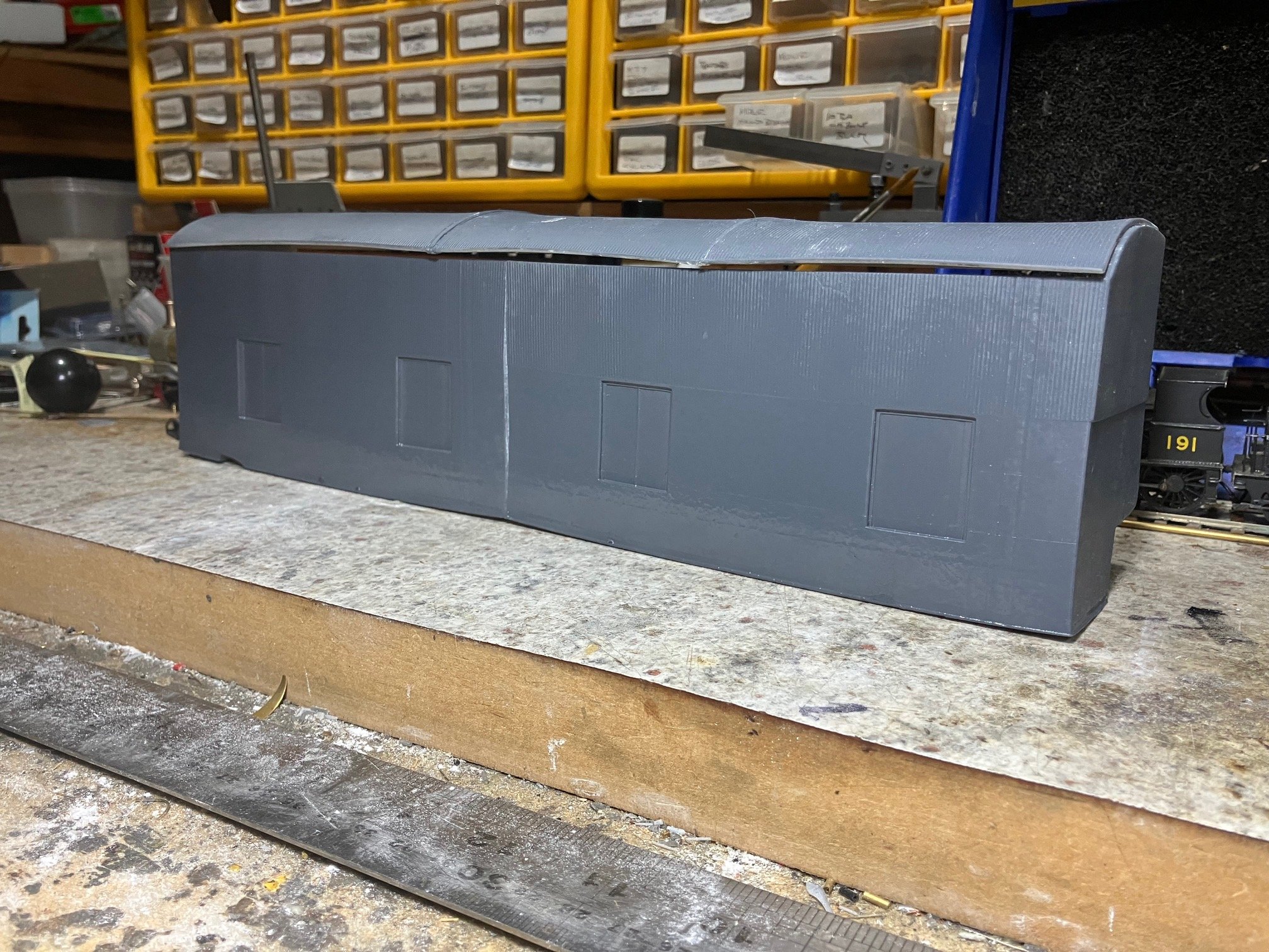

Some SLA prints.
Printed the walls of the Grainstore in two sections (each 170X60 on plan) with halved joints. Horizontal lines that were once a problem when using this printer now largely absent, but vertical lines/grouves present in one area.
Main issue was the outer corners of the model peeling away from the buildplate during printing despite the using a build plate adhesive.

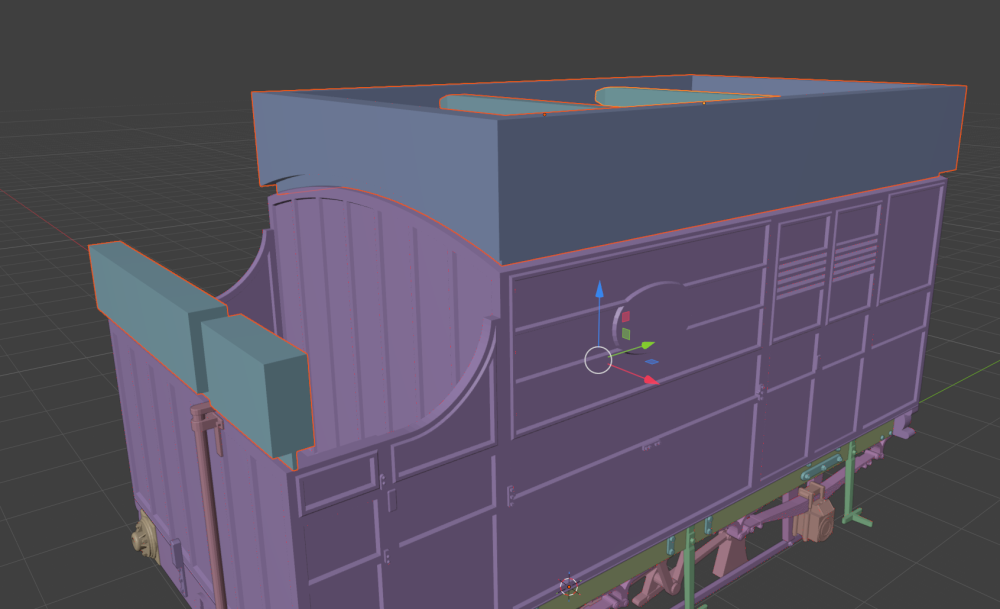

I have re-designed the roof so it can be printed in two rather than 3 sections and added a reinforcing rib inside the bottom edge of the roof to minimise the risk of warping.
The grainstore is intended as a low-relief building against a backscene.

Progress on SLNCR small tank.
I've decided to use a cheap Chinese gearbox/ motor set at least initially. A fiver with Now, a question for you mech eng experts: have any of you tried printing driving wheels? I was thinking of the spokes etc of ABS type resin, the P4- ish tyres of mild steel (made with my trusty Unimat CNC lathe!), the lot "somehow" glued together. The motor has D shaped axles, and printing the wheels would make quartering easy as well as solving the problem of extracting the axle to replace it with a round one. And save £50+ for wheels.
As you see from the screenshot, I haven't decided yet how to fix the wheelsets in the frames - I'm aiming for a Sharman type 3 point suspension with the driving axle rigid. Any experiences here would be gratefully listened to.
