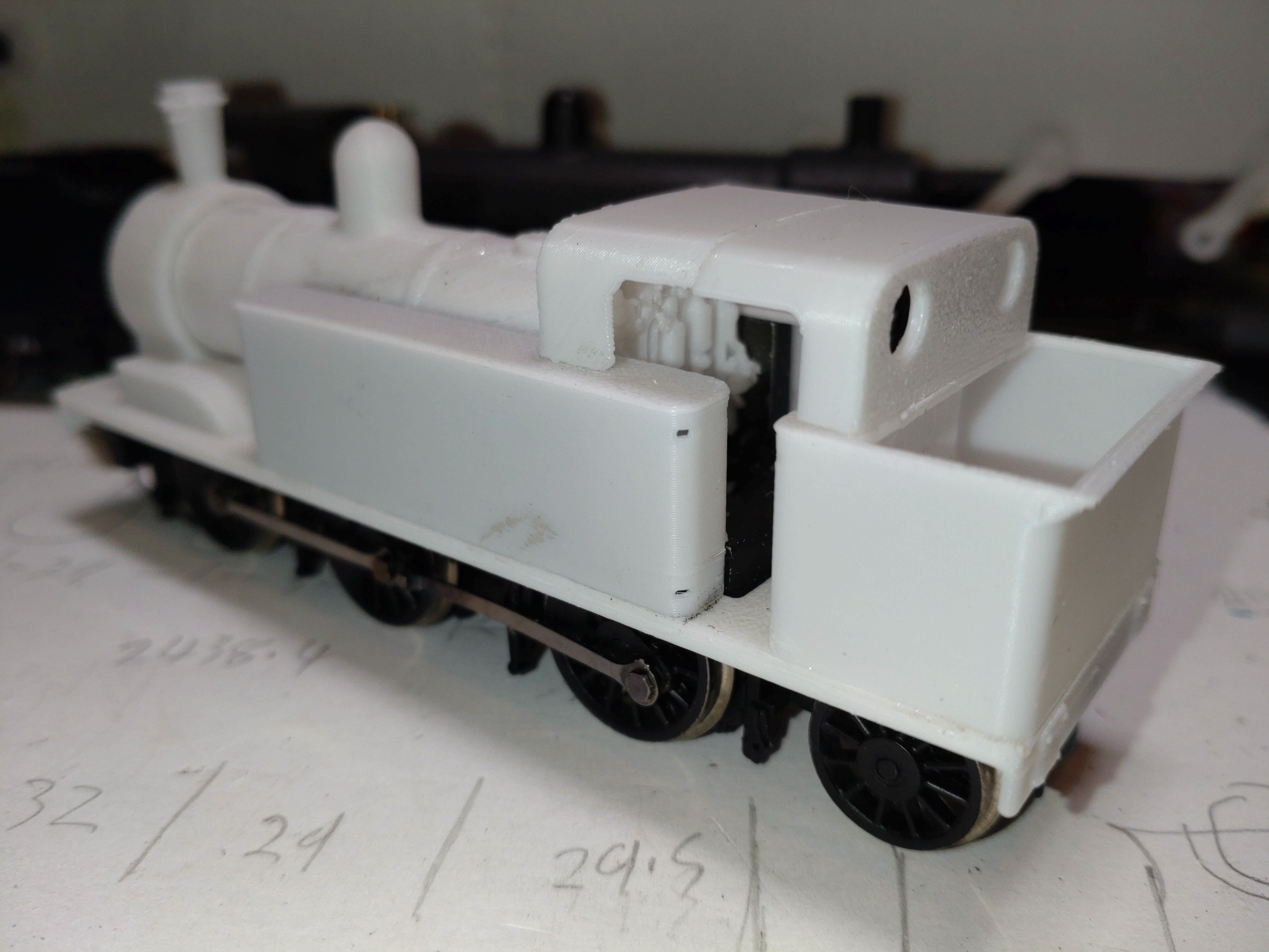

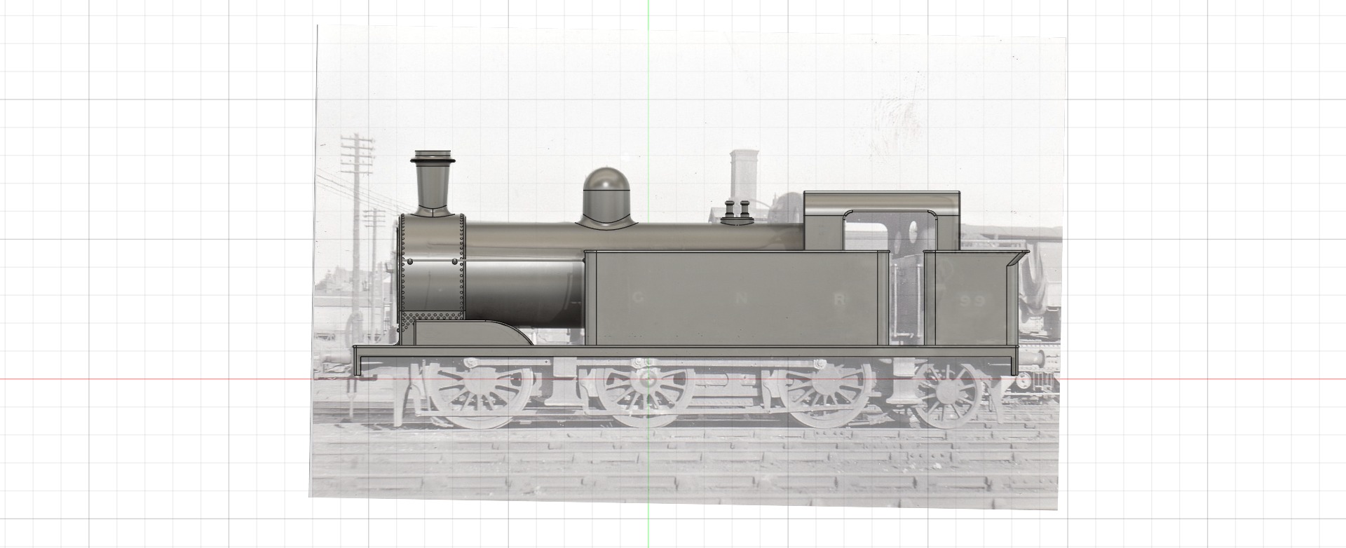

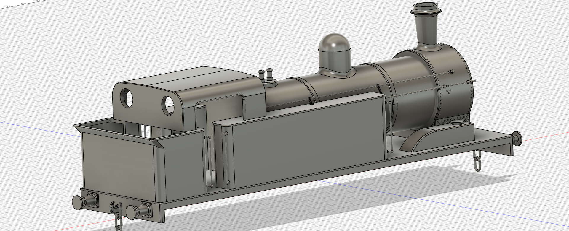

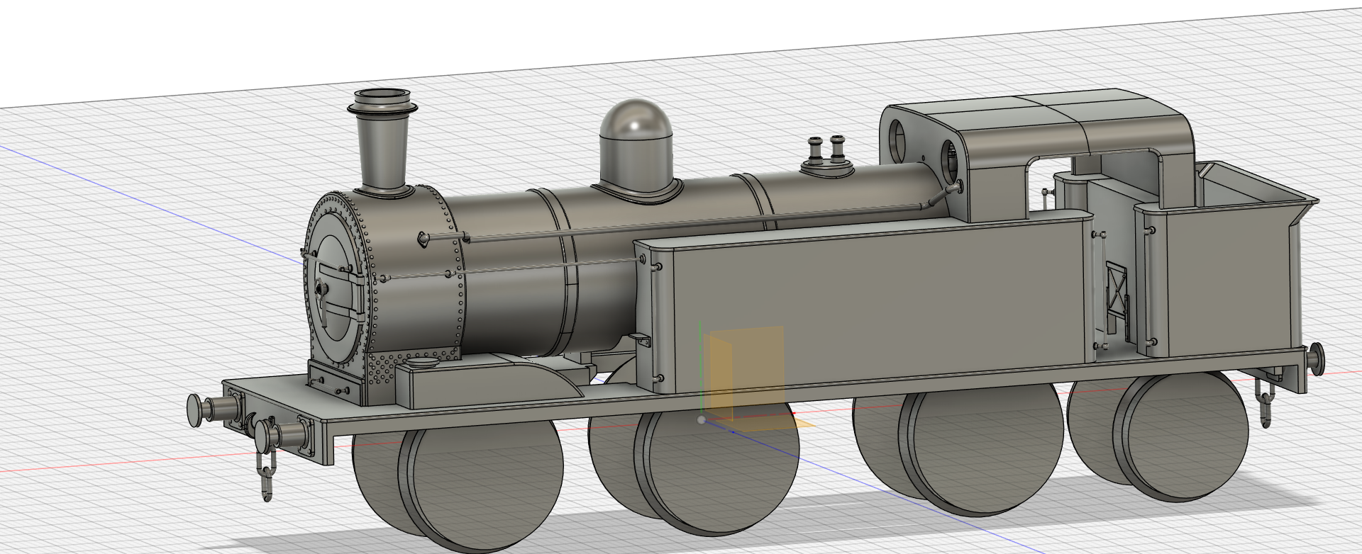

Moogie-69 Posted October 8 Posted October 8 New project time. GNRi QGT No. 98. Just got started today so still a fair bit to go, Using a Bachmann Class 56XX as a donor for the running gear although the rear wheels will need to be moved. Once I get the cad done I think it will be mosty 3D printed in resin, getting the details with a FDM printer could be a bit of a challenge. I'm having to work from photos as I haven't yet found any technical drawings of the QGT's. I'm hoping most of the dimensions are similar to the Q Class. 8

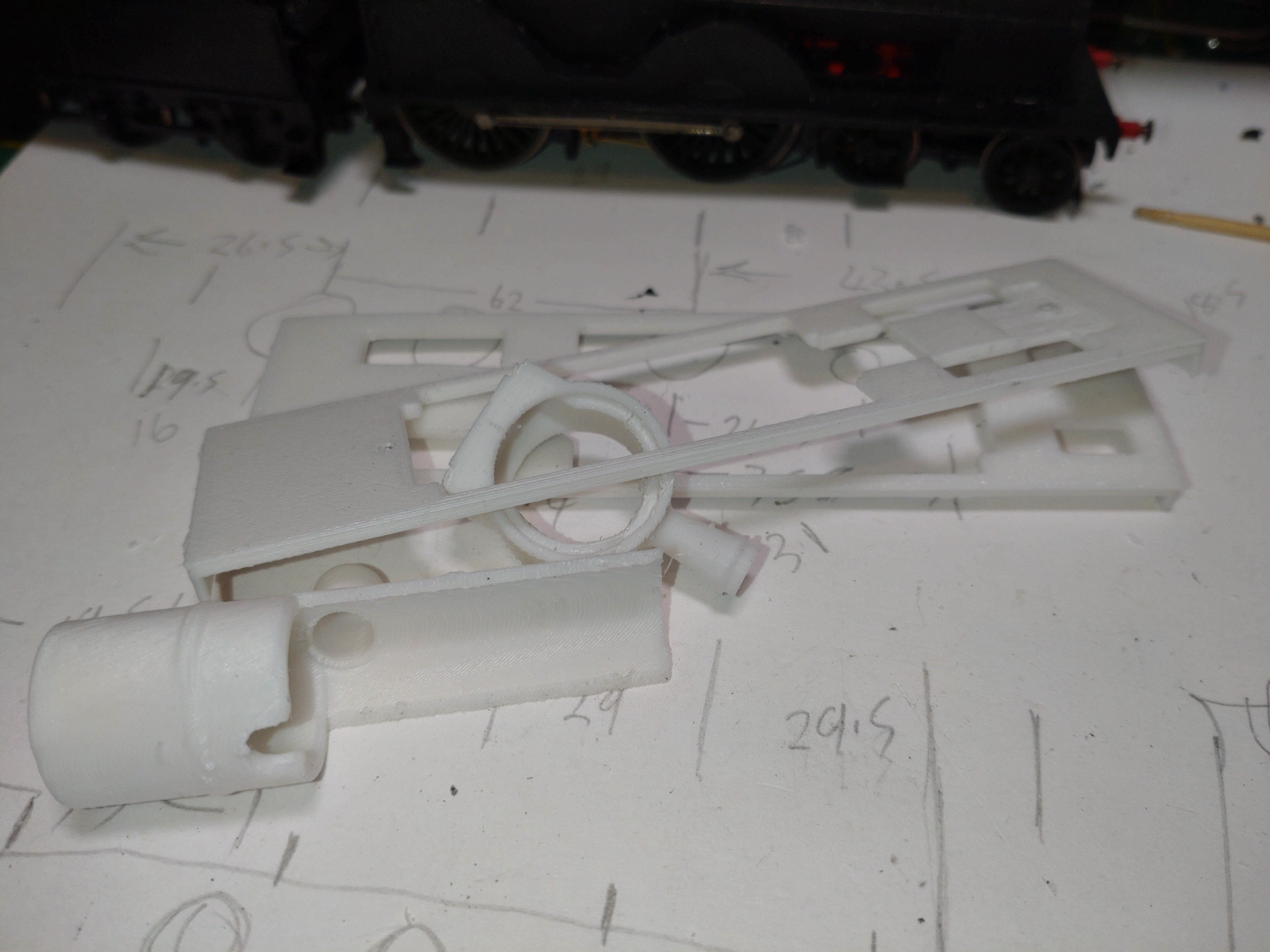

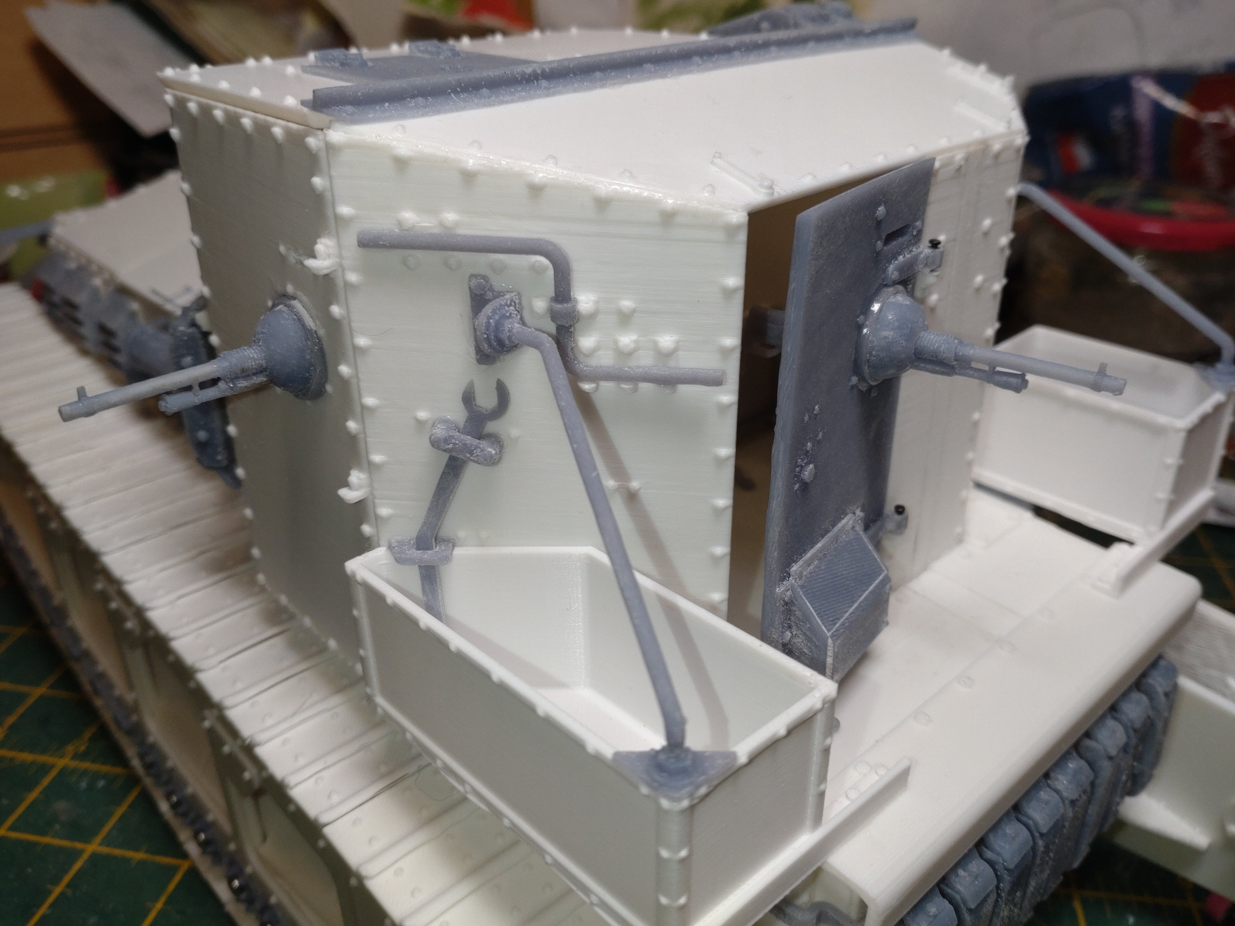

Moogie-69 Posted October 9 Author Posted October 9 6 minutes ago, Maitland said: That looks nice.. now tell us how you print it.. Just break it down into components parts, water tanks, coal bunker, cab, ect. Majority will be printed in resin so that the fine details will still show. All the gray parts in this photo are resin, the white parts are pla filament. Filament is stronger but less detail, resin is great for details but can be brittle. When you are printing small scales, filament isn't an option but good if its 1:16 scale. 3

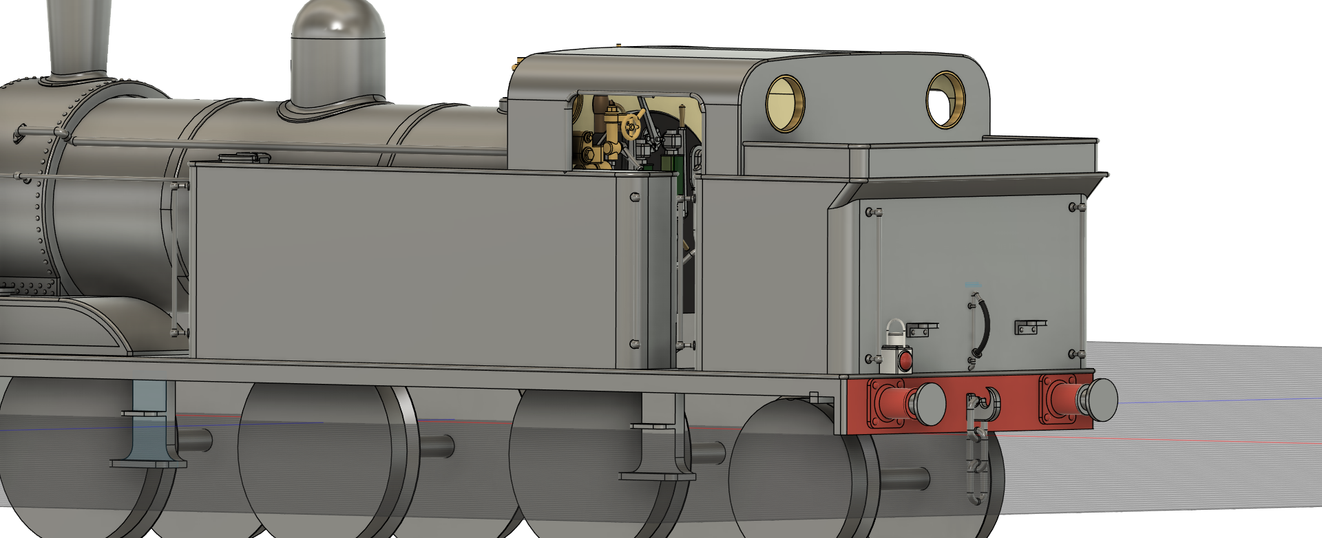

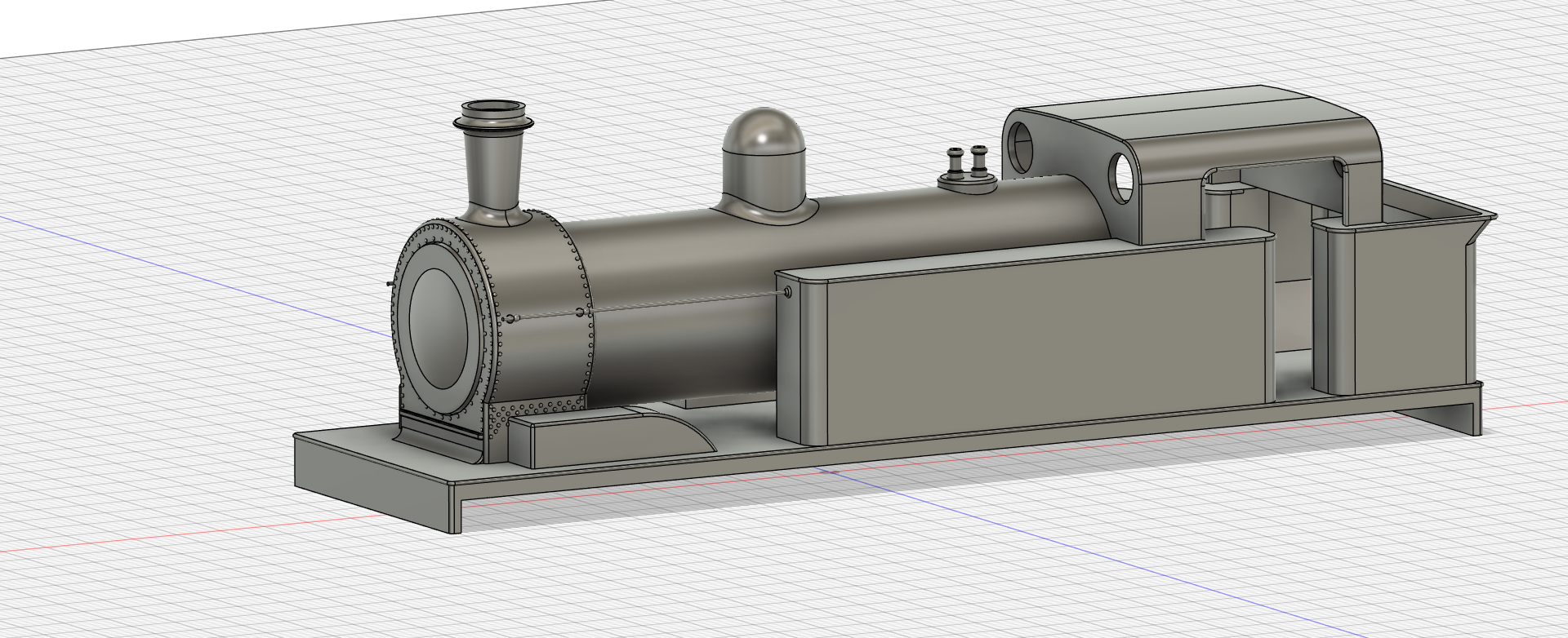

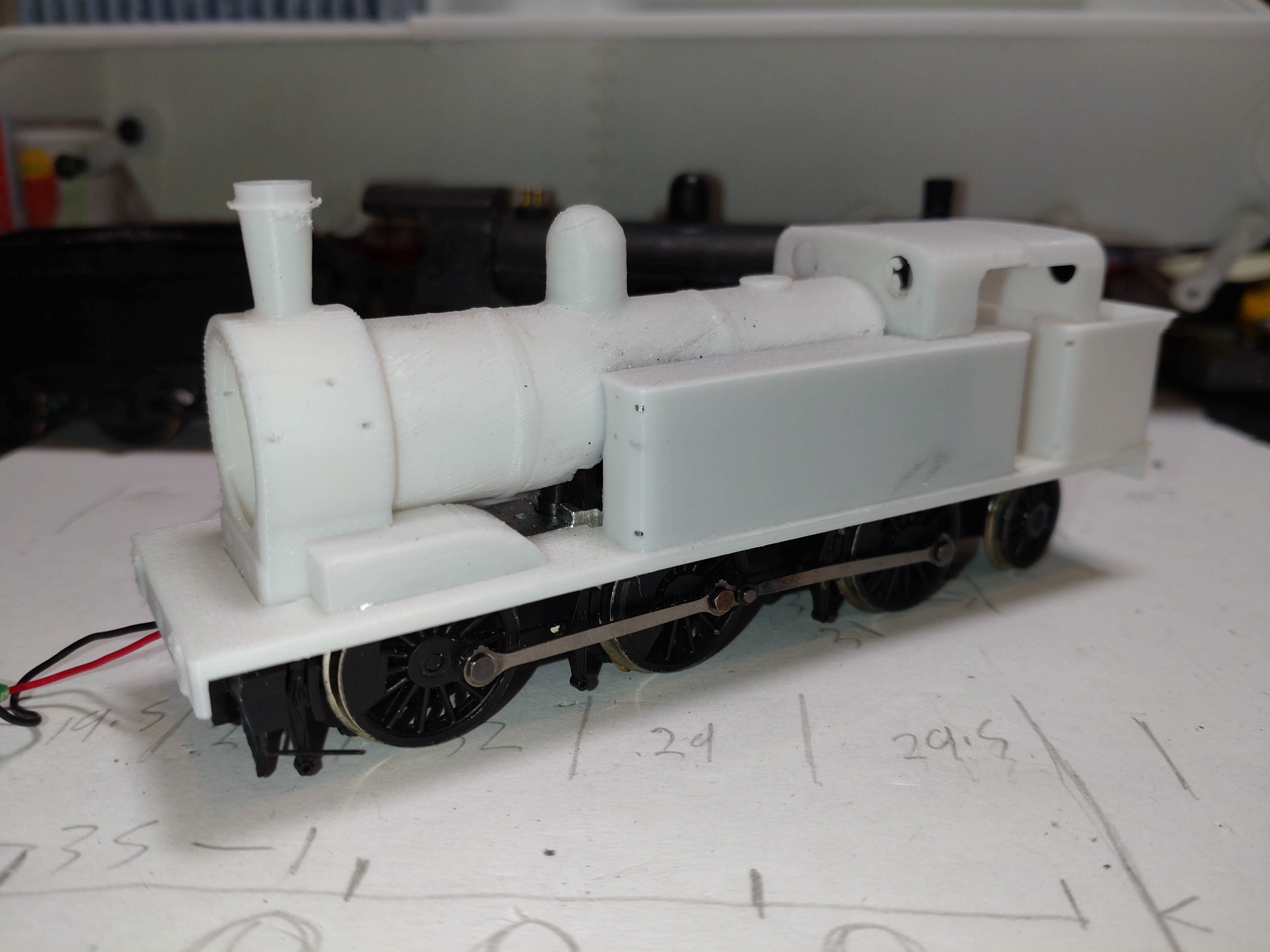

Moogie-69 Posted October 13 Author Posted October 13 Little has changed on the outside, mostly detailing the cab. I have also started printing the running plate, smoke box and boiler to check for fitment. Ill try to get more photos up later. 8

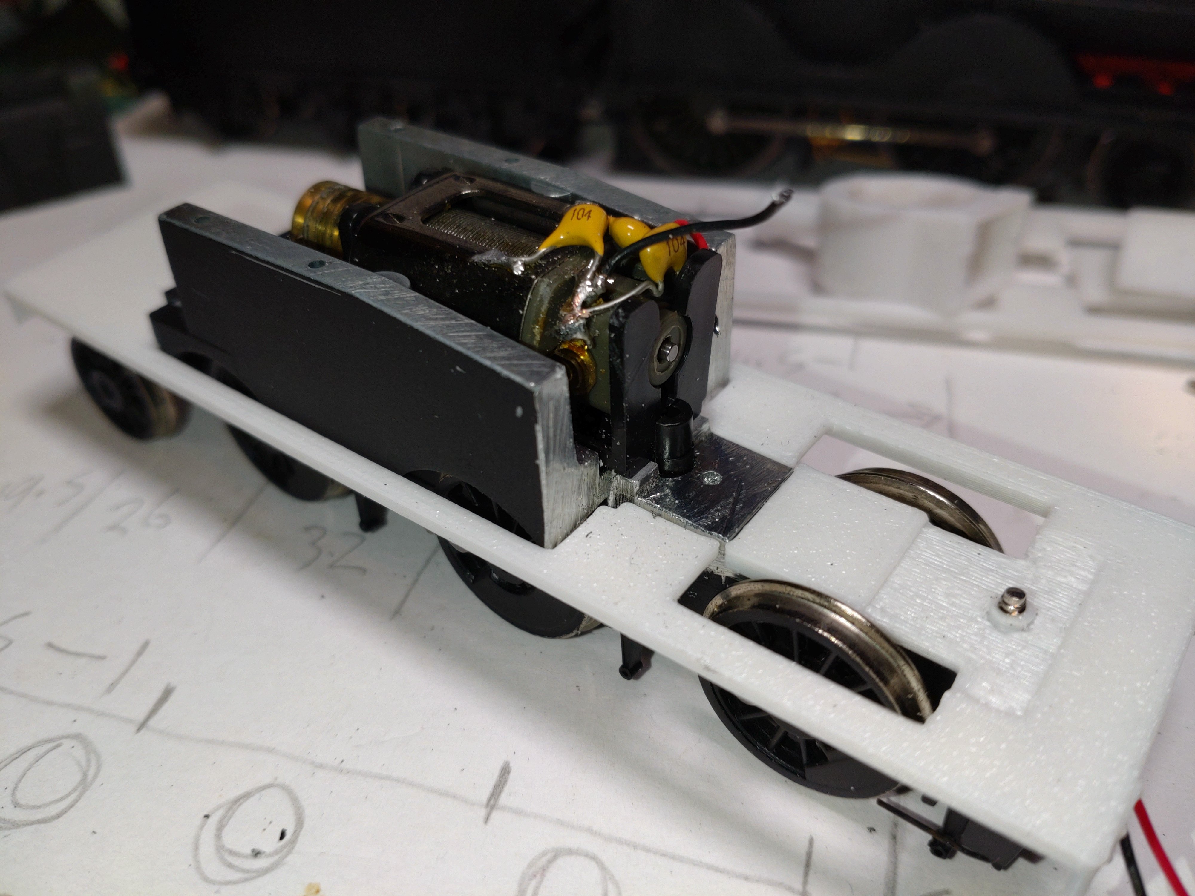

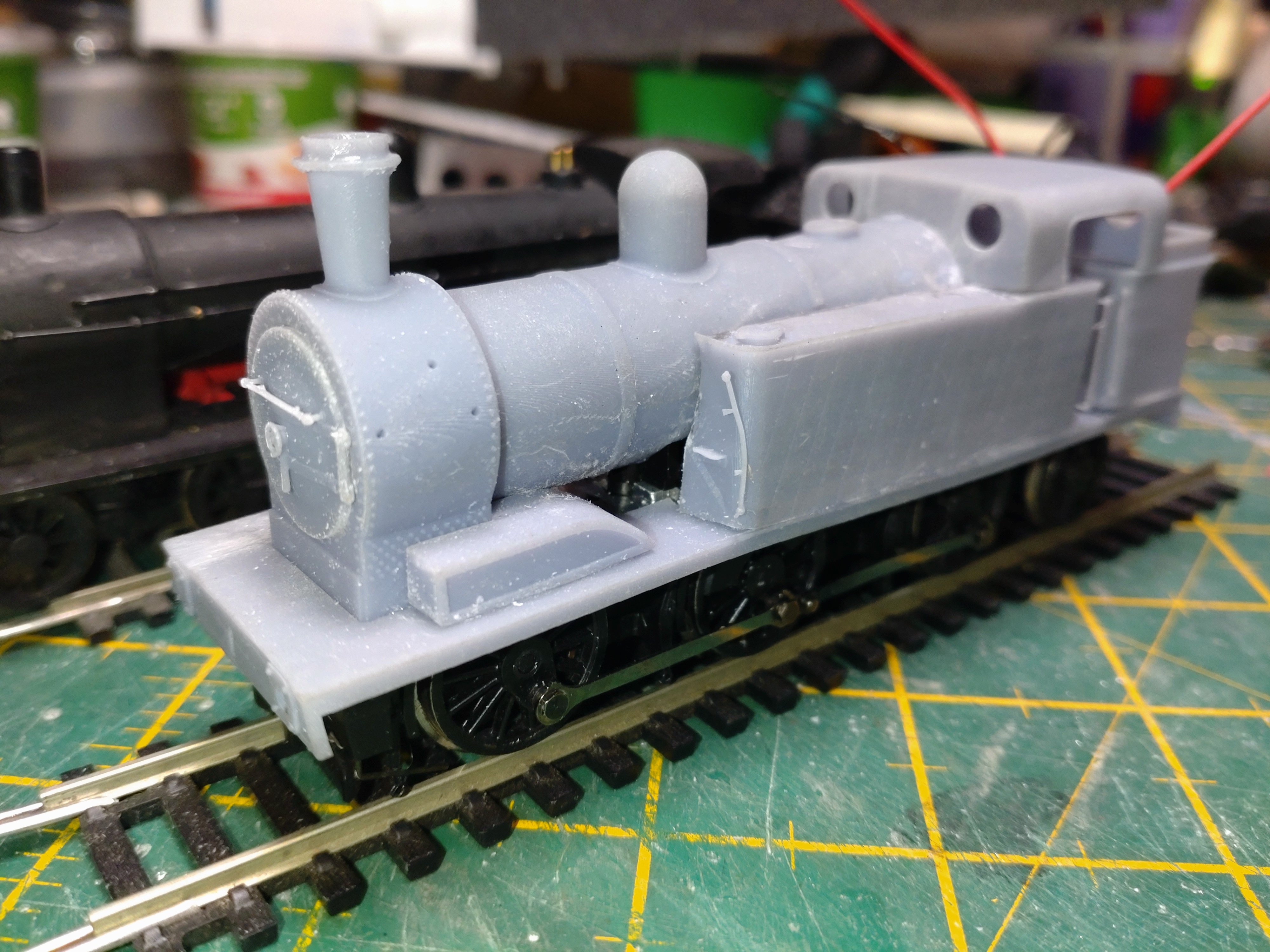

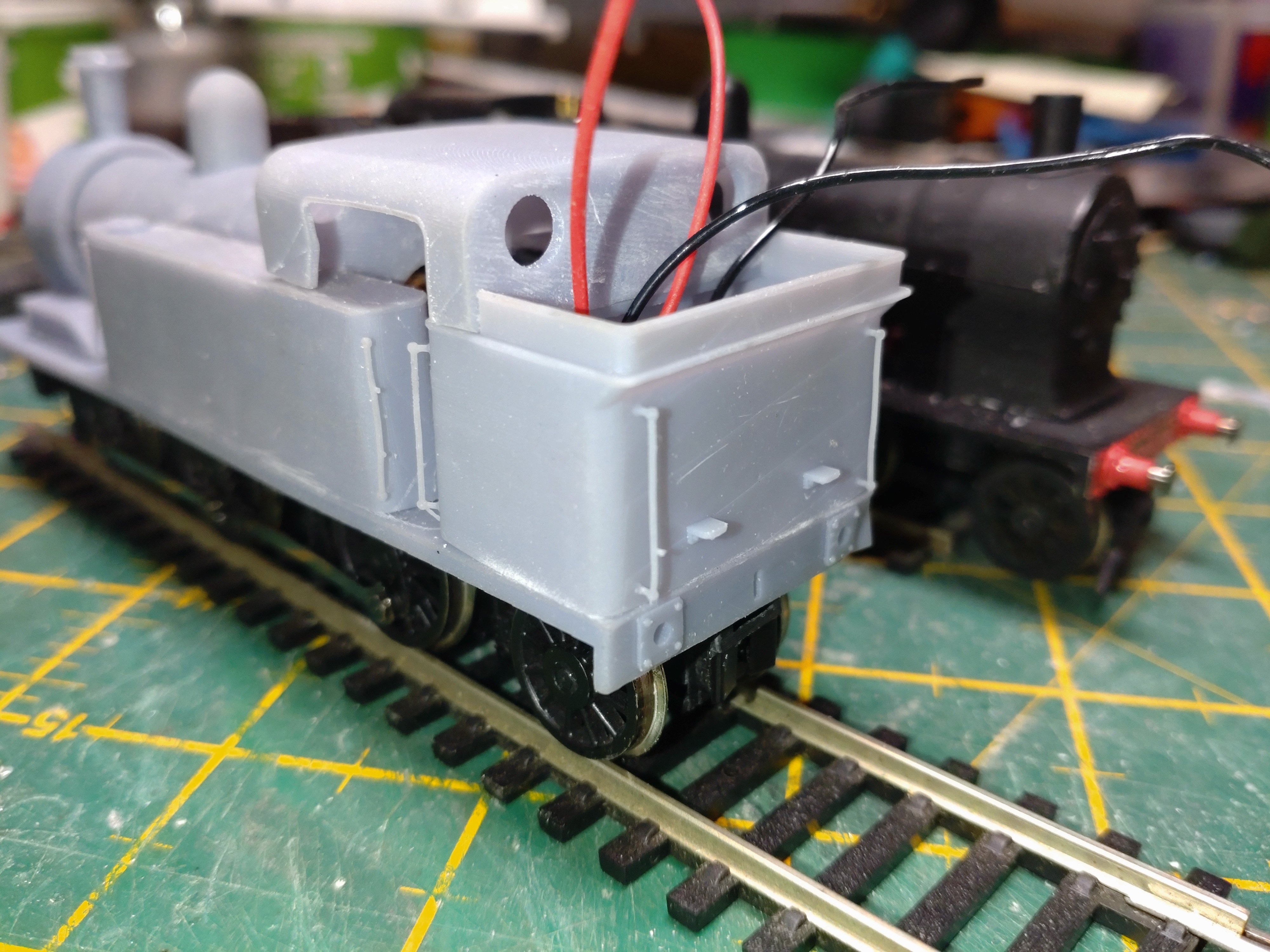

Moogie-69 Posted October 13 Author Posted October 13 (edited) Had to do quite a bit of trimming to the class 56xx running gear to fit it in the confines of the QGT body. Done the test prints in filament, once I'm happy with the fit I'll reprint them in resin. Think the decoder will have to live in the coal bunker as there is zero room in and around the boiler. As you can see, I didn't get all my dimensions correct first time. Edited October 13 by Moogie-69 13 4

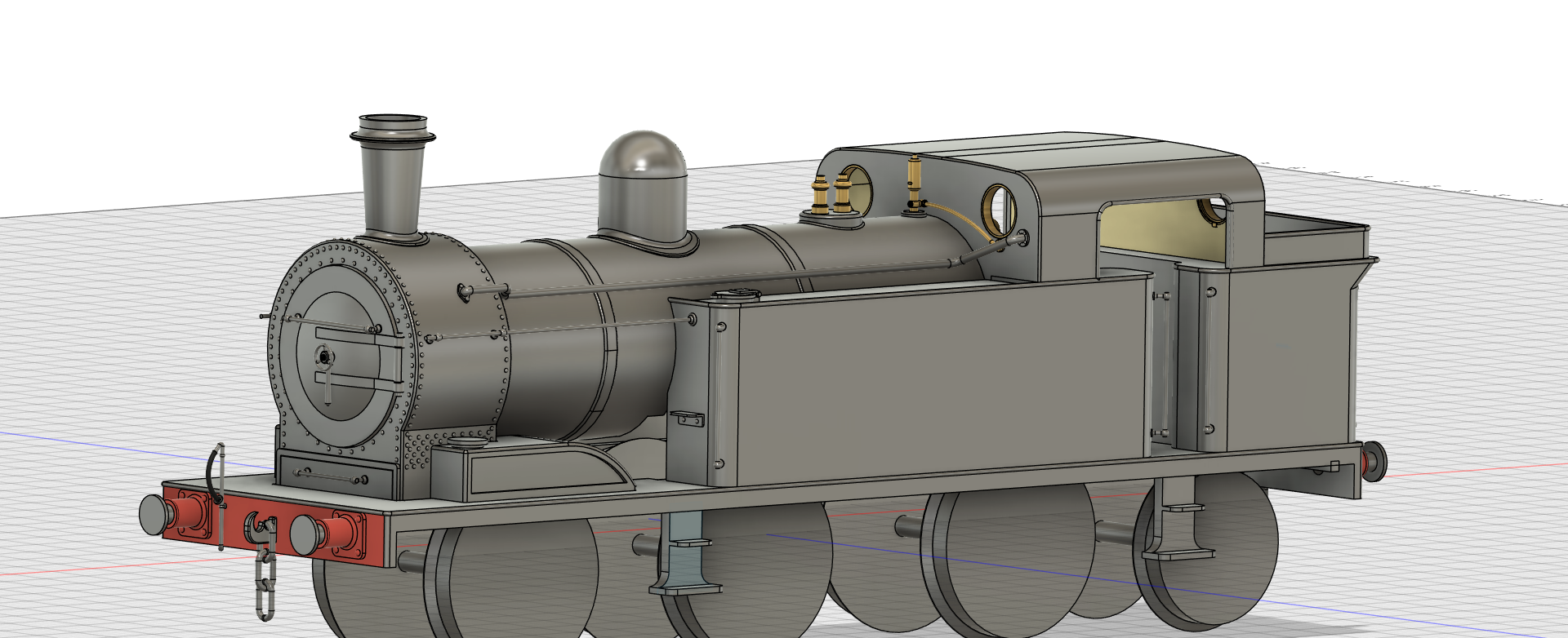

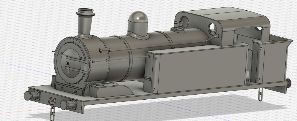

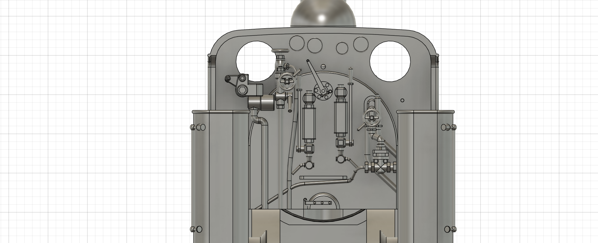

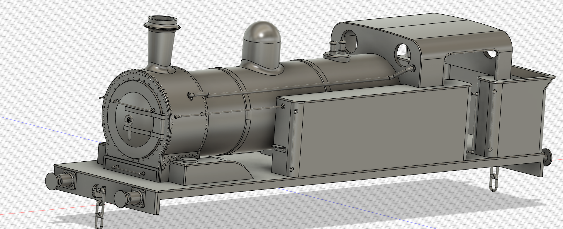

Moogie-69 Posted October 18 Author Posted October 18 (edited) A few more details added to the cad drawing. And the resin printing has begun. Having fat fingers and very fine handrails isn't a good combination. Edited October 18 by Moogie-69 11
Moogie-69 Posted November 3 Author Posted November 3 Prototyping still moving forward. Had a go at printing it as a one piece model, 90% is perfect except for the running board at one side only. Time to reorientate and try again. 8
Moogie-69 Posted November 5 Author Posted November 5 Got the printer working properly this time, finally a successful print -- almost ! A few handrails, pipe, etc. makes a good difference. 11 8
