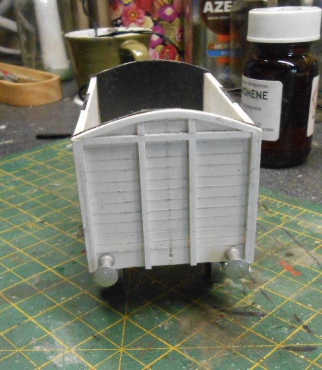

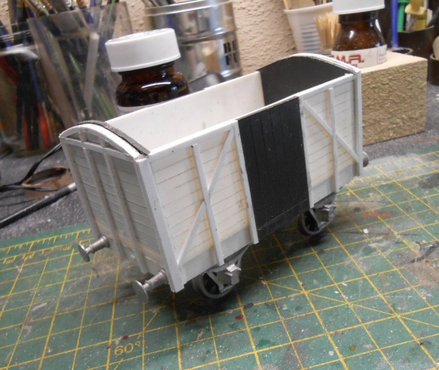

David Holman Posted September 2, 2020 Author Posted September 2, 2020 A little more work on the strapping. More 60 x 80 thou strip, but a little more tricky, especially the end profile below the roof. One photo shows the pieces used. They have fitted quite well, but suspect a coat of primer will reveal some filling is needed. The diagonal strapping on the sides also needed a little thought, but in the end simply marked and cut them in situ. The black pieces you can see inside the van bodies are profiled so that they can provide roof supports either side of the canvas/corrugated central roof section. 7
popeye Posted September 2, 2020 Posted September 2, 2020 Very nice wagon build. Is there a reason for using black plastic for the doors?
David Holman Posted September 2, 2020 Author Posted September 2, 2020 Couldn't find any white 60 thou, Popeye! 1

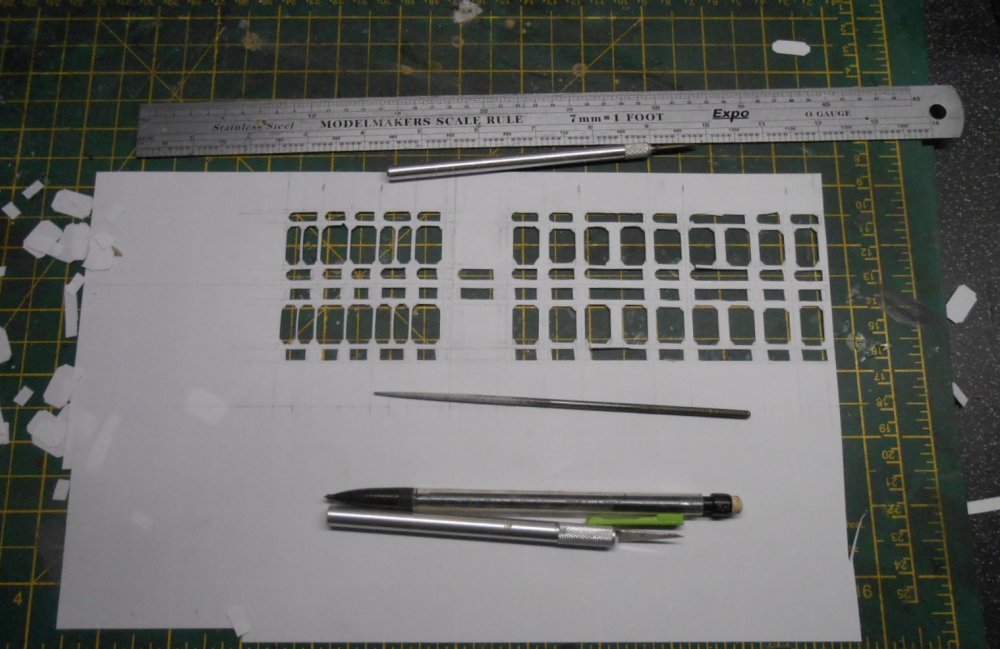

David Holman Posted September 6, 2020 Author Posted September 6, 2020 Less than a week ago I wrote of how adding micro strip strapping to wagons could be therapeutic. However, since then have been doing little else and it is quietly driving me nuts. The two MGWR vans only have about 80 [!] pieces between them, but the plates that hold everything together add up to over a hundred separate pieces for each van, while there are over 200 rivets too. Take the small plates that go round each length of strapping - often two or three to each - it involves five separate pieces [four of them just 1.5mm square] with three rivets - plus two of the small squares have rounded ends. Ok, it only takes a few passes with a file to do the latter, but believe me, it all adds up! Thus far, I think I've got all these bits done, along with what appear to be two metal vents on each side - each of these comprising another five individual parts and four rivets - but there still remain two louvres on each side, with one more each end. Had I thought ahead a bit more, I really should have resin cast the body work, for even with just two of each van, making just a side and end for each would have cut the work by 75% AND I could have made my fortune marketing them to other 7mm scale broad gauge modellers. Well, maybe not the latter! Oh well, slowly getting there and, fingers crossed, the GSWR vans appear much simpler. The photos hopefully show what I mean and include some pretty cruel enlargements of some of the detailing.. There is also my GW model rivet press, without which this work would be a lot harder. This really is a quality piece of kit and if you use the added table can not only churn out straight lines of rivets less than 1mm apart, but [if your maths is up to it] create circles of them too. 6 4

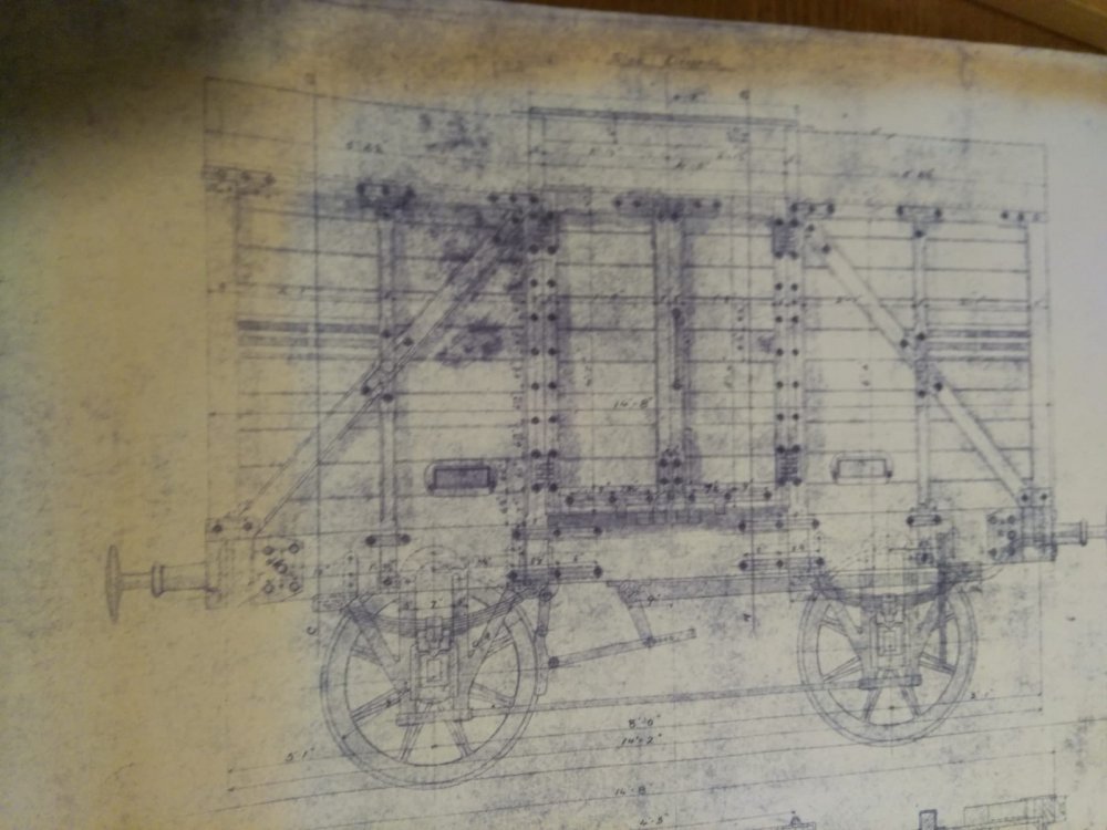

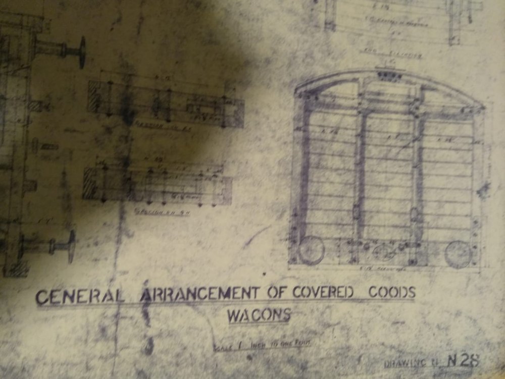

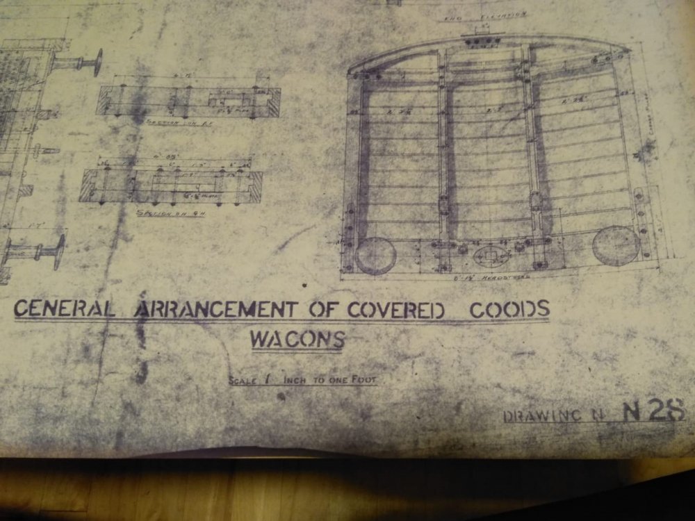

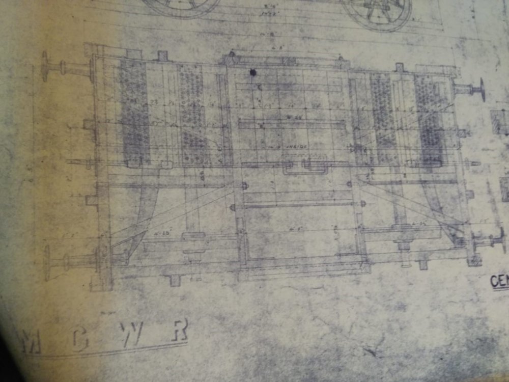

David Holman Posted September 9, 2020 Author Posted September 9, 2020 Just when I thought I'd finished building the MGW vans, was looking through Ernie Shepherd's bible on the railway and discovered the lovely photo which Roger had clearly used as part of his planning for the Alphagraphix card kit. Up till now, I'd been using the latter, along with a rather grainy photo of the prototype, which I now know is a copy of a print of a copy etc, etc. As the cropped details show below, there was not only the bracing between the axles to add, but the canvas roof [and associated fixings], along with some hooks and brackets to hold the doors open. Hence spent a couple of hours this afternoon, faffing around with all manner of things from plastic strip brass wire, tiny eye rings [from the Dingham couplings etch], masking tape and thin cotton to create all of the above. Hopefully you can work out what went where from the photos. 7 1

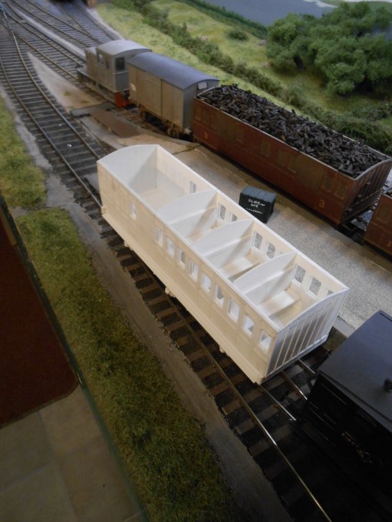

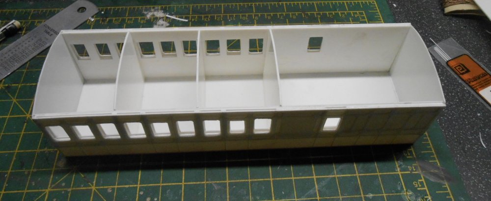

David Holman Posted October 14, 2020 Author Posted October 14, 2020 A new direction My 1950s fiddle yard has been full for some time. There are seven tracks, which if you include the railcar and railbus separately means eight trains. A few photos of these will appear in the Layouts section shortly. However, to extend interest in stock building, Belmullet will also feature an early 1900s period, so that is what I am moving towards now. First up is a train for my 101 [J15] 0-6-0. The loco was built last year, but still needs its tender pickups wired to the loco, plus some weight to improve its haulage ability. Its train is deemed to be a 'private special', comprising a six wheel first [for the wealthy] and a brake third for the servants and luggage. Two horse boxes bring up the rear. The first and horse boxes have been around for a while so thought that the brake third would be a good idea to complete the consist. The coach in question is based on the GS&WR one which graces the cover of Desmond Coakham's book on broad gauge coaches. It is being made from plastic sheet. The most difficult bit has been the marking out and subsequent cutting out of the panelling. This was done on a sheet of 10 thou. The worst part was filing all the rounded corners of the panelling - the MGWR makes life so much easier by having square corners meaning you can just use micro strip. This lattice/doilly was then stuck to a piece of 20thou to form each side and in turn, these were further built up to create a space for glazing to be added after painting. The two sides took about a week in all to do, but progress since then has been fairly quick, adding ends, floor, partitions and seating, along with the usual flexible six wheel under frame and springs/axle boxes. Ordered some Markits buffers from Roxey Mouldings this afternoon. Photos hopefully show progress thus far. 8 2
